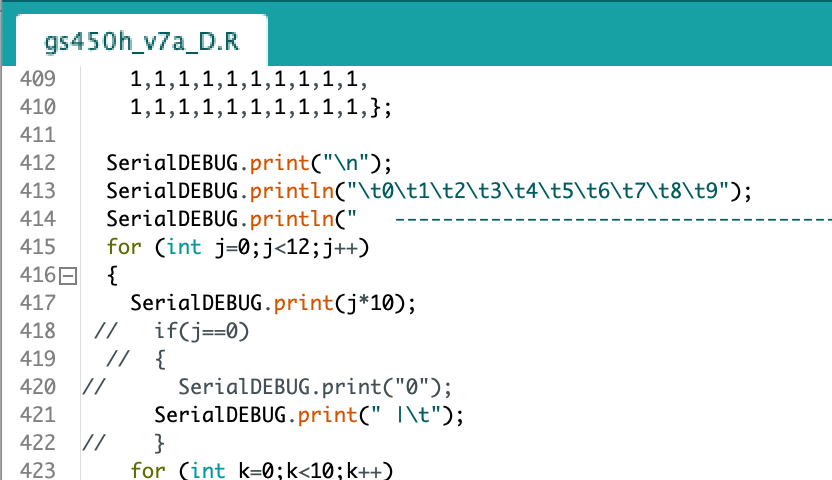

Dale, you've changed the behaviour of the debug mth printout in your tidy-up.
The "|\t" print should not be inside the if(j=0) bracket.

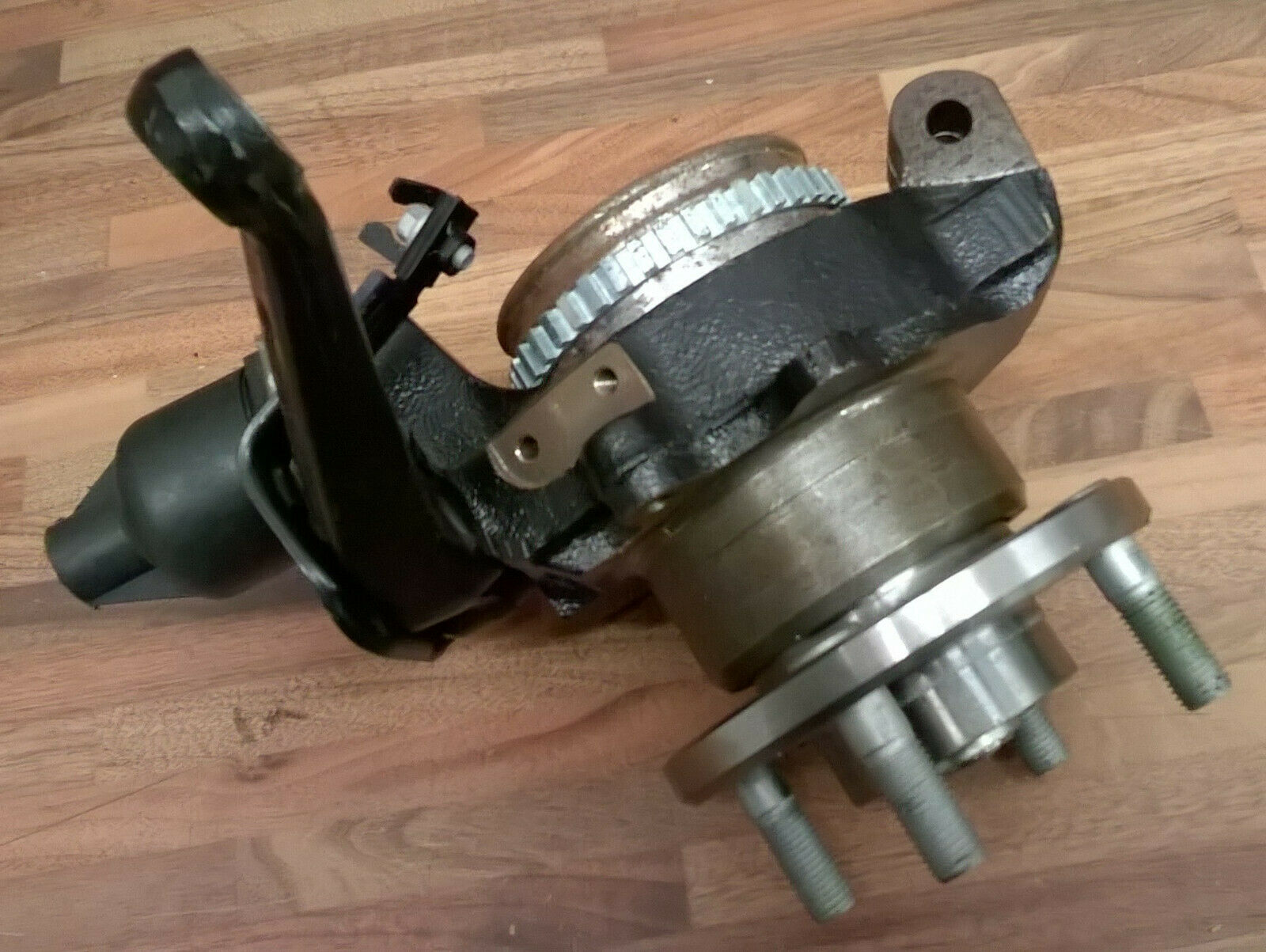

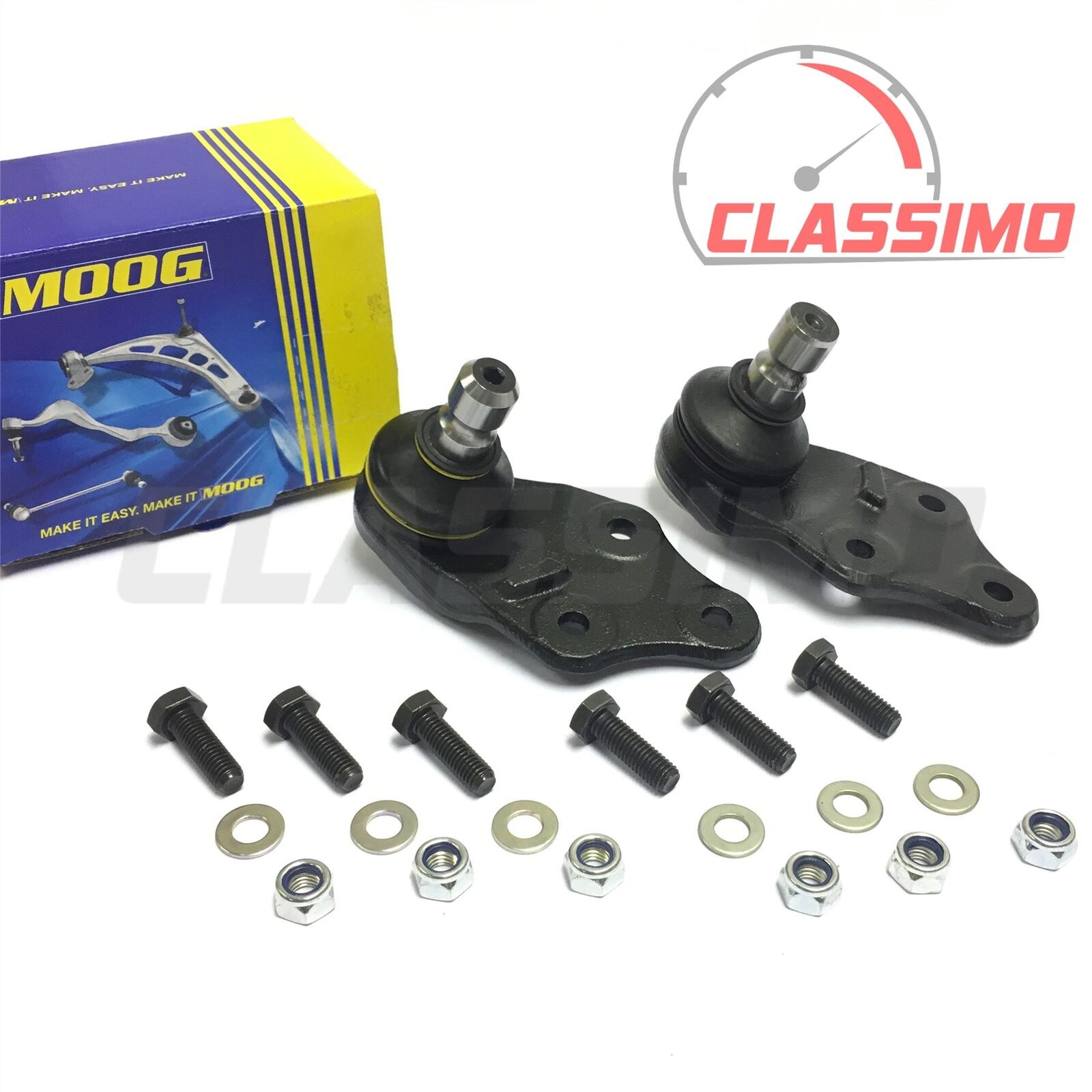

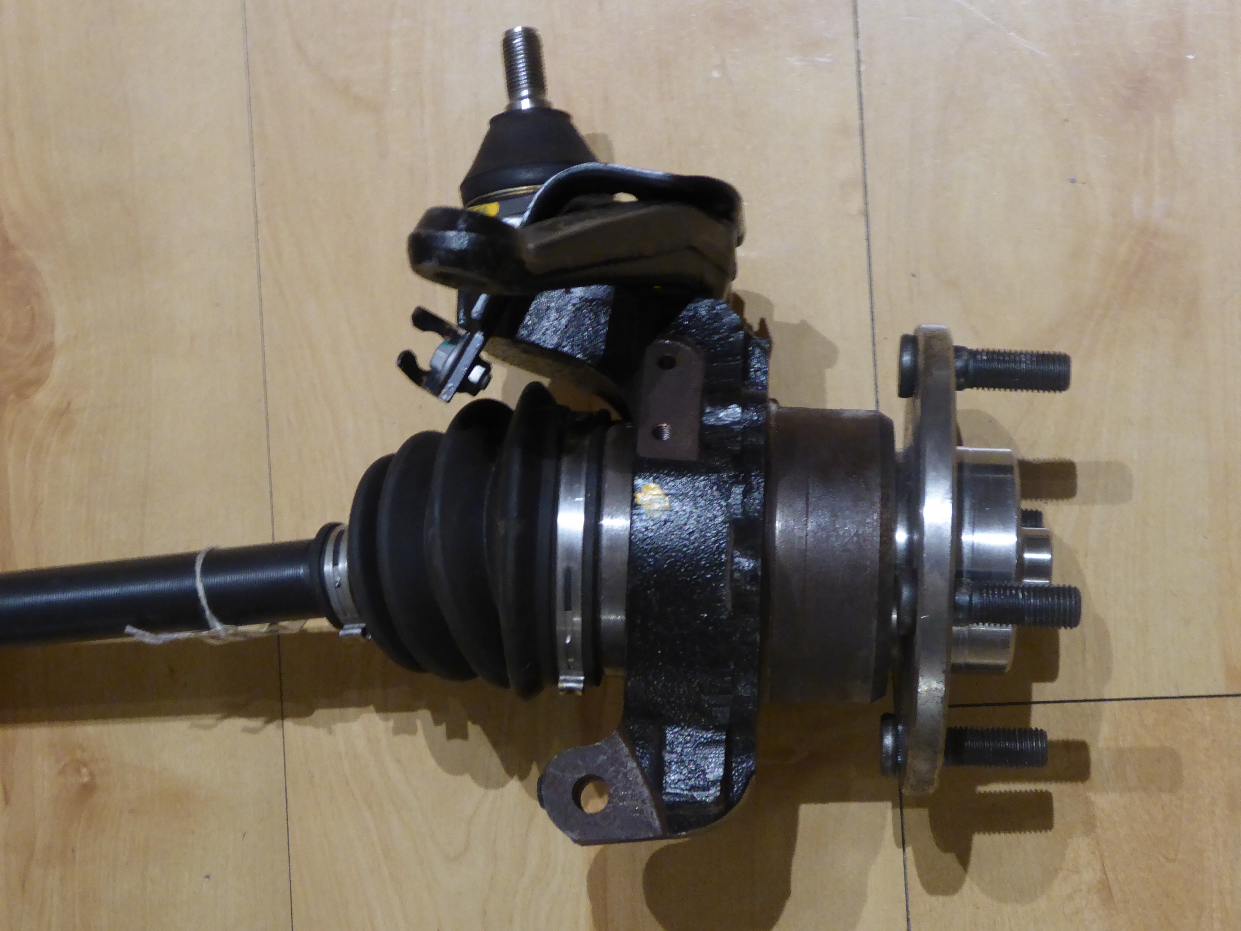

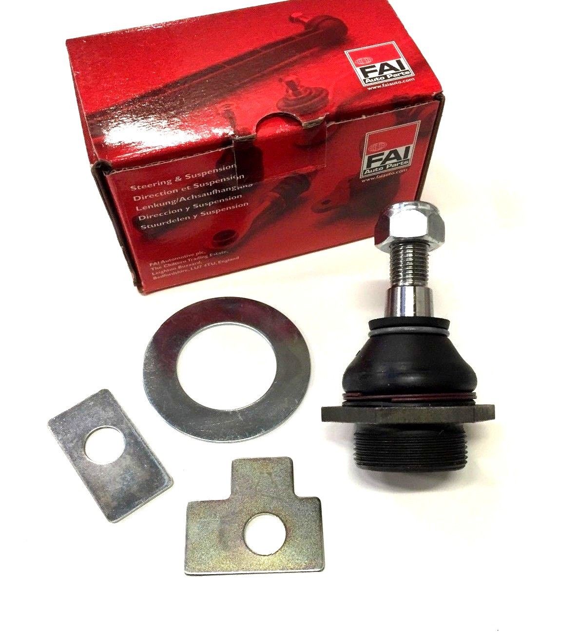

The classic MGF has an upper and lower load bearing ball joint.
You will need to take the ball joints out of your upper and lower arms.
Then weld on thick washers on their on the top arm place to make ~10mm then use a taper reamer to take the MGF/MGTF upper ball joint.
The lower ball joint is a bolt on 17mm pinch bolt so should be easier
Should be strong as f... , and cheap parts.
You can use a space saver tyre at the front?
With Ford 4x108 (4.25") Hub
Use a Ford Mondeo Mk3> 5x108 and drill new 5x4.50" for your PCD between the studs
The Mondeo hub is 40mm in diameter, you will need a machine shop to take it to 39mm
MGF lower ball joint
MGF upper ball joint
Complete hub, we can but a used pair for ~£20, ~AUD36
Thank you, and oops.
But I cant see that in the code I have?
I have this in version 3 user, "gs450h_v3_user.ino"
gs450h_v3_user.ino

Change was in the spreading out of the last quoted line of v3:
print(j*10) is the Row heading.
if(j==0)print("0"); is to line up Row Zero with 10,20,30 that follow, because the previous line would just output "0" not "00"
print(" |\t") is drawing the column separator vertical line. By putting it into the if(j==0) statement (in the v7 code) it does not print as intended.
I've modified mine to the following because I'm printing more than 100 characters:
  SerialDEBUG.println("\t0\t1\t2\t3\t4\t5\t6\t7\t8\t9");
  SerialDEBUG.println("   ------------------------------------------------------------------------------");
  for (int j=0;j<12;j++)
    if(j<10)SerialDEBUG.print(" ");
    if(j==0)SerialDEBUG.print(" ");
    SerialDEBUG.print(j*10);
    SerialDEBUG.print(" |\t");

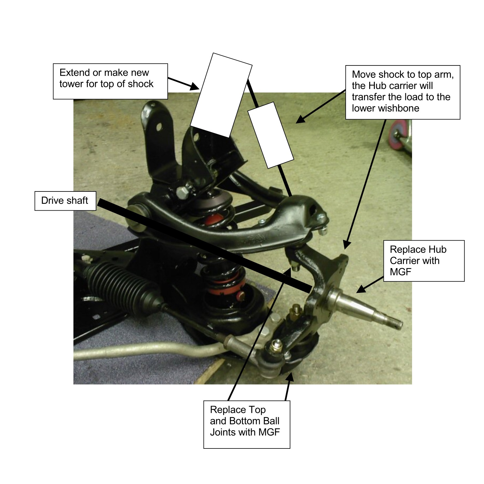

Front Hub Changes

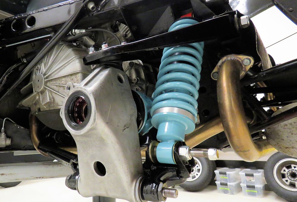

Yes, that looks a good guide plan..may 90 deg belcrank the top wishbone to allow for horizontal coil spring, or transverse leaf spring , center mounted, linked to top wishbone. Both options keep the height acceptable.
Shocks another consideration, as horizontal is abnormal, so perhaps shocks to the lower wishbone to clear driveshaft.
daleread
Posts: 49
Joined: Sat Mar 05, 2022 3:59 pm
Location: UK
Re: Hyper car hybrid
Post by daleread »

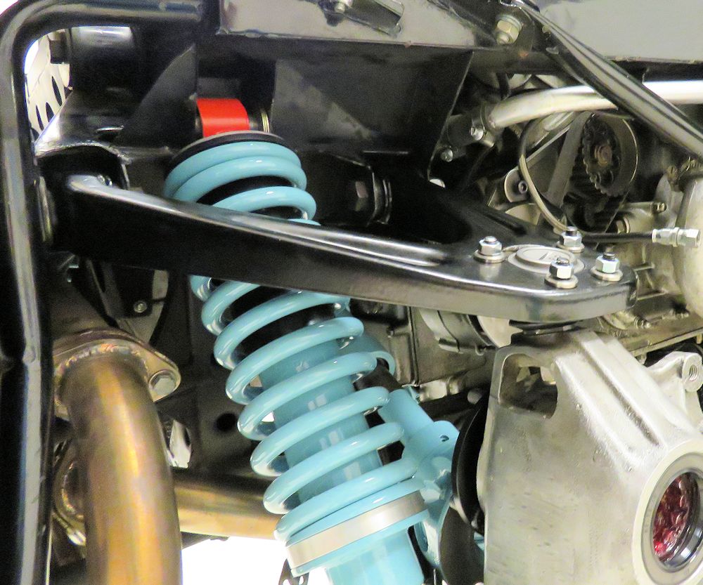

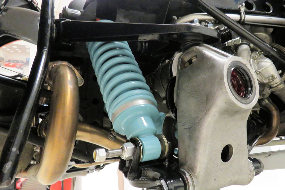

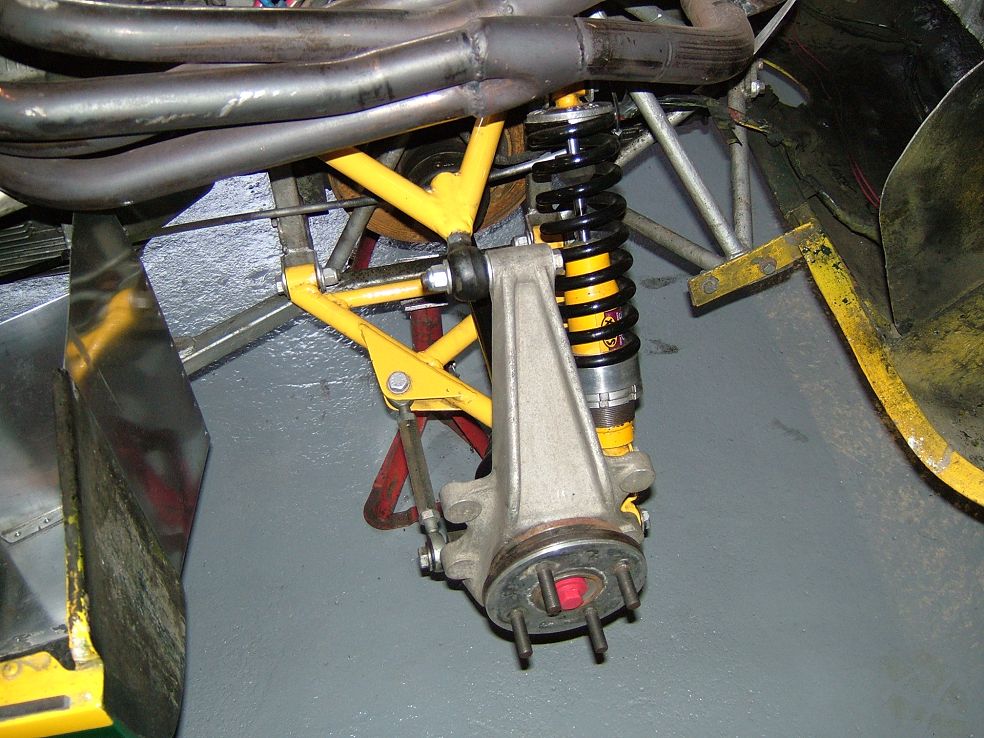

A leaf single spring is a no, no as one wheel will effect the other side giving weird handling, the last thing you need in a powerful car.
For Horizontal shocks they must be mono shocks and not the regular type.
These are often double the price.
Regular shocks have to stand upright because the valves are at the bottom.
Coil overs can be as short as 7"-9", 180mm to 230mm, that would bring the top tower down by (380mm-230mm) 150mm
See;
https://www.rallydesign.co.uk/product_i ... ts_id=5237
https://www.rallydesign.co.uk/index.php ... rers_id=53
You could, as you mentioned in an earlier post, use twin shocks lower down, but would steering clear them on full lock?
Bell cranks are good, but unneeded complexity, you need special shocks and where do you put the coil overs to not to crash with the electric motor?
Noble and Lamborghini both use a single lower shock that is not on the centre line of the wheel.
They know what they are doing...
BTW, there is no big weight in the front, the Motor is ~35kg

Thanks for the Suspension of the Noble and Lamb pics, are they your collection?
daleread
Posts: 49
Location: UK
Post by daleread »
Lambo, yes. Noble, not any more. But I am using a Noble M600 V8 4.4l twin turbo 6530bhp in the back of the RS200 EV build. 😊

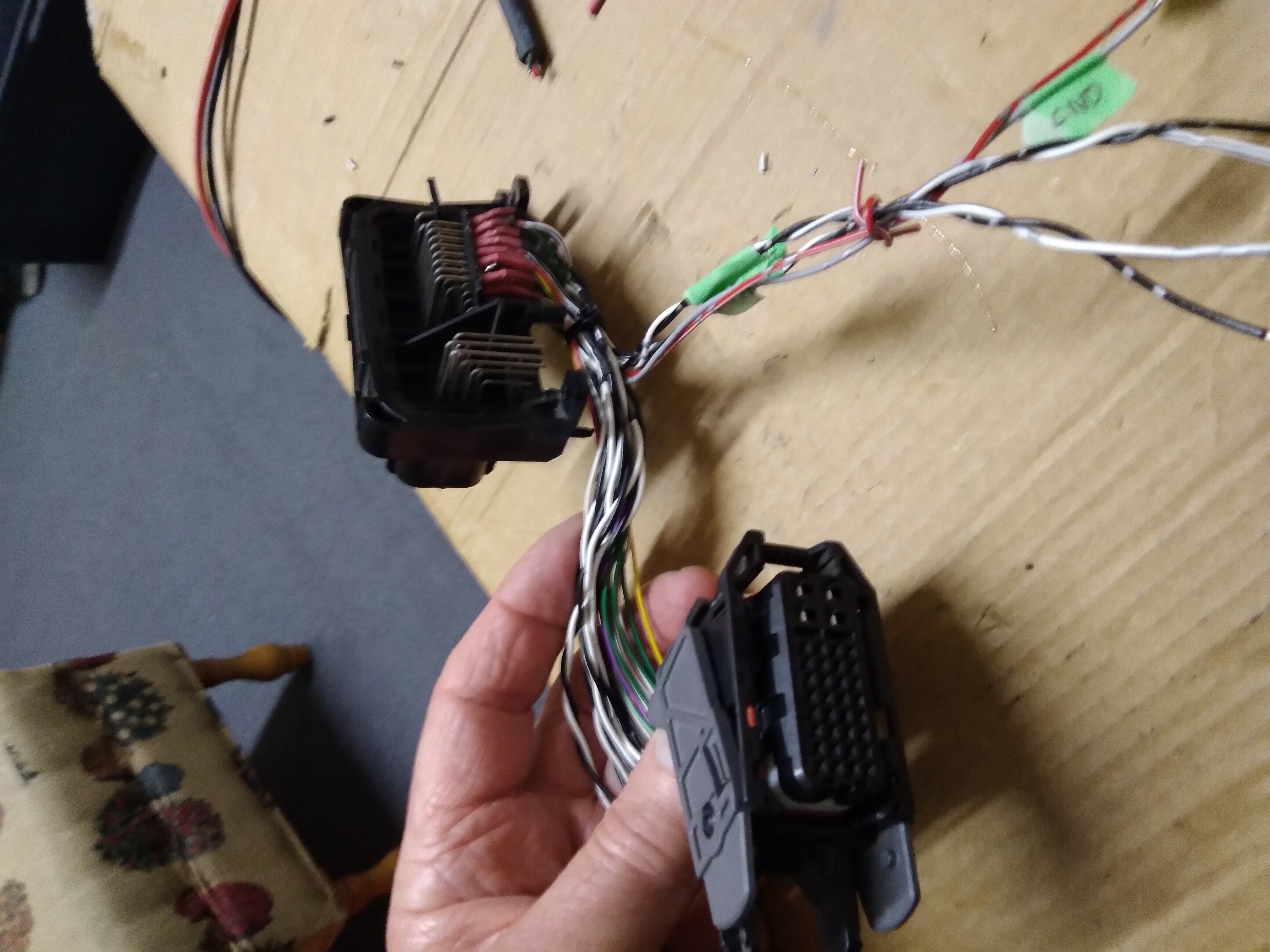

Hi Daleread, have procured plugs and rescued a socket from an inverter, to produce an extension lead adapter to allow MTH and HTM real car info to fill in some if the unknown gaps....Delivered to evbuilder last evening.
Have been severely distracted by some poor behaving Chinese trucks that are used locally, and have suffered from lockdown self discharge or somesuch.
Also Have Lexus gs450h transmission now aligned and bolted up to a Test Bed ic engine , for some impending charge and starting trials.

Hi Woodfie, finding those two plugs is not so easy, the Inverter to car and the Inverter to the resolvers that piggy backs onto it.
Looks like you are on the right track there.
