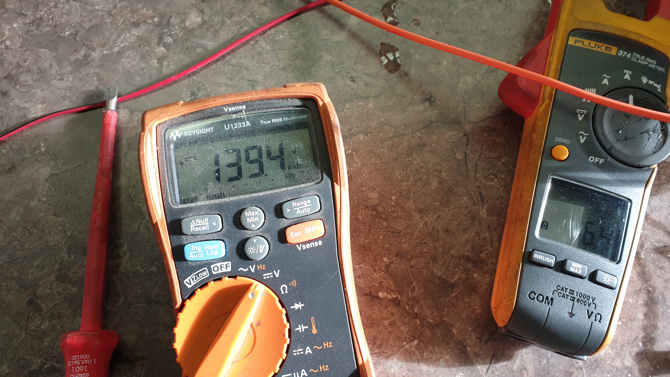

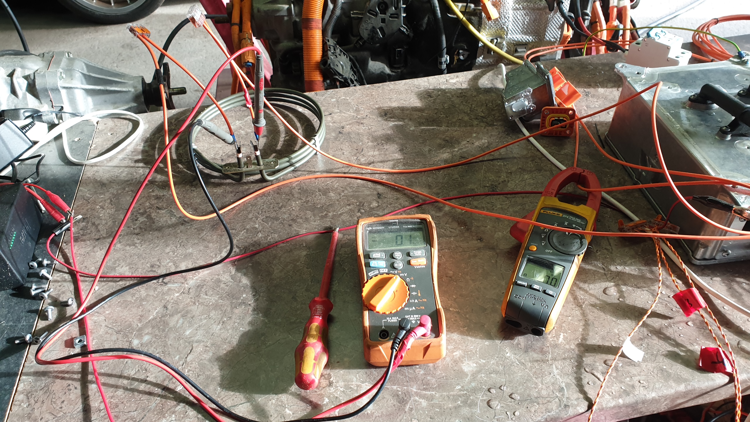

Small update. The good old Völlig Wertlos is finally responding to CAN generated by a micro and not just replayed logs. Oh and it doesnt care what you connect to the HV wires. 360v, 12v, heating element, dead short. Its mission in life is pumping current and annoying me with its silly amount of cross checks. But anyway, progress is being made:)

Wait so it just dumps out voltage even when it does not see any voltage present? This might greatly simplify my testing setup and allow me to do this at home.
Posts: 4000
Been thanked: 1116 times
Re: MEB Chargers
correct. its a current pump. Damn the voltage and full speed ahead. found the can message today that commands the charge port lock so yay. More soon hopefully.
