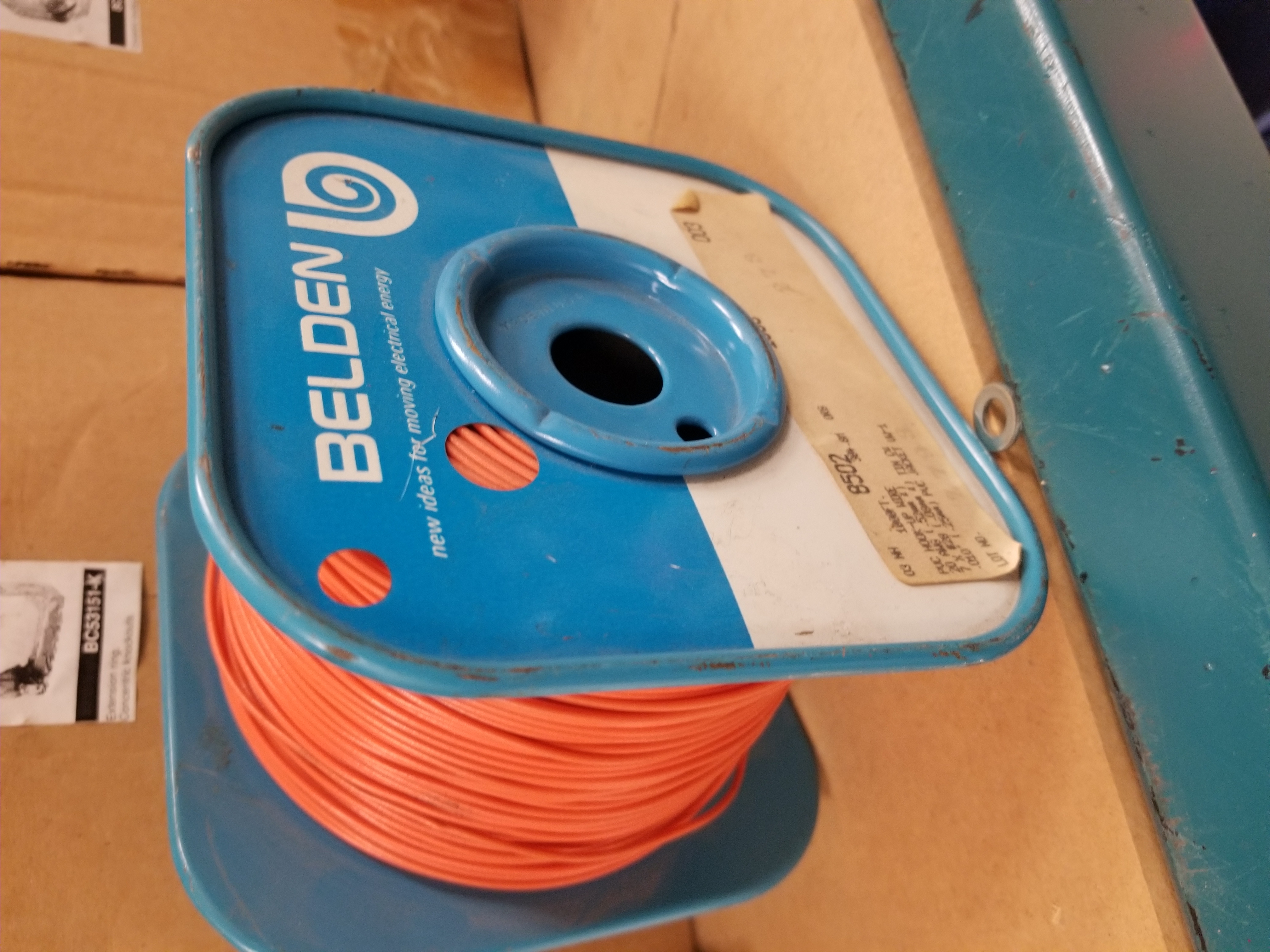

Can you provide links to the shielded/twisted pair cabling you used for comms and resolver connections? Amazon gives plenty of results, but would be helpful to know what you used and/or recommend.

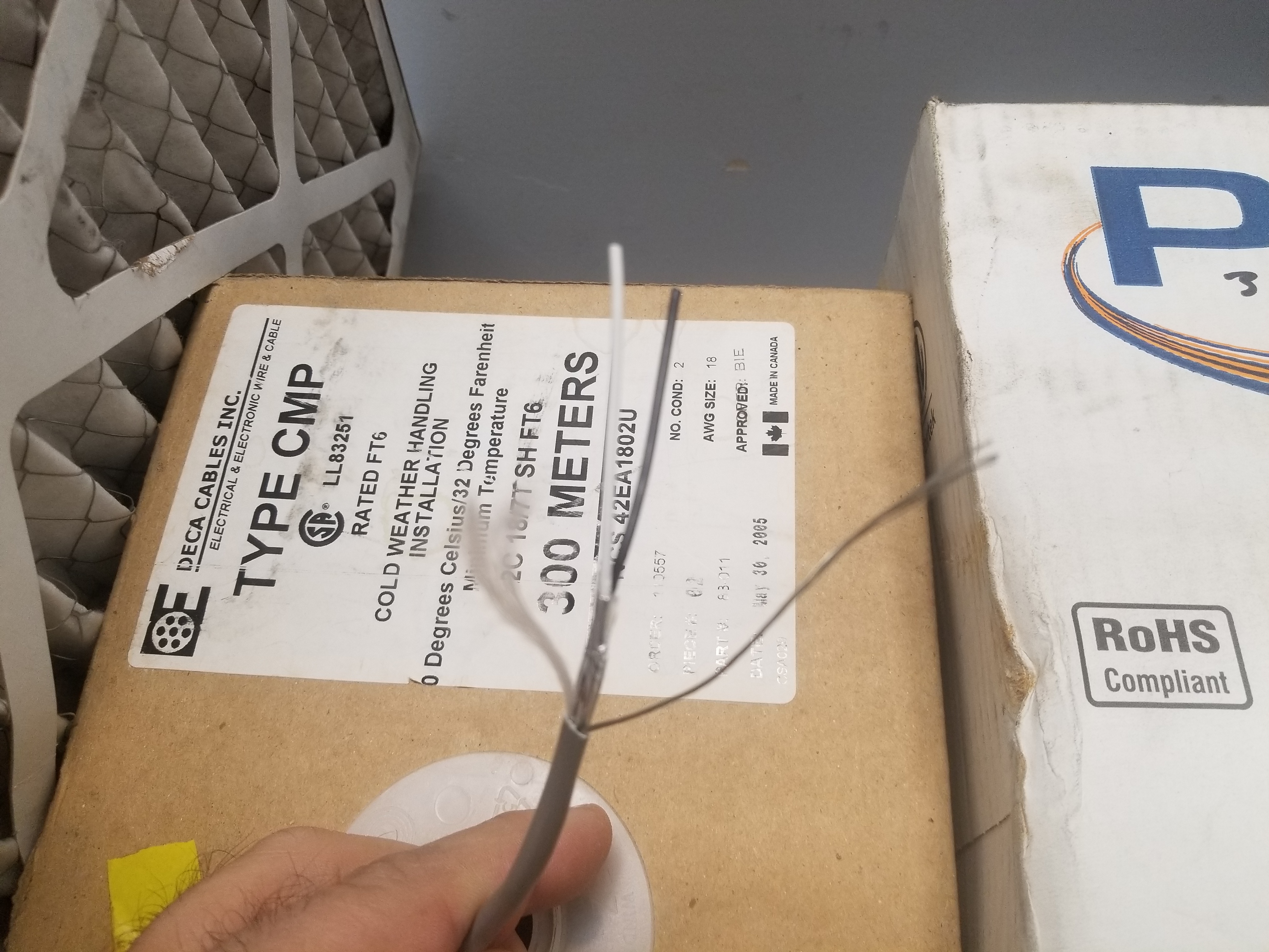

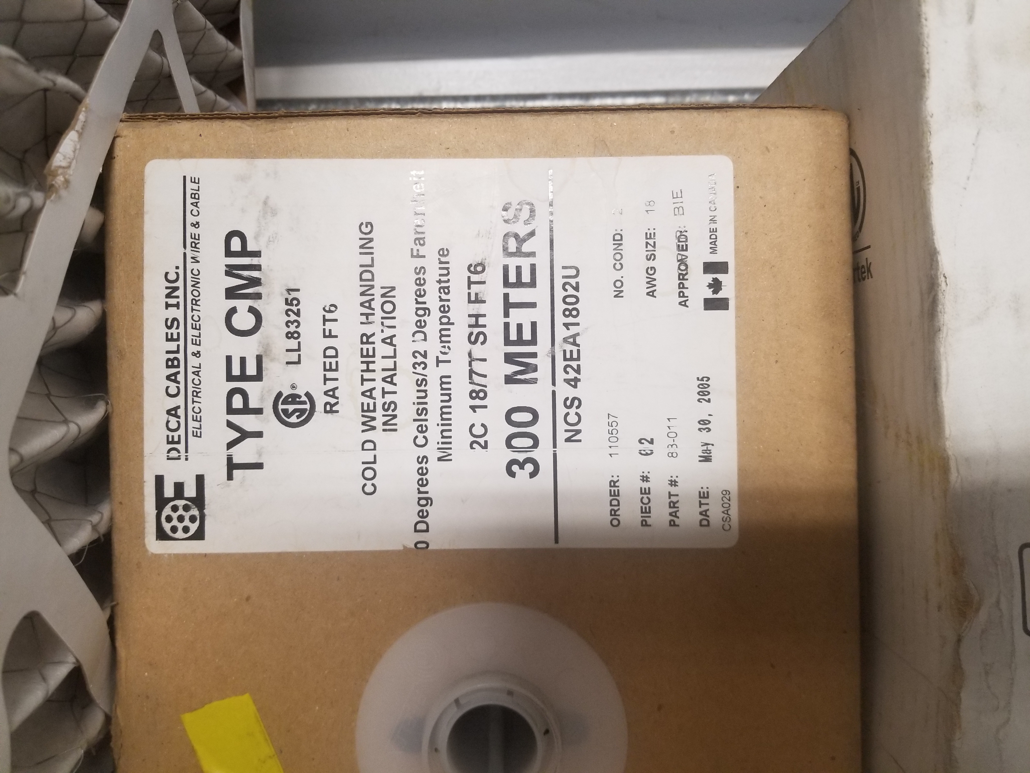

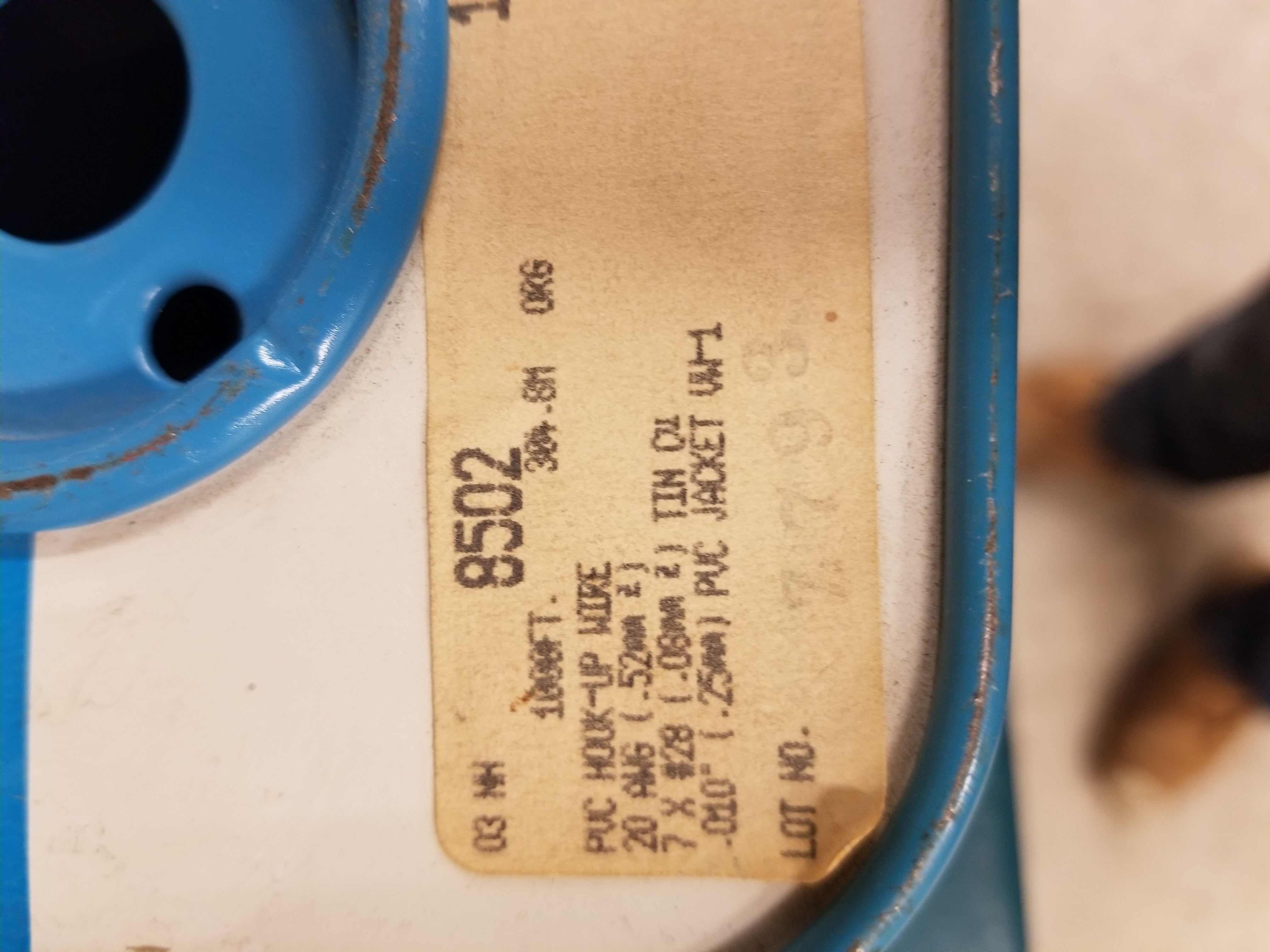

Sorry I don't have any links to the wire I used.
I "borrowed" some wire from work for my temp setup. 8-)
From my experience you don't want to use anything bigger than 20AWG
here are a couple pictures.
the wire on the roll worked well, but it single conductor and non-shielded.
the wire in the box is single pair shield. worked OK, but 20AWG would be better.
Both worked well in the resolver and MOLEX connectors

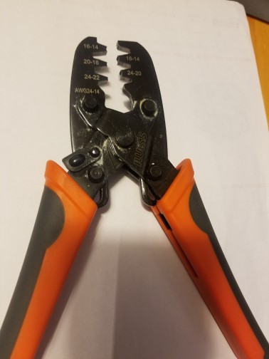

Crimping Tool
https://www.aliexpress.com/item/4001235 ... 4c4dj8NhvP
I bought one.
Did the job. I'm sure there are better ones out there.
Again took roughly 30days to arrive.

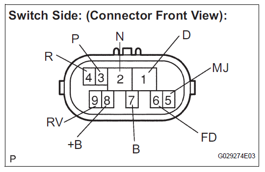

For the Position Sensor, the wiki isn't clear.
Below is my assumptions:
B+ -> 12V
D -> Zombie Forward
R -> Zombie Reverse
N -> Not Connected
MJ -> Not Connected
FD -> Not Connected
B -> Not Connected
RV -> Not Connected
P -> HSDN pin on Inverter
Is this correct?
EDIT Found this on the zombie page https://openinverter.org/wiki/images/9/ ... con-et.png was looking on the GS450h page :D

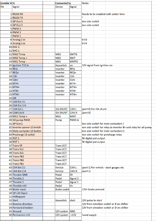

In the list of pins on Zombie VCU on pin:
(12) (MG2 Temp-) (MG2) (GMTG)
(13) (MG2 Temp+) (MG2) (GMT)
(14) (MG1 Temp-) (MG1) (MMTG)
(29) (MG1 Temp+) (MG1) (MMT)
Is this correct? Should it not be MMTG on MG2 and GMTG on MG1, and MMT on MG2 ang GMT on MG1?

JappeEs wrote: Thu May 02, 2024 7:24 am
Yes this is a typo

I have been working on a project with the Zombieverter and a GS450H and came across the pin sheet on the wiki "Zombieverter pinouts and wiring diagram for the GS450H", then this forum post. It looks like the wiki wasn't updated so I went ahead and made an updated image. While I did put a new image on the wiki, unfortunately it has a size cap of 2MB so the newest image isn't that clear.
Here is a full sized image if anyone wants to fix the wiki that can upload larger images:
