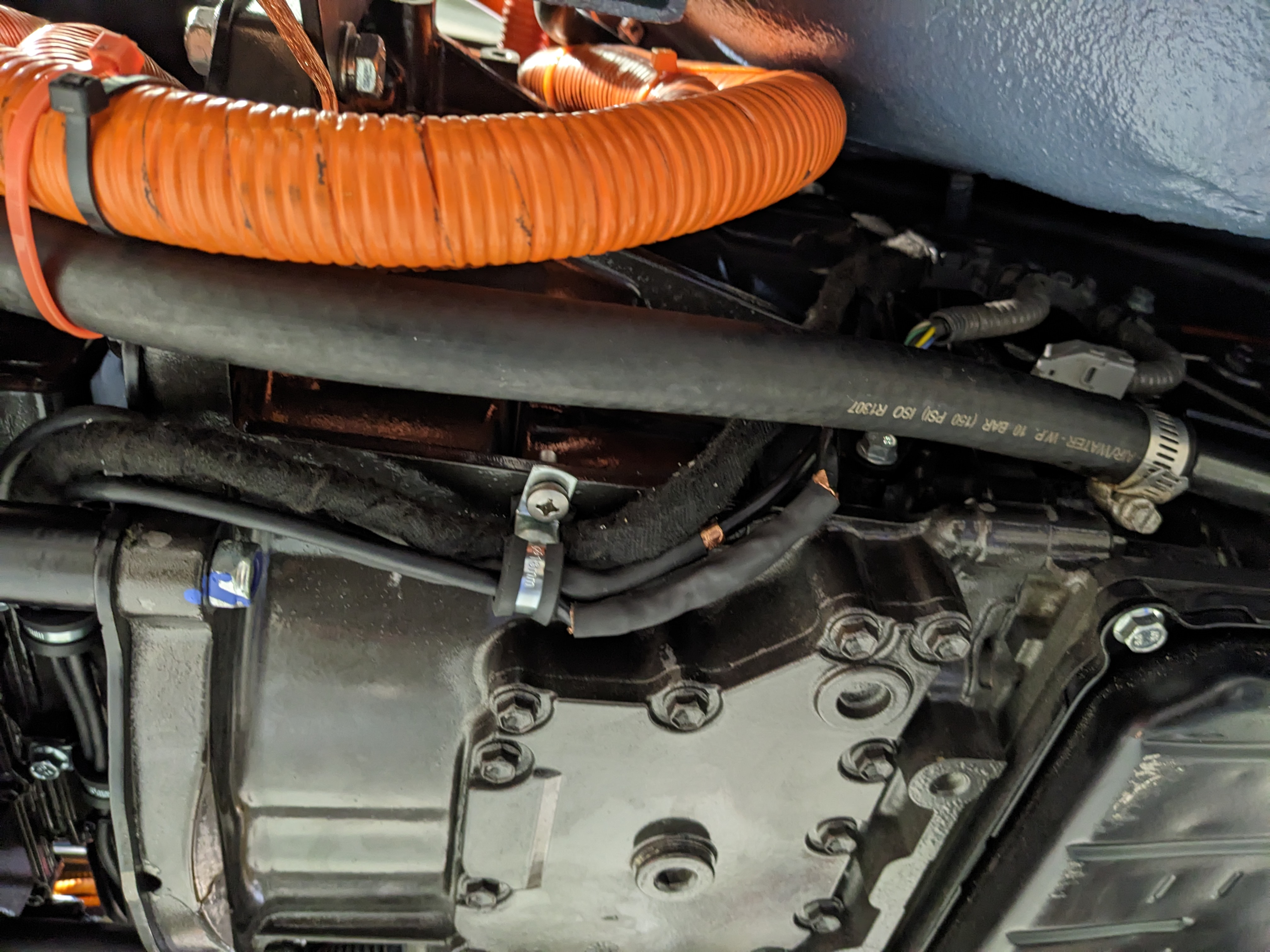

Update....
So I replaced the encoder wires with 6 core shielded wire. Funnily enough the original cables I had installed were twisted and had copper tape wrapped around the whole length but was not grounded at the inverter end.
With the new shielded cable installed it still has the terrible cut out. In fact I would say it is worse now :(
I moved the encoder wires as far away as possible from the HV cables going to MG1 and MG2 ... The inverter is mounted about as close as it can be to the gs450h.
Please see pics for reference...
One thing I would say when it does cut out if I keep my foot in the same position it continues to almost switch the power on and off violently. Obviously I do not like doing this as it puts much strain on the drivetrain.
The only thing that has improved my issue so far is removing the current limit from the code.
Shall I get another plot of torque and IDC whilst trying to keep my foot still? Before my plots show me letting off the power.
