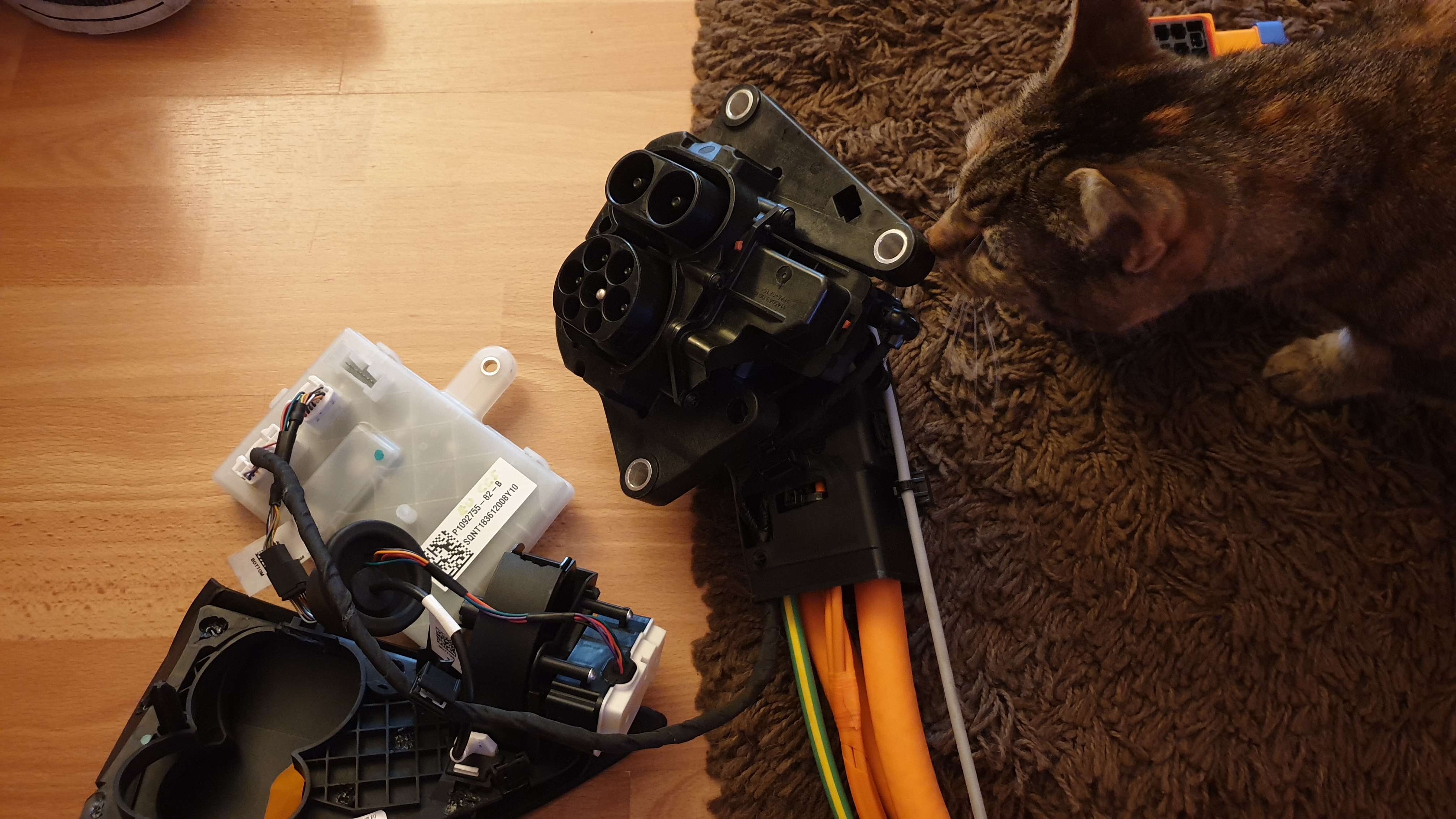

Re: Tesla Combined Charging System (CCS)
Bringing this thread back up as I now have an M3 CCS port and ECU to play with. Intention here is to support the work of mdrobnak who is working on the US version of the model 3 charge port.

Post by johnr »
Hello everyone. My business is making charging adapters for Tesla, and a few days ago I tried charging a 2020 Model 3 (North America market) vehicle using a prototype CCS1 to NA Tesla adapter. It didn't work, and maybe that's a confirmation that only the European Tesla vehicles have the additional hardware necessary to support CCS charging (unless I messed up on the wiring somehow, but I don't think so). Well, we will soon start making a European to NA Tesla Supercharger adapter that will work at the new Superchargers in Europe that have the CCS2 connector. So if anyone here can figure out a feasible way to retrofit NA Tesla vehicles to support CCS charging, I can fairly easily arrange production of the adapters to physically make the connection. FYI.
mdrobnak
Posts: 692
Post by mdrobnak »
johnr wrote: Sat Oct 03, 2020 12:00 am Hello everyone. My business is making charging adapters for Tesla, and a few days ago I tried charging a 2020 Model 3 (North America market) vehicle using a prototype CCS1 to NA Tesla adapter. It didn't work, and maybe that's a confirmation that only the European Tesla vehicles have the additional hardware necessary to support CCS charging (unless I messed up on the wiring somehow, but I don't think so). Well, we will soon start making a European to NA Tesla Supercharger adapter that will work at the new Superchargers in Europe that have the CCS2 connector. So if anyone here can figure out a feasible way to retrofit NA Tesla vehicles to support CCS charging, I can fairly easily arrange production of the adapters to physically make the connection. FYI.
Yes, if you look at the standalone development thread, you can see the board is physically larger and has the GreenPHY support on it.
The practical road path I see going down this road is reverse engineering the signals the Chademo->US Tesla connector uses, and having a CCS adapter speak that. If you're just doing a physical connection change, that's not going to work. Which business are you associated with?

johnr
Posts: 5
Joined: Fri Oct 02, 2020 11:41 pm
Post by johnr »
mdrobnak wrote: Sat Oct 03, 2020 5:26 pmYes, if you look at the standalone development thread, you can see the board is physically larger and has the GreenPHY support on it.
Hi Matt,
Good to know. I'm with EVSE Adapters . I was hoping for an easy solution but it appears there's no realistically feasible way until Tesla chooses to support the standard natively. The weird thing is that NA Tesla vehicles using the right adapter can charge at the European Superchargers which have CCS plugs (and non-Tesla vehicles have temporarily been able to charge at these Superchargers too). Maybe the Supercharger has its own programming and can switch between Tesla and CCS modes...
