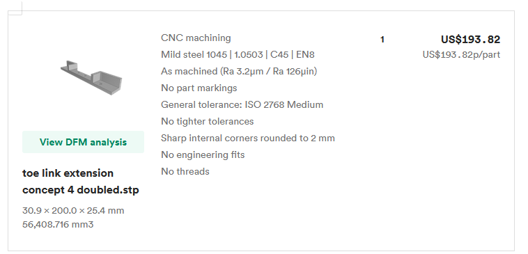

For some reason I decided to work on the toe link extension first. This is the least critical and I'm not even sure I'll bother with it, but I wanted to get the design finished. The purpose of this part is to move the connection point further away from the lower ball joint, which will allow more precise adjustment when setting the rear toe angle. What I have is workable, just somewhat tedious and I was going for perfect. Originally I didn't make the mounting point further away because the uprights were already expensive and extending the tab further out would just add to the cost (larger stock size to start with, more time machining away all the unused material).
So this is what I'm thinking about doing. It will use the original toe link bolt hole as well as one more hole I will need to drill and tap. Thinking steel for the material - more strength and the weight is negligible.
Still iterating on the design, but now I also need to find a way to make it cost effective. One way to do that is to remove certain features that I know I can mill myself on my manual machine. I hate hogging out tons of material but if the savings are significant then it may be worth it. Also, maintaining a flat bottom surface and designing it such that the features can all be machined from above on a 3-axis mill can help, so I removed the hole that is perpendicular to the rest of the part - I can drill that myself.
Yikes - this is going to be expensive! Here, I left that perpendicular hole in, and left out some of the less precise cuts that I can hog out myself. Since the parts are mirror image though, no discount for quantity. Going to end up paying double this for both sides.
Okay, suppress that perpendicular hole, and what if I mirror the part myself so it's one long 'stick'. Add a bit in the middle for the saw kerf and I can order 'one' part and cut it in half. Okay, not double the price! Great!
Now, hogging out the middle is not going to be fun. Maybe I will replace that feature and see how much it goes up. Sorry this one is formatted differently, I had to go back to my history to screenshot it.
After that I noticed the height of the part is exactly 1". Width is just under 1.25", nothing I can do about that. But the height doesn't NEED to be exactly 1". They may think they need to start with a taller piece of stock so they can machine it DOWN to exactly 1", which adds material costs and the extra machining time to remove all that excess material. I can change it to be 0.985" tall with no impact to me, and that tells them they can start with a 1" bar and skim it down. Not a huge change, but a slight price drop.
That's where I am at now. Next step is to do some stress analysis and determine if it actually needs to be steel or if aluminum will do. Aluminum will be cheaper and easier for me to machine. The reason steel is more expensive it because it takes longer in the machine and is harder on tooling. So not a super consequential update but I home someone finds it interesting. It gives a small insight into the process of designing something like this for easy/cheap manufacturing.

Where's the quote from? Have you tried JLC's machining services yet? They made a couple intricate polypropylene parts for me with orings and BSP threads that run at 250psi. They did a great job.
Re: [Driving] Homebuilt Locost 7 - from Motorcycle engine to Leaf power!
Posted: Mon Nov 18, 2024 4:23 am
by Zieg
Ah, yeah no room to run it under the upright unfortunately, very little clearance to the control arm. I could probably run it on the top though. Still won't likely be symmetrical but I can try. I'll also have to jog it down or use a spacer where the link connects - gotta keep it on the same horizontal plane as the ball joint centerline or else it'll have bump steer. I'll put some more thought into going across the top though, thanks for the idea. Added benefit would be not having to take it all apart to drill that extra mounting hole in the bottom edge!
These quotes are from Protolabs, same place I got the uprights made. I haven't tried JLC but I will check it out, thanks.

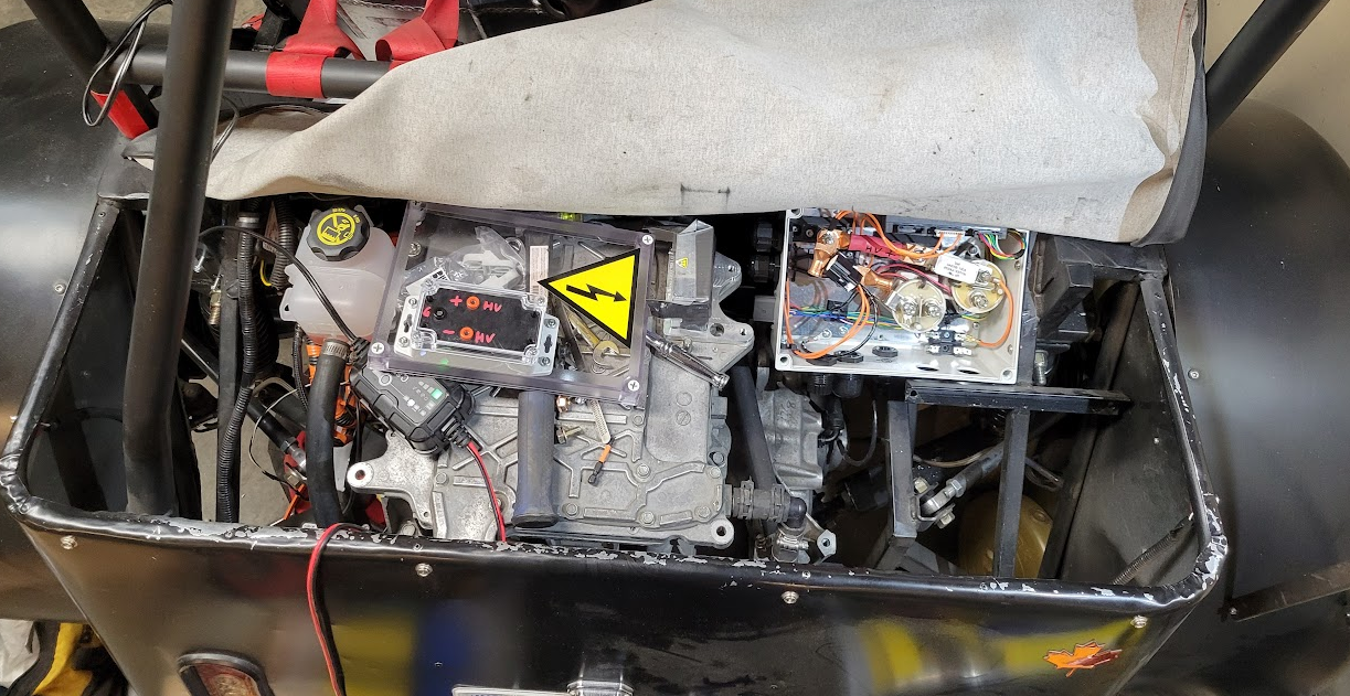

Been working on the junction box I need to add to the rear of the car, while also pulling out the old HV cable to replace it with shielded cable (required by the SCCA rulebook). I think I could use some opinions on where to locate my new CCS charge port. I think I have it narrowed down to two options but I'm not thrilled about either.
First, here's the new junction box. Basically the wires from the contactor box come in from the left side, terminate at the posts (which are at different heights), then exit through the bottom of the picture to go to the inverter. The contactors in this box are for the CCS port. The black box in the upper right is the insulation monitor. The cable from the OBC will enter through the cable gland at the bottom middle, where one leg will go through the fuse block and the other leg goes to the live side of the negative CCS contactor.
The random loose plug you see in the above image is for the insulation testing system. The regulations state that you need to bring your HV+ and HV- through some 10k resistors and terminate at a pair of 4mm banana jacks which have a separate cover over them. To test the system you need to connect a cable with one more resistor that will bridge either the HV +/- together or to chassis ground, and the insulation monitor must detect the fault and open the main contactors within a few seconds. Here you can see how I added those ports. I am thinking about 3d printing a cover that looks like a household electrical socket and then making the test cable look like a fork. :)
And here's a zoomed out photo of the whole boot, showing where the junction box is. The OBC gets mounted to the bracket just below it.

Unfortunately that's where the good news ends, because EVs are still banned from all tracks in Alberta. I just heard back from the local governing body and they've made zero progress towards finding a solution. From the tone of the email it's pretty clear they don't have any interest in working on the problem. There are two clubs in BC that are a 4-6 hour drive away and in theory they do allow EVs, but when I contacted them to verify I'd be allowed to run, they said they need to discuss and get back to me. I haven't heard from them since. So, I'm feeling very discouraged. The only other option is to go to Montana, but with recent political tensions I'm not sure I want to try bringing the car across the border. Have heard several horror stories recently.
I think I need to seriously consider other options now, as much as it pains me. I'm trying to at least examine all possibilities no matter how much I may dislike them, and so far I don't think any of them are good.
1. Sell the car (no idea how much I'd get) and buy something with an ICE. I really don't want to sell it, and I doubt I'd get enough to afford what I'd want to replace it with.
2. Convert the car back to ICE. Expensive and a lot of effort. I really like how it drives as an EV and I'm not keen to go back.
3. Store the car for a while and buy something else to race in the meantime. Best I can come up with is a cheap Formula 500 or Formula Vee, but those are rare around here.
4. Keep doing what I'm doing, which is not racing at all and only driving the car on the street on weekends. At least I get to enjoy it a bit, but it's not what I built it for, and I really miss racing.
5. Try to build another ICE car on the cheap, but this is a huge time investment and I don't think I could build one cheaper than buying it.
Anyway, in addition to feeling sorry for myself I also built a new set of loading ramps since the old ones were a bit flimsy and warped due to the way I welded them. Won't have that problem now! They are upside down in the photo, but the near end hooks onto the ramps inside the ambulance and the stitch welded flat bar along the sides keeps the car on the ramps.
And I posted this in the Foccci gallery, but here's my first DCFC session. It ran for about 10 minutes before cutting out, I believe it was because of interference from my isolation monitor. I did have it disabled, but the IMD also has internal relays that you can command open. I didn't have that function in place at the time but I've since added it.
It snowed again today, so I may or may not be able to try another DCFC session this weekend. There's also a nearby EV awareness event happening on the weekend. It's geared towards educating people about EVs and convincing them to buy one, but I'd like to go anyway to check it out.
