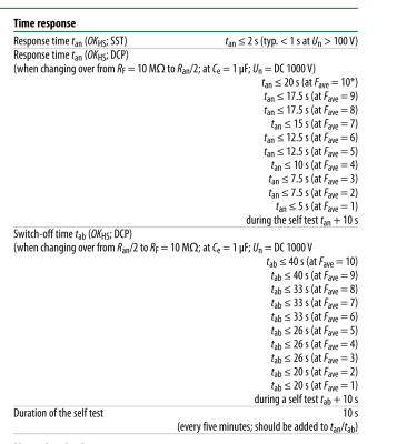

I've found a couple different datasheets for the 3210:
https://pamir.com/wp-content/uploads/20 ... 012821.pdf
https://www.bender.de/fileadmin/content ... D_XXEN.pdf
It's hard to tell if the differences are just in certifications and such, or if there's actually a configuration difference to the device. The second 3210 datasheet mentions the 'AMP' monitoring as opposed to 'DCP' measurement, but then the first 3210 datasheet mentions both so maybe they're interchangeable. The 3204 datasheet I have only mentions DCP.

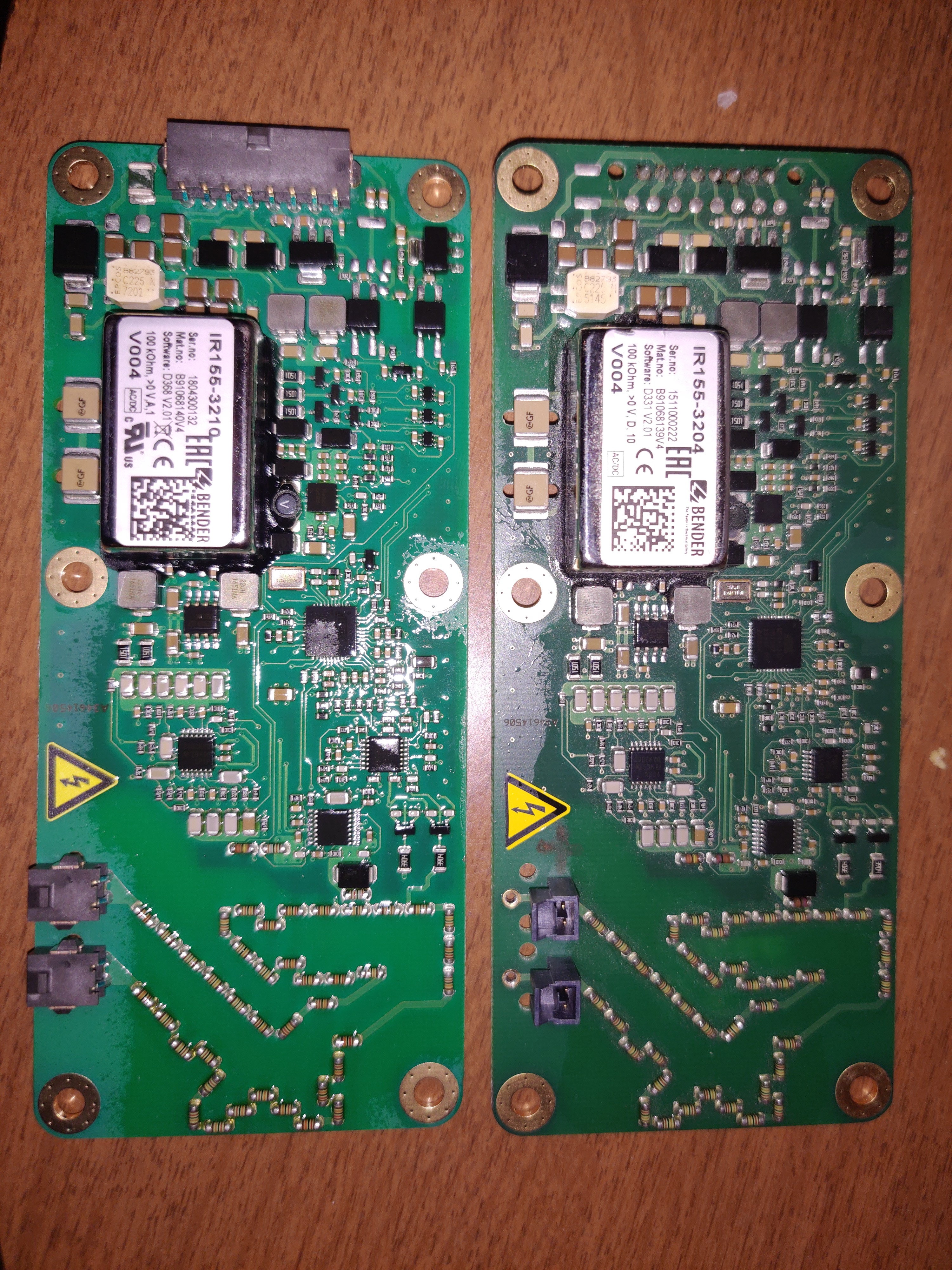

Post by nickyivyca »
Comparing the 3210 to a 3204, the only difference is the missing ferrite bead (I think that's what that is) on the bottom left corner of the board, and the label applied to the brick. (The Nano-fits on the 3204 were a manual modification and not how it originally came, borrowed board from my old FSAE team to compare)
I'm guessing D,10 and A,1 are the different parameters. If the 1 is the Fave number then that would mean the 3210 is just more reactive than the 3204.
Plan to install in my 914 as part of the next round of upgrades, we'll see how soon that happens.

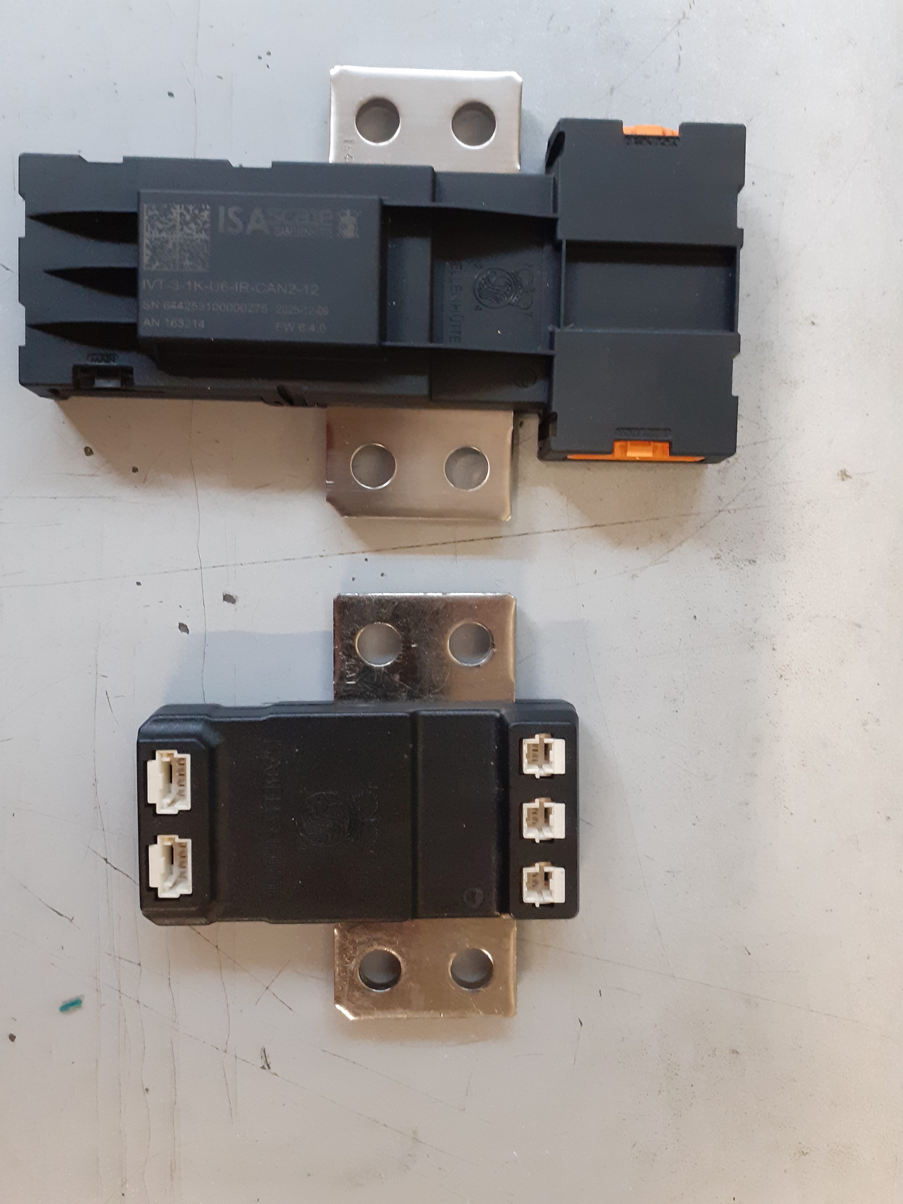

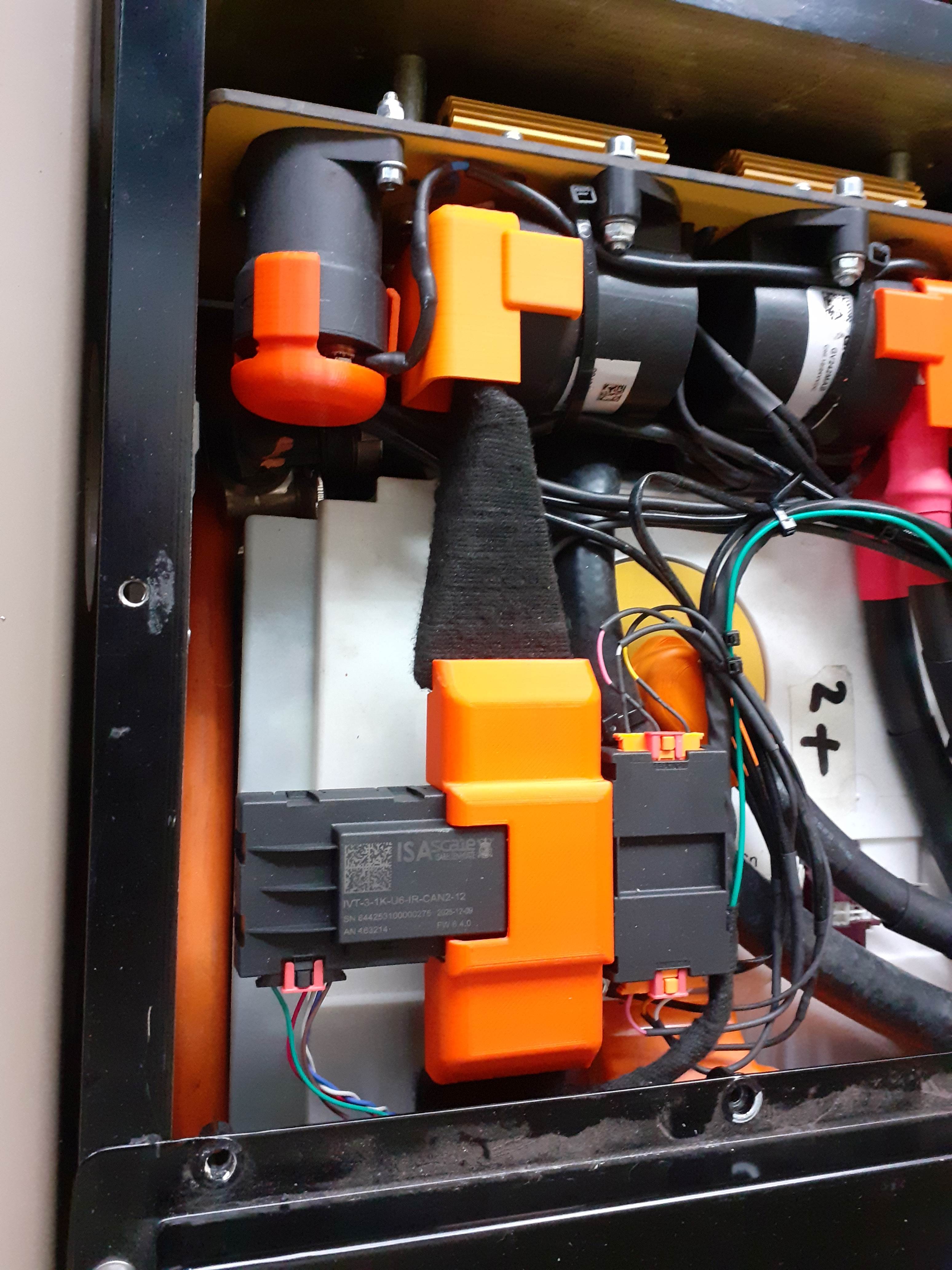

Post by muehlpower »
I have now received and installed my IVT Pro with insulation monitoring. The mounting dimensions are the same as for the old IVT with 1k (2 holes), but as you can see from the data sheet, the housing is significantly larger. The connectors are on the side, and I have not yet found a source for them. I printed a suitable cover right away. The CAN messages are different from the old ones. The configuration can be changed by customers via UDS security access level 1, whatever that means. I use it out of the box :) The insulation measurement can be switched on and off via CAN to avoid interference with external insulation measurements during DC charging. There are no switching outputs. Output is exclusively via CAN. A Ctrl. CAN message with CRC must be sent continuously, otherwise the insulation measurement stops. The other functions also work without it. I also found an insulation fault right away. A radiator hose was in contact with an exposed part of the HV+ cable, causing the resistance to drop below 1kOhm. After I fitted a plastic cap to the contact, the value rose to 3600kOhm. The internal sensor warning threshold is 1000kOhm and the alarm threshold is 400kOhm. For my 400V system, 200kOhm AC and 40kOhm DC would be sufficient after the R100. With an additional 2 MOhm resistor, the system measured perfectly and my total value dropped to 1700 kOhm, which would still be sufficient. HV+ and HV- are also output separately, making it possible to identify which line is causing the problem.
