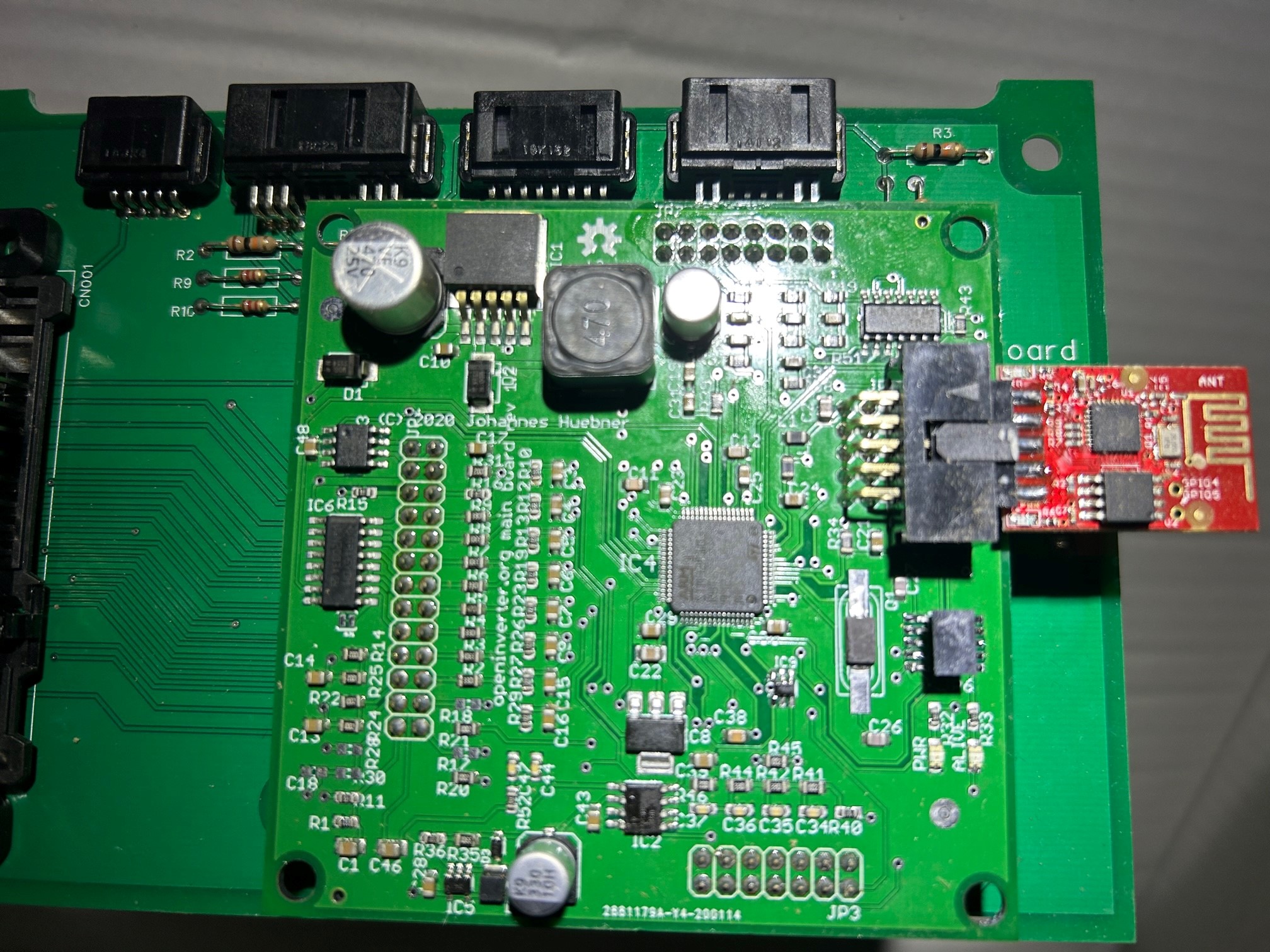

No, the gate drivers would be overkill as they add isolation and power switches.
The Skypers need 0/15V drive signals while the main board provides only 3.3V. So you will need to do some level shifting either with an IC (don't know which one) or some simple PNP transistors. Emitter to 15V (you have to generate 15V anyway for powering the drivers), base to main board via 10k resistor, collector to skyper input with 1k pull-down resistor.
Re: Mainboard V3 FAQ
Posted: Fri Feb 12, 2021 5:03 pm
by Isaac96
The v3 board does not include gate drivers. You'll need to figure out some sort of output scaling to deal with that.
It looks to me, upon checking the Skyper32 datasheet, that they just need 0v - 12v inputs.
https://www.semikron.com/dl/service-sup ... 100102.pdf
So maybe you can figure out some sort of buffers for that, maybe a ULN2003 and pullups?
-Isaac

Posted: Mon Oct 28, 2024 9:03 pm
by D@F
hi there !
i'm backafter a long time! and i would like to know if there is a change log for the version of the board?
i have this card to fit inside my nissan tower
will i have to do some upgrade ?
thanks
Posted: Mon Oct 28, 2024 9:45 pm
by johu
Will work a treat!
The new version has the ESP32 and uses the Mini Mainboard for easier manufacturing but does the exact same thing
