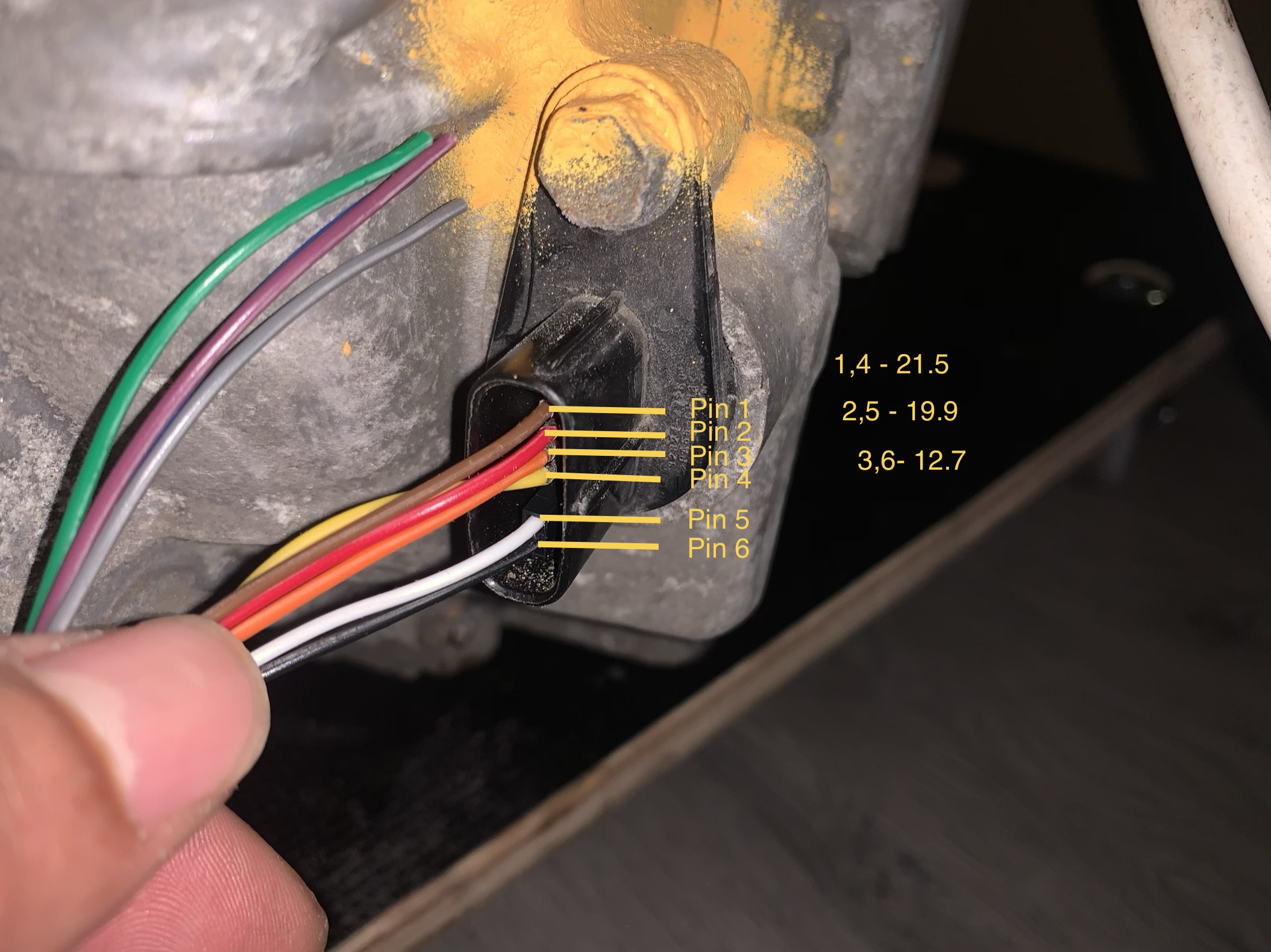

Hi all, when setting the parameters on the MG2 of the Prius Gen 3 Transaxle, I've managed to figure out the resolver exciter pins, however I seem to be getting the same plot results from all 4 of the other pins on the resolver. The results are very similar and all appear to be giving decent reading according to Damien's FOC tuning video. This is a photo of the pinout, pairs, and resistance values. Has anyone got this working successfully or have the pinout? Also are there some parameters that I can compare mine to please? I'm using a Prius Gen2 inverter and a Prius Gen 3 transaxle.
Thanks in advance
Re: Transaxle Modifications
vin wrote: ↑Sun Nov 08, 2020 5:52 pmJack Bauer wrote: ↑Sat Aug 29, 2020 1:38 pm Please understand I'm not trying to give anyone a hard time. The toyota stuff is very promising. Examples being the gs450h and prius gen 3 inverter both of which I am comfortable selling control boards for as I have proven them first hand in my own cars. I just wish someone, anyone , would forget about perfection and just throw something together to prove the viability before we get tied up with bench tuning motors etc. Again, please don't missunderstand I'm just trying to give of my experience both past and present of things that "everyone" said wouldnt work that subsequently did and vice versa.
It turns out that on the picture I've uploaded
Pin 1 = Sign
Pin 2 = Co Sign
Pin 3 and 4 = Exciter
Pin 5 and 6 = Ground
