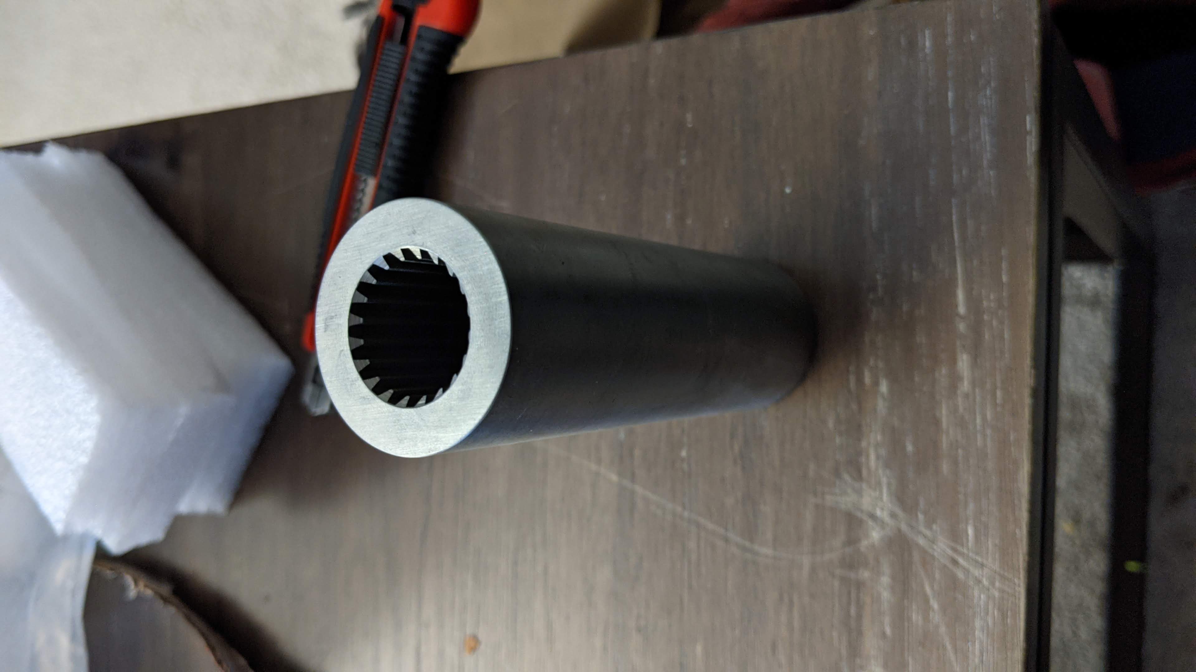

hey folks, after lots of back and forth with the machine shop, v2 couplers are finally in production!
-4140 alloy steel
-simpler design. No flange, but still compatible with the bearing.
-cheaper!

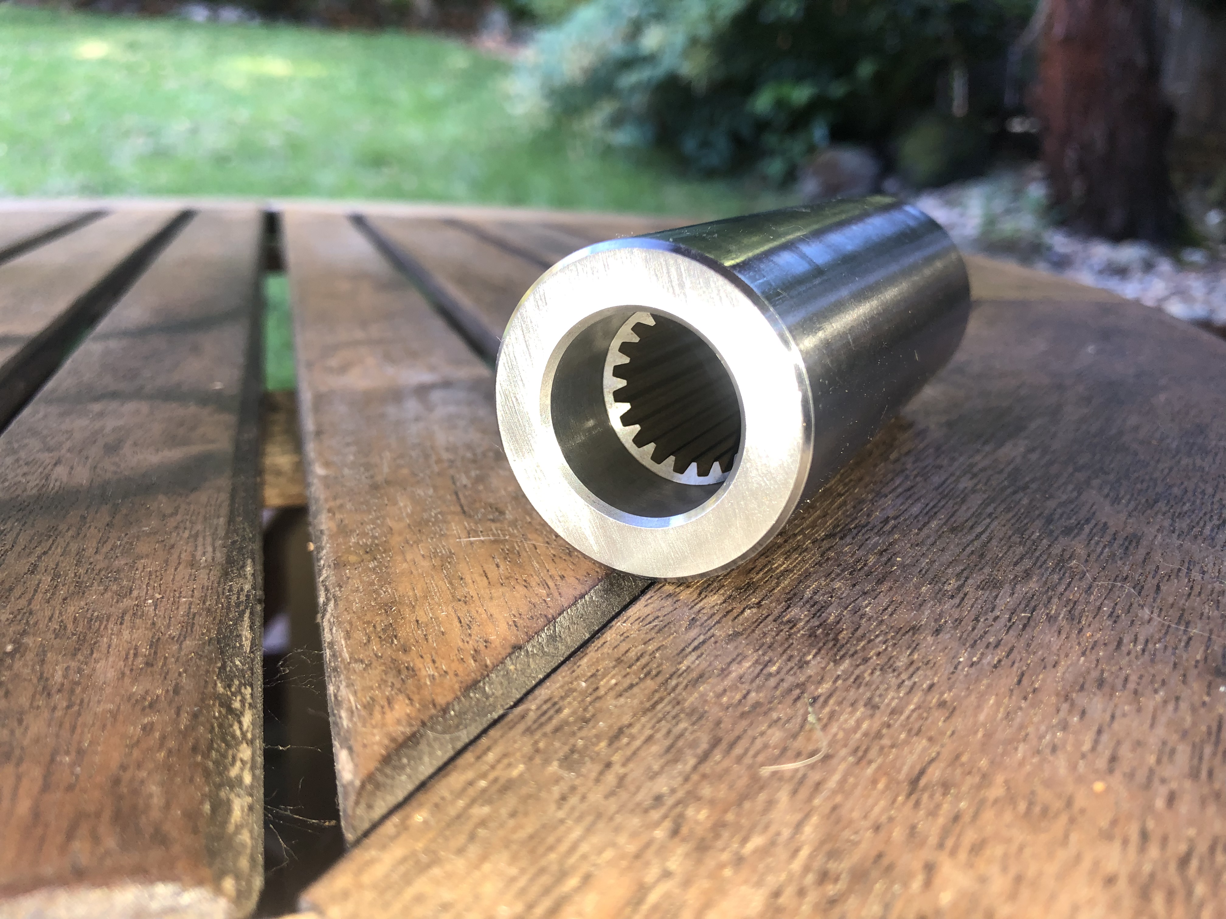

v2 couplers arrived !
EDM machined 4140 goodness

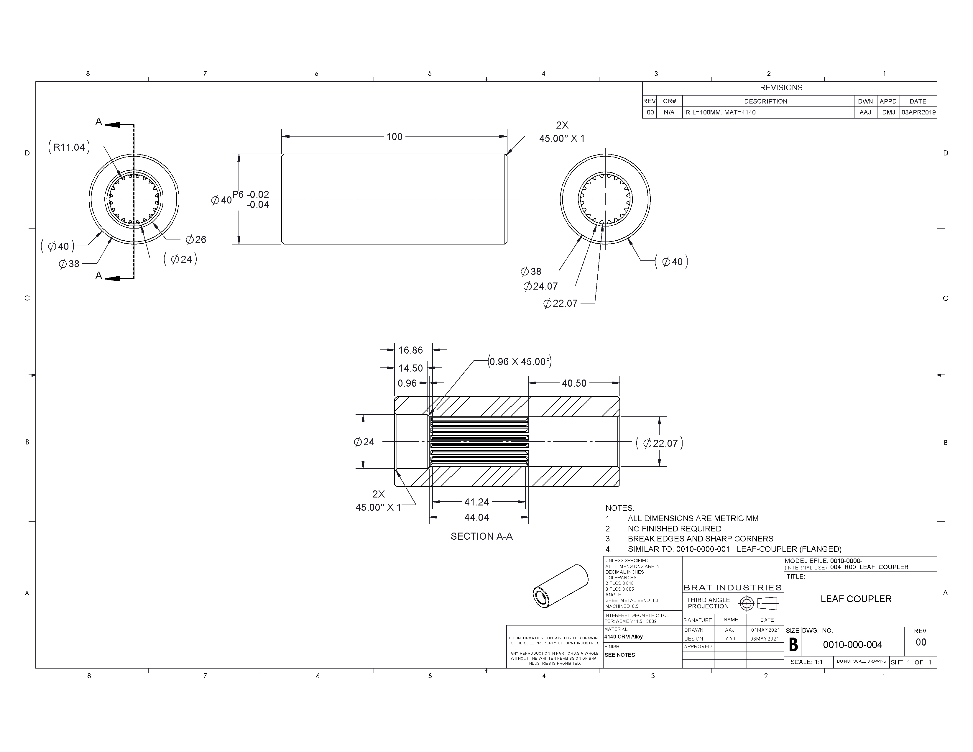

what does the other side look like?

vwbrady wrote: Sat Jun 26, 2021 5:09 pm what does the other side look like?
I’ll post drawings and better photos once I’m back at the shop. About a week from now

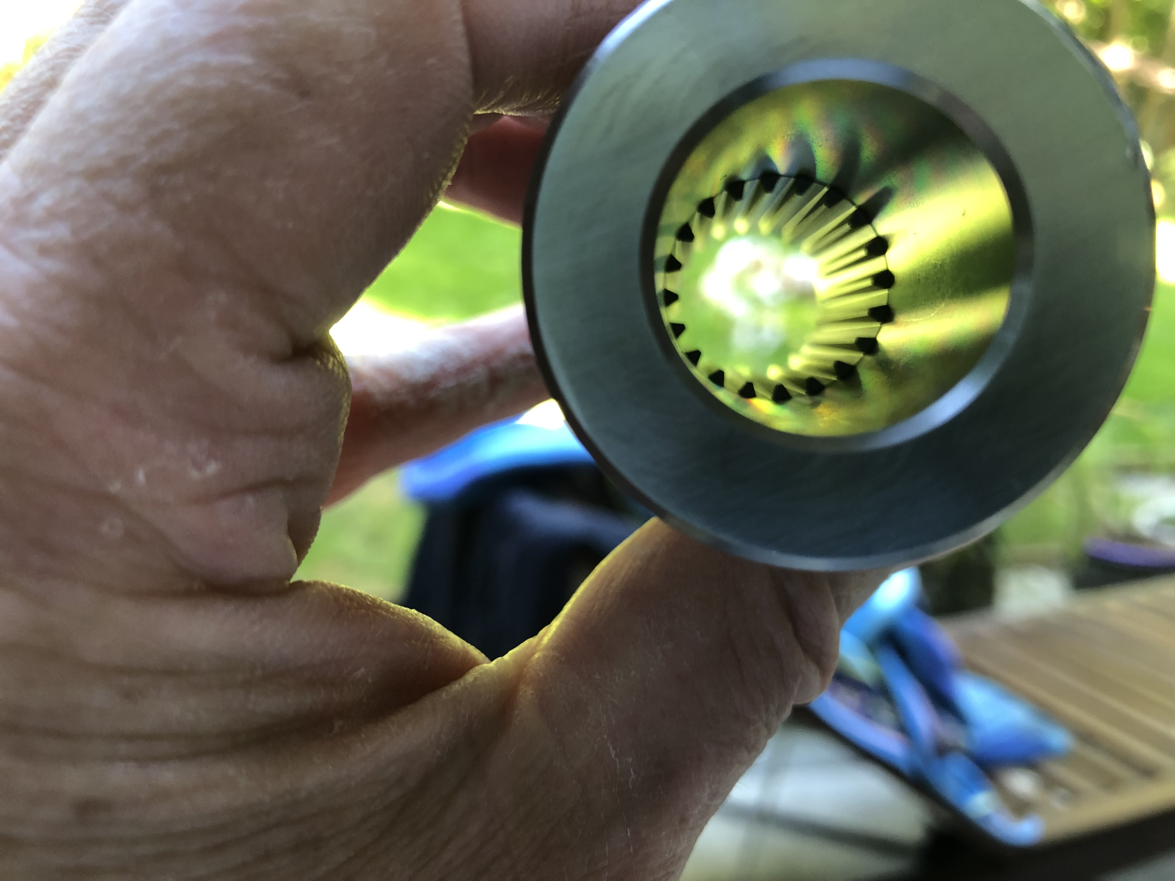

looks like you simplified it the same way i did. though i didn't see any need for a bearing. just a universal opposite side to add a clutch spline piece to.

vwbrady wrote: Mon Jun 28, 2021 4:27 pm looks like you simplified it the same way i did. though i didn't see any need for a bearing. just a universal opposite side to add a clutch spline piece to.
viewtopic.php?p=23018#p23018
still compatible with the bearing, now just some additional machining if some one wants a flywheel or Drive shaft interfaced compared to gearbox direct drive
