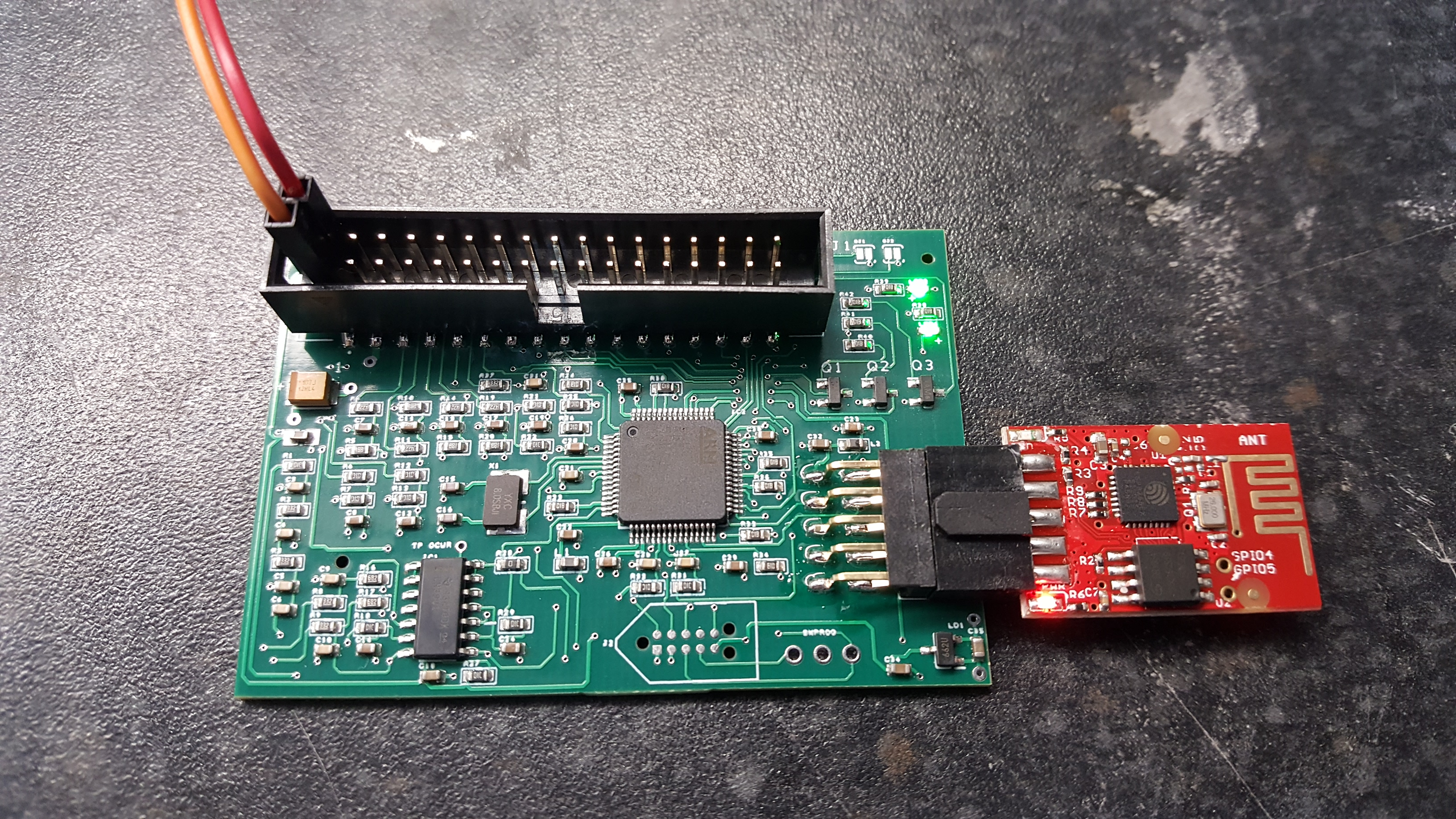

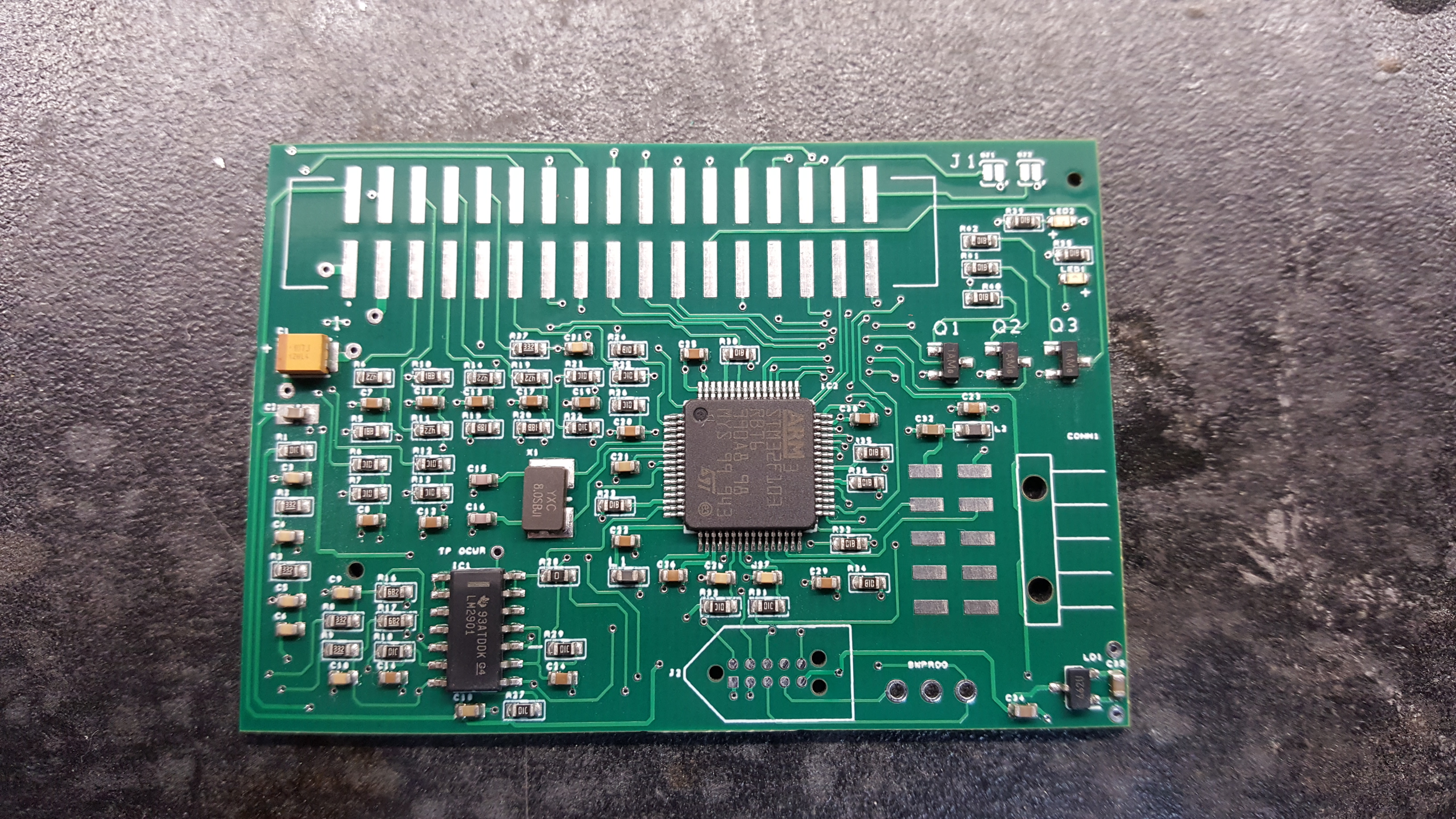

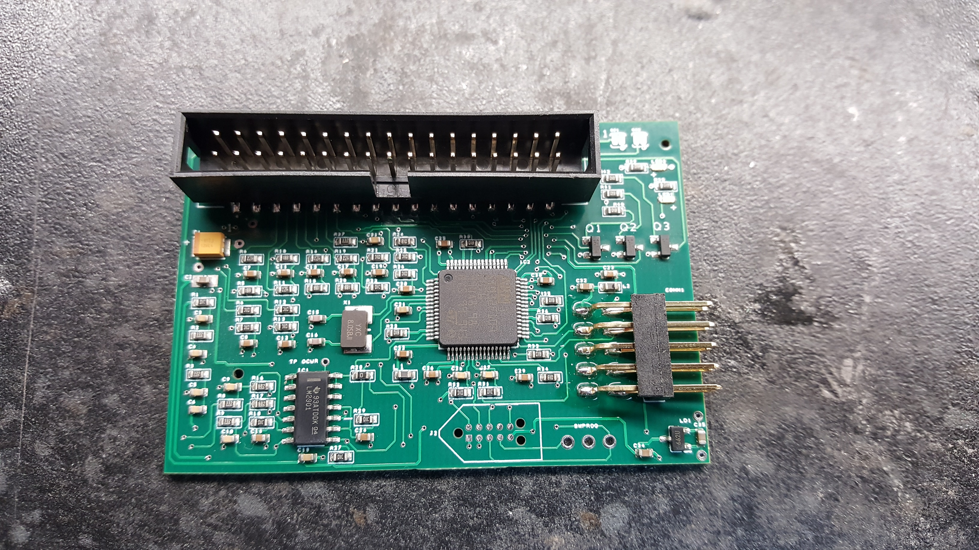

Boards have arrived from JLC. First powerup test on the bench is a success:) Next up fitting one to the inverter and hopefully spin the motor. Lots to do.

It is a cute little board :)
JLC delivers quite fast? Do they come to you without the connectors?

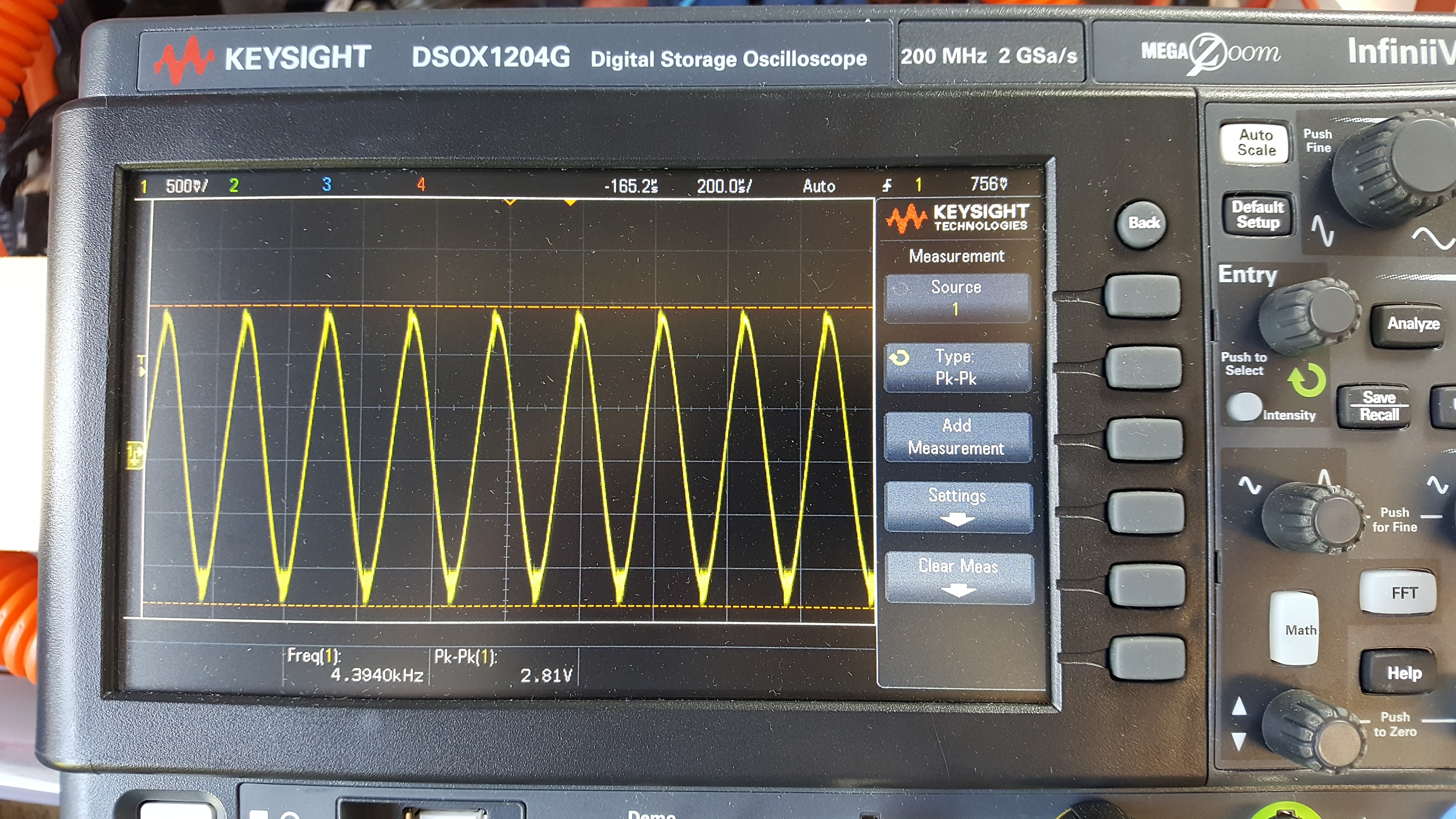

Some info on the M3 rear du temp sensor and resolver wiring.

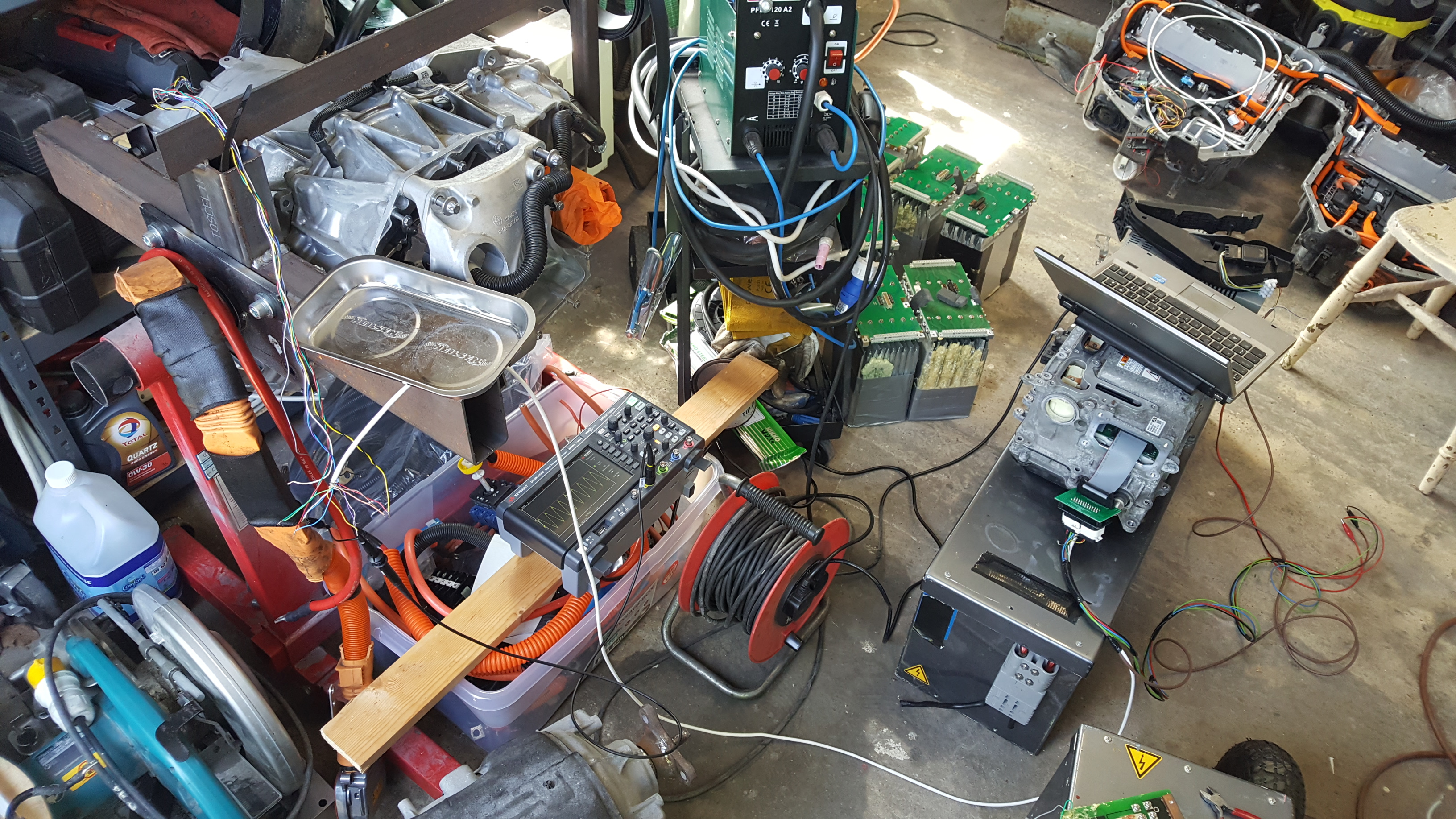

First attempt running the drive unit using FOC firmware in the prius inverter today. No luck as I think I have my current sensors mixed up. Going to do some investigation on this over in the Gen 3 prius thread then back here to see what happens:)

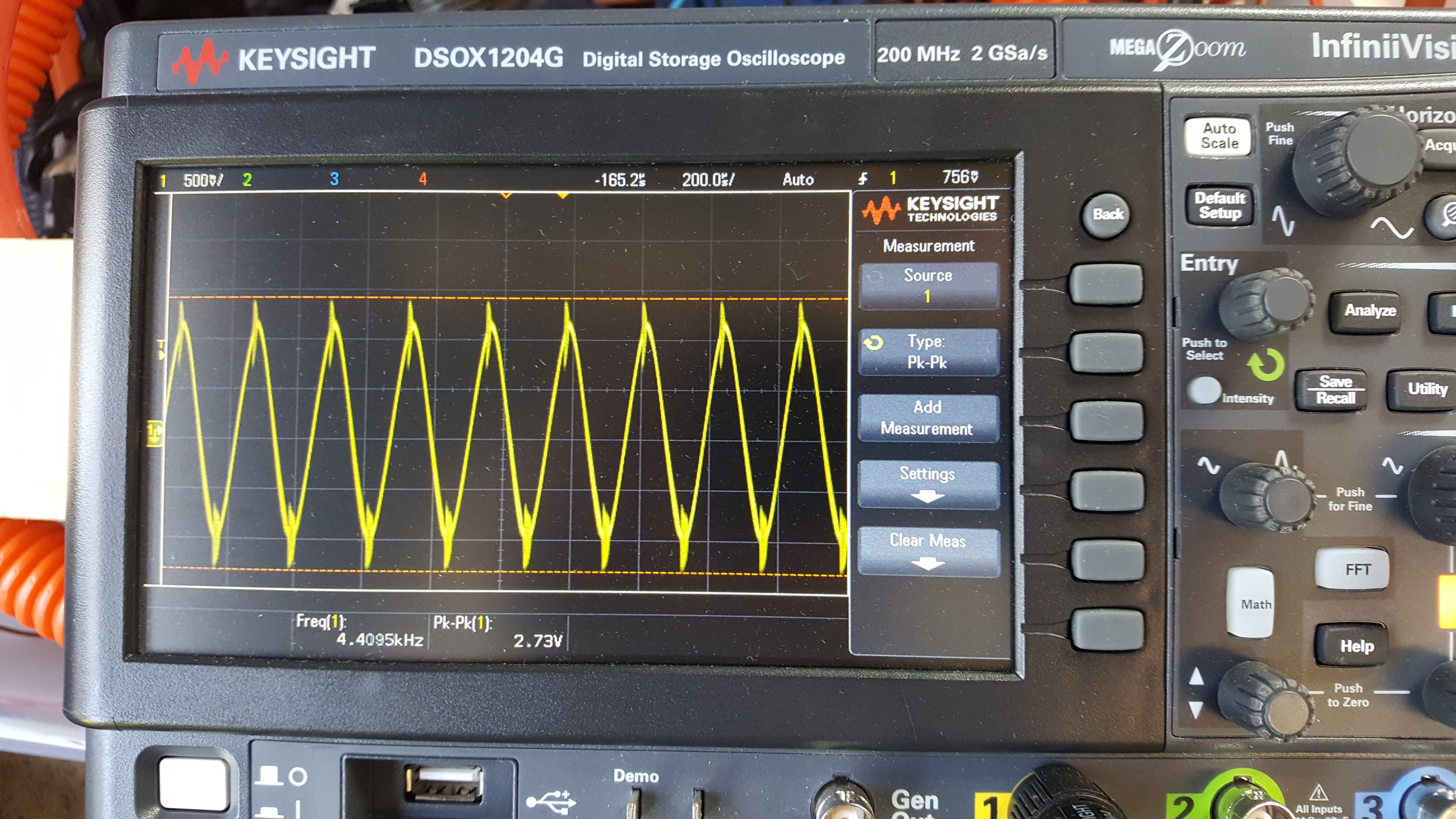

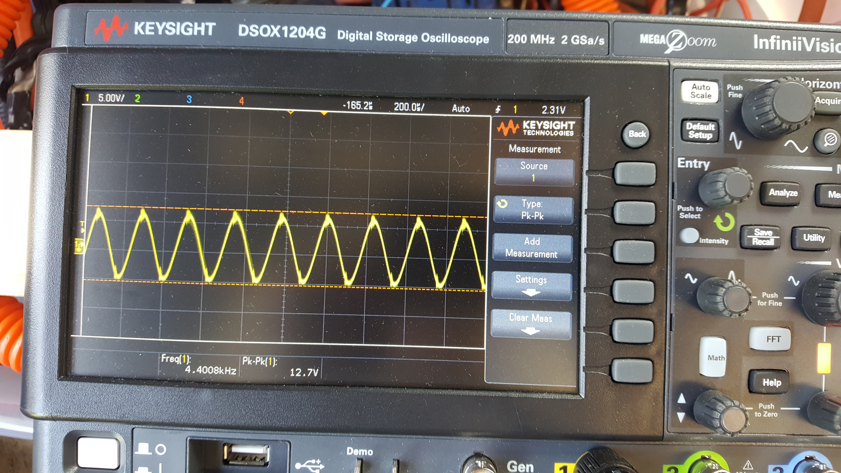

Damien just try giving it 10 poles and the same resolver. I suspect 10 poles should be much for such a small motor. It gives higher torque at lower rpm and good max RPM count regarding 360Vdc bus.
If it still doesnt work then try 8pole. I am sure they wont use odd pole numbers :). I will look for some dissassembly videos.
Kevin Sharpe
Posts: 1339
Location: Ireland and US
Been thanked: 10 times
Post by Kevin Sharpe »
arber333 wrote: Sat May 23, 2020 9:25 pm Damien just try giving it 10 poles and the same resolver. I suspect 10 poles should be much for such a small motor. It gives higher torque at lower rpm and good max RPM count regarding 360Vdc bus.
Two comments on the YouTube video;
"The prius gen2 motor is a 4 pole pair motor. It would pay to check the resolver too, pretty sure it is 4 pole pairs also. The inverter will not run properly if these parameters are wrong since FOC depends on correct rotor angle information to function correctly."
"Actual resolver may only have 2 pole pairs. In any case if you plot rotor angle you should get 4 0-360 degree transitions for every 1 turn of the rotor. Adjust resolver pole pairs until that occurs."
Posts: 4007
Been thanked: 1137 times

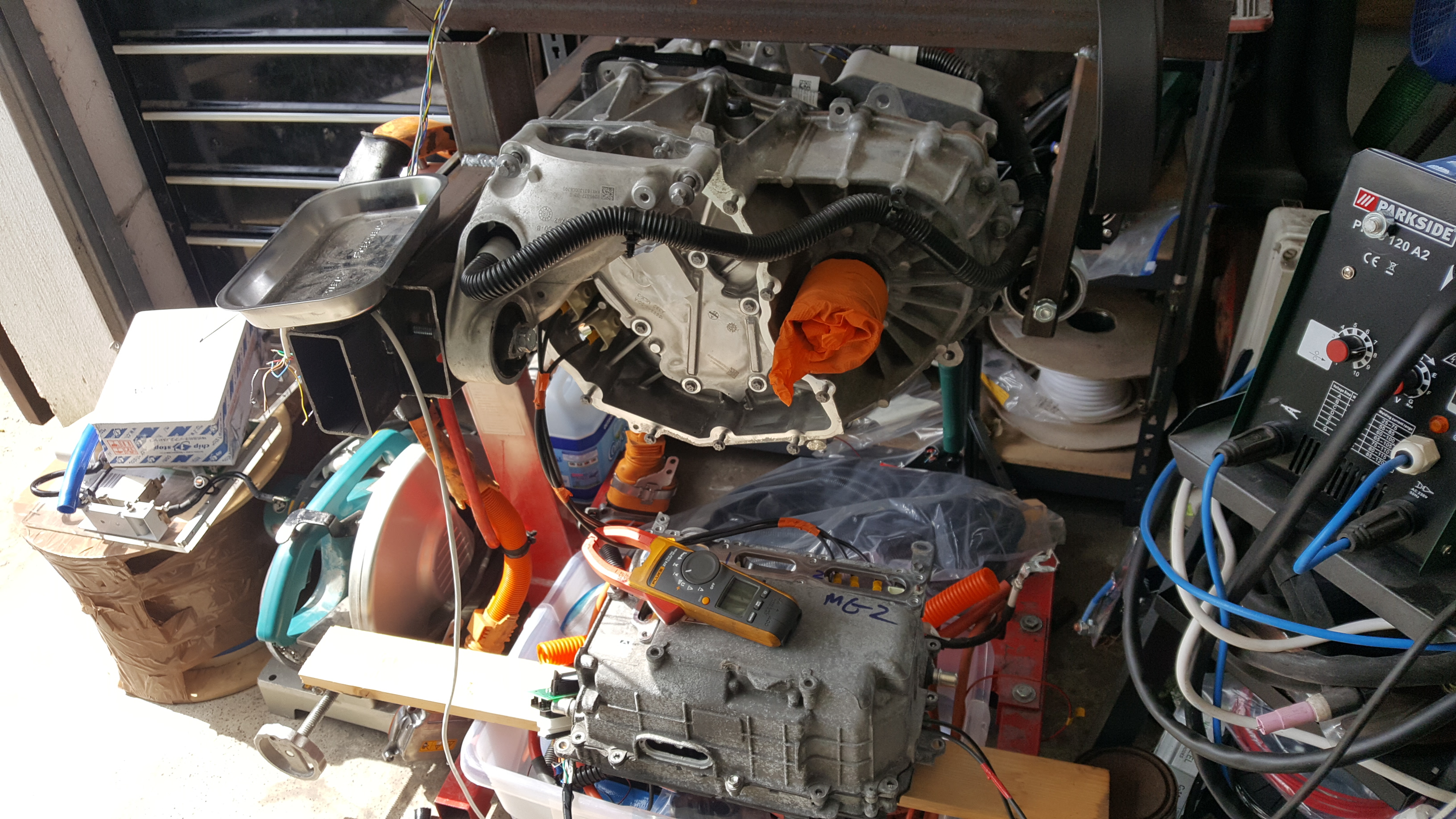

Thanks to everyones help I have now got the prius gen 2 mg2 spinning beautifully with foc using the V1c board in a gen3 inverter.
Some things I learned :
1)I wasnt pumping in enough manual Id to find the right syncofs value. ie i put in a syncofs, tried 5a then if the motor didnt spin I figured this was the point of no spin. I just needed to man up and pump in some real Id:)
2)Once I had found the point of no spin I tried run mode but got runaway condition. A brain cell fired up and I added 32768 to the no spin syncofs value. Result perfect throttle control but running in the opposite direction.
Hope that helps someone.
In regards the M3 motor I have trawled some of the "Masked Maraduers" videos and think what we have is a 3 pole pair motor and a 3 pole resolver.
