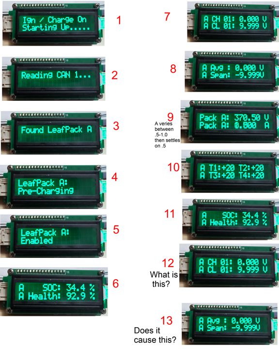

I have hit a snag using the pack sniffer 2 from Woftronix.
The new 24 pack I built was put on a purchased 24 pack buss bar.
I used the existing 12 pack wiring to figure out how to rewire the new 24 pack to match the sense wiring of the two 12 packs.
However, When I do the initial power on of the PS2 it gives the following sequence.
As you can see in step 7 and 8. those readings indicate something is amiss.
Jerry Kauffman
jerryk48 at gmail dot com
jerrykco
Posts: 156
Has thanked: 119 times
Been thanked: 28 times
Re: '70 MGB Roadster - 2015 Leaf EM57 powered
Post by jerrykco »
I have awesome news! My battery pack is working and WolfTronix PS2 is working also. I was at v1.0. Wolf made a change at v1.2 that fixed a timing glitch. I upgraded to v1.2 and everything is now working. So, my rewire job for the 24 pack sense wires in my rebuilt 2ed 24 pack to match the two 12 packs is 100% working. Whew! Really good news. I still want to also get the STM32F1 for Johannes' "car" code. I'll need a digital canbus speedometer!

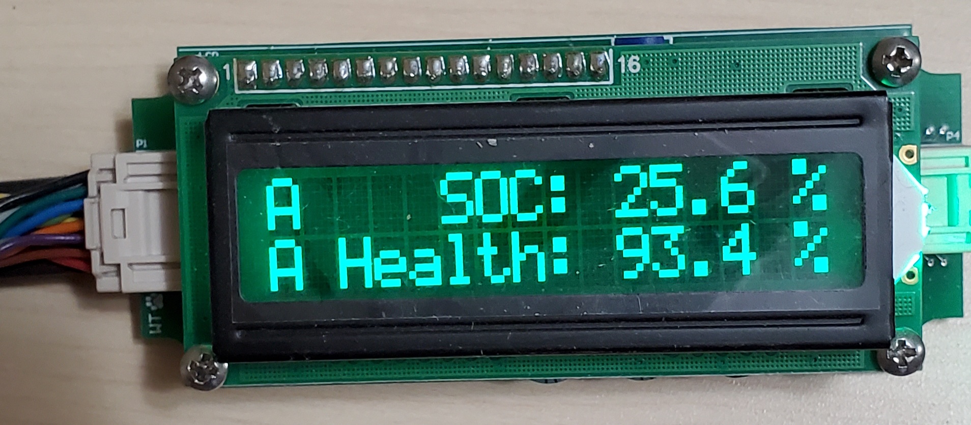

I'm really curious what capacity level is left in your pack from Battery Hookup? I've found it VERY hit or miss buying used cells from them, and I'd like to use them in the future IF I can feel like I'm not throwing my money away. A good deal is very tempting, until you feel like your money would be better put to use buying NEW cells.
Thanks!
jerrykco
Posts: 156
Post by jerrykco »
sigdigits wrote: Thu Mar 24, 2022 5:45 pm I'm really curious what capacity level is left in your pack from Battery Hookup? I've found it VERY hit or miss buying used cells from them, and I'd like to use them in the future IF I can feel like I'm not throwing my money away. A good deal is very tempting, until you feel like your money would be better put to use buying NEW cells.
Thanks!
96%. The Leaf battery pack was a replacement pack (Ready to install in a Leaf) from the manufacturer and was in storage at the depot for the manufacturer here in the USA. It had never been in a car, never charged fully and stored at ~30% charge. I have charged it a couple times, first 35% and now 45%.

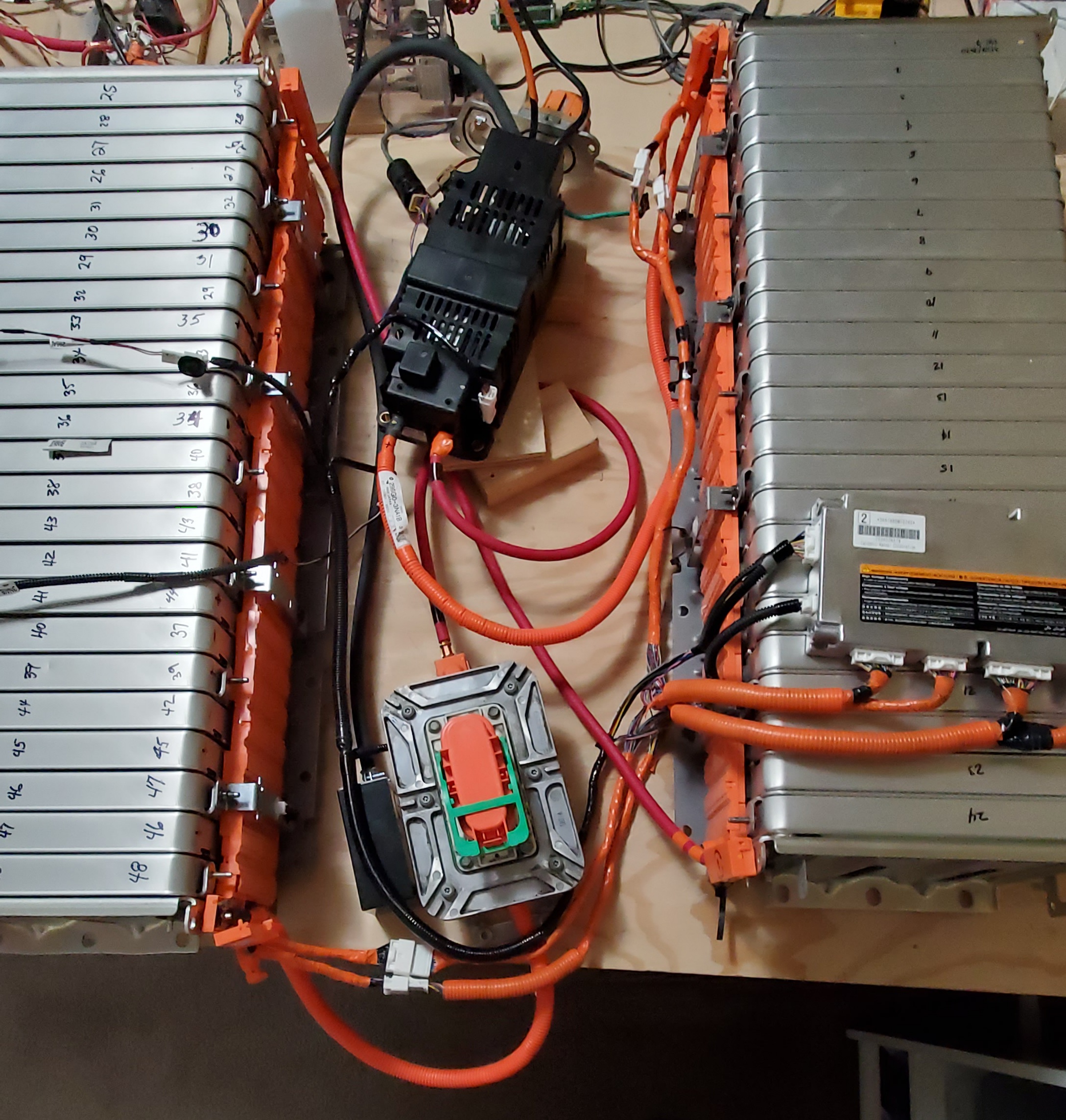

HI, (I'm back)
After two Spinal Fusion surgeries, followed by a serious back infection at the second surgery site and a third surgery to clean out the wound and now daily antibiotics to suppress reinfection, I am back working on the this MGB project.
Next step install these two 24 cell (2s2P) battery modules into the MGB. Conveniently they will fit cross ways one in the trunk and one behind the seats mounted to the MGB Tubular frame.
Leaf Batteries reconfigured into two sets of 24
I am working on the steel mounts. Pictures to follow of the mounts.

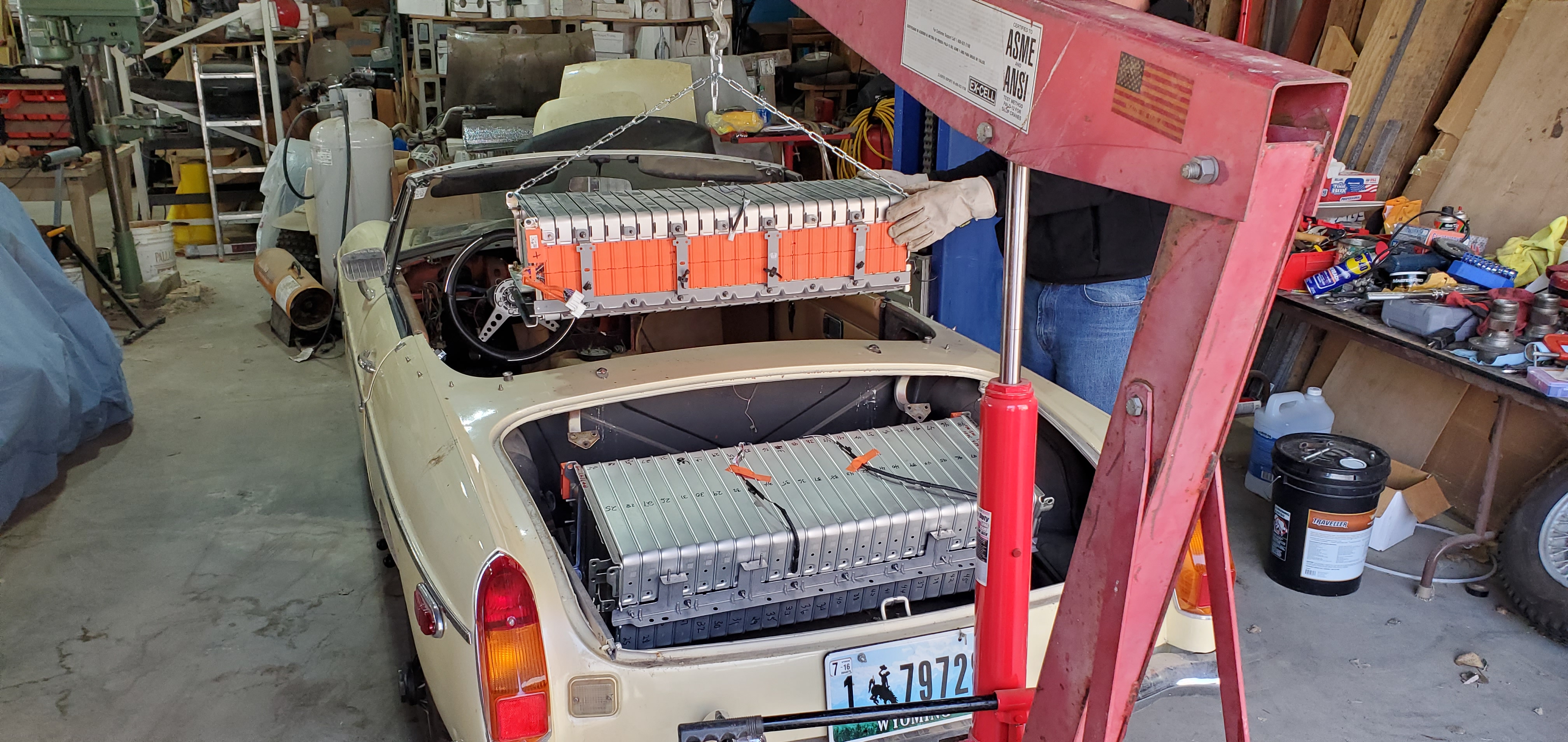

Started on the installing of the two 24 pack Leaf batteries in the MGB.
The tubular frame was reinforced to mount the battery packs and now we will check fit and decide on the mounting.
One 24 pack will go behind the seats and one in the trunk.

No batteries under the hood? I wonder what the corner weights are...
This will be a fun car.
