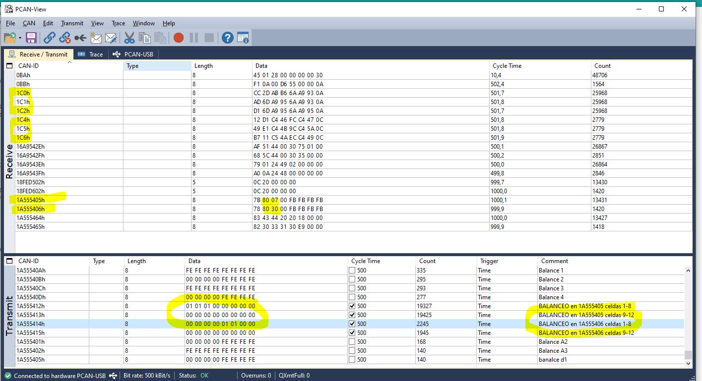

Hello.
I introduce myself with the first message, I'm Alfonso from Spain.

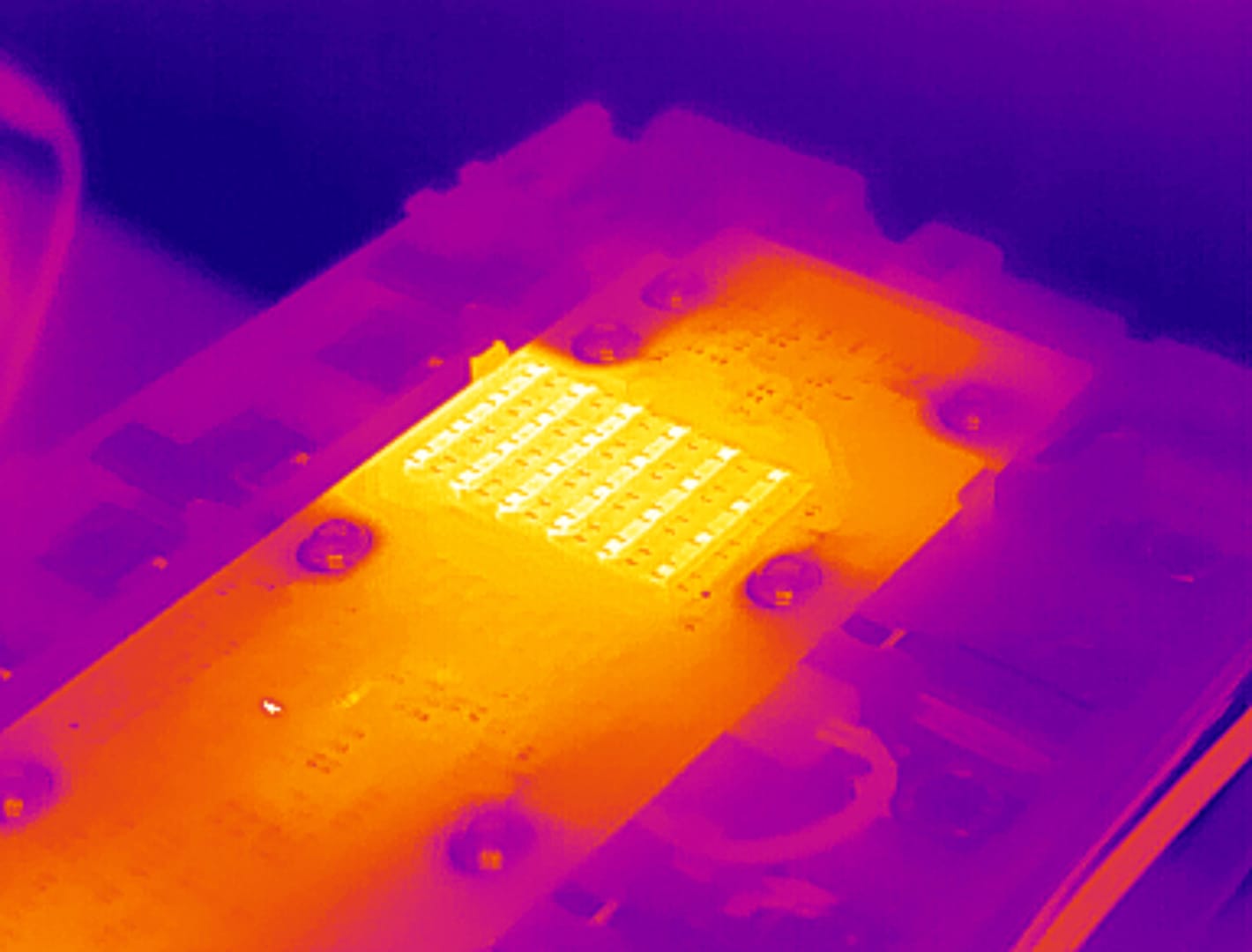

I have bought 16 modules from VW (1.64kWh), and seeing that the Teensy 3.6 cannot be obtained right now, I am trying to communicate with a simple Arduino.
I am looking for the plot to activate cell balancing, but I see that it is not working.
I have a thermal camera, but I see that the resistances are not activated, sending in all possible directions.
I have unbalanced on purpose, but there is no cell balancing.
I have looked at the balancing datasheet, and it can dissipate a maximum of 150mA, so it will be there for a while.
I'll wait until tomorrow to see if anything works, or if the cell voltage changes.
Best regards

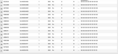

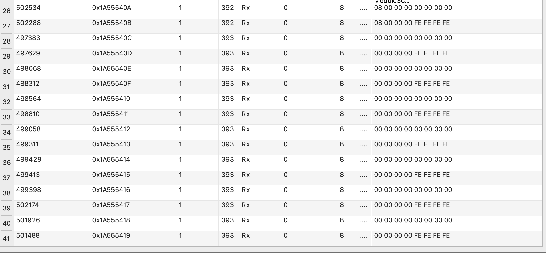

Re: VW eGolf hardware
Hello.

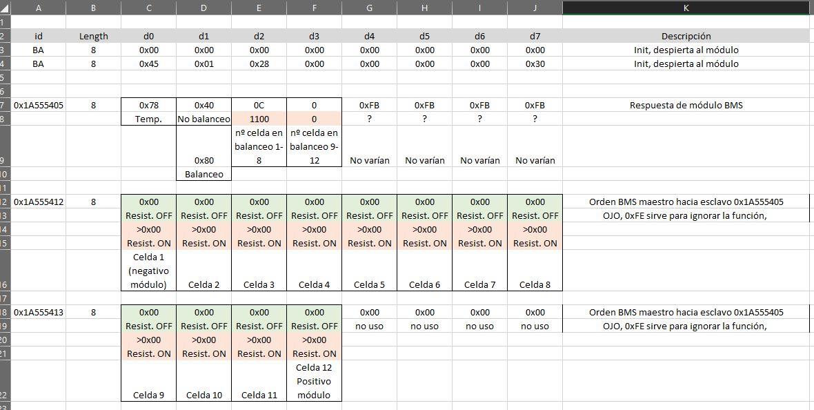

I have confirmed that the commands for balancing work fine. I attach two images, thermal, and photo of 2 battery versions. This is a video with work balance https://youtu.be/fDm4_A2jWdU
To activate balancing, any value greater than 0x00 , except 0xFE (the latter ignores the function, neither activates nor deactivates balancing).
To disable balancing, 0x00. Best regards

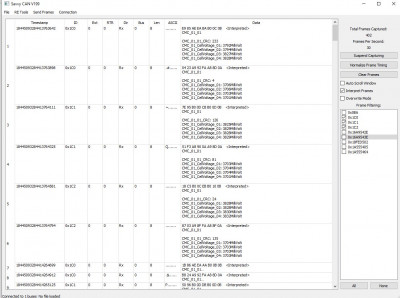

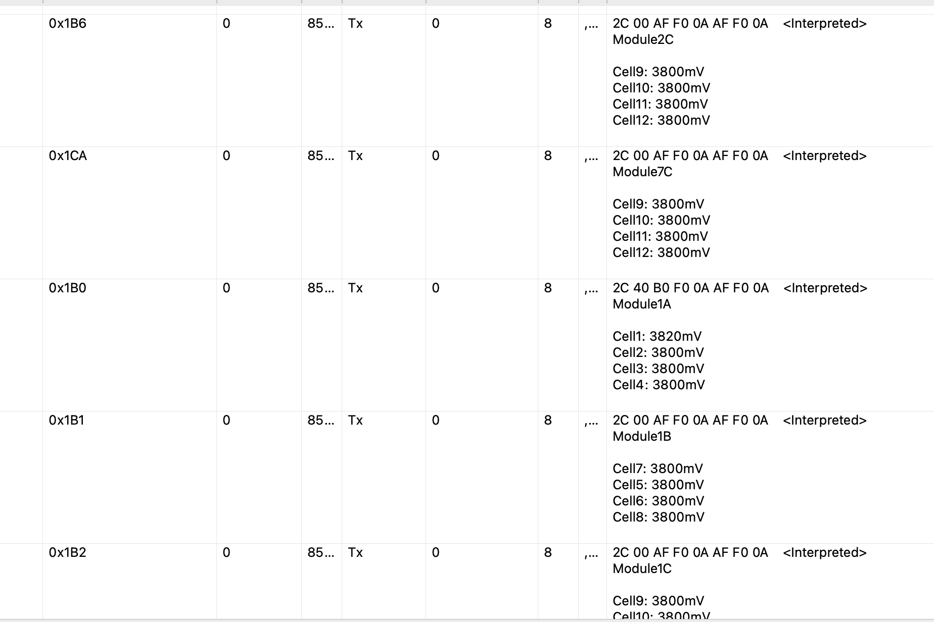

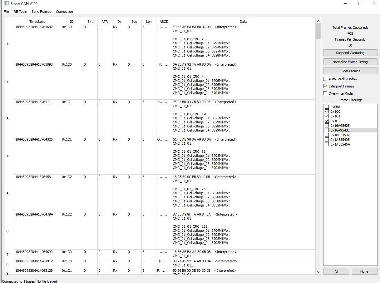

Sorry, I don't know the DBC format, or for what system is it needed? Batrium? SimpBMS ? or app?
I am attaching a modified Excel (VW GTE Canbus Ids) with the results that I have experienced. Best regards
- Posts: 2418
- Location: Bristol
- Has thanked: 209 times
- Been thanked: 576 times
thank you for confirming my finds are correct. Good to see others being able to replicate my findings/hunches
DBC is a file to describe the ID and bit mapping, using by SavvyCAN and others.

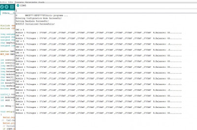

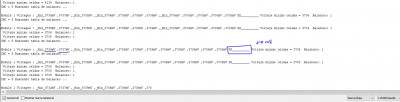

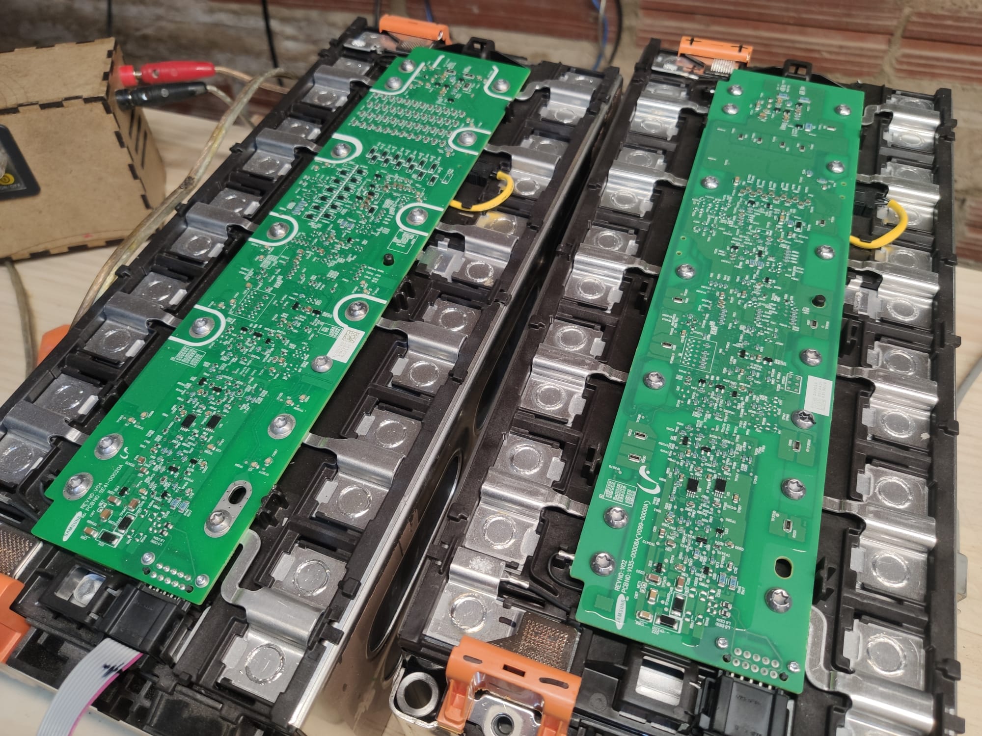

Hello.

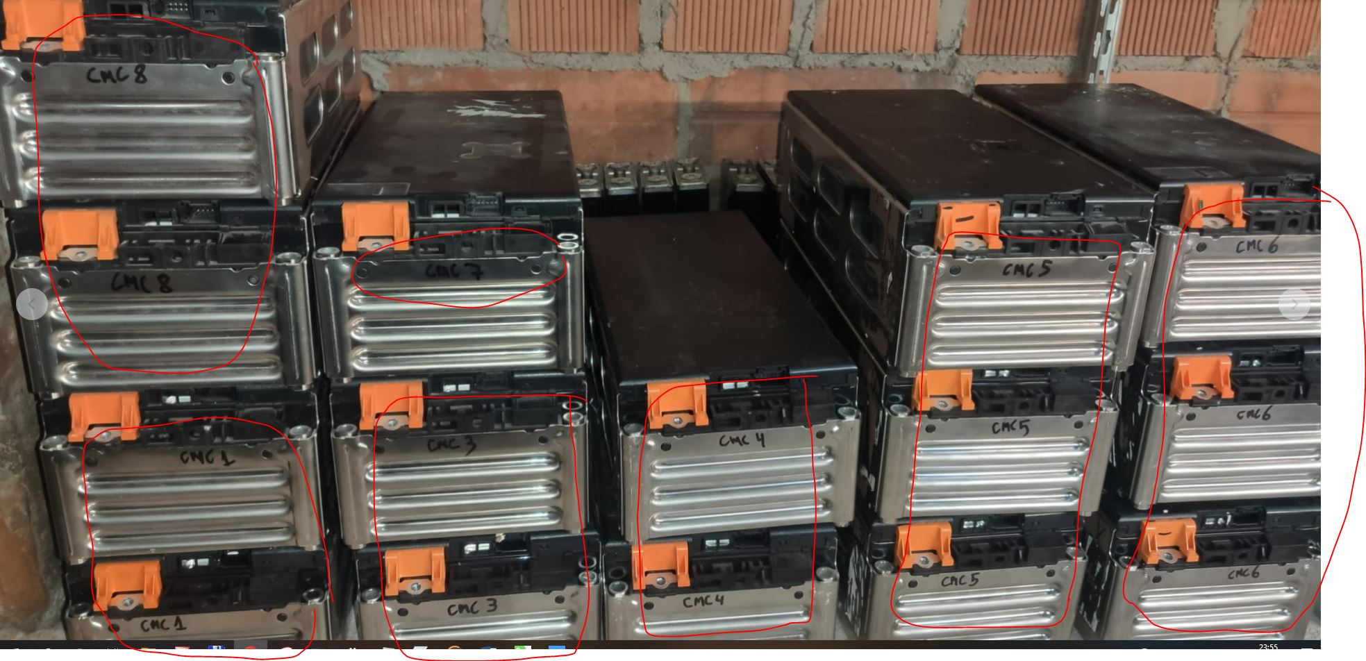

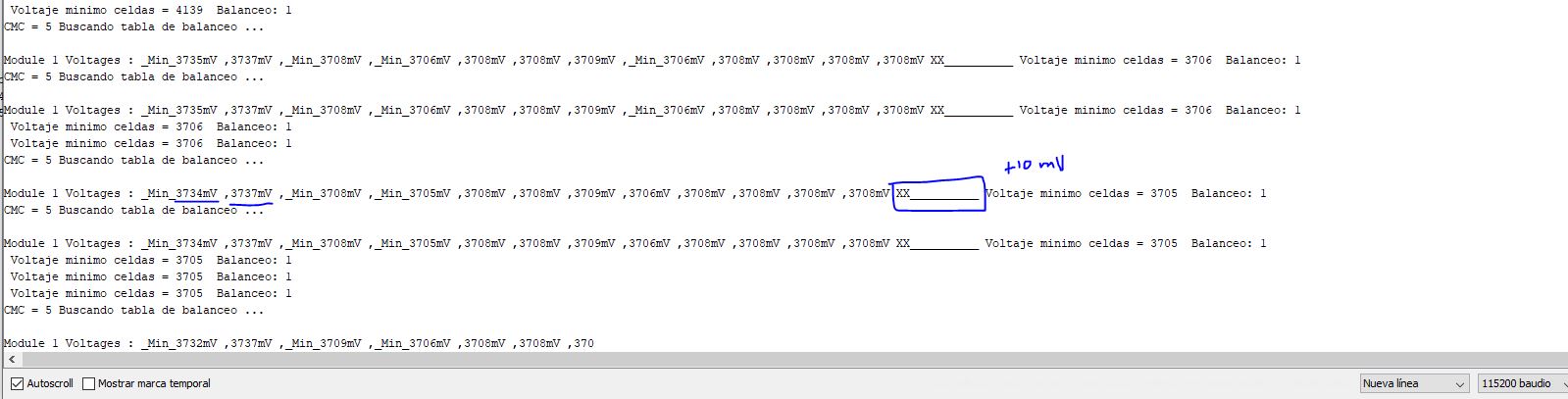

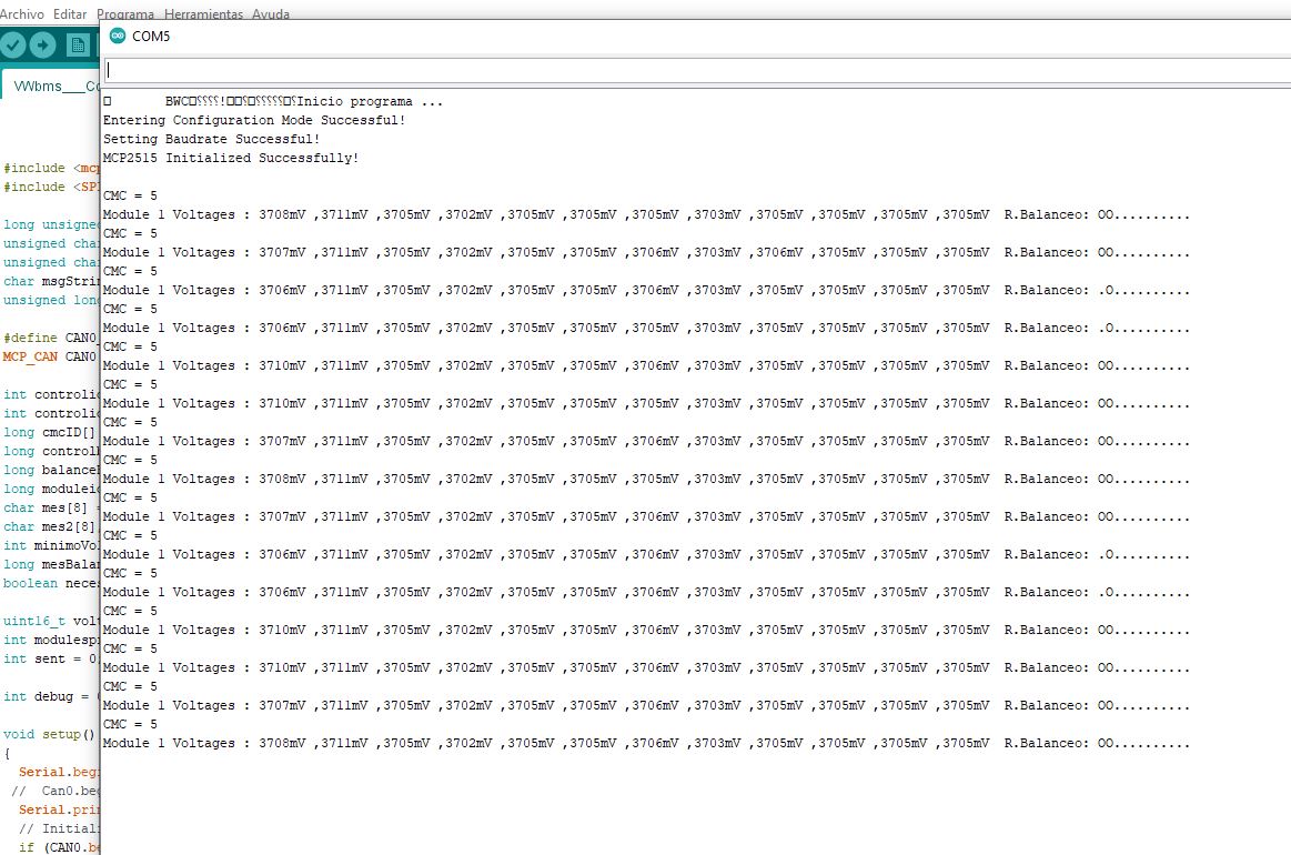

I still can't get teensy 3.6, so the Simpbms code doesn't work on teensy 4.0 or 4.1 that are available.
I am writing a little code in Arduino nano, to test the balance of each individual module.
Although the Arduino nano is very slow, it loses frames, but it works fine with a battery module.
I have found that I have 16 modules, and many have repeating CMC addresses.
With the SimpBMS can all the modules be connected even if they have repeated addresses?
Attached image when starting the balance After 10 hours the result was acceptable, I put a 4mV differential with respect to the minimum voltage.
It's true.rstevens81 wrote: ↑Thu May 05, 2022 2:06 pm Tom de Bree (tom91) is the author, but what I do know is that ...
You can't have repeated addresses, basically the BMS is receiving a shunt on the can saying I am module 1, my cells are ... If you have 2 modules called 1 things are going to go bad quickly.
As far as I know then can't be renumbered.
You'll going to need to work out what the IDs are for each of your modules and then create some sort of can in the middle device that will translate the ids's.
They cannot be connected with the same address, it's difficult to identify them.
In my case, by the voltage I know which module corresponds.
But in case of sending balanced, it's a problem. It's a shame, I was thinking of using 16 modules to install in a vehicle, a Think City, but I'll look for an alternative BMS.
Summarizing:
I understand that you cannot install modules with the same address if you want to enable balancing.
If you don't turn it on, no problem, it will read all the voltages but it won't be able to identify which module has the wrong voltage.
You are limited to 8 different CMC modules, so your final battery with slave BMS will be limited to 8x1.64kWh = 13kWh approx.
Summarizing:
If not a conversion device would do the trick, except you have 3 modules #6 that means you need 3 can ports in your translator. I might have a solution for you todo translations. I need to check how easy i can make it 3ports... (It has 2 natively). So for all others it's easy.
P.s. i do think we should be able to change ID's.

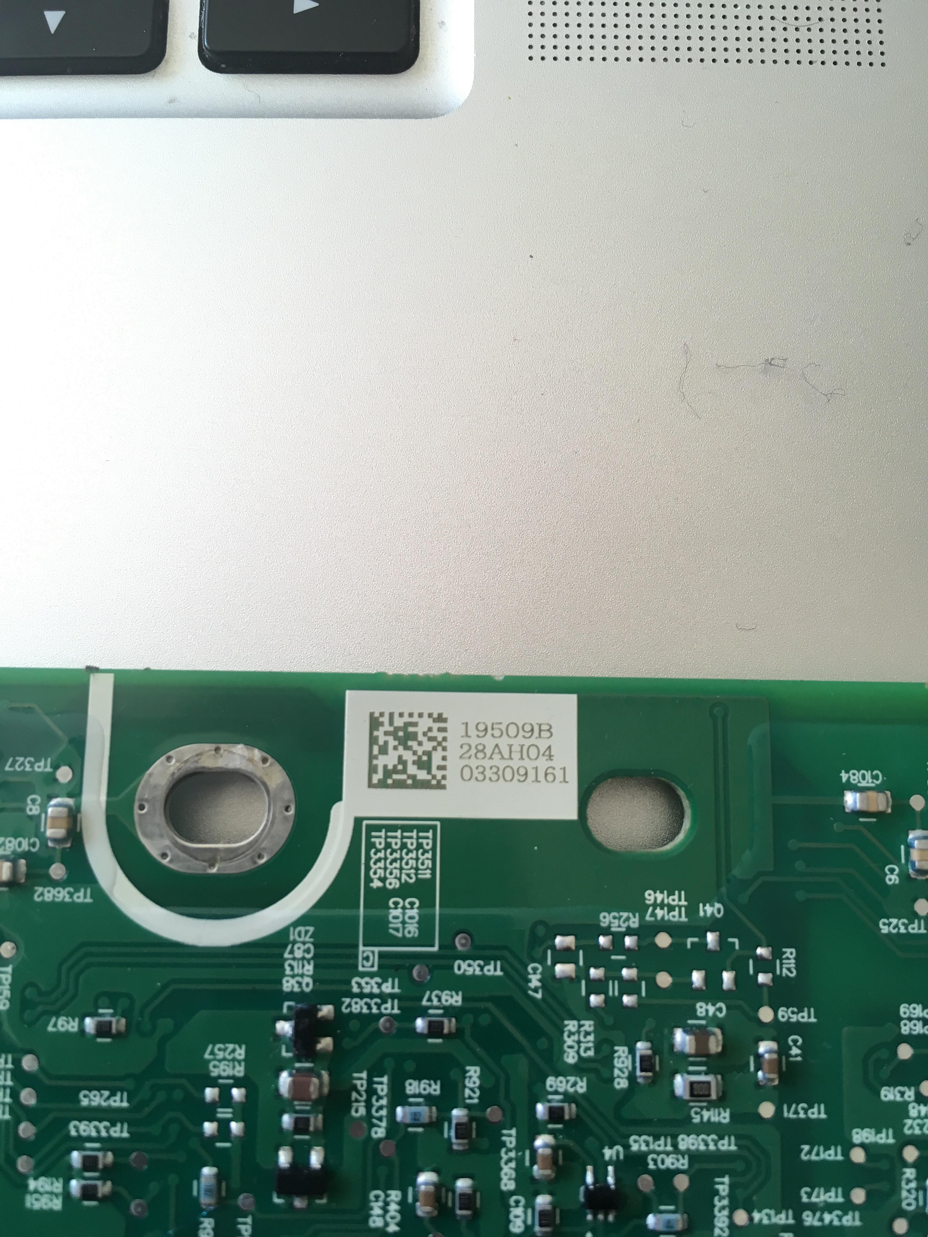

In the small square section looks like some configuration to me?
Do you have closeup? What's printed on the small table?

@ the third screw on both HW revs. you see like a config zone.
(Could be)
The table is on the left side third screw on the left board. The right board has the table at the second screw.
That table might be interesting...
It's speculation best thing would be compare two boards same HW rev. different ID's.

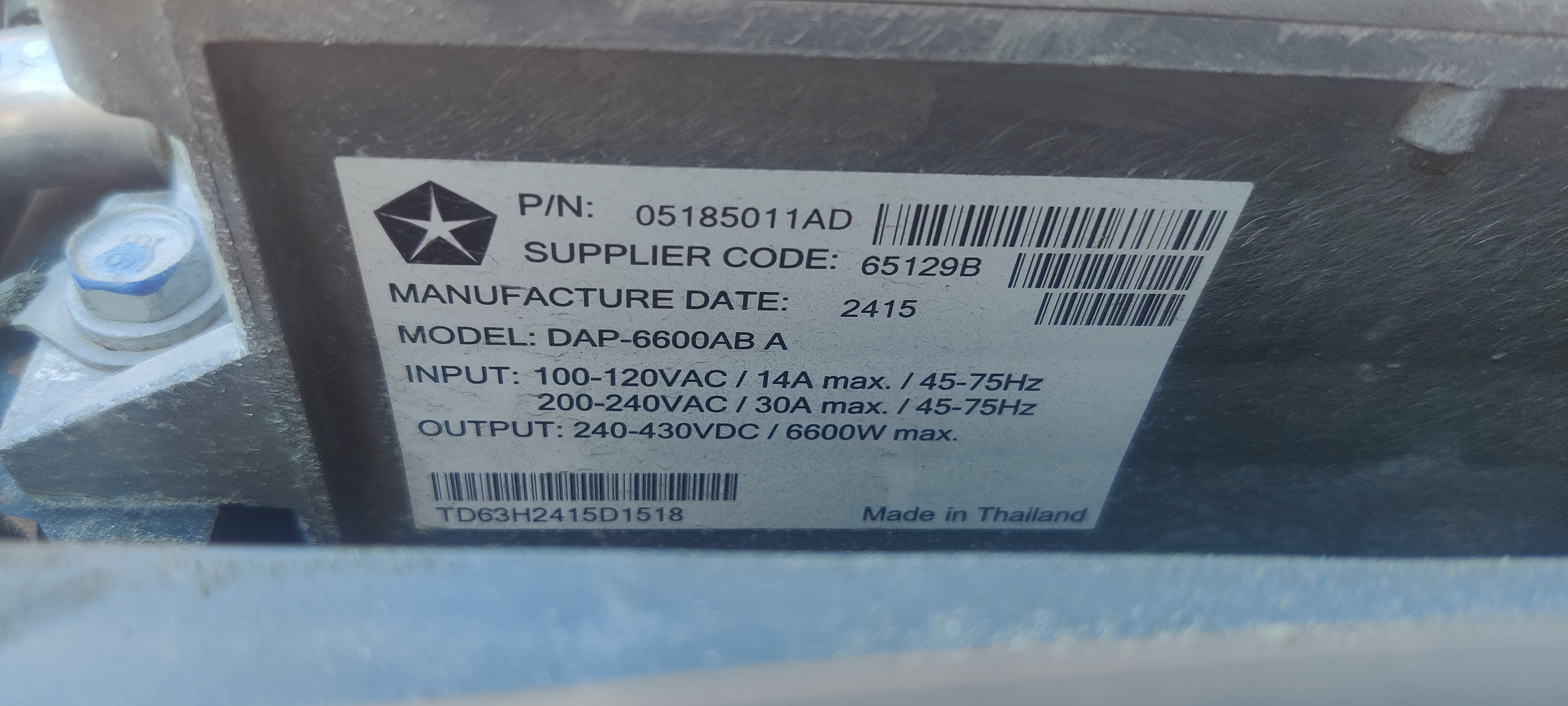

Old thread, but it's so har to find info on this inverter, no spec sheets anywhere to talk aboutarber333 wrote: ↑Mon Mar 16, 2020 8:56 pm .... It can produce 7.2kW, but it is not single phase. It actually uses 2 phase charging. I checked with my clamp meter... 14A per phase. This is very good for European housing where 3phase is common. This leaves a remaining phase for house consumption.
Do you happen to now if Bosch has made different versions for this inverter. Have a 500e with this inverter. It's rated at 240v 2 phase charging since it was only sold in the us. But can it maybe take 2 phase 400v without a problem? Would mean you can charge at home at full speed. Or might there be something there that goes boom with 400v
- EV_Builder
- Posts: 1205
- Location: The Netherlands
- Been thanked: 37 times
It all depends on charger input specs. What gives your phase to neutral? 240V 2 phase means here to that you connect neutral and 2 phases or the old 3 phase 240 network but that's very old...
EV_Builder wrote: ↑Tue Jul 05, 2022 4:42 pm It all depends on charger input specs. What gives your phase to neutral? 240V 2 phase means here to that you connect neutral and 2 phases or the old 3 phase 240 network but that's very old...
Well the inverter only has the Chrysler specs. But since it was a California only car it really doesn't say much if Bosch rely produced different versions. I mean it can take 2 phase 120v without neutral I would gladly open it up if I knew what i what components I was looking for to know if it can take 400v or to say it mor correctly 2 phase 230v.
Voltage to my basic knowledge voltage shouldn't impact but I'm not rely interested in a 6000€ + experiment if I'm wrong
