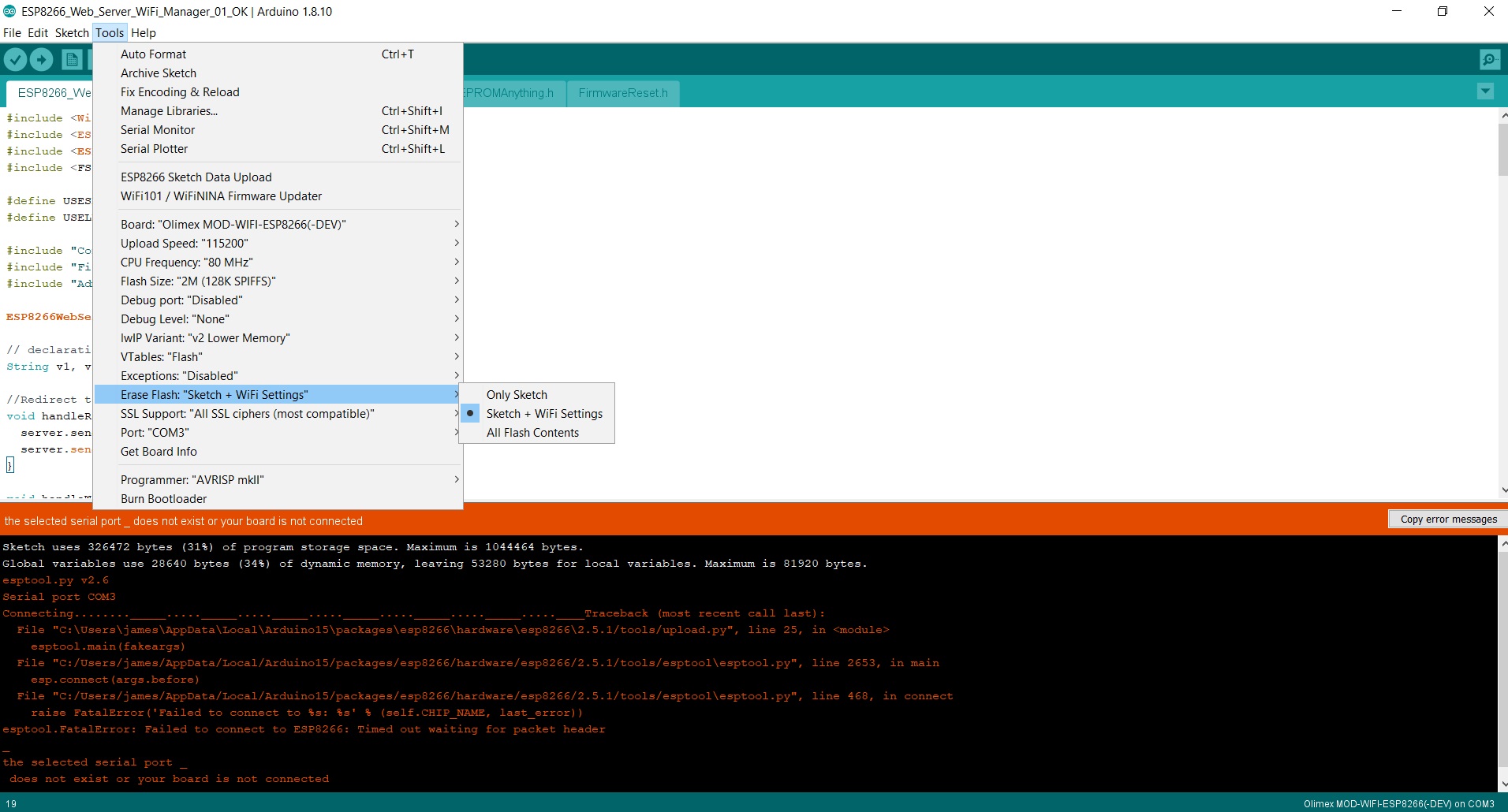

Hi, I’ll try to keep this specific. I’m trying to use an FTDI breakout board to flash an Olimex MOD-WIFI-ESP8266 Board with the WiFi Interface using Arduino IDE v1.8.10. When I try to upload the sketch I keep getting the error “the selected serial port _ does not exist or is not connected”. Seems like an obvious error on my part, here are the steps I have been through to check.
1. Followed Dima’s instructions for connecting FTDI to Olimex. Verified pin outs match for both boards. FTDI Voltage jumper set to 3.3v. Verified Olimex jumpers are soldered correctly for flash mode.
2. Downloaded web server sketch and added sub files to data folder (following arber333’s instructions).
3. Added ESP8266 to boards manager. Added esp8266 Filesystem Uploader to Arduino tools directory. Restarted Arduino IDE. Selected Olimex board. Tried to upload sketch, keep receiving the error messages attached (not sure of Olimex SPIFFS Flash Size so tried all of them, no luck).
I have tried a different USB ports, usb cables and verified the FTDI board works. When I try to upload the sketch file, the FTDI is clearly attempting to make a connection as the green data led’s are flashing on both boards simultaneously.

1. Can you see the FTDI inside your "device manager"? Which COM port it is assigned to it?
2. Did you verify you connected TX RX lines correctly? You only need to connect 4 lines. Vcc (3V3), Gnd, Tx and Rx. Maybe a redundant line is keeping ESP in reset? Try to connect only required lines.
Maybe you can also change to AVR ISP loader?

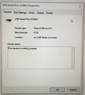

1. Yes. It appears in DM as USB Serial Port (COM3) see attachedarber333 wrote: ↑Sun Feb 16, 2020 11:35 am 1. Can you see the FTDI inside your "device manager"? Which COM port it is assigned to it?
2. Yes. The wiring appears to be correct according to the schematics and board labelling (Tx—>Rx and Rx—>Tx). This seems to be confirmed by the blinking LED’s when I go to upload. I tried reversing them and the Olimex Led does not blink. The same error occurs. There are only the 4 cables attached as you describe.
Thanks for looking into this btw.

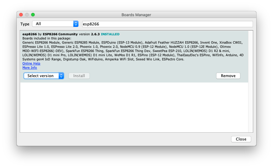

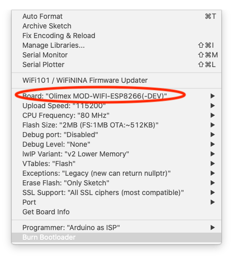

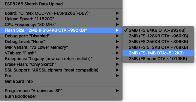

This has been repeated but for Olimex did you solder GPIO0 to 0 (zero) Not just left it open but actually made a solder bridge to 0?
Always select highest SPIFFS (1MB) and you can leave Erase Flash: Only Sketch
EDIT: Also I recommend updating "esp8266" boards library to version 2.6.3 (it has important fix for web update)

Hi Dima thanks for picking this up. Yes I did solder the jumpers exactly as you described (with none left open).
I will recheck when I get home tomorrow that SPIFFS are set to 1MB and change back to Erase Flash.
I will also switch back to V2.6.3. I have tried with all versions from 2.5.1 up as this fixed some issues i have seen for others.

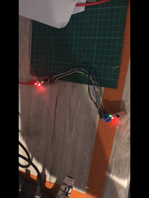

Dima and Arber I tried as you both suggested but still no luck unfortunately. Just to confirm, I am not using the -DEV board, it is the MOD-WIFI-ESP8266 with the UEXT header like your picture on the original post.
With these settings you posted above and an FTDI board connected as you originally posted, have you or Arber successfully managed to flash one of these boards with the latest Arduino IDE and esptool.py v2.6?
Re: HOWTO: Flashing ESP8266
Yes all the time. Only difference not using expensive FTDI (You will need USB to TTL not RS232 Serial) Prolific2303 or CH340 work. (-DEV) is in brackets IDE builds for both.james@N52E01 wrote: ↑Sat Mar 07, 2020 5:06 pm With these settings you posted above and an FTDI board connected as you originally posted, have you or Arber successfully managed to flash one of these boards with the latest Arduino IDE and esptool.py v2.6?
