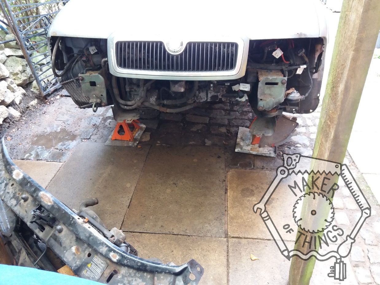

I have started to dismember the car, after work today!
So many rusted screws and bolts on the nearside. :roll: Offside was fine.
Bumper off, cross-member loosened, I just want to video the engine start up and running so I can show it is a good unit when I sell it. Then I can drain the fluids and remove the front end, lights and radiator as a unit. That will give easier access to the engine to save lifting it over the front of the car.

I started the disassembly today.
While draining the radiator I found out why the air con wasn't working.
That's quite a split in the hose crimp!
I disconnected the radiator hoses and, with much frustration, disconnected the electrical connectors.
Why do they fit them so the release clip is impossible to see?
It wouldn't have been possible to remove the radiator or fans in situ as the screw heads were so badly corroded.
It will all need cutting out I think.
I also disconnected as much as I could of the rest of the wiring loom, gear shift cables, and the clutch cylinder.
Then labelled as much of the loom as I could
There is more write up in my blog, including the fun removing the front wheels!
