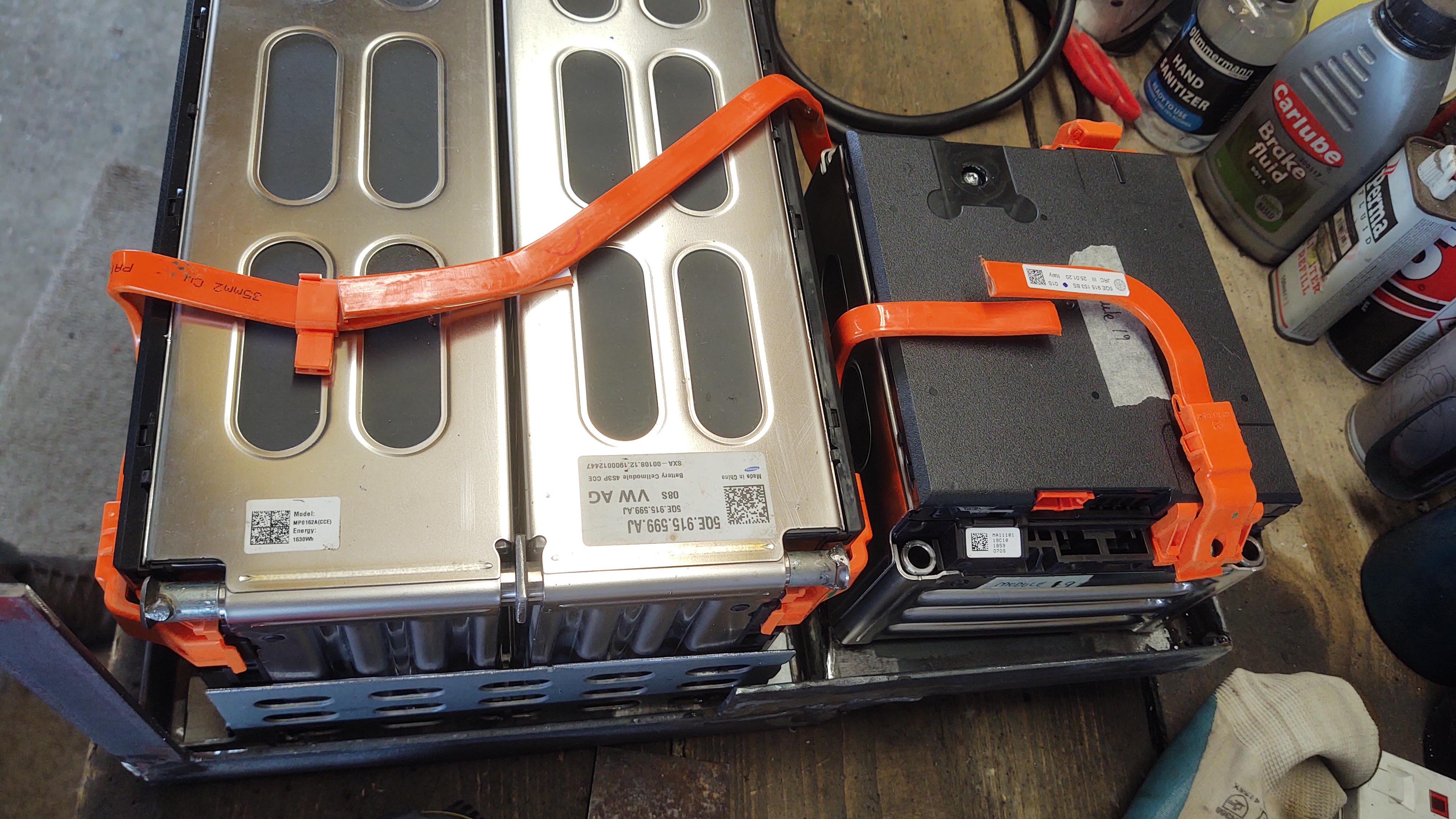

So after several goes at making the fuel tank box this seems to be the best option. It may not be perfect and maybe I could fit more in but I'm being cautious as this is my first attempt at this.
However until I figure out exactly how to bolt the modules together fit them in the box I can't be certain this will work.
So I've started making the brackets to hold the four large modules together.
The idea was to have the 4 large modules bolted together with threaded bar then bolted to the box. I plan to have studs on the floor of the box but as I haven't sorted that yet I haven't drilled the brackets.
To help with cooling I'm spacing the modules with 3mm washers and have made the middle part of the bracket from 3mm steel.
This is the four brackets made and they are a tight fit. I'm waiting for some threaded stud connectors to screw onto the ends of the threaded bar as I've no access to tighten nuts. Originally I planned to weld the inner brackets together but I think it will be easier to manage two modules at a time rather than 4.

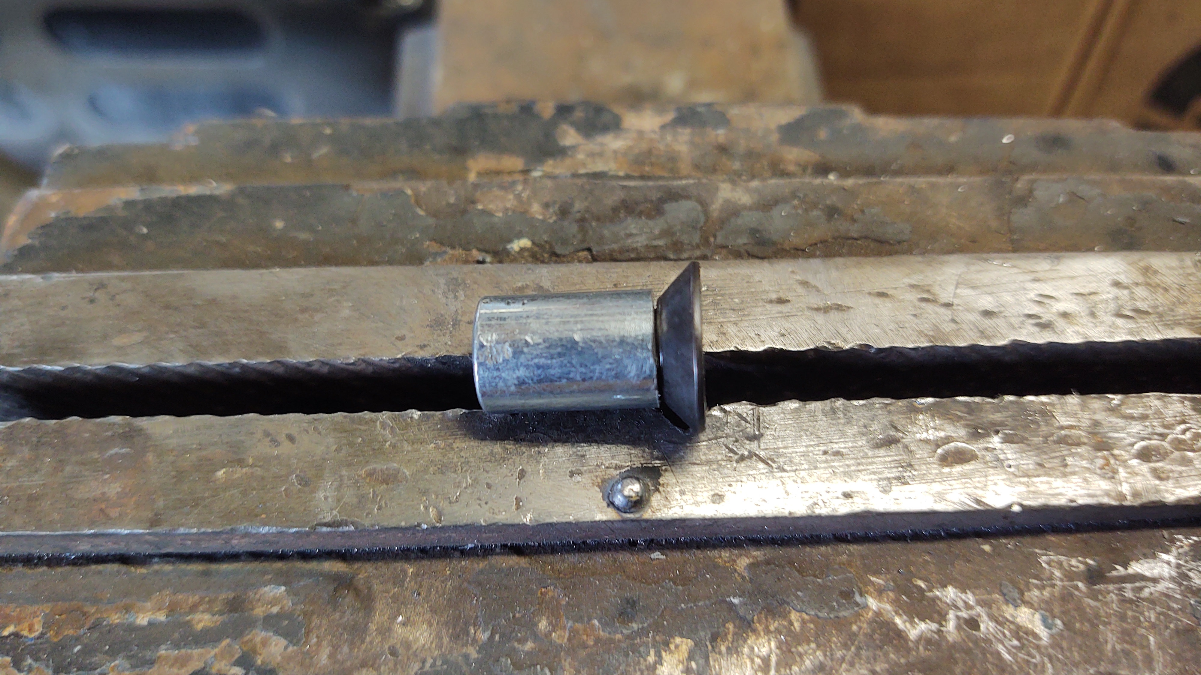

So I've finished making the brackets to hold two large modules. I might tweak them a bit but his is the general shape.
And this is how I made the securing screws
And how I plan to bolt them down. When I get the box built I'll drill the holes and weld in studs.

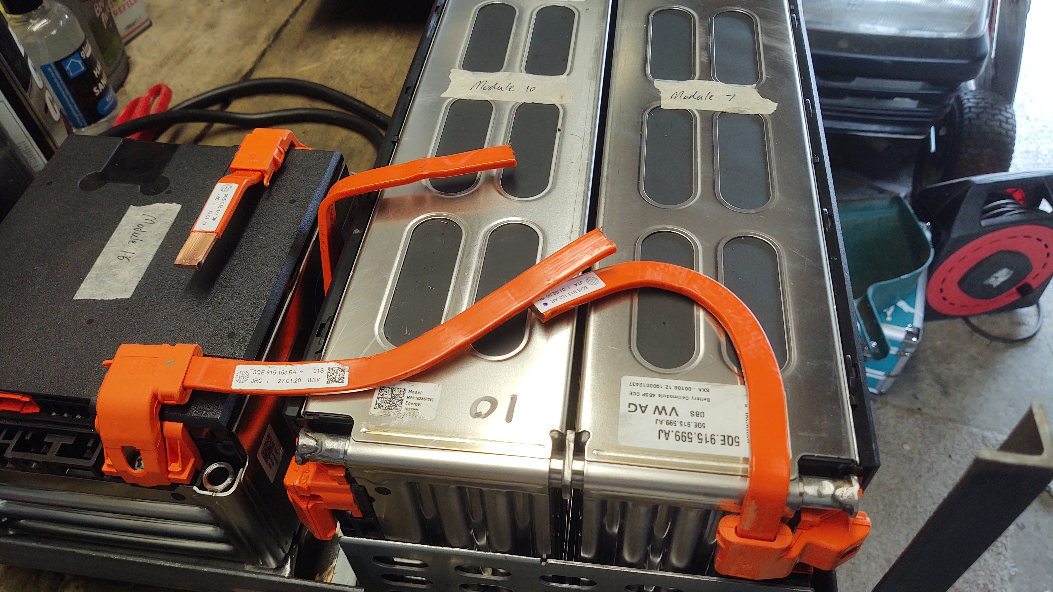

I've been struggling to decide the best way to link the battery modules inside the battery box and I figured it was important to sort this out before going any further with the box fab.
The screw terminals are close to the sides of the box and I wasn't completely happy bending ring terminals at 90 deg. The original solid copper cables are really hard to bend and many of them are not suitable for the position I have the modules now. At first I thought I wouldn't be able to reuse them but a mate suggested just cutting and joining them so after a bit of fettling this is the current idea.
I just need to trim back the insulation, drill holes in them and bolt them together. I might twist them 90 deg so it's easier to isolate the bolts from the battery case but I'll decide that when I have the case finished.
They are solid copper bars 35mm2 It looks like they're soldered to the connectors so at first I was thinking of soldering the bars together but there is one good reason why I can't do that nor weld them. I need to be able to screw the connections to the battery modules BEFORE I set them in the box. :eek:
If you look at the position of the terminals on the modules many of them will be impossible to access after they are set in the box. I only realised this when I went to tighten the connections nearest the two uprights. :confused:
I will probably have to change the center links for this reason too as I will not be able to set all four modules into the box bolted together.
Insulating them shouldn't be a major issue and is why I'm thinking of putting a twist in the bars so the bolts will be horizontal.
Any thoughts guys?
