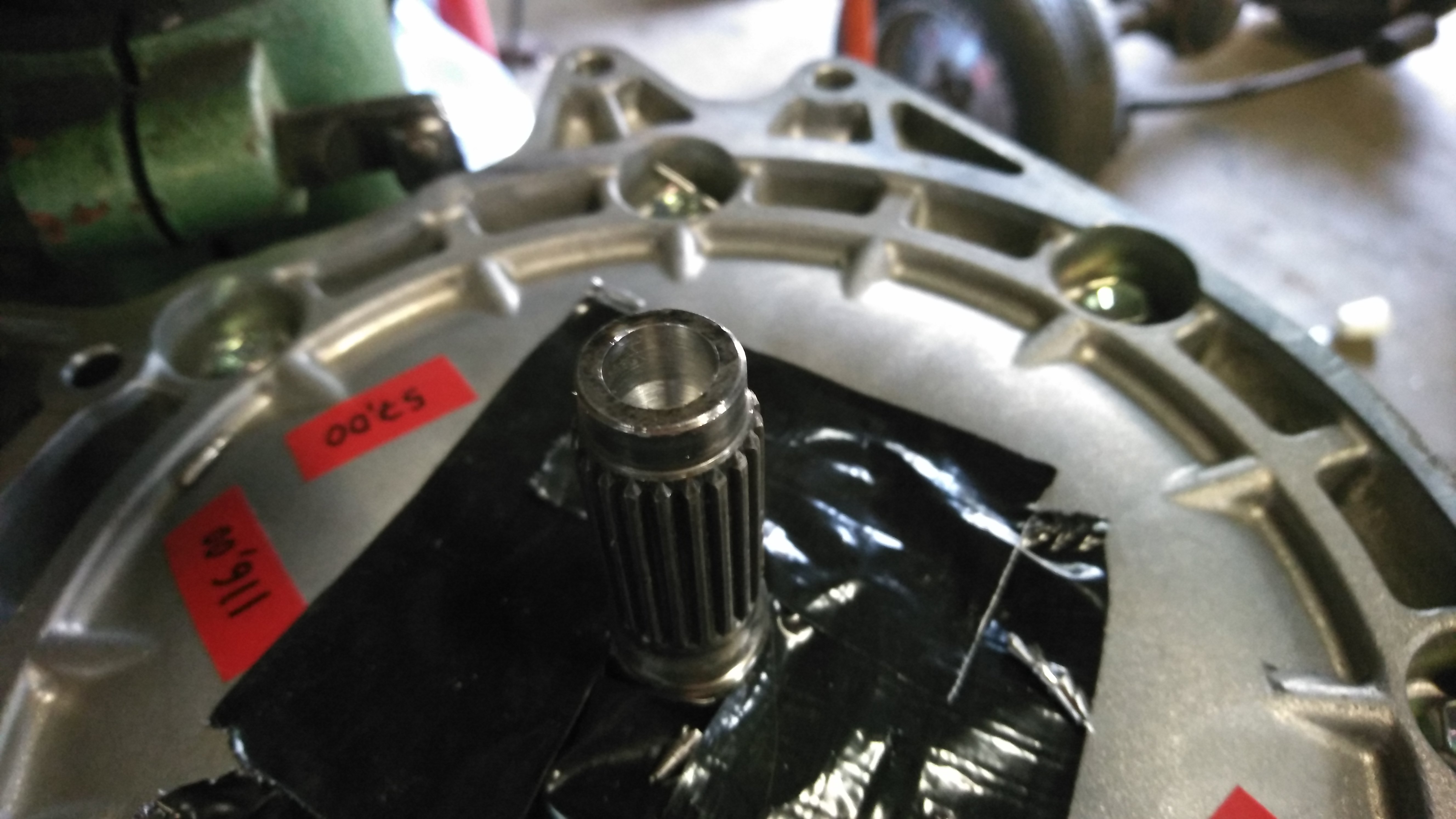

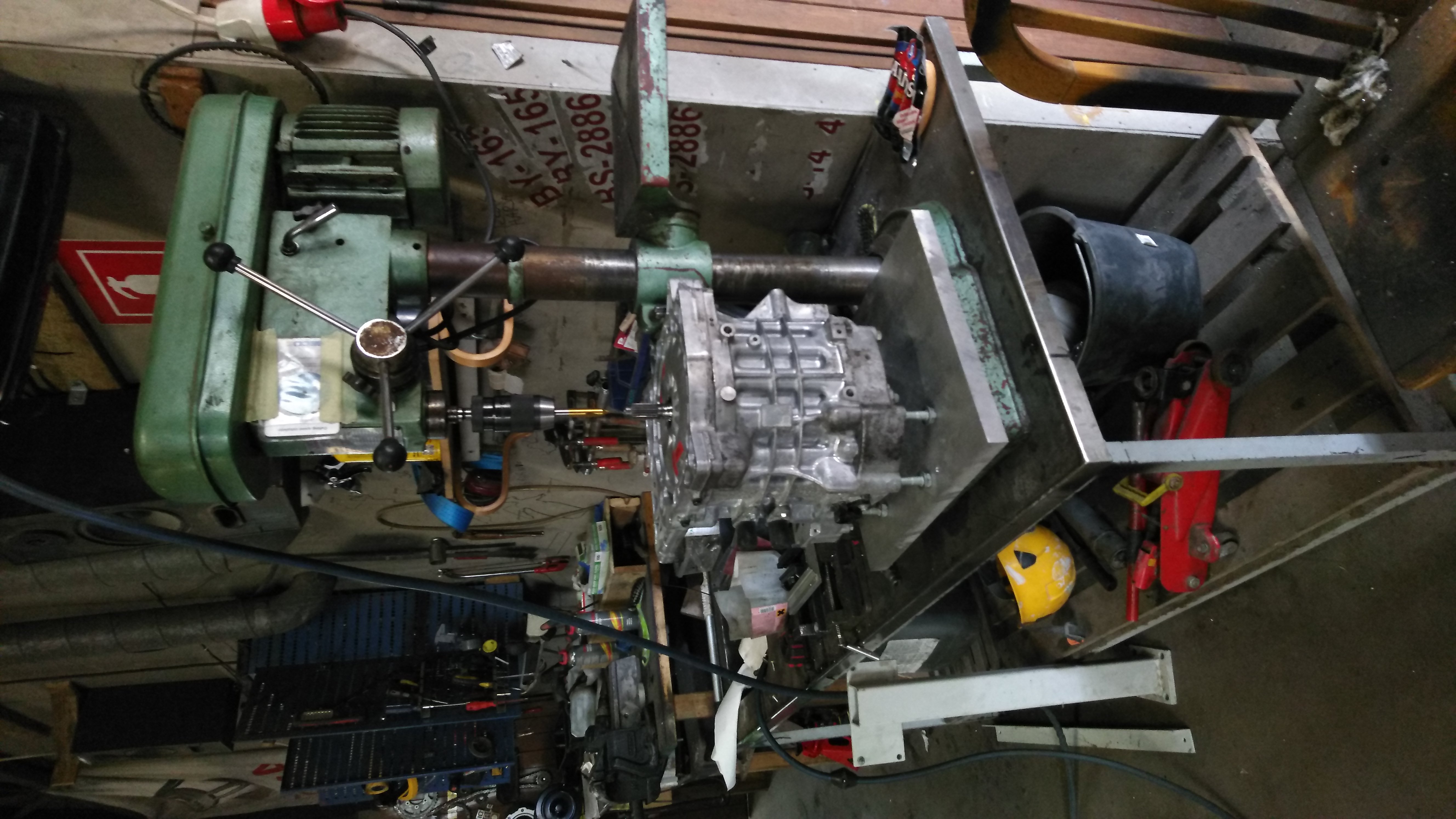

I maintained the pilot support in my coupler: I drilled a 12mm centered hole in the end of the Leaf motor shaft so that the transmission input shaft could center in that hole just like it originally did in the 12mm inner diameter pilot bearing.
Doing that wasn't too bad: I got a 60° 12mm drill bit (the Leaf motor shaft has a 60° hole at the end that was used to originally turn it in a lathe), attached the bit to a drill press, placed the motor below, made sure it was straight, used a temporary setup to run the motor and used the drill press to press the bit. The shaft isn't very hard and didn't require anything special. You could probably get away using the drill press to spin the bit, but by spinning the motor it can only go in straight. It's an ad-hoc lathe, effectively.
I would indeed recommend this for other RWD builds that keep the original transmission. But a spline will also center a shaft, especially if it's tight or under load, so it's not the end of the world if you don't do this.
