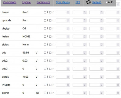

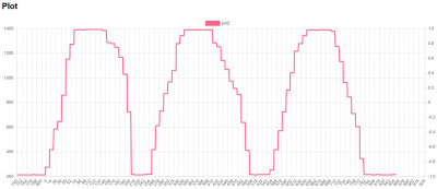

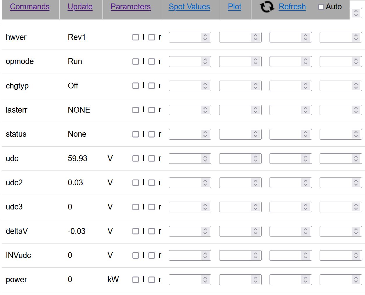

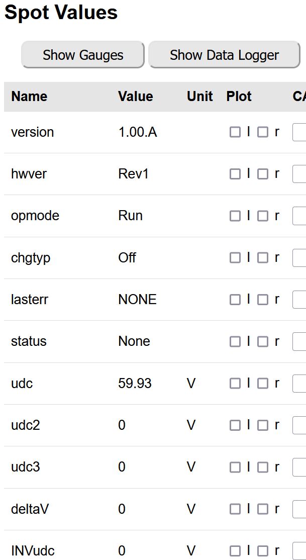

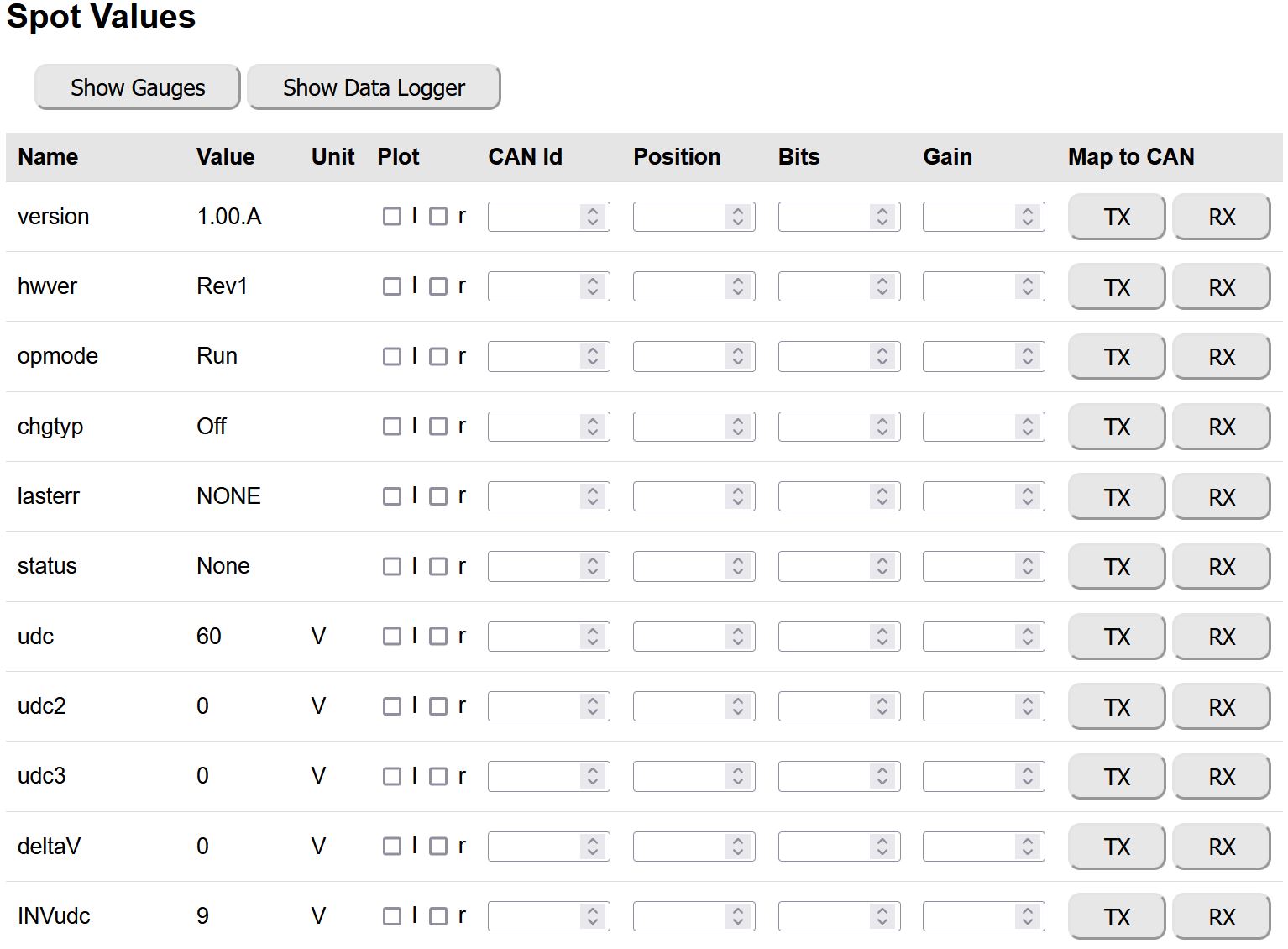

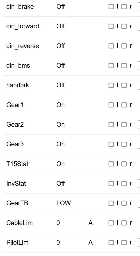

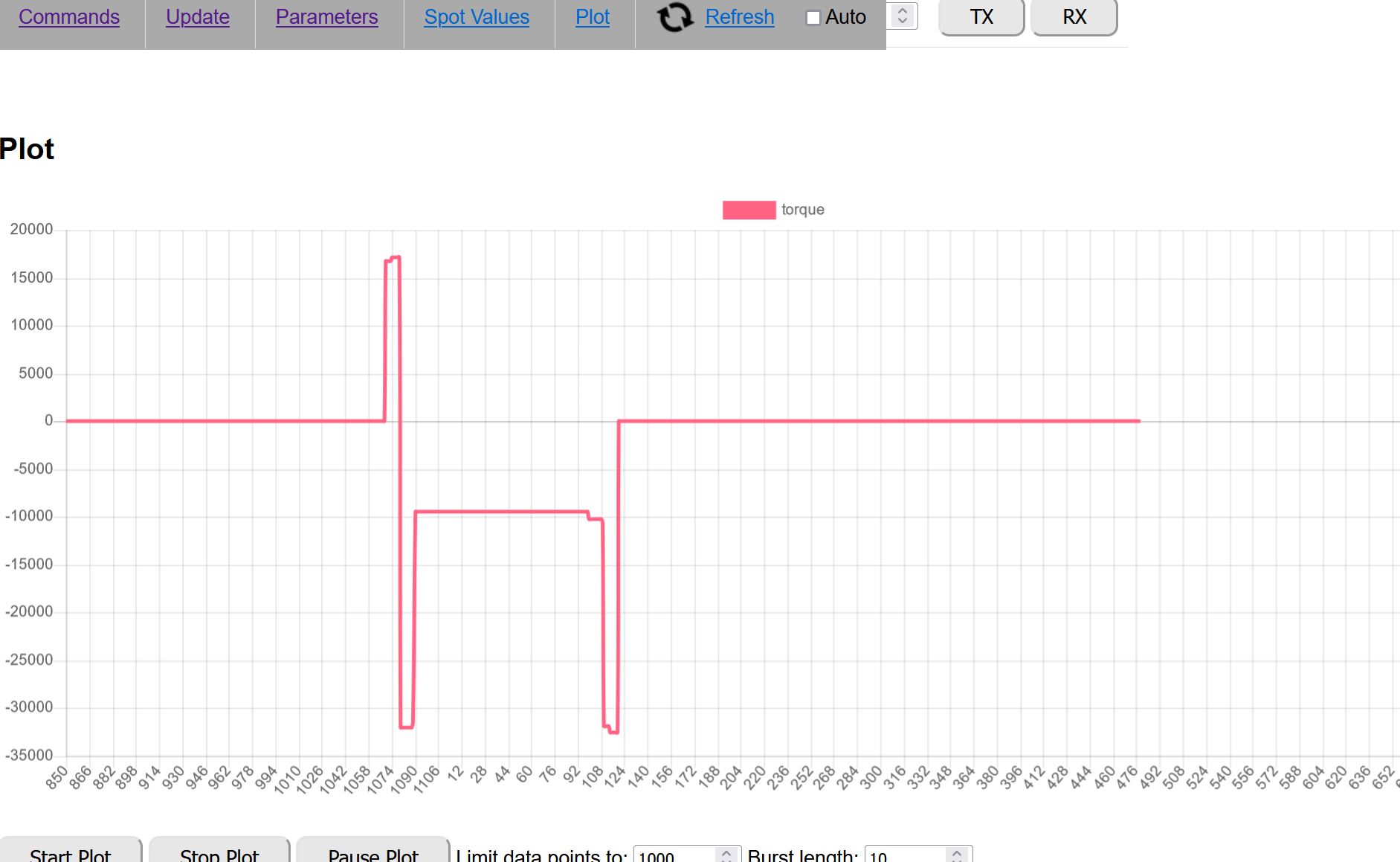

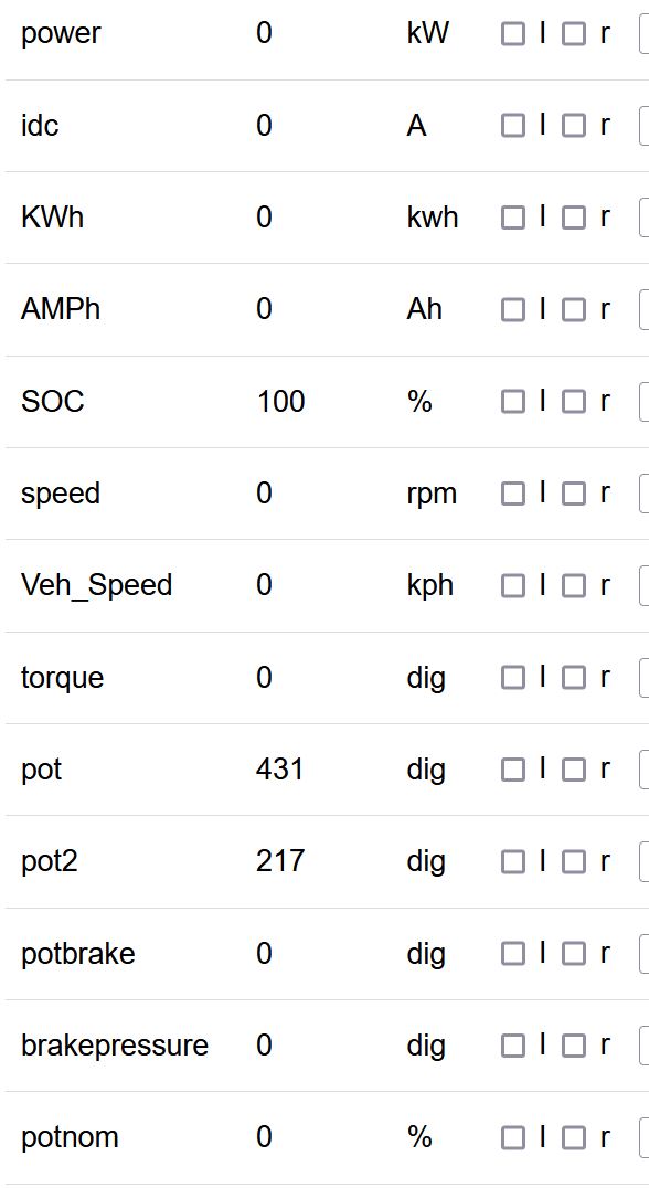

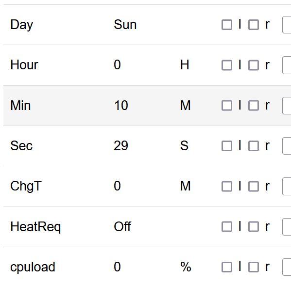

Quick update on my Zombie workings and a few queries.
So I was sure I probably had the dud CAN transceiver chip issues others have had (although I've had my board since before the potential bad batch of chips). As per one of the posts above, I have a GS450H VCU that I've T'd into the same set up and this runs the GS450H drive ok. So I got the four CAN chips swapped over from the GS board to the Zombie. Just did some testing and same results as before, so not the CAN chip issue for me.

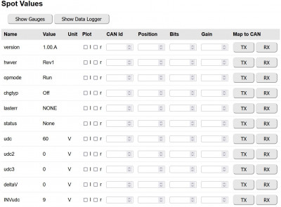

One question, in the spot values, what exactly is INVudc measuring/showing, and how does it get the information? Previously it would show approx 9V (so I would assume it was reading the 12V battery voltage getting to the inverter power input pins), but today it shows 0V. I'm measuring 60V at the inverter HV inputs which shows as UDC ok, and 11.8V at the inverter LV power inputs when system is powered up and contactors on:
INVudc spot value today:
INVudc spot value in previous testing:
I tried selecting different vehicles from the drop down and saving the parameters as originally I had this set to 'None'. This didn't allow the motor to turn, but I did notice that the contactor behavior stopped working correctly especially when I selected the E65 option, but I think that was to be expected.

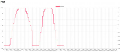

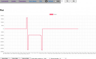

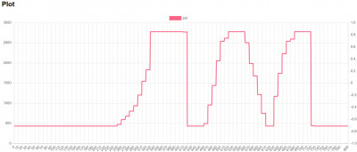

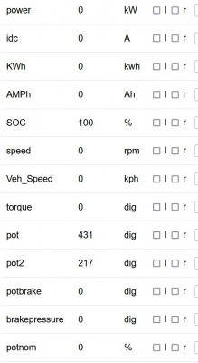

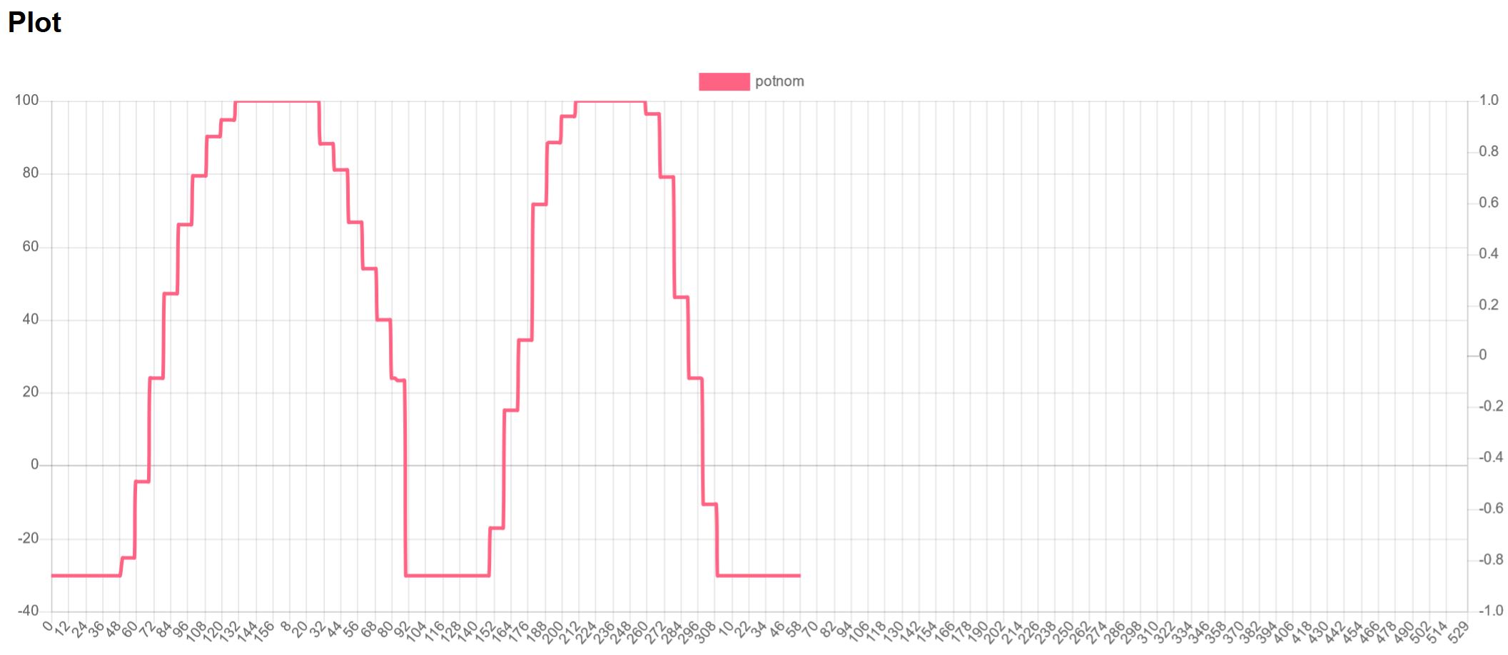

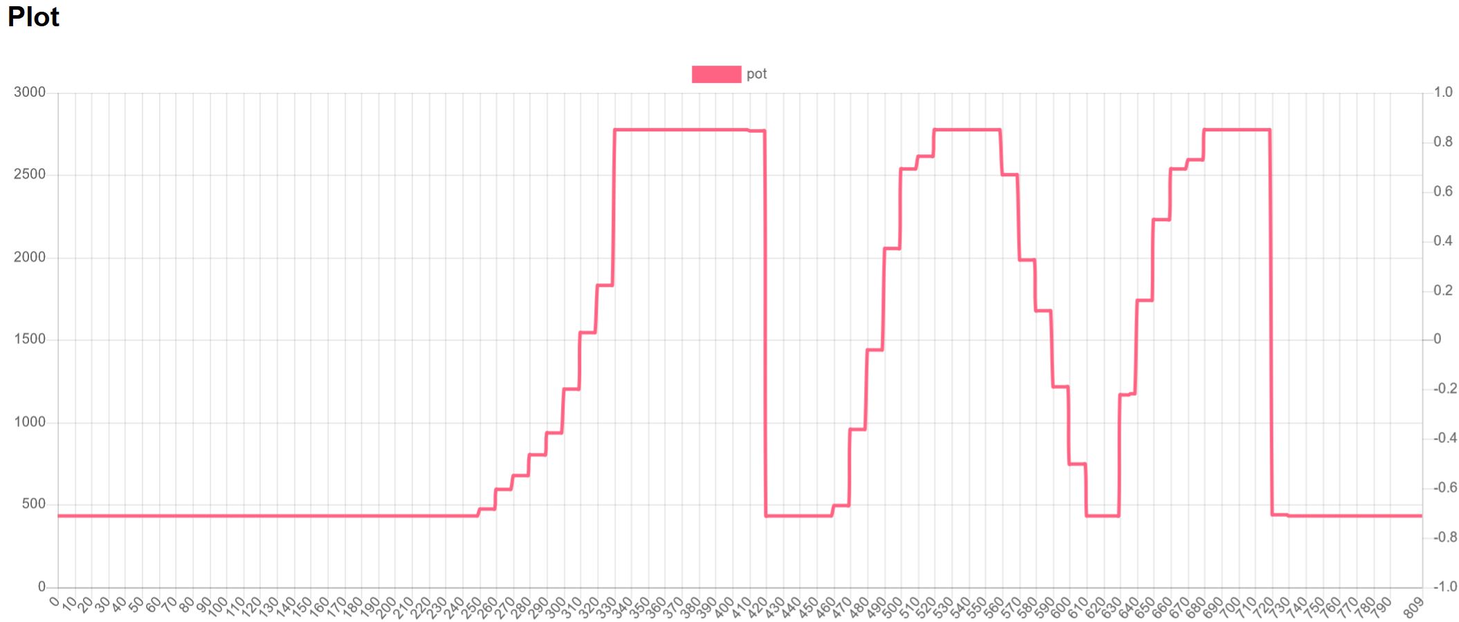

One more question. I did a plot of Pot, Pot1, Potnom while pressing the accelerator pedal and all look to behave as expected. I then did a plot of torque and got the graph below...not as expected. Wondering if anyone has a thought on this, it should be similar to potnom no? This plot is showing the pedal move from off to full and back to off just once, so I expected it to rise from 0 to max and back to 0 only. Looks to skip to negative values half way through pedal travel
So my next plan is to try some more versions of the bin files, some recent posts above on versions that others found to work. If anyone has any other suggestions, happy to hear
- Posts: 4005
- Been thanked: 1127 times
Re: ZombieVerter VCU Support
So lets start with a little reminder that I have two very detailed videos showing the operation of all the parameters on the web interface. these videos are linked and indexed in the wiki so you don't need to plod through the whole thing :
https://openinverter.org/wiki/ZombieVerter_VCU
INVudc displays the HVDC as measured by the inverter and depending on the setup is transmitted to the vcu via CAN or in the case of the GS450H, sync serial. So if you have the inverter powered up and HVDC applied but INVudc reads 0 then the information is not making it to the vcu.
A little word on general fault finding. Absolutely no offense to nkiernan but the shotgun approach to fault finding rarely works especially on a complex system. Its funny that EVERYONE now assumes they have bad can transcievers and this causes all manner of problems from lack of well can comms to bad weather:) I understand frustration with something not working better than most folks believe it or not and have found (much to my frustration!) that the best way to solve a problem is to back off and start with what we know. Sadly I don't have a GS450h setup or I would happily make a video.
1)We know the VCU hardware design works. That doesn't preclude a hardware BUILD problem such as opens or shorts but the design works therefore any build specific build problems can be solved.
2)We know the specific software I used in the E65 drives the GS450h drivetrain. Again, there could be a bug in the version in use in the vcu now as I have not been able to keep up with the flow of things on github for most of a year.
3)The fake CAN transciever parts CAN cause quite a few problems but not ALL problems.
Now in this particular case we have another VERY important piece of info : We know the drivetrain works with the GS450h vcu thus eliminating another unknow. So with this in mind my approach would be as follows :
1)Go back to the know working firmware (linked in the wiki) and run through the throttle cal procedure (also in the wiki). Get all that working happy before even bothering to hookup a drivetrain.
2)Hookup the inverter comms to the vcu tripple checking all the connections and polarities. If I had a penny for every time I've flipped a CANH and CANL I'd be retired to Lanzarote years ago.
3)Now fire it up. Of course it wont work but thats ok. Now observe what the system is telling you. e.g. you are not getting invudc reading a sane value but is INVstat reading something sensible?
Let's try that and see what happens. Slow is smooth, smooth is fast.

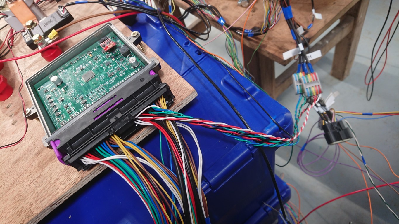

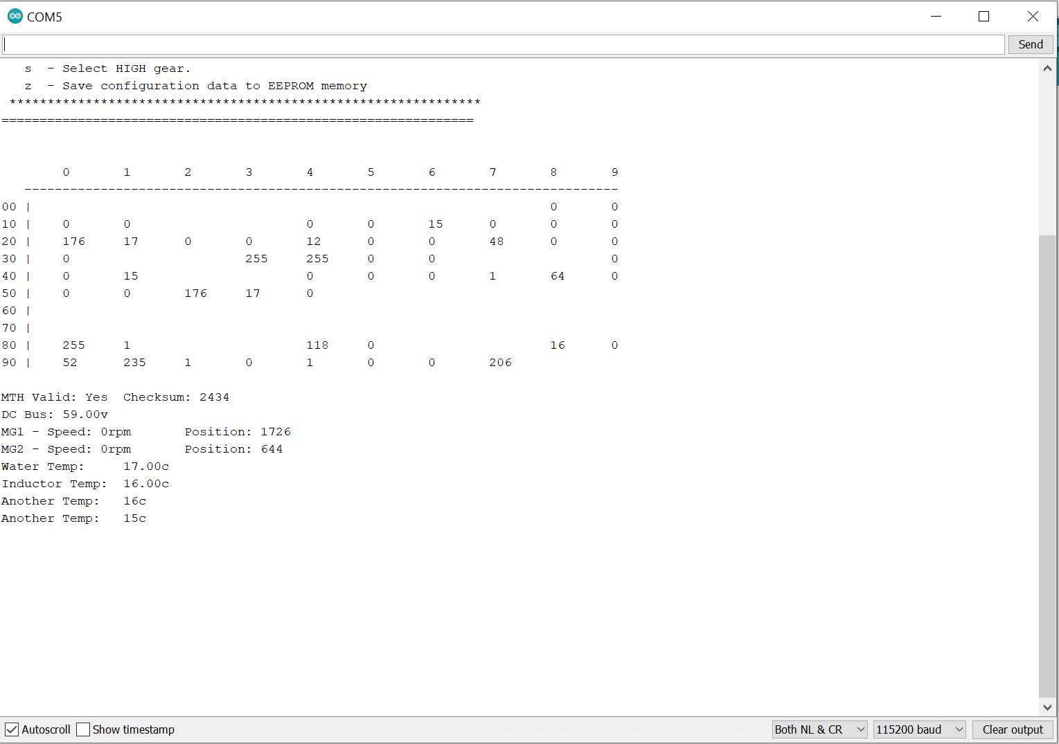

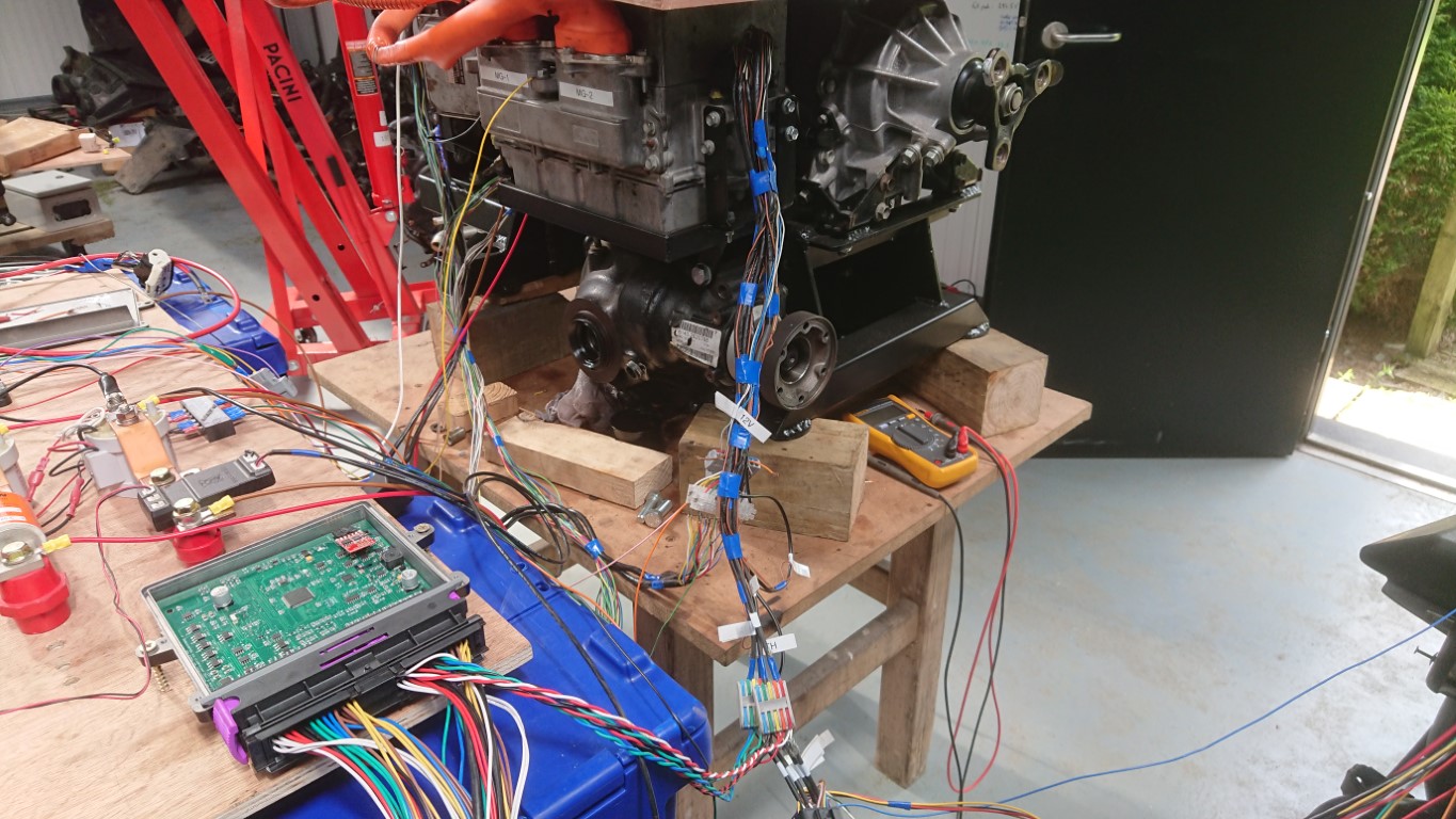

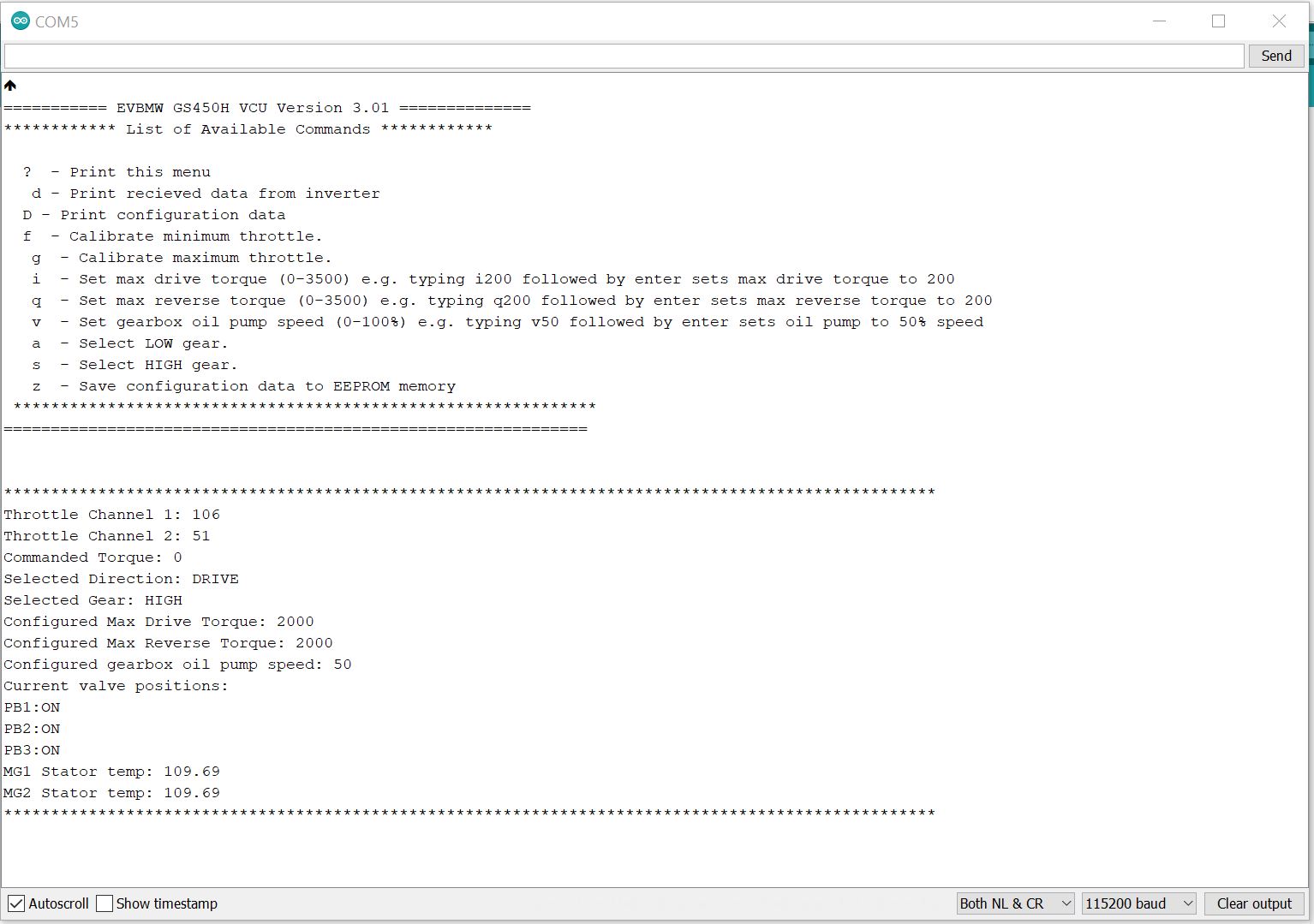

Ok, so this might end up being a long post (or two!) but trying to document some troubleshooting from very basics as per Jack Bauers post above. Appreciate there are some newer bin/hex files others have working but hoping this helps Jack and others in case there's something about other non-tested setups.Jack Bauer wrote: ↑Thu Jun 09, 2022 8:35 am Let's try that and see what happens. Slow is smooth, smooth is fast.
So I broke this into three phases:
1) Wiring tidy and checks
2) GS450H VCU benchmark test
3) Zombieverter comparison test
Phase 1:
I started by shortening the Zombie to inverter comms wiring as short as possible and twisting the relevant pairs. I have the Zombieverter and GS450H VCU's T'd into the wiring loom (you'll see the GS450H VCU black plug in the first photo below) so I can plug in one or the other for easy comparison tests. Confirmed the following:
- Grounds and power sources all ok
- Continuity ok between the relevant pins on the inverter controls plug, the GS450H VCU connector, and the Zombie connector. Double and triple checked the comms wiring in particular and everything ok so the loom is good
- Worked through checks on the Zombie board to confirm continuity between the relevant CAN transceiver IC pins (inverter comms) and ground, power, or main connector, and all ok. Also checked continuity between these IC's and the STM32 as per the schematics and again all ok
- Checked resistance between the Inverter comms IC's pins 6 and 7 and confirmed 119.3R on each
So conclusion is that wiring is all good and the Zombie board is good (note I had the CAN transceivers changed over to good ones in case of issues there - IC9, IC13, IC15 and IC18)
Phase 2:
To ensure the GS450H gearbox and inverter were working ok, I connected the GS450H VCU running the V3 User simplified code (disconnecting the Zombie). Confirmed the following:
- GS450H VCU powers up with the car ignition and using the car accelerator, the motor spins forward or reverse depending on direction selection as expected
- When powered up, I measure 12.95V at the car battery, 11.62V at the inverter controls plug LV power input, and 59.96V at the inverter HV inputs (from bench PSU)
So conclusion is that GS450H VCU can run the system correctly and so the inverter comms are also working correctly. Below screenshots show the serial monitor data during the test which shows the MTH data is valid and the inverter DC bus voltage is reading correctly at 59V (this is important as it doesn't seem to work the same in the Zombie testing).
Phase 3 will be covered in the next post!

Phase 3:Jack Bauer wrote: ↑Thu Jun 09, 2022 8:35 am Let's try that and see what happens. Slow is smooth, smooth is fast.
Following on from the previous post that looked at the wiring and GS450H VCU benchmarking, next I did some work with the Zombieverter.
- Uploaded the known working firmware bin file linked in the wiki and also posted by Jack Bauer earlier in this thread
- Left all options at default except for selecting GS450H for the inverter and changing some of the voltage settings to work with the bench power supply (60V)
- Followed the wiki instructions to calibrate pot (spot values showed 430/2782 so set at 450/2760) and pot2 (spot values showed 215/1396 so set at 235/1375 and uploaded to Zombie). Plots of pot and pot2 shown below while accelerator is pressed and depressed
- Turning the car key to start initiates the contactor sequence, negative and precharge contactors come on and a few seconds later the positive contactor comes on
- When powered up, I measure 12.86V at the car battery, 11.66V at the inverter controls plug LV power input, and 59.94V at the inverter HV inputs (from bench PSU). This is very close to the GS450H test
- No motors rotating in forward or reverse!

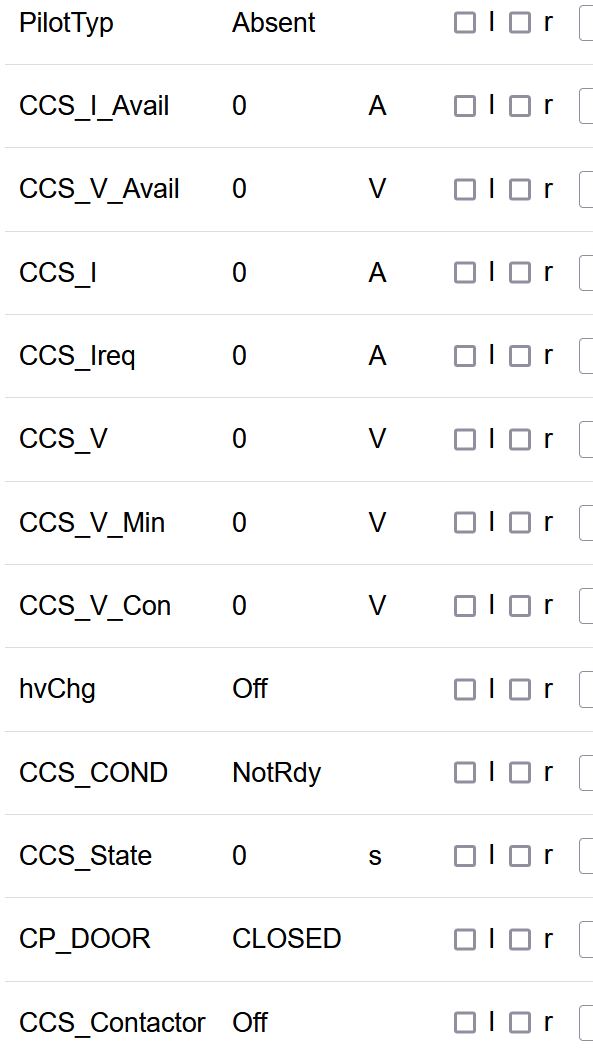

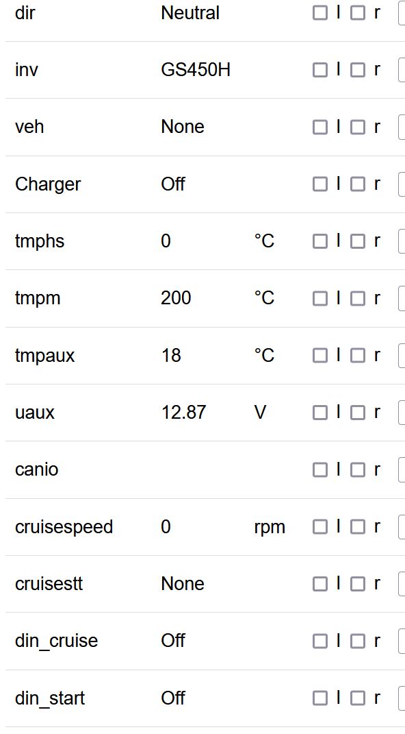

- json and screenshots below show the settings and spot value results at this stage
Conclusion at this point is the motors are not spinning as expected. I tried changing the CAN speed setting between 10ms and 100ms with no change in results. If hardware and wiring are ok as tested, then points to the firmware for now. So hopefully this gives a clear update on where I'm at and maybe something in the images below highlights settings I need to change or what to try next. (Note, this is kind of where I got to last time as per earlier posts in this thread and had some suggestions on trying different settings like selecting a vehicle and trying new firmware bin files, all of which haven't had a different result so far). So maybe someone with the GS450H set up could upload my parameters below and see if their setup runs as expected!?
Slowly moving the accelerator hence the jittery plots
Potnom plot when system is powered up. Torque plot is a straight line at 0 even when forward and reverse selected and accelerator pressed, so no torque values are being sent by the VCU
So we can see that the inverter is in Run mode as expected, there were no errors, and the ISA shunt is correctly reading the HV (59.93V from the bench supply). However, INVudc is reading 0V when I can measure 59.94V at the inverter HV inputs, and in the GS450H test, the inverter was able to measure the correct HV also
Pot values look ok

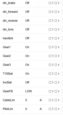

Selected forward and reverse which show in the spot values when selected but no motor rotation when pressing the accelerator. TMPM is 200 here where TMPMmax is 300 so that's not a de-rating issue, and Thortmax is set to 100 so that shouldn't be an issue. Note vehicle is selected as None, that something that could cause issues? Uaux reading the 12V battery voltage correctly too
T15Stat/Ignition is correctly showing 'On', but InvStat is 'Off'. Someone suggested earlier in this thread that InvStat never changes to 'On' with the GS450H yet the motors spin for them. Is this an issue?

Haven't got back to it yet to try your Hex file but will soon. While you were testing this Hex file, what option have you selected for Vehicle? If others are successfully running a GS450H setup with the Zombieverter, what have you selected for Vehicle also? I wondered if it was developed around the E65 so works ok for that, but when used on other vehicles it might not be getting the CAN messages its expecting.paaa wrote: ↑Sun Jun 12, 2022 10:24 pm Have you tried the .hex I uploaded today? There was an issue with throttle input scaling on older hex files floating about . It would scale it as per the way the leaf scales torque request thinks it up to 100 and the lexus is up to to 3500. . It's fixed in the code I shared so try that .hex first as I tested it again today and it spins up no problem. Also I'm wary of the fact you still have no inverter udc showing. I'm nearly sure mine does so I'll check the screenshots I took tommorrow.
Yes, the INVudc has me scratching my head. With the GS450H VCU, the inverter is sending the correct inverter udc, but with the Zombie, its either not sending it correctly or the Zombie is not reading it correctly. I have seen 0V, 2V and 9V on INVudc while testing different bin files though!
I get a faint whine from the inverter with the GS450H VCU in drive/reverse, Don't seem to be getting it with the Zombie. I'm not just sure how the Zombie interacts with the inverter. Inverter is getting 12V power and has HV same as in the GS450H VCU test, so should be doing its thing. Does the data between the inverter and Zombie then have to be accepted by the Zombie before it kicks the system into operation maybe!?
Curious, does your InvStat turn to 'On' during your test?

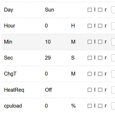

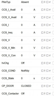

Attached is pdf of all statuses. INV udc seems to be half what isa reports. Also inv stat is on. I using e65 for vehicle and for that vcu looks for can messages for direction. I think your issue lies with the inv stat not coming up and no whine from inverter. Ill try get pic of how mines is wired as i know that works.
example status.pdf- (1.68 MiB) Downloaded 344 times
