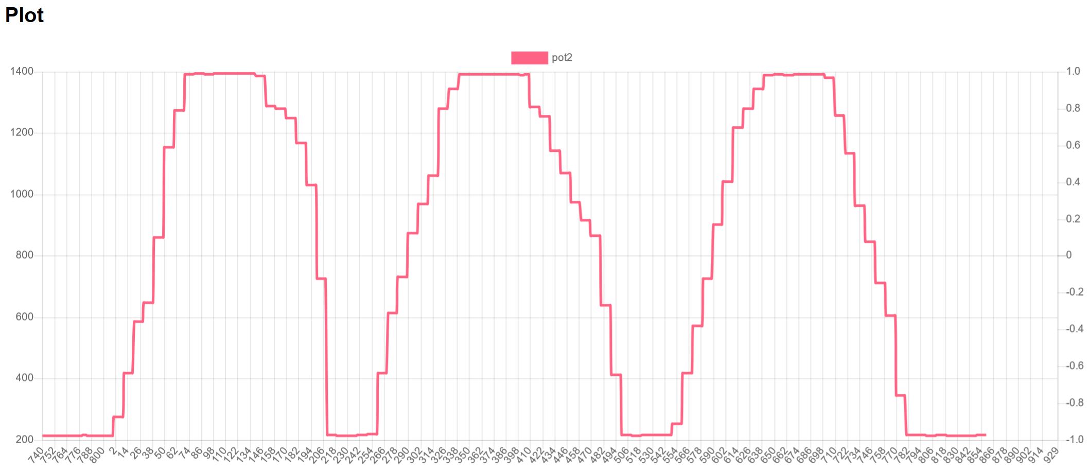

One more question. I did a plot of Pot, Pot1, Potnom while pressing the accelerator pedal and all look to behave as expected. I then did a plot of torque and got the graph below...not as expected. Wondering if anyone has a thought on this, it should be similar to potnom no? This plot is showing the pedal move from off to full and back to off just once, so I expected it to rise from 0 to max and back to 0 only. Looks to skip to negative values half way through pedal travel

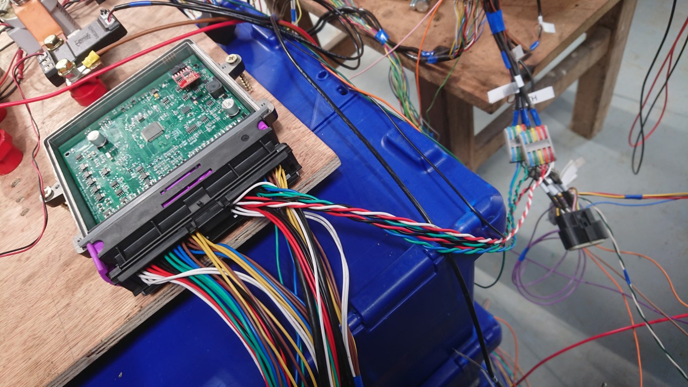

Ok, so this might end up being a long post (or two!) but trying to document some troubleshooting from very basics as per Jack Bauers post above. Appreciate there are some newer bin/hex files others have working but hoping this helps Jack and others in case there's something about other non-tested setups.
So I broke this into three phases:
1) Wiring tidy and checks
2) GS450H VCU benchmark test
3) Zombieverter comparison test
Phase 1:
I started by shortening the Zombie to inverter comms wiring as short as possible and twisting the relevant pairs. I have the Zombieverter and GS450H VCU's T'd into the wiring loom (you'll see the GS450H VCU black plug in the first photo below) so I can plug in one or the other for easy comparison tests. Confirmed the following:
- Grounds and power sources all ok
- Continuity ok between the relevant pins on the inverter controls plug, the GS450H VCU connector, and the Zombie connector. Double and triple checked the comms wiring in particular and everything ok so the loom is good
- Worked through checks on the Zombie board to confirm continuity between the relevant CAN transceiver IC pins (inverter comms) and ground, power, or main connector, and all ok. Also checked continuity between these IC's and the STM32 as per the schematics and again all ok
- Checked resistance between the Inverter comms IC's pins 6 and 7 and confirmed 119.3R on each
So conclusion is that wiring is all good and the Zombie board is good (note I had the CAN transceivers changed over to good ones in case of issues there - IC9, IC13, IC15 and IC18) :)
Phase 2:
To ensure the GS450H gearbox and inverter were working ok, I connected the GS450H VCU running the V3 User simplified code (disconnecting the Zombie). Confirmed the following:
- GS450H VCU powers up with the car ignition and using the car accelerator, the motor spins forward or reverse depending on direction selection as expected
- When powered up, I measure 12.95V at the car battery, 11.62V at the inverter controls plug LV power input, and 59.96V at the inverter HV inputs (from bench PSU)
So conclusion is that GS450H VCU can run the system correctly and so the inverter comms are also working correctly. Below screenshots show the serial monitor data during the test which shows the MTH data is valid and the inverter DC bus voltage is reading correctly at 59V (this is important as it doesn't seem to work the same in the Zombie testing). :)
Phase 3 will be covered in the next post!

Phase 3:
Following on from the previous post that looked at the wiring and GS450H VCU benchmarking, next I did some work with the Zombieverter.
- Uploaded the known working firmware bin file linked in the wiki and also posted by Jack Bauer earlier in this thread
- Left all options at default except for selecting GS450H for the inverter and changing some of the voltage settings to work with the bench power supply (60V)
- Followed the wiki instructions to calibrate pot (spot values showed 430/2782 so set at 450/2760) and pot2 (spot values showed 215/1396 so set at 235/1375 and uploaded to Zombie). Plots of pot and pot2 shown below while accelerator is pressed and depressed
- Turning the car key to start initiates the contactor sequence, negative and precharge contactors come on and a few seconds later the positive contactor comes on
- When powered up, I measure 12.86V at the car battery, 11.66V at the inverter controls plug LV power input, and 59.94V at the inverter HV inputs (from bench PSU). This is very close to the GS450H test
- No motors rotating in forward or reverse!
- json and screenshots below show the settings and spot value results at this stage

Slowly moving the accelerator hence the jittery plots
Potnom plot when system is powered up. Torque plot is a straight line at 0 even when forward and reverse selected and accelerator pressed, so no torque values are being sent by the VCU
