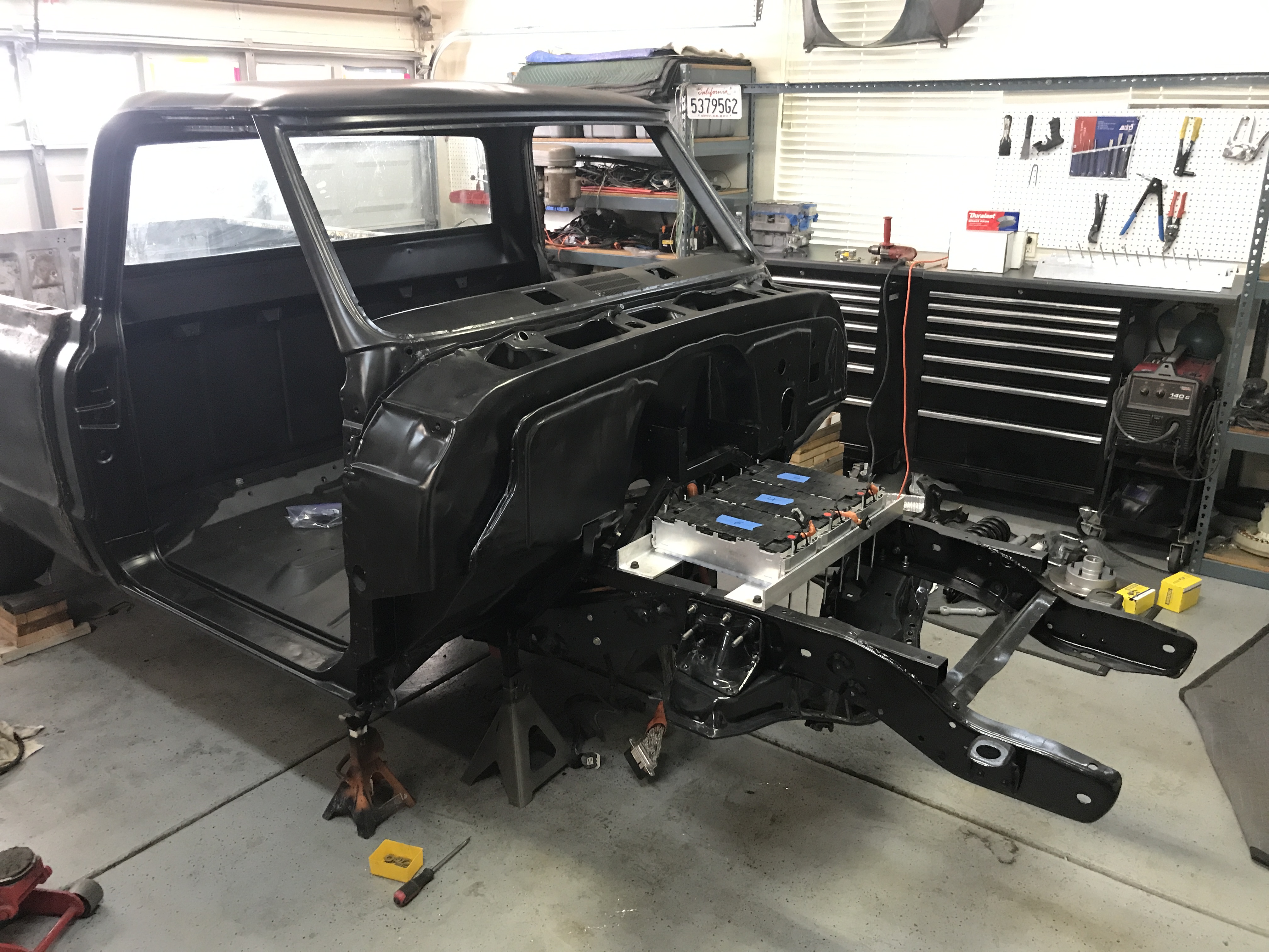

so here's the crap I've been up to the last couple weeks (when not dealing with weddings and graduations, lol)
Gregski
Posts: 2743
Has thanked: 500 times
Been thanked: 951 times

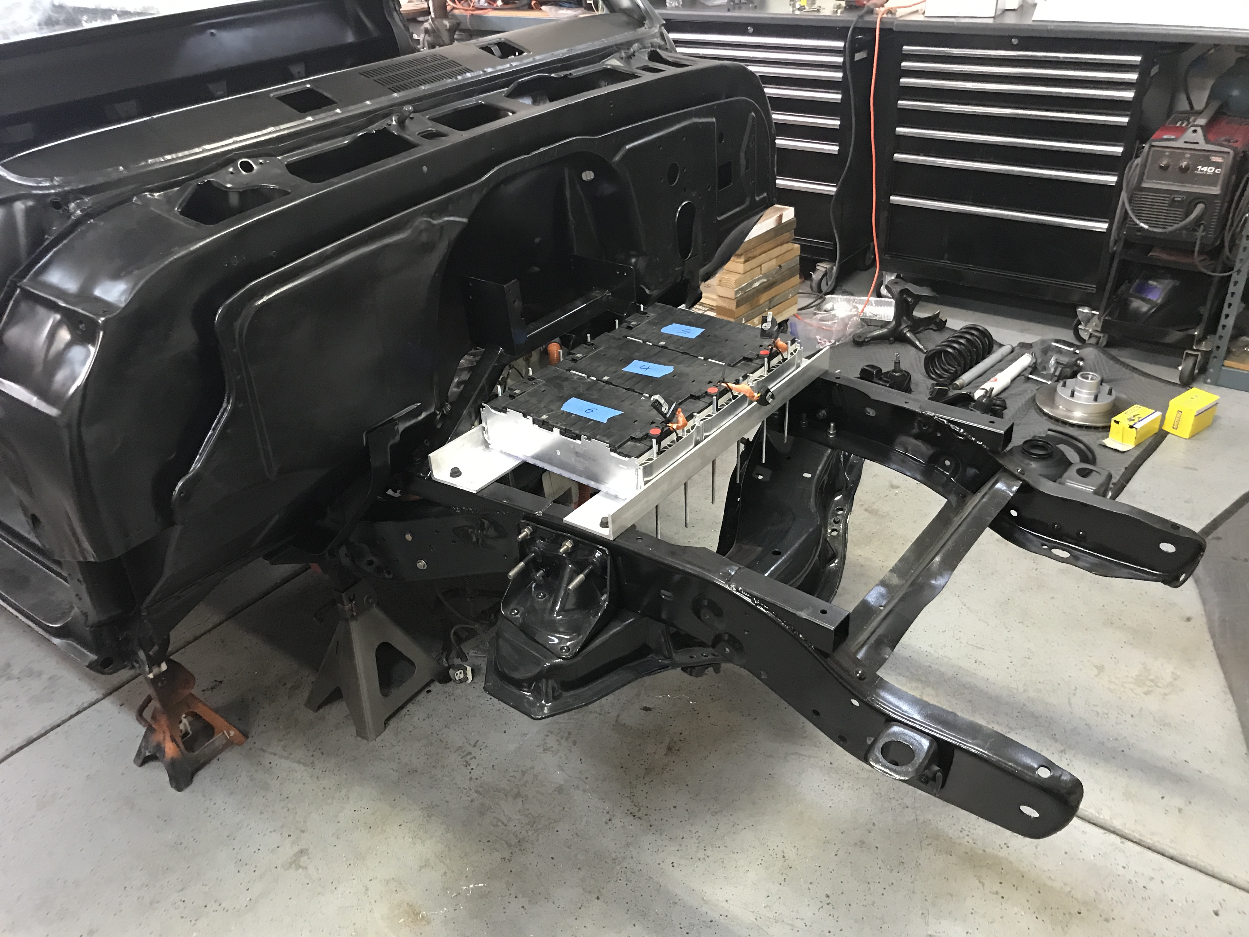

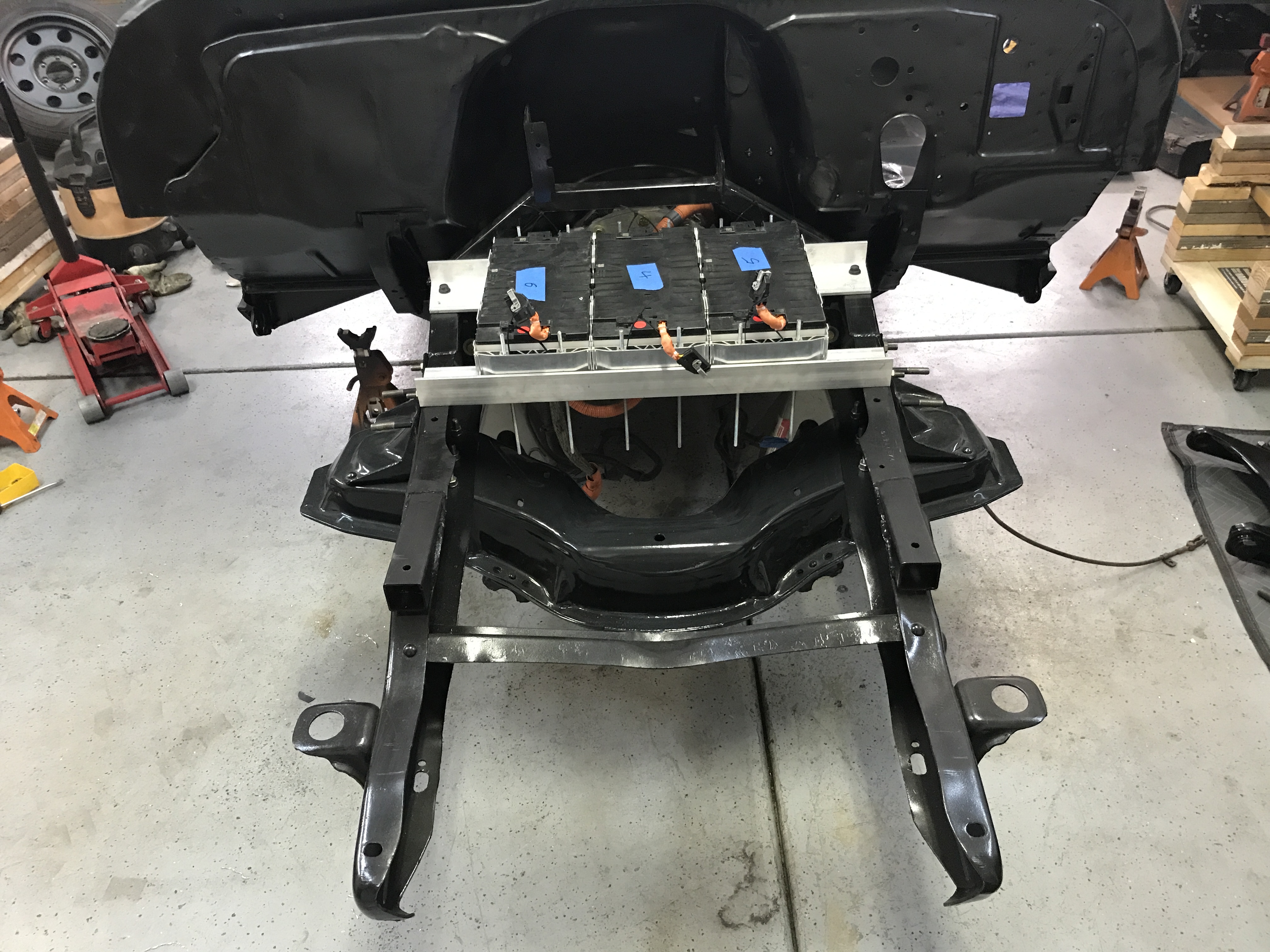

Post by Gregski »

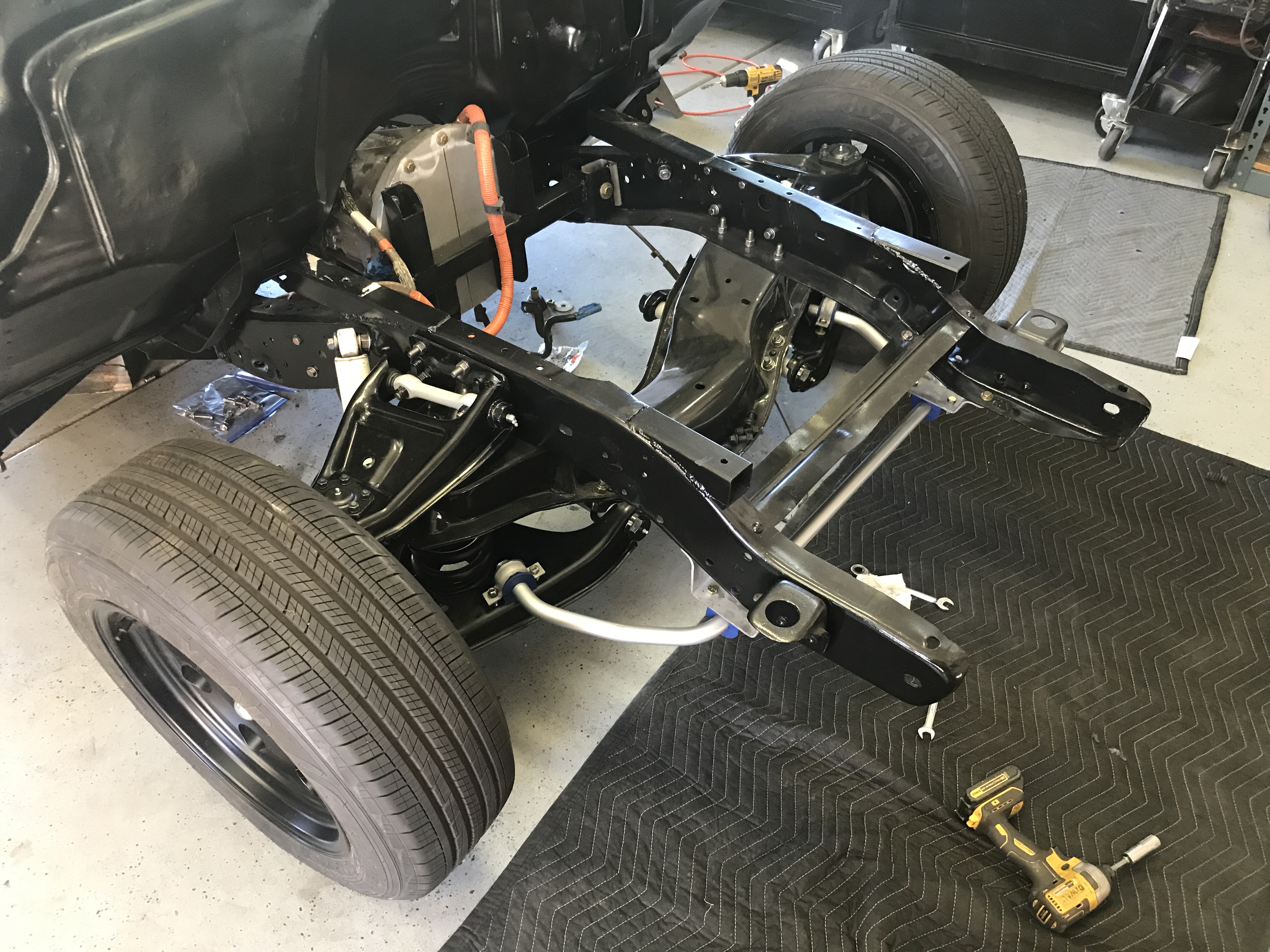

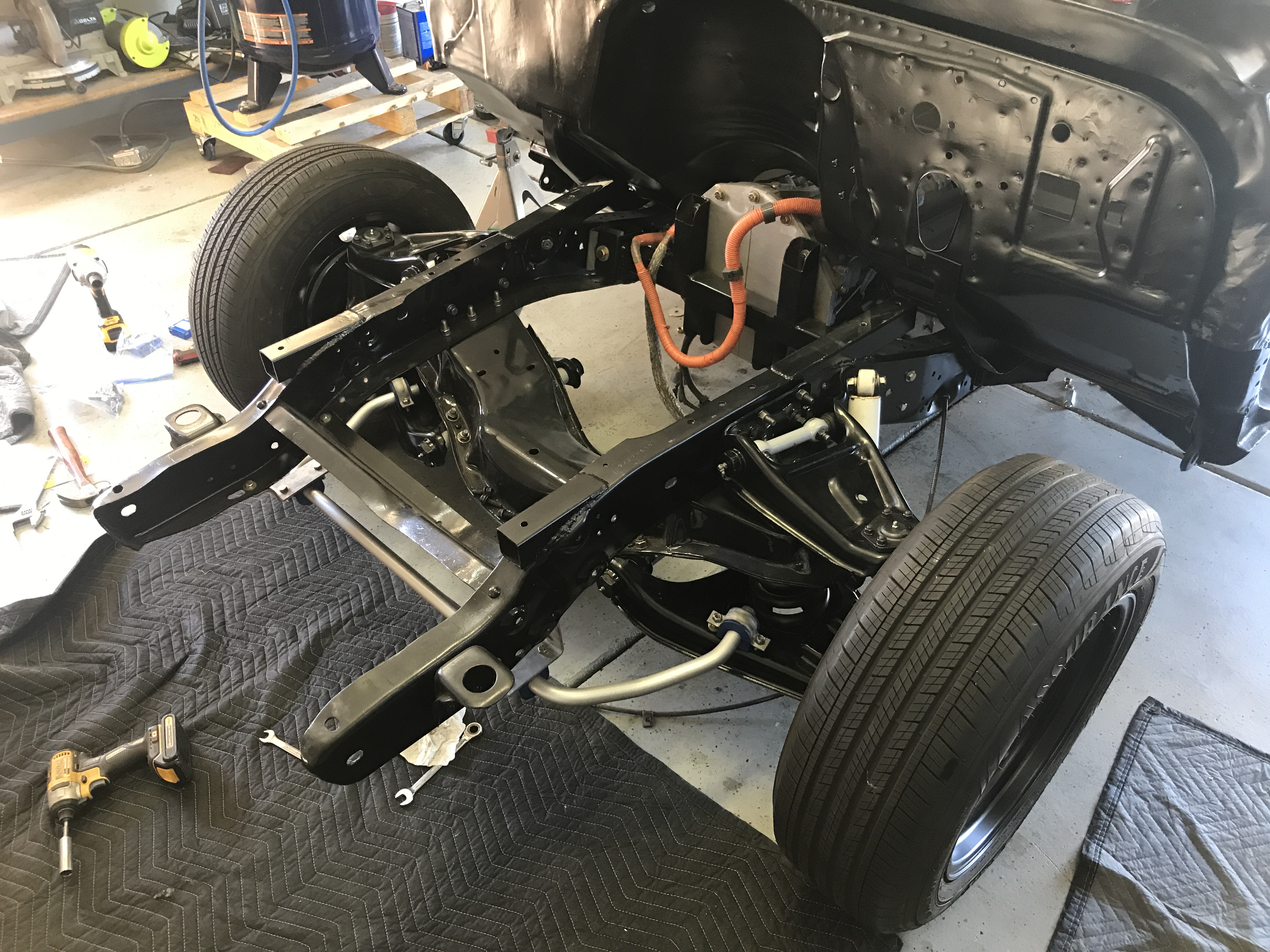

happy to report the final assembly has commenced, with the help of a few friends we got the drive shaft mounted, the transmission mounted, the cab mounted, and the "engine" crossmember installed, we could not go any further since I am still waiting on the control arm rubber seals, yes $3.00 parts, lol
Top Tip: don't be too proud to ask for help, the scratches you save may be your own, ha ha

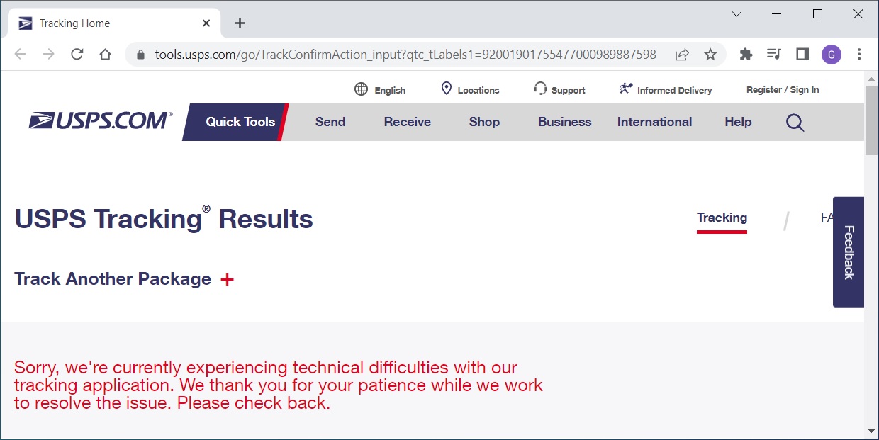

hey I know let's check on those $3 dollar rubber seals that are holding up the project and preventing us from putting the control arms back on
how did that saying go again: "Neither snow nor rain nor heat nor gloom of night stays these couriers from the swift completion of their appointed rounds"
Posts: 3572
Has thanked: 134 times
Been thanked: 339 times
Gregski wrote: Tue Jun 21, 2022 6:39 am hey I know let's check on those $3 dollar rubber seals that are holding up the project and preventing us from putting the control arms back on
They are probably outsourceing couriers, not US based :).
Gregski
Posts: 2743
Post by Gregski »
arber333 wrote: Tue Jun 21, 2022 7:01 am
ha ha, right? well this thing has been sitting 12 miles away from my house since Sunday (two days ago) I know this is the US Postal Service but a buddy of mine worked for FedEx and said they would sit on packages if their predicted tracking said they would get there later so that they would not make their tracking system look bad, true story, he had no reason to lie to me

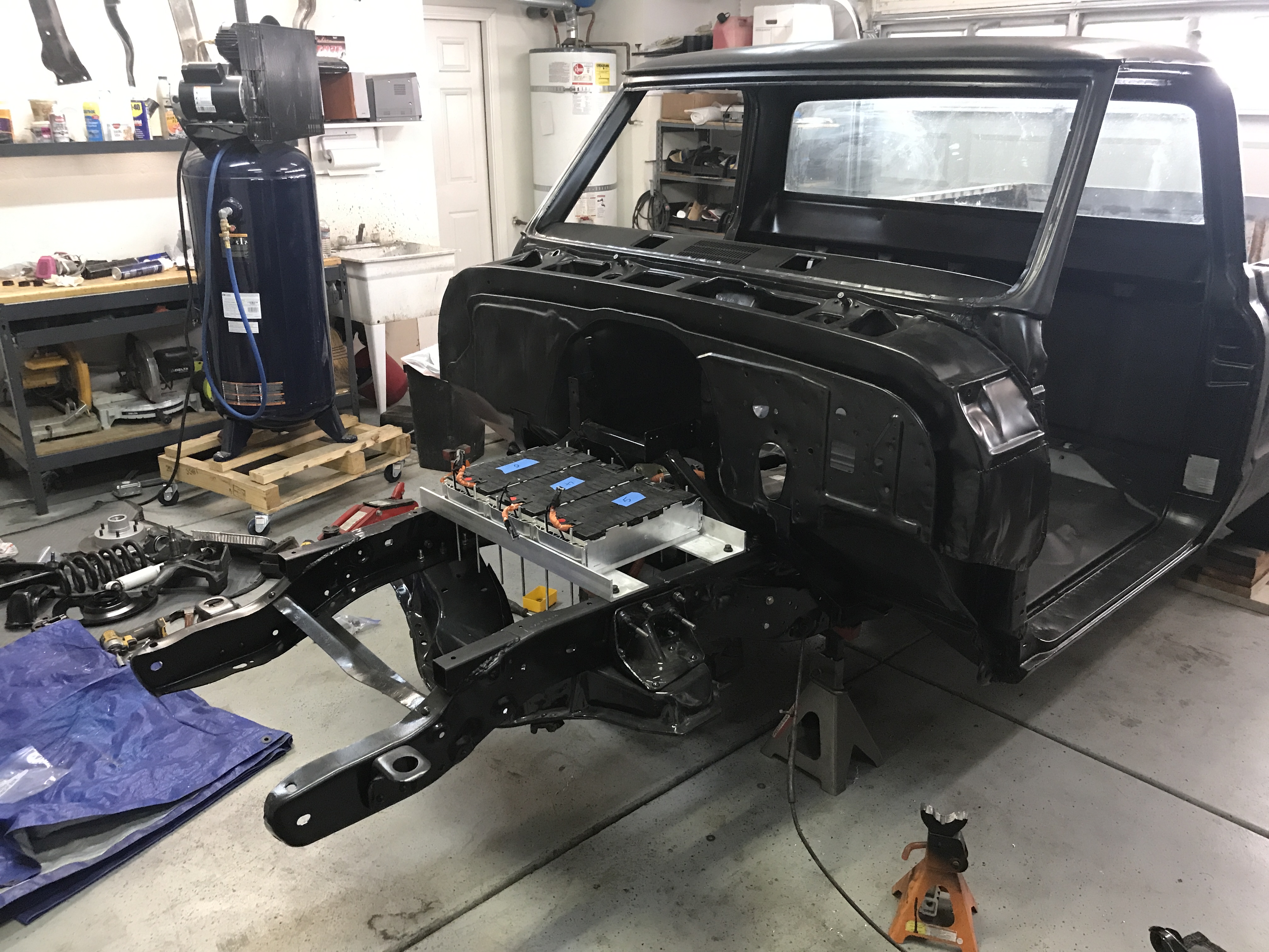

and here she is back on her feet

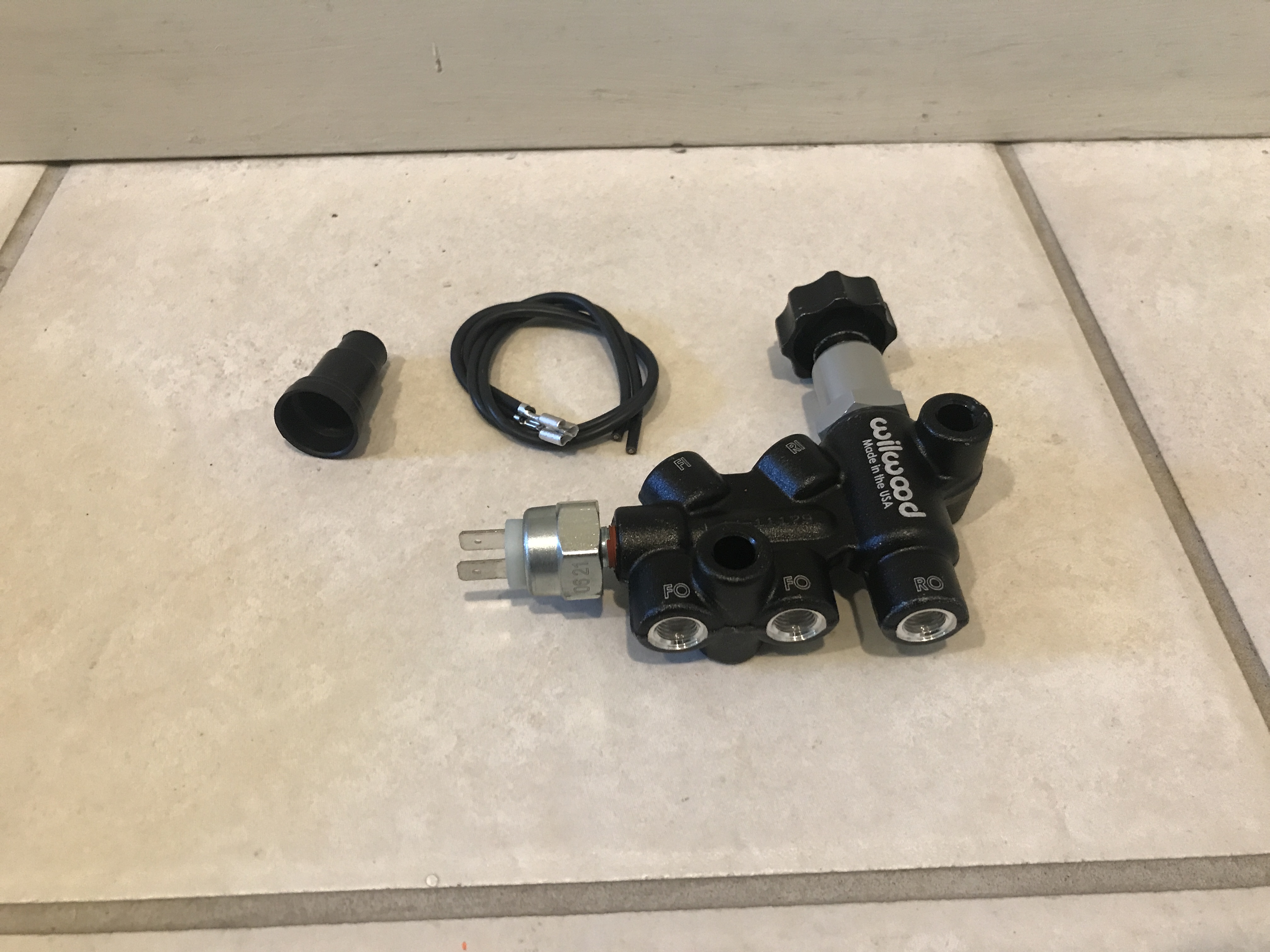

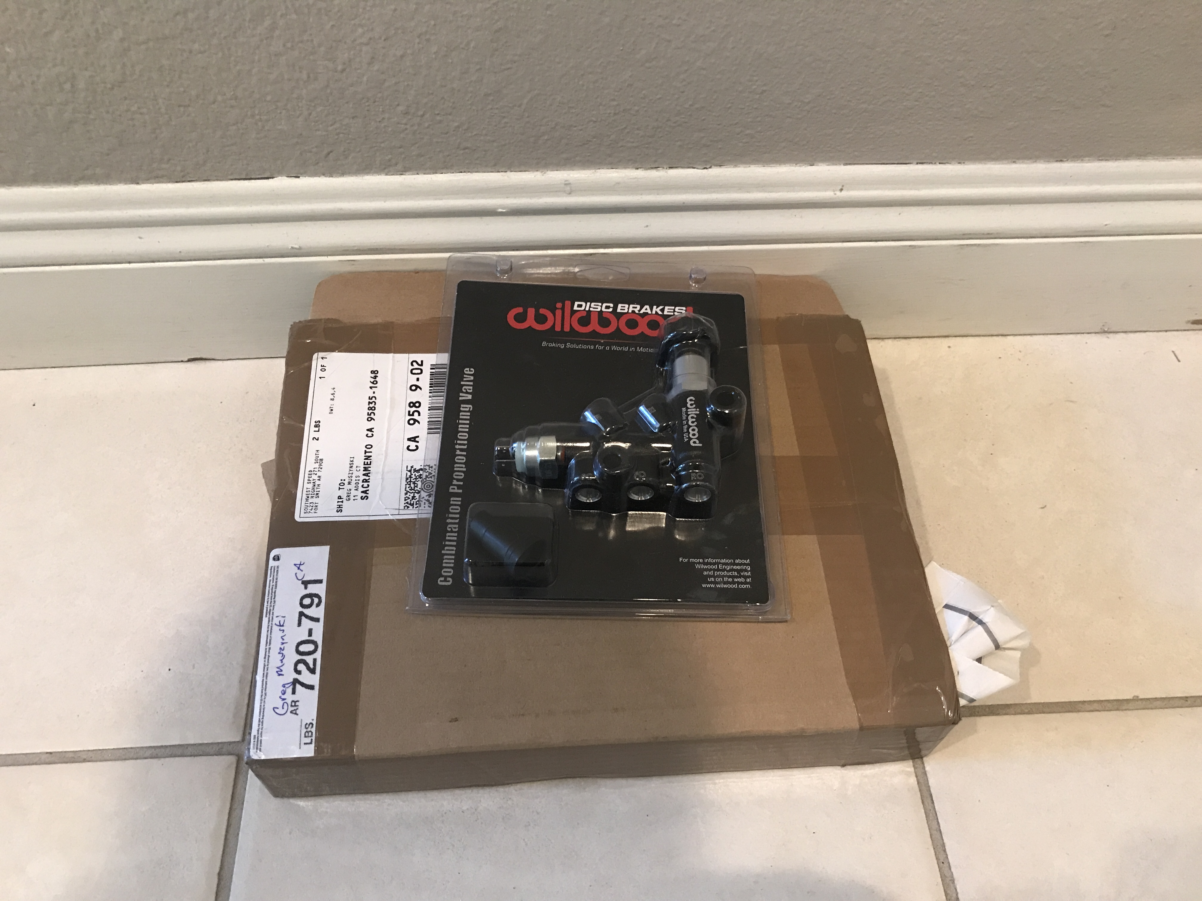

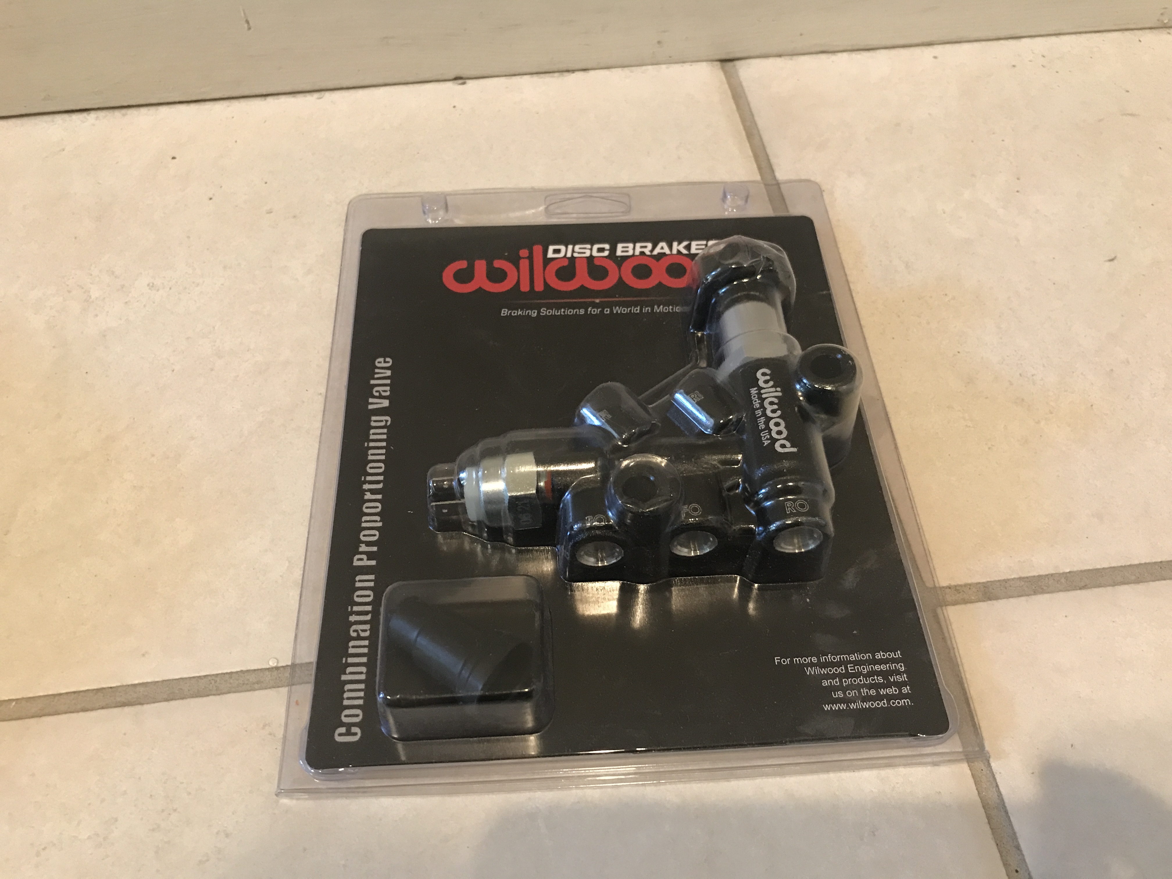

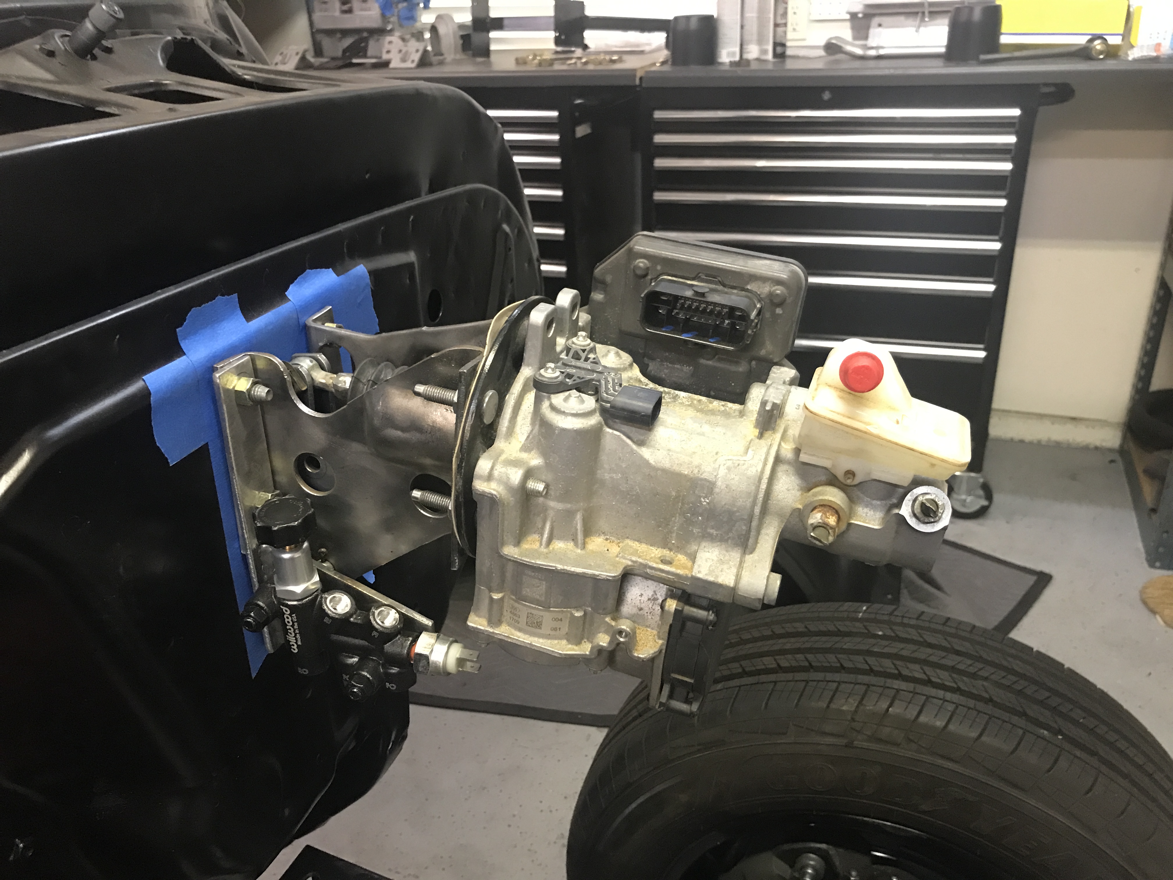

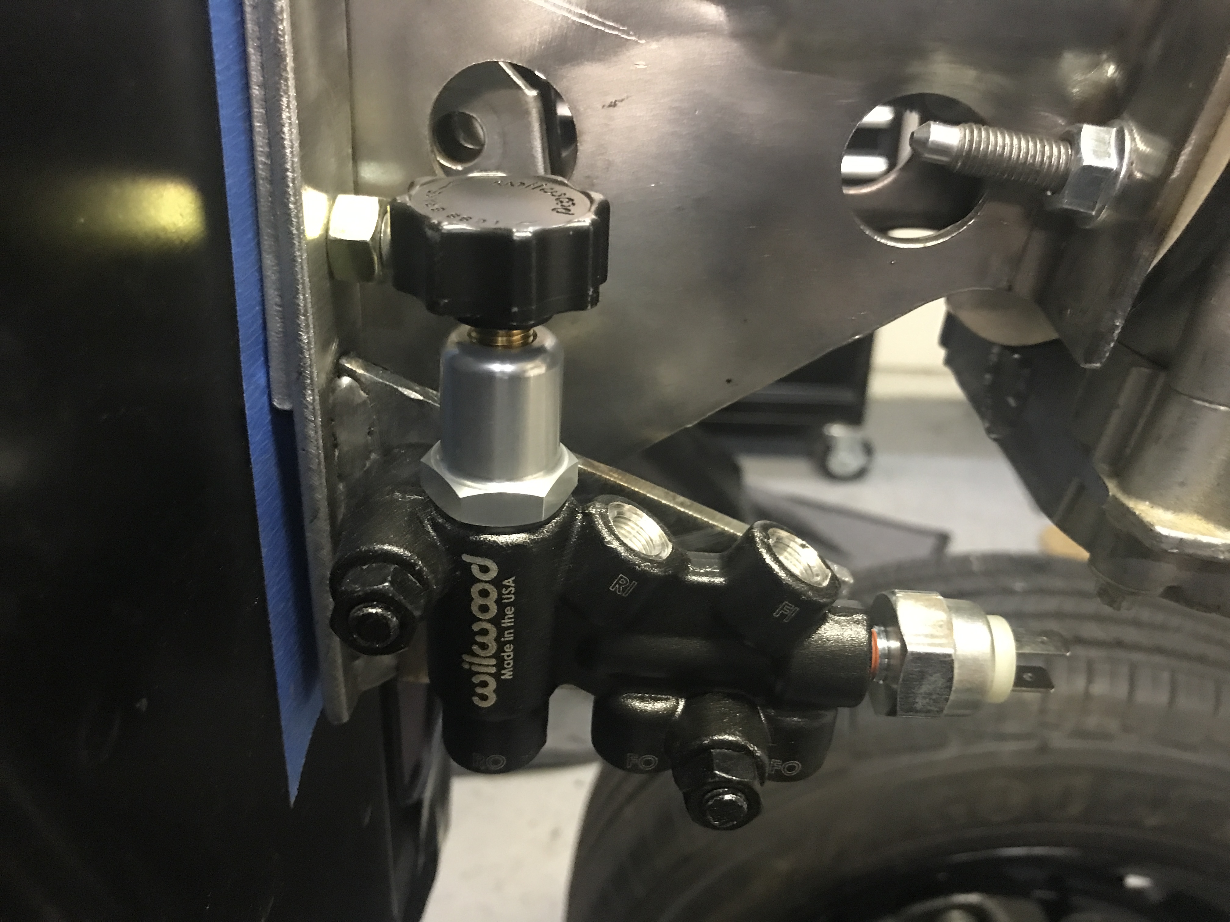

a little motivation
WILWOOD Combination Proportioning Valve (pronounced: adjustable)
Gregski
Posts: 2743
Post by Gregski »
me going to plumb the brakes

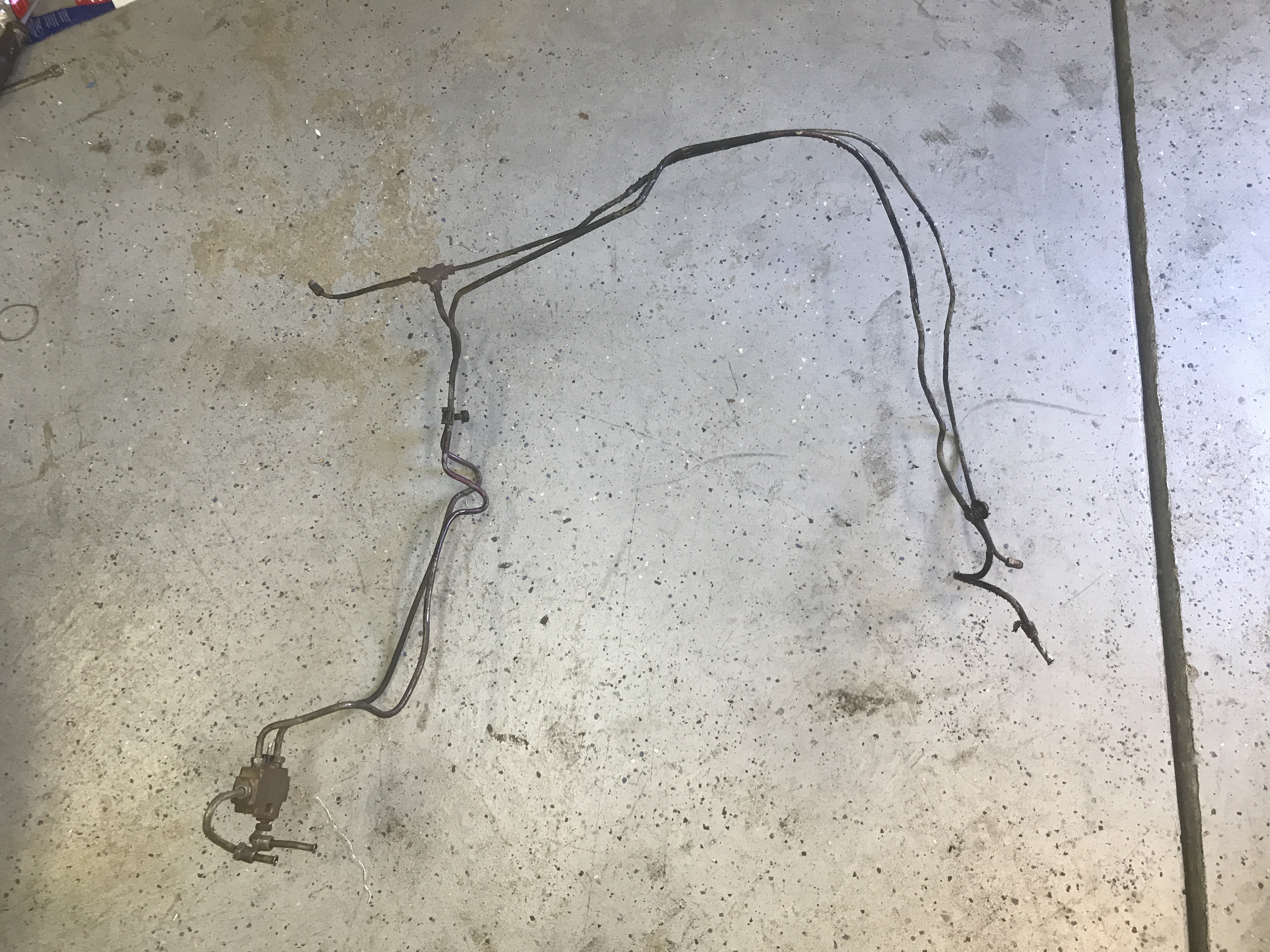

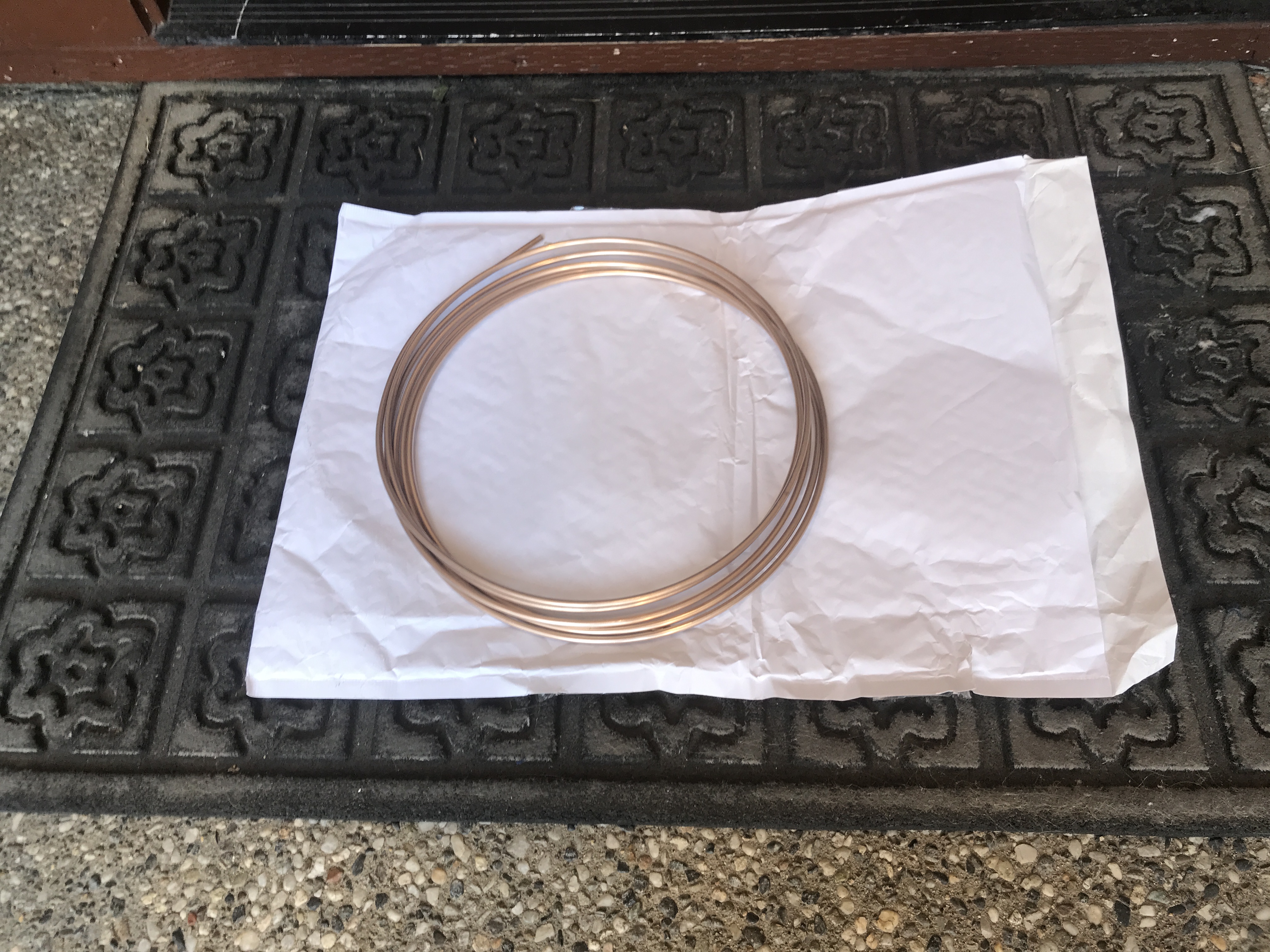

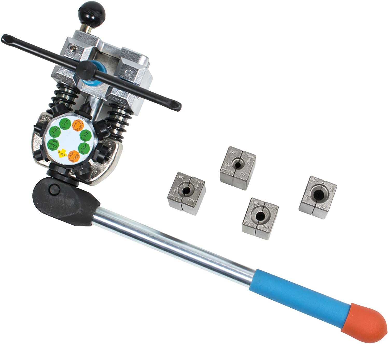

give me a brake
larsrengersen
Posts: 146
Has thanked: 10 times
Been thanked: 28 times
Post by larsrengersen »
Matt mentions it as well: use the brake line that was originally used. However, that can be a challenge. Most classic cars use 3/16" or 4,75mm (or 5mm) and Tesla (and I also expect Honda in your case) uses a larger diameter. So I recommend to use an adapter.
Are you going to upgrade the brake switch on the Wilwood with a pressure transducer?
Gregski
Posts: 2743
Post by Gregski »
larsrengersen wrote: Fri Jul 01, 2022 7:53 am Matt mentions it as well: use the brake line that was originally used. However, that can be a challenge. Most classic cars use 3/16" or 4,75mm (or 5mm) and Tesla (and I also expect Honda in your case) uses a larger diameter. So I recommend to use an adapter.
Hi Lars thank you for taking the time to post this, (folk's this gentlemen did the awesome iBooster write up on EV Create which can be found here: https://www.evcreate.nl/category/brakes/)
honestly I am learning as I go and following your write up as much as I can and as much as I understand it, as far as the brake switch I have not thought about that yet, so I am completely open to suggestions and appreciate any and all advice, especially from you, please and thank you

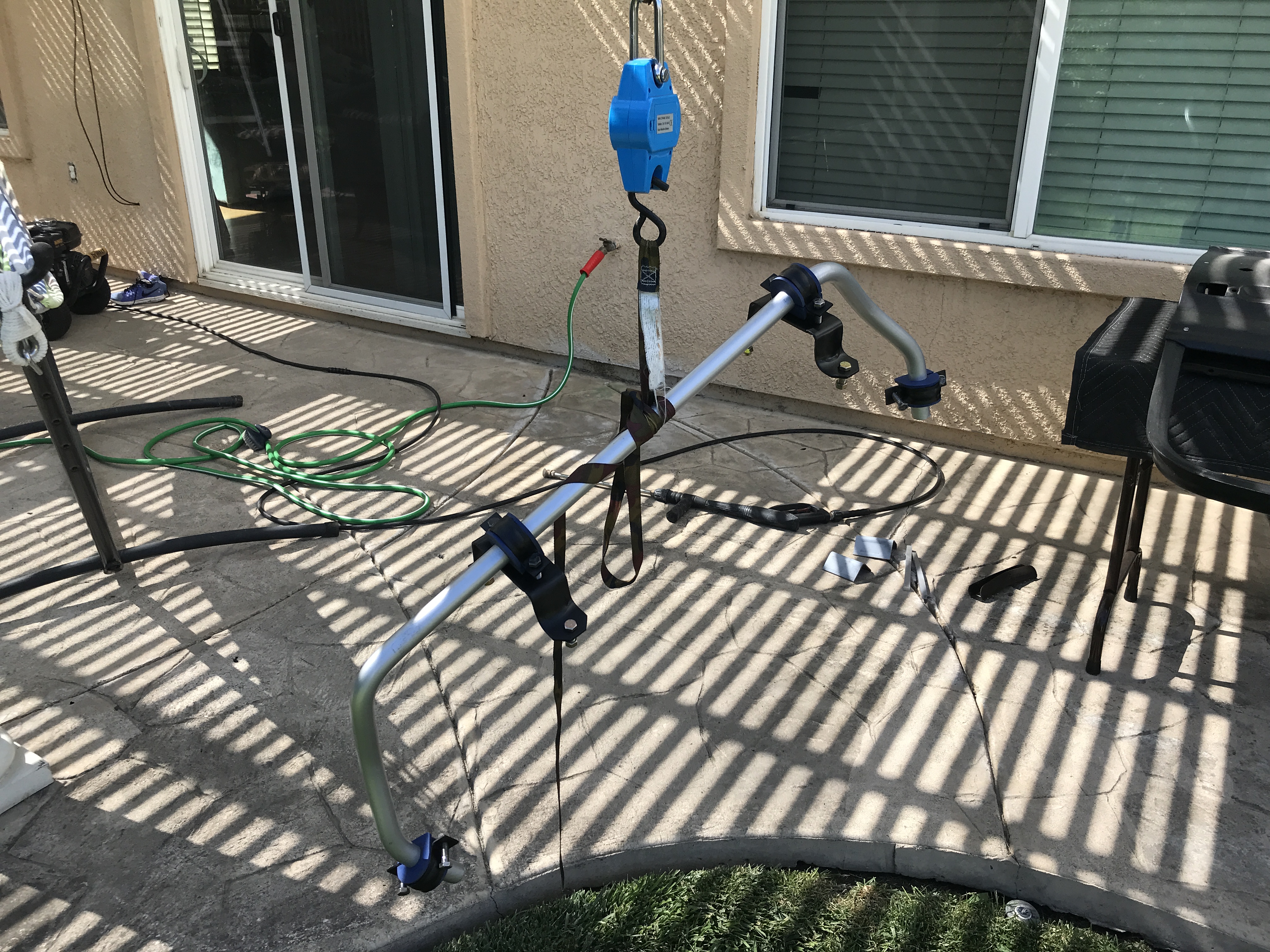

just a little stateside fun with drive shafts

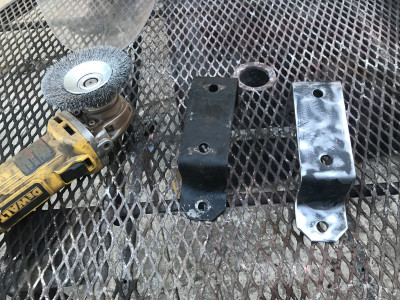

Post by Gregski »

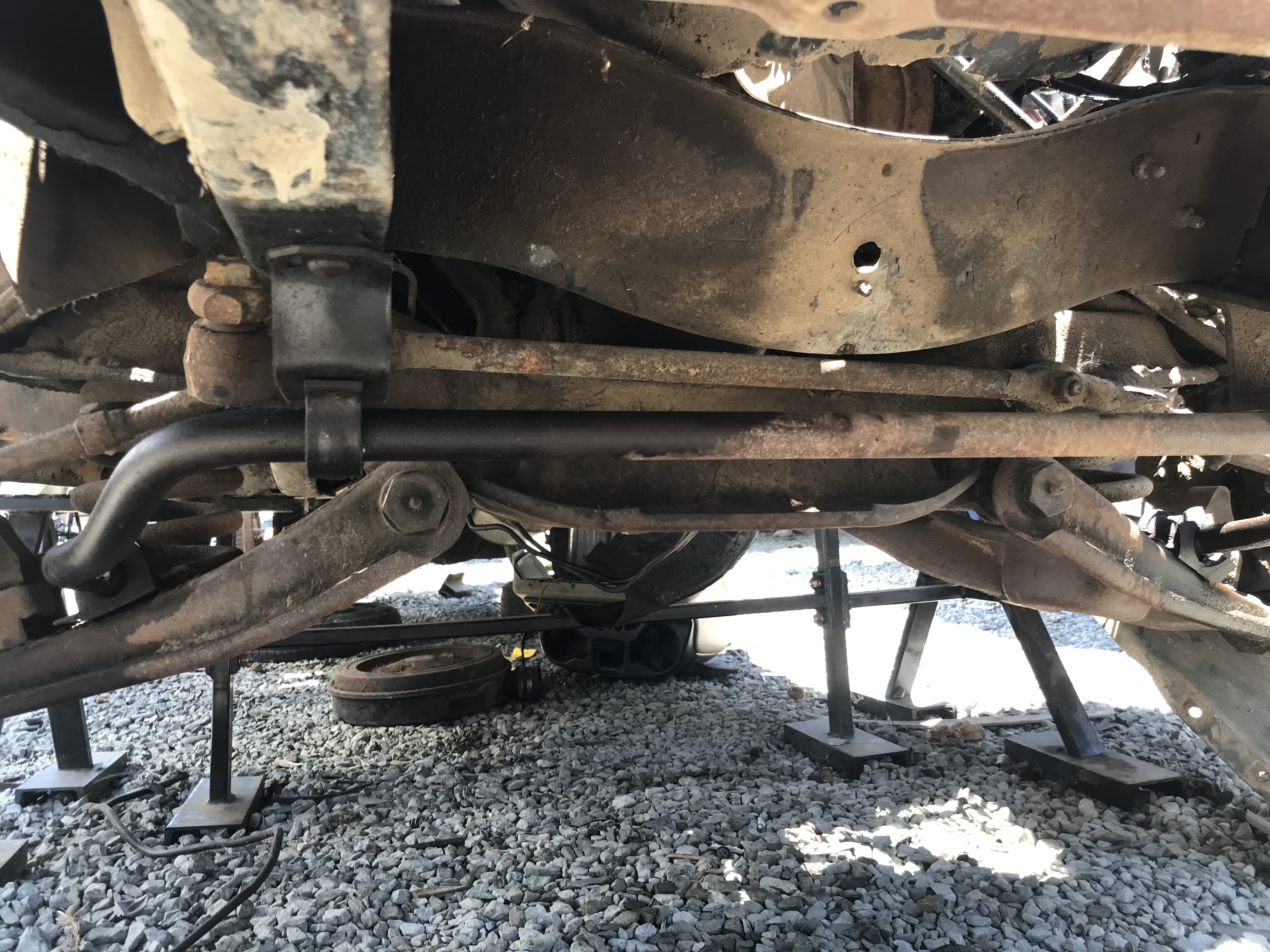

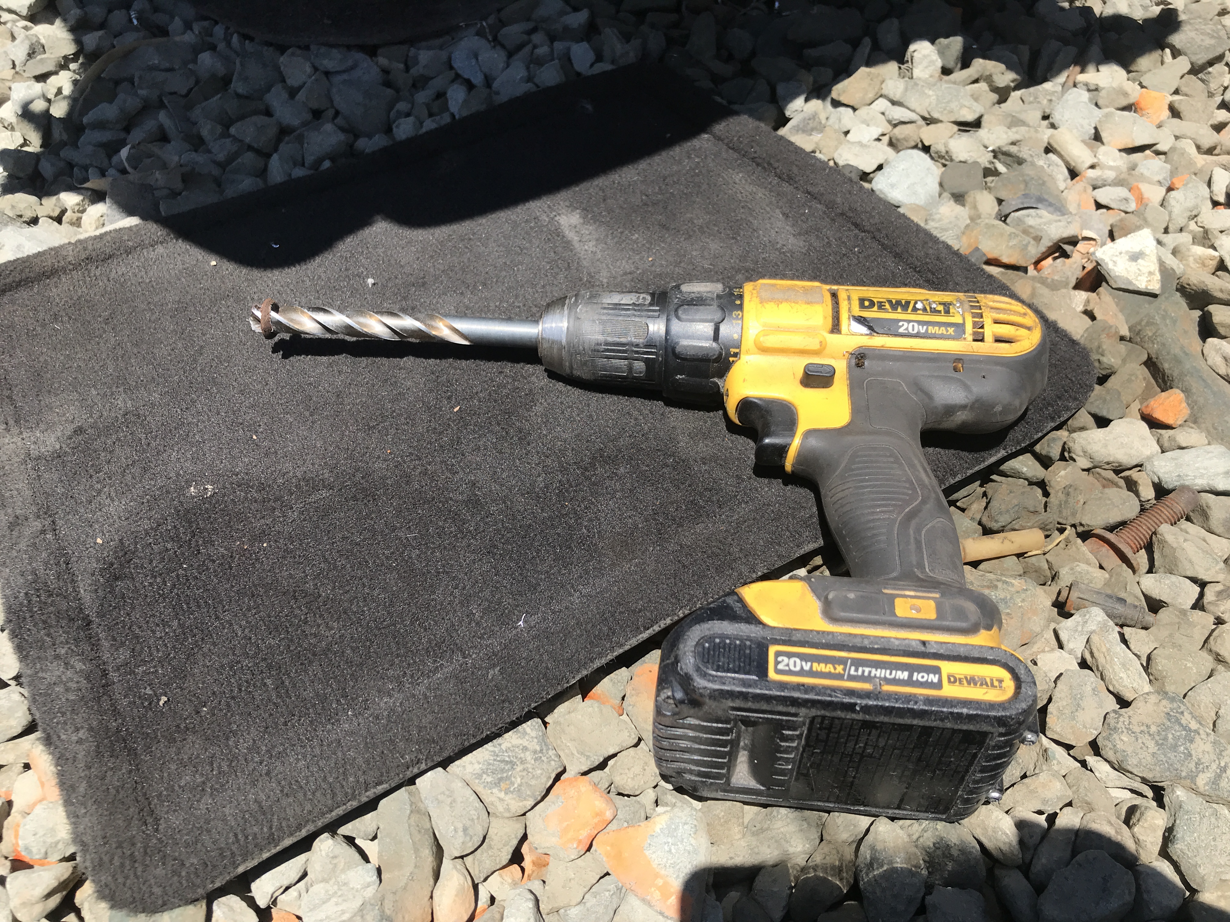

What is he up to now?

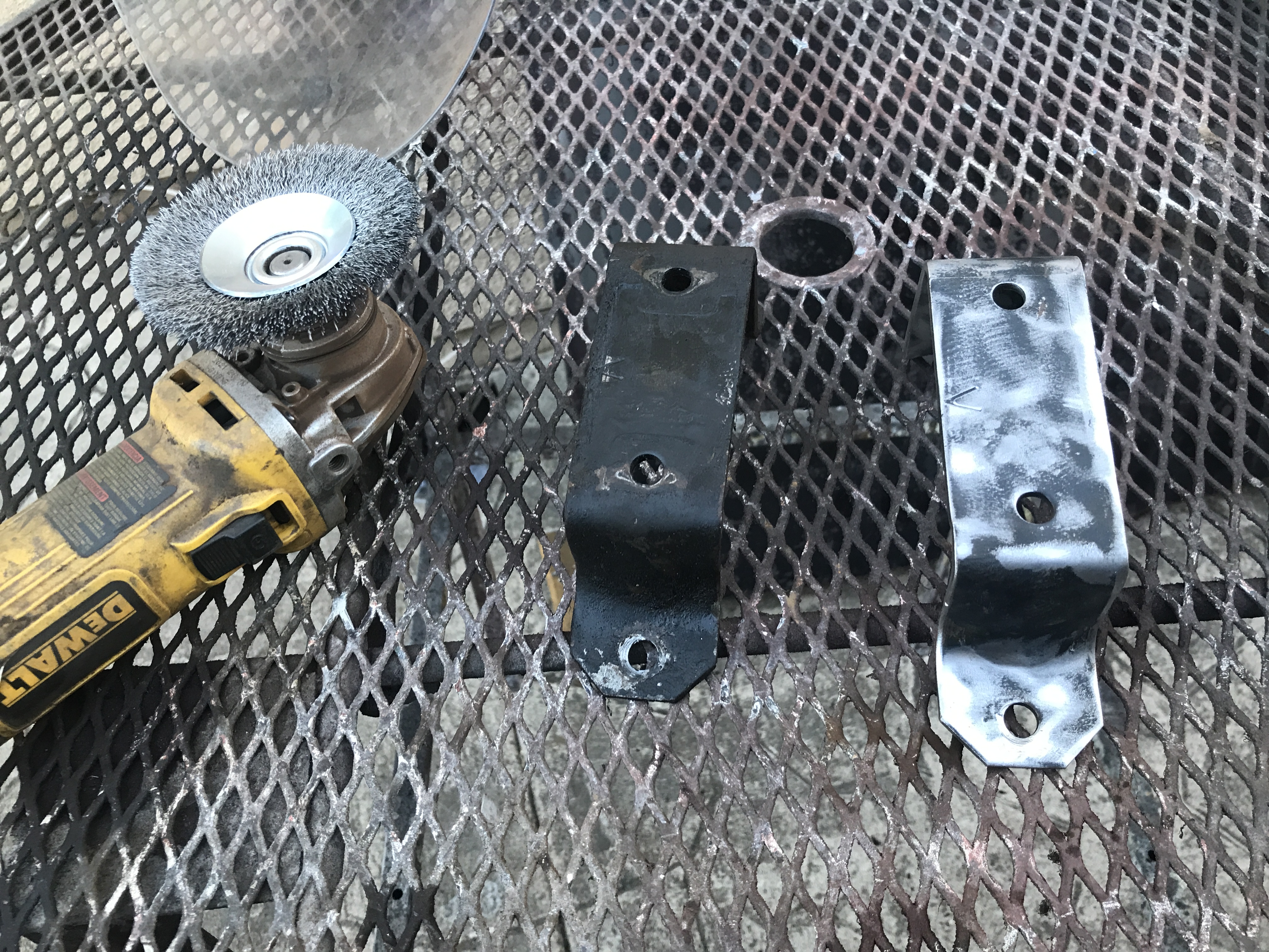

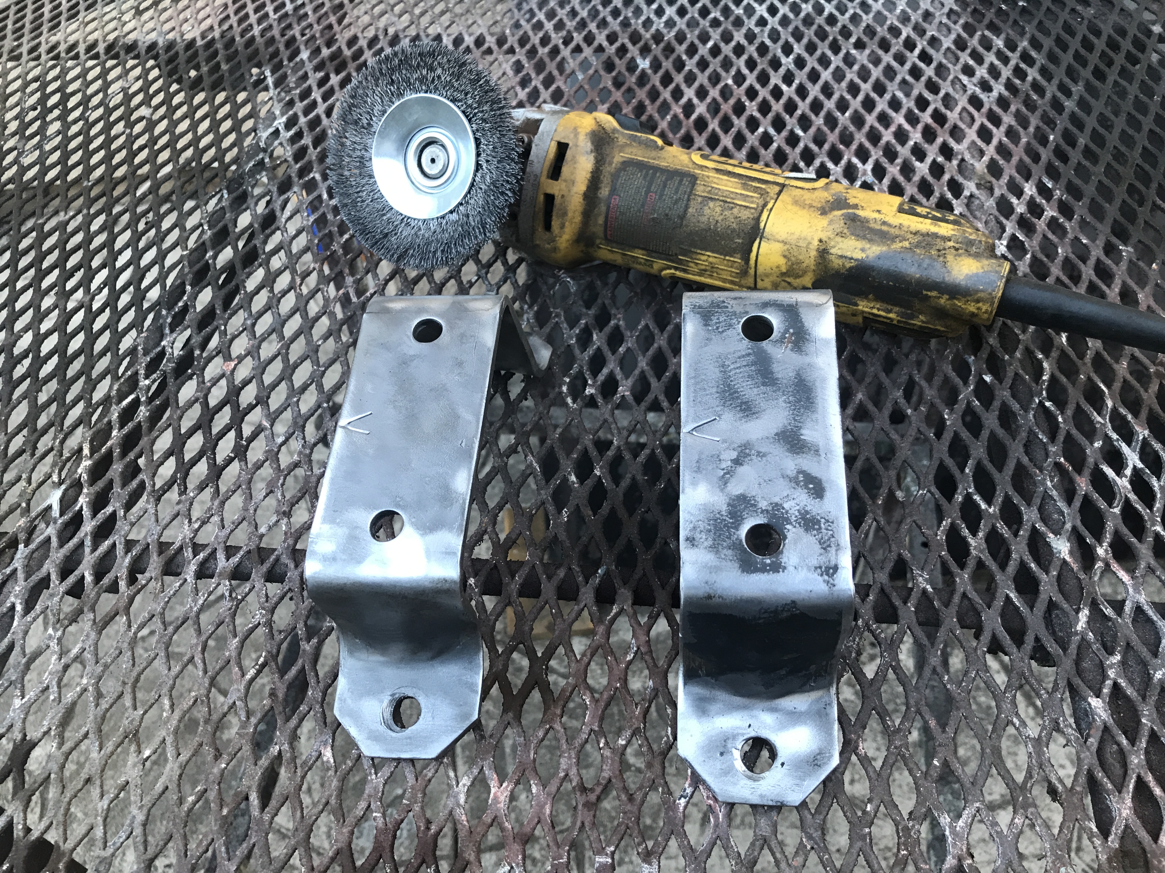

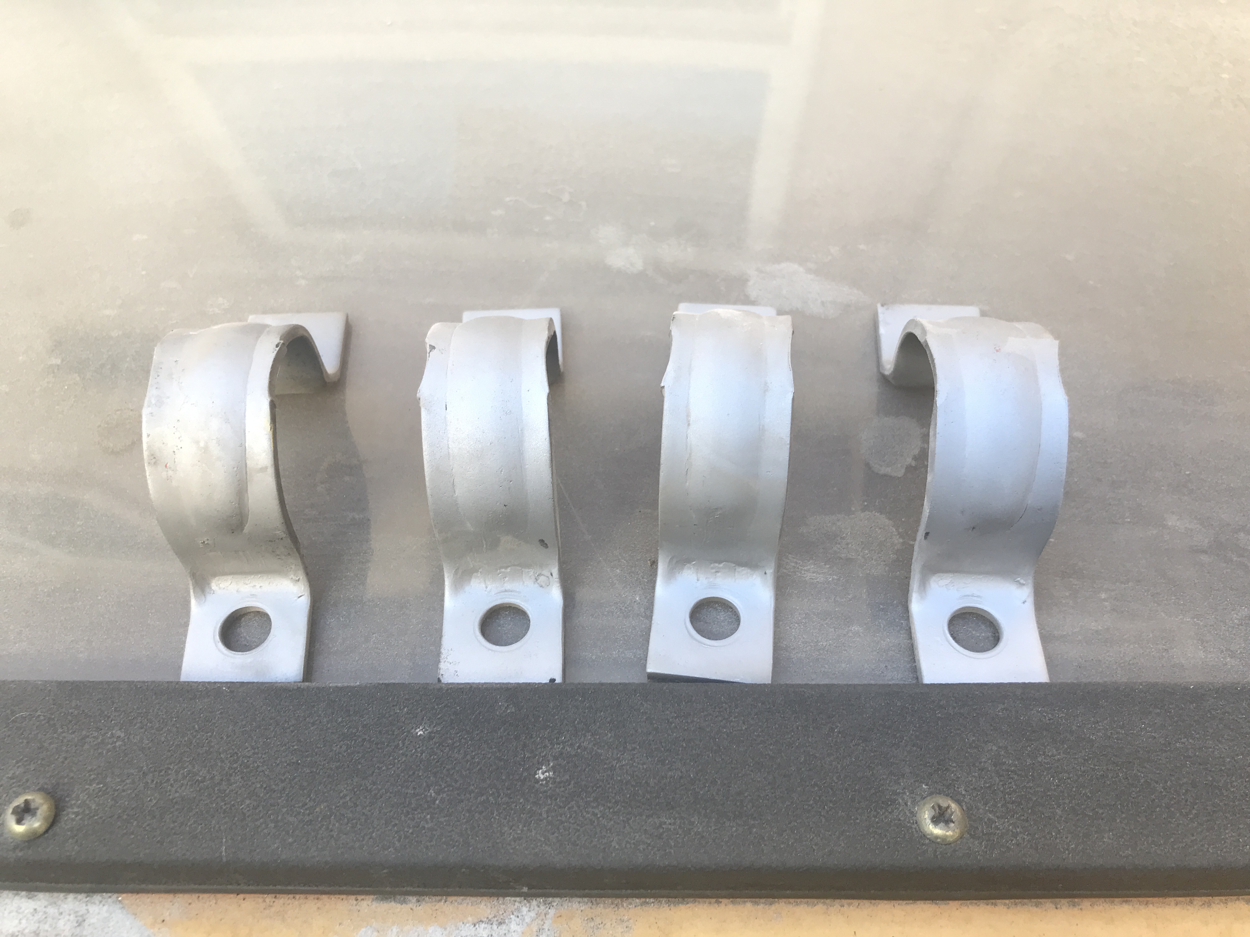

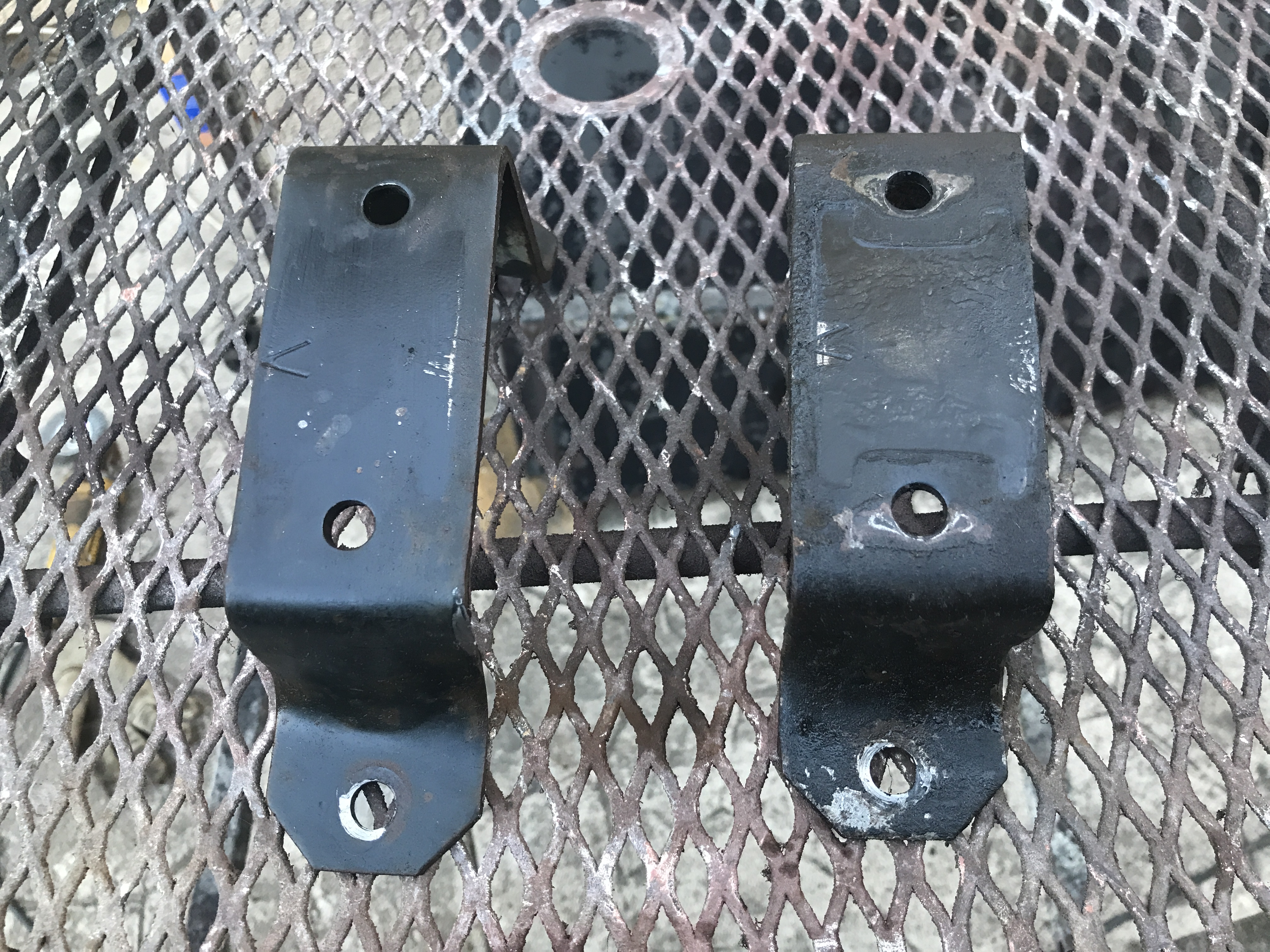

I swear it was the hottest day of the year that day and I was laying upside down on sharp gravel drilling out rivets to get the stabalizer bar support brackets off the frame, it was so bad I decided to get two of them
Gregski
Posts: 2743

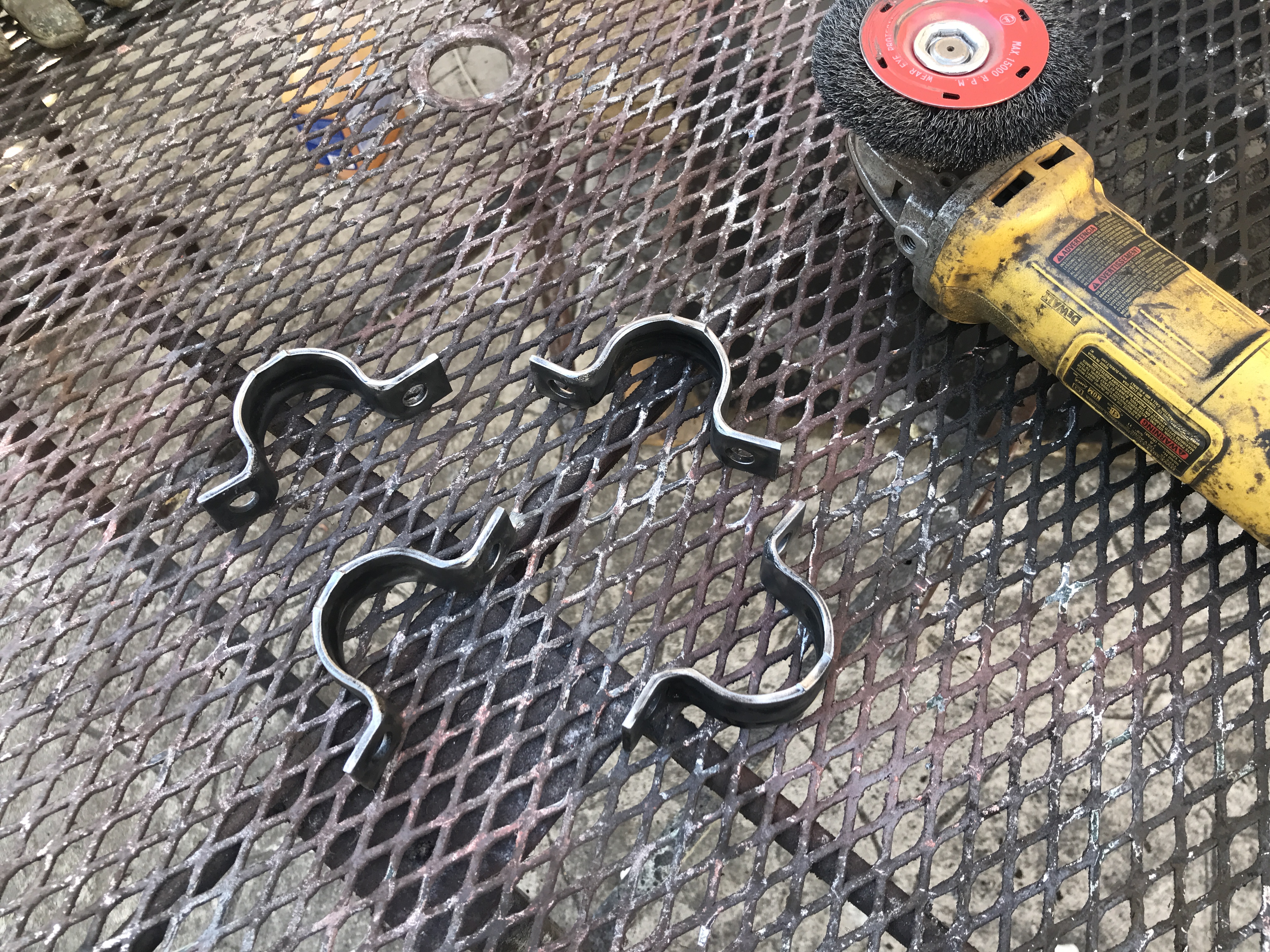

Post by Gregski »

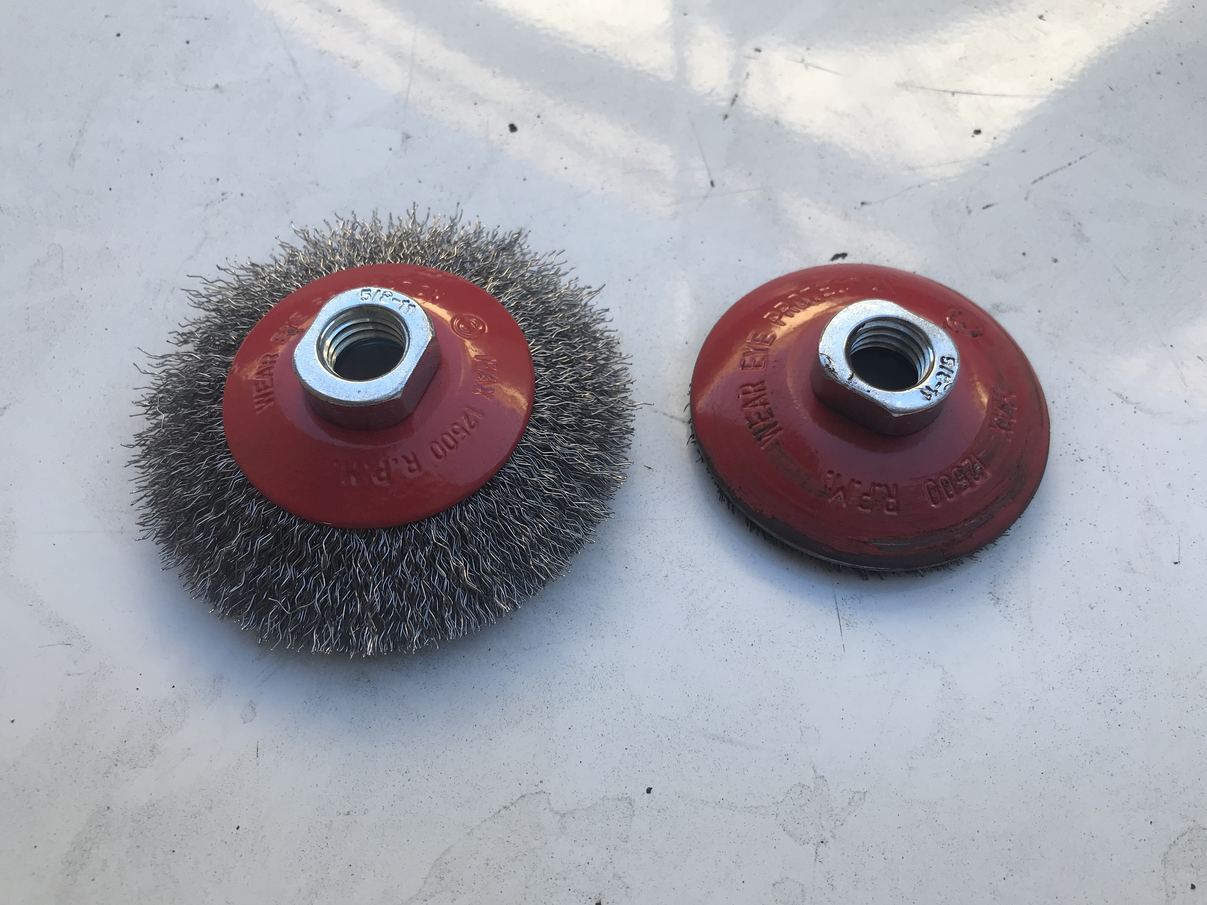

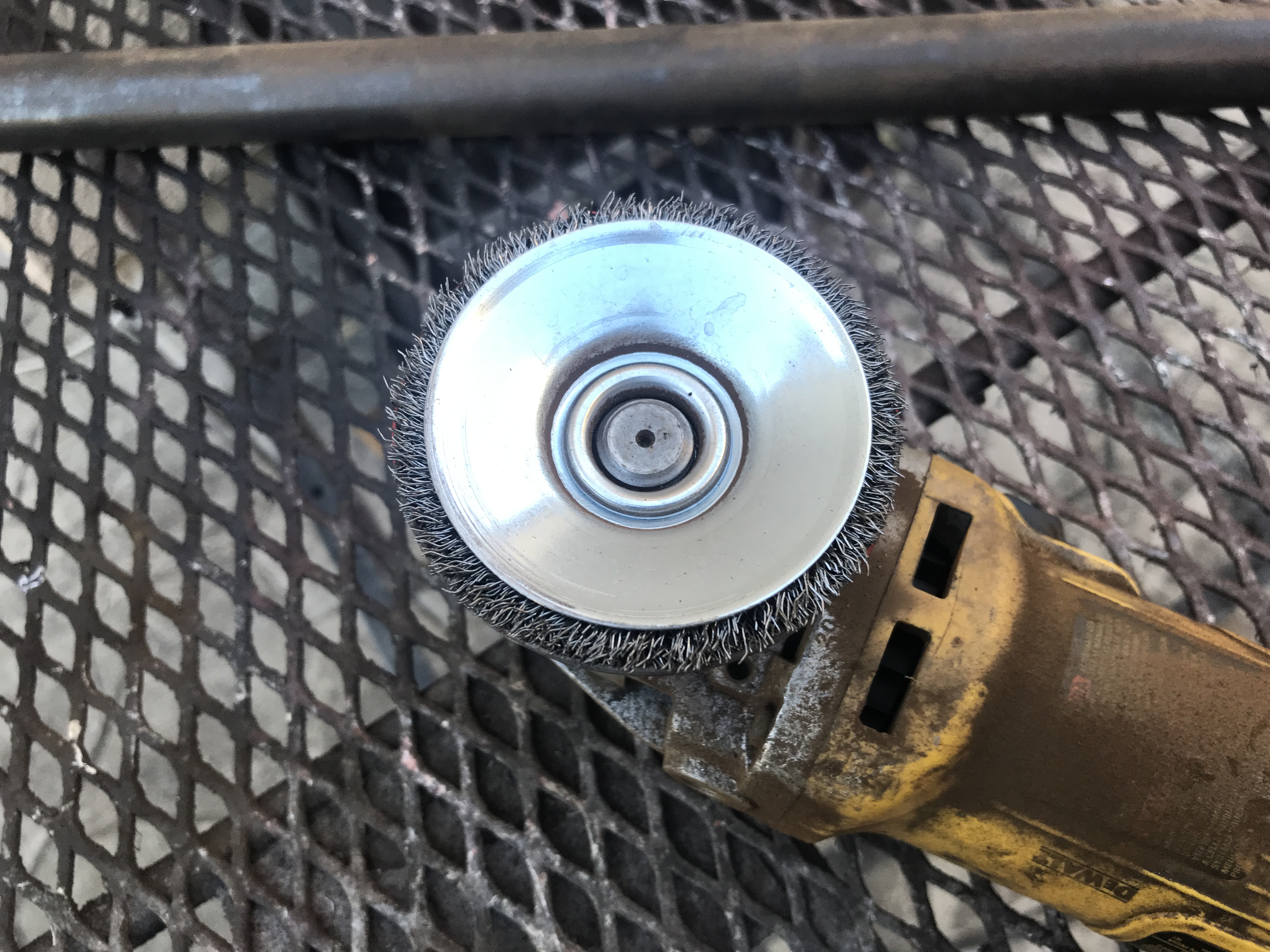

next thing I knew I was wire wheelin' like a Boss
Gregski
Posts: 2743
Post by Gregski »

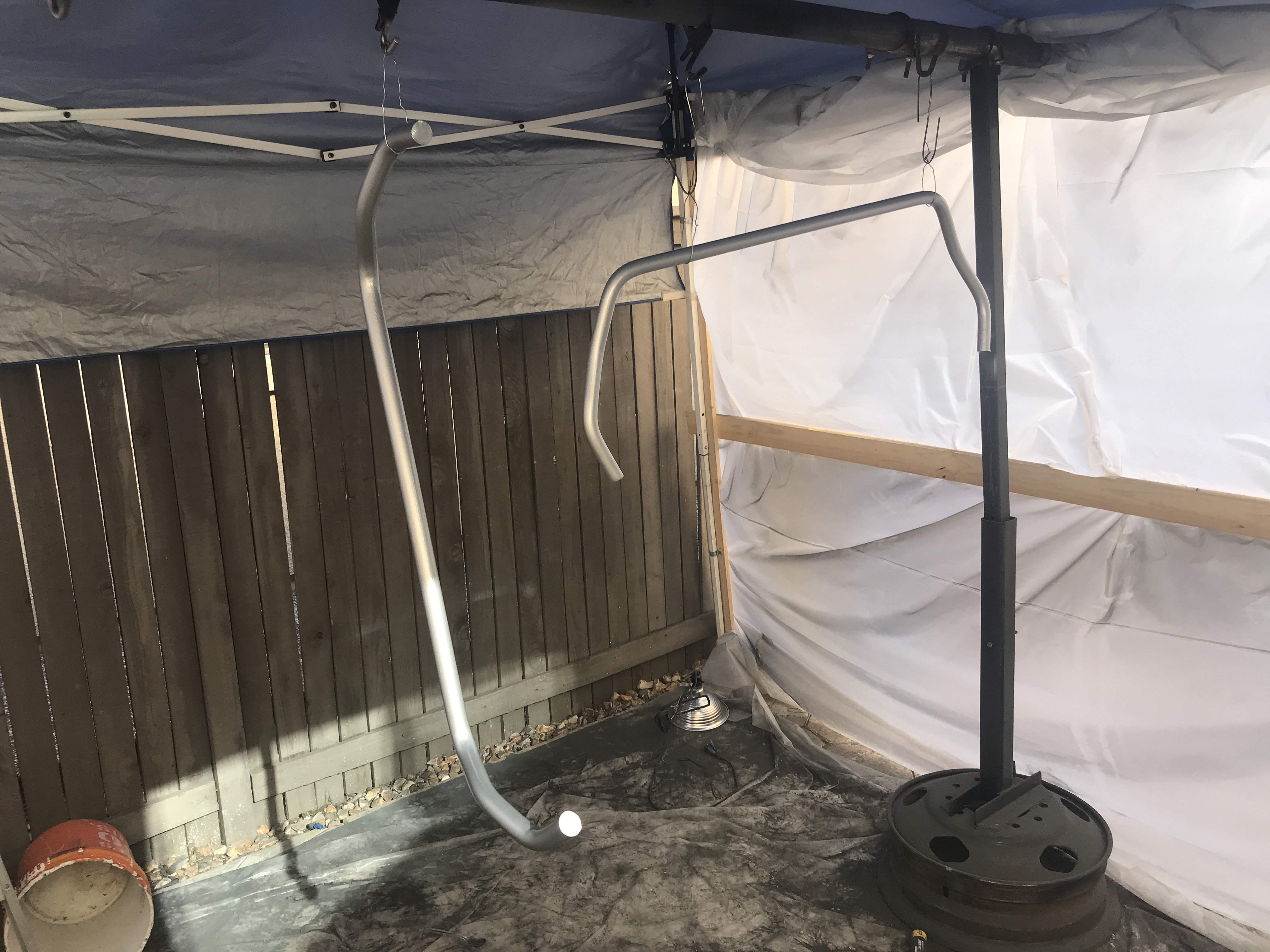

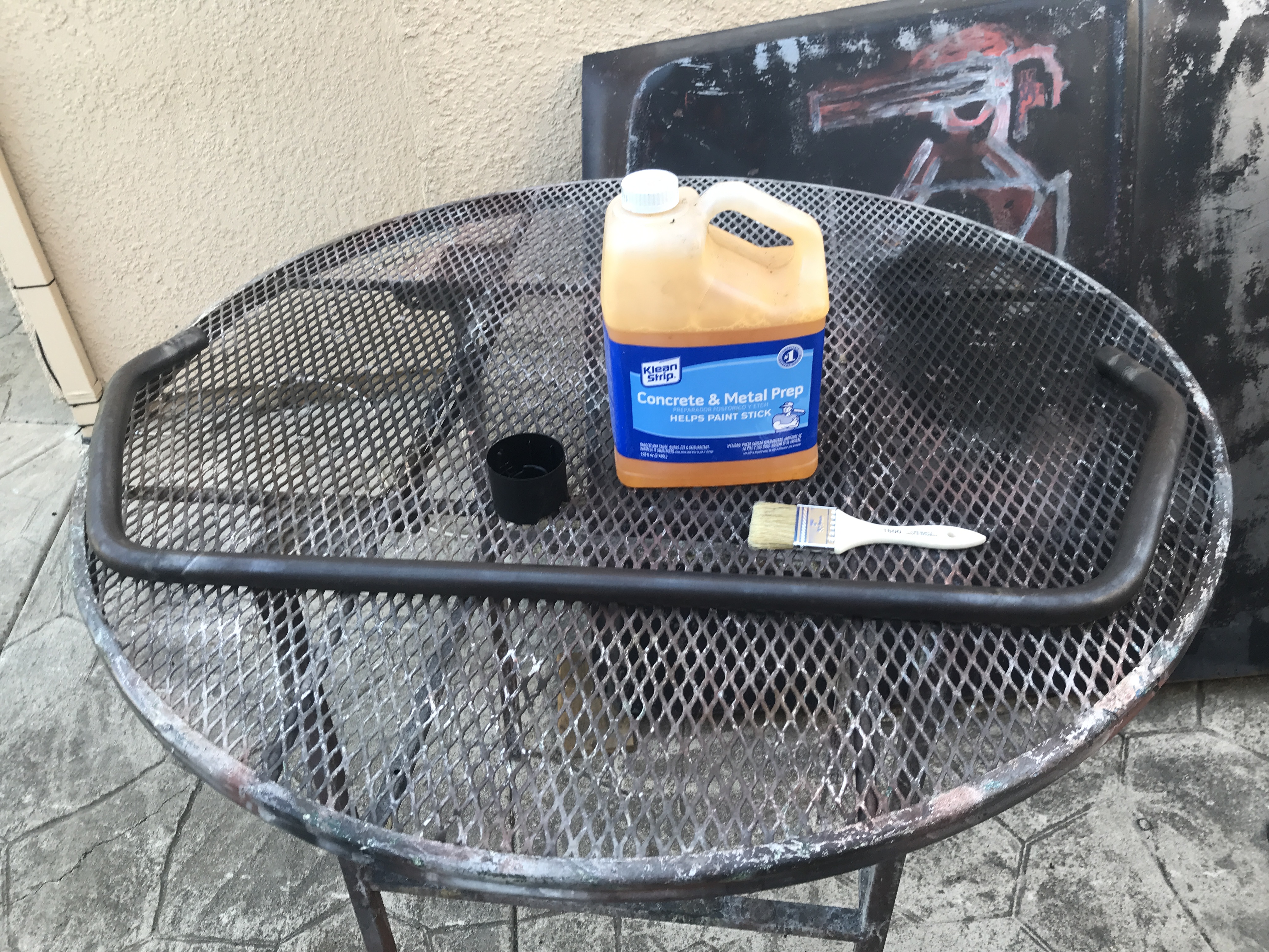

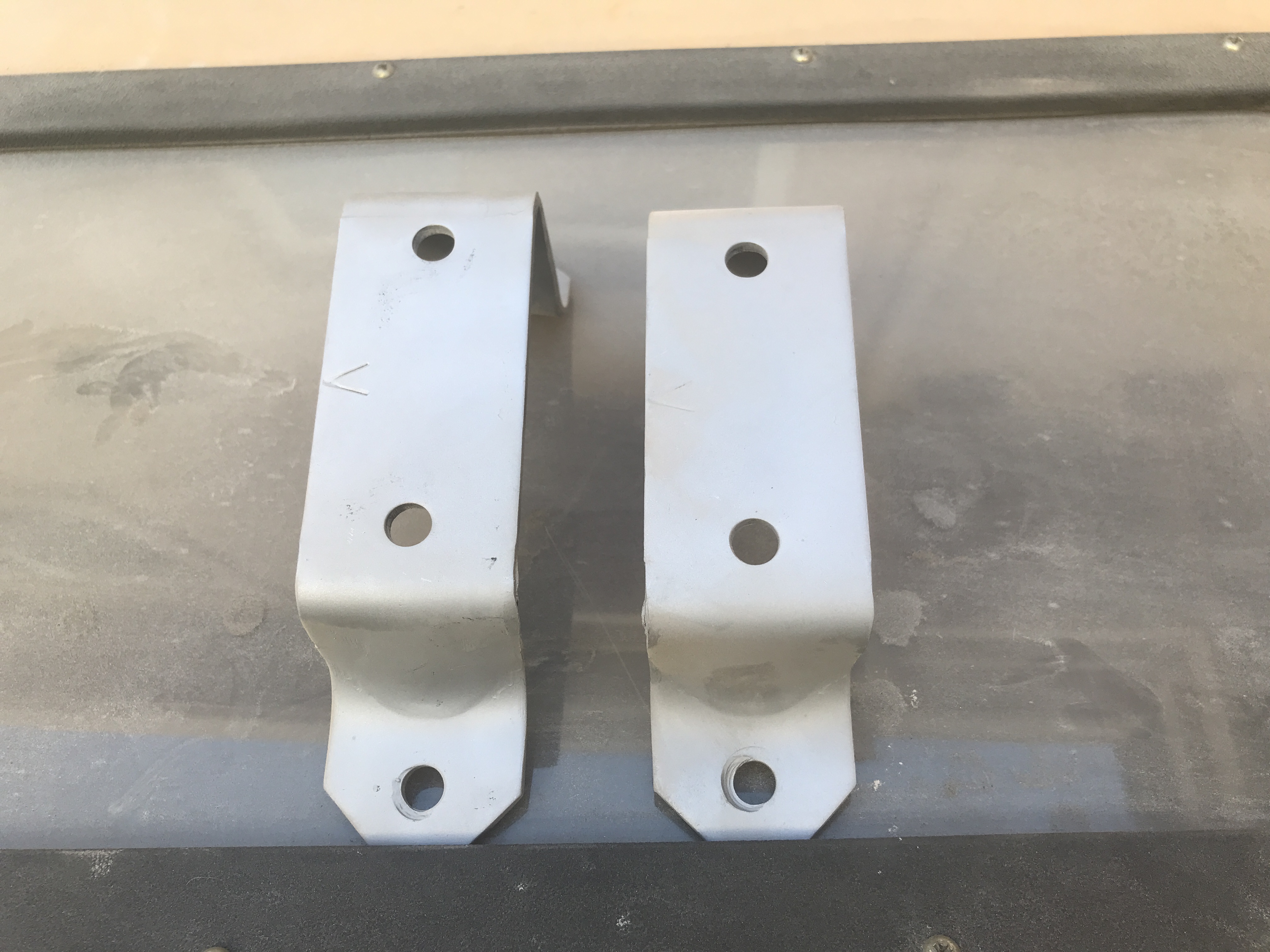

the Devil's in the details
Gregski
Posts: 2743
Post by Gregski »

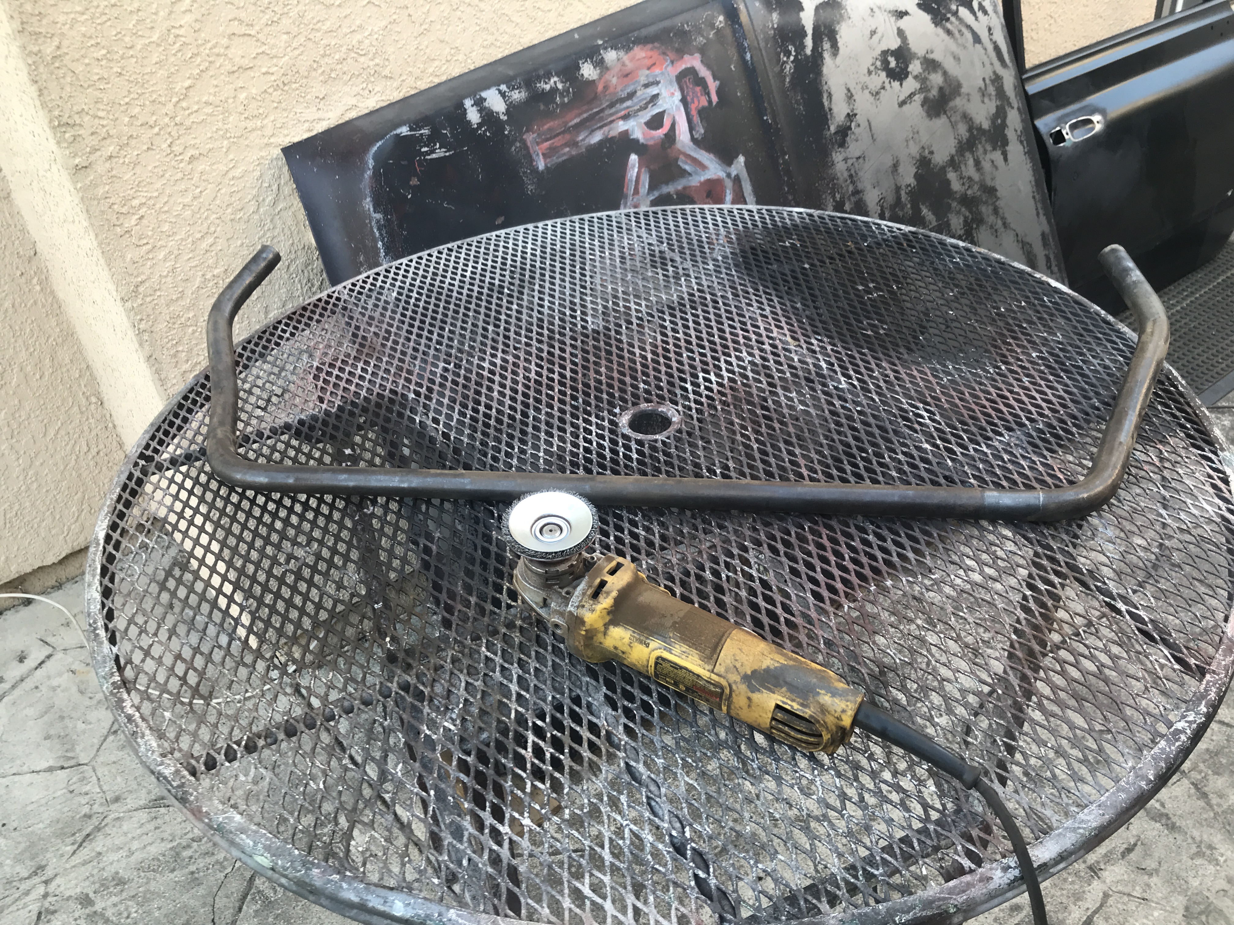

media blasted and ready for powder coating and paint

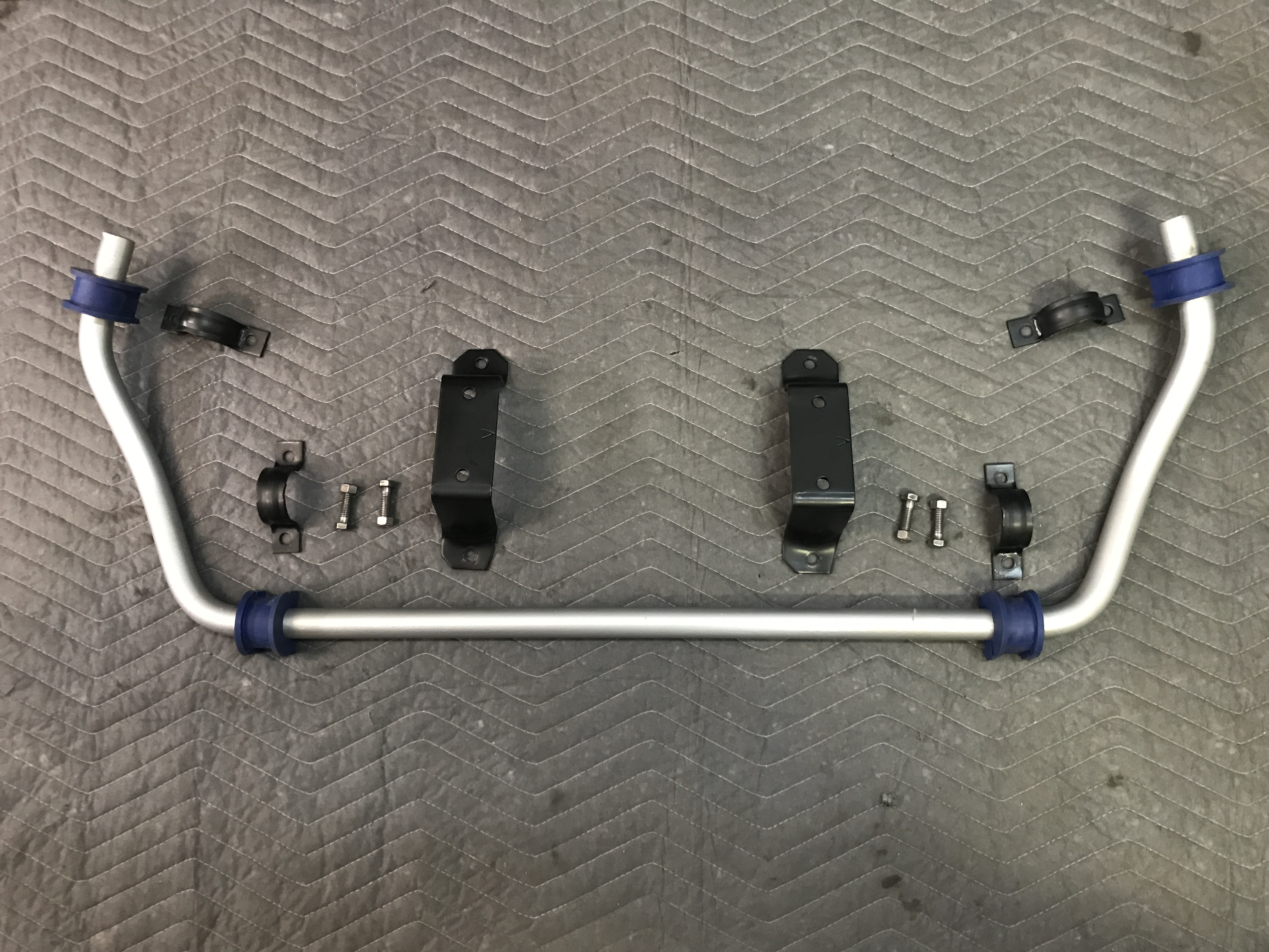

Post by Gregski »

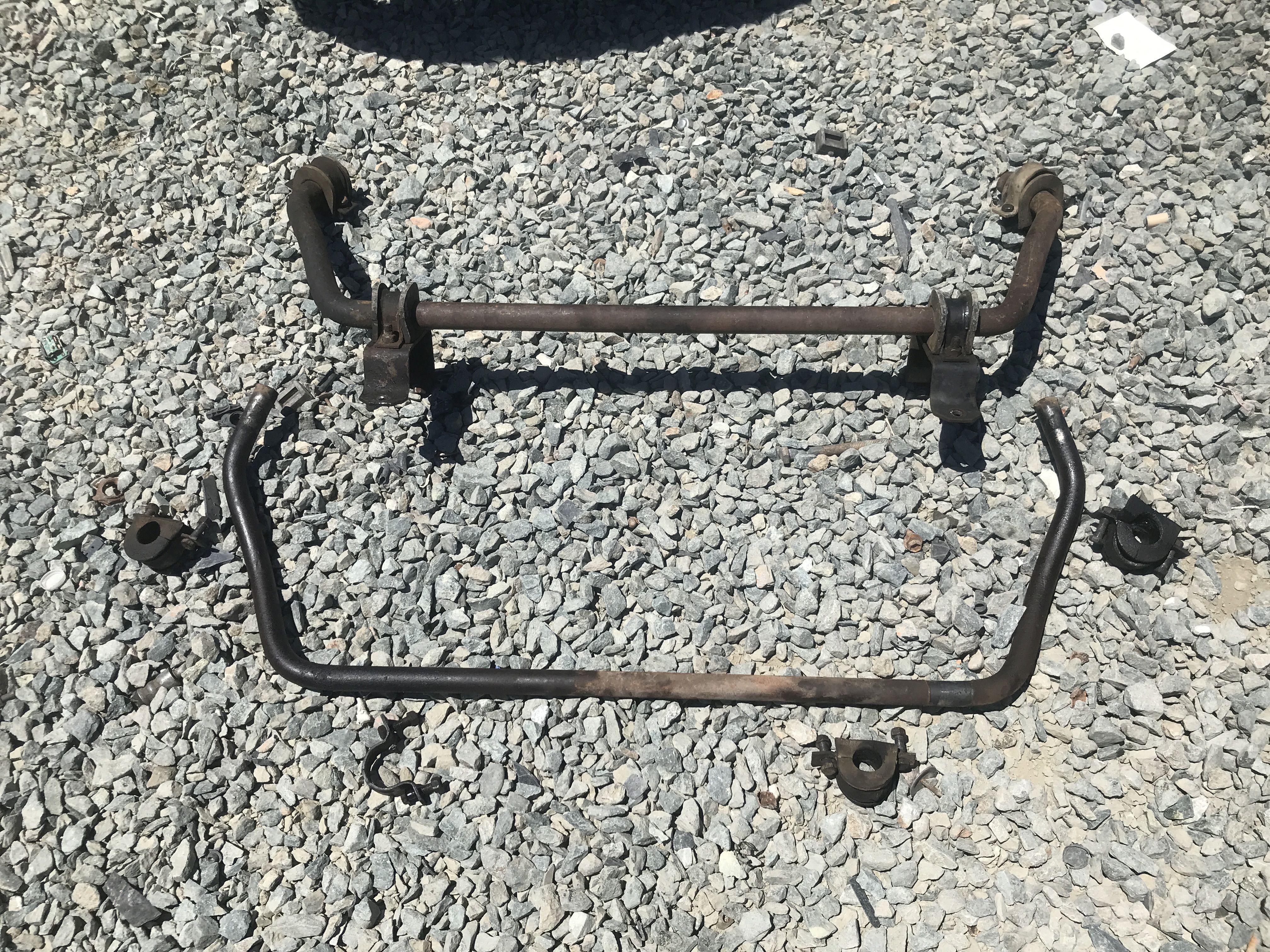

so yeah I was little bit concerned about the EV ending up lighter than the original, so I decided to add an anti swear bar

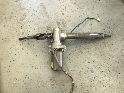

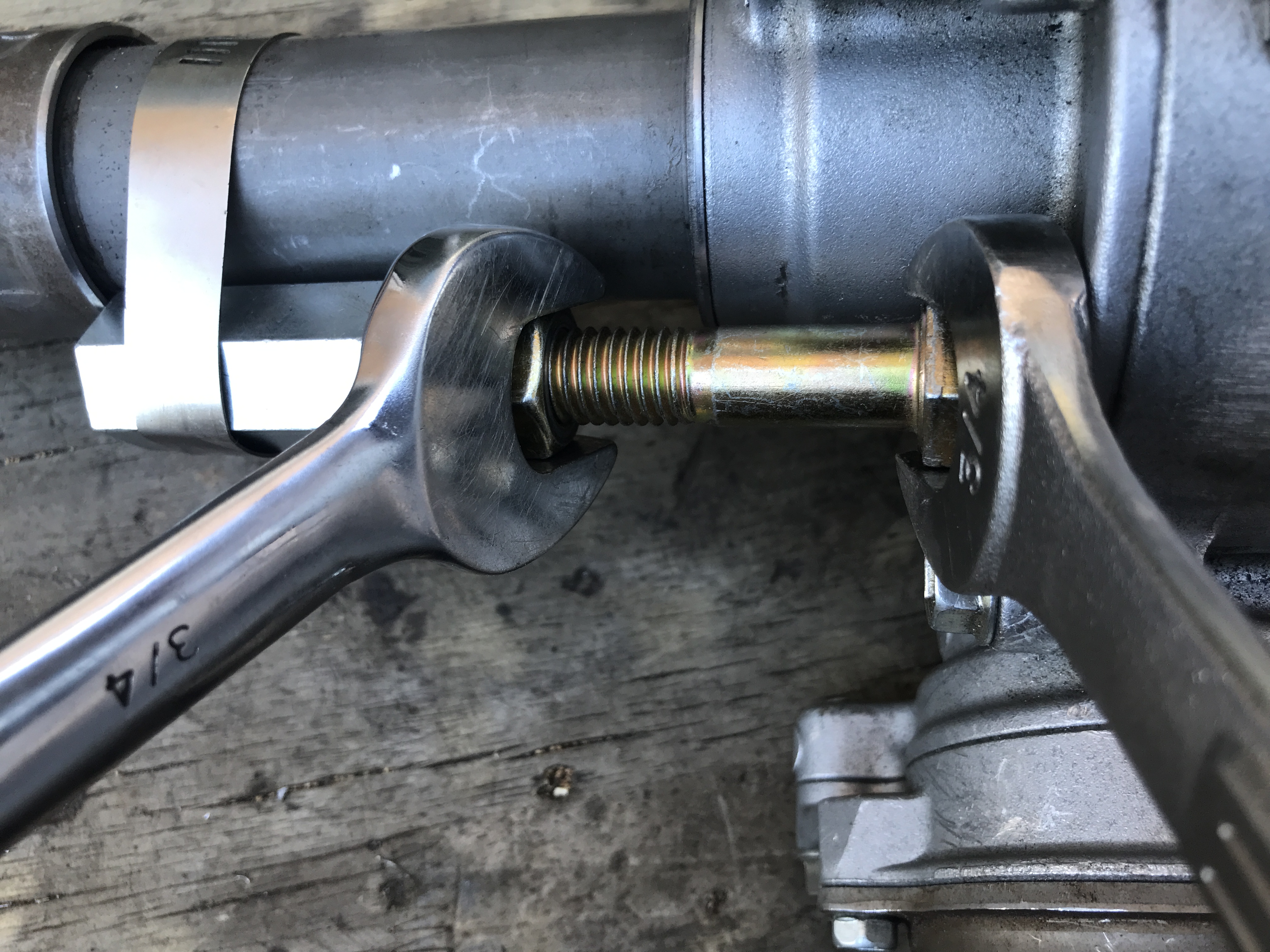

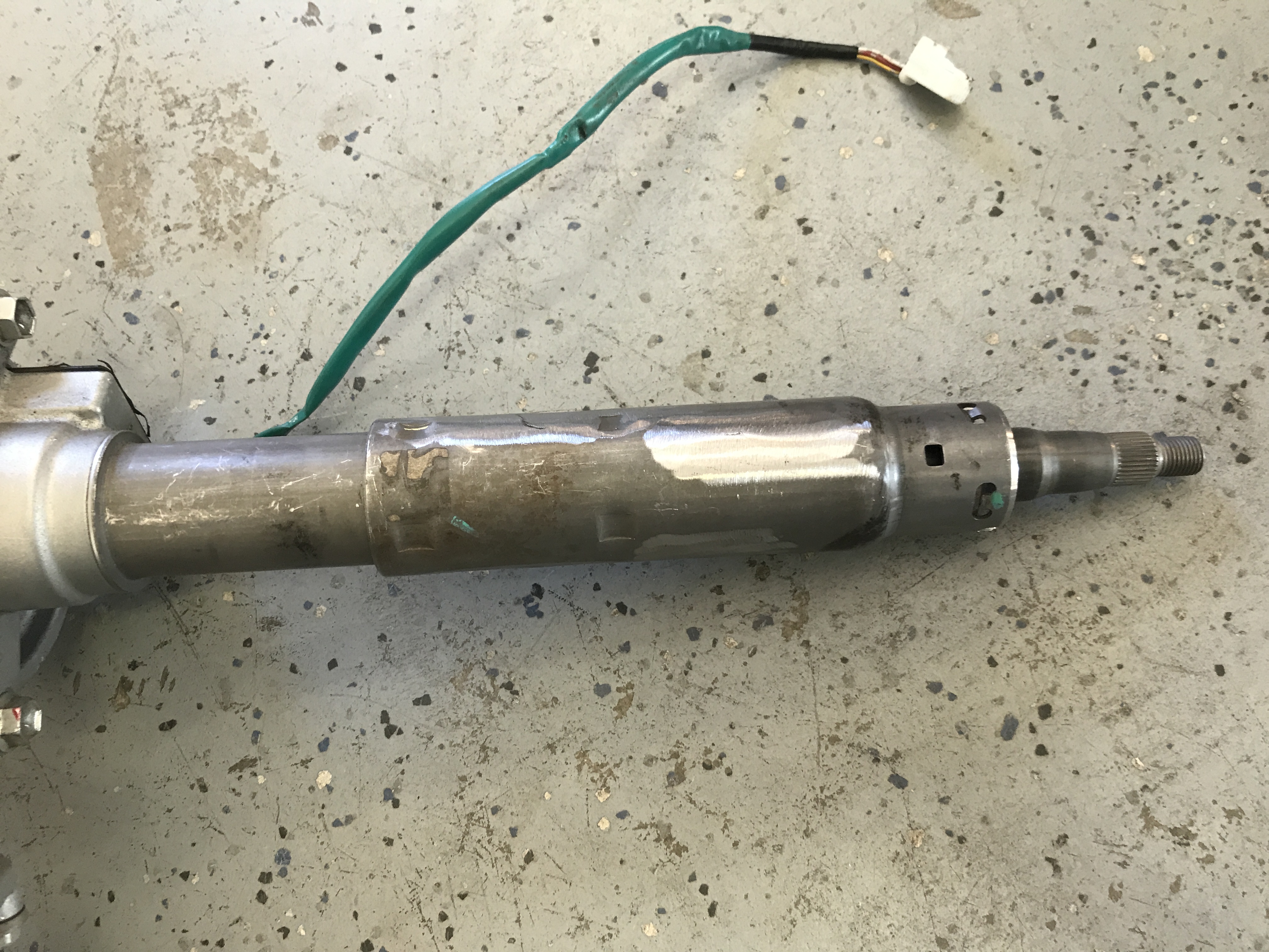

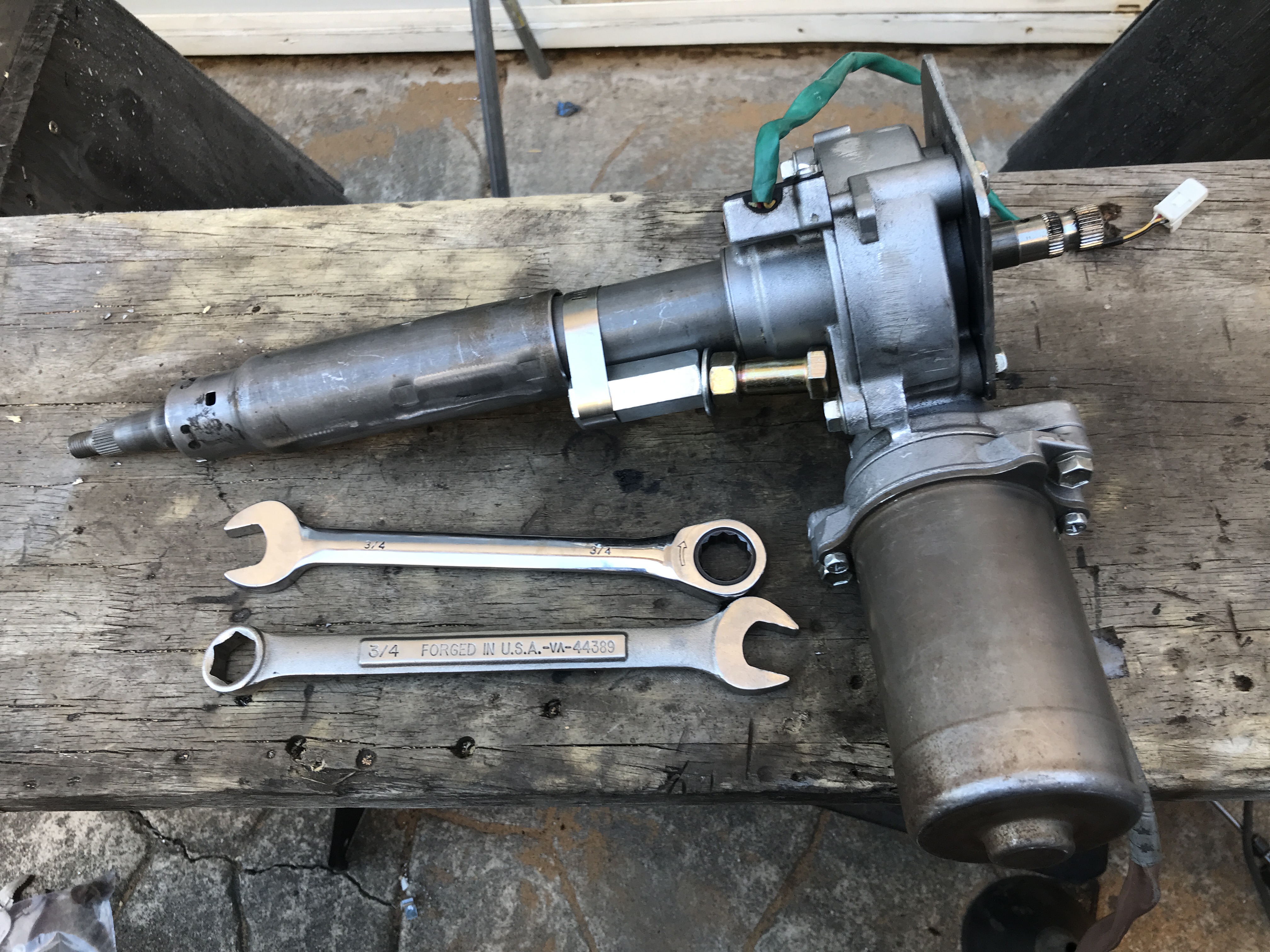

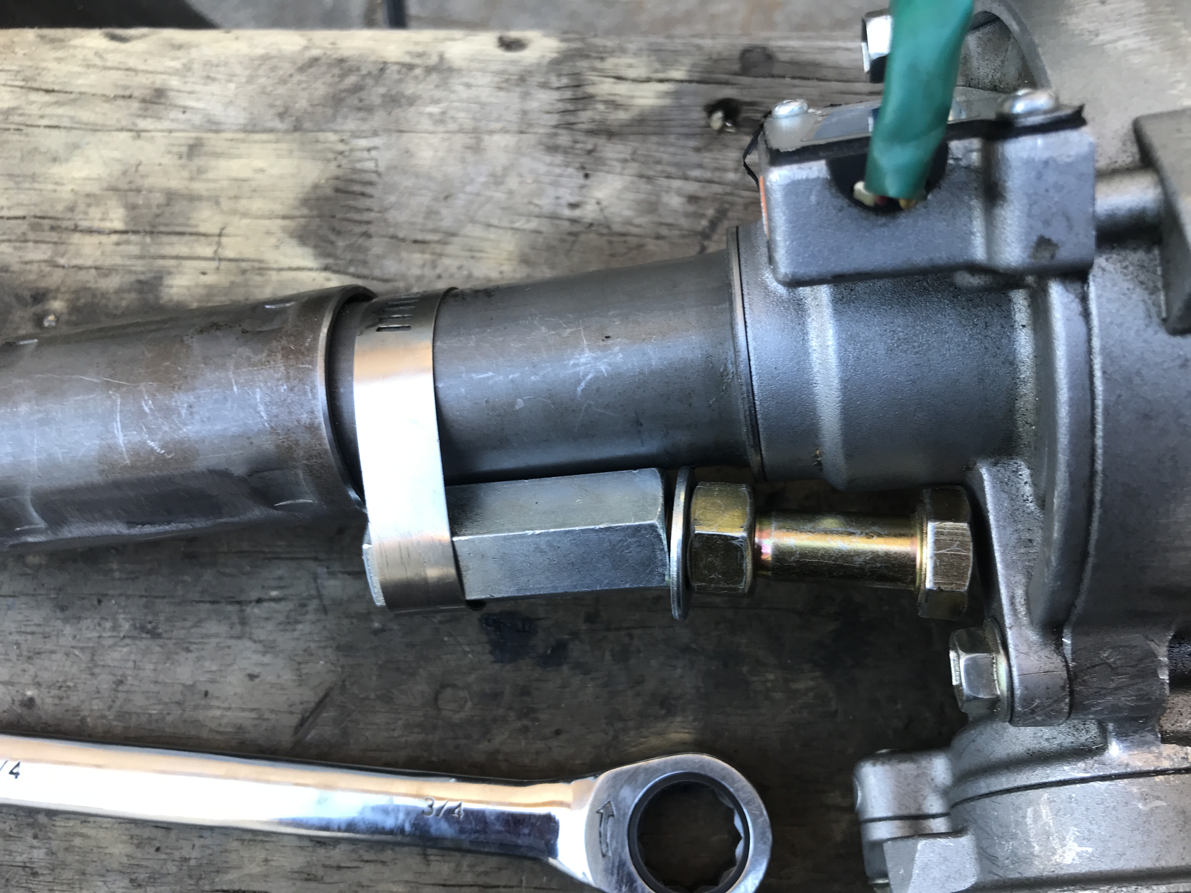

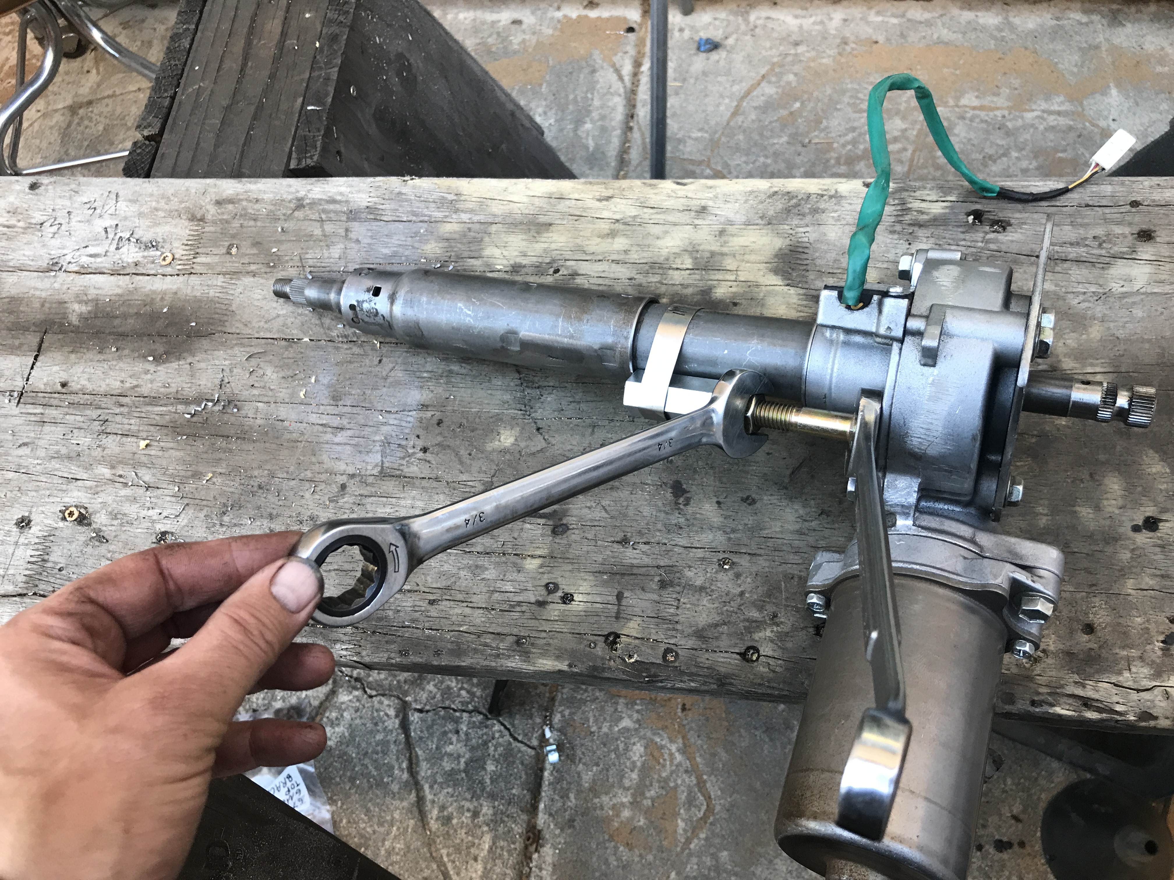

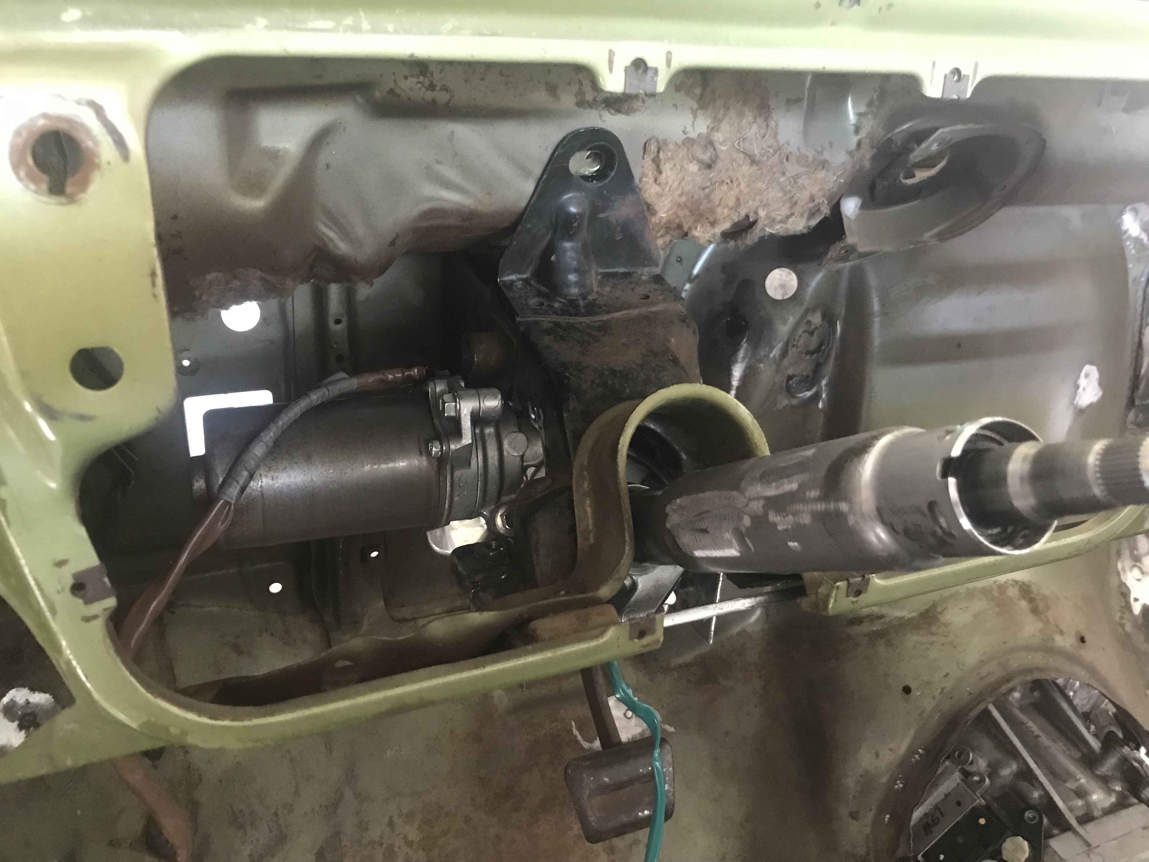

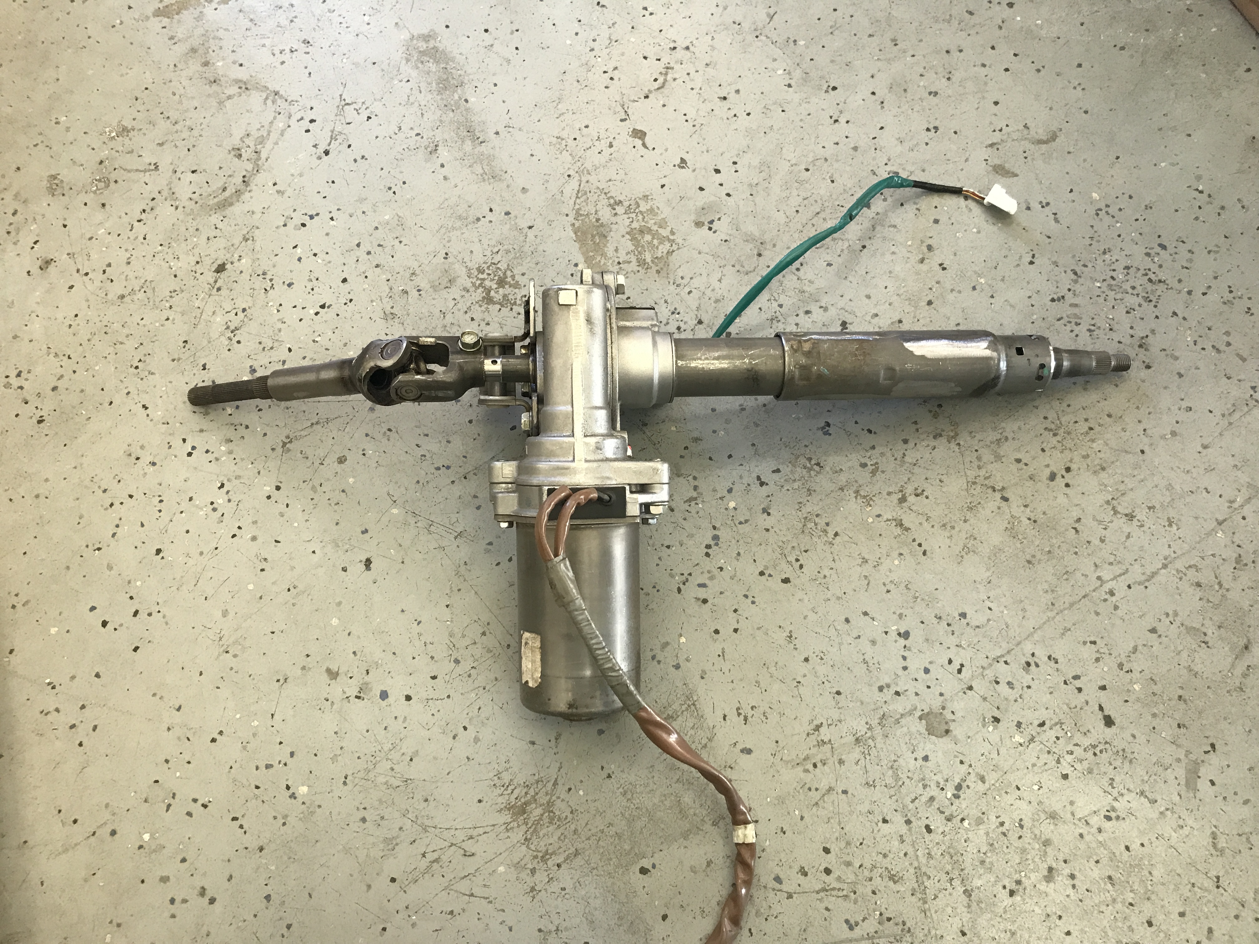

so motivated by Bill Bayer I decided to take another stab at the Prius power steering doo dad, I was not happy with it under the dash
Gregski
Posts: 2743
Post by Gregski »

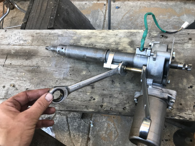

so here we go time for surgery
Gregski
Posts: 2743
Post by Gregski »
The Pull-A-Parter 3000
Sketch Level: EXPERT
