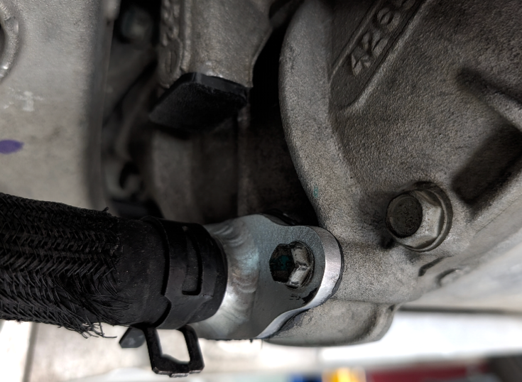

canadasconvert wrote: Sun Jun 02, 2024 7:50 pm I am leaning towards buying the REVOLT Coolant Delete product and eliminating the problem altogether.
Unless you need a bolt-on solution and don't mind the cost, the DIY coolant manifold modification is under $50 (coming soon) and maybe a couple of hours work with tools no more complex than a hacksaw and Dremel.
I had my coolant manifold plug machined by a local hobbiest for USD$80 and the slug of alum. 6061 was under $20. The SS formed cup that should be available later this month will be half that cost. I'm not involved in that, but I have queried the person who had a prototype batch made and has a "production run" of them arriving soon. I will post purchasing info when it becomes available.
The QCC manifold is USD$770 (with tax). Revolt's is ~$550 (but eliminates the flyover tube coolant path). Both are beautiful CNC and anodized. But if you don't need pretty . . .

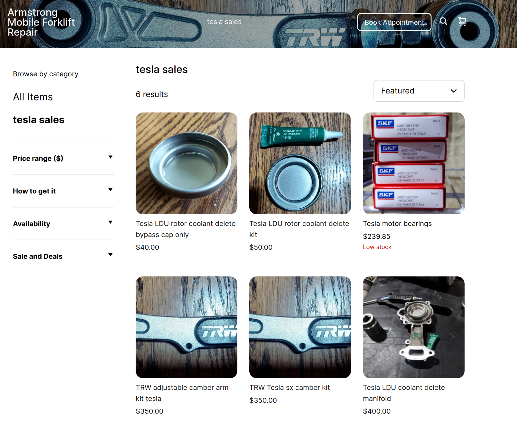

Post by asavage »
Paul is selling the SS formed caps + Loctite for $50. IDK if he has them "in stock", but they're on his sales page:
https://armstrong-mobile-forklift-repair.square.site/shop/tesla-sales/OFZJ2ZCVNNQRWQANTM2DMIU6
Do use the Loctite ("green" for sleeve or bearing mounting) and not "red" or "blue" (for thread locking). I used Loctite 640 on mine.

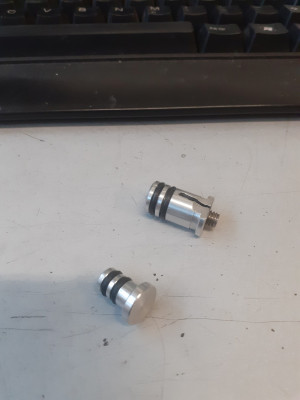

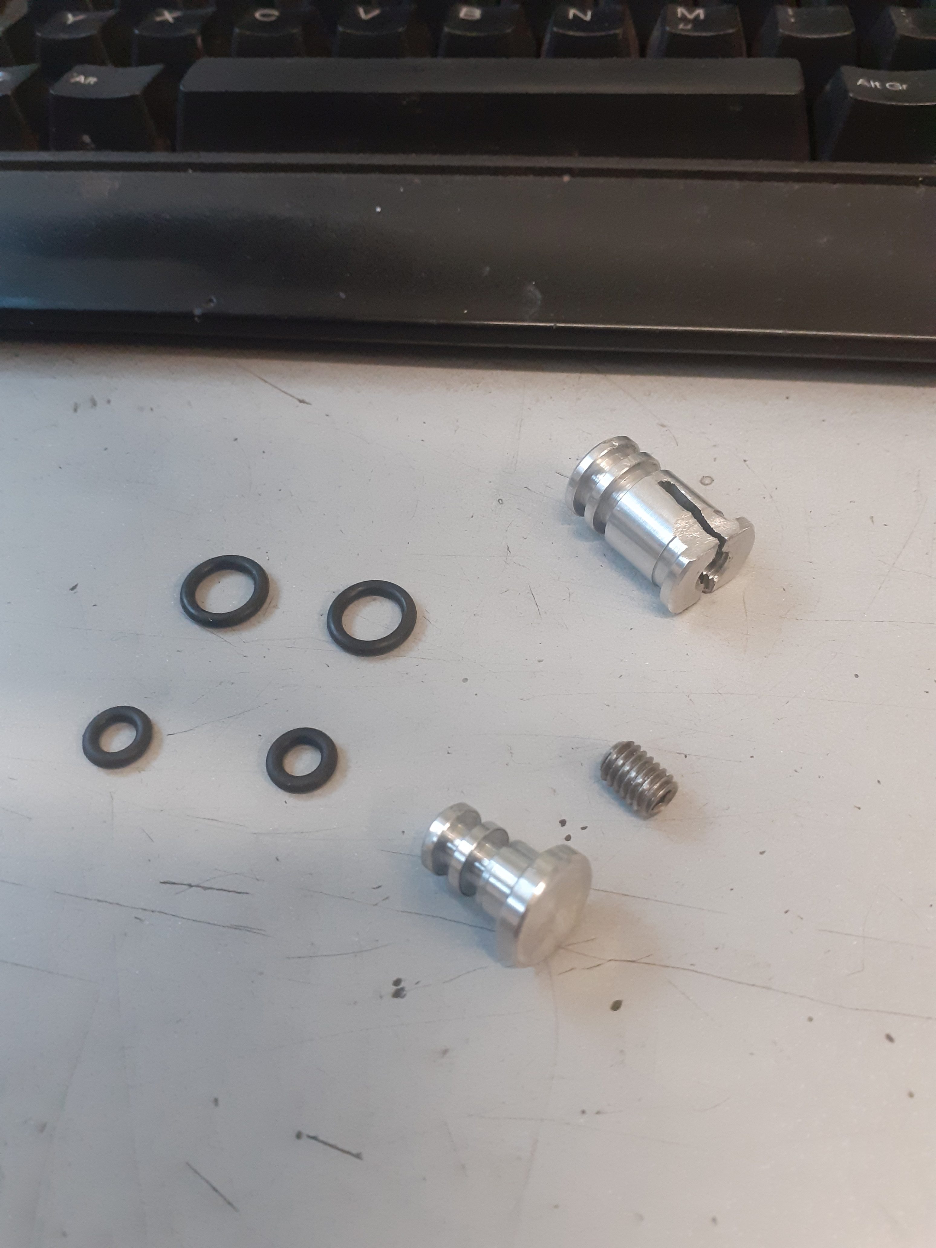

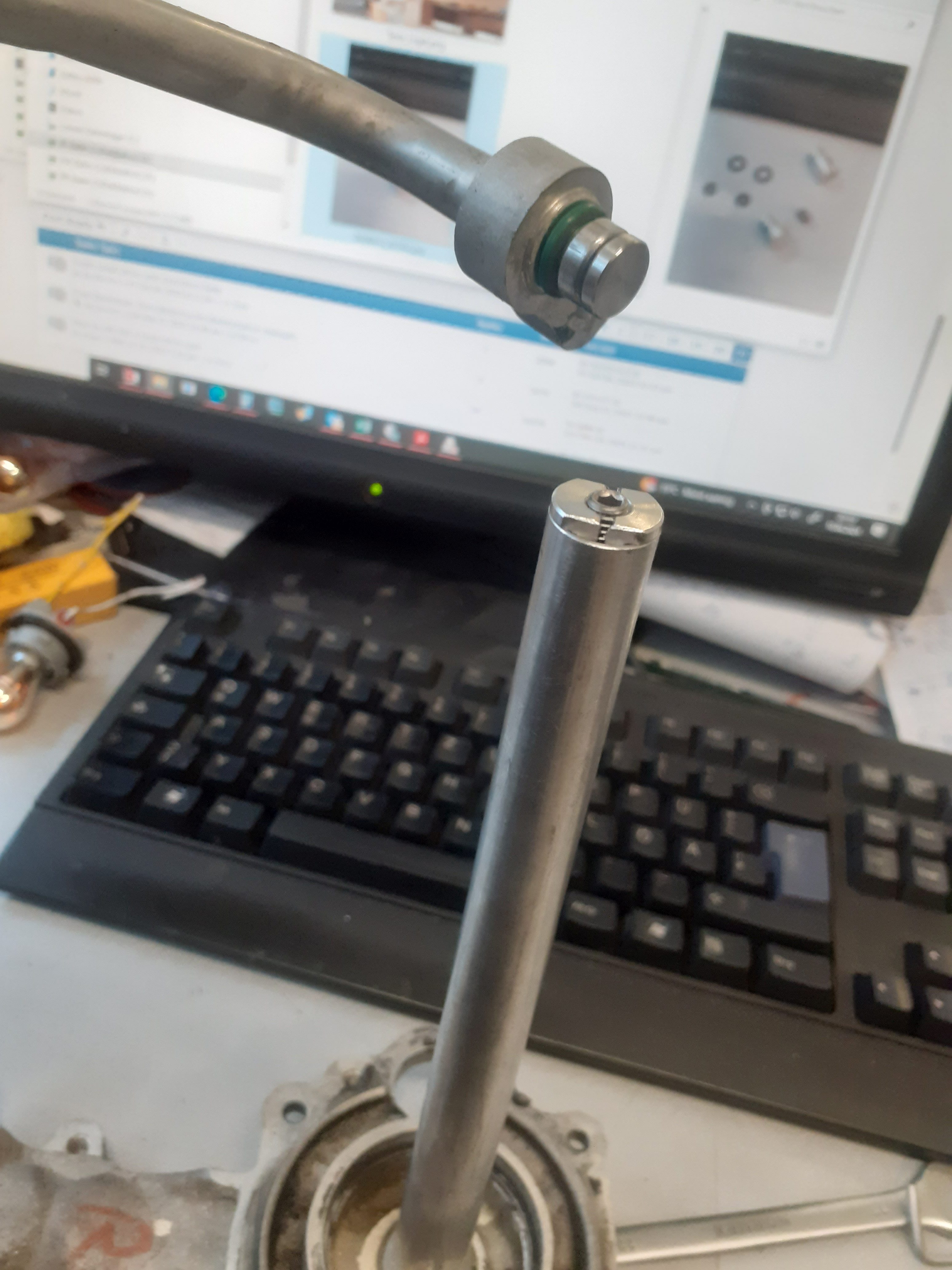

What do you think of two plugs, one at the end of the pipe, the other in the screwed-on line? The one in the pipe is held in place by spreading, but can of course also be pinned, in which case a hole must be drilled. It took less than an hour to make.

Post by asavage »
Nice idea! Not in your USD$50 budget (unless you have a lathe already, and most people do not).
If I own a CNC mill, then a bespoke coolant manifold is "simple and cheap", but for the typical person this is not the situation.
If I own a lathe, etc.

I have inquired a few online fabricators in aluminum / CNC and nylon12 / 3D printing. A price under 50$ is not unrealistic even for 1 set. JLC now also makes 3D parts, not just pcb boards. https://jlc3dp.com/
muehlpower
Posts: 690
Has thanked: 14 times
Been thanked: 141 times
Post by muehlpower »
At jlc3dp the price for a set in nylon is 2€! However, without spreading, but with drilling. For the O-ring set with 800 parts, from which I took the 4 O-rings, I paid 10€ at ebay. I don't think it could be cheaper.
I'm not going to remove my cooling system. Has anyone tested my sealing rings? My car is not running yet, so I have no experience. I haven't heard anything from the people I sent one to.
