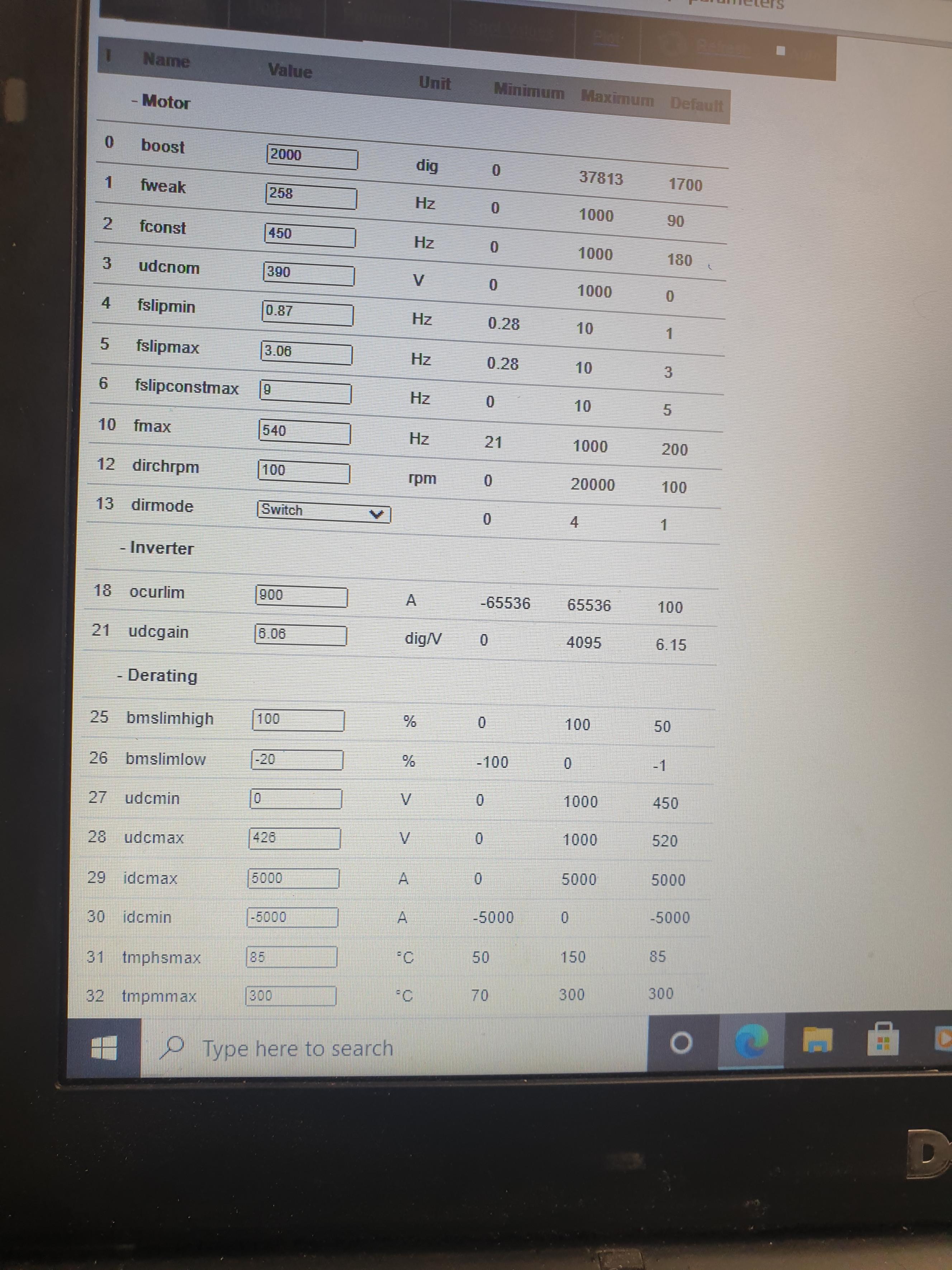

Good Morning guys,
Hoping you can help me out here.
Im very new to Tesla motors and Evs in general, Ive got my first Tesla LDU and have set it up on the bench in an attempt to test it.
Im getting a very slow 'Jogging' motion when applying throttle - Much like alot of people have described when signal wires need to be inverted from the encoder - However i have tried this with no joy.
(shielding is connected to pin 18 etc so interference shouldn't be an issue either)
Is there a way of testing the encoder without and oscilloscope? - I've Tried, connecting the 5v feed and ground to the encoder and spinning the motor by hand to see if i get a fluctuation of voltage from the signal pins, however it stays at 4.5 V consistently - Could my encoder be faulty or is this not a sufficient way of testing?
Regards and thanks in advance.

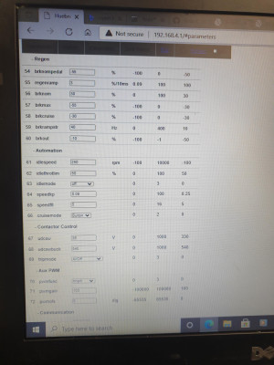

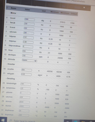

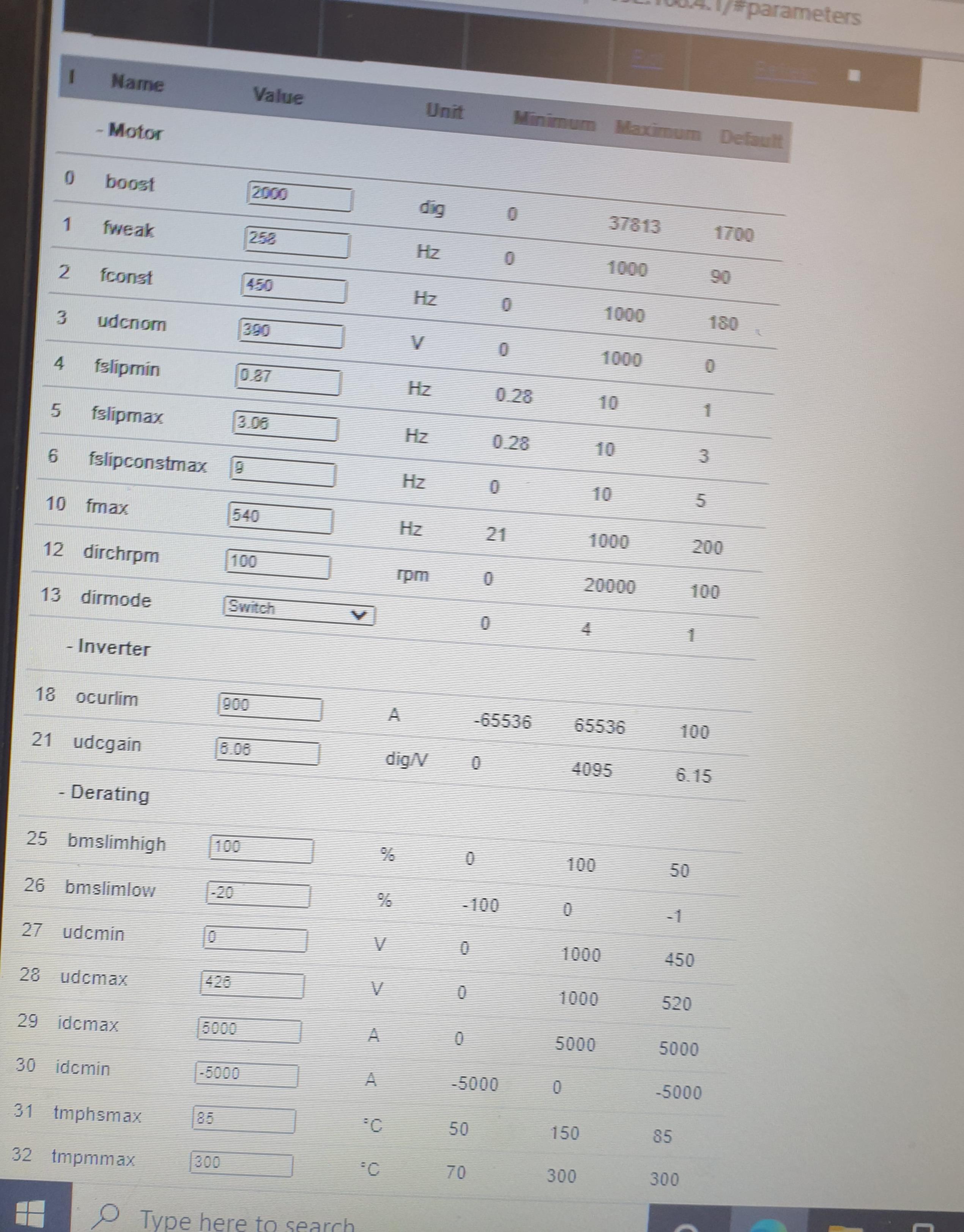

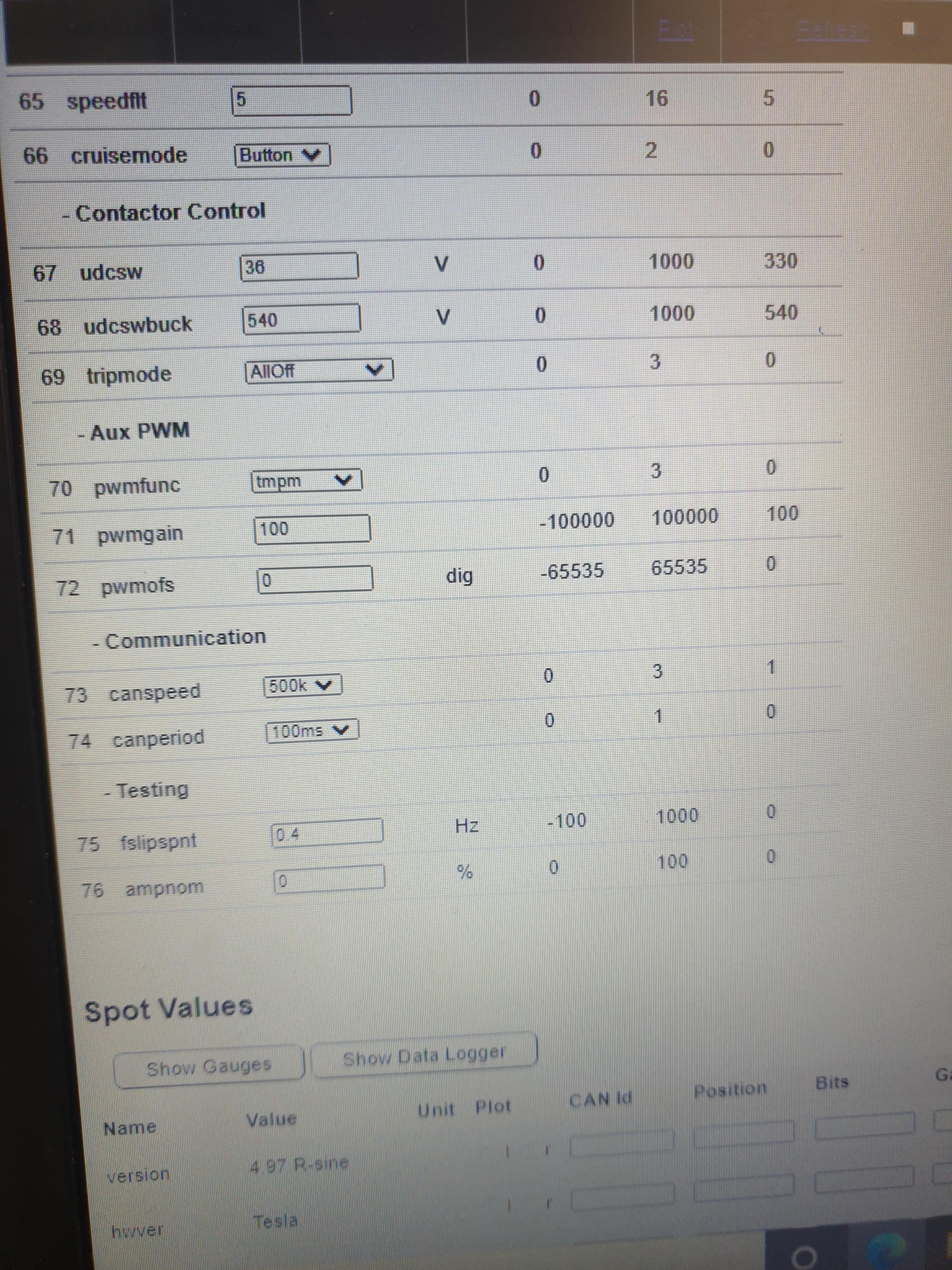

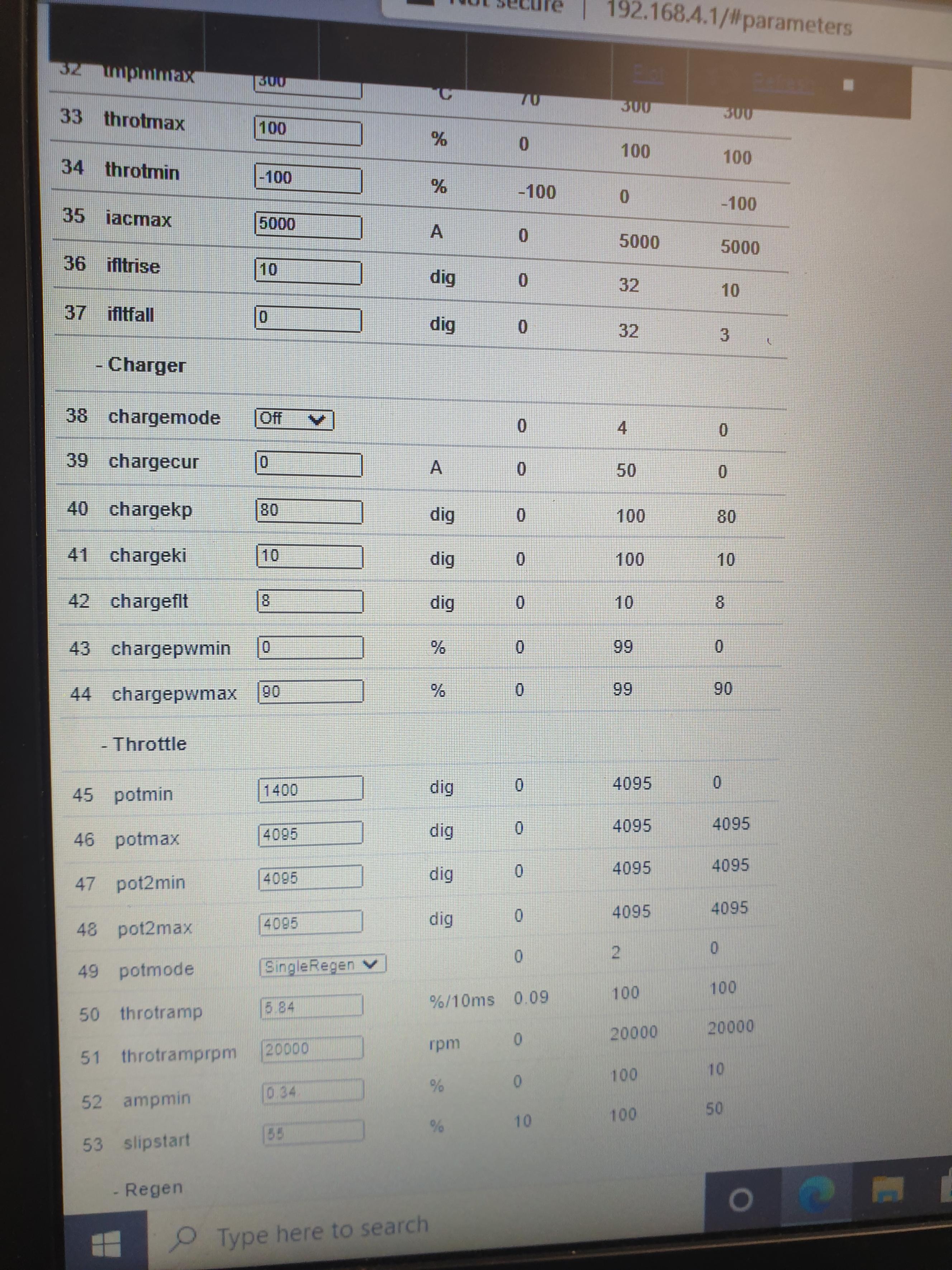

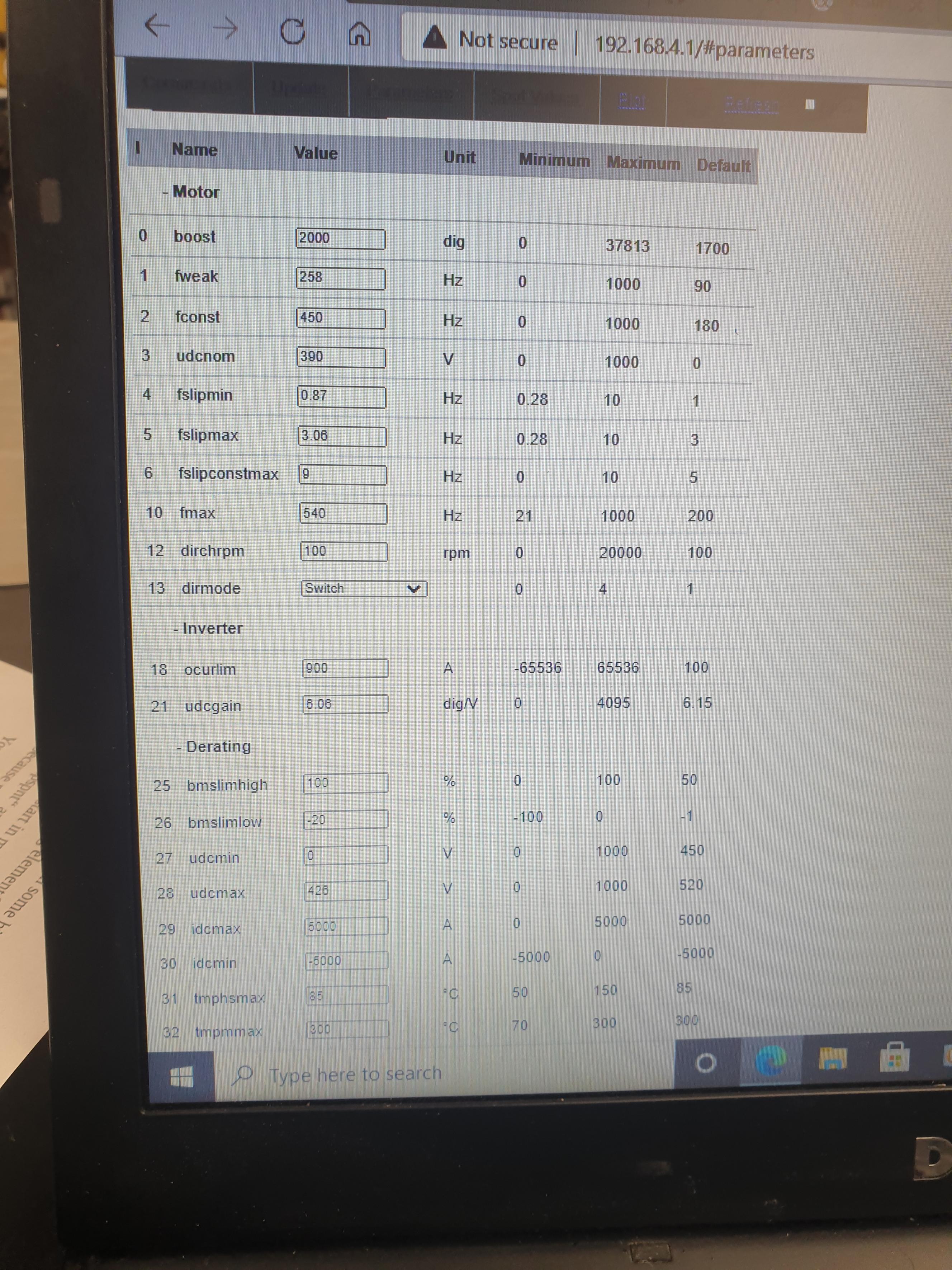

Post your software parametersEvSteeve wrote: ↑Tue Sep 07, 2021 10:15 am Good Morning guys,
Regards and thanks in advance.![]()
Hi John,
Thanks for the response.
Here are my parameters!
Thanks again.
Ps - cannot get inverter to run in manual mode? Will only 'Run'
Thanks again.

Did you start with a known parameter example such as Jon's? If not, start by comparing your parameters to a known set, and see if any are significantly different.

Sounds simple but have you calibrated the throttle pedal? Potmin looks quite high.
Try setting udcnom to 0.
Also, same about potmin mentioned above.
Yes, calibrated throttle. Did think when calibrating that potmin value seemed a bit high compared to other parameters I've seen.

No need to change throttle if it’s calibrated correctly.EvSteeve wrote: ↑Tue Sep 14, 2021 8:07 am Yes, calibrated throttle. Did think when calibrating that potmin value seemed a bit high compared to other parameters I've seen.
Is it worth trying another throttle? I have a Prius here, but currently have it on a zero ev hall effect throttle.
Thanks for the help guys
Everything you describe points back to encoder wiring. Have you triple checked all of the pins are seated (checked for continuity at each end of the plug), and for sanity, tried swapping the signal wires (again)?
Okay, will try recalibrating just to be sure.
Yes have checked encoder connections and feel pretty confident in them as have checked continuity.
Will double triple check later though as can never be to sure, and will also try swapping signal wires over again.
I agree it all points to an encoder fault, however when I try to run in open loom - (just to see it spin!) I cannot get my inverter into manual! Anyone had this issue before?
