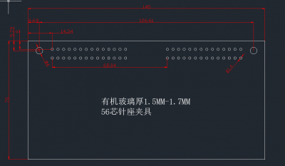

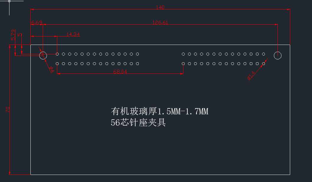

Ok so trying to get this enclosure header footprint done a few questions on the drawings :
1)What is the relationship between the two 3.3mm holes used to secure the header to the board and the pins?
2)What is the maximum board size?
3)Distance from front board edge to center of first row of pins?

nkiernan
- Posts: 589
- Has thanked: 516 times
- Been thanked: 95 times
Is this the info you need JB? Just sense check there's no scaling issues, or I'll try againJack Bauer wrote: ↑Thu Apr 01, 2021 9:34 am Ok so trying to get this enclosure header footprint done a few questions on the drawings :

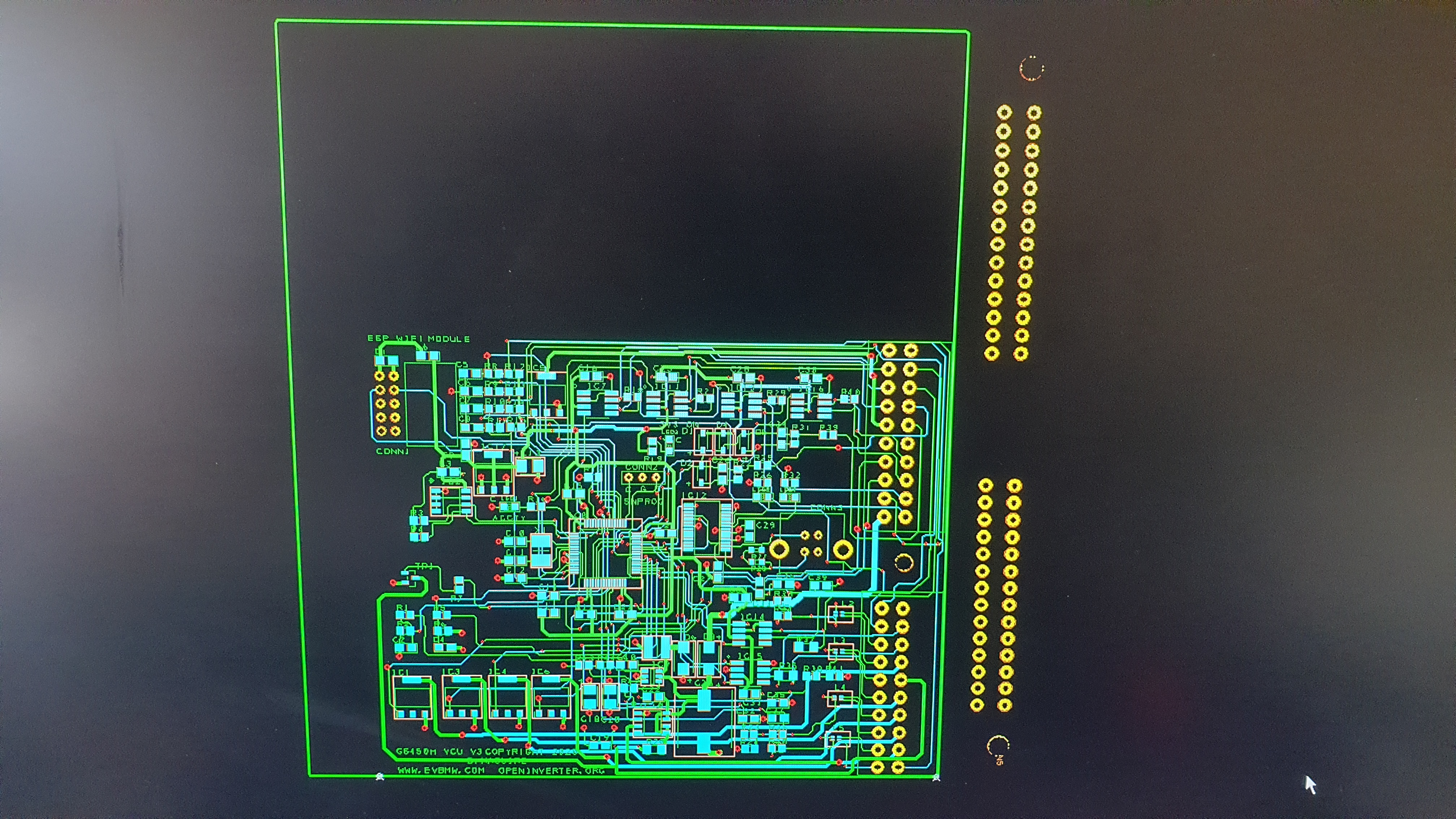

We got a basic footprint and board size for the new enclosure. Shown here with the original layout. Also, JLC are now stocking the 100 pin STM32F107VCT6 part as a basic component.
https://jlcpcb.com/parts/componentSearc ... 32F107VCT6
So this is going to be the mcu used.

Ok so getting started on the pinout for the 100 pin f107. Attached a first cut in CubeMX format. Now is the time to get those suggestions and pin requests in please.
So far :
Analog inputs (0-5v) :
2 throttle chans
pedal pos/pressure
vacuum sensor
2xaux analogs
Digital inputs (12v):
Forward
Reverse
Start
Brake
3xaux digital inputs
hv request
Output drivers (NCV8402) :
Precharge
Pos con
Neg con
Inverter power
3x aux outputs
3x Pwm via timer 3
Comms :
Usart1 - RS232/RS485 driver for external comms
Usart2 - Toyota hybrid
Usart3 - wifi
CAN1 - HS can
CAN2 - HS can
CAN3 - HS/SW/FT can via spi mcp25625 and drivers. solder jumper selectable
Toyota Hybrid :
Free running clock for sync serial comms
3xgear pos inputs
3xshift solenoid drivers
Memory :
2Mbit external I2C eeprom
Clock:
8Mhz main clock
32khz rtc
Programming :
SWD
WiFi
Keep in mind we have 56 external pins of which at least 2 are required for power and ground.
