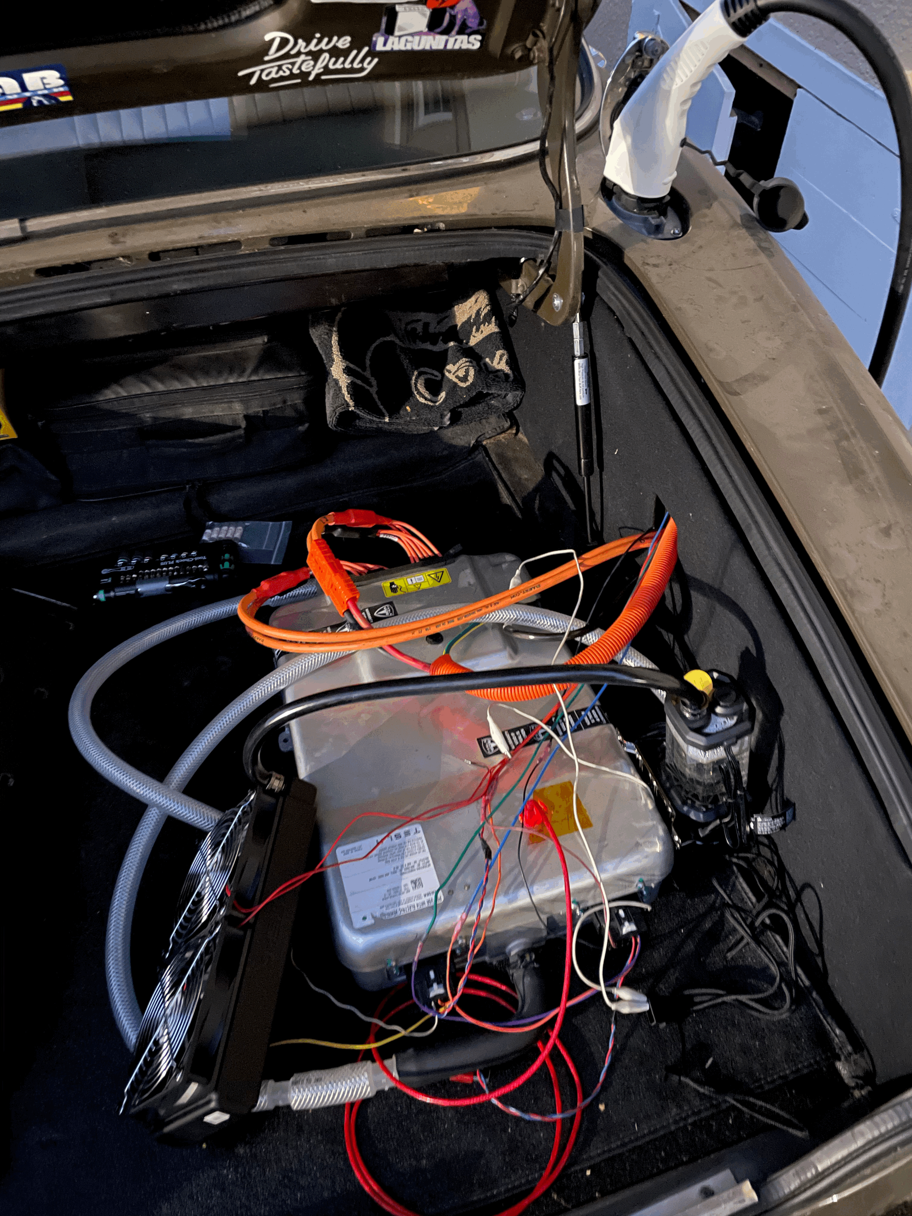

Posted: Tue Jan 05, 2021 3:54 am
by Bryson
Alright, today I finally got the cooling system plumbed up and got a charge session with the Gen2 v5 in before I hook up the Simp Charge. I charged up to ~415V (90% SOC) successfully before manually disconnecting.
I've noticed two issues with the charger:
1) All values still display 900 on the wifi screen, I wasn't ever able to see anything different after several tries, power cycles, and a total charge logged of ~35kWh (read: it was actually charging)
2) During the charge taper period (I believe), phases of the charger keep cycling on/off, sometimes with all three cycling off. I observed a little bit of this during the nominal charge period, but it really went wild during what looks like the taper period. I can hear the relays clicking, see it in my EVSE log, and see it in the charger serial log with associated weirdness in the AC/DC data. Has anyone else observed this behavior before I start the debugging process? I'd like to solve this before introducing the Simp Charge as another variable and hope that it's not simply due to the higher voltage I'm running, as it was happening intermittently at lower voltage.
charge taper log.log
(444.14 KiB) Downloaded 353 times
The setup as it looks before it gets tidied up and stowed away, please excuse the mess of wires:
Thanks for reading this far,
Bryson
Posted: Tue Jan 05, 2021 8:23 am
by Jack Bauer
I have addressed the ramping issue in the past in fact I just did so again in the new firmware thread so here is a copy :
Once again to address the ramping issue : Yes I have seen it, no I don't know the cause , Tom has said its down to thermal limiting in the modules. It may indeed turn out to be a can issue and like all things we do here the more minds we have working on it the faster it will be fixed.
In terms of the wifi the first thing I would do is check you are seeing serial data on the wifi header. It comes out at 19.2k 8n1.
As Johannes has announced we will soon have an openinverter based firmware available (along with a new board rev) for the gen2 and gen3 charger control boards. It will be compatible with stm32 based V5 boards only. More on this once we complete testing.
Posted: Tue Jan 05, 2021 4:11 pm
by Bryson
Thanks for copying that here, I hadn’t caught it in the other threads.
As I browse through the log, it’s worth noting that one of the things happening is phase 3 goes into a fault state, which is triggering a move to state 2 and a reset of all phases (based on my understanding of the code). This may or may not be related to other phases dropping to zero current without faults. I’ll be going over my grounds again first to see if it may be noise related as I don’t have a scope handy. Maybe a choke on the power to the board is worth trying as well. Then I’ll attempt further dives.
Thanks for the tip on the WiFi debugging.
Great to hear that another crack at the firmware is on its way, thanks.
