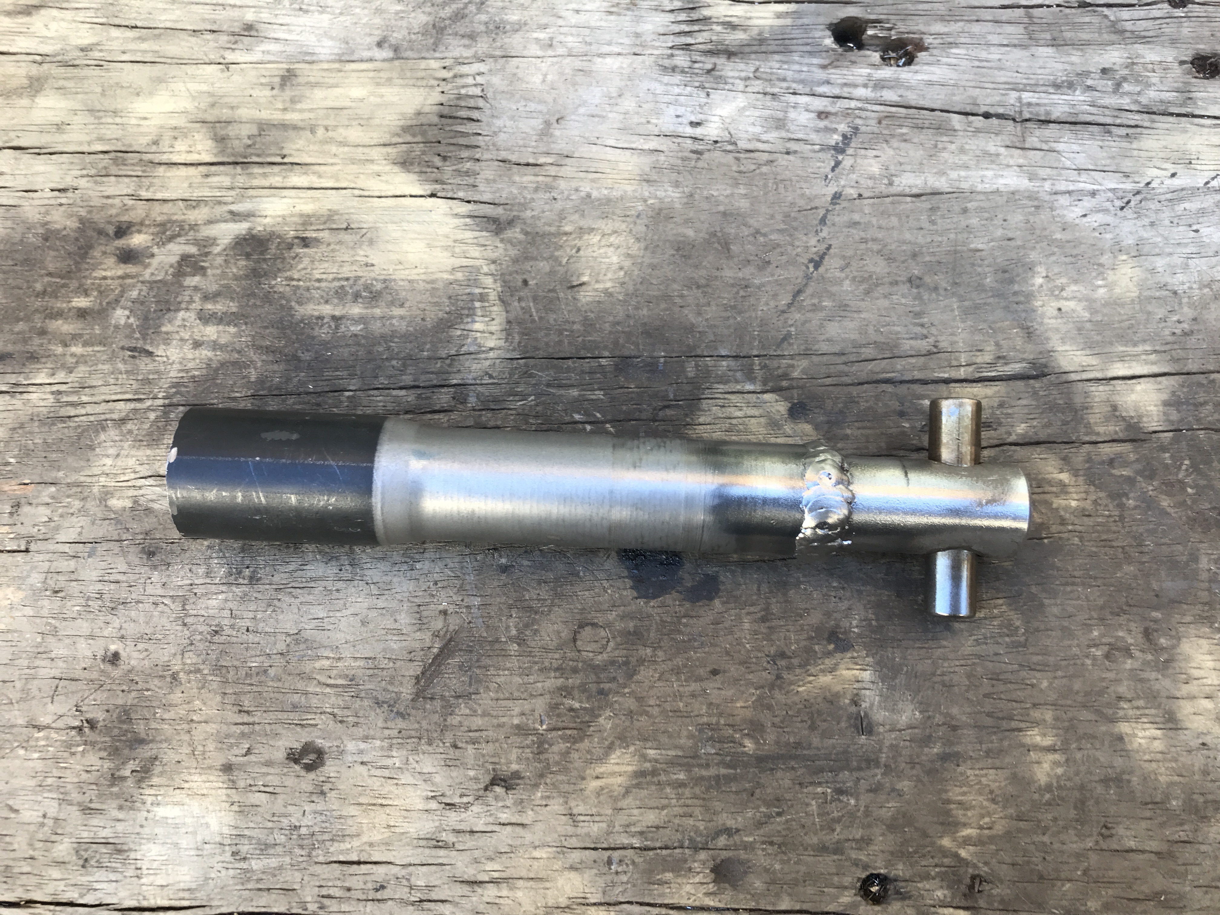

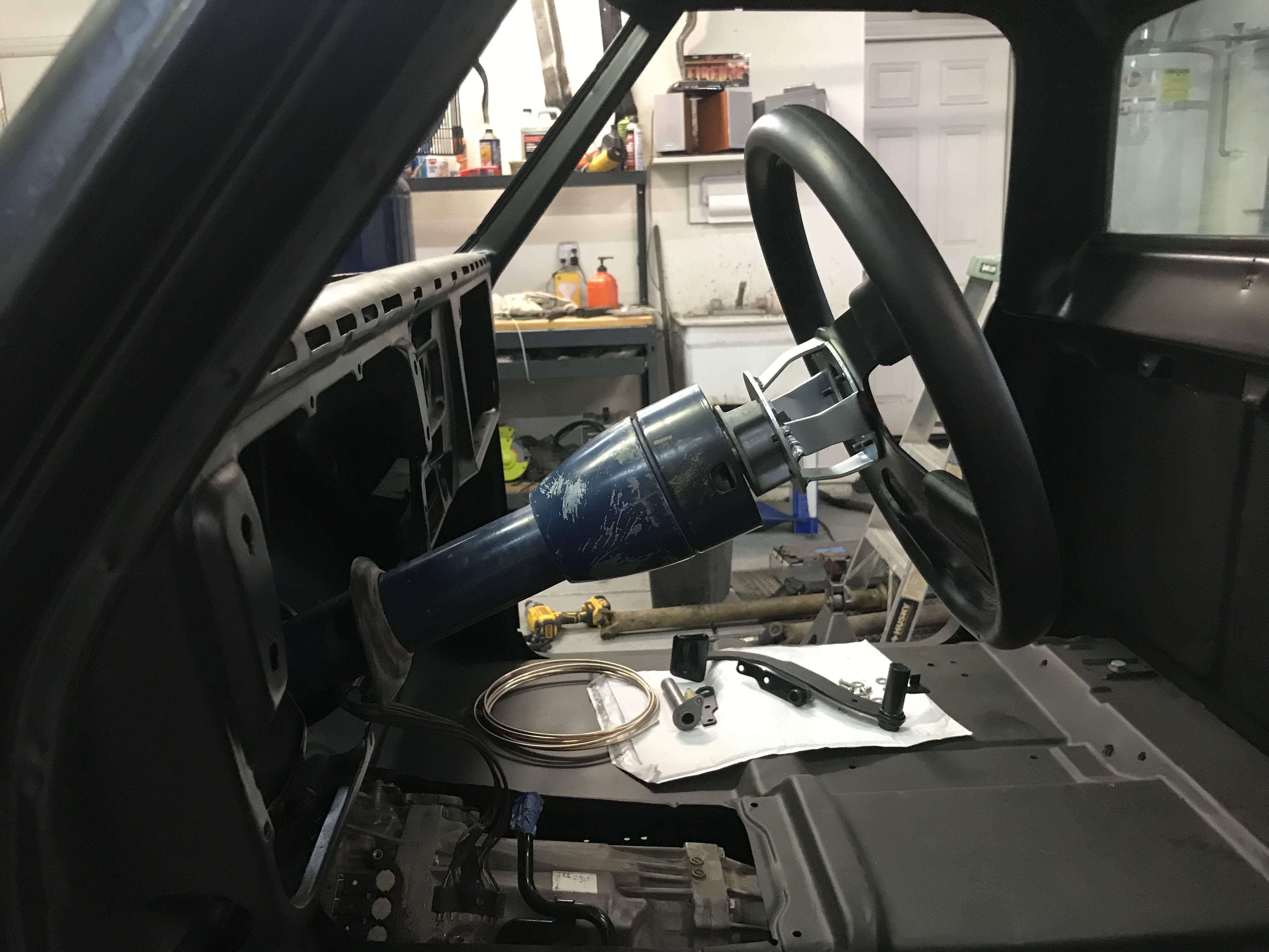

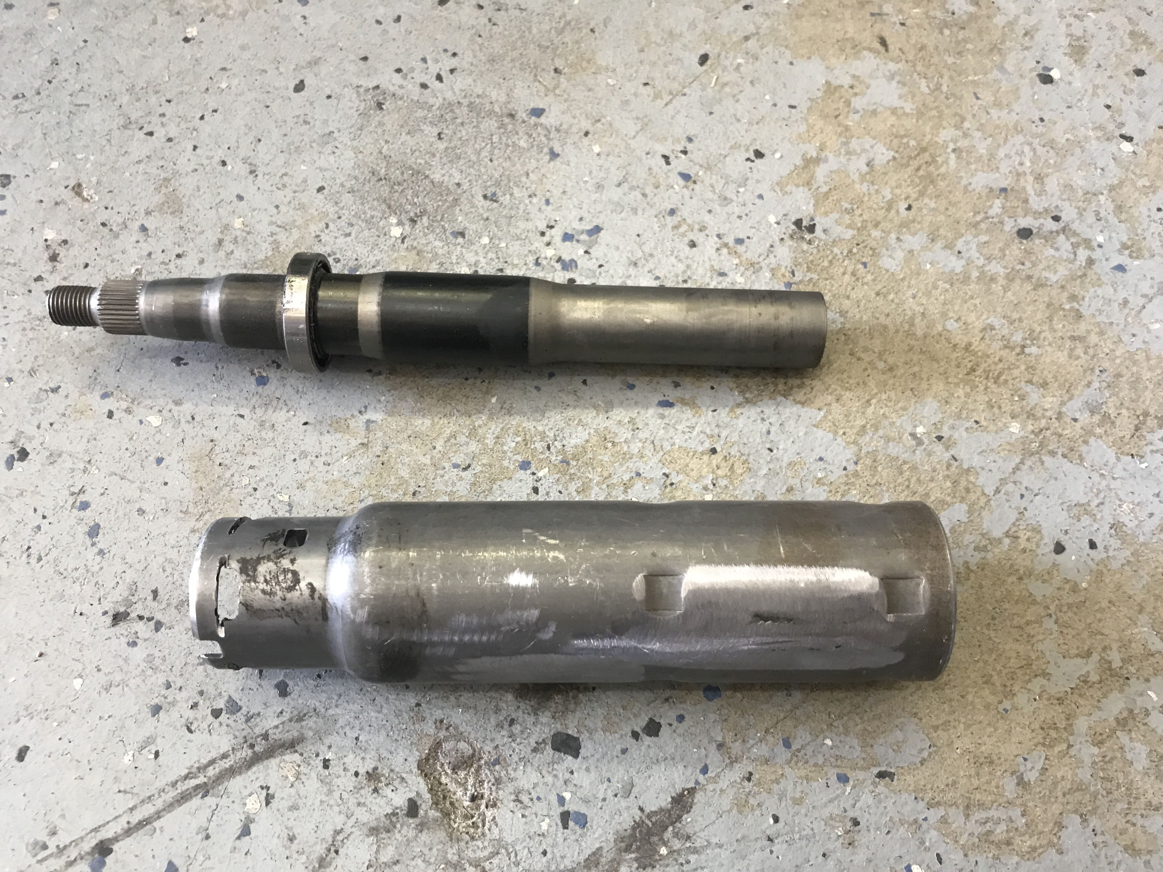

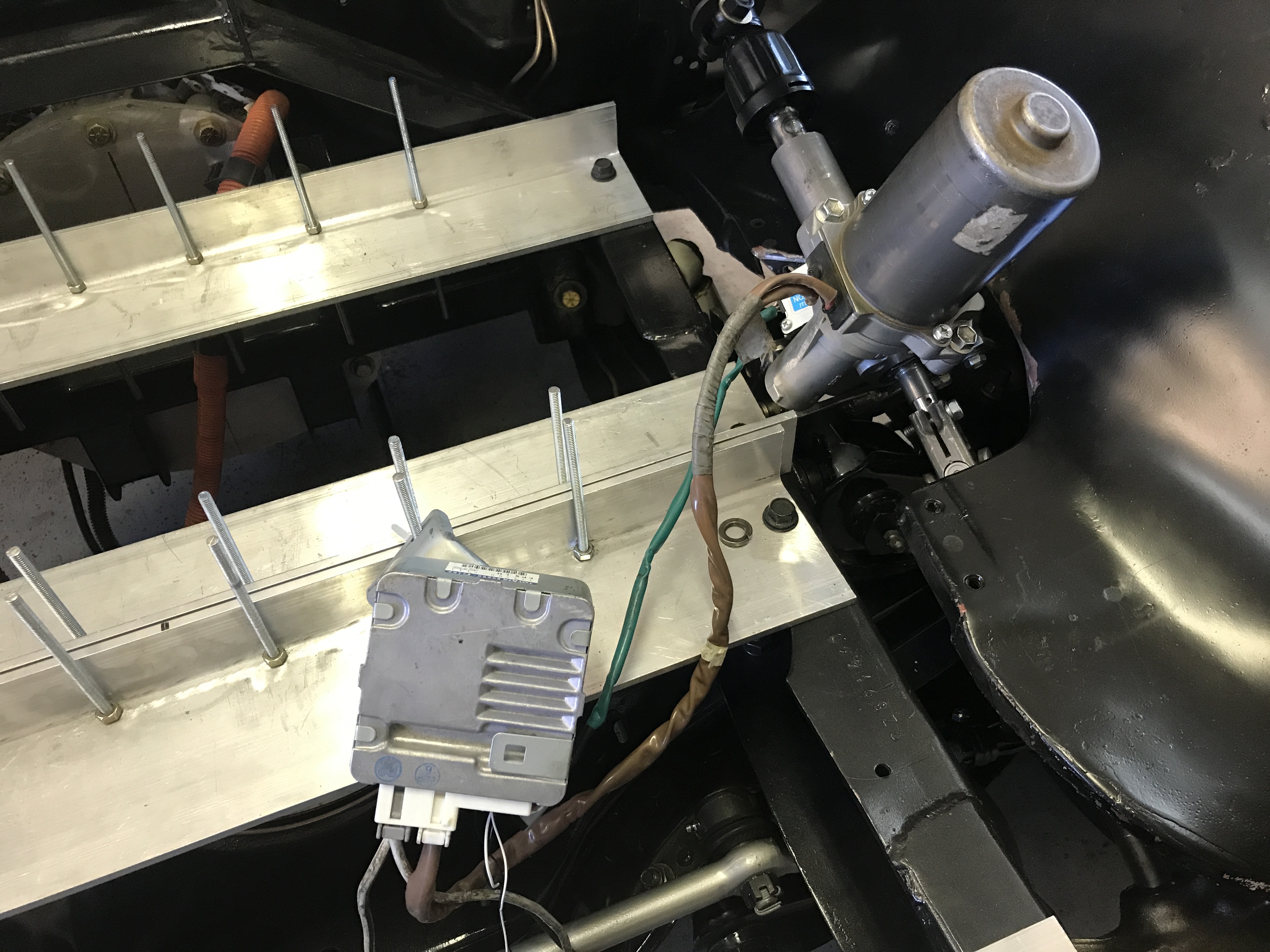

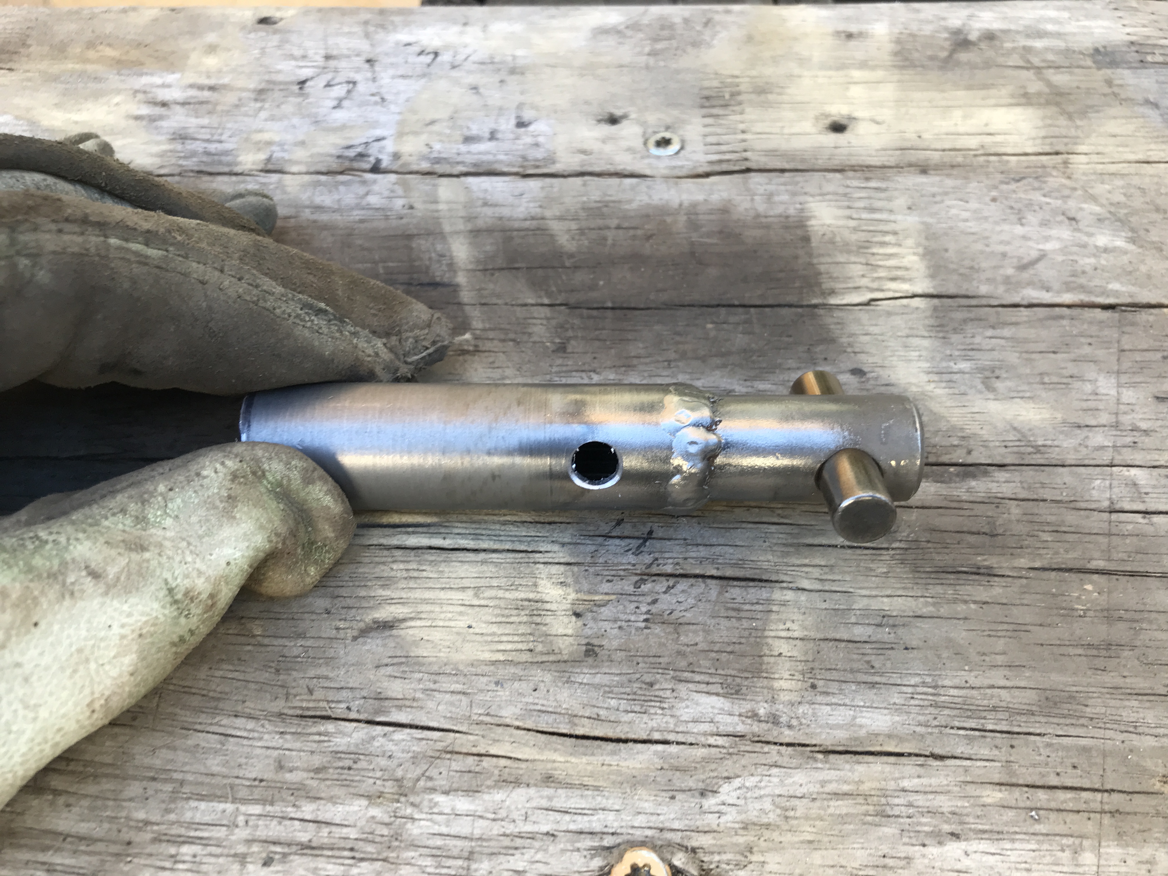

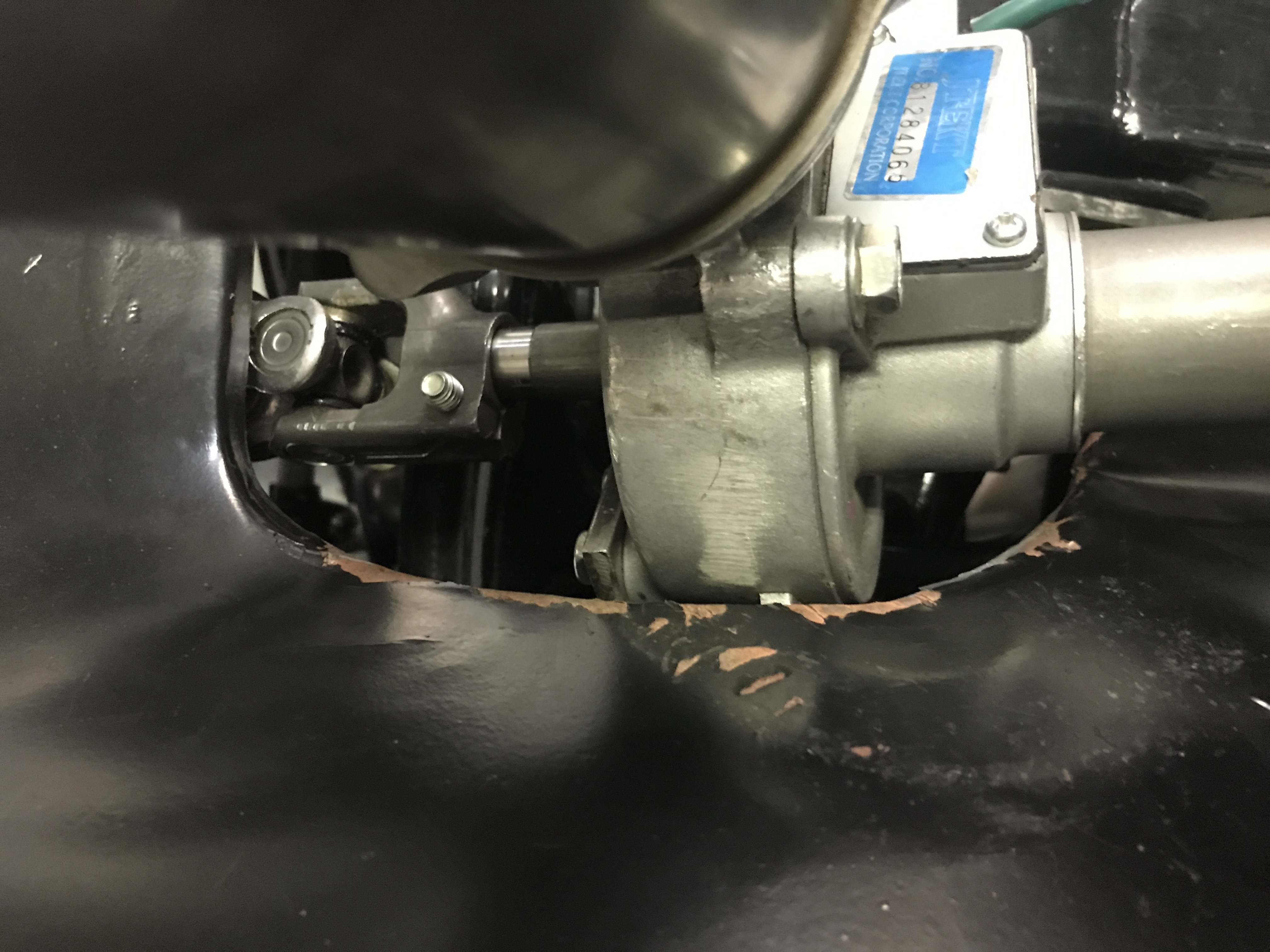

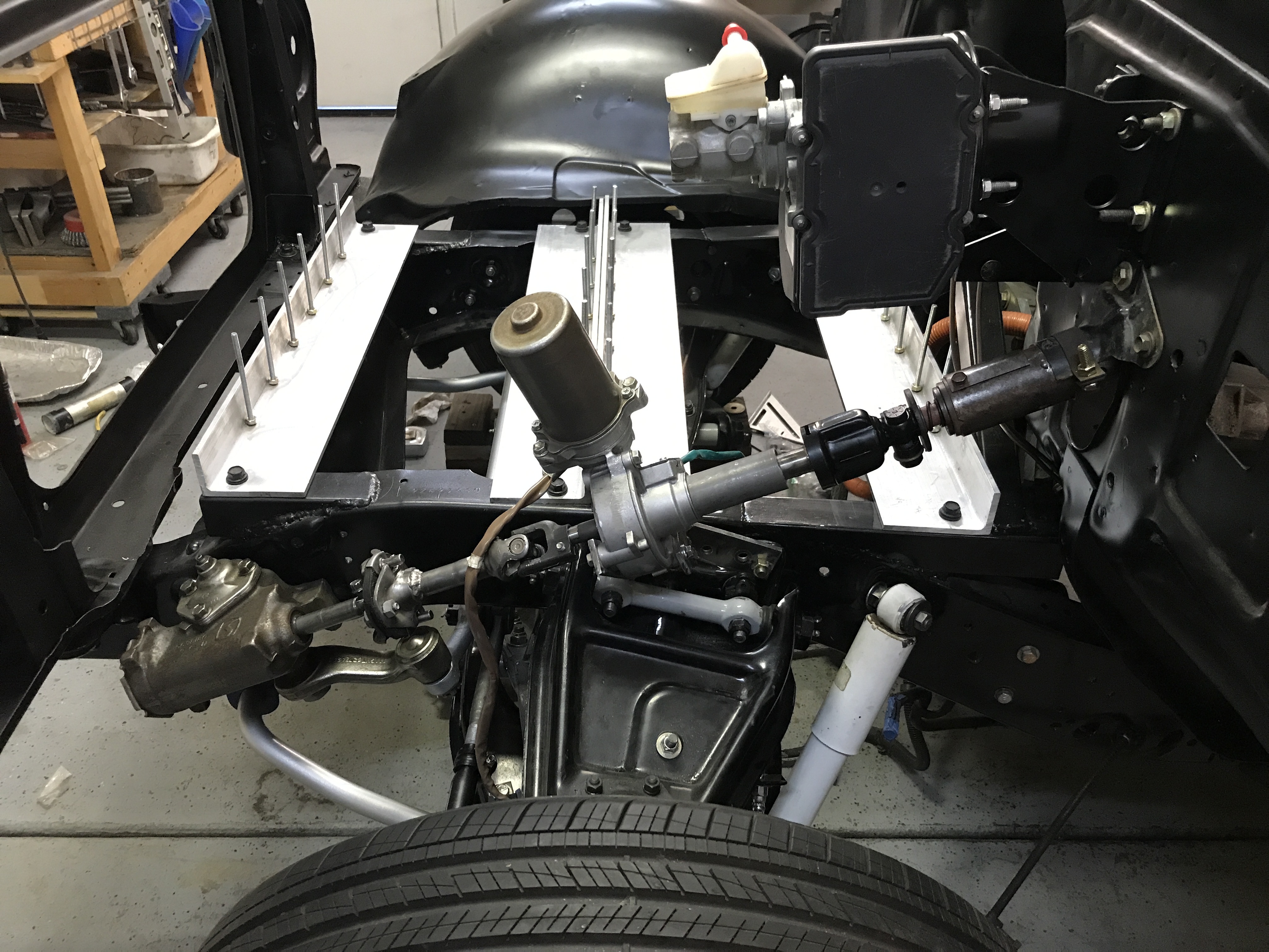

we also extracted the steering wheel shaft from the upper part that runs to the steering wheel
Gregski
Posts: 3161
Has thanked: 631 times
Been thanked: 1608 times

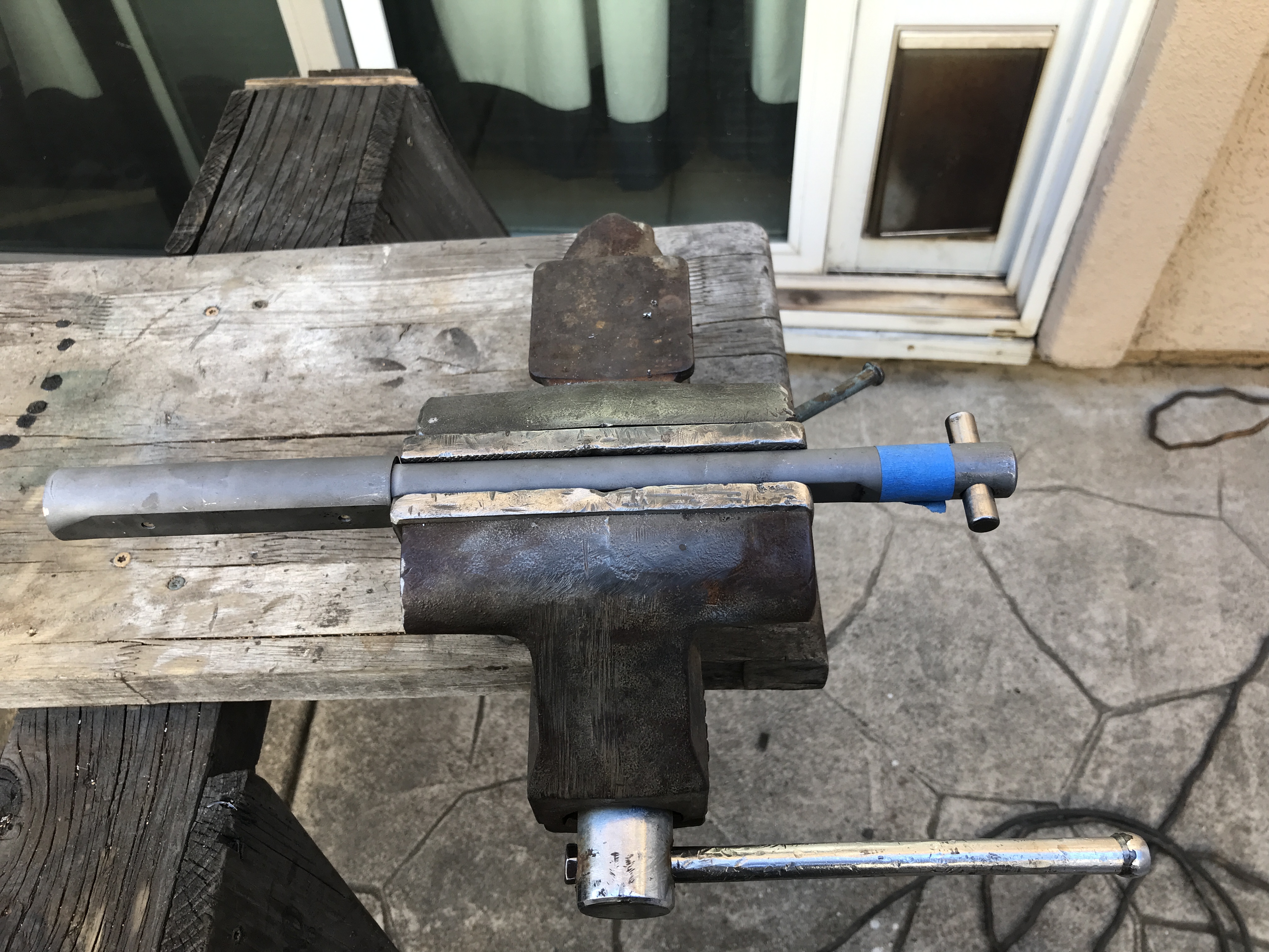

Post by Gregski »
then we sliced and diced the north pole
the GM intermediate shaft coupler married to the Prius upper steering column shaft
and poked a hole in it to rosie weld it once it slipped on to the native Prius splines

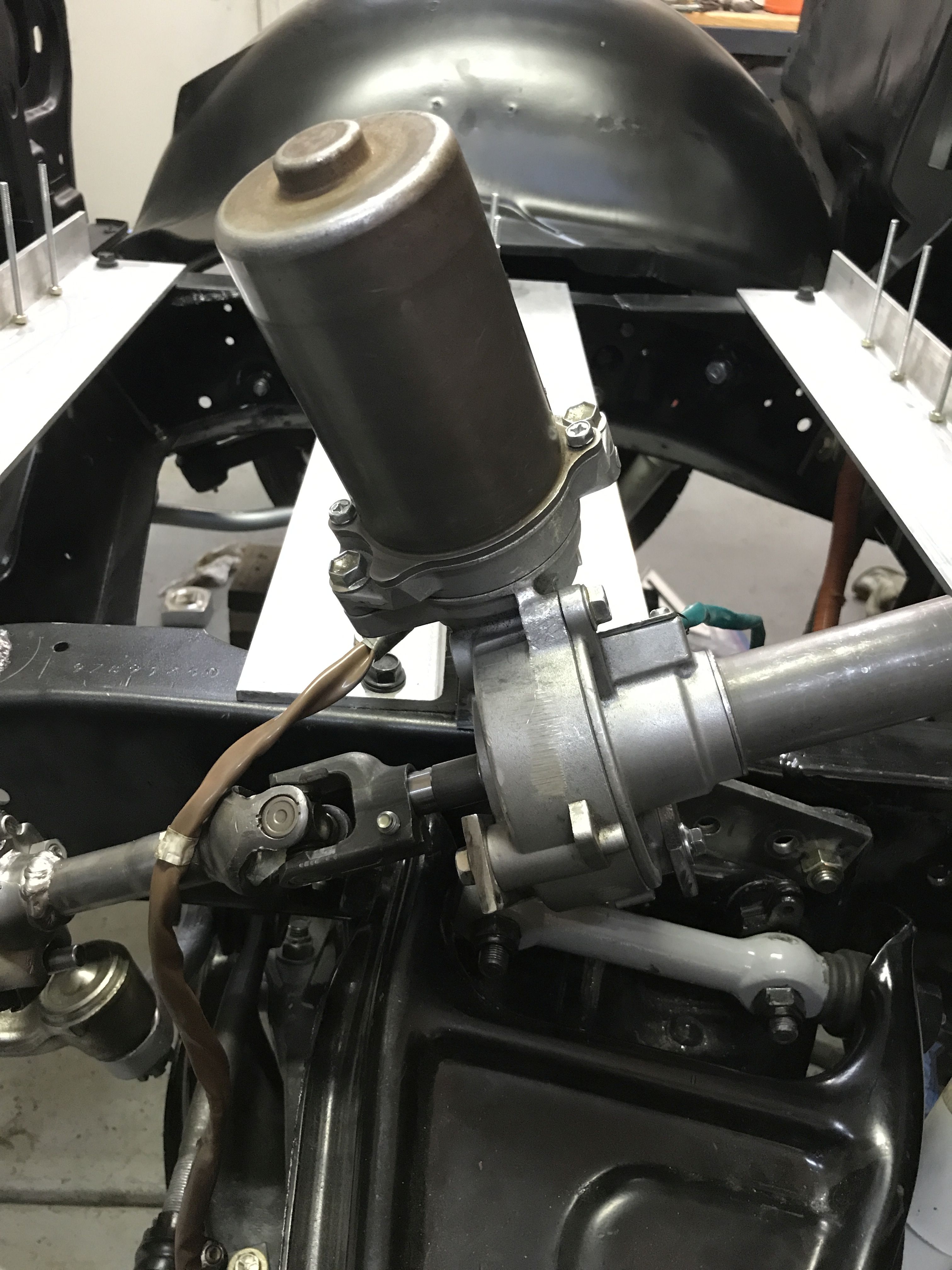

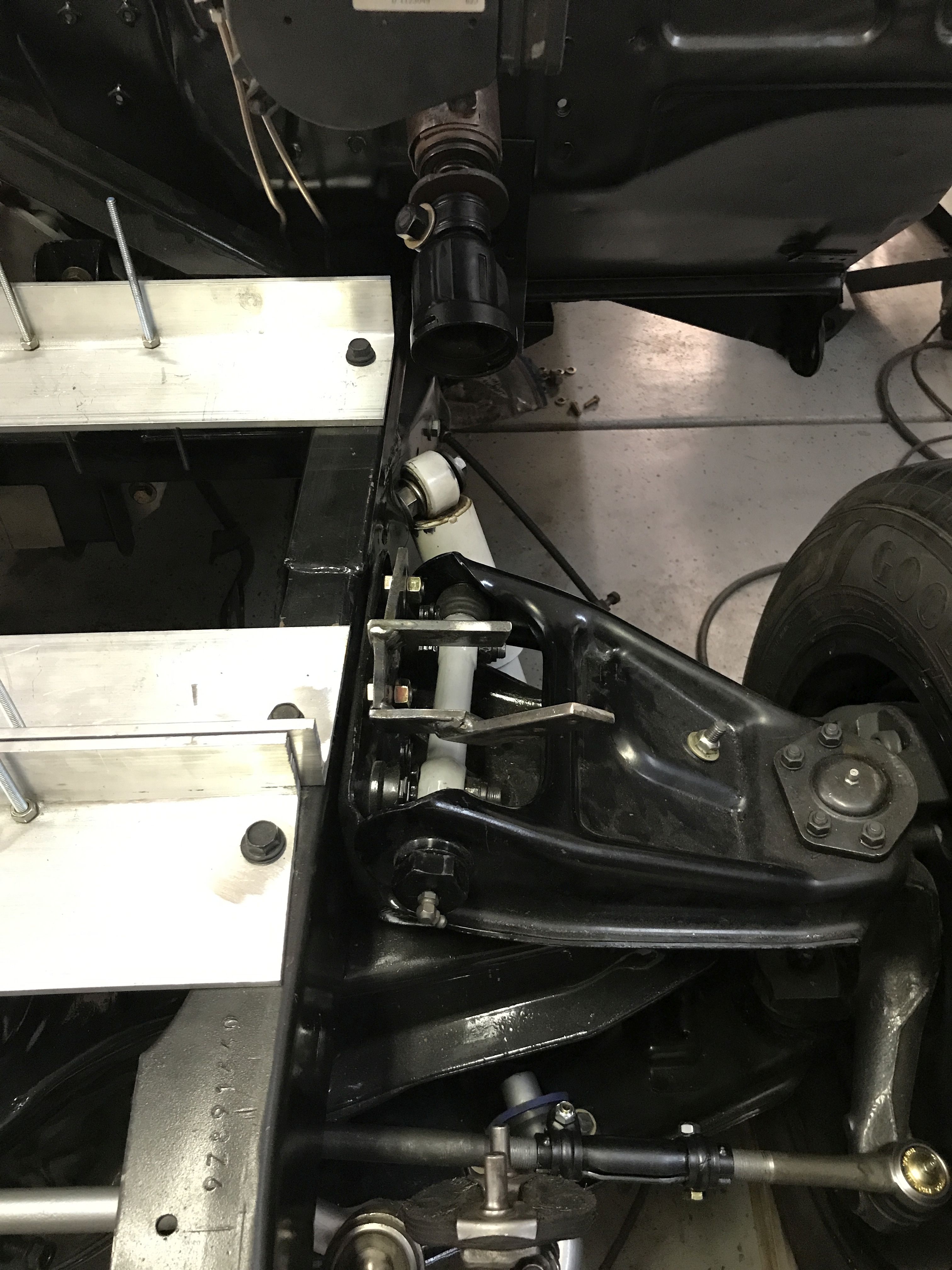

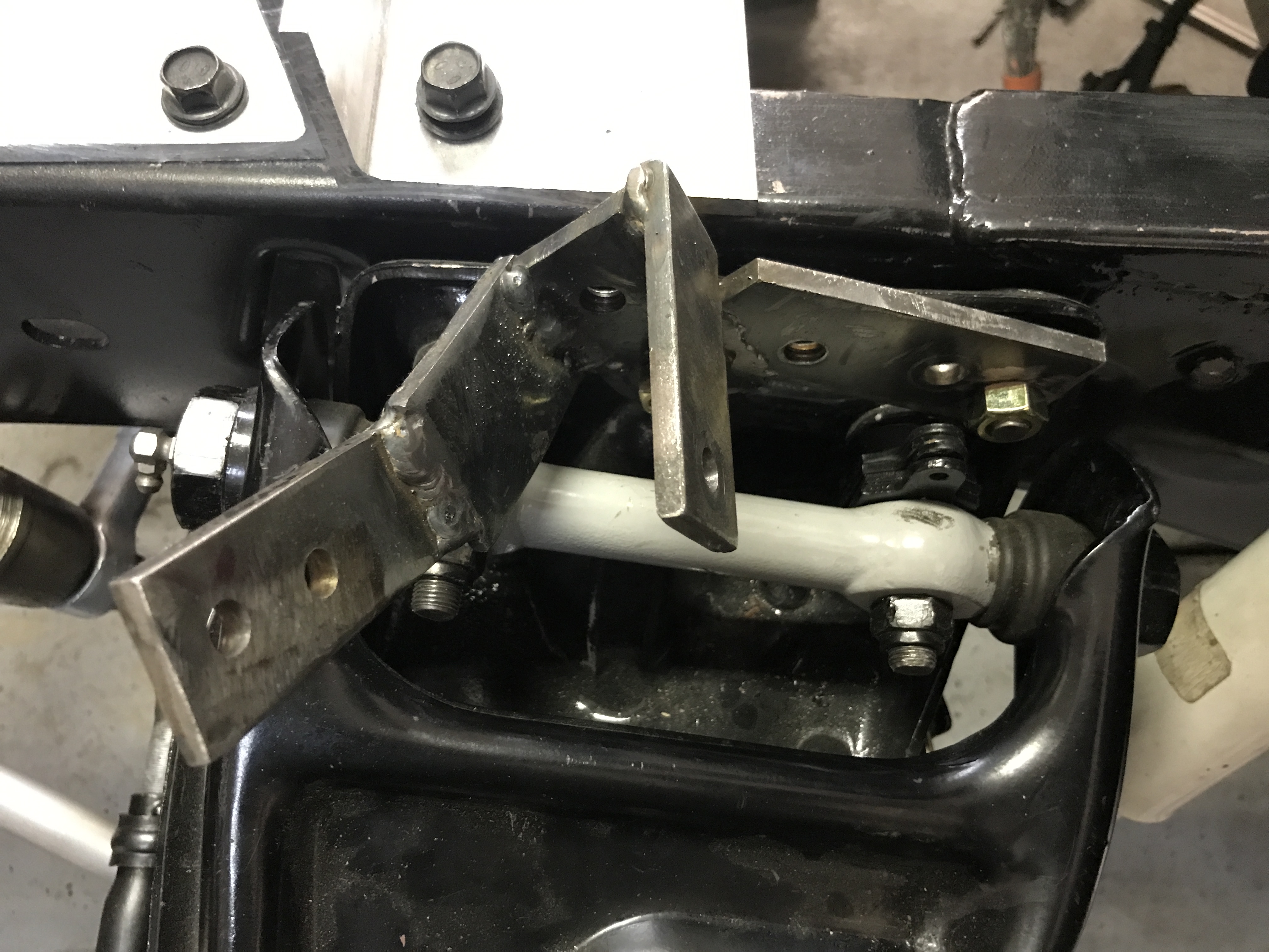

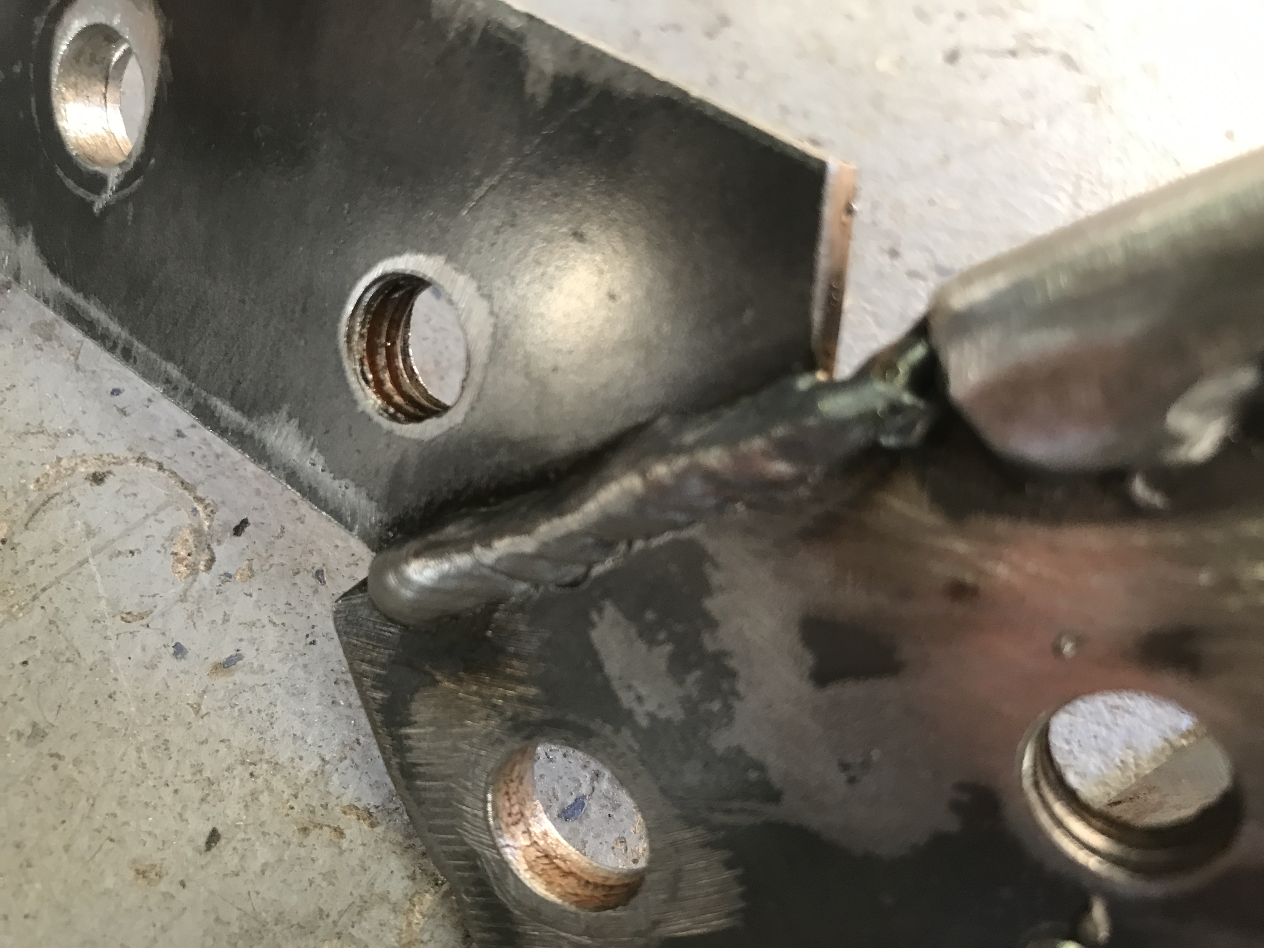

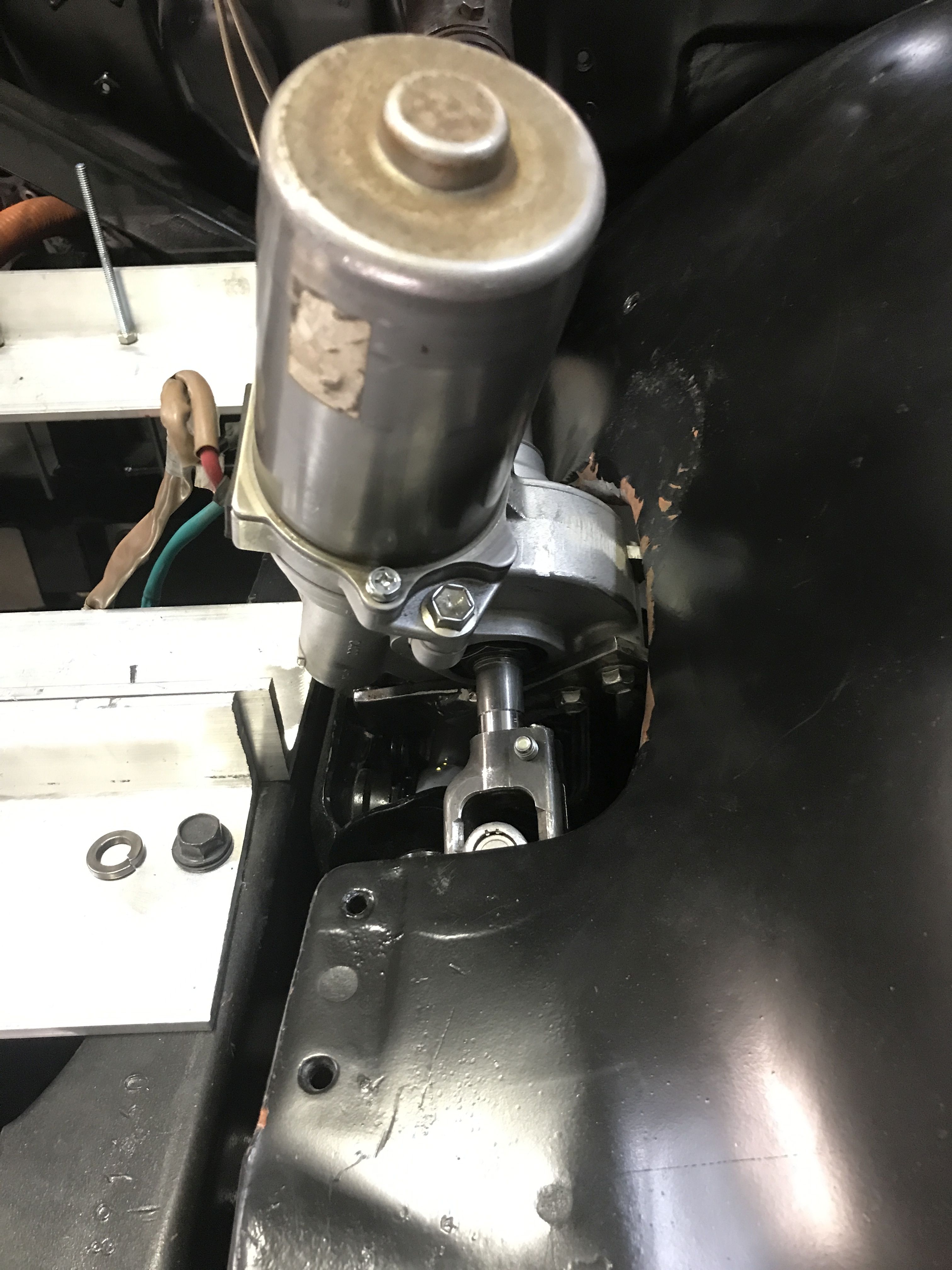

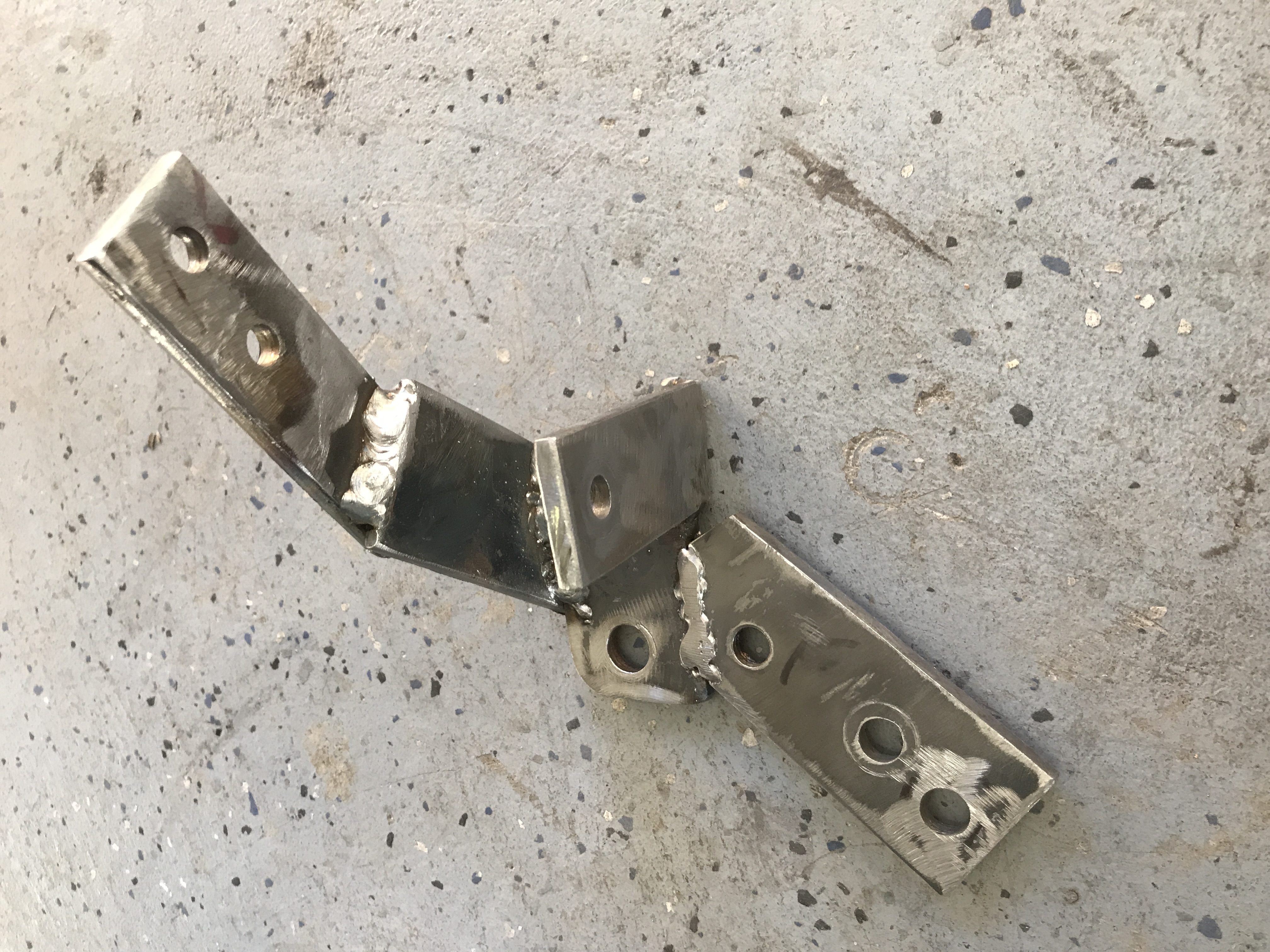

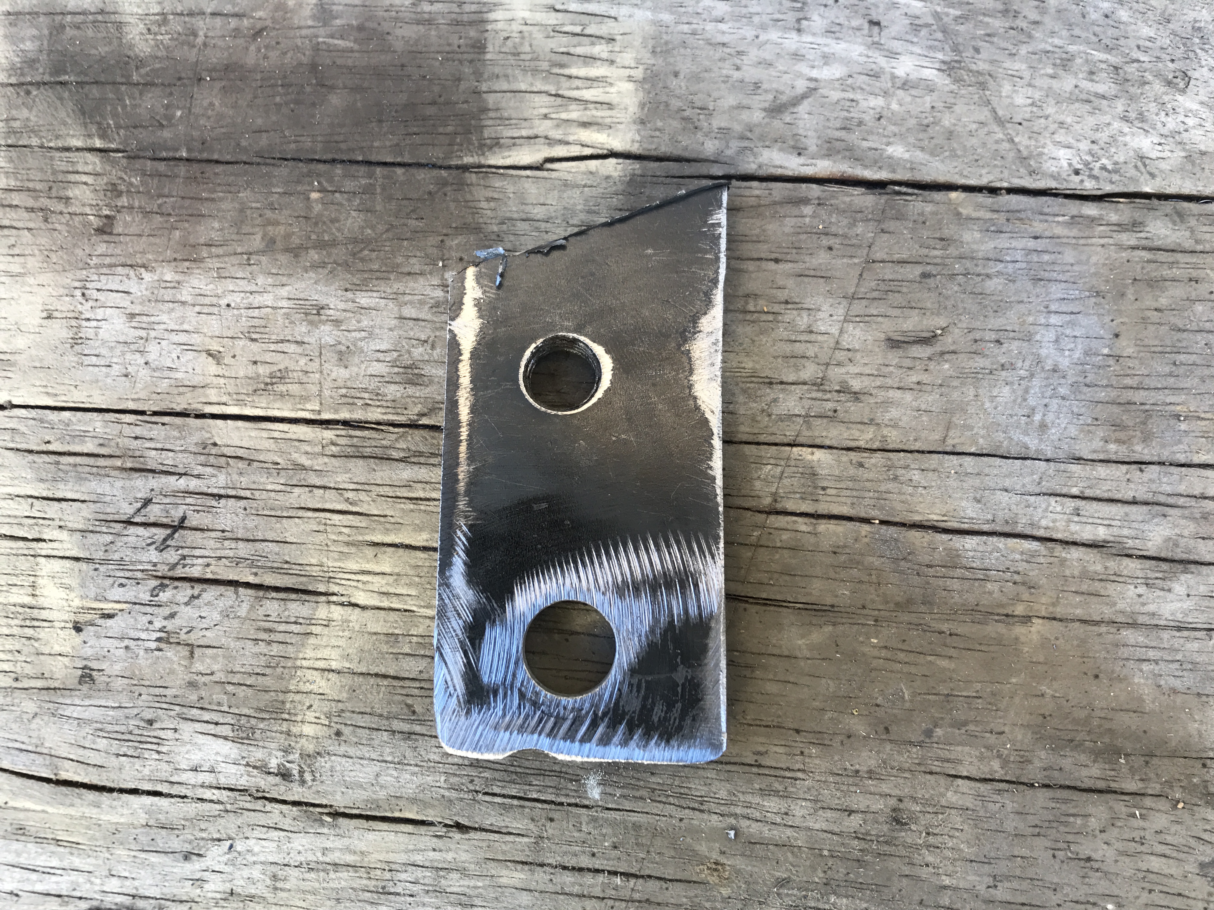

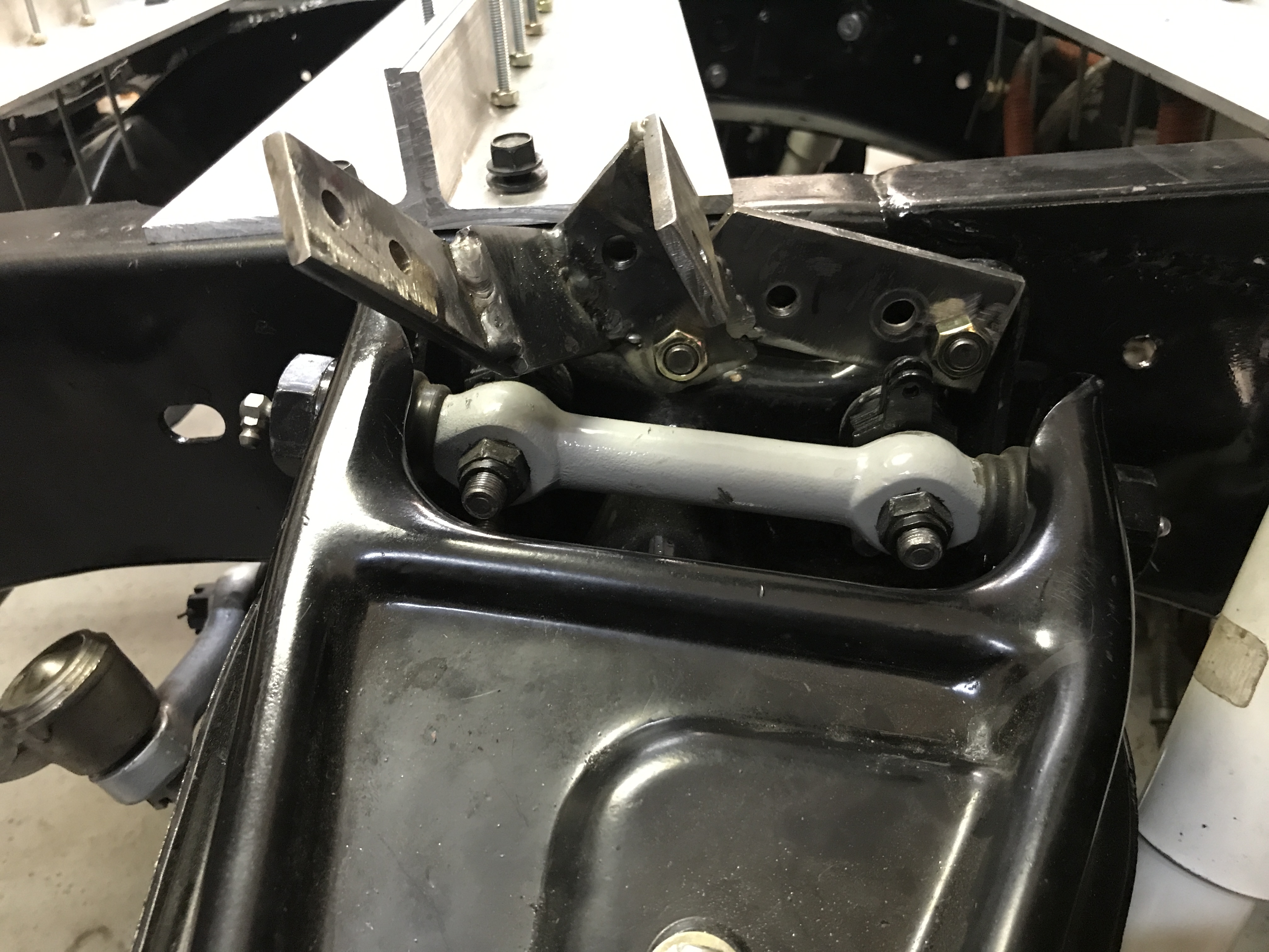

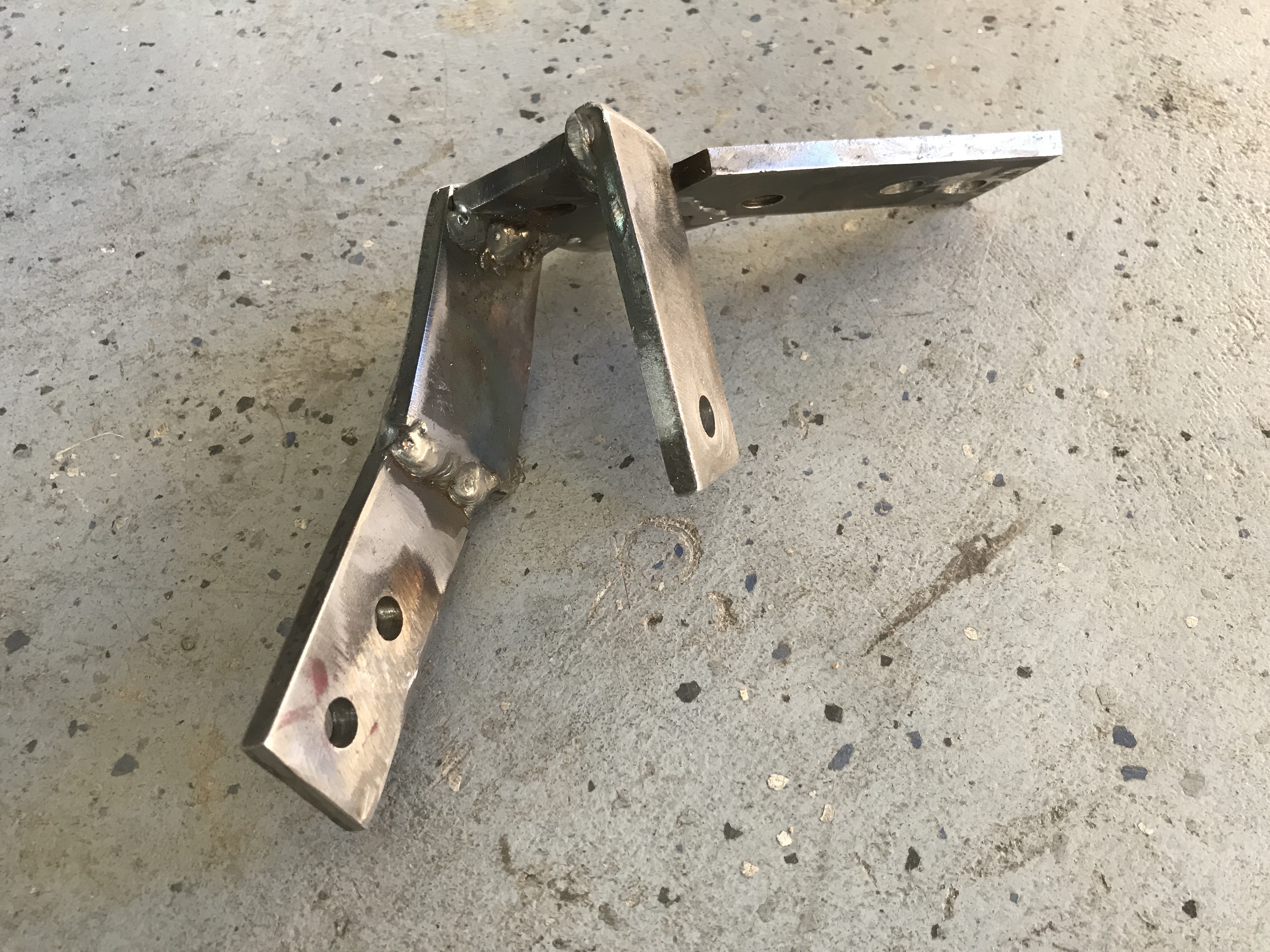

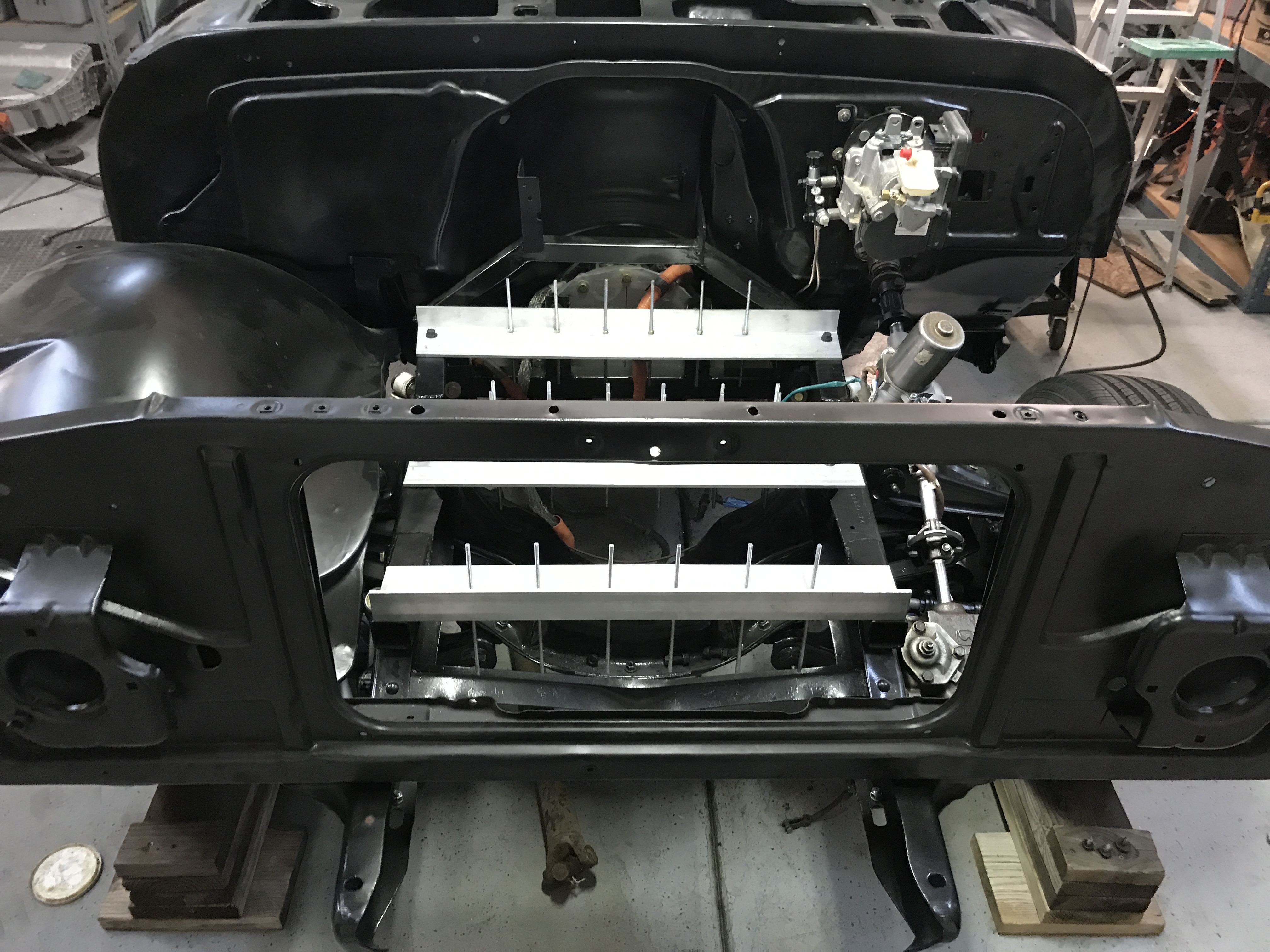

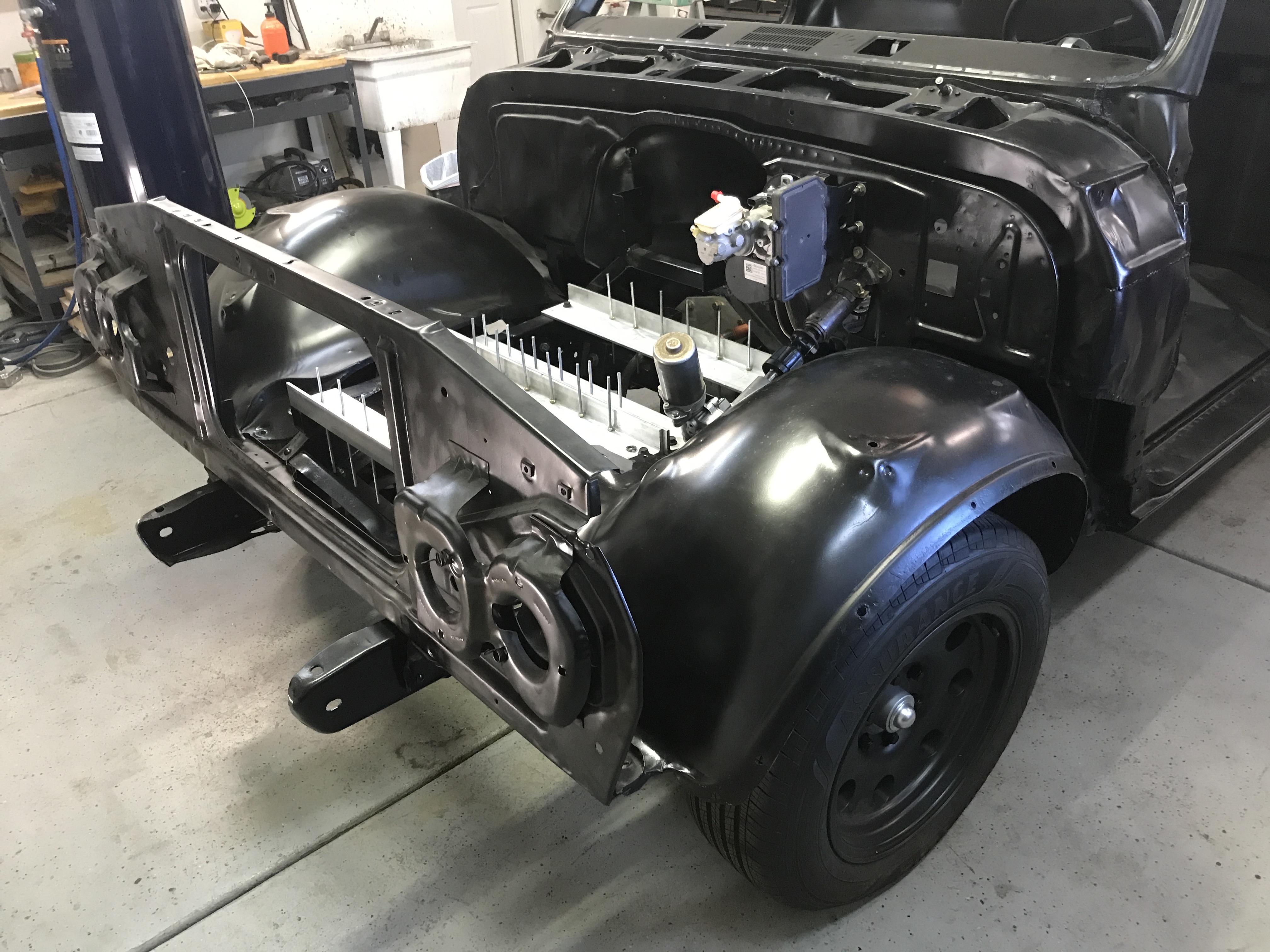

you are going to need a dance partner for the next part
Step 1. cut a bunch or random pieces that look like this
Step 2. welder them all up in any random formation
Gregski
Posts: 3161
Post by Gregski »
mount it to the frame, and back away 50 feet
Gregski
Posts: 3161
Post by Gregski »

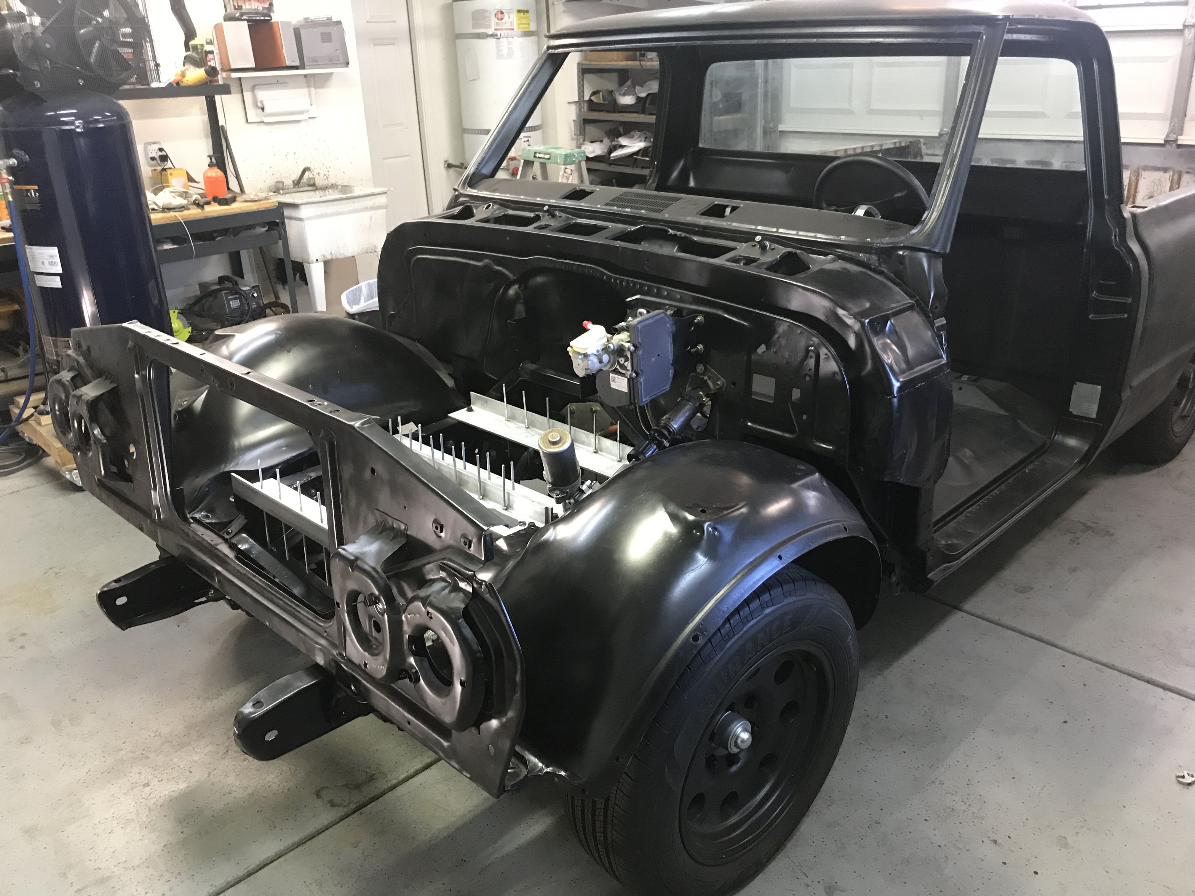

enuff already mount the damn thing !!!
alright, alright...
mounted it looks great, is strong as hell, and it even turns them wheels

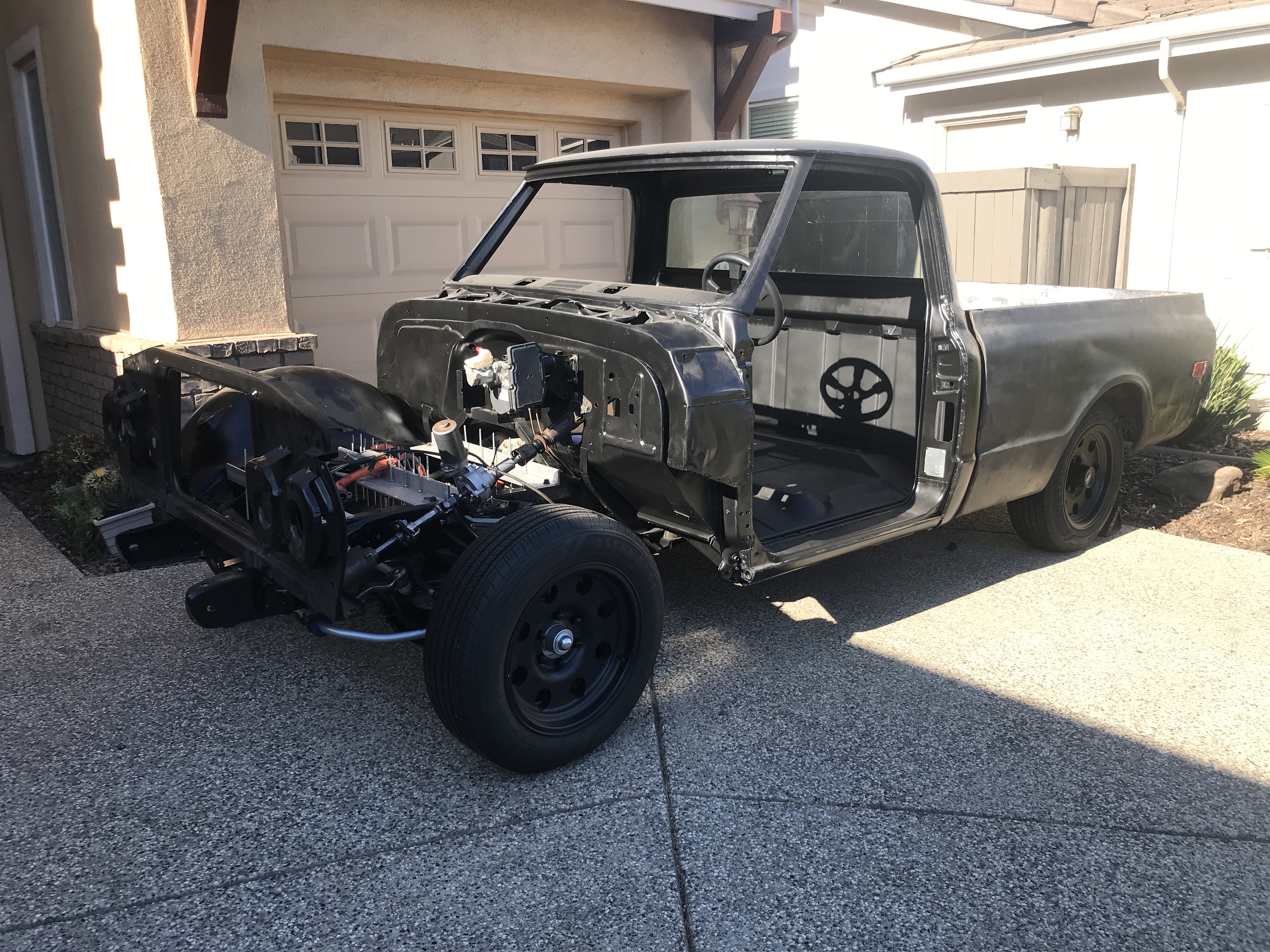

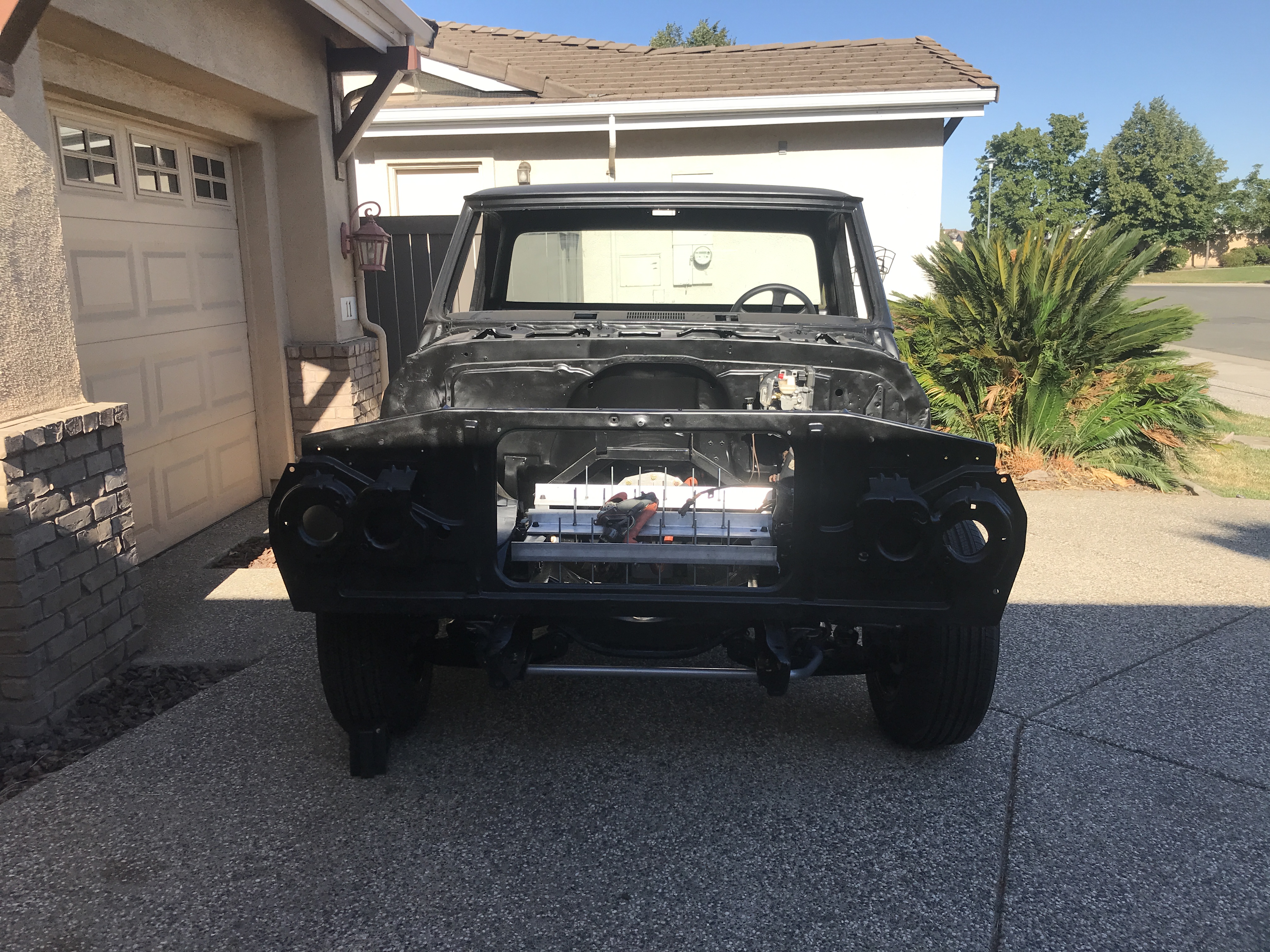

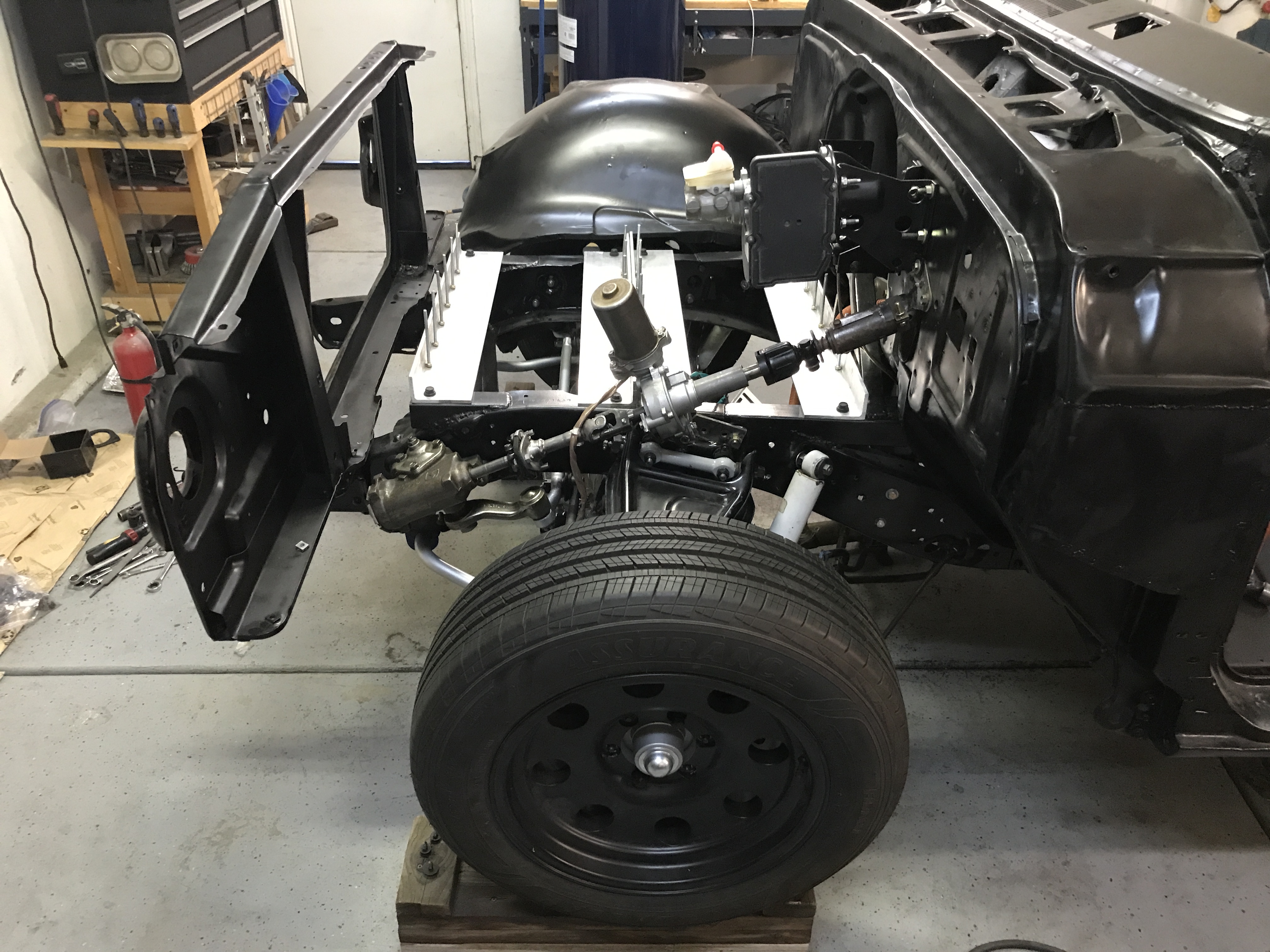

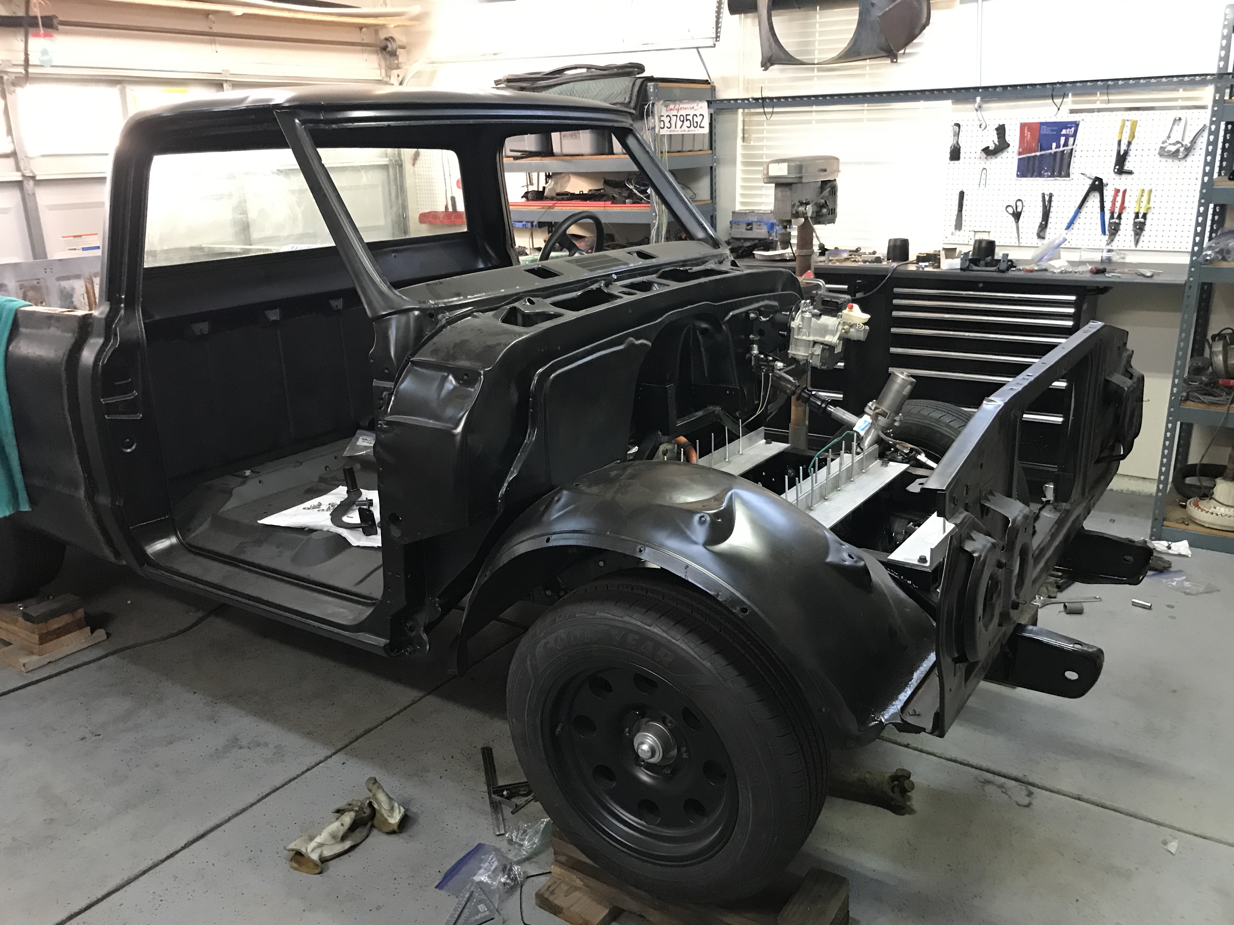

the flux capacitor
The Iron Maiden
It almost looks like a truck again

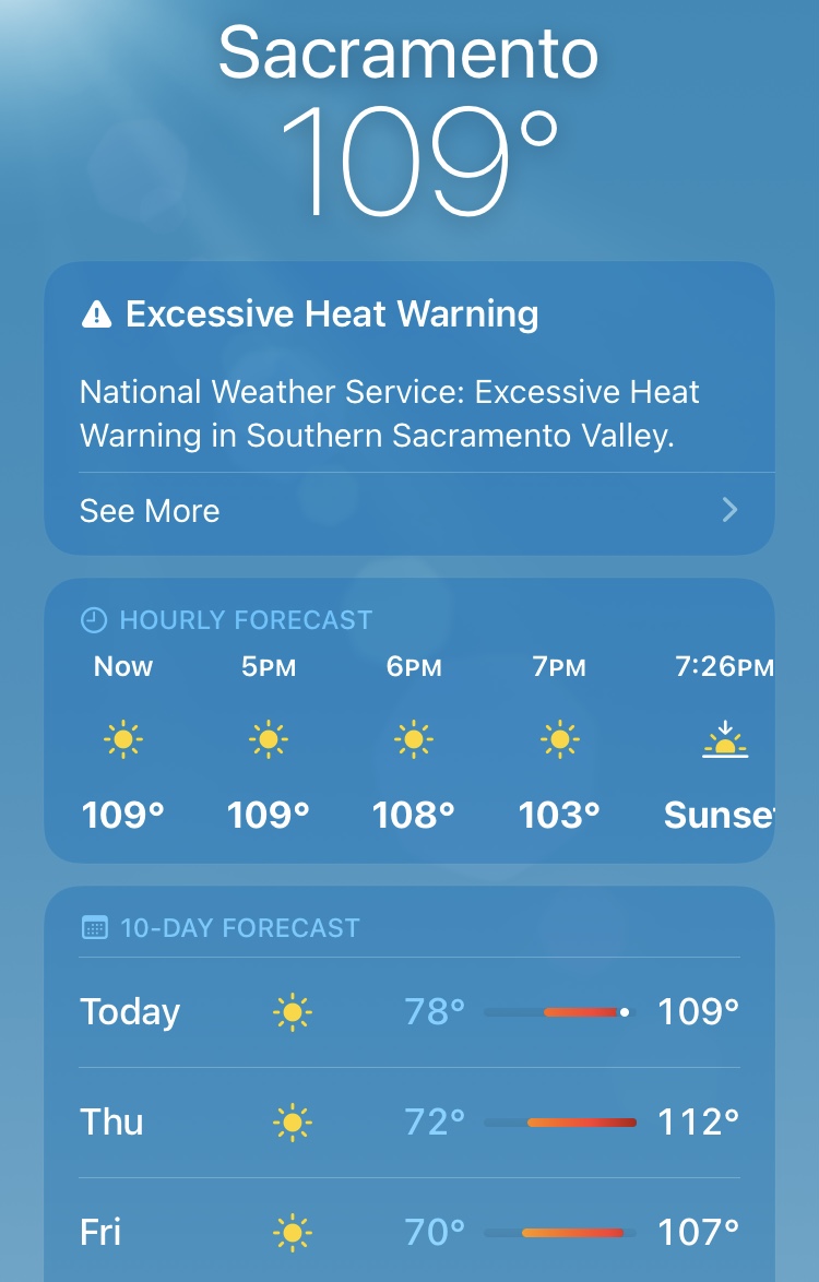

sorry guys and gals it was literally 106°F today and 200° in the Good Enuff Garage so as much as I wanted to shoot a video I'm sure the camera would not have worked in the sauna

Post by Gregski »

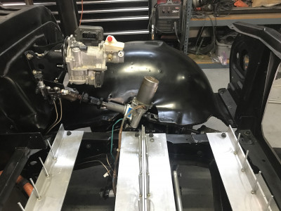

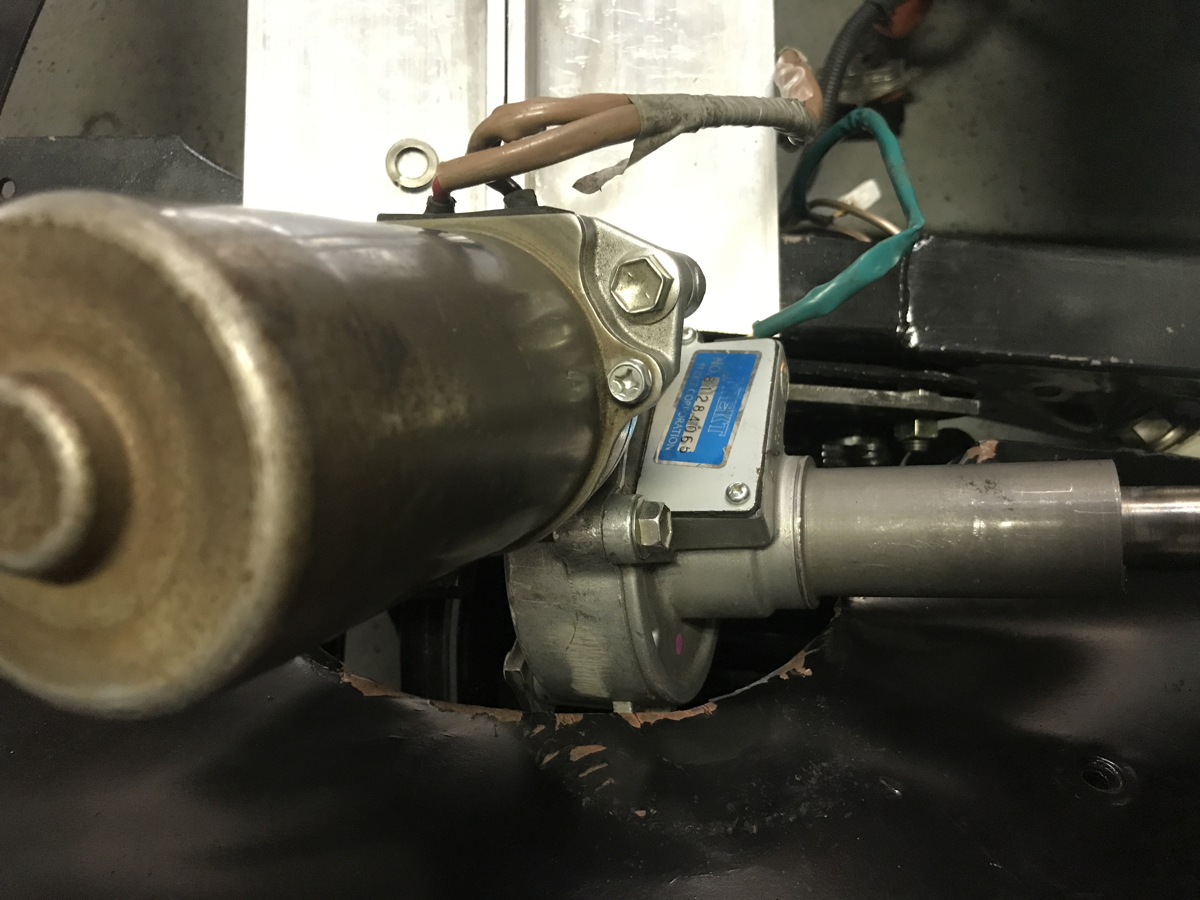

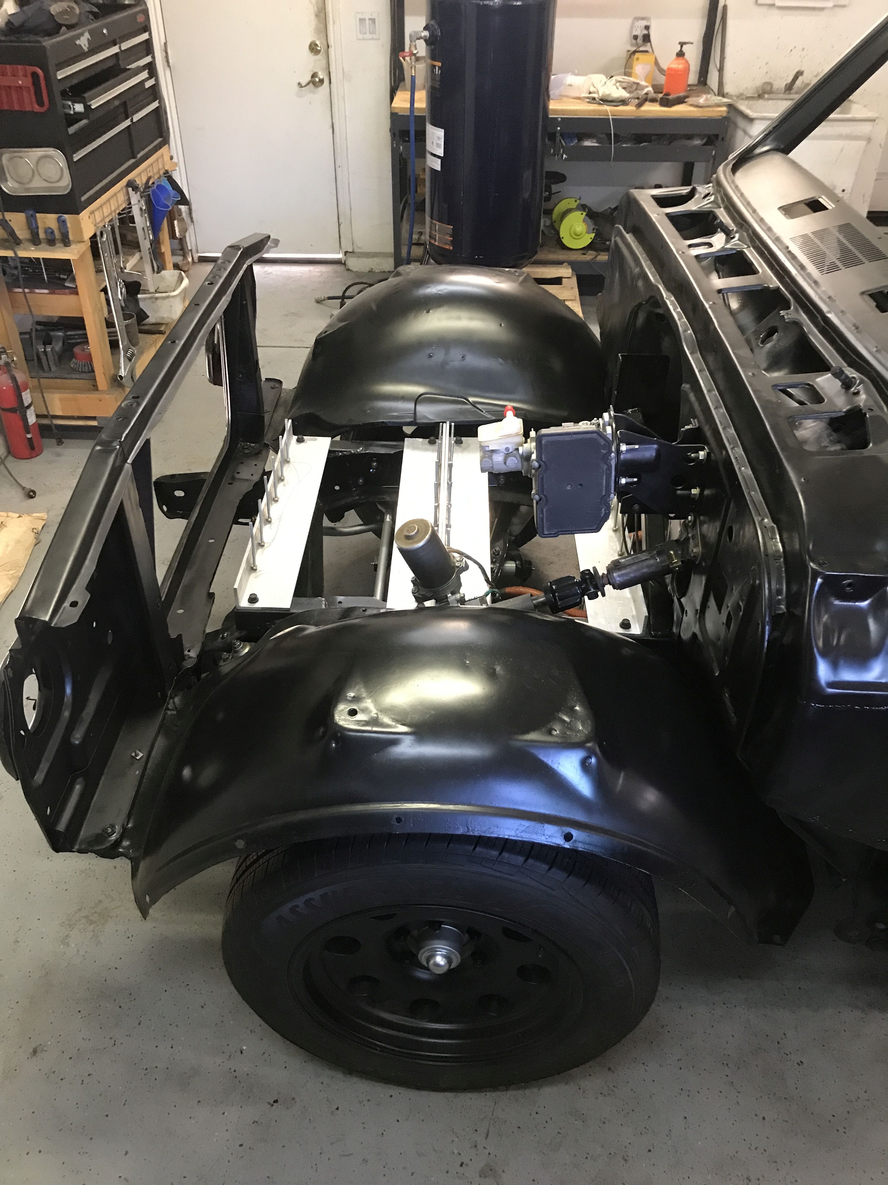

the Prius power assist project implementation summarized:
Gregski
Posts: 3161
Post by Gregski »
Black Sunshine
Gregski
Posts: 3161
Post by Gregski »

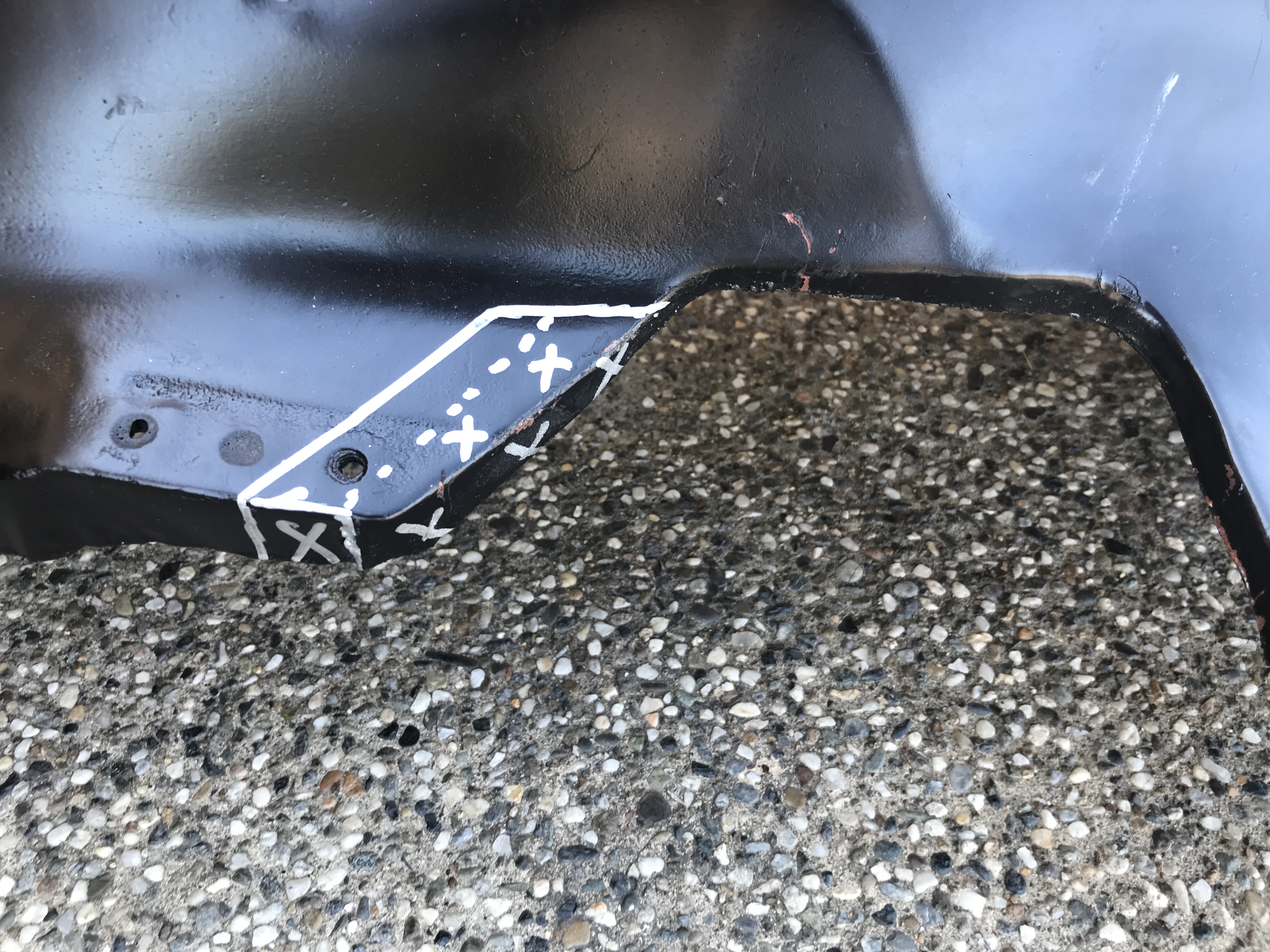

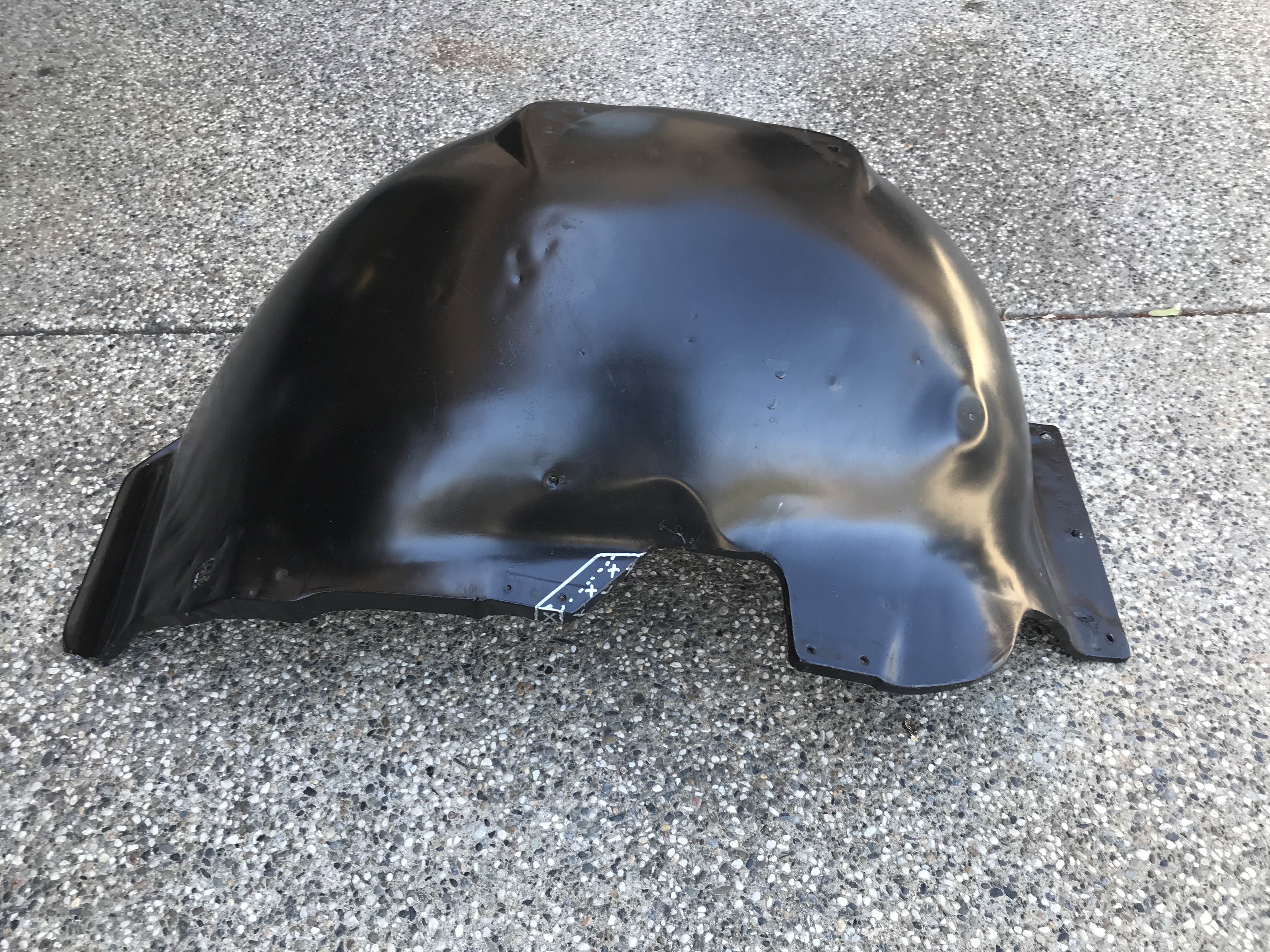

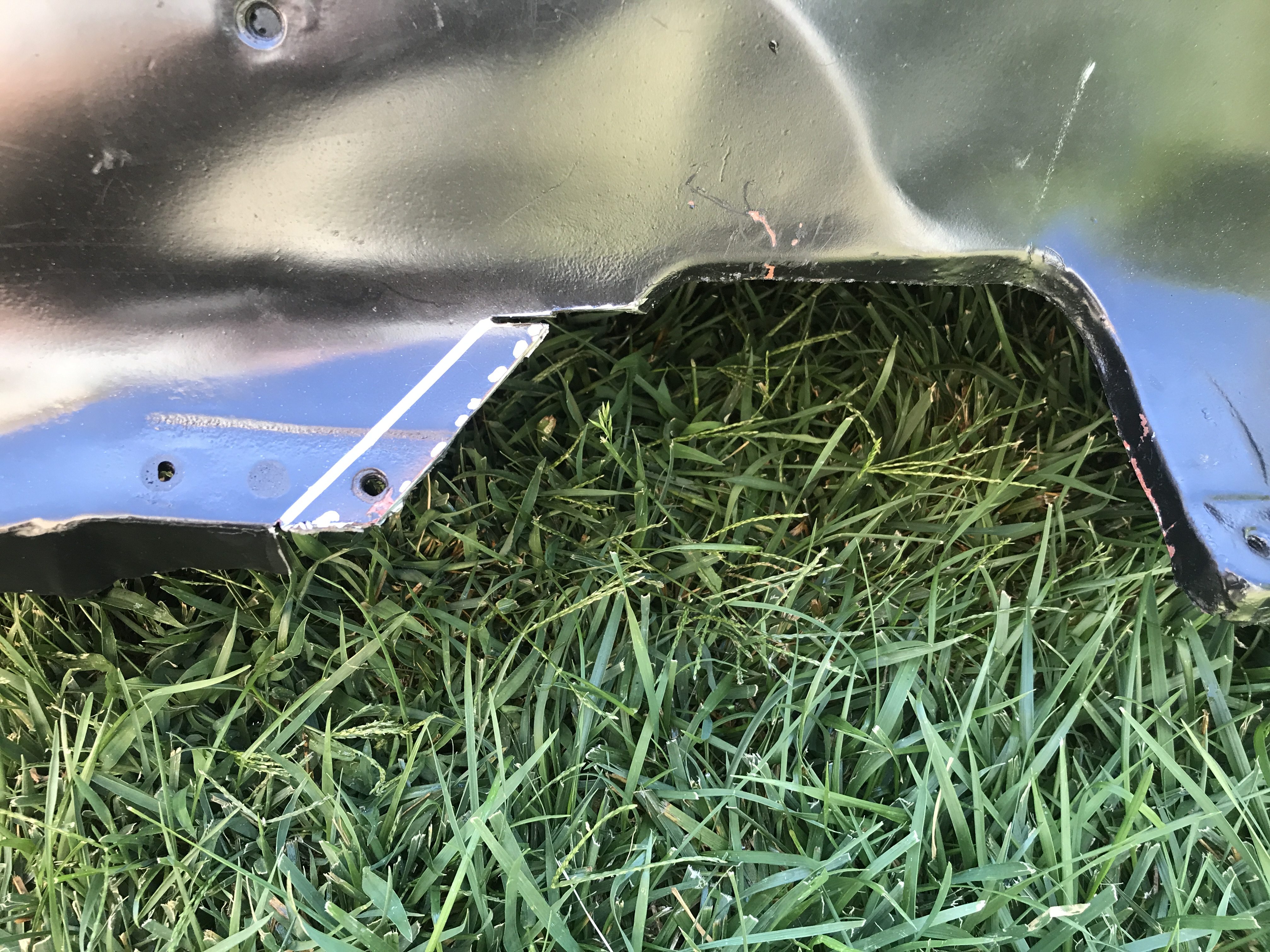

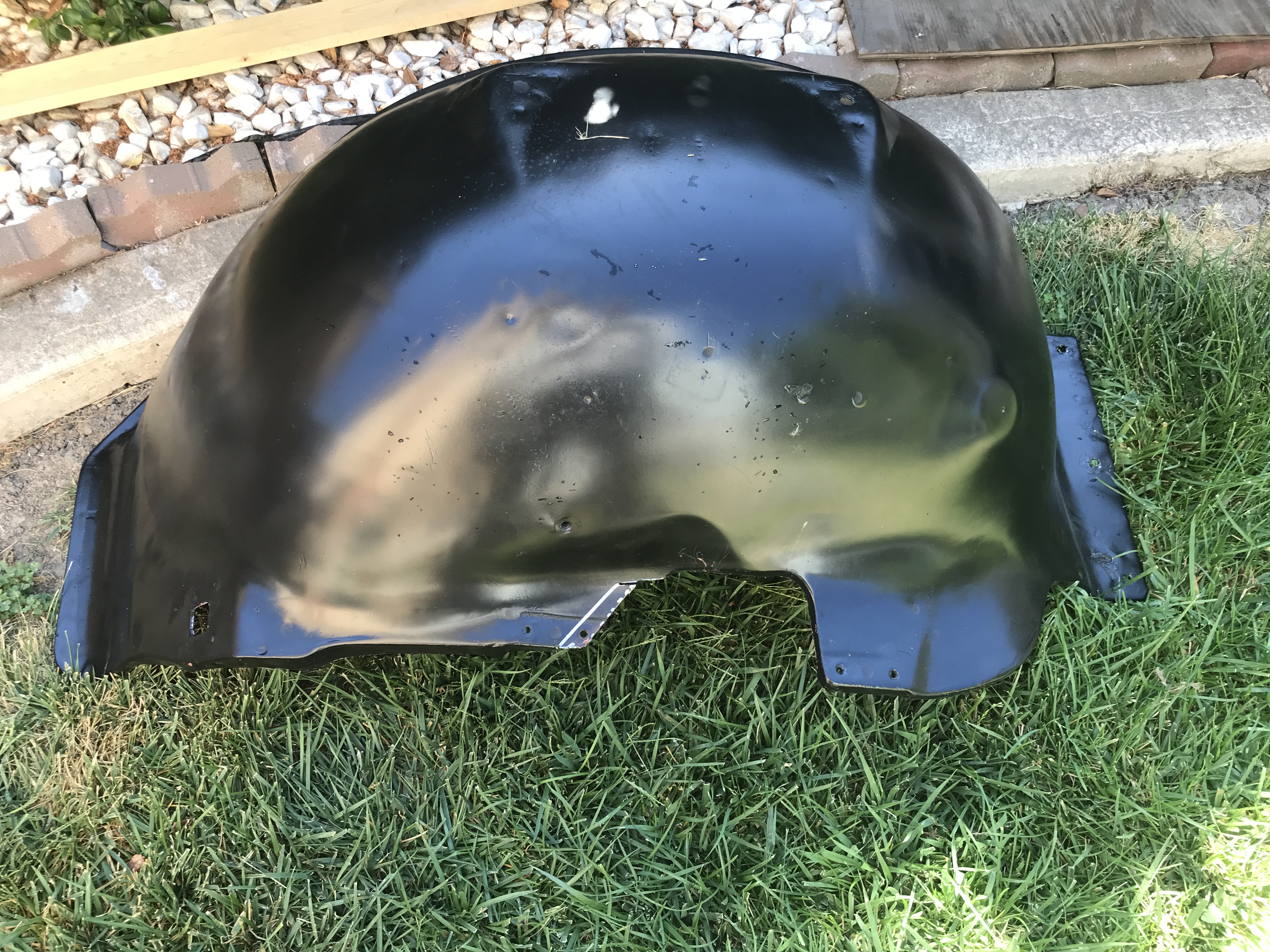

I think I missed my calling as a plastic surgeon
Gregski
Posts: 3161
Post by Gregski »
a 1,000 cuts later...
Gregski
Posts: 3161
Post by Gregski »
good enuff for government work
Gregski
Posts: 3161
Post by Gregski »

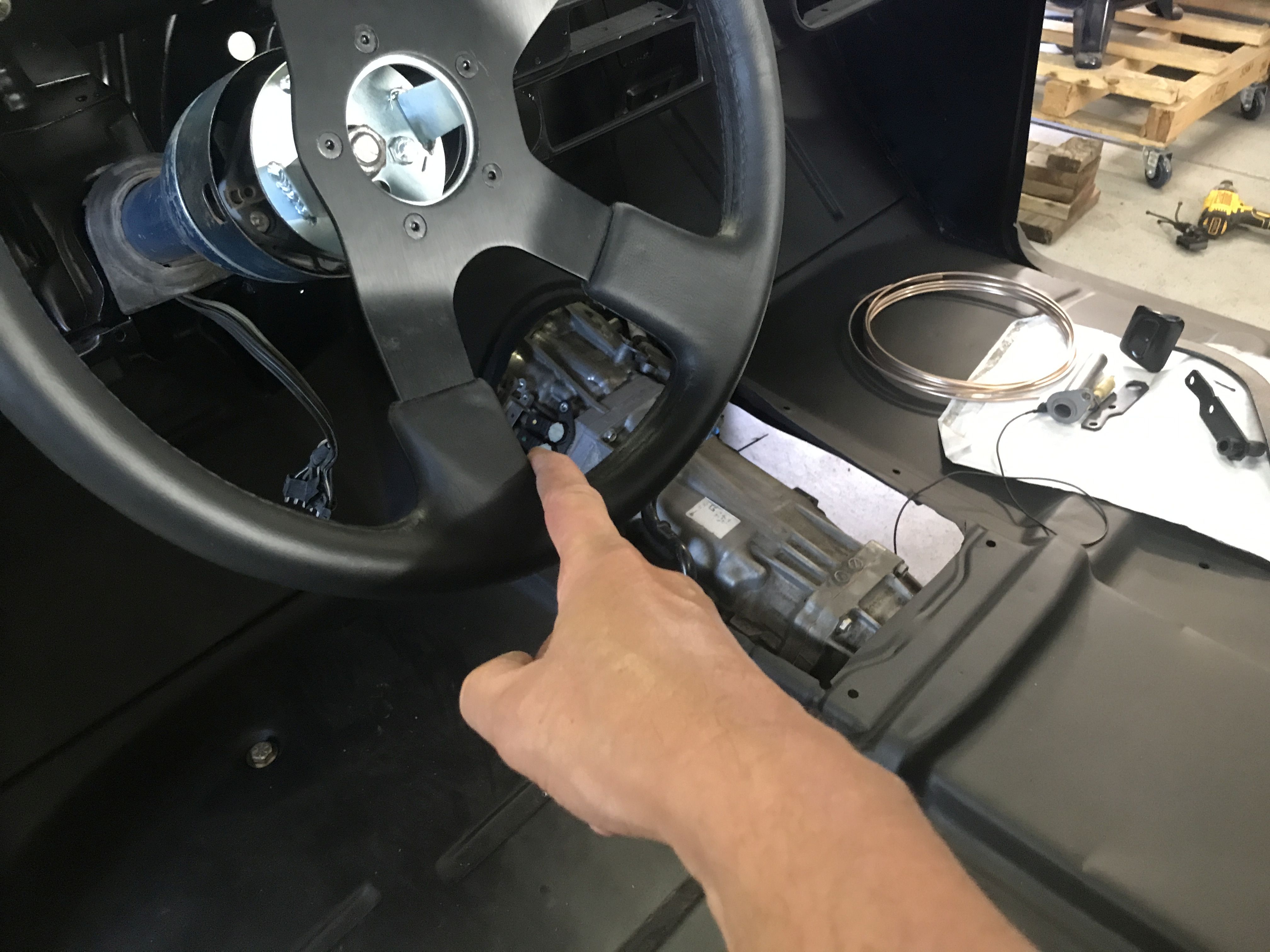

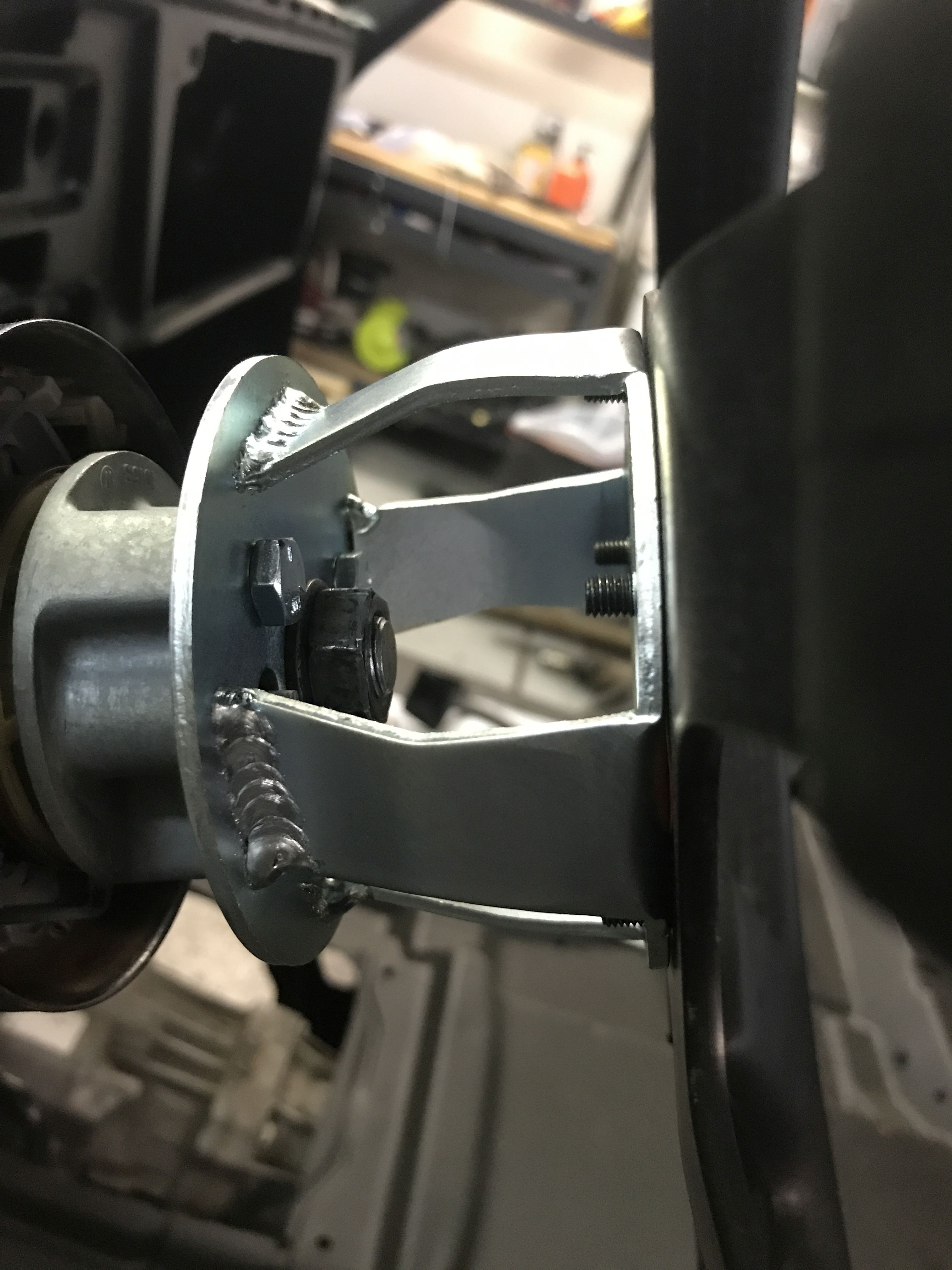

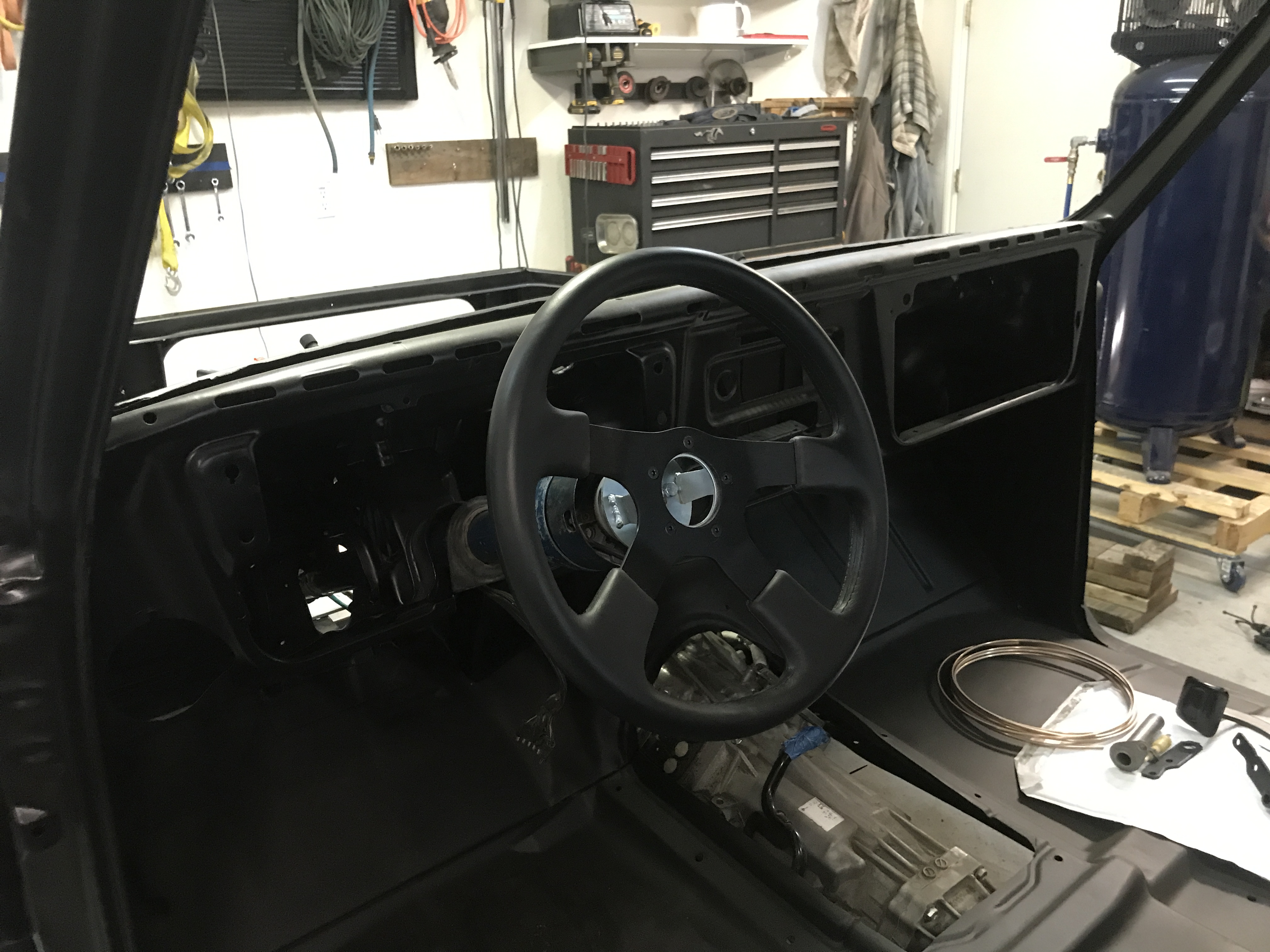

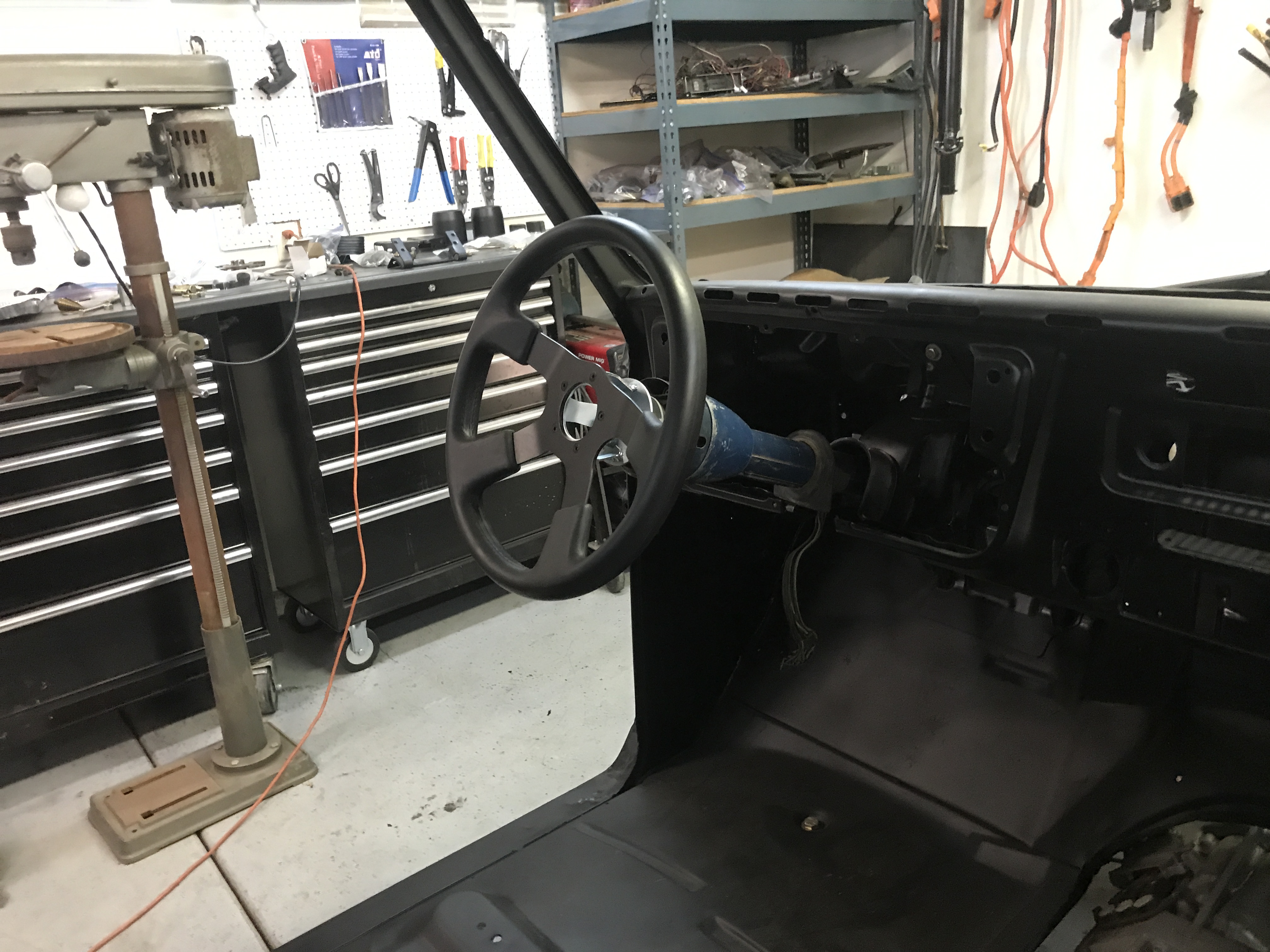

also got the brand new Grant steering circle installed
Gregski
Posts: 3161
Post by Gregski »
though I don't like how far it sticks out, I don't have a back seat to steer from
I'm thinking eliminating the specialized riser all together
Gregski
Posts: 3161
Post by Gregski »
sure, we labored in the blistering garage all day yesterday only for it to completely cool off to only 105°F today
Gregski
Posts: 3161

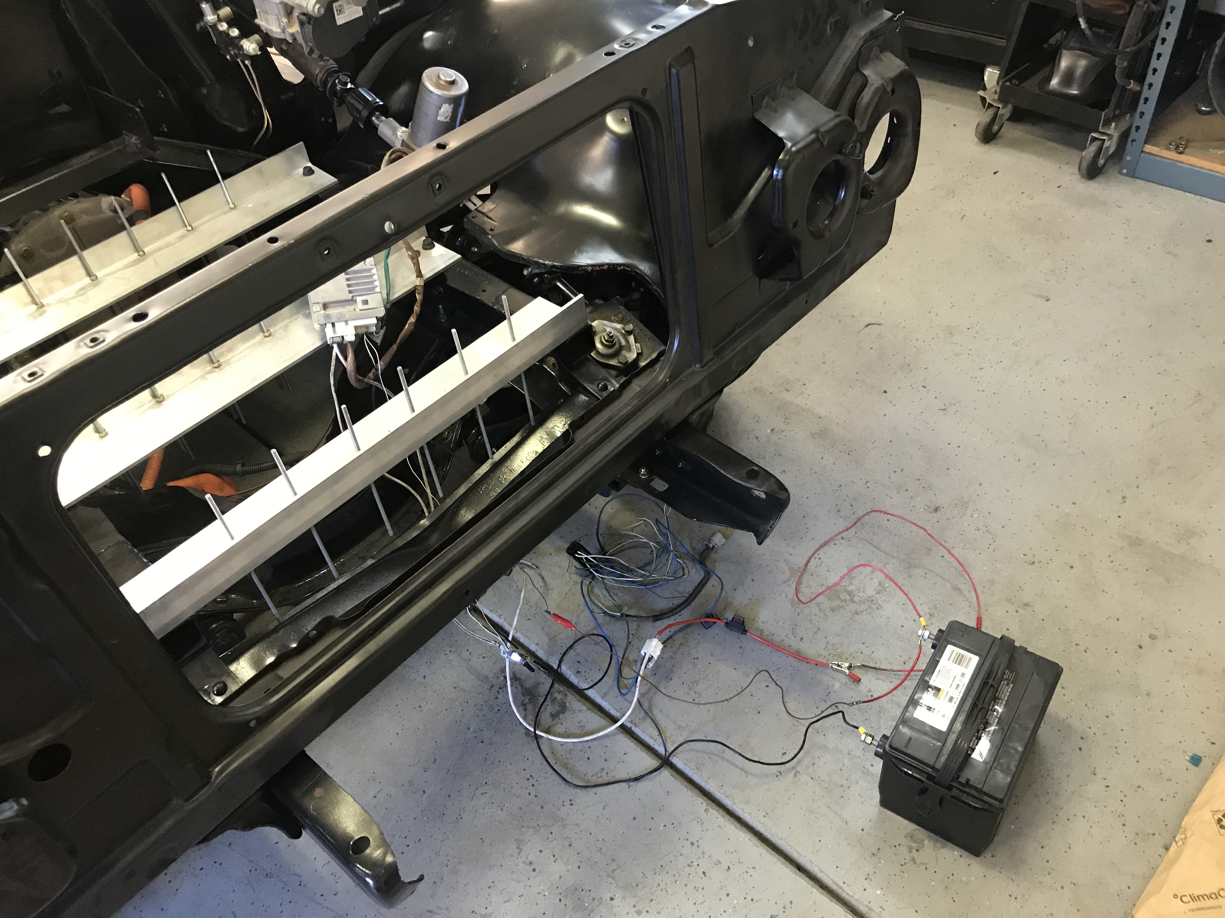

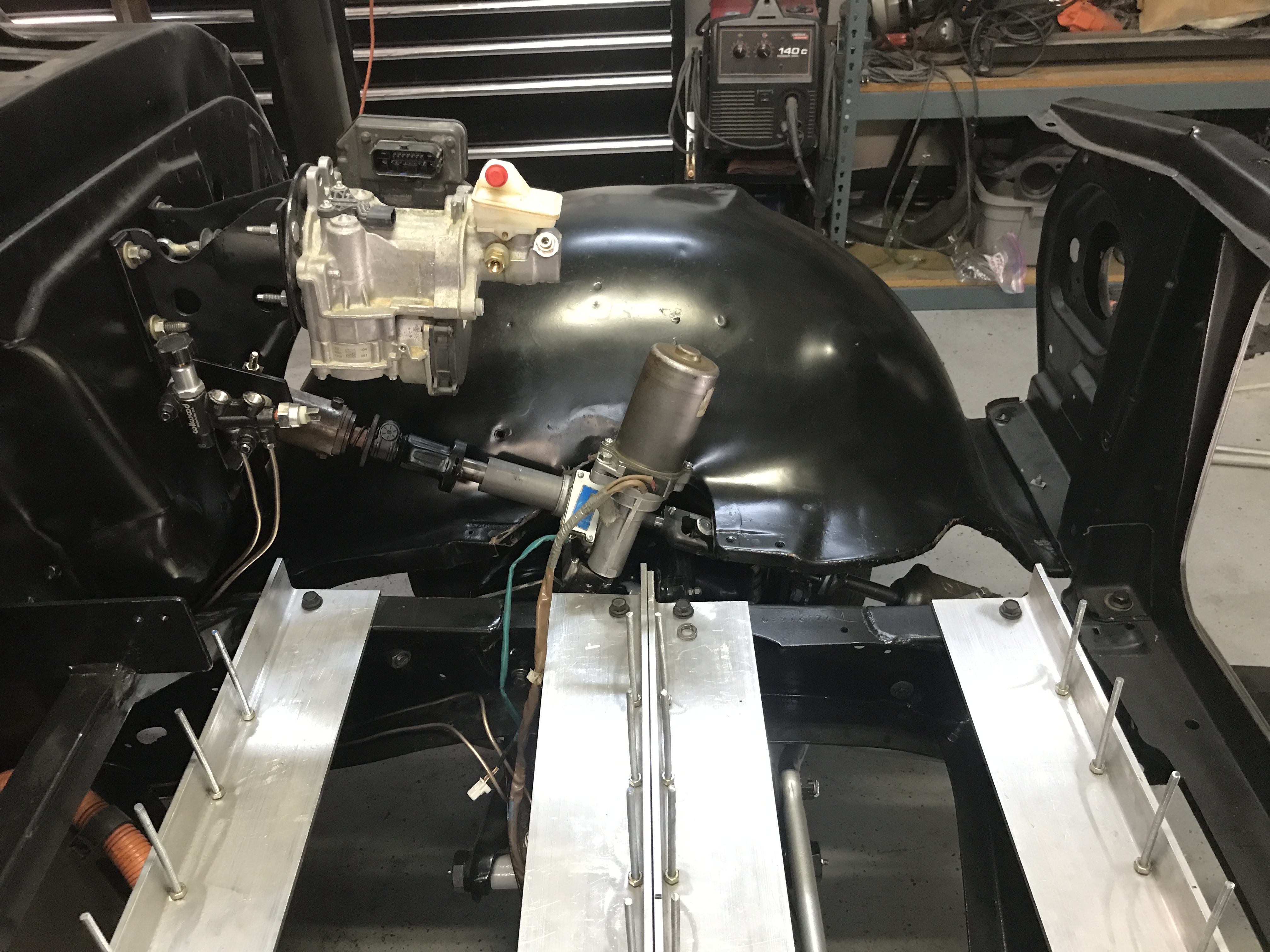

Post by Gregski »
and we got ourselves, one finger power steering, completely CANable Free simply works in fail safe mode, (I believe this means the assist is the same regardless of vehicle speed as opposed to being progressively less as the speed increases in an actual Prius, oh well we'll take it)
Gregski
Posts: 3161
Post by Gregski »
learned how to wire it up from this video

third half of the second gen Prius electric power assist steering combobulation into the 50 year ol' rig
