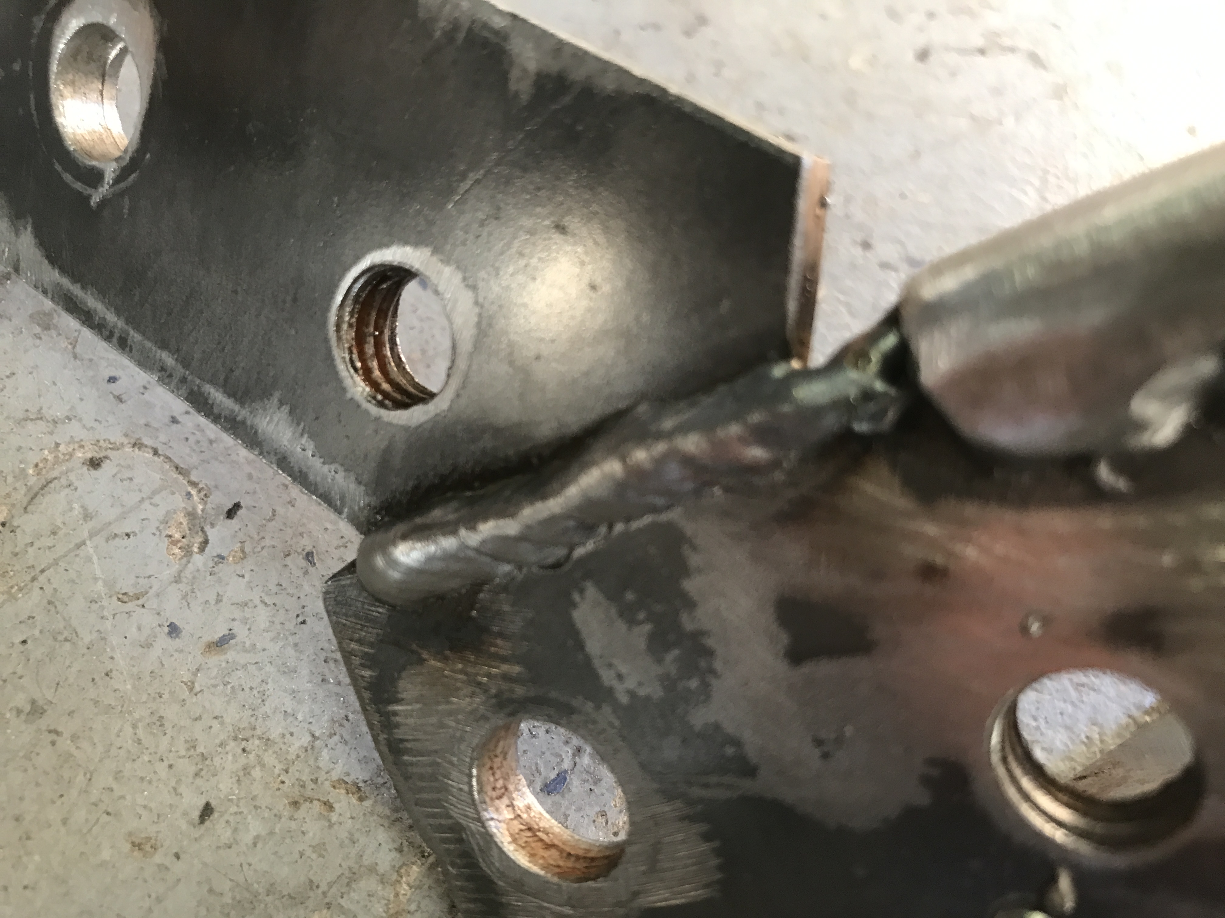

we also extracted the steering wheel shaft from the upper part that runs to the steering wheel
Posted: Sun Jul 17, 2022 3:57 am
by Gregski
then we sliced and diced the north pole
the GM intermediate shaft coupler married to the Prius upper steering column shaft
and poked a hole in it to rosie weld it once it slipped on to the native Prius splines
Posted: Sun Jul 17, 2022 4:03 am
by Gregski
you are going to need a dance partner for the next part
Step 1. cut a bunch or random pieces that look like this
Step 2. welder them all up in any random formation
Posted: Sun Jul 17, 2022 4:09 am
by Gregski
mount it to the frame, and back away 50 feet
Posted: Sun Jul 17, 2022 4:16 am
by Gregski
enuff already mount the damn thing !!!
alright, alright...
mounted it looks great, is strong as hell, and it even turns them wheels
the flux capacitor
The Iron Maiden
It almost looks like a truck again

the Prius power assist project implementation summarized:

also got the brand new Grant steering circle installed
Posted: Sun Jul 17, 2022 6:35 pm
by Gregski
though I don't like how far it sticks out, I don't have a back seat to steer from
I'm thinking eliminating the specialized riser all together

and we got ourselves, one finger power steering, completely CANable Free simply works in fail safe mode, (I believe this means the assist is the same regardless of vehicle speed as opposed to being progressively less as the speed increases in an actual Prius, oh well we'll take it)
Posted: Mon Jul 18, 2022 6:32 am
by Gregski
learned how to wire it up from this video
