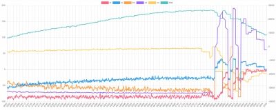

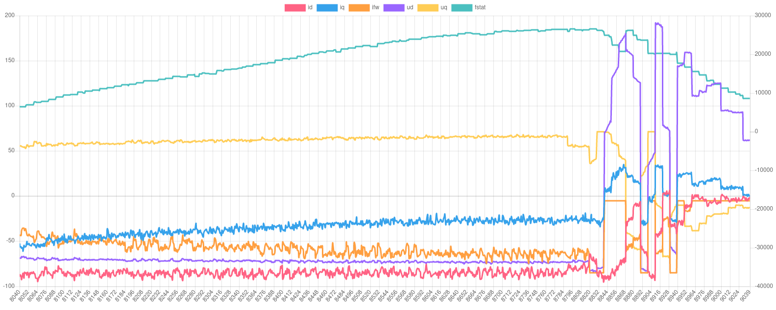

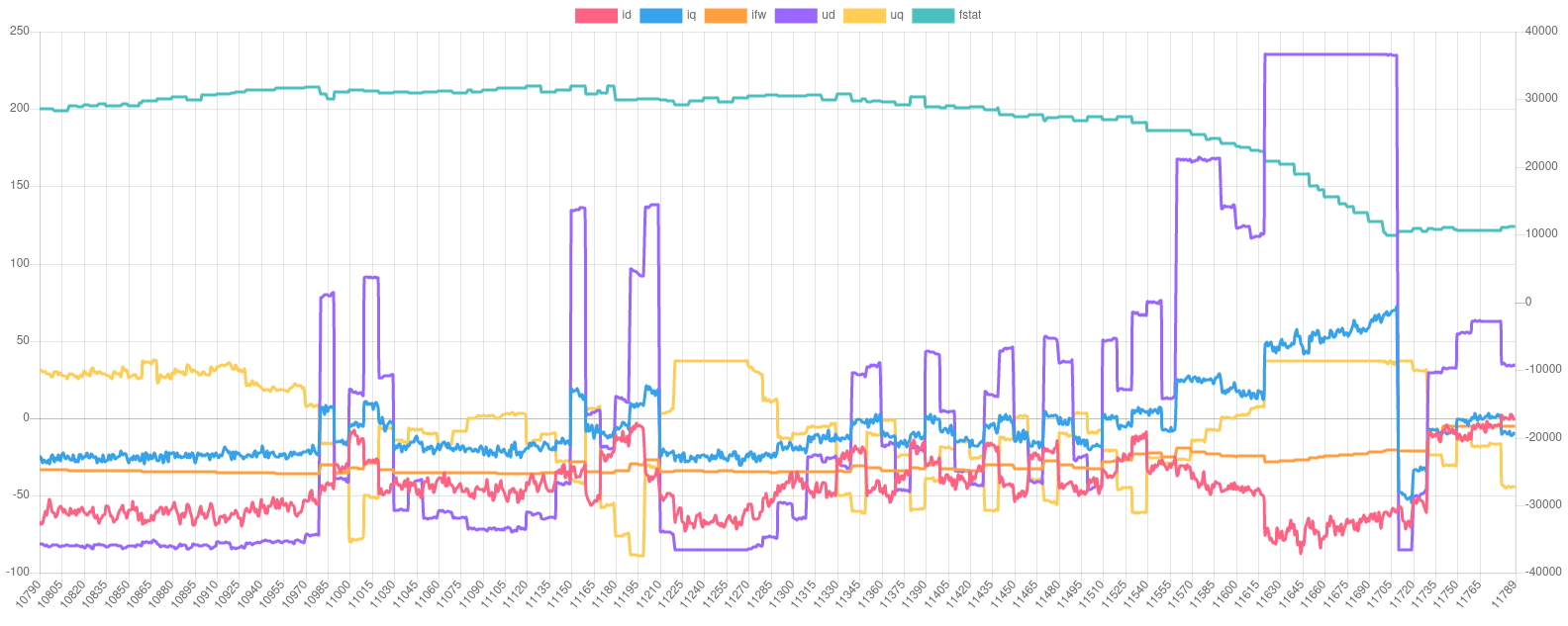

Just noticed in the latest firmware that ProcessCurrents() which calls the Park/Clarke transforms is called before SetAngle(). Is this right, what am I missing?
Been thanked: 1914 times

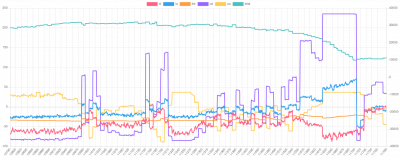

I have made that log you said, just coasting down a hill with regen and FW disabled but various fixed FW currents programmed. At the higher currents I started with low FW current and only switched in the higher value once I was rolling.
The results are rather surprising. Lets look at the 50 Hz value for uq
- ifw=0 -> -7322
- ifw=-20 -> -7352
- ifw=-45 -> -4941
- ifw=-90 -> -11
So at ifw=-90 it looks like we have completely eliminated the rotor field! Even at 100 Hz hardly any voltage is needed to keep iq=0. Then as soon as ifw is lowered to -9A we need uq=-17259 digits to stay at iq=0A. Also once again we see that there is no frequency dependence of ud but when driving with MTPA suddenly there is. syncadv=7 at all times
EDIT: at -90A ifw the inverter tripped out a number of times so you'll see some strange data
EDIT2: while off-throttle regen was disabled brake pedal regen was still enabled. So at the end of each run you see positive iq. And then ud suddenly changes sign and has much higher magnitude. So the two are very closely coupled. That's probably what "dq decoupling" is useful for.
Also did another test drive on a level road. It drives fine at full throttle (although not mighty powerful) but starts doing weird oscillations when trying to maintain speed
audi 2022-10-27.json
(1.5 KiB) Downloaded 339 times
log.ods
(72.77 KiB) Downloaded 313 times
Pete9008
Posts: 1801
Has thanked: 102 times
Been thanked: 351 times
Post by Pete9008 »
Thanks for doing that, it looks like it ties in well with the maths :)
It does suggest that either the motor Ld is lower than we thought, or the flux linkage is higher. The values we were working on would have suppressed the field at 45A not 90A. Some of it could be due to core saturation but i doubt that much (especially on only 90A of Id). Maybe 150mWeber and 2mH plus a bit of saturation.
If you are comfortable going a little higher it would be really interesting to see if the voltage increases again with more than 90A?
Could the oscillation be when the Id goes above 90A and the field start coming back? There would be some odd effects when the current crosses Icrit.
Edit - what's dq decoupling?
If its started tripping then going higher would be a bad idea. Wonder if the tripping is because the loops don't like the phase reversal on uq?
Pete9008 wrote: Thu Oct 27, 2022 4:41 pm Could the oscillation be when the Id goes above 90A and the field start coming back? There would be some odd effects when the current crosses Icrit.
Never goes above -90A so I don't think that's it. Seems to get to the point where ud changes sign. The car felt like the plot looks. Accelerate, decelerate.
Pete9008 wrote: Thu Oct 27, 2022 4:41 pm Edit - what's dq decoupling?
It a feed forward method to anticipate the coupling of d and q, it's in one of Dave Wilson videos, don't remember which one.
Pete9008 wrote: Thu Oct 27, 2022 4:41 pm If its started tripping then going higher would be a bad idea. Wonder if the tripping is because the loops don't like the phase reversal on uq?
No phase reversal, it randomly tripped while just rolling. Not sure why.

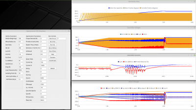

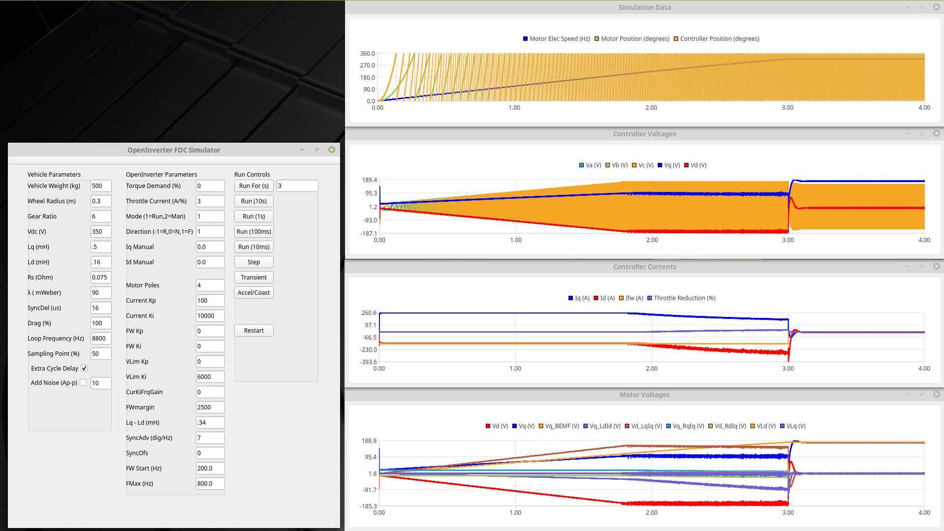

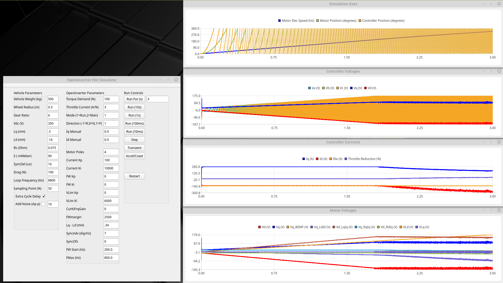

Couldn't resist giving Wednesdays code a quick run with just the voltage limiter controller enabled (FW controller disabled), before starting the changes ,to see whether the idea worked and it looks very promising :)

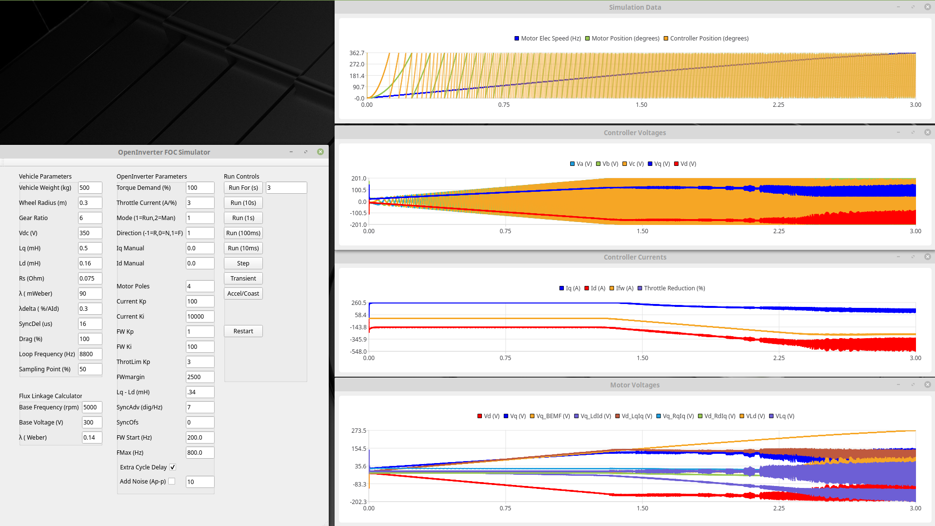

This is the same code that runs the high L motor but running a low L motor.

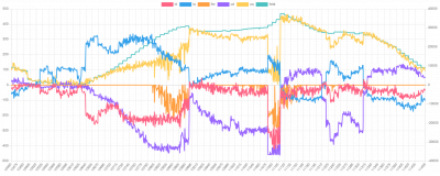

First a plot (taken from an earlier post) showing the old code:

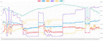

And a plot showing the same run but with the new controller:

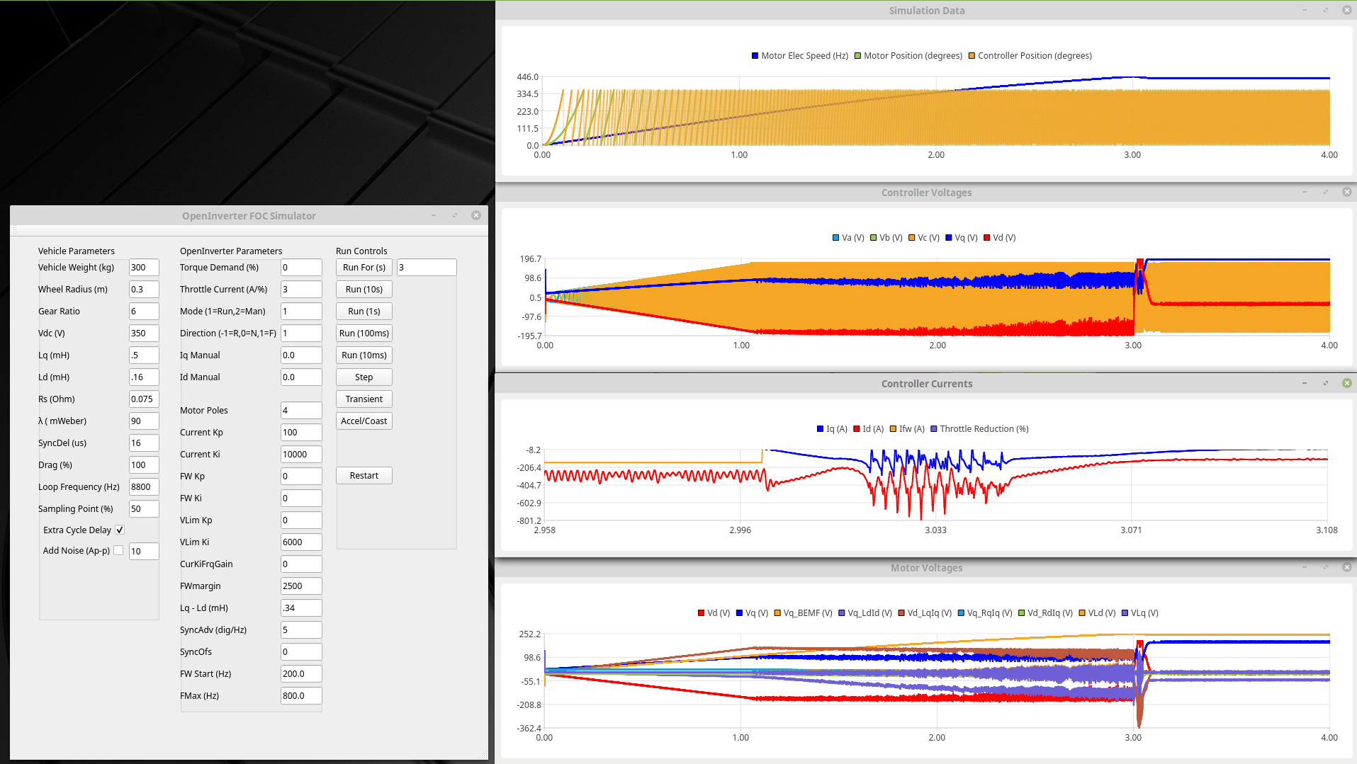

And a run showing the coast still works fine too:
Going to call that a sucess!
Couple of points worth noting. First the limiter comes in a little later (because it aims for a lower margin than the FW controller) and second the terminal speed is slightly lower. This might be due to a change in the model (there was a bug with the flux linkage updating in the model so not sure whether the motor was actually using the shown 90mW or 150mW in the first plot) or whether this is due to the slight performance reduction inherant in just using the limiter (mentioned in an earlier post). I'm going to add an Iq/Id polar plot to the simulator to make it easier to see what the operating point is doing during the simulation to see which it is.

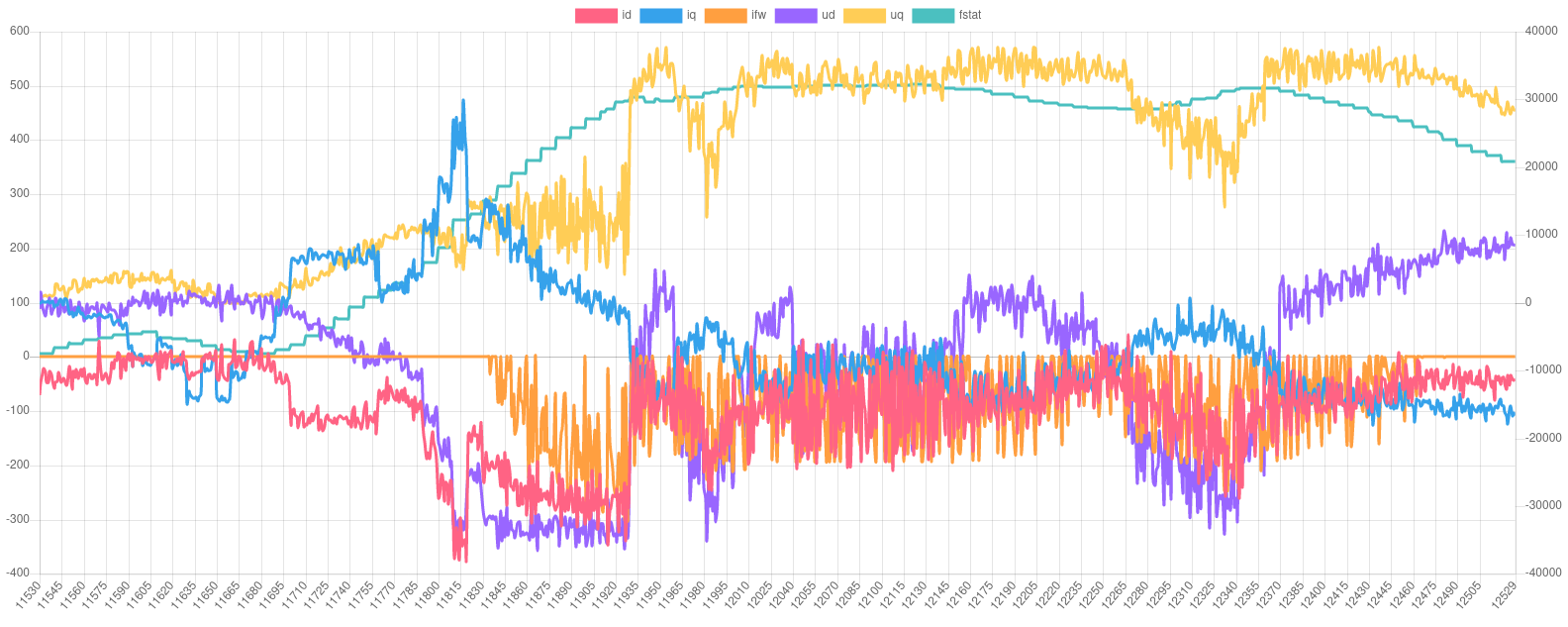

Pete9008
Posts: 1801
Post by Pete9008 »
And one more plot that has accelerated to a higher speed (~7krpm) which shows detail of what the currents do at the point where it changes from accelerating to coast:
Id is around -333A while accelerating and changes to -140A when coasting to maintain control of the bemf (bemf of 250V reduced to the max inverter voltage of 190V). There is a bit of oscillation during the transition suggesting there is still a bit of work to do on the controller gains but overall not too bad :)

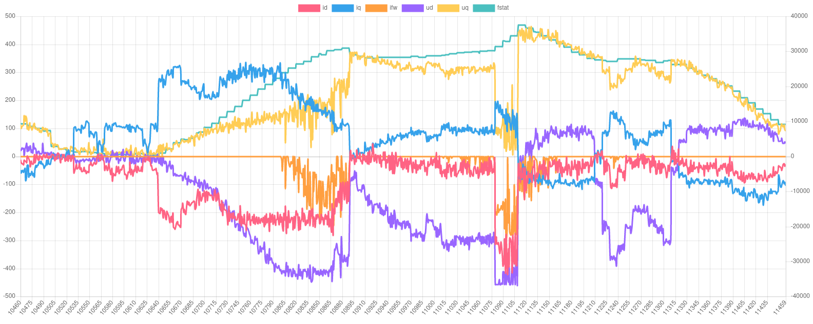

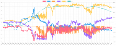

Also been out driving with yesterdays change
Drives well but doesn't like coasting
And doesn't like low throttle. Full throttle and regen work fine, no unwanted regen.
But unwanted acceleration. This seems to be clearly down to uq being limited to the negative. Don't quite understand why it wants to go negative.
I reached 120 kph on that one :)
So I should allow full swing of uq once above a certain speed. That will still suppress low speed juddering but won't cause issues in FW.
At one point I set fwcurmax to -90A and it went into unwanted acceleration really fast. Maybe -80A is still too much I don't know.
So in general with this setup it was not possible to coast once above a certain speed. Maybe it's the MIN() function, not sure.
Very keen to test your code once pushed.
stm32_foc.bin
(48.45 KiB) Downloaded 398 times
audi 2022-10-28.json
(1.48 KiB) Downloaded 262 times

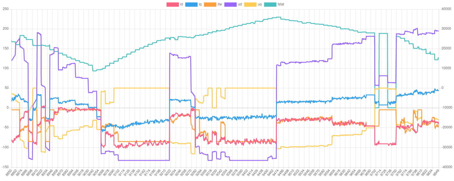

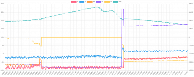

Wow, that was quite something! Flashed that latest firmware on Touran with the amplitude limit revised (not that it makes a difference on that motor, see for yourself)
      if (frqFiltered < FP_FROMINT(30))
         qController.SetMinMaxY(dir < 0 ? -qlimit : 0, dir > 0 ? qlimit : 0);
      else
         qController.SetMinMaxY(-qlimit, qlimit);
First, a subtle try with throtcur tuned down to 3 and ocurlim to 500 in to be able to kill off unwanted acceleration with the current limit:
At around 300 Hz you see FW come in slowly
Then with the normal parameters downhill and up to 500 Hz. Performance is spectacular for my standards, no problems transitioning to regen and out of regen, no controller saturation. Just wow :D
Admittedly current waveforms don't look pretty but at least they work.

Looking good :D
Sorry, I've had a bit of a slow start to the morning. Got thoroughly fed up with resizing all the simulator windows every time I restarted it do decided to make it save and restore the window states and geometries. Should have only been a 10min job but took most or an hour! Working now though.
Removed the FW controller and it all looks good. I've also figured out how to make the one controller give the best of both worlds by making use of the remaining margin on the q and d controllers to change the trajectory of the operating point slightly so going to try that now.
Edit - that code on the uq limit dependant on speed is a good idea, I'll include that!
