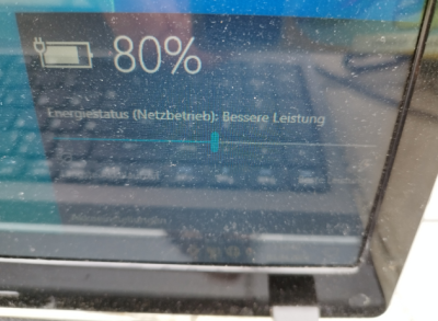

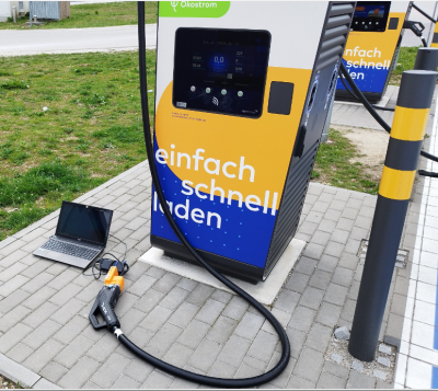

Re: Develop a QCA7000 board?
Posted: Wed Apr 03, 2024 5:11 pm
by uhi22
Foccci for laptop charging
Laptop during DC charging
The laptop power supply had no problem with the DC current.
