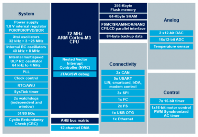

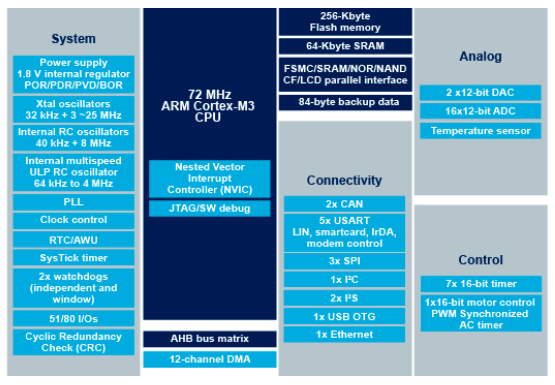

The F107VC also has 2 DACs and 2 CANs. That said, for mysterious reasons the STM32F411VET6 is only $3.70 as opposed to $17 for the F107

Prices are all over the place at the moment, and the cost of the stm32 is not really going to put us off!
I think the best course would be to just pick one and regroup in a year when the prices and availability stabilise.
Plus with the 107 and it's dac's Damian has the possibility of macking some tunes on the inverter 🤪
Posts: 4005
Been thanked: 1126 times
Yep thats the plan. Found the DACS on the f107. Under "Analog". Duuhhh. I'll feed em into a dual audio amp.

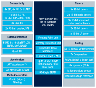

I just read a thread about a nice board.
And if we would go one CPU bigger then that board it would be: STM32G473VBT6
Its a JCL part, its in stock. Costs $10,- has 3x Native CAN's, many timers. PWM signals with dead time etc. it comes from the same series as the STM32F107
We should check the libraries. I do agree this will be a V2 cpu.

Ok, i checked the libraries and the G4 is not very much supported. Saying that i don't think its allot of work plenty of examples to get the hang of it.
Comparison:

I've not used the "G" series before. They look very interesting, but their CAN is FDCAN whereas the "F" series use BXCAN. Multiple 16 bit ADC looks pretty cool. I wonder if it may be too much of a departure from the F series as an early consideration.
I of course agree with Damien that the F107 (F105V) is perfectly suited, as long as stock is available.
Posts: 4005
Alrighty, First full day on the design. Got the f107 and peripherials drawn out. We'll have :
2x HS CAN
1x HS/SW/FT CAN via MCP2562 / NCV7356 / TJA1055
1x LIN optionals master/slave via TJA1020
2x DACs boosted to 12v swing via TDA2822 Audio amp
2x AD5160 digital pots
And had a shot at a pinout. Didn't take long to fill up 56 pins :)
