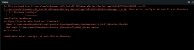

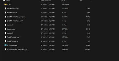

I'm trying to compile a revised version of the Volt BMS code (thanks to amsmntparks), and I'm running into a library issue. Specifically, my Arduino IDE can't seem to find freeRTOS, which is referenced in one of the ESP32 libraries that is referenced in one of the BMS libraries. I've downloaded every possible version of FreeRTOS that Arduino's library manager has, and the issue persists. Does anyone have a version of the freeRTOS library that will work?
EDIT: I'm trying this on another computer, and have hit a different weird issue. It says that the config.h file doesn't exist, but it is definitely in the folder. Any ideas?

Not sure about the freeROTS issue, but rename your config.H to config.h and it should work. I don’t think GitHub picks up the case change when you commit but Arduino does. I’ll force a fix when I’m back home at the end of the month
