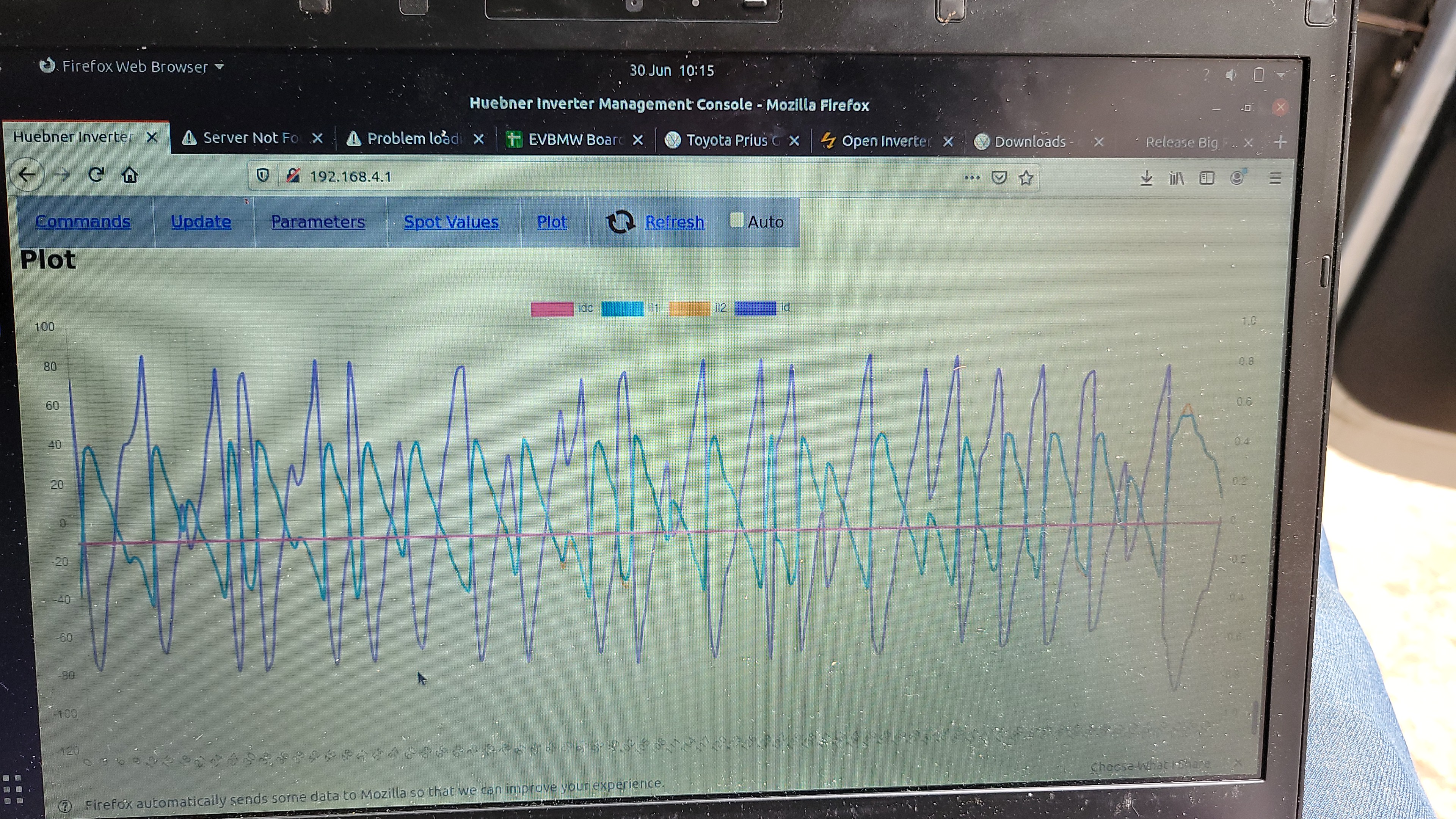

Got the inverter installed in the car with the Outlander motor (same as @Bigpie) and two BMW PHEV modules (~114V together). Turning the wheels manually with the car in gear gives me decent resolver readings.
In Run mode a little throttle produces inverter whine and the motor tries to turn the wheels. I assumed syncofs needed tweaking.
But in manual mode I didn't get any whine when adding manualid. And when I dug a little deeper, my current readings seemed to be all over the place.
See image attached which shows idc, il1, il2 and id in manual mode with zero manualid applied. Apologies for poor image quality.
I'm guessing some issue with current sensors? Will be checking voltage supply and continuity but any other pointers very welcome.

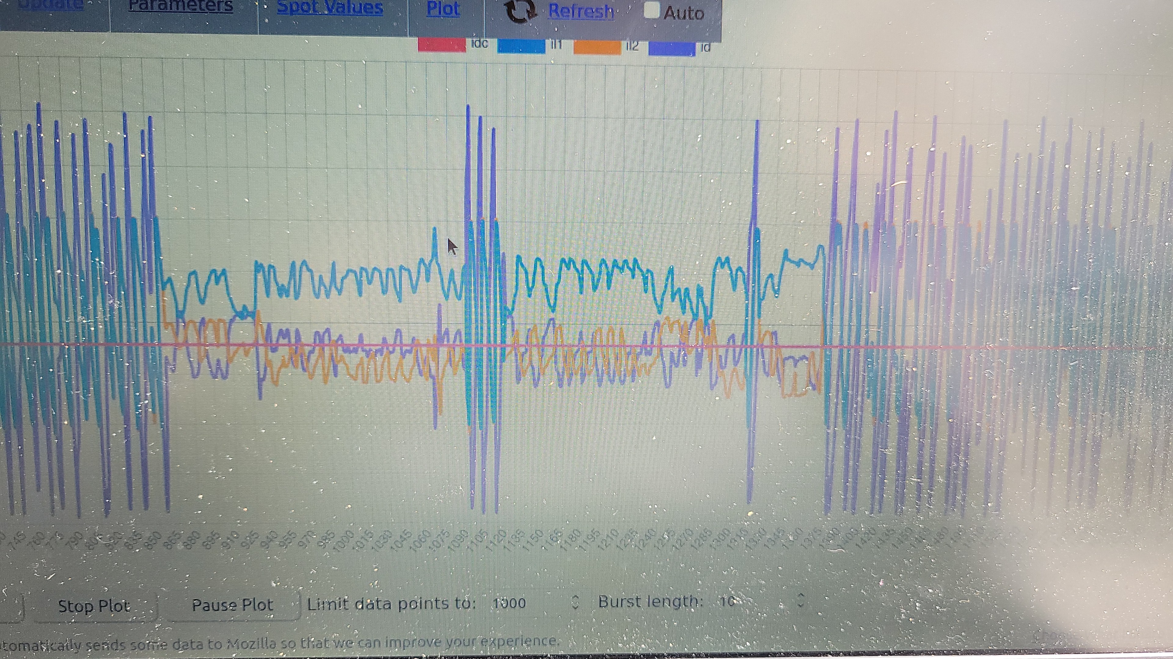

For reference I've also posted plot from run mode with and without a little throttle (the more consistent readings are with throttle applied).

Following up on my last post, I've swapped out my boards for a spare which had better readings on the -5V. I've installed a bulb again for testing. But still can't get manual run to work.
I can spin the wheels (slowly) in run mode, and with the the lamp connected, that lights up when the pedal is pressed (albeit not very much and it doesn't seem to get brighter as the pedal is depressed). But when I put it in manual run and add some manualid, nothing happens. No whine, no lamp.
Any suggestions welcome.

When you put the inverter in manual run did you have the direction chosen to forward?bobby_come_lately wrote: ↑Sat Jul 03, 2021 3:21 pm Following up on my last post, I've swapped out my boards for a spare which had better readings on the -5V. I've installed a bulb again for testing. But still can't get manual run to work.

Lots to think about - thank you. Short answers at half time in the football:m.art.y wrote: ↑Sat Jul 03, 2021 7:07 pmYou should, wondered if you were not putting it into forward direction. Johannes inverter will not produce any pwm if direction is not chosen including manual run mode. Do you get any error codes at all? Can you share your settings? Has this inverter experienced a short circuiting event on the -5/5v line? If you suspect current sensors are damaged that might be how it happened. Did you ever change firmware/settings/wiring including phase wiring order since the last time you had ir properly running?
- No error codes
- No short circuit event on those lines that I can think of. Trying to borrow a spare inverter to test that
- Settings have probably changed - and hardware now. Was nervous about doing much FOC testing before the motor was hooked up to something so this is really first proper testing. But manual run definitely worked before.
- I've largely been using @Bigpie's settings from the parameter database so they're pretty consistent https://openinverter.org/parameters/view.html?id=18. From these I've changed syncofs, udcgain, and pot settings.

Right, mucking around again this morning and tried downgrading firmware from 5.05 to 4.96. Instantly, everything worked:
- manual mode worked as it should, could hear inverter whine straight away and current readings were responsive
- throttle response in run mode with syncofs set was exactly as it should be
My daughter and I are absolutely buzzing now. Can't wait to get this thing on the road.

Fantastic result, very well done! Amazing to see the wheels spin. Did you ever get to the bottom of what was causing the resolver reading to continually peak and trough?

I think I just had it wired wrong. I've added a load of detail to the motor page on the wiki now that I know I have it right, including references to the original loom wiring colours and where it connects on the OI boards.

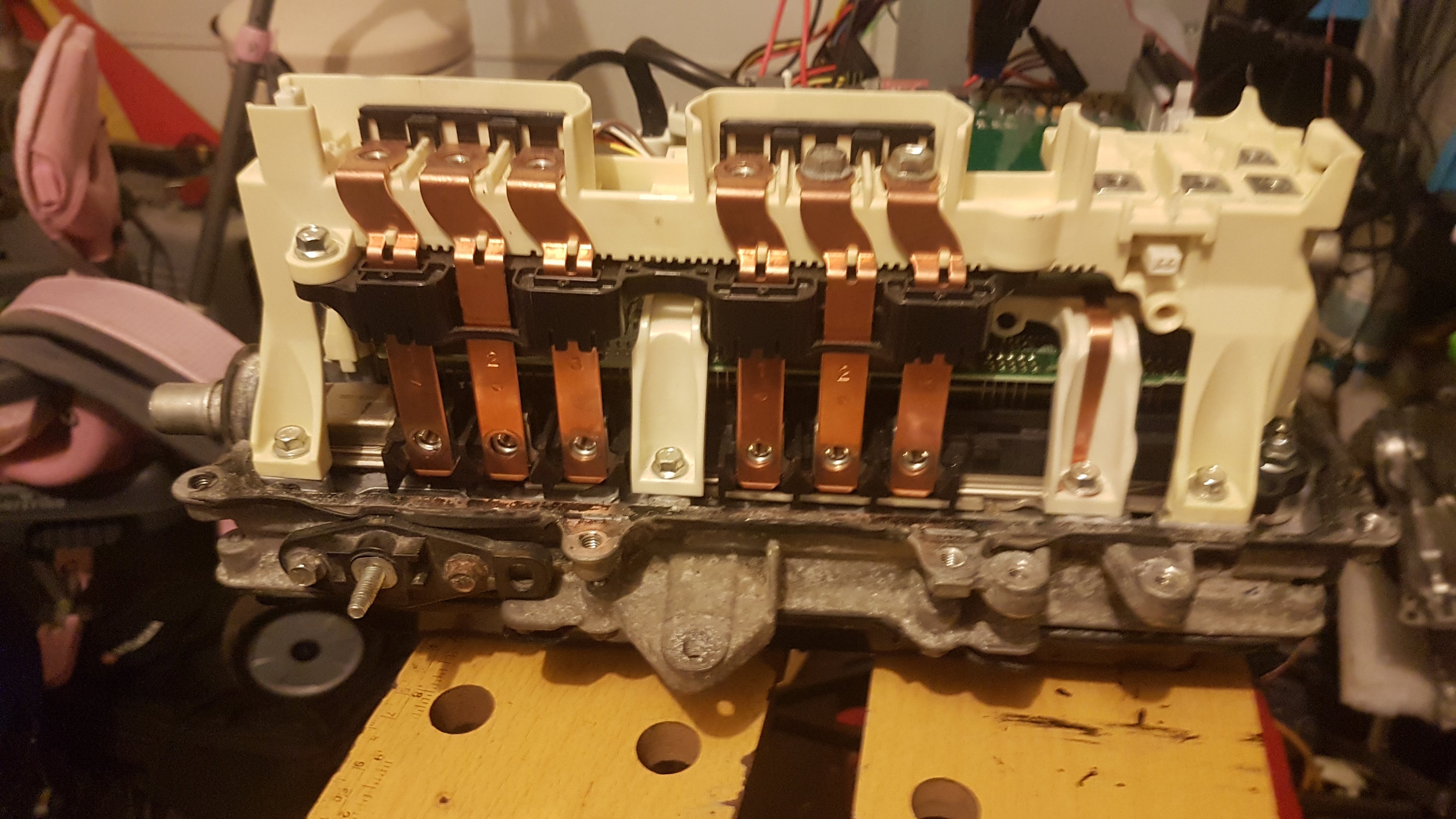

- Posts: 1884
- Has thanked: 91 times
- Been thanked: 517 times
Guess who was doing it wrong?
Missing bolts on the lower phase connections will cause intermittent working motor.
9 times out of 10, user error

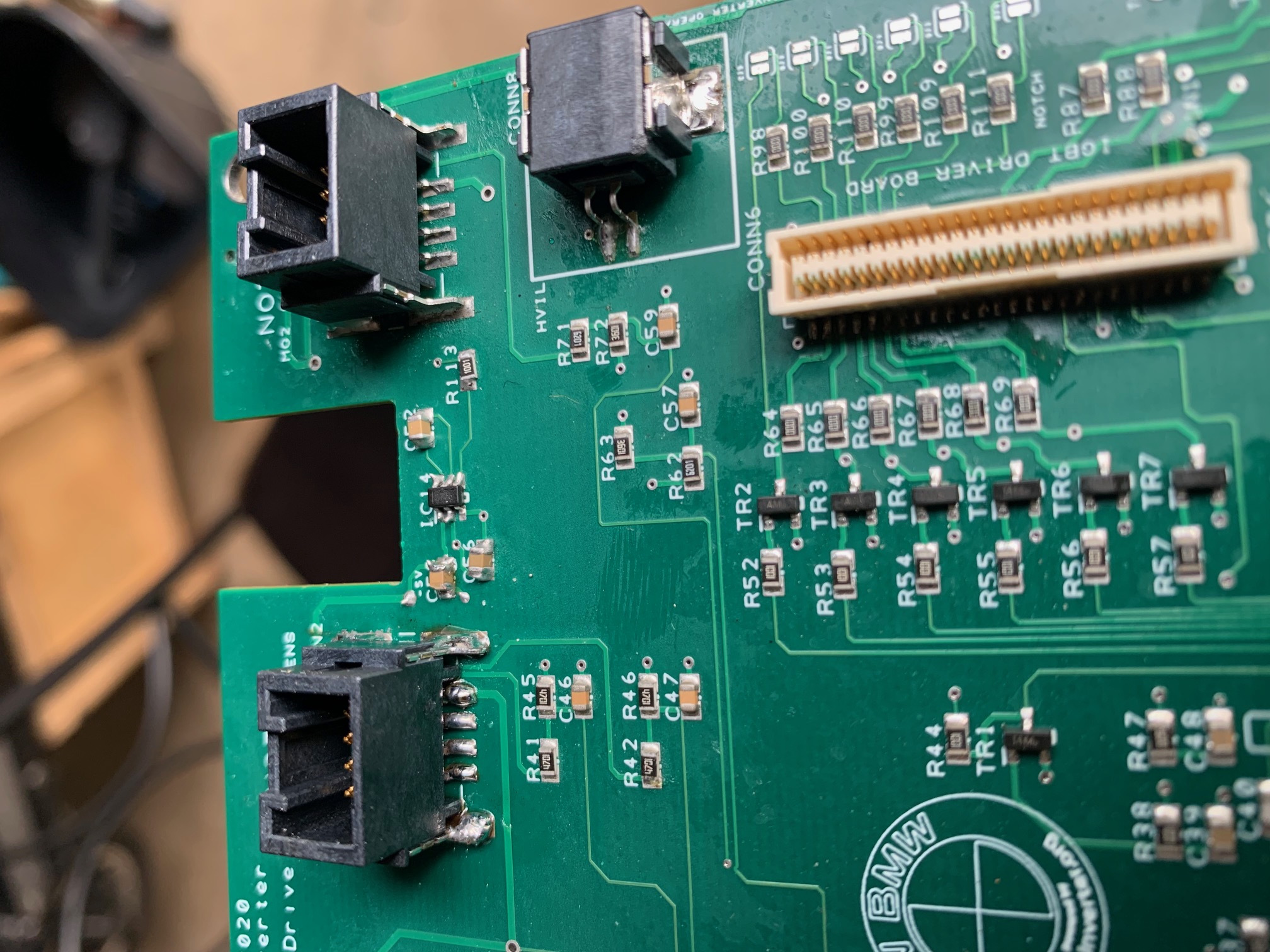

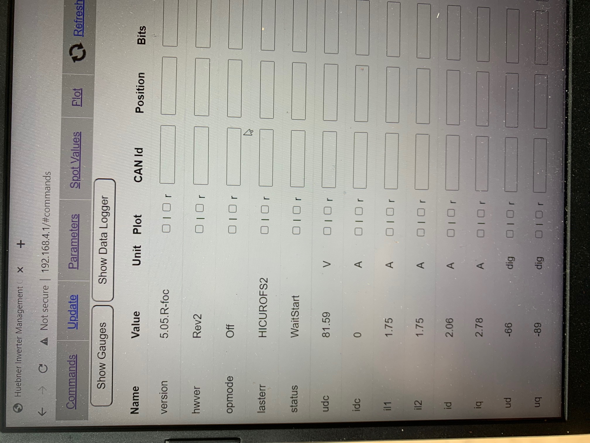

Can someone help me determine what could cause HICUROFS2 error and complete FULL battery current injection when a throttle input is given. The inverter current sensors are working properly when I switch V1c boards with the same FOC parameters the inverter functions with full control. I also verified the MG1 and MG2 sensor connectors are properly soldered and all voltage rails have correct voltage levels. Thanks

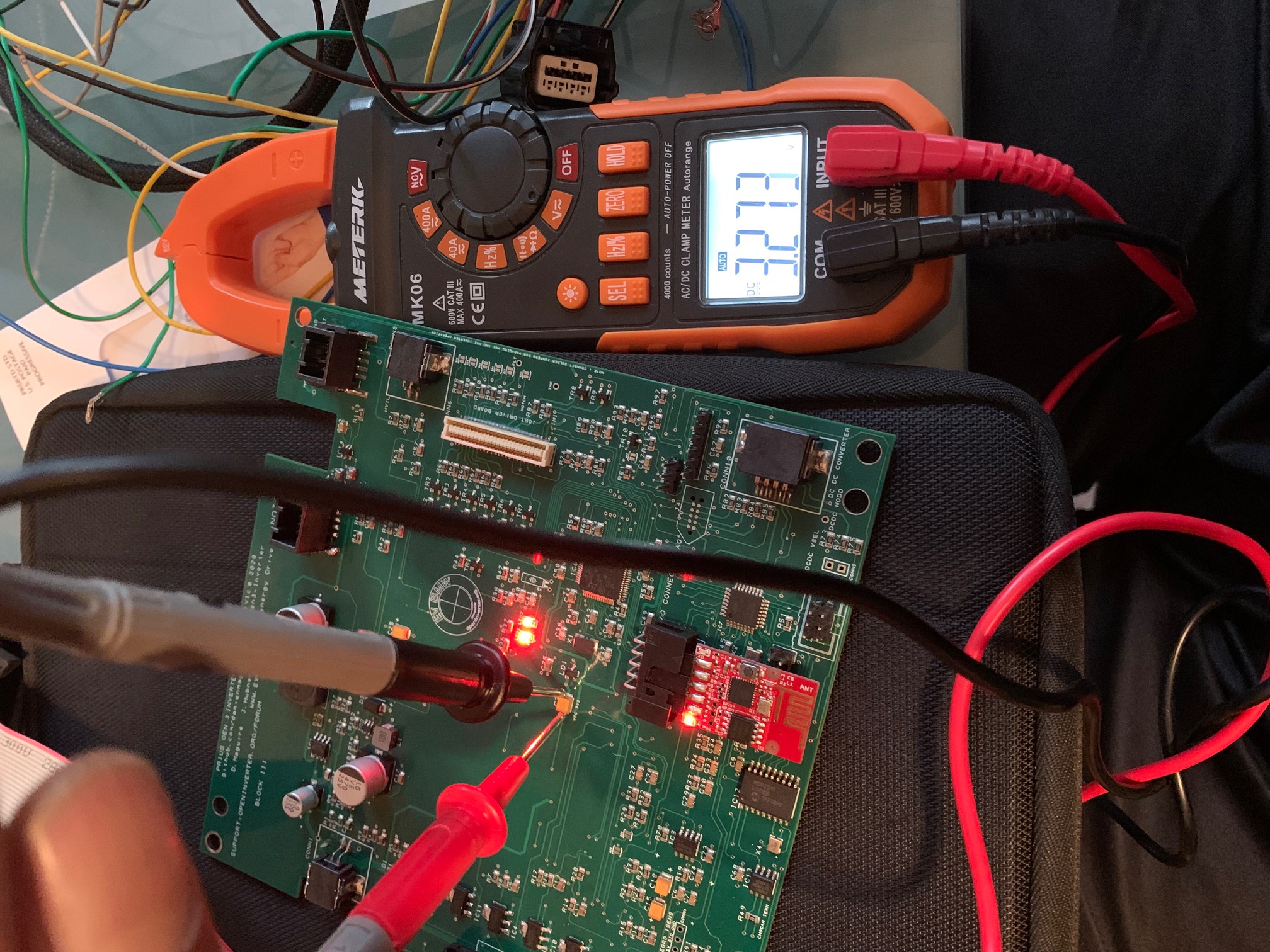

invokeperformance
- Posts: 45
- Joined: Fri Feb 14, 2020 4:23 pm
- Location: Atlanta
is 3.273v acceptable deviation on the C32 3.3v supply? I also have -4.95V on Connector 7 (mg2 current sensor ). Could this voltage difference be the cause for the HICUROFS2 error?

When looking in the link below it seem like your current sensor feedback is outside limits. When getting this error, do you have the current sensors connected? If not, try and connect them. If the current sensors are connected, measure the voltage across C57 resp. C59. That is the current feedback voltages.

The current sensors were connected and the board was fully installed in the inverter when I got the error messages. I will check the voltage across C57 and C59 and let you know what I find what voltage should they read?bexander wrote: ↑Fri Jul 23, 2021 6:36 am When looking in the link below it seem like your current sensor feedback is outside limits. When getting this error, do you have the current sensors connected? If not, try and connect them. If the current sensors are connected, measure the voltage across C57 resp. C59. That is the current feedback voltages.

Quoted from the error message page:invokeperformance wrote: ↑Fri Jul 23, 2021 1:55 pmThe current sensors were connected and the board was fully installed in the inverter when I got the error messages. I will check the voltage across C57 and C59 and let you know what I find what voltage should they read?bexander wrote: ↑Fri Jul 23, 2021 6:36 am When looking in the link below it seem like your current sensor feedback is outside limits. When getting this error, do you have the current sensors connected? If not, try and connect them. If the current sensors are connected, measure the voltage across C57 resp. C59. That is the current feedback voltages.
https://openinverter.org/wiki/Errors
"Current channel 1 or 2, respectively, is below 1.23 or above 2.06V when no current is flowing. Check wiring and voltage dividers."
So if between 1.23 and 2.06V it is good, outside means error.
