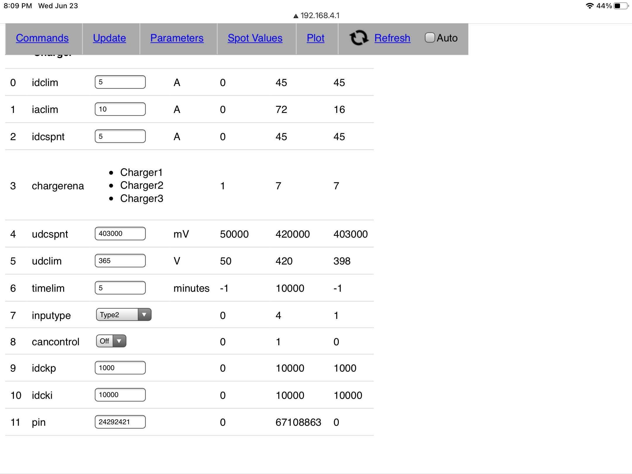

And on a separate note: I was able to run the charger today. :D It was a fun journey and I learned a lot on the way to get it working.
A remaining problem: on the A/C side it rises from 0A to 30A, then the EVSE fails out, and the process starts again, every 15s.
I am using commercial firmware.
variables:
idclim 45A, iaclim 16A, idcspnt 7A
I would have expected iaclim or idcspnt to kick in.

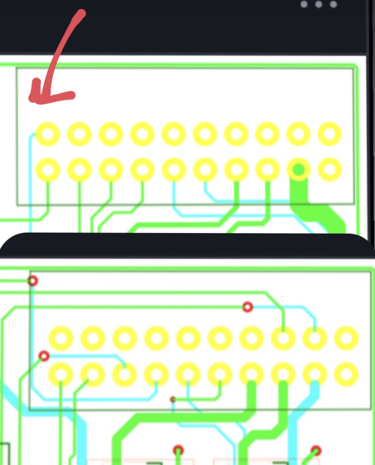

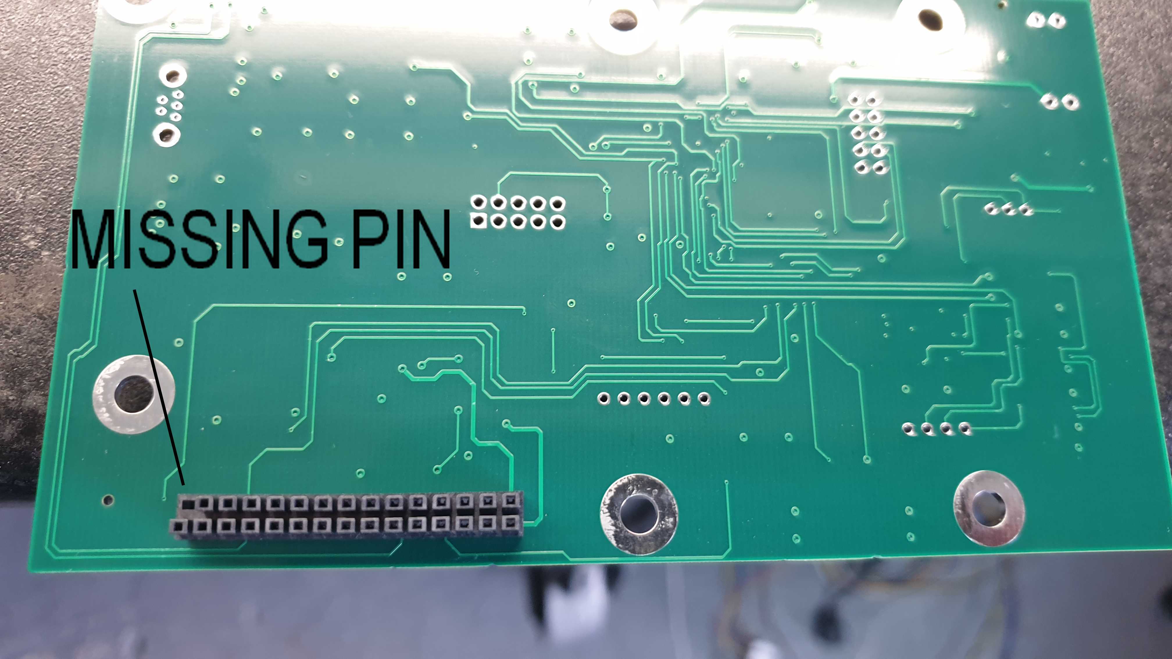

Trying and failing to find a Gen3 (v3) pinout for the 12 and 20 way plugs.
Also the pn for the ecu style shroud... (oops was at the bottom of the BOM... 100% Mybad!)
Can anyone point me in the right direction please? I read elsewhere in this thread that Patreon would contain the design files but I cannot find Gen3 anywhere.
Boxster EV
Posts: 489
Location: UK
Has thanked: 57 times
Been thanked: 49 times
Post by Boxster EV »
ev340
Posts: 39
Joined: Sat Mar 20, 2021 12:06 pm
Post by ev340 »
Thanks but that has the pinout for v1 and 2.
Which appear to be different to v3 and there is no pinout in the v3 folder.
The board schematics for the 20way plug have 12 traces for v1/2 but the schematic shows 11 for the v3.
I’m not confident enough to try to figure out what is what.
Edit:
So to avoid spamming the thread I’ll edit this post with the knowledge I’ve managed to scrape together, hopefully if I get anything wrong someone can point it out. And it might be helpful for the next guy?
The 20 way connector on v3 has traces to 12 and 13 removed because the USB port has been removed, so that makes sense, but the pinout also lists 5v+ To pin 14 which isn’t on the diagram 🤷‍♂️ And something I think I am misunderstanding?
More pertinently v3 diagram has a trace on pin 20 which goes to vss1 on the STM32, so is that a 3v line? To activate the board?
Posts: 3666
Has thanked: 12 times
Been thanked: 350 times
The pinout of the Gen3 charger controller is the same across all version that use the ME MX header :
https://github.com/damienmaguire/Tesla- ... Pinout.pdf
