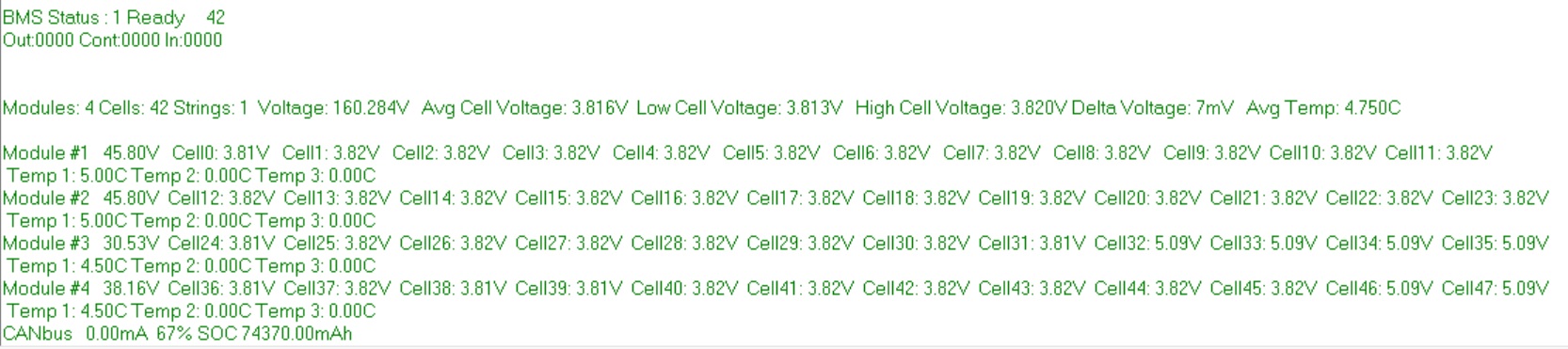

OK, I have a problem that I cannot solve;
I am using original old SimpBMS hardware, the software version is from 11.03.2023
https://github.com/Tom-evnut/VW-bms/com ... er/VWBMSV2
VW BMS V2
problem item: Module #8 (CAN module 4S+4Sdumb+2Sdumb total 10S)
I have 12S(module#6) and 10S(module#8) connected to SimpBMS. They have both worked fine standalone when tested before with old vw code supplied with the simpBMS years ago, but now the 10S shows up as 8S, but the problematic 2S module, that is not showing voltage, is transmitting the temperature via CAN bus.
Shown here with the 2S interconnect wire, temp shows when connected, the voltages are present on the CAN module circuit board too, but not showing on terminal for some reason. I tested other 10S module and other interconnect cable but still same behaviour.
could this be something changed in the code and the voltages for 2s modules are just ignored? the 4S modules work fine as you can see.
Module#6=4S BMS +4S +4S
Module#8=4S BMS +4S +2S
Are the missing 2S cell voltages possibly shown on the canbus debug capture below?
(Module #8 has total 10Cells connected, temp3 is from 2S module that shows no voltages.)
BMS Status : 5 Error     20
Out:0000 Cont:0000 In:0000
Modules: 2 Cells: 20 Strings: 1  Voltage: 76.166V   Avg Cell Voltage: 3.808V  Low Cell Voltage: 3.803V   High Cell Voltage: 3.812V Delta Voltage: 9mV   Avg Temp: 10.333C
Module #6   45.70V   Cell0: 3.81V   Cell1: 3.81V   Cell2: 3.81V   Cell3: 3.81V   Cell4: 3.81V   Cell5: 3.81V   Cell6: 3.81V   Cell7: 3.81V   Cell8: 3.81V   Cell9: 3.81V  Cell10: 3.81V  Cell11: 3.81V  Cell12: 0.00V
 Temp 1: 11.00C Temp 2: 10.50C Temp 3: 10.50C | Bal Stat: 0
Module #8   30.46V  Cell13: 3.81V  Cell14: 3.81V  Cell15: 3.81V  Cell16: 3.81V  Cell17: 3.81V  Cell18: 3.81V  Cell19: 3.81V  Cell20: 3.80V  Cell21: 0.00V  Cell22: 0.00V  Cell23: 0.00V  Cell24: 0.00V  Cell25: 0.00V
 Temp 1: 10.00C Temp 2: 9.50C Temp 3: 10.50C | Bal Stat: 0
CANbus   0.00mA  66% SOC 73260.00mAh
   !!! Series Cells Fault !!!

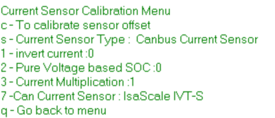

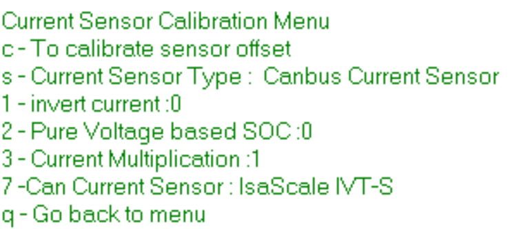

Are there any notes how to setup the IVT-S sensor with the SImpBMS?
I have it selected in the menu:
Have the IVT-S initialised and current transmits via 0x521
But the BMS reads gigantor values...
CAN network is terminated on both ends and reads 60ohms.
royhen99
Posts: 265
Location: N. Wiltshire. UK
Has thanked: 22 times
Been thanked: 134 times
Re: Simp BMS
Post by royhen99 »
I have not used IVT-S with simpBMS but from looking at the code it uses big endian for current and voltage whereas Zombieverter and other OI solutions use little endian.
Posts: 2962
Has thanked: 330 times
Been thanked: 847 times
Re: Simp BMS
The IVTS setup is the factory default that is to be used with the SimpBMS, makes it easy on anyone buying one. No need to change any parameters.
alexbeatle
Posts: 292
Has thanked: 82 times
Been thanked: 35 times
Re: Simp BMS
Post by alexbeatle »
royhen99 wrote: Wed Oct 04, 2023 5:46 am I not used IVT-S with simpBMS but from looking at the code it uses big endian for current and voltage whereas Zombieverter and other OI solutions use little endian.
That's a bummer 😔
tom91 wrote: Wed Oct 04, 2023 9:12 am The IVTS setup is the factory default that is to be used with the SimpBMS, makes it easy on anyone buying one. No need to change any parameters.
tom91 do you think you can add an option in the menu to choose big endian vs little endian to make it more universal with the other OI solutions? Or I'll need to fork the code and learn how to reprogram my unit....
Posts: 2962
Re: Simp BMS
alexbeatle wrote: Wed Oct 04, 2023 3:41 pm tom91 do you think you can add an option in the menu to choose big endian vs little endian to make it more universal with the other OI solutions? Or I'll need to fork the code and learn how to reprogram my unit....
Why did you change the programming of the IDs are there other devices that us it too? Did you not propperly achieve a reset?
Never understood why people changed the CAN configs. If you need it the code is Opensource and I am not making any updates or changes to it myself, forking it will be the only way to get changes. These can ofcourse be pushed back into the main branch when proven.
