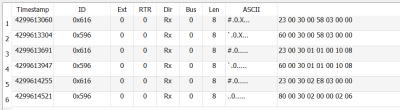

I have managed to break something.

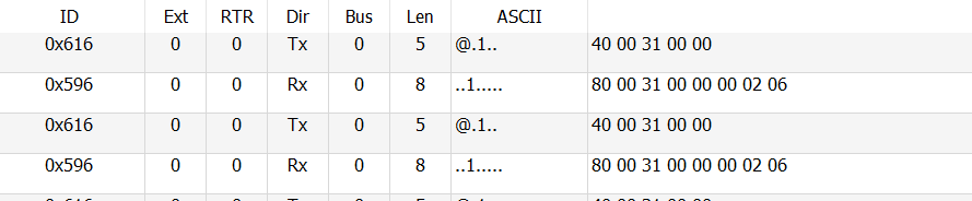

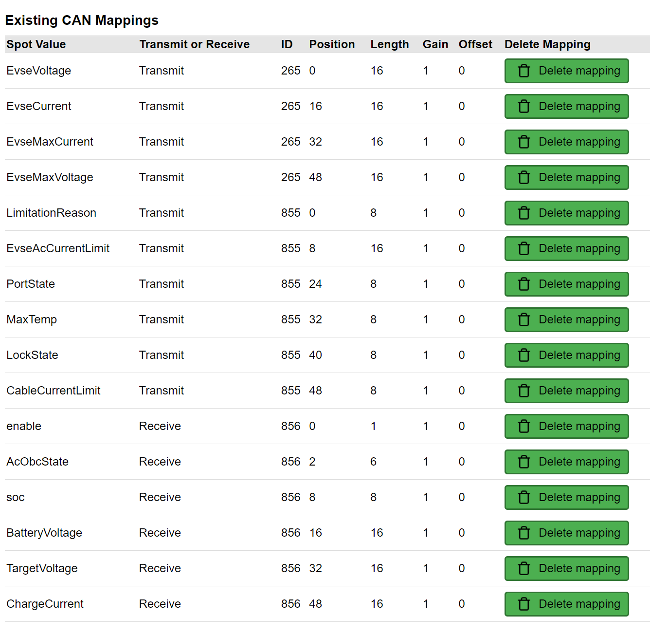

Subindex 2 commits the mapping. Maybe you have used up all slots. If you haven't saved to flash just reboot

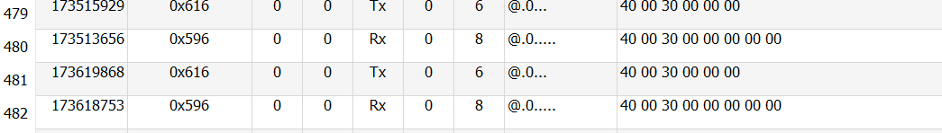

I have the Zombie run a clean up routine first by emptying the write 0x3100 and read 0x3180 messages, currently no CAN is stored as far as I can tell. As the response from Focci are already 0x80
Rebooting did nothing, same with reflashing the BIN.
Cold boot now, requesting first write ID.

I have seen repeated create/erase cycles of CAN maps to cause the device to get in a state where it reports it has an empty map and will not accept creation of new map entries. Not got a full reproduction yet to raise an issue against libopeninv. Rebooting fixes things though.

I use STM32CubeProgrammer and it does have memory erase functions, it can do a full erase function. Will hook it up tomorrow with an STlink.

I used the STM32CubeProgrammer to full wipe memory then install CAN bootloader and my own revision of Focci. Back up and CAN mapping

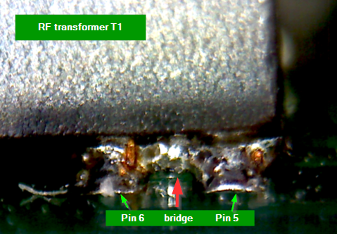

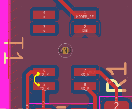

JLCPCB has a small quality issue with the soldering of the RF transformer. On two boards, the transmit path is shortened by a solder bridge below the transformer.
Found this during testing, no communication was possible, but the modem did not go to sleep (LED stays green), this means the modem hears the EVSE, but the Foccci was not able to transmit anything.
Measuring the coil reveals 0.0 ohms, while the coils on good Focccis have ~1.5 ohms. We should keep an eye on this when testing new focccis. Or maybe redesign to use a better solderable transformer?

That's unfortunate, is there solder mask between the pads?
There looks to be a surprising amount of solder in there.
You might be able to shrink the pads down slightly or offset the pads away from each other a tiny bit in the footprint for the next batch.

Yes, a lot of solder, much more than on similar sized other pads. Is it possible that they can selectively control the amount of solder paste? They use very small amount for resistors, but for the big transformer they seem to go the safe way. Hm.
Shrinking the pads is a good idea. And yes, there is solder mask between the pads, this works on the pcb side. The tin tends to bridge on the ferrite side, seems the ferrite "pulls" it.
[Edit] Created issue https://github.com/uhi22/foccci/issues/5

The solder paste should start on the pads.
I'm not sure how JLC adds the solder, I don't believe they use the solder paste layer info for that. I think they use the pad info and +/- from that.
