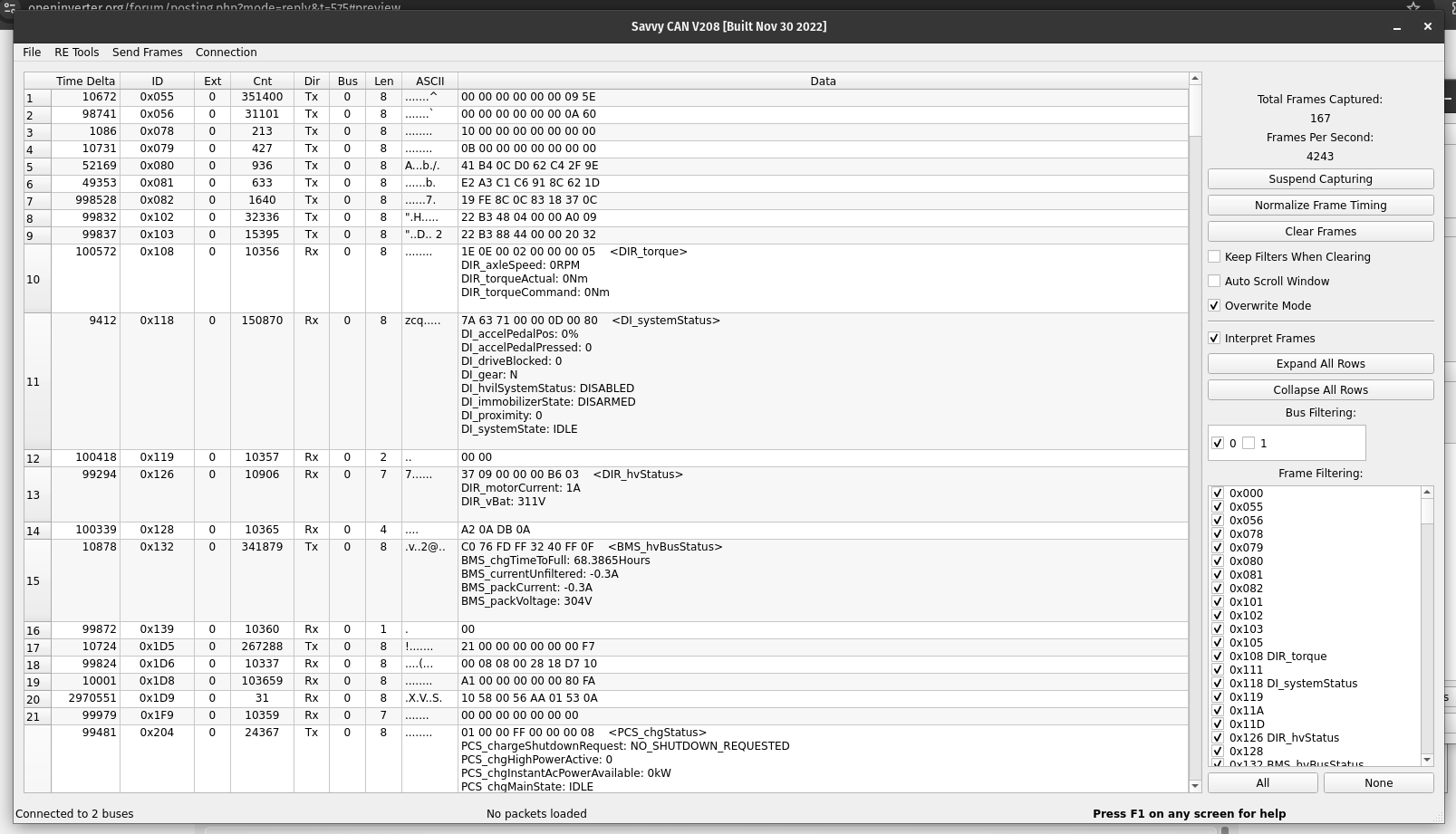

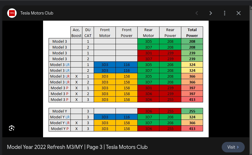

According to this table does it mean that 3D7 has a "full mosfet" inverter? Not like old 3D5 without 3 mosfets?

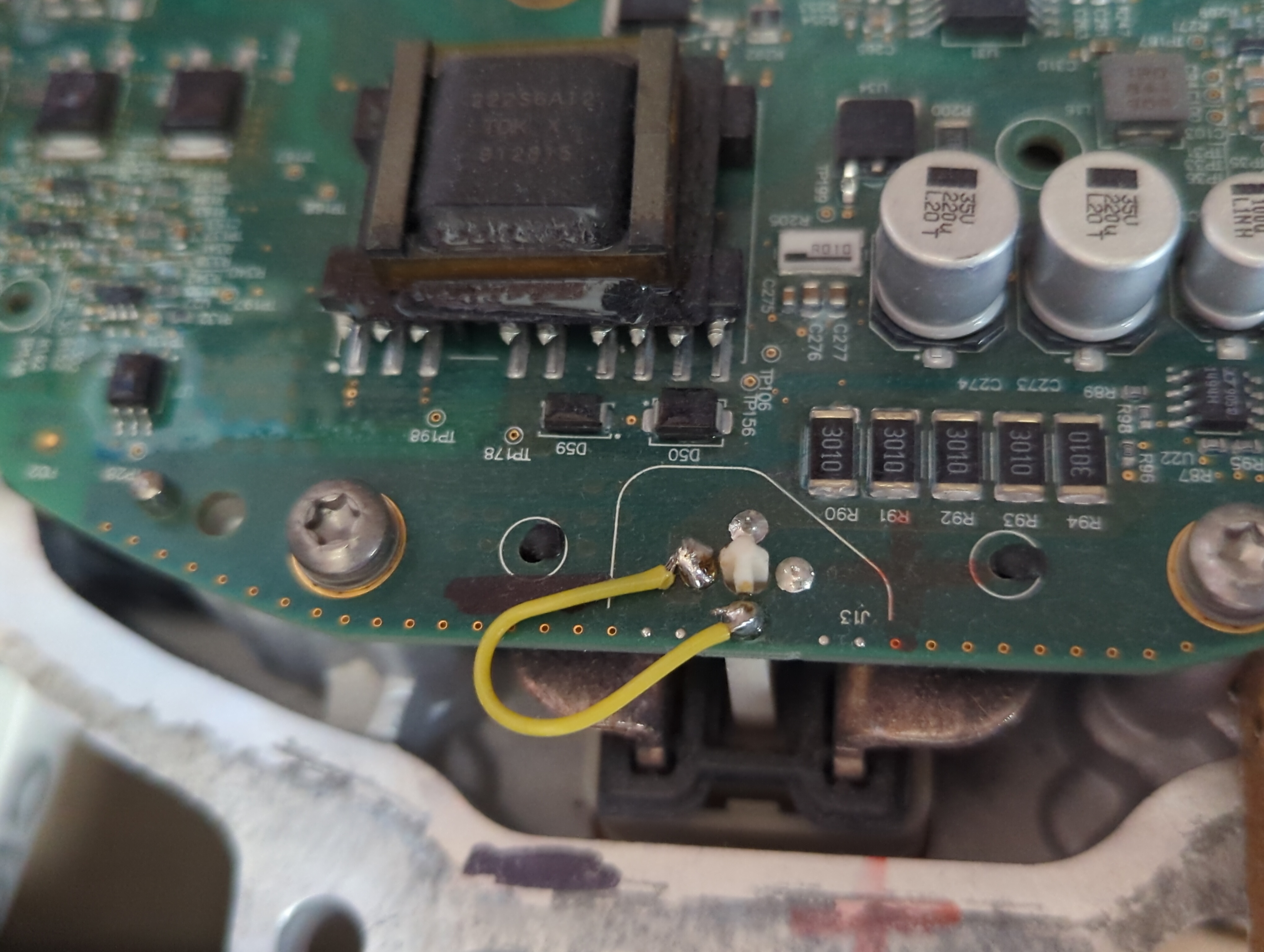

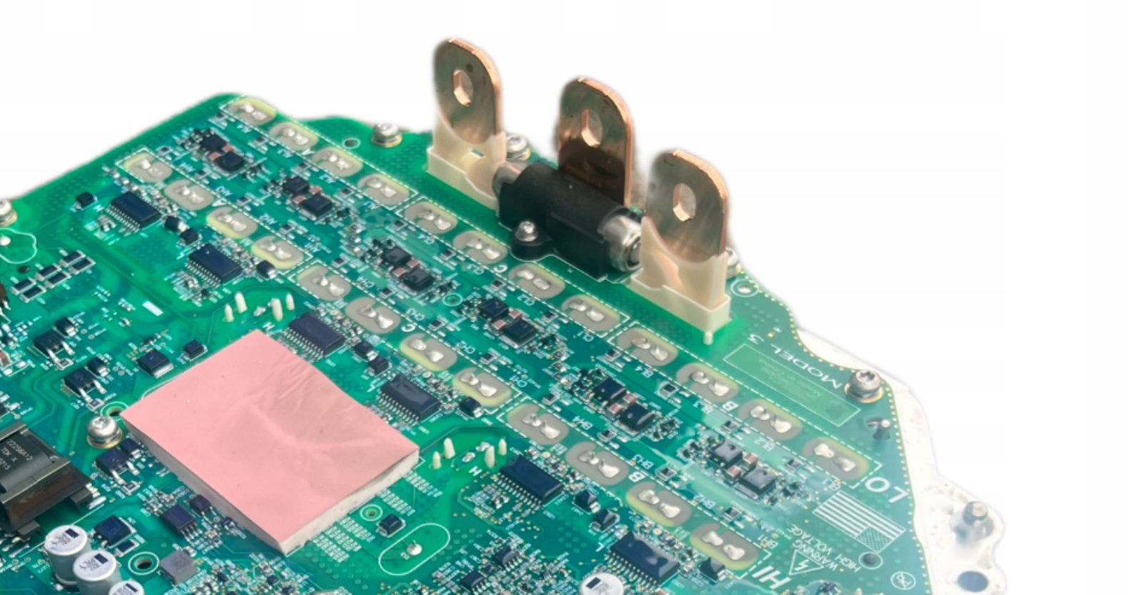

What are the chances that the pyrofuse didn't break 2 phases in the inverter of 3D7 motor whose rear mount was torn off?

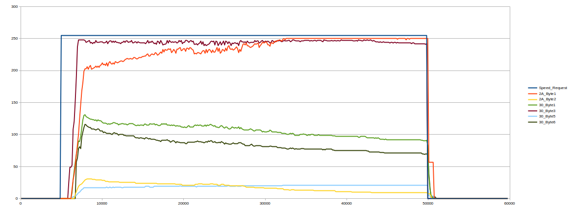

Been having a bit of fun this week programming in the garage to see how the Tesla M3 oil pump works. Turns out to be pretty simple. There's a single command being sent out by the inverter to the pump and although it's 2 bytes long only 1 seems to actually do anything. The value that's sent commands the pump to vary the output with 0 being off.
The Tesla inverter firmware traces taken before I accidentally nuked it showed 4 separate requests being sent to the pump. I've been able to decode a bunch of the values these return including: fluid and pump temperatures (and 4 other temps!), supply voltage and current, motor RPM, and suspected fluid flow and pressure.
A simple ESP32 Arduino sketch to drive the pump and the retrieve the status can be found here: https://github.com/davefiddes/Tesla-Model-3-Drive-Unit/
I'm sure that there's more to be found particularly on error states. I can only really see the Fluid Temp being useful in the short term.
Here's a graph of what a short 50 second run of the pump produces:

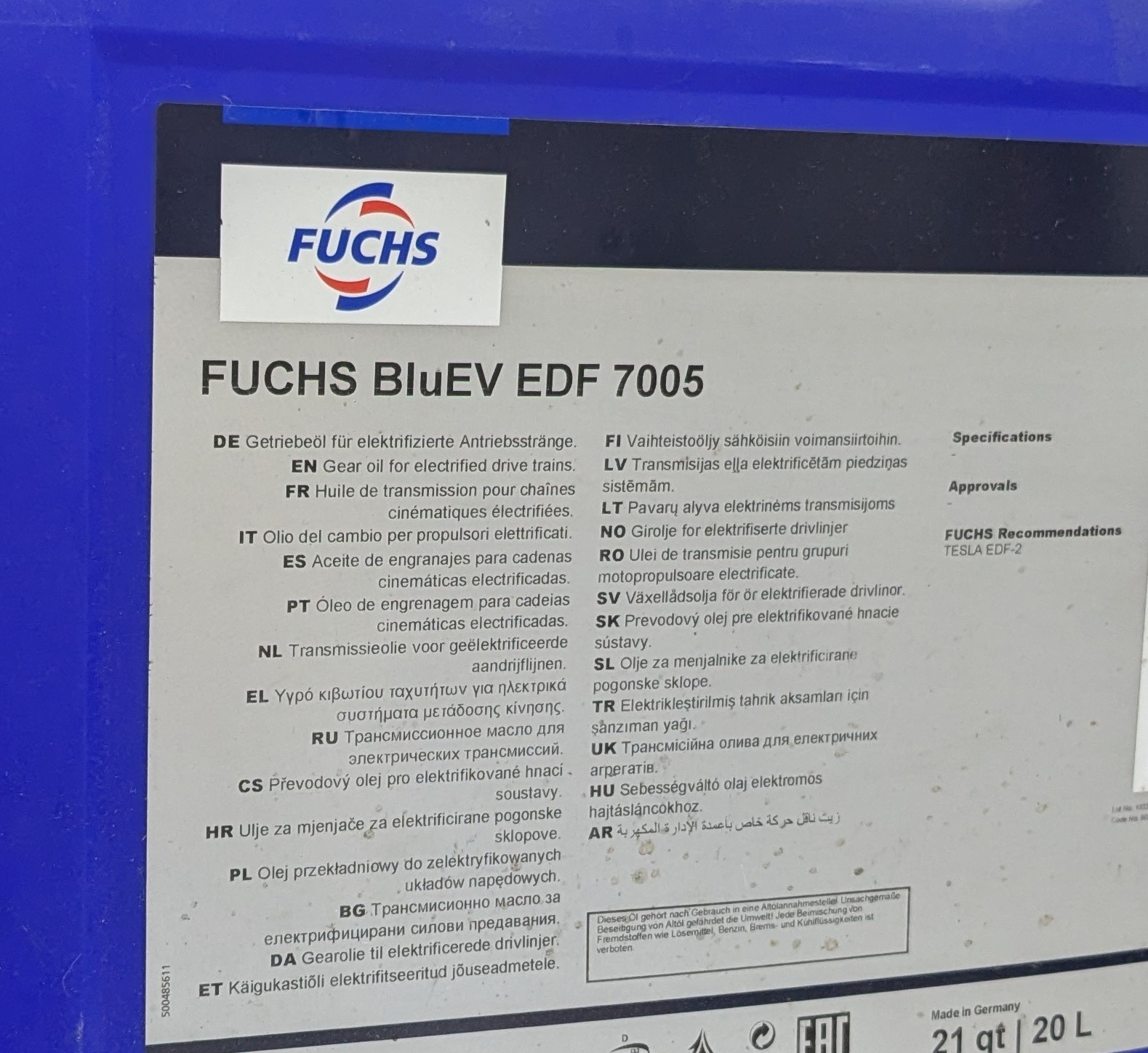

Regarding unit oil. If you have the drive unit where oil is in the motor as well you need to use FUCHS BluEV EDF 7005. Apparently it has the correct additives for use inside the motor.
It is black in colour from new with additives in suspension as well as solution. So it needs a good physical mix before refilling.
I got this info from Fellten who spent a good bit of time researching it.

Wished I'd known about this before buying 3 bottles of Fuchs Titan ATF 6009 which was what Opie Oils were recommending last year.

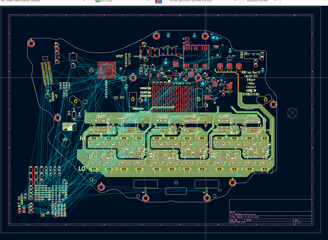

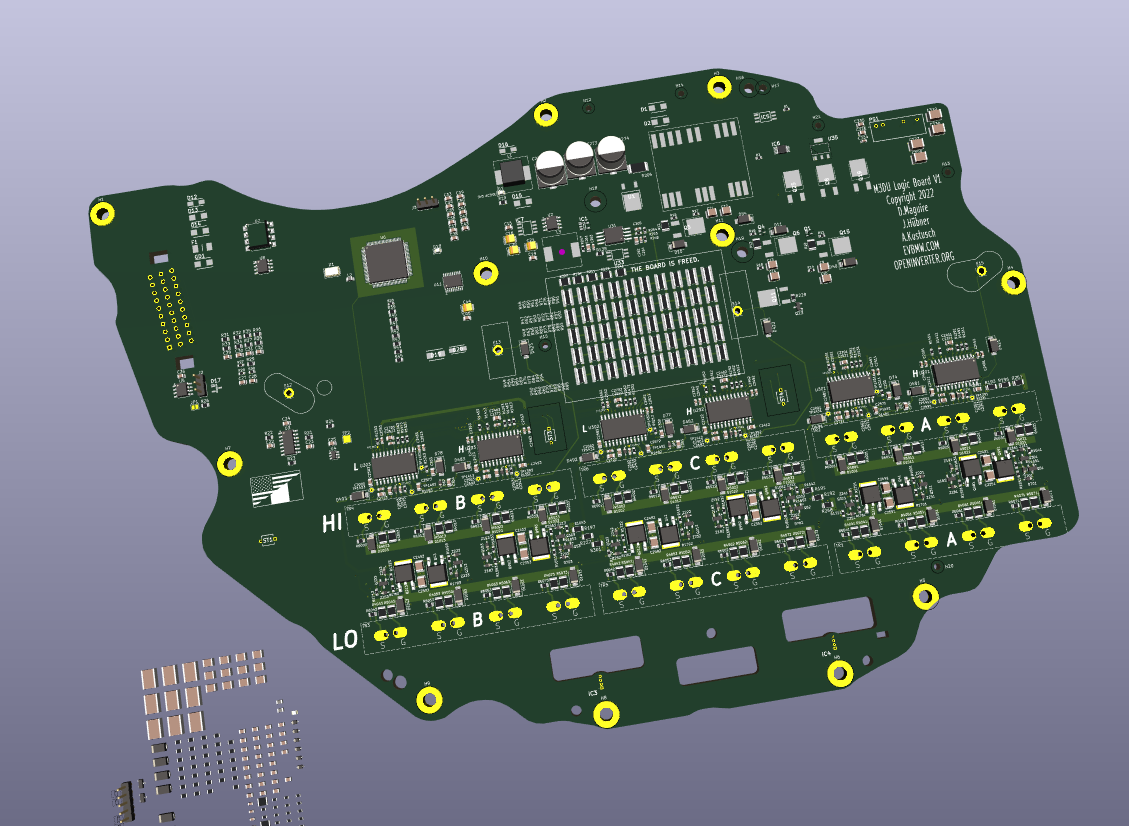

Sooo, some updates on the musk. I must admit I had let the replacement pcb project lag. Thankfully, Artur Kustusch came onboard and reverse engineered the ENTIRE gate driver section :o This has given me a big push to get back on the project and I've since reversed the gate driver psu and other peripherial circuits to the point now that I'm laying out the pcb with a view to ordering some bare boards before year end for fit testing. So yeah its been slow but its a BIG project :)
Attached latest schematic for those interested. Note that like the MG drive unit logic board this design utilised the 100 pin VCT6 variant of the STM32F103.
Also, where is practical, oem component designators and positions are used on the OI board. The OI board will be 4 layer, single sided SMD. And just for fun I get to learn kicad along the way.
Github repo : https://github.com/damienmaguire/Tesla- ... Drive-Unit
Jeez, 5 years has flown:)
