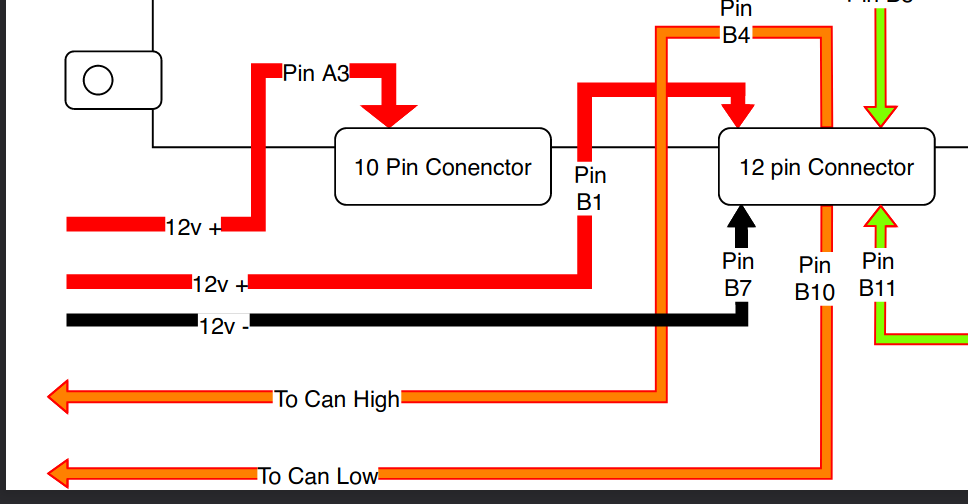

Stupid question:
Gen2: A3/D1 enable is 12V or 5V?
I connected +12V but saw references to +5V and +12V here and am now questioning myself. Others have also connected 12V, but is that wrong?
I can update the wiki.
- EV_Builder
- Posts: 1205
- Location: The Netherlands
- Been thanked: 37 times
It's +12VDC.
I will try if I can analyse your logs to see what's going on in the broken charger.

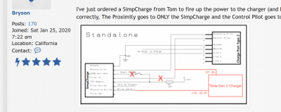

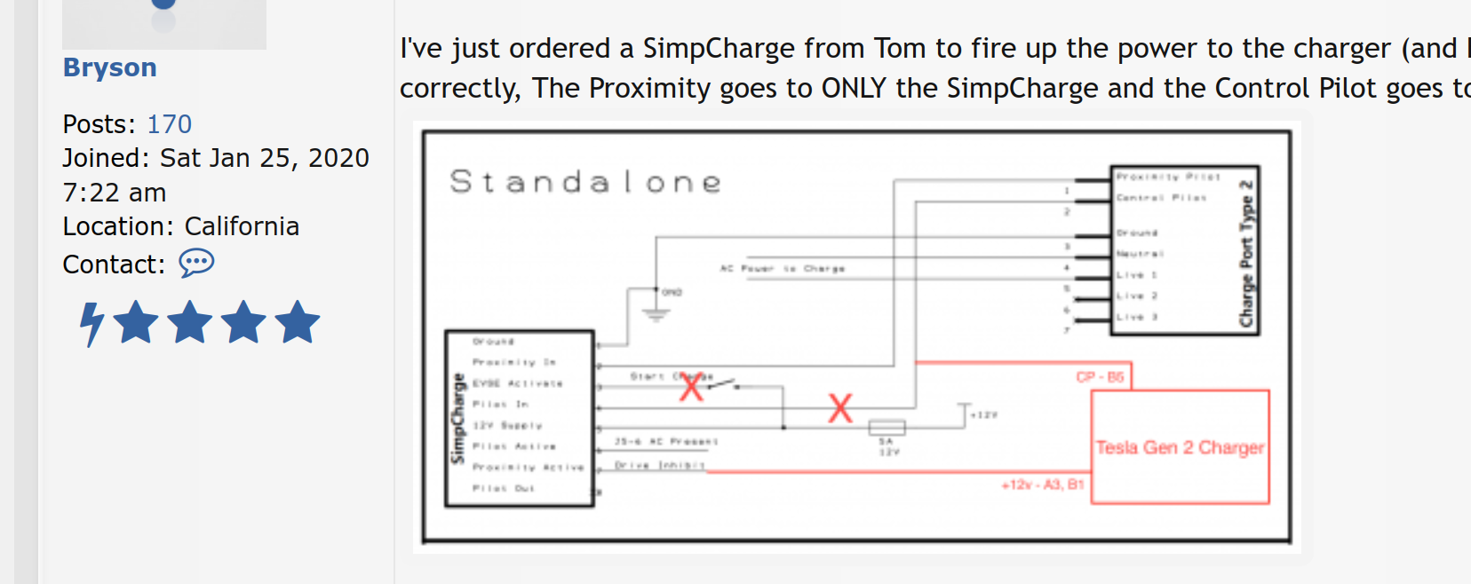

Bryson
- Posts: 179
- Location: California
- Been thanked: 4 times
I don’t recall using 5V anywhere, just 12V from the car’s regular bus voltage

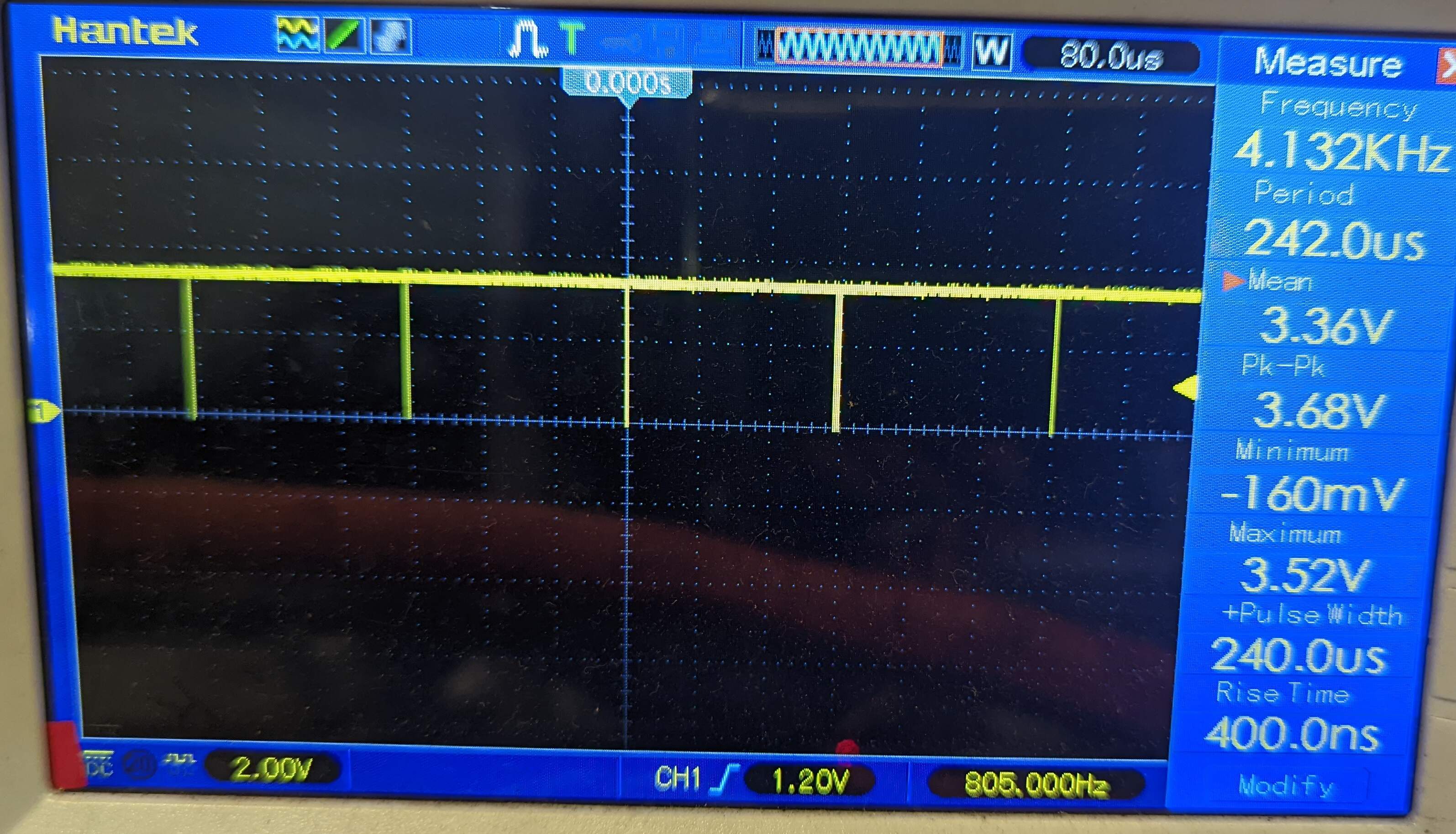

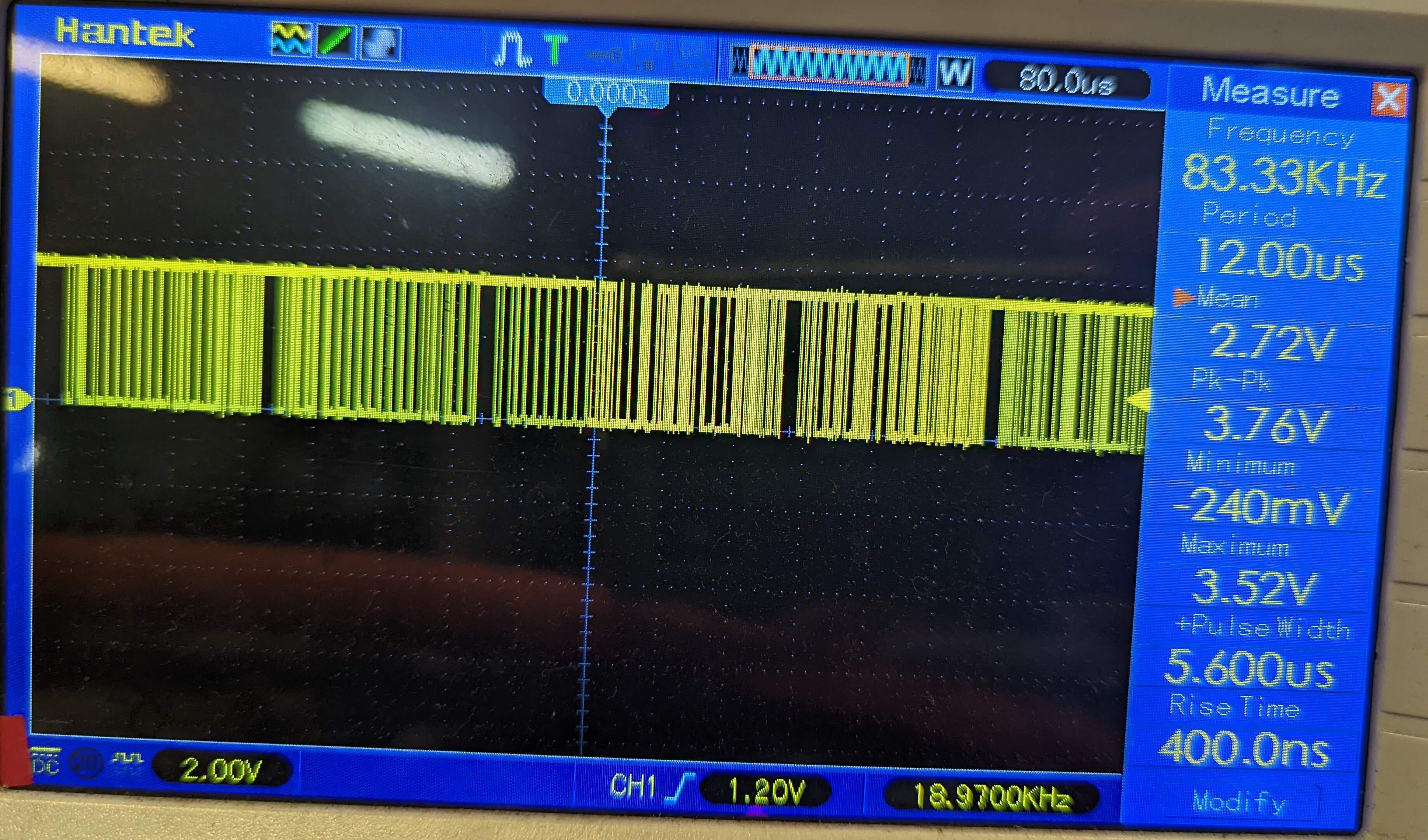

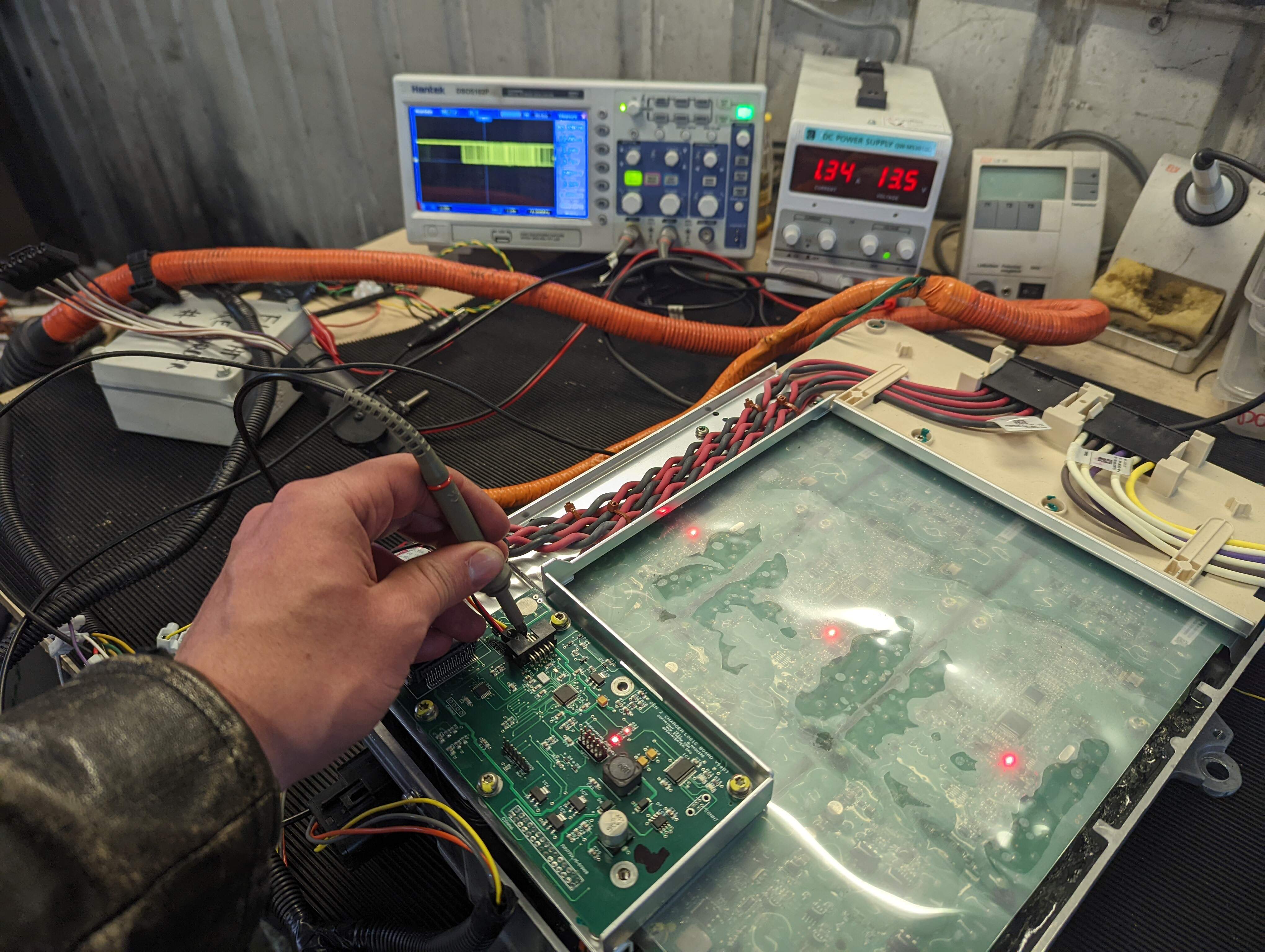

Hi, definitely make sure its 60Ohm.
Interestingly I have the same problem with a logic board at the moment, I am just today measuring on the CAN TX side of the can transceiver on the board if it gets the signal there
1) if it gets the signal and it doesn't generate CANH & CANL --> transceiver faulty, replace
2) if the STM32 is silent --> trace back signal, flash firmware and see if that will make it spit out signals (unlikely to be firmware issue I suppose)
If I understood Johannes correctly, the logic board should always spit out CAN messages 45C, 42C, 43C.

Ok, on the logic board CAN_RX looks good, CAN_TX not so much. I am just reading up on this, but does that mean that the transceiver is toast, or the stm32 not sending properly? It looks to me like periodic attempts at sending the message and failing after 1 bit, but is there an ACK needed from the transceiver that is missing when its broken?
- Been thanked: 1914 times
I think it means the stm32 is not reading back what it is sending so it backs off right away. Could be a bad transceiver or solder joint
