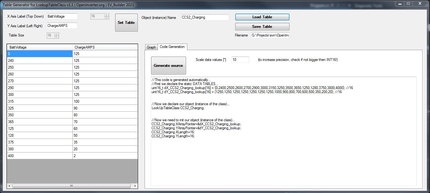

Post by EV_Builder »
okey updated the GUI with some new features :)
Time to test my c++ class on the VCU board...
Making and using lookup tables never was easier :D

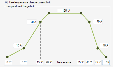

bitterandreal
Posts: 56
Joined: Fri Jan 15, 2021 2:30 pm
Location: Netherlands
Post by bitterandreal »
EV_Builder wrote: Sun Jun 20, 2021 9:25 pm okey updated the GUI with some new features :)
I like your table generator! But isn't it more a BMS task to protect the battery and tell the VCU max charge and discharge currents?
Attached some inspiration from lithium balance s-bms...
They use separate temperature and SOC dependant lookup tables for charge, discharge and regen.
No 3D table but separate 2D tables for temperature and SOC and then they use the lowest value as limit.

EV_Builder
Posts: 1205
Location: The Netherlands
Has thanked: 18 times
Been thanked: 37 times
Yes! very fair point! So the place where we add the code will decide 'who' is reporting it. In the VCU it could still be the BMS class if there is one in use.
Multiple tables can be added indeed. Just copy the file and edit.
For a temperature correction value. If needed I could add it to my generator but I think waste of time for now.

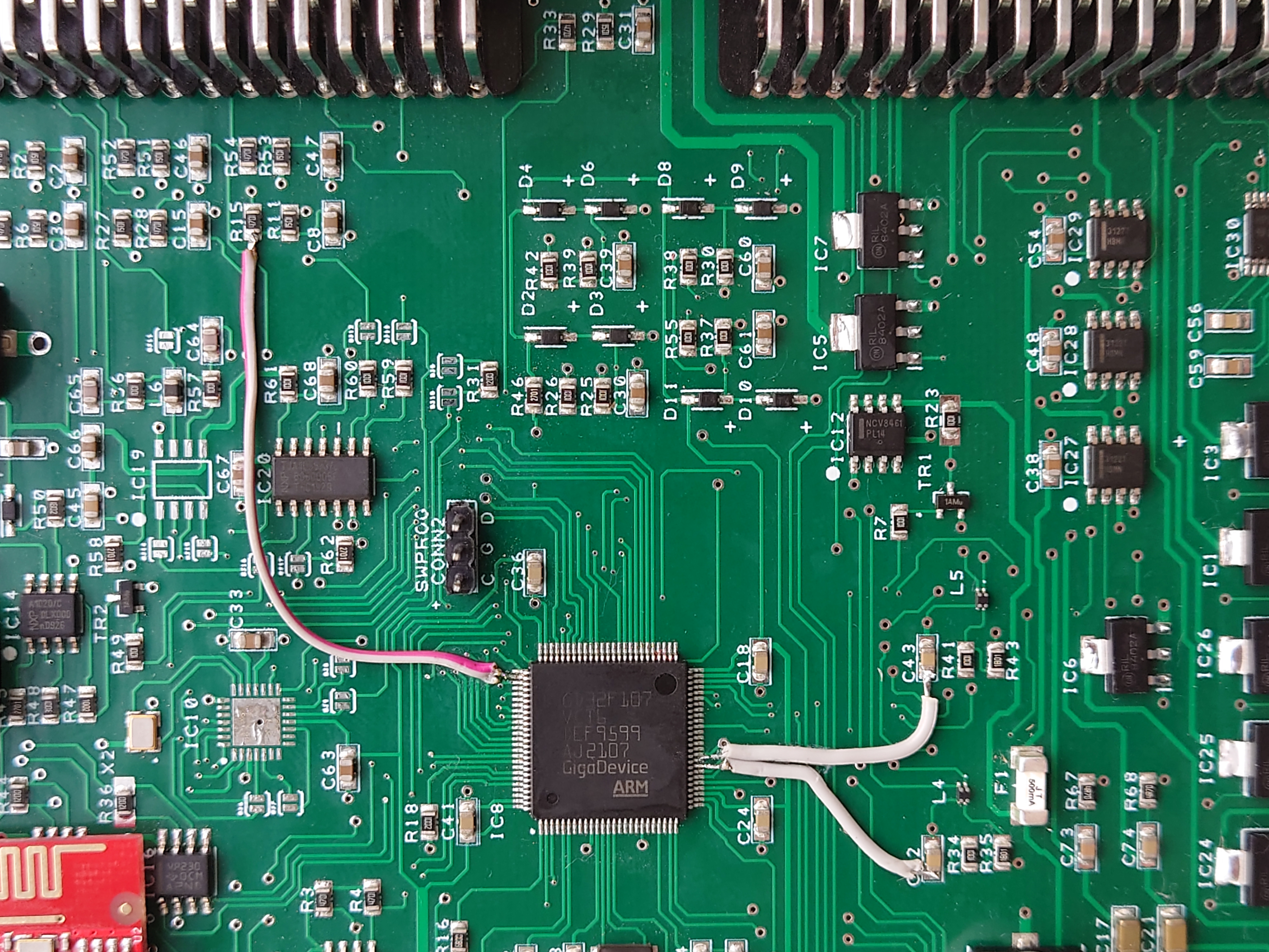

I have now swapped the LQFP100 for a 'real' STM..
The Giga didn't want to debug on my IDE... :roll: :roll: :roll:
Actually not sure if this was a good idea but hey..it's journey..

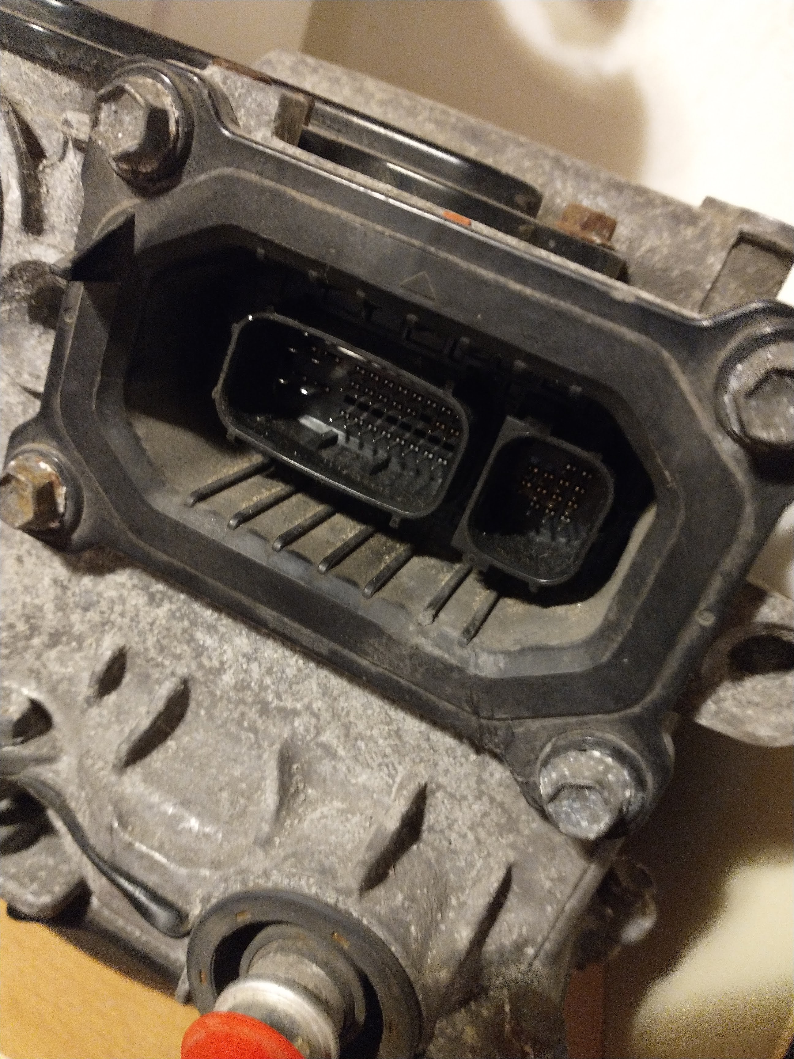

Re beta boards: Ugh, yeah, haven't tested my beta board cause I haven't been able to find the missing part of our prius harness so far. Sorry about that. Suppose today is a good day to try the junkyard.

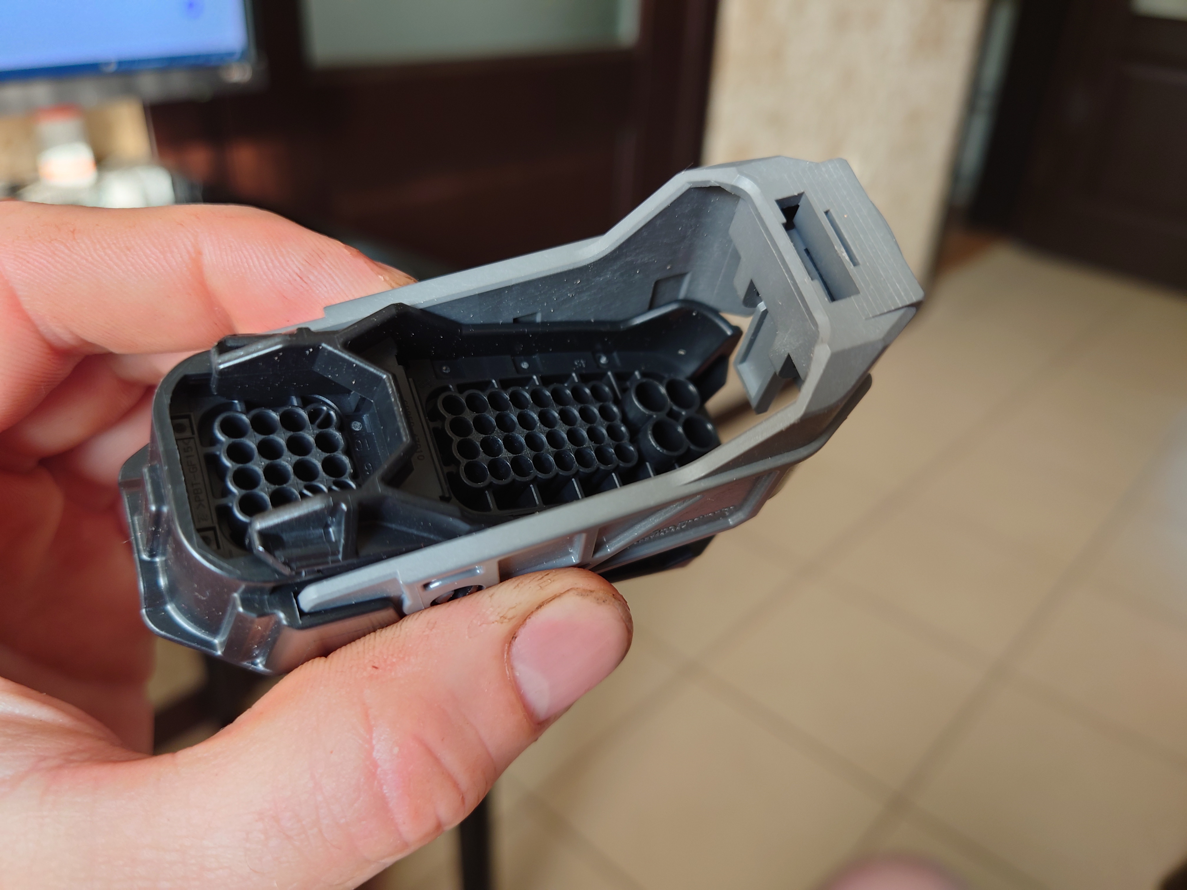

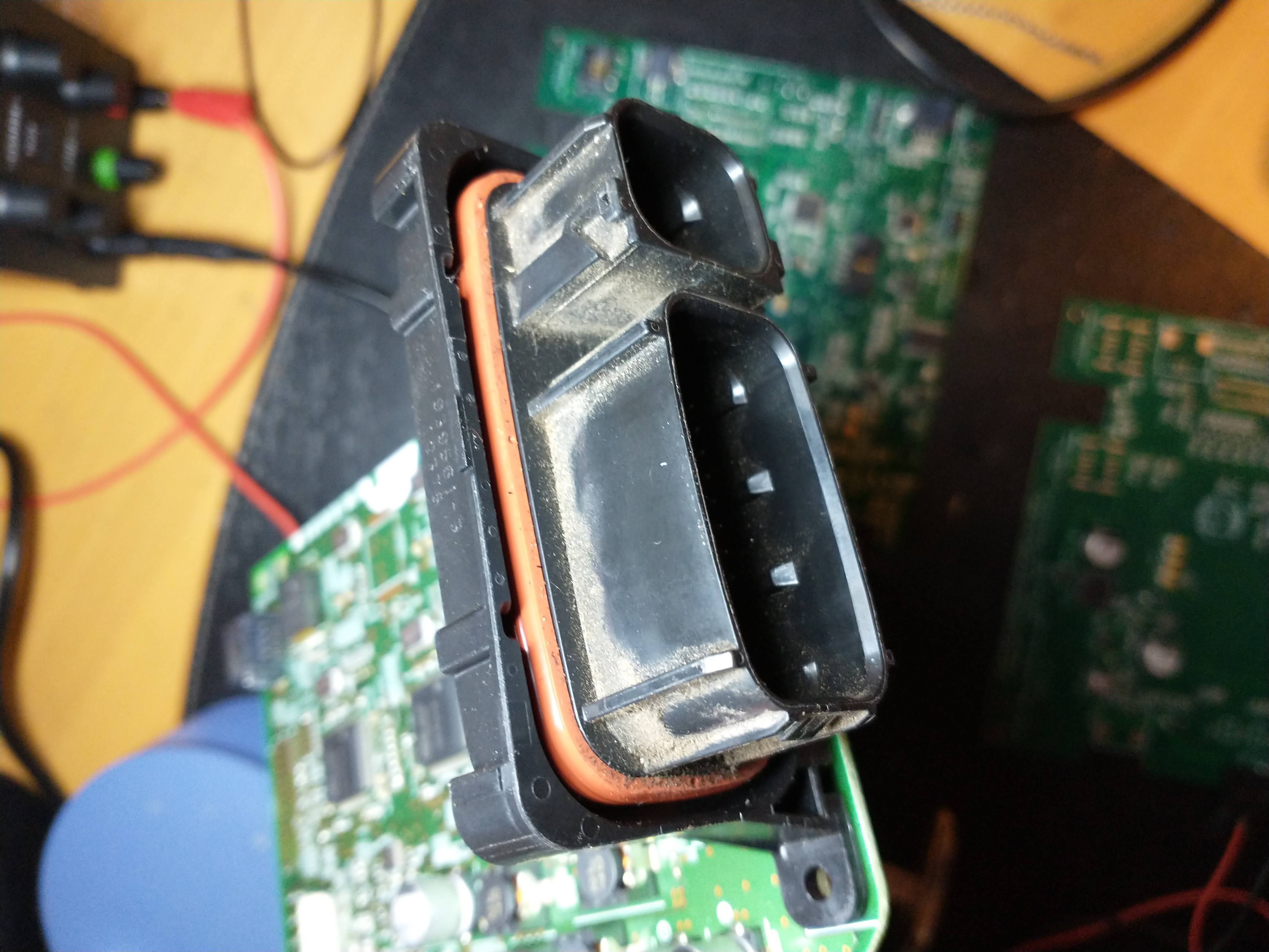

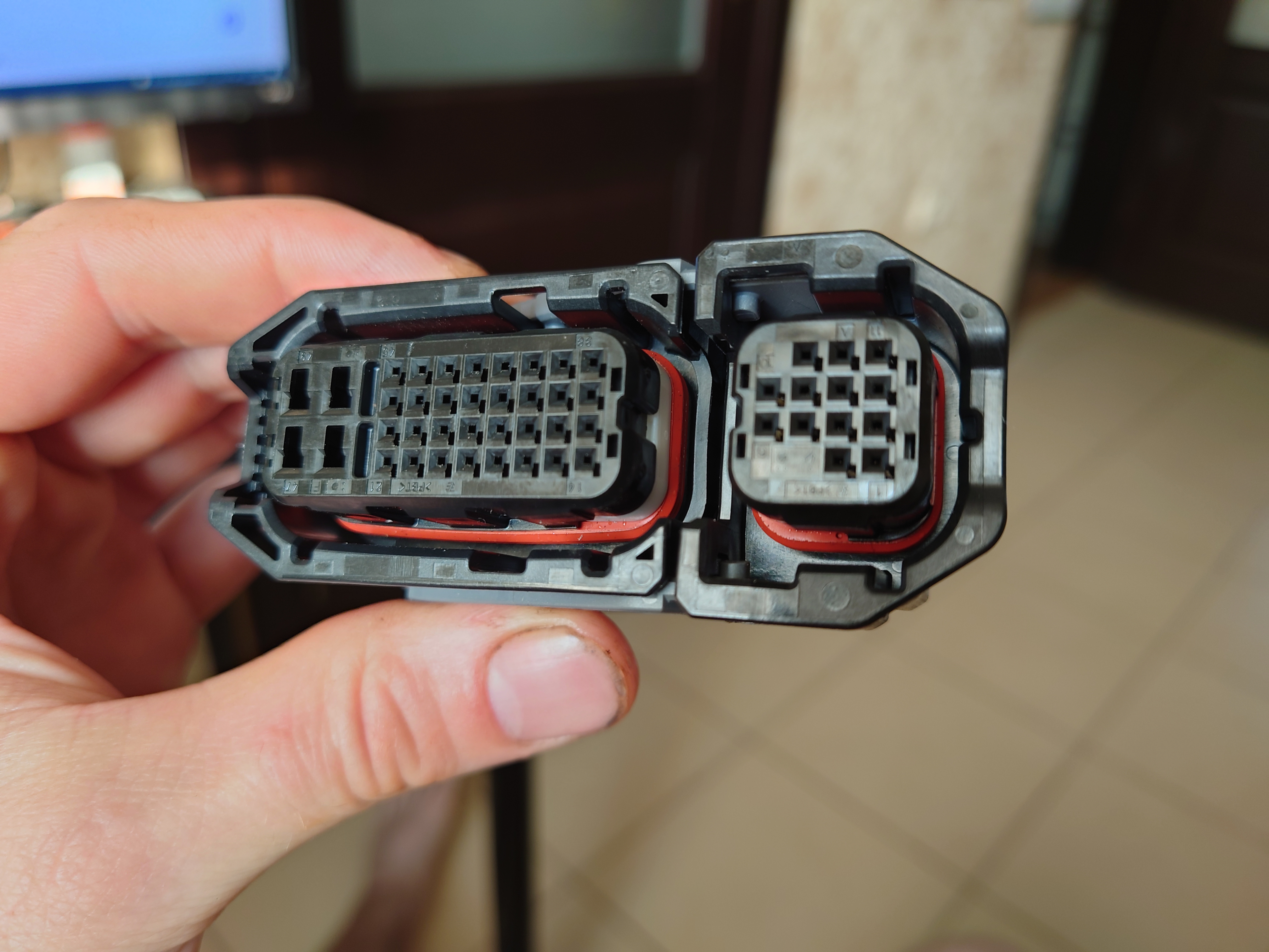

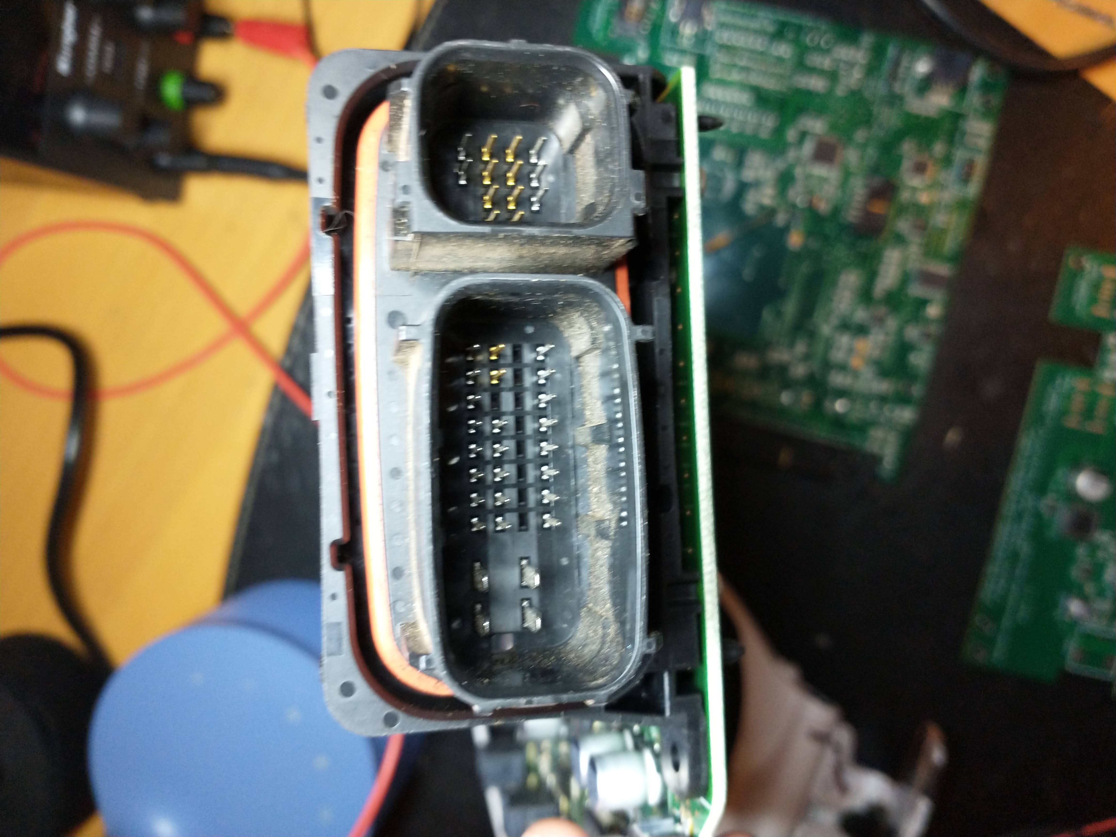

Electro Wrks
Posts: 3
Joined: Thu Jan 28, 2021 6:55 pm
Post by Electro Wrks »
angusmf wrote: Fri Jun 25, 2021 4:26 pm Re beta boards: Ugh, yeah, haven't tested my beta board cause I haven't been able to find the missing part of our prius harness so far. Sorry about that. Suppose today is a good day to try the junkyard.
Re wiki page: This one? https://openinverter.org/wiki/ZombieVerter_VCU
Is it a plug you are looking for? Show us the one you need or its mate with a photo and maybe we can ID it.
angusmf
Posts: 26
Joined: Sat Oct 03, 2020 2:54 pm
Location: Phoenix USA
Post by angusmf »
Electro Wrks wrote: Tue Jun 29, 2021 6:09 pm Is it a plug you are looking for? Show us the one you need or its mate with a photo and maybe we can ID it.
Yes, the main inverter plug for a gen 3 prius. Somehow I have everything but that.
Patreon supporter and mild troublemaker. You can be both.
chuuux
Posts: 68
Joined: Fri Mar 12, 2021 5:11 am
Location: Ural
Post by chuuux »
I guess you need G926047010 and G926647010 connectors. They join to each other.
Electro Wrks
Posts: 3
PNs confirmed. A Google search shows they are available as repair parts from US Toyota stocks. I've forgotten where the pins(2 sizes) are available. You could salvage them with a length of lead from other harnesses. Also, salvaged pins and leads have the nice little sealing rings on them. The tool for unlocking the pins can be made from a squared-off(by careful grinding) regular or extra long push pin. The unlock holes are the small rectangular ones next to the larger pin holes.
Before the tool is used to unlock individual pins, the white plastic primary lock in the body of the connector needs to be slid sideways, with a small screwdriver, to unlock and lock all of the pins in the connector.
Shouldn't this info be on a Wiki somewhere?
