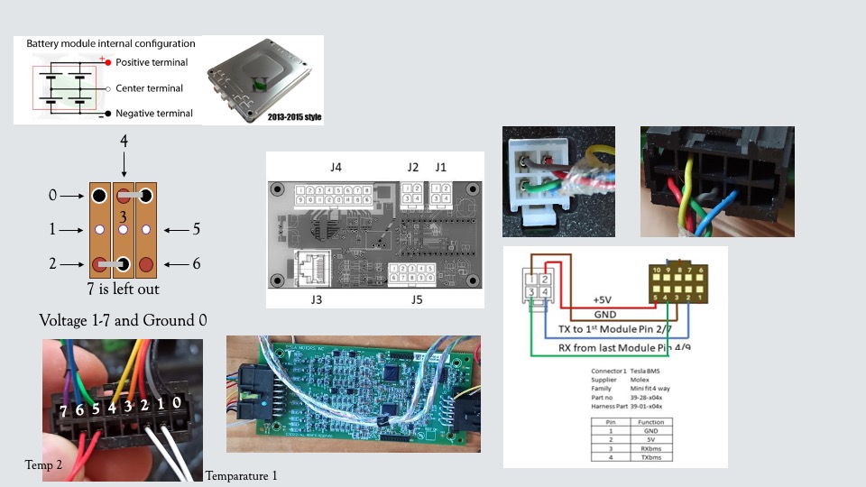

I have the Tesla B-Class BMB (7s) with a SIMP BMS and I tried to test them the first time. I checked one BMB connected to three Nissan Leaf Gen 2 Packs (each pack is 2S 2P).
Temp test worked. Voltage somehow worked except for the last two reads. It splits my one BMB into two and shows wrong values for the "second" module.
I am an absolute beginner. I read as much as I can (manual, Forum, etc.) but obviously missed the puzzle piece what I messed up here.
I might have missed something obvious. The BMS shows the following:
0
BMS Status : 1 Ready   |Balancing Active  6
Out:0000 Cont:0000 In:0000 Charge Current Limit : 16 A DisCharge Current Limit : 0 A
Modules: 2 Cells: 6 Strings: 1  Voltage: 22.220V   Avg Cell Voltage: 3.652V  Low Cell Voltage: 3.091V   High Cell Voltage: 4.012V Delta Voltage: 921mV   Avg Temp: 27.747C
Module #1   15.01V   Cell0: 3.74V   Cell1: 3.74V   Cell2: 3.77V   Cell3: 3.77V   Cell4: 0.00V   Cell5: 0.00V  Neg Term Temp: 21.92C  Pos Term Temp: 33.52C
Module #2   7.21V   Cell6: 4.01V   Cell7: 3.09V   Cell8: 0.00V   Cell9: 0.10V  Cell10: 0.00V  Cell11: 0.00V  Neg Term Temp: 21.86C  Pos Term Temp: 33.68C
CANbus   0.00mA  9% SOC 6000.00mAh
The BMS config is set to:
0 – slaves in parallel = 1
a – cells in series = 6
Why does it split the modules with incorrect reads? (I attached an image how I the pins are connected)
Posts: 2962
Has thanked: 330 times
Been thanked: 848 times
Re: Simp BMS
It splits it because of the way the BMB works it contains 2x bms slave ICs that can measure 6 cells each.
Split 4 - 3. You only wired up 6 cells to a 7 Cell BMB so the second part is upset.

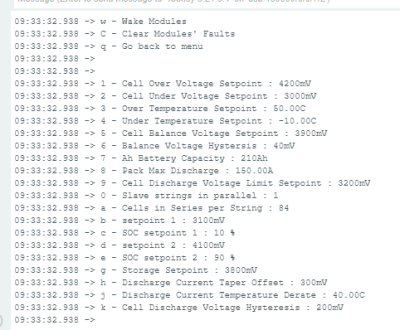

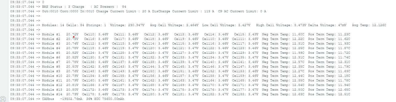

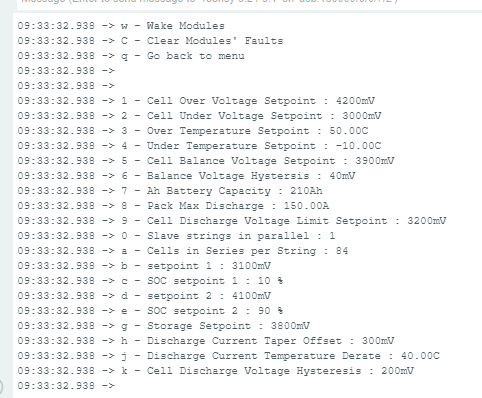

Hi, there.
Could you please help me understand. I don't quite see why my discharge current gets derated. I have max discharge set to 150A, but this morning BMS derated it to 30A. I didn't capture it at 30A, but below is the screenshot showing it at 113A as it seems to be slowly rising as I'm charging.
It's a cold morning, but the batteries where at 10C...11C temperature, when it derated the current to 30A. SOC was at 24%.
My understanding other than setting it to 0A, this is the only place in the code where the discharge current gets modified:
    //Modifying discharge current///
    if (discurrent > 0)
      //Temperature based///
      if (bms.getHighTemperature() > settings.DisTSetpoint)
        discurrent = discurrent - map(bms.getHighTemperature(), settings.DisTSetpoint, settings.OverTSetpoint, 0, settings.discurrentmax);
      //Voltagee based///
      if (bms.getLowCellVolt() < (settings.DischVsetpoint + settings.DisTaper))
        discurrent = discurrent - map(bms.getLowCellVolt(), settings.DischVsetpoint, (settings.DischVsetpoint + settings.DisTaper), settings.discurrentmax, 0);
However, looking at the snapshot of my battery cell volts and temperature, it looks as though it wouldn't fall within these conditions.
I'm on a forked firmware 230719, but the fork changes are related to the CAN messaging, and relay control.
Please let me know if I'm not seeing the obvious.
Posts: 2962
Re: Simp BMS
Literally here.
Your settings:
settings.DischVsetpoint = 3200mV
settings.DisTaper = 300mV
So if your cells are below 3500mV limit discharge.
The settings for Discharge Hysterisis is for allowing discharge again when the cells have risen by 200mV (your setting) from Discharge limit setpoint.
