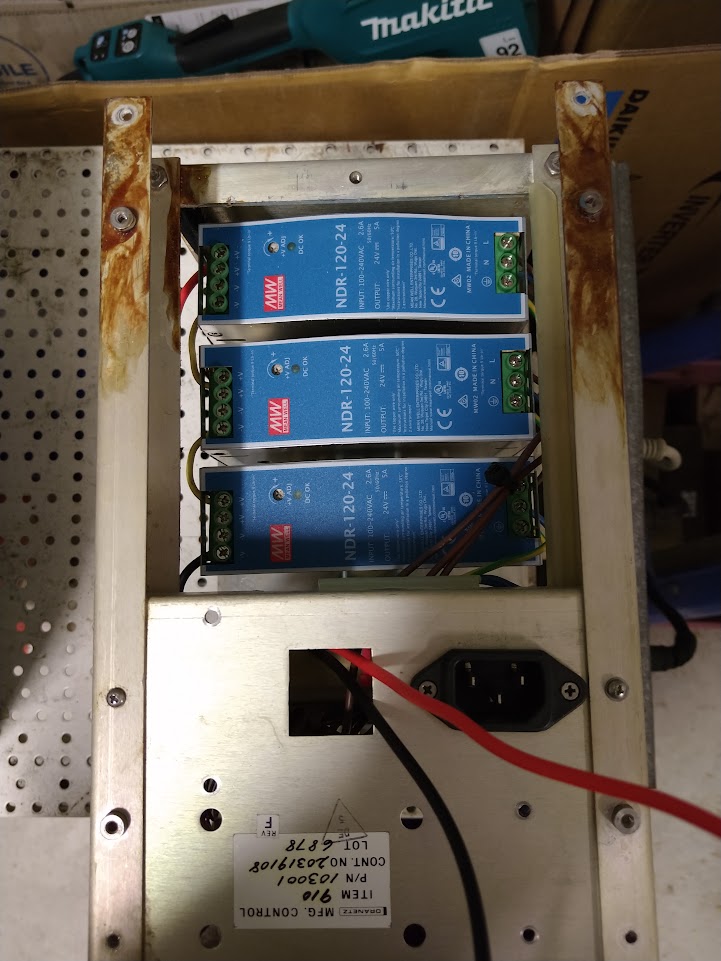

Q4: What power supplies are y'all using for testing?
Q5: What sequence do you usually use to apply high voltage?
Thanks!

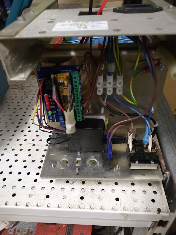

I'm using a series of Main Well NDR-120-24 power supplies in series (they're isolated, so can be added in series/parallel by design). They're capable of putting out 5A each, and I have 3 wired together for 72V DC (and I have another, for a total of 96V, but don't need that yet).
Part 1 - Supply. The Arduino in the photo controls each power supply via a relay board - the main power switch turns on the 1st power supply, then there's a 2 second delay then the Arduino turns on the 2nd power supply, then after an additional 2 second delay the Arduino turns on the 3rd power supply. Finally, after another 2 seconds delay the three power supply outputs are connected in series, and the 72V DC supply goes 'live'.
Part 2 - Load. The 12V DC circuit connects first, and rudimentary checks are done. Once 12V DC power-up is successful, pre-charge HV connects, and HV checks occur. Once pre-charge is complete, the final HV circuit connects. Note - I'm running a Curtis controller at this point in time - my Toyota Hybrid testbed is yet to be built.

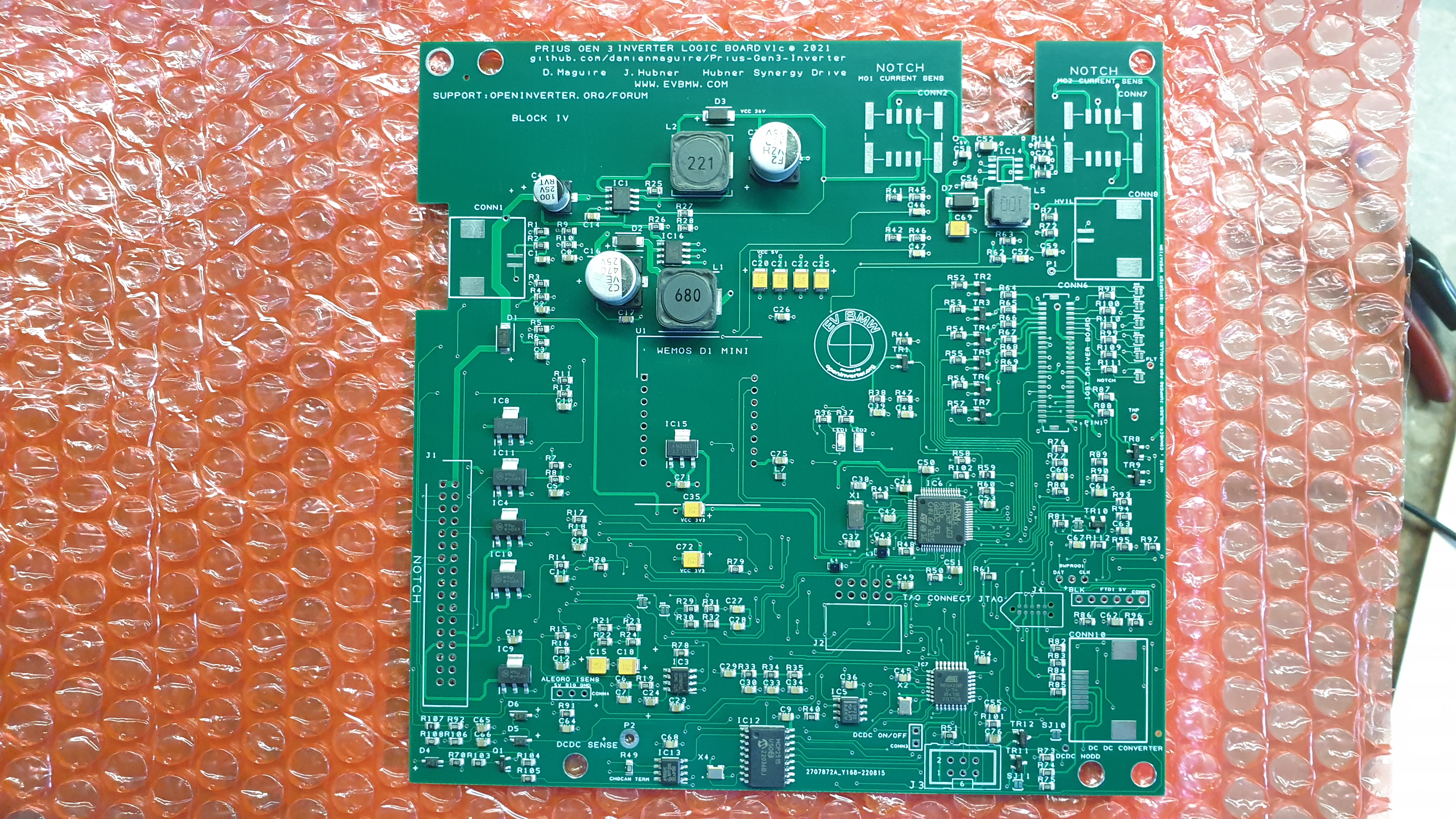

so, for the questions i had the past few weeks. i removed the V1c Logic board. im hopes that maybe something with the board would be the cause of this issuse. ( issue- when accelerating i get highamp trips. it keeps shuting down the inverter )
with closer inspection i checked to see if any of the circuits were bad or maybe they were shorted on the current sense leads. ?
or is the shorted leads the PWM for mg2?
stm32 prius gen three logic board V1c.jpg (20.2 KiB) Viewed 9424 times

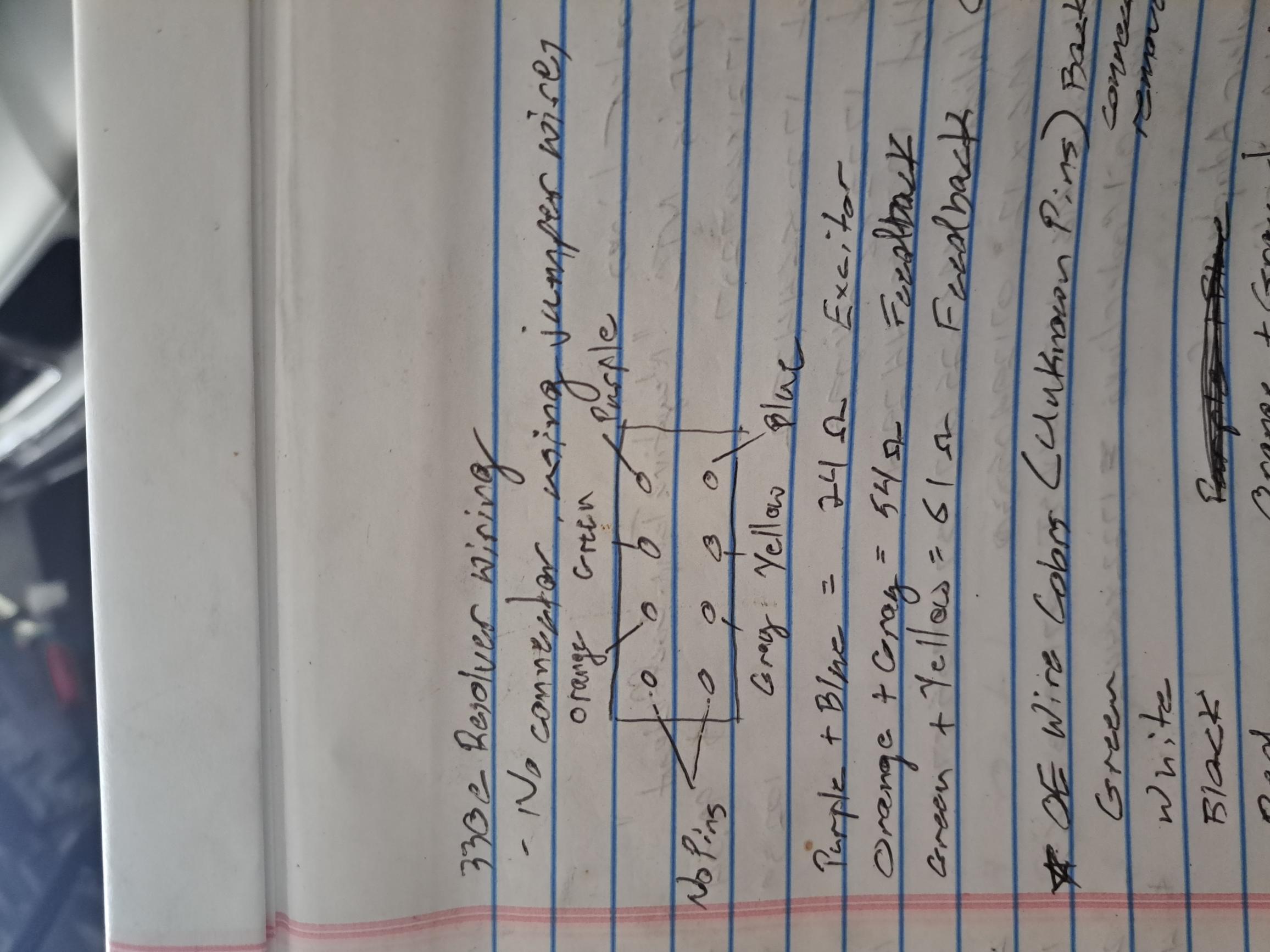

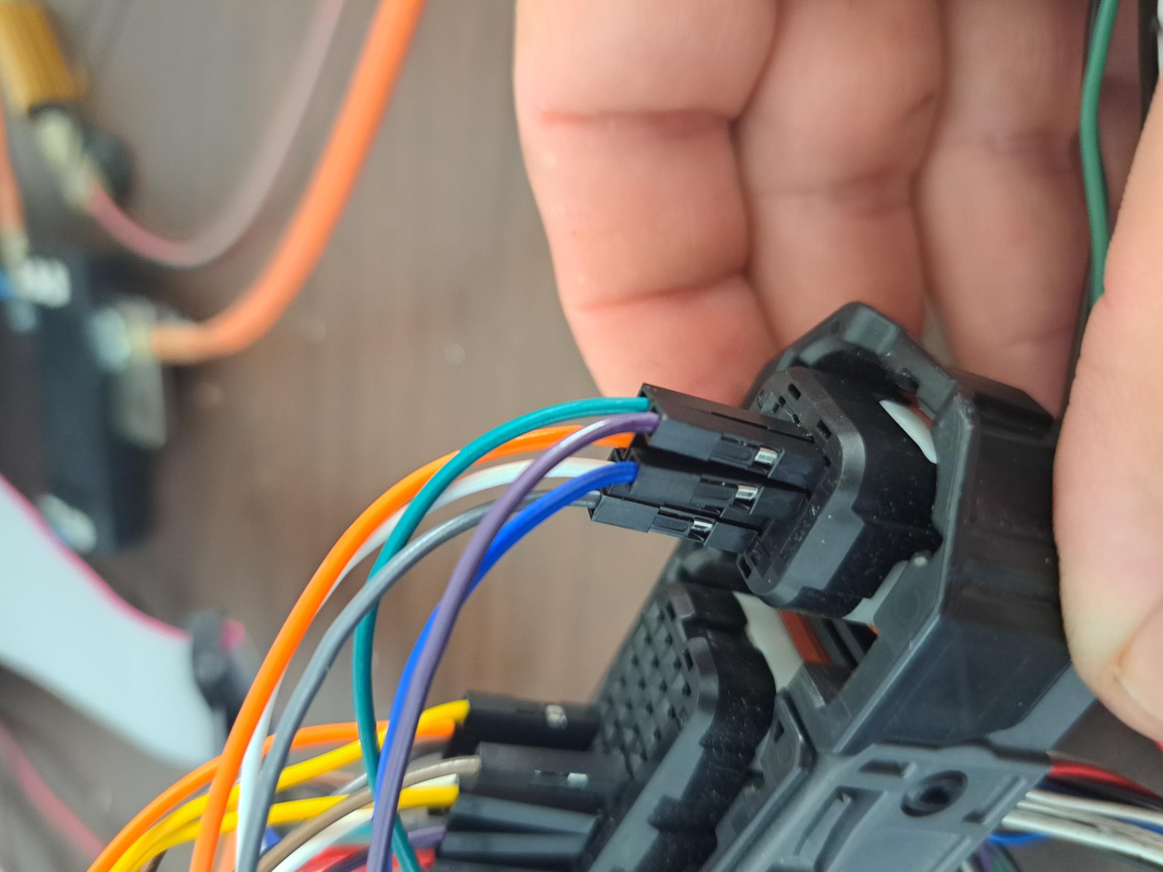

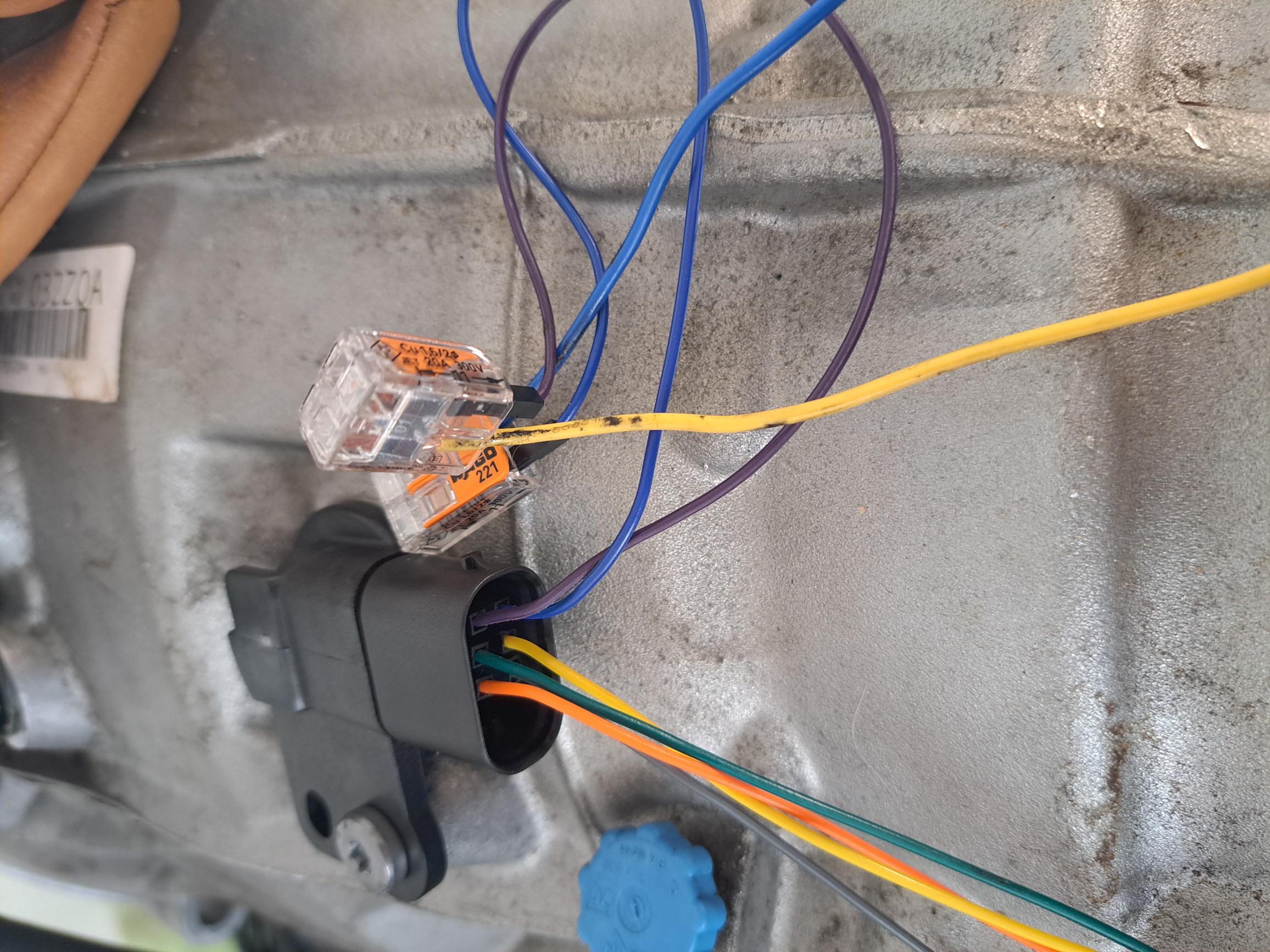

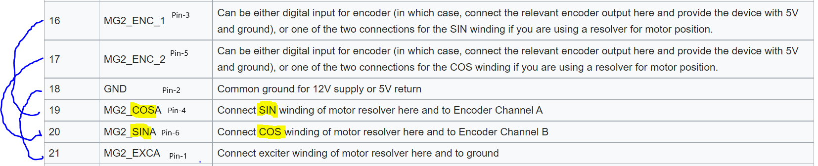

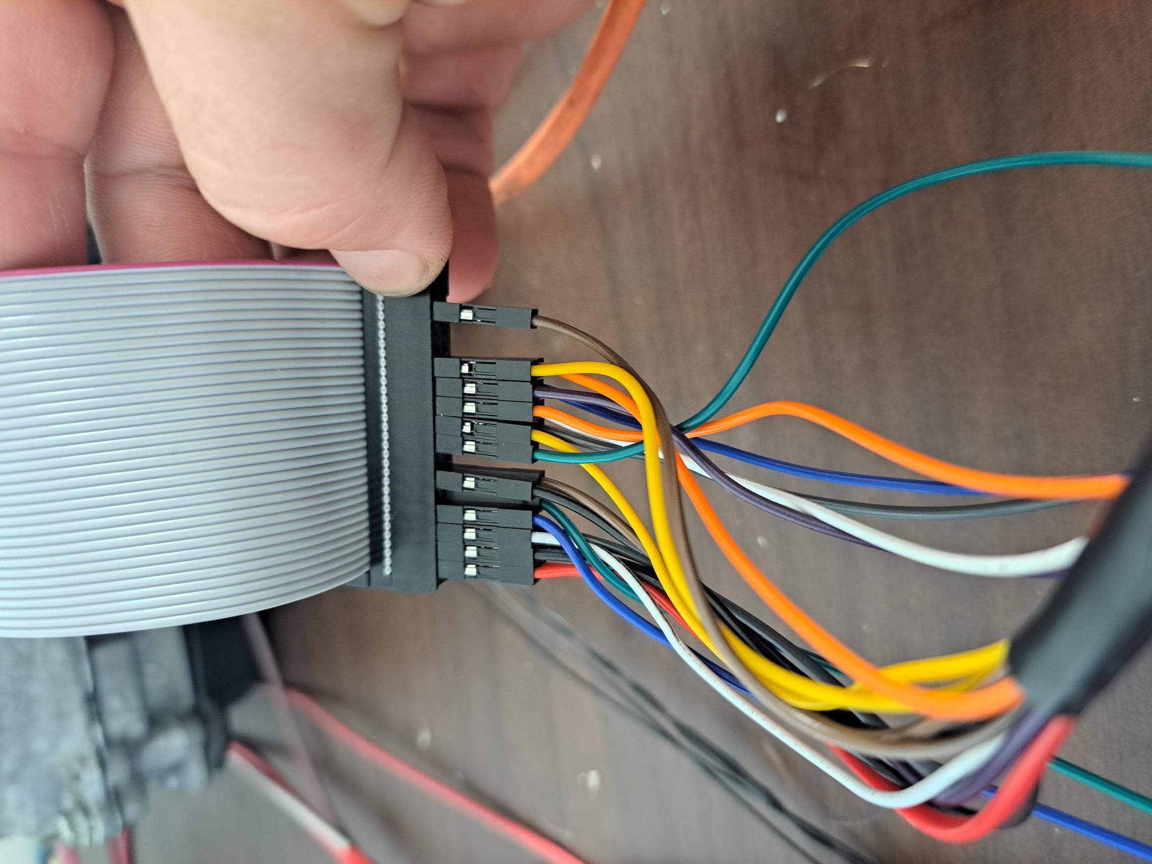

Really struggling with resolver feedback and a HIRESOFS error while going through the FOC tuning steps. Can someone confirm I have this connected correctly? Using jumper wires from the 34 way IDC to the factory Prius connector.
LeonB
Posts: 56
Joined: Fri Mar 26, 2021 12:19 am
Location: Germany
Post by LeonB »
andrewjenkins34 wrote: Mon Jul 25, 2022 3:44 pm Can someone confirm I have this connected correctly?
According to the last image, you connected Enc1 to Cos. I think it needs to be Enc1 to Sin and Enc2 to Cos (the labels are correct, the text right beside it is not.
andrewjenkins34
Posts: 57
Joined: Thu Dec 17, 2020 1:48 am
Been thanked: 15 times
Post by andrewjenkins34 »
So then it should be
Prius: Desc: 34 Way:
1 Ex + 21 MG_2EXCA
2 Ex - 18 GND
3 Sin + 16 MG2_ENC_1
4 Sin - 20 MG2_SINA
5 Cos - 19 MG2_COSA
6 Cos + 17 MG2_ENC_2
Does that look correct?
