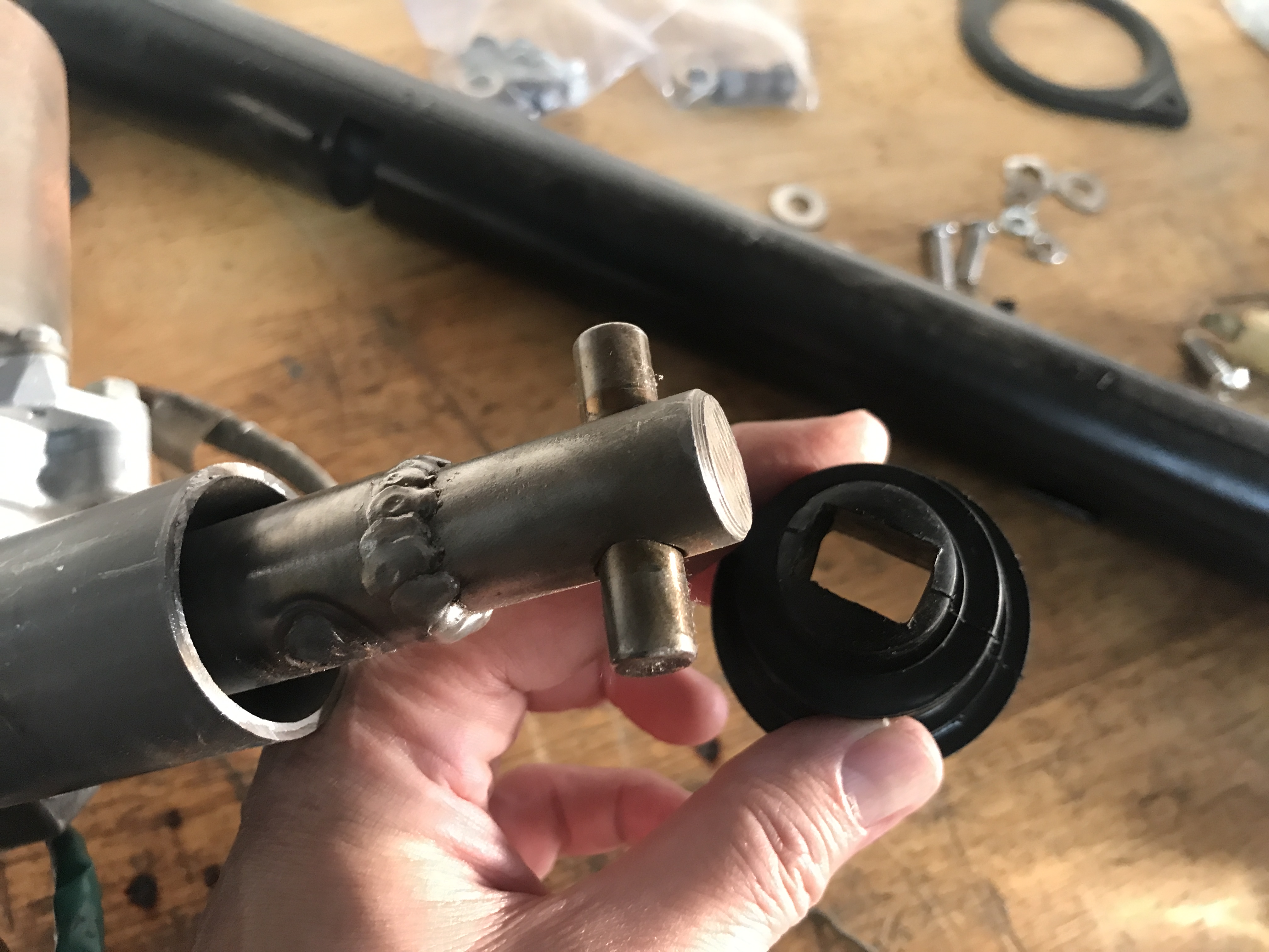

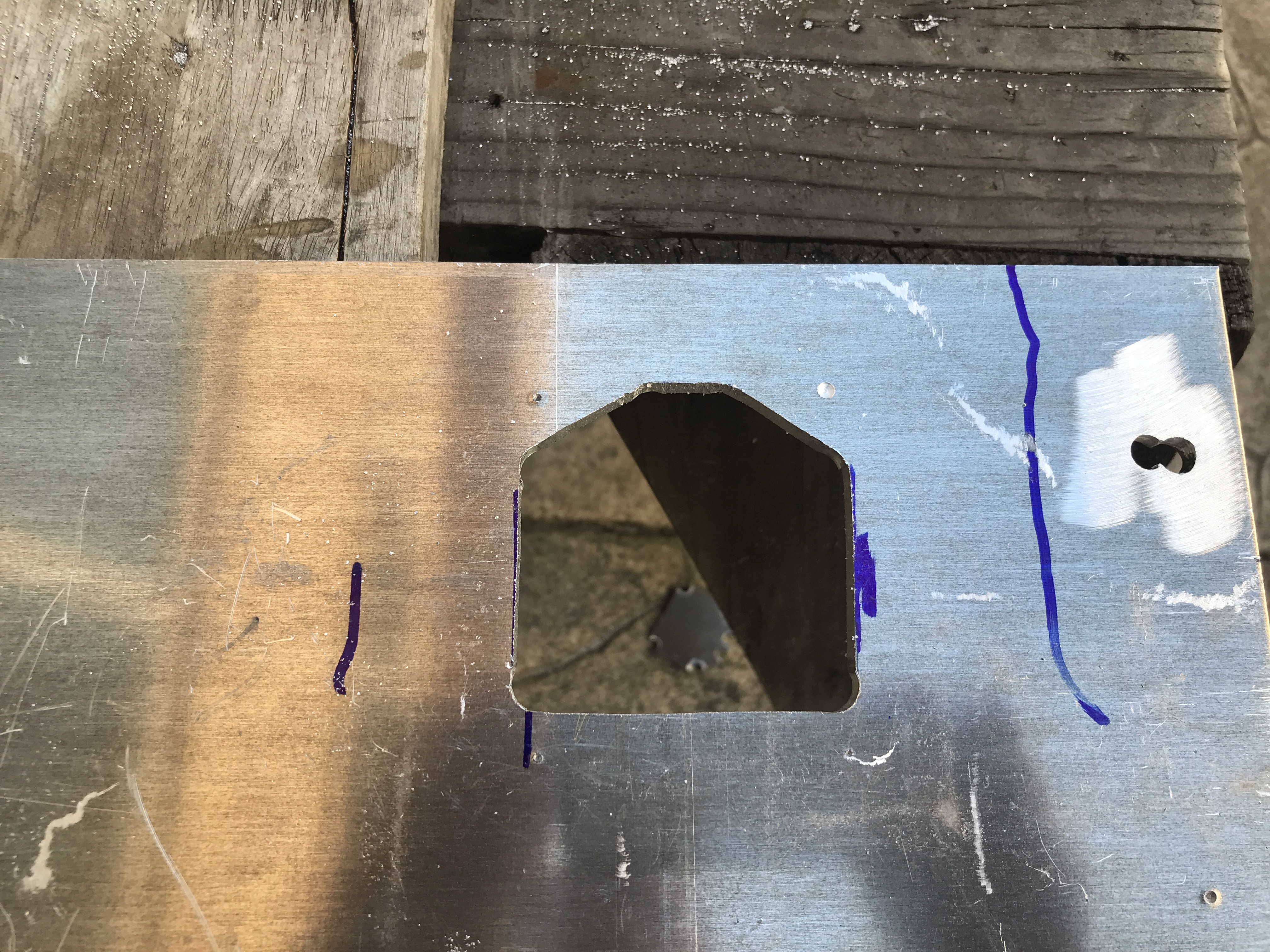

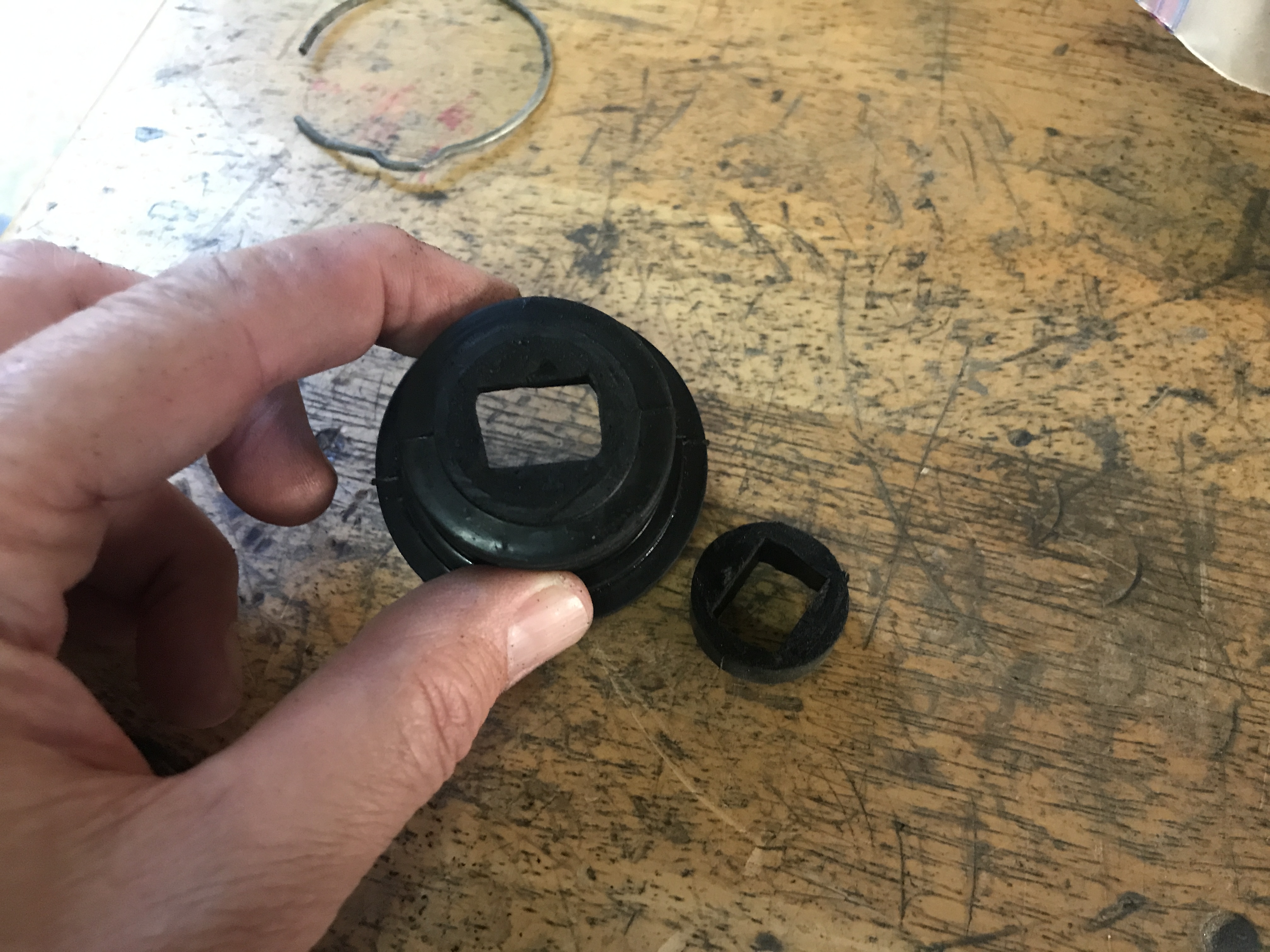

round peg square hole, how does that go?
so you cut off the square part and what do you have left?
you can't make this stuff up folks:

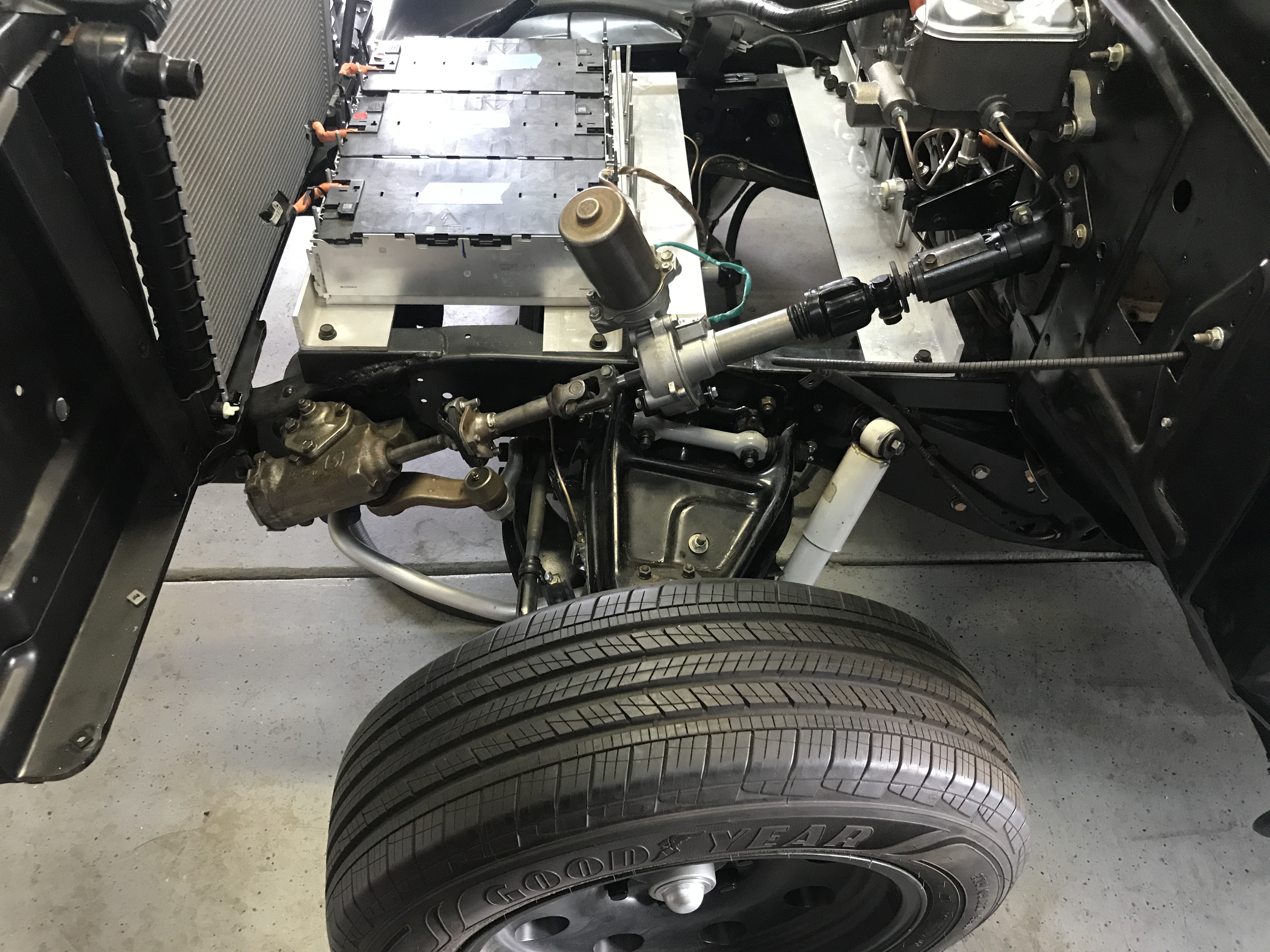

Post by Gregski »

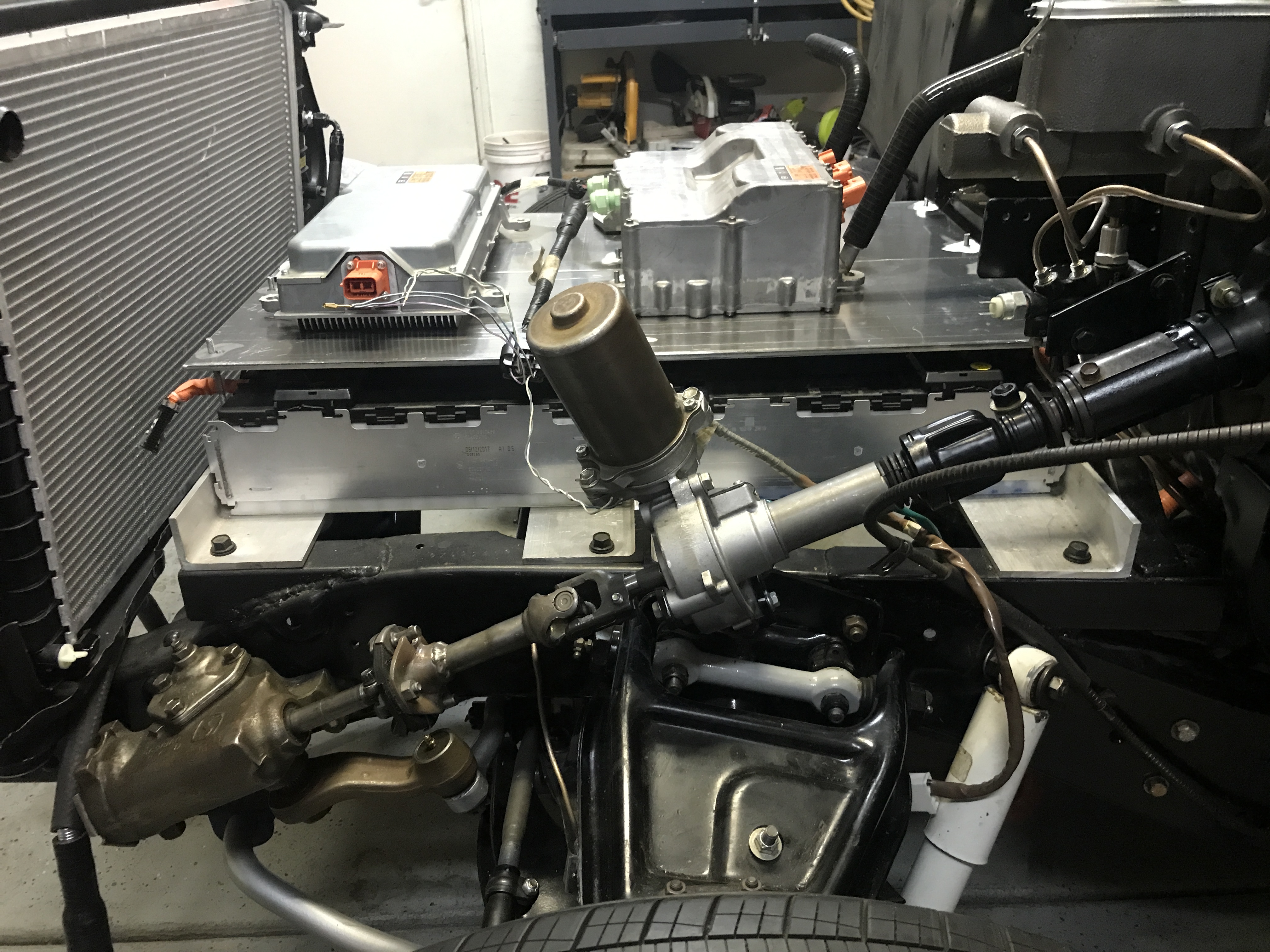

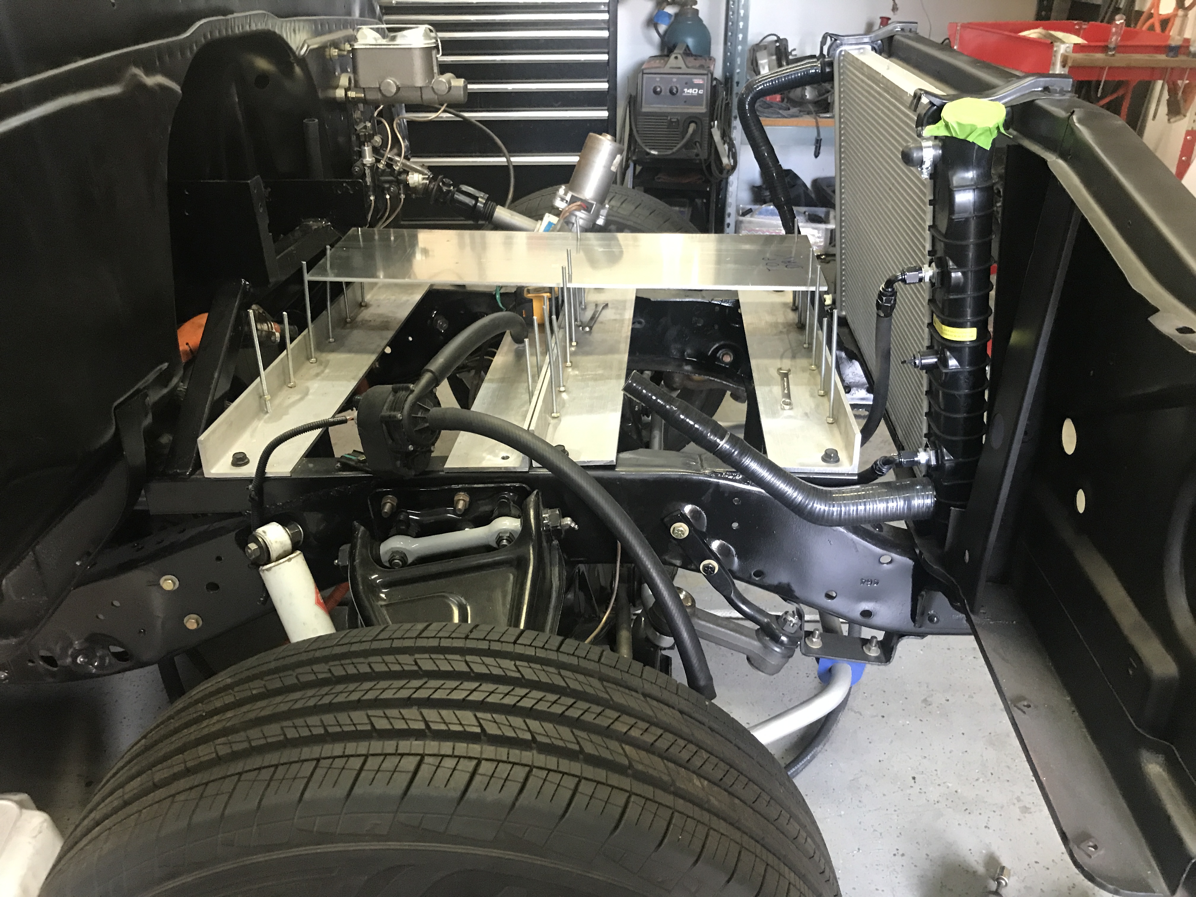

and the Toyota Prius electric power steering is back in
Gregski
Posts: 3163
Has thanked: 631 times
Been thanked: 1609 times
Post by Gregski »
got the Toyota Prius electric power steering installed

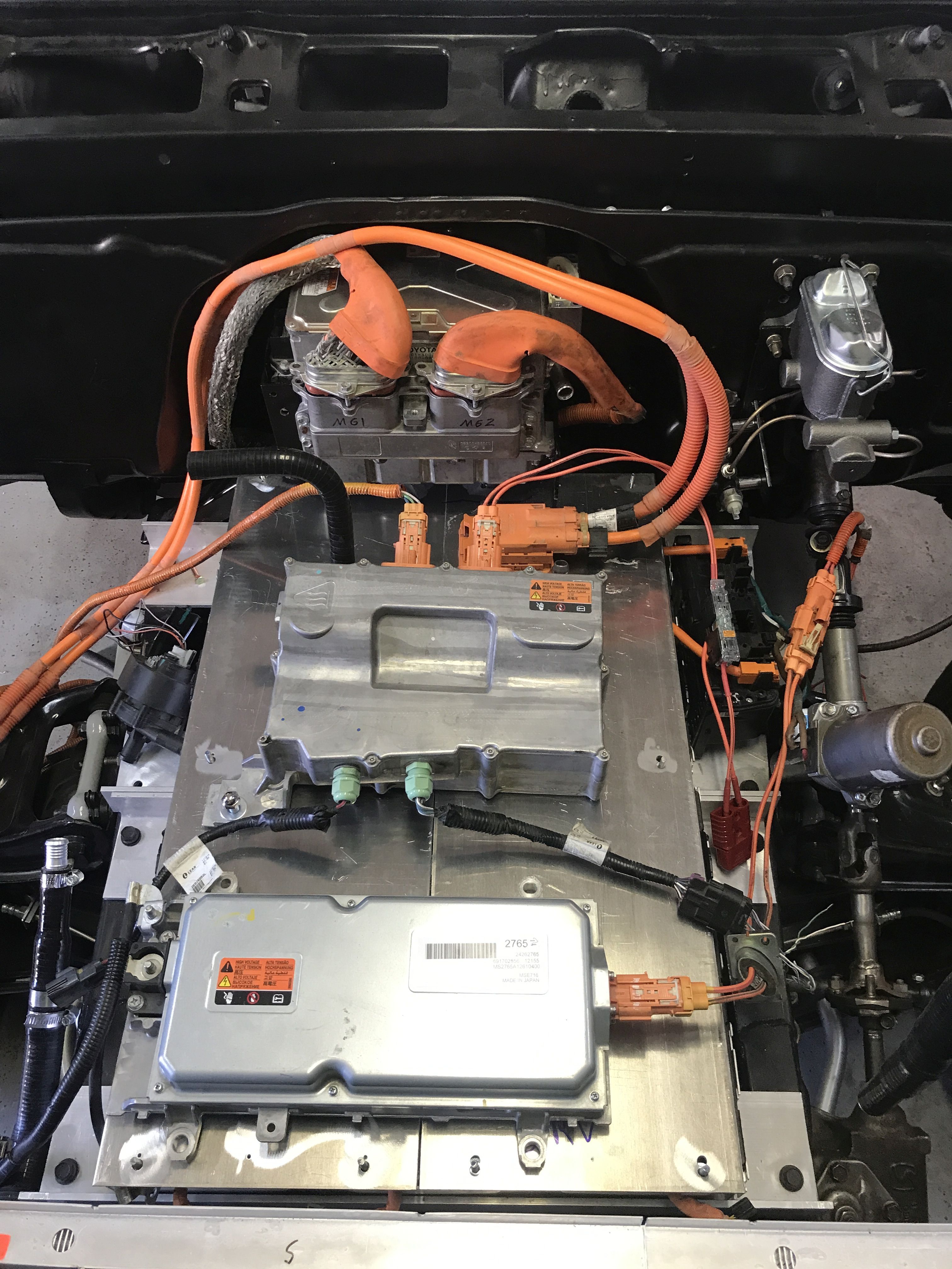

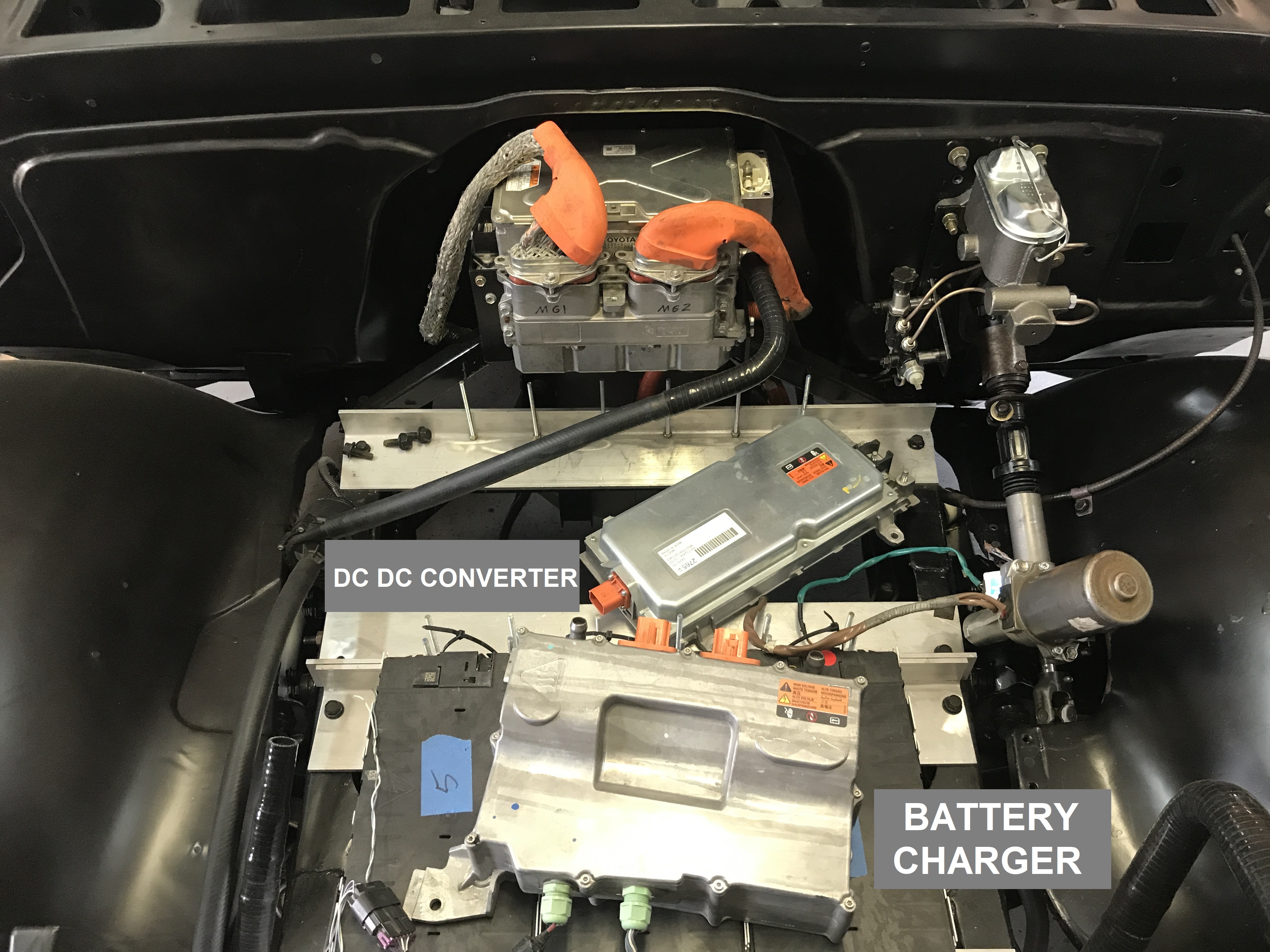

Post by Gregski »

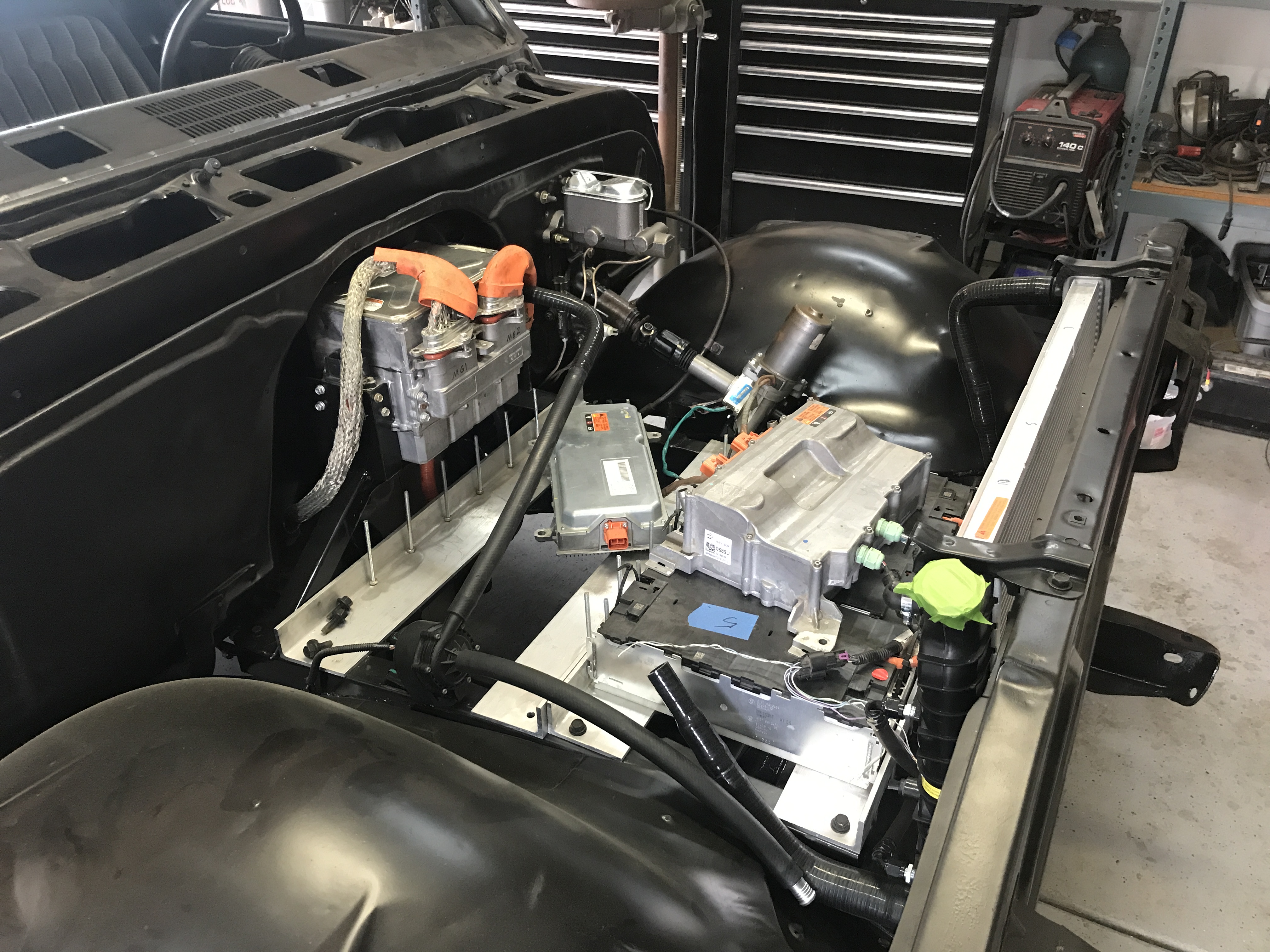

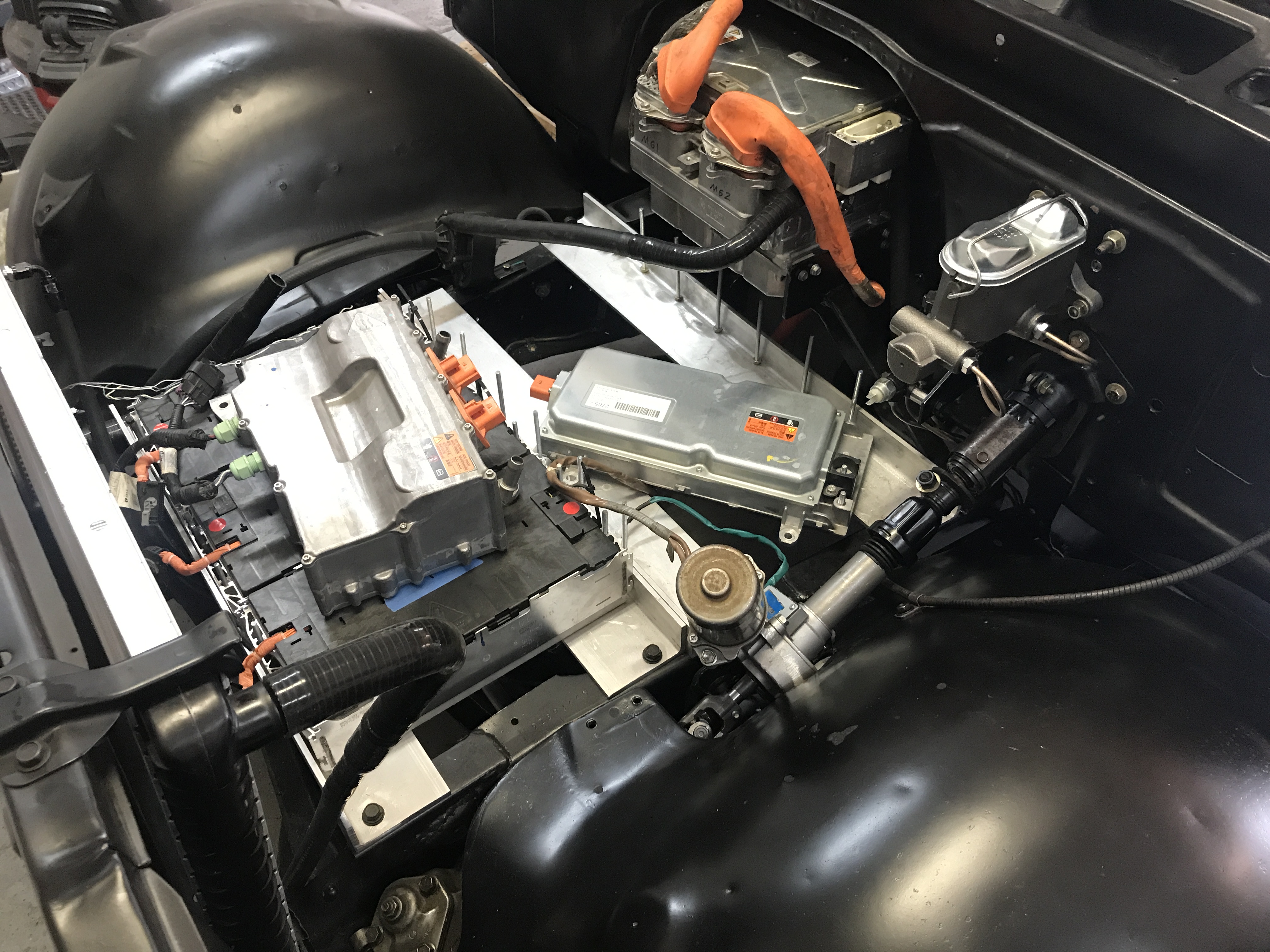

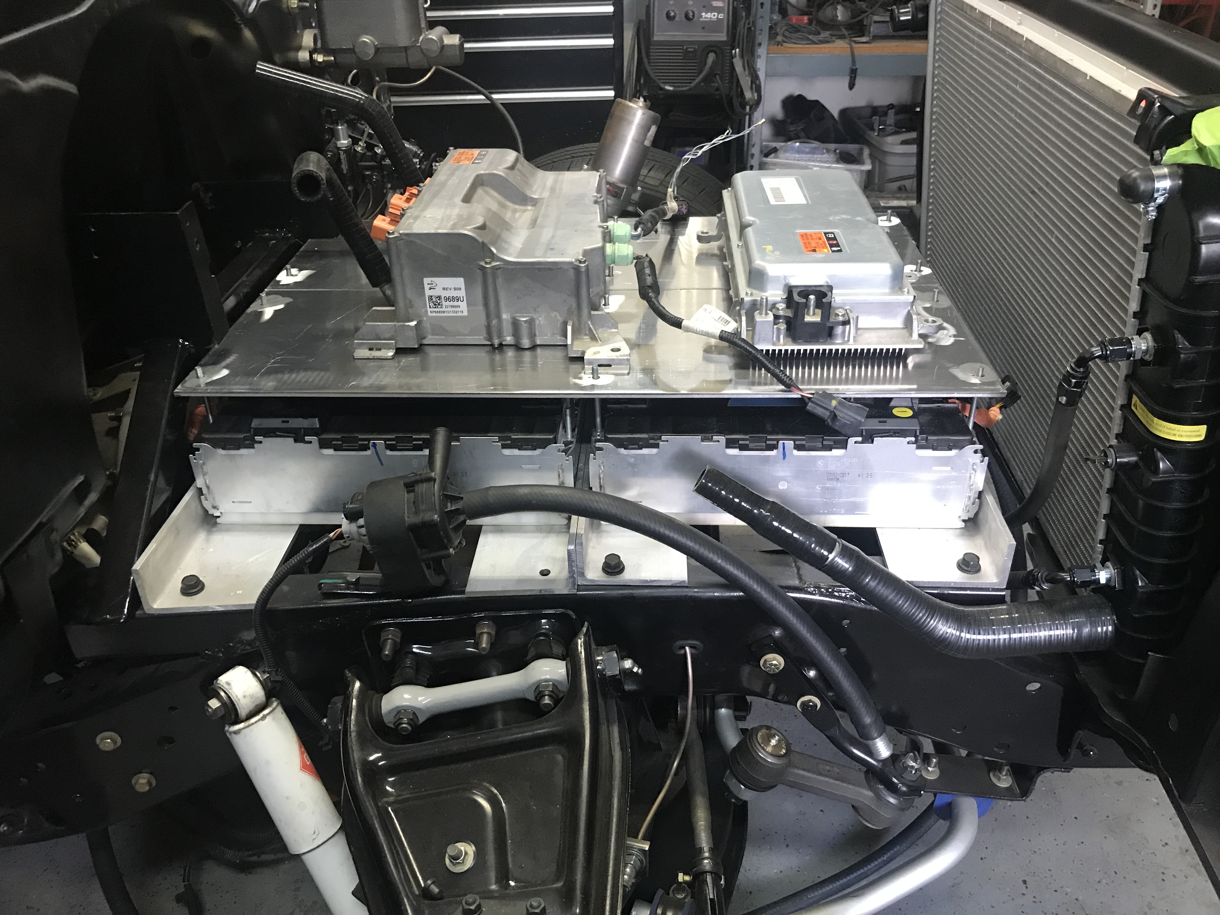

Gen 1 Chevy Volt charger and DC DC converter
keeping the Chevy GMC, Lexus, BMW, Prius, Honda, Tesla all stock for the purists

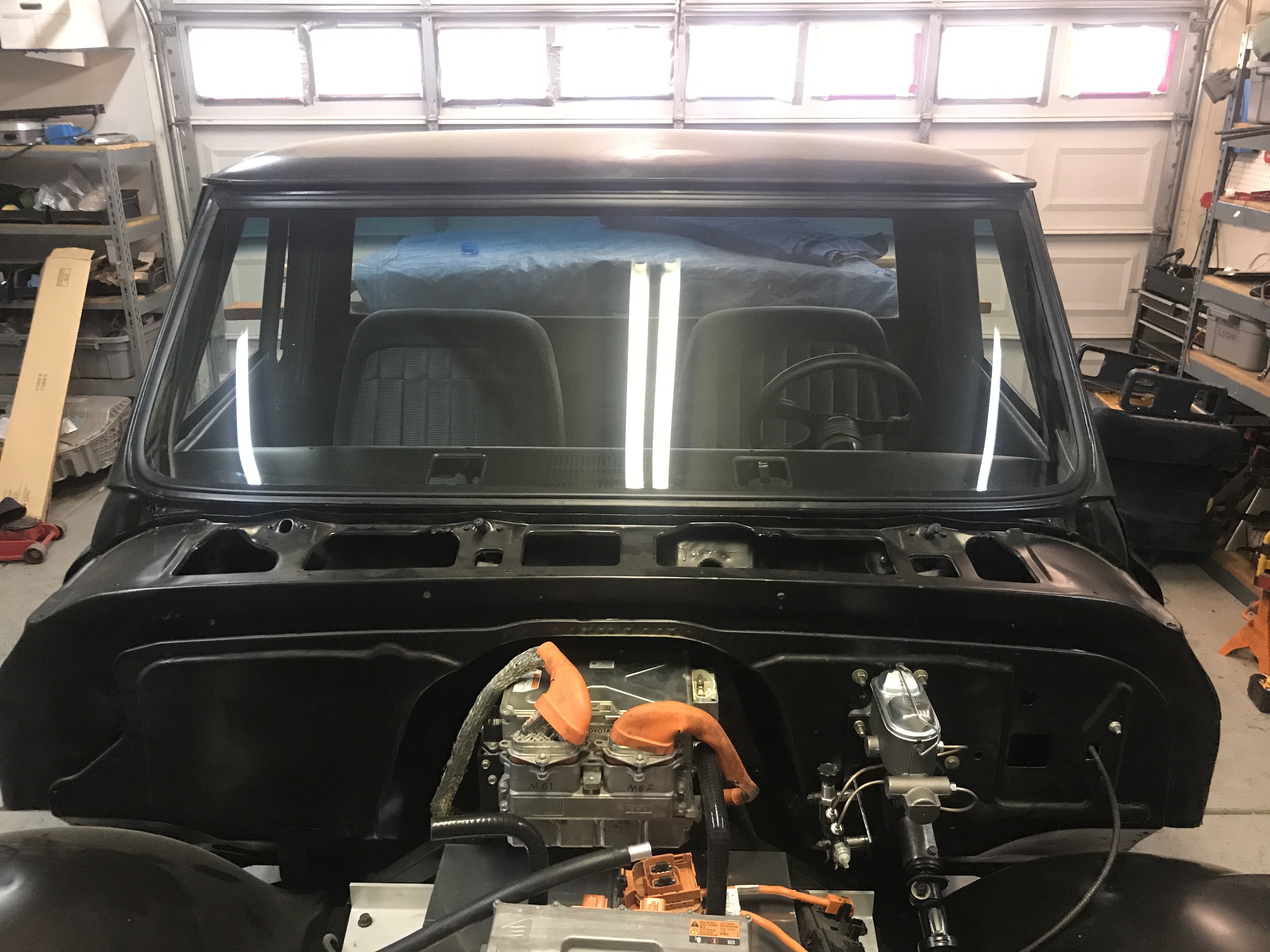

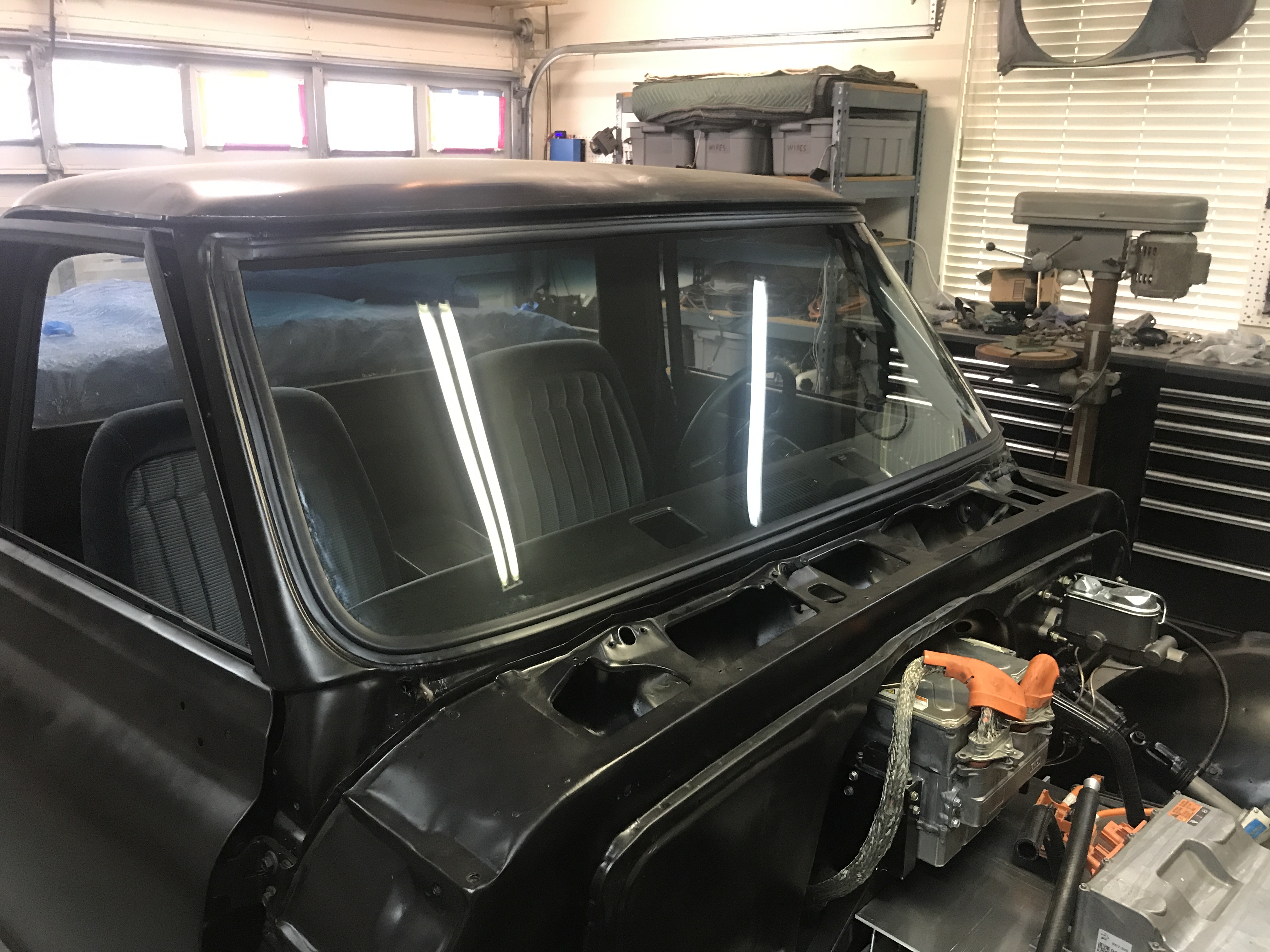

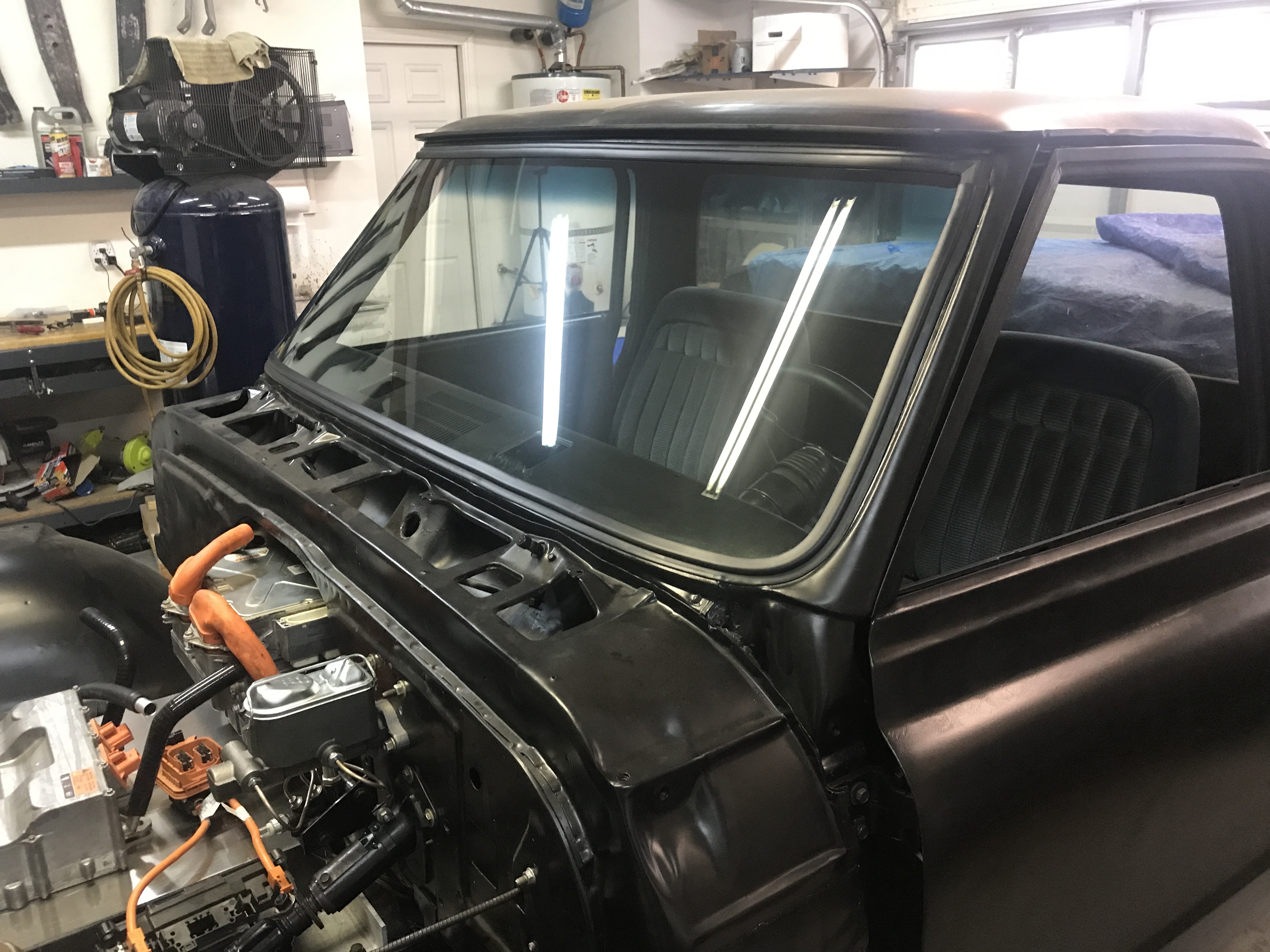

Post by Gregski »
got a new windshield installed, took the guy three hours, so glad I farmed this out, quoted me $330 but I paid him $400 I don't think he'll do one of these ol' Chevys for a while l0l I'm sharing what I paid cause the quotes I received were all over the place
a little walk around video

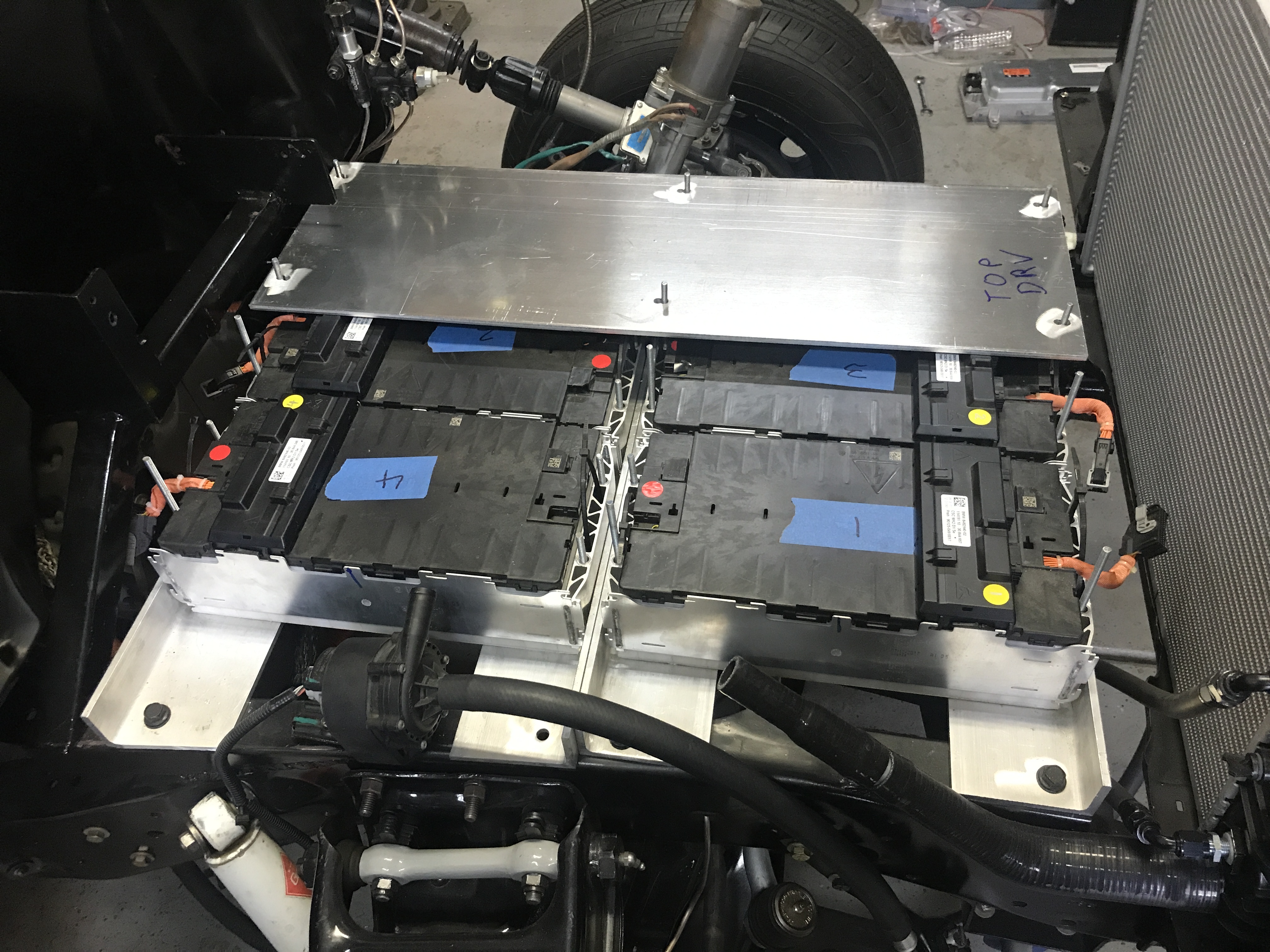

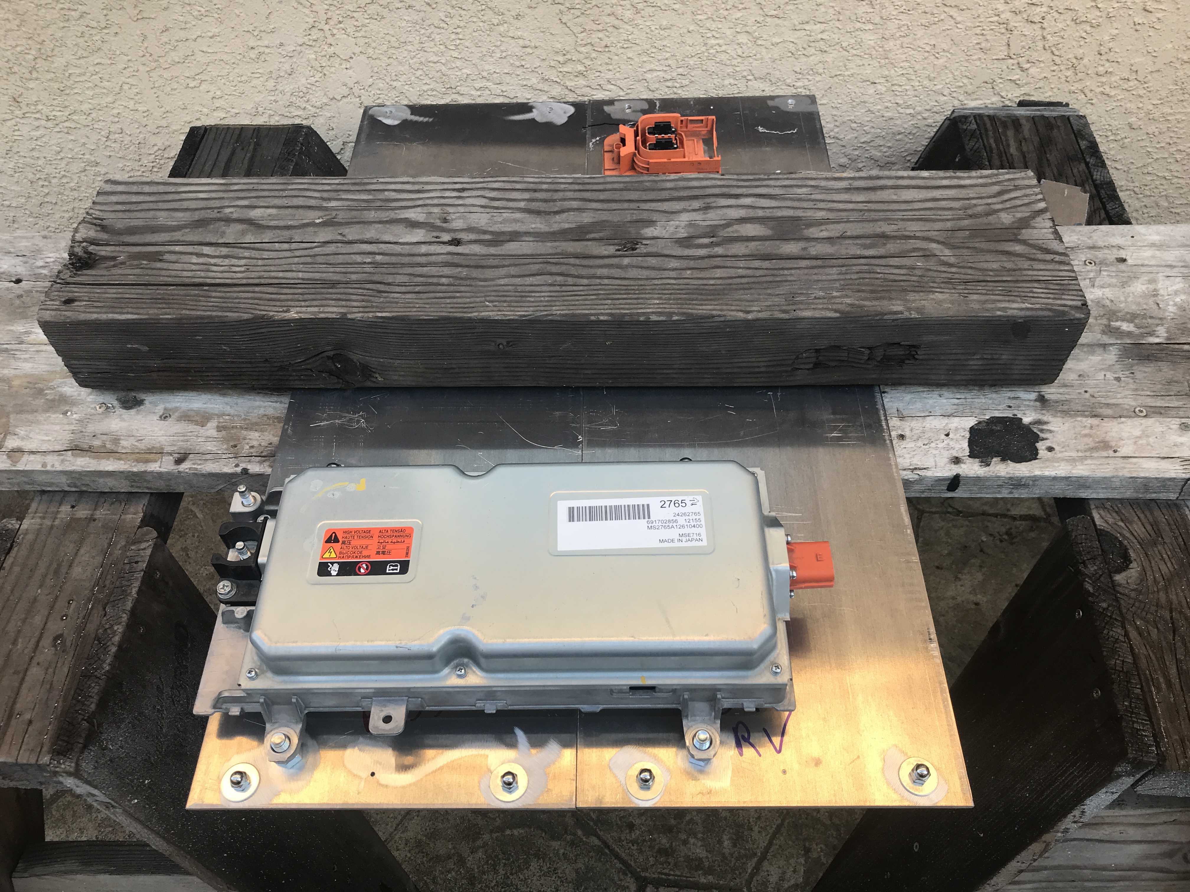

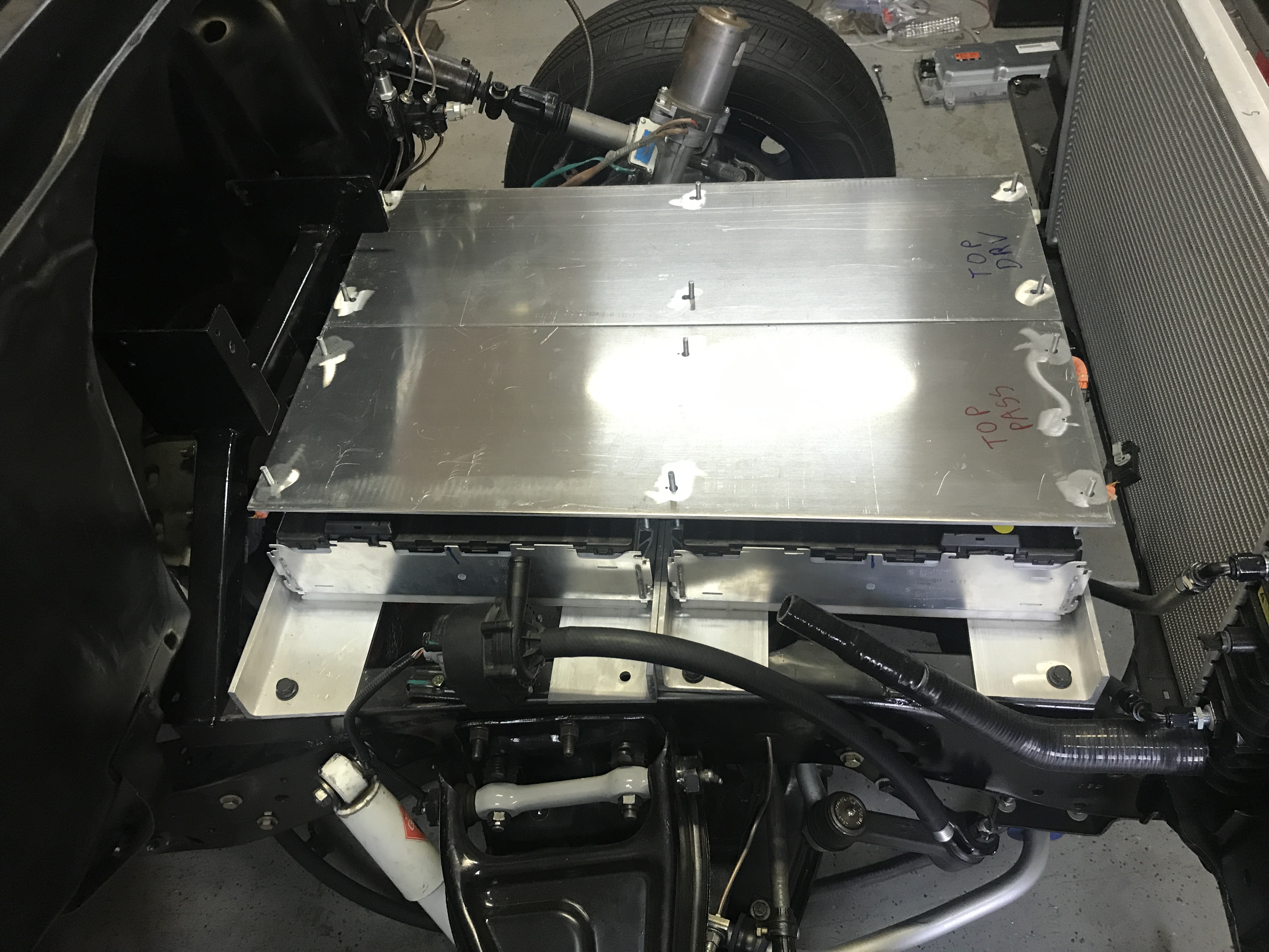

Post by Gregski »

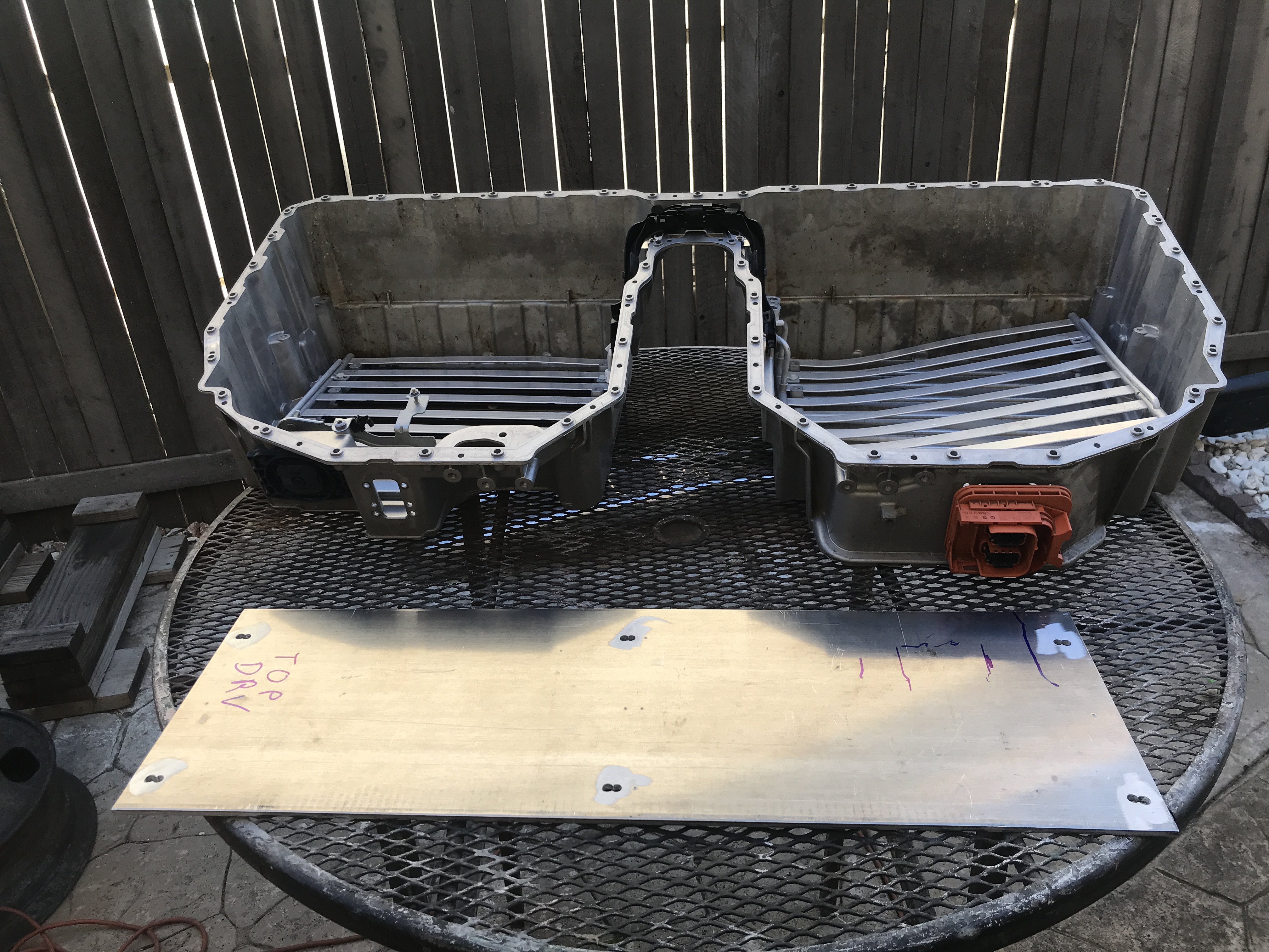

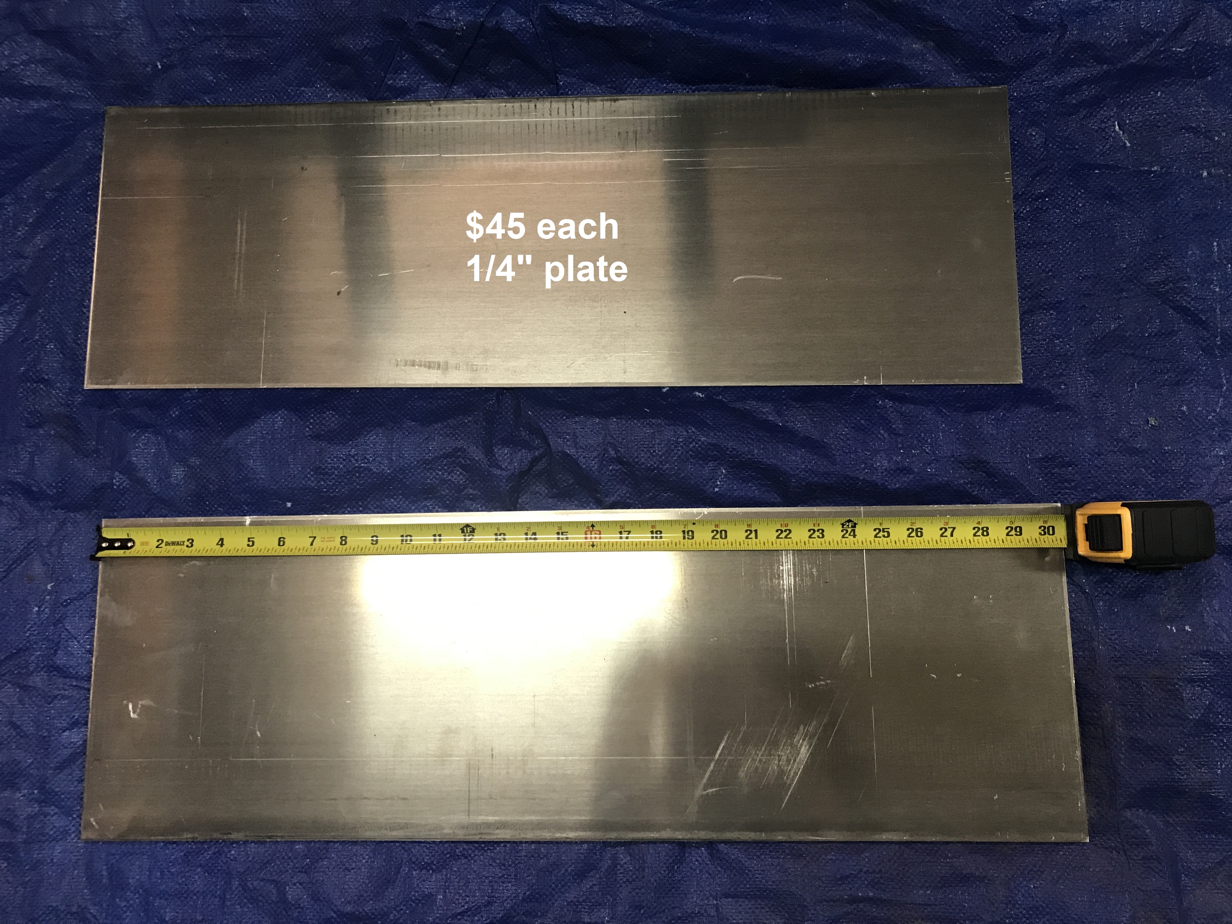

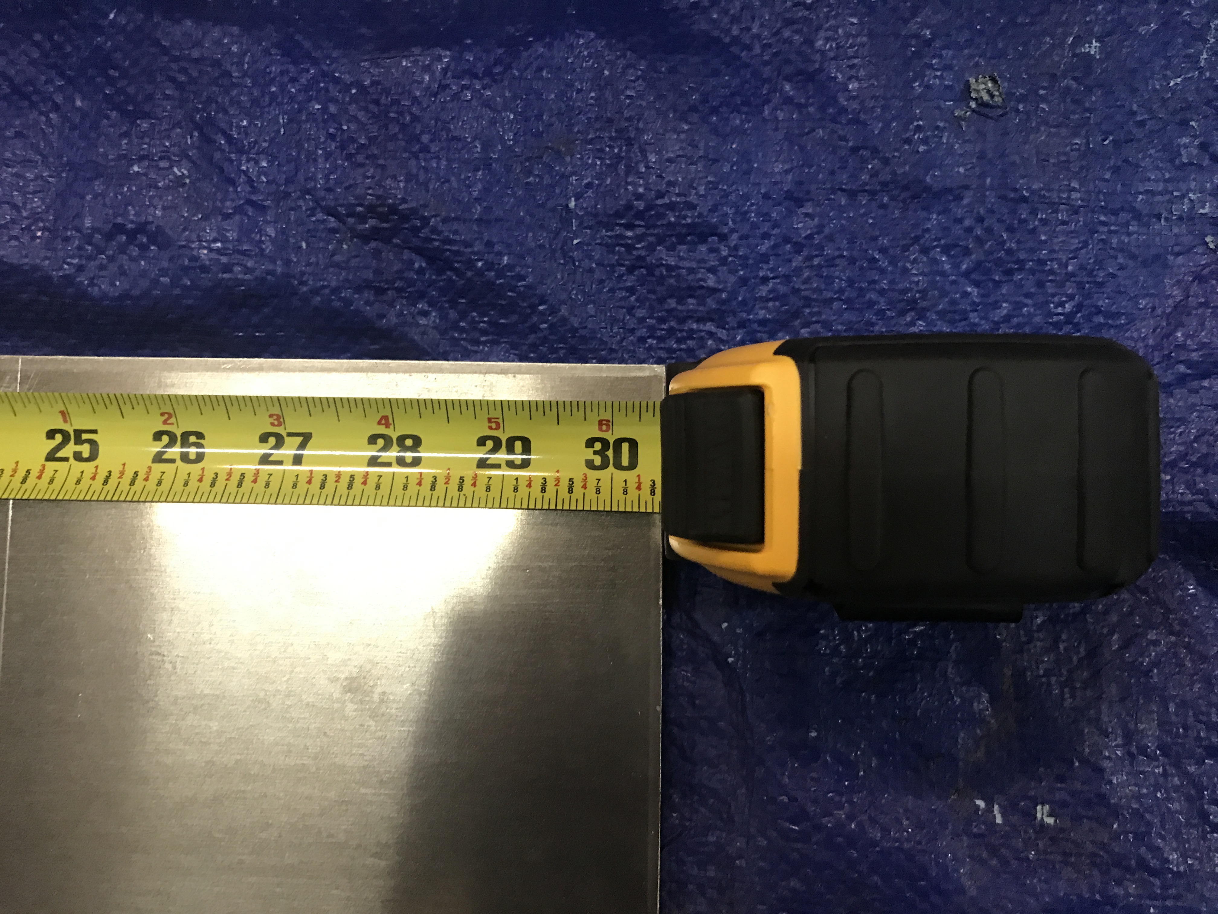

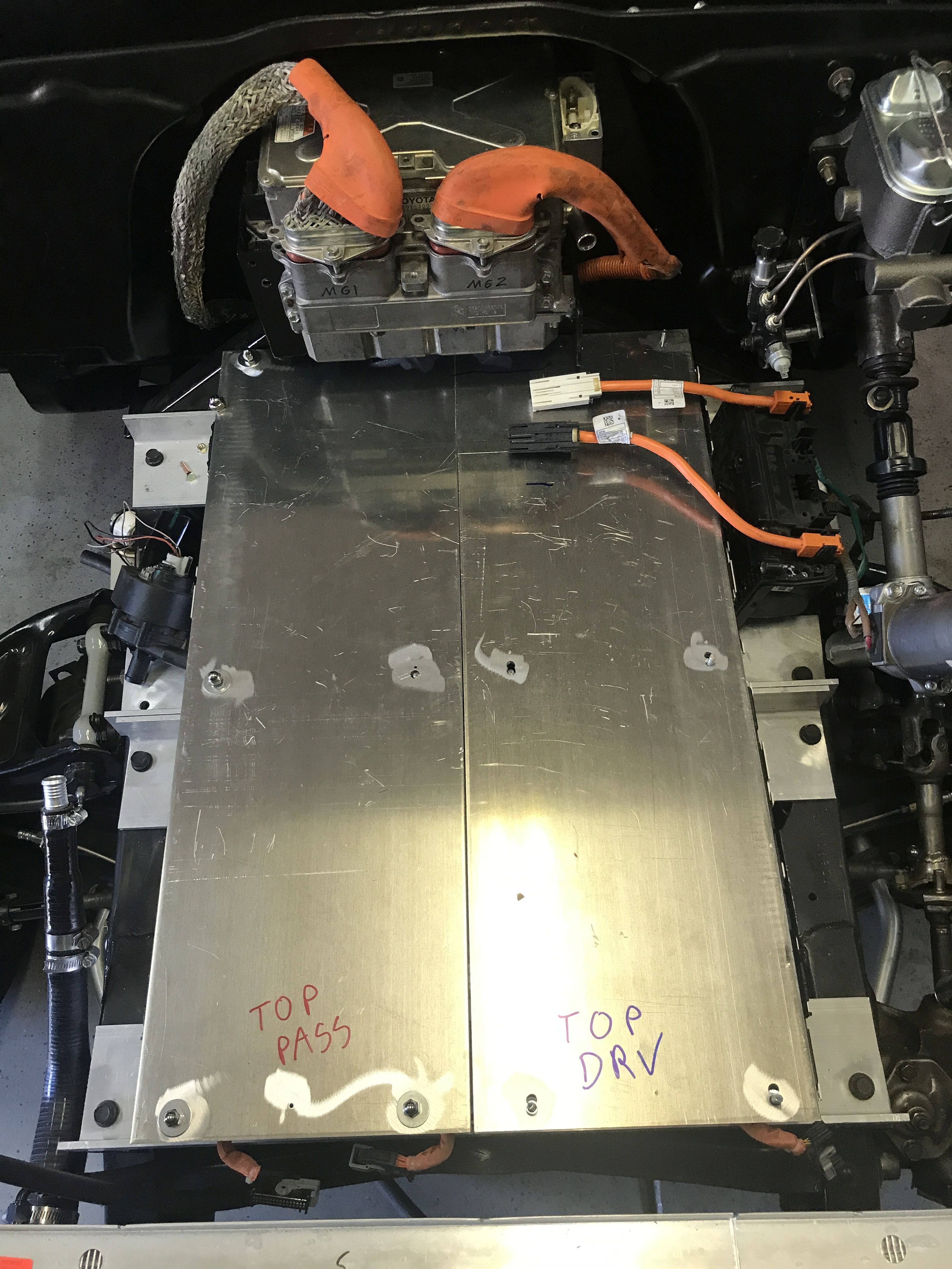

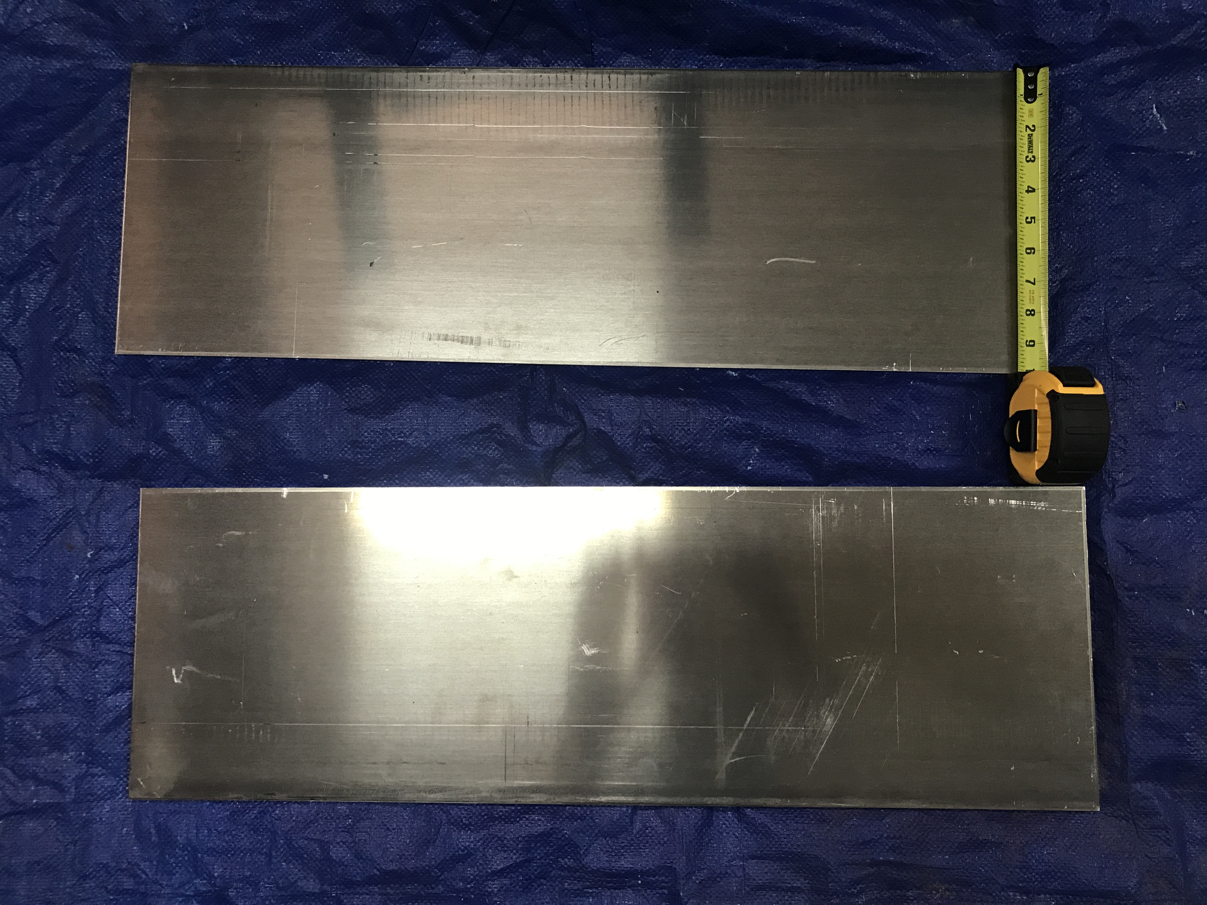

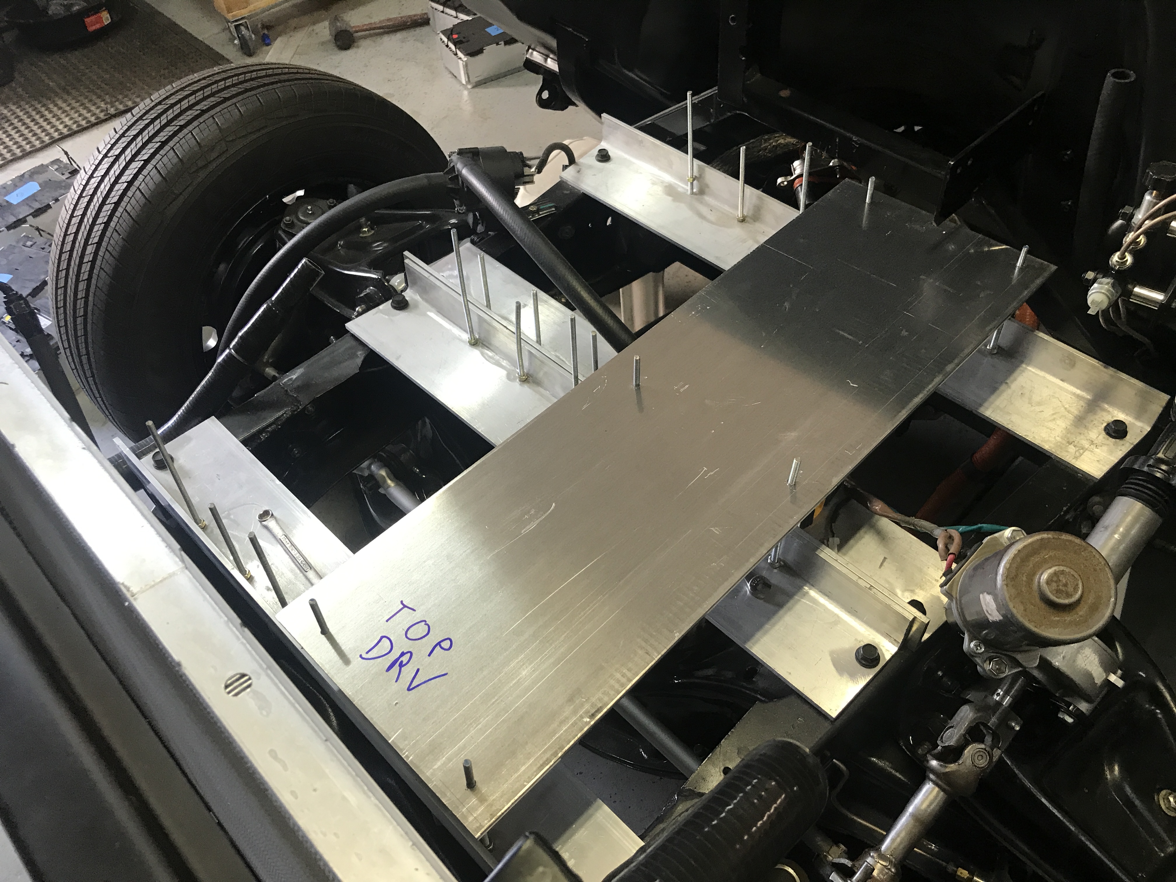

so I went to my favorite mum and pop metal house and got me some alumininininumnum to mount on top of the battery tray
this was from their remnants ie left over pile so I did not pick these sizes on purpose we gonna work with what we found, fortunately our battery tray be 30.5" long so these were perfect length
Gregski
Posts: 3163

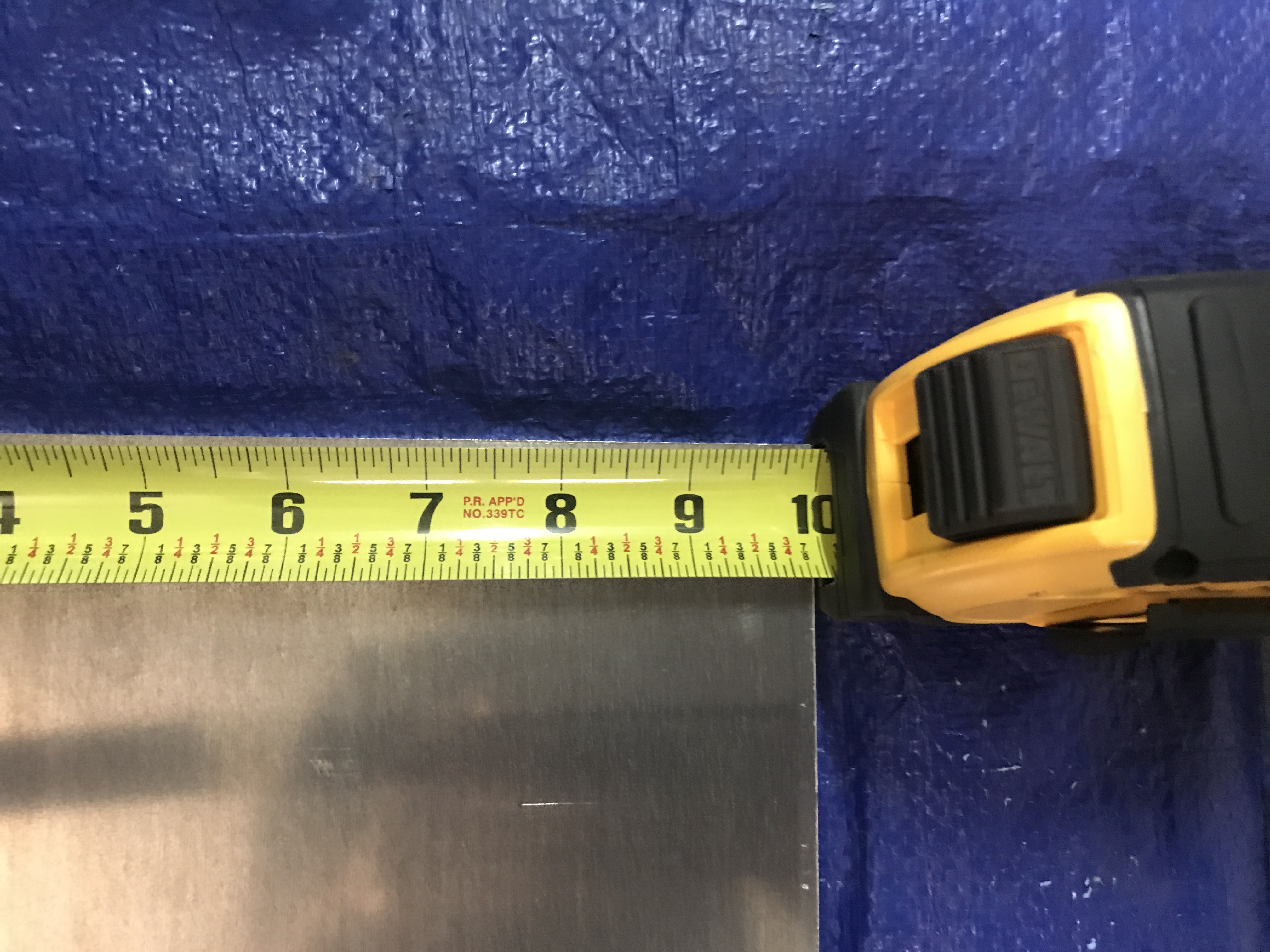

Post by Gregski »

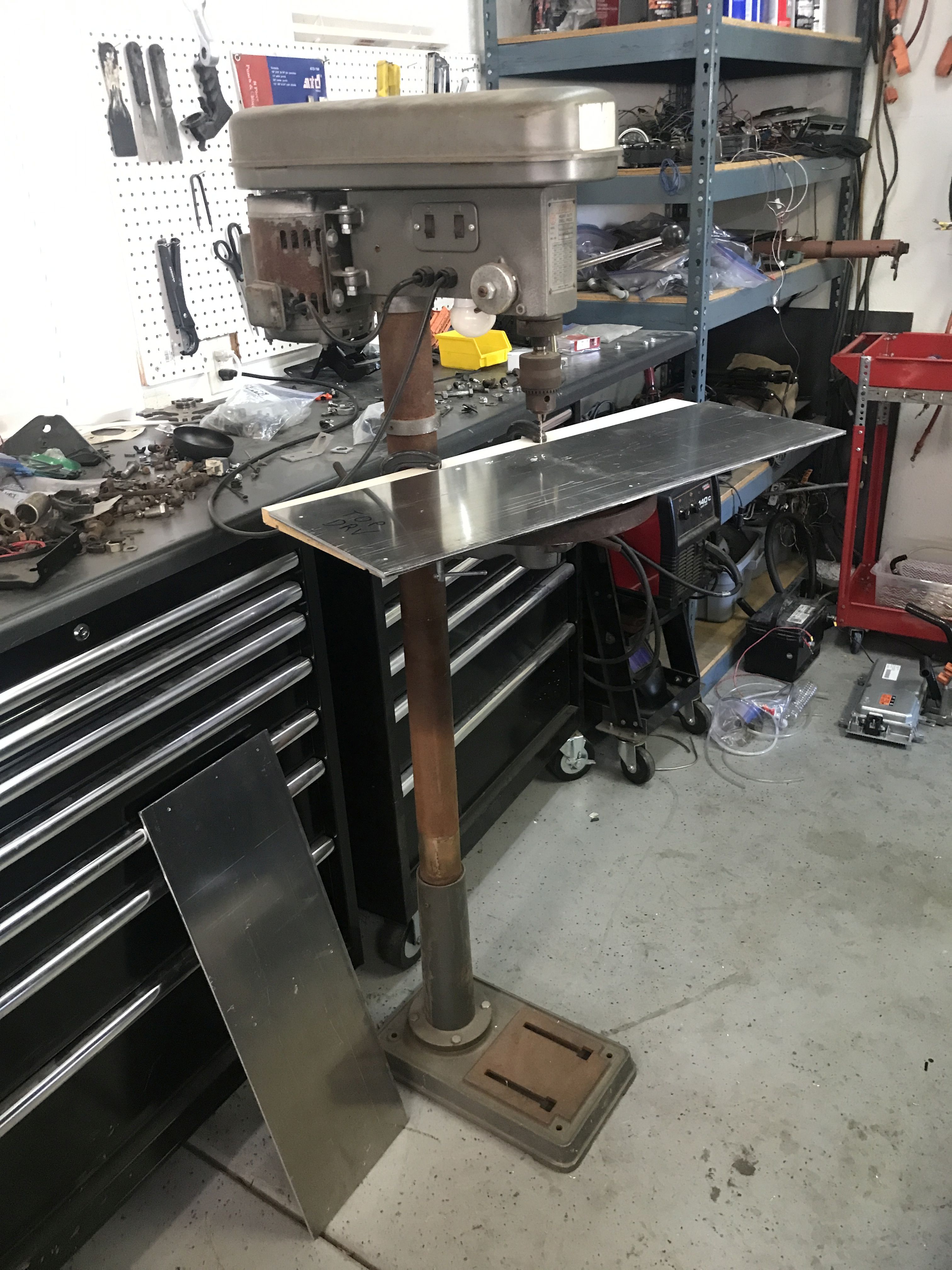

I don't usually drill perfect size holes, but when I do I make sure my measurements are off by 1/2 an inch !
Gregski
Posts: 3163

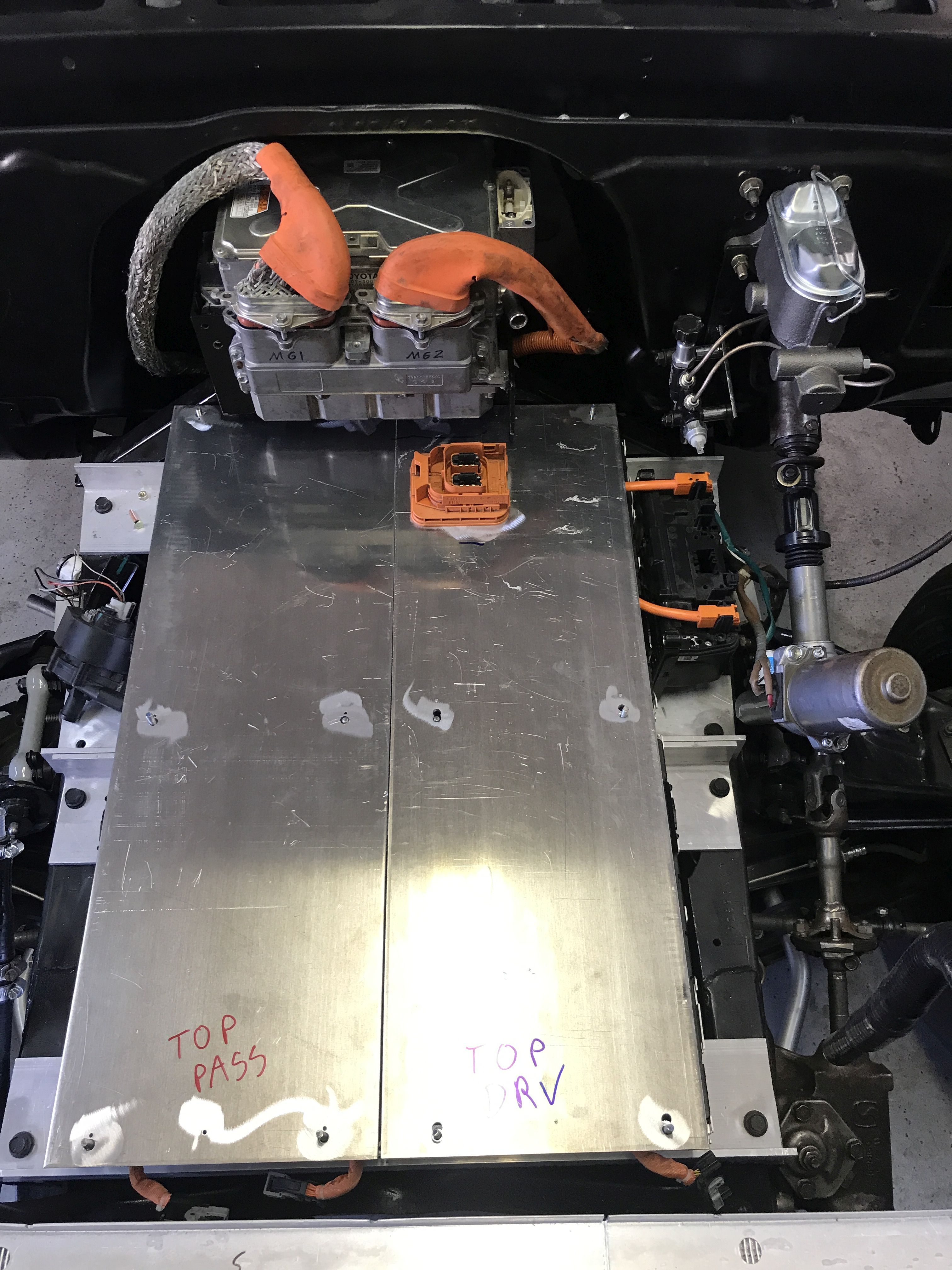

Post by Gregski »
pretty happy with the result, wish each of the plates was about an inch wider, but oh well not bad for ver 1.0

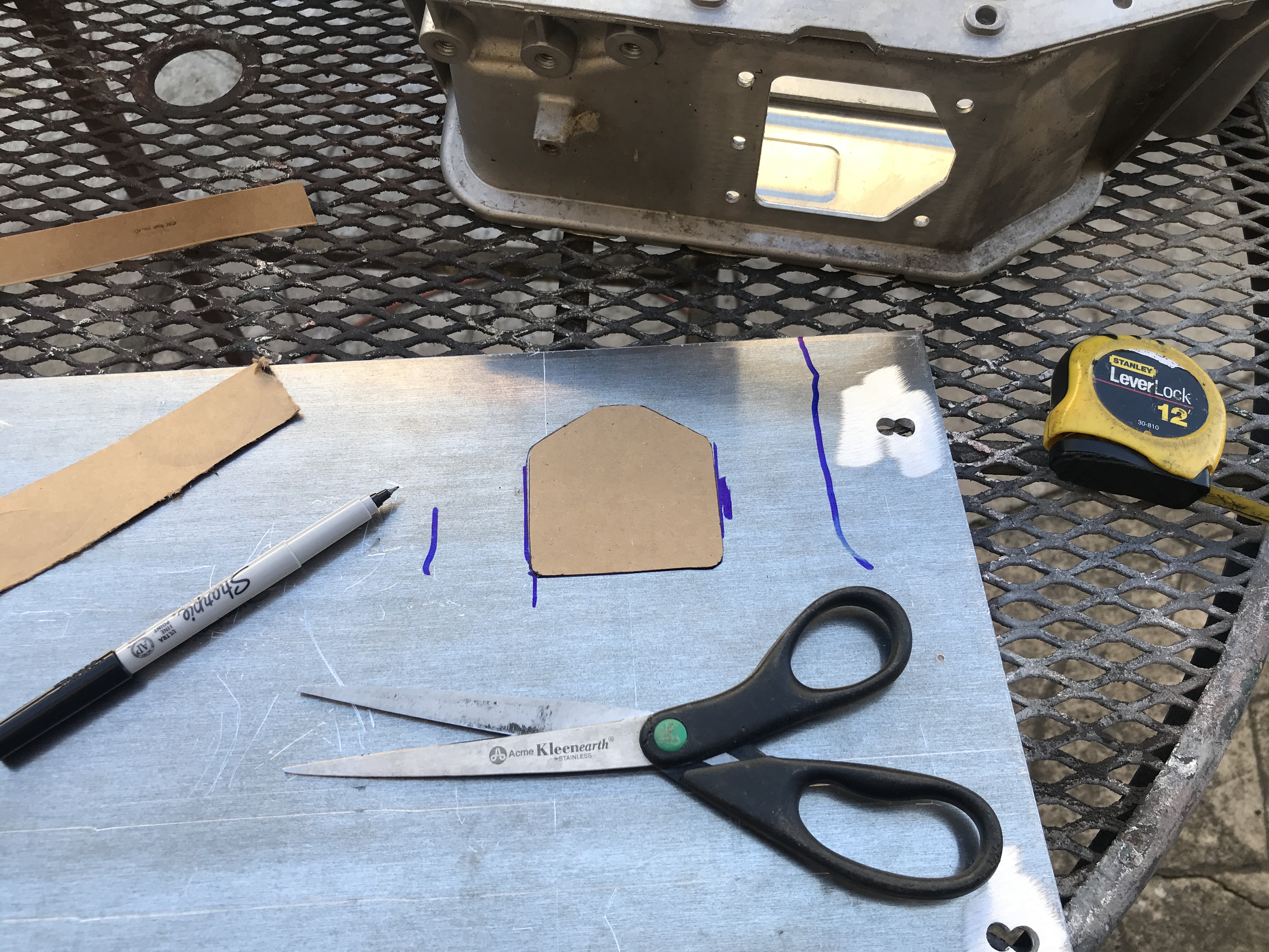

just thinking outside the box

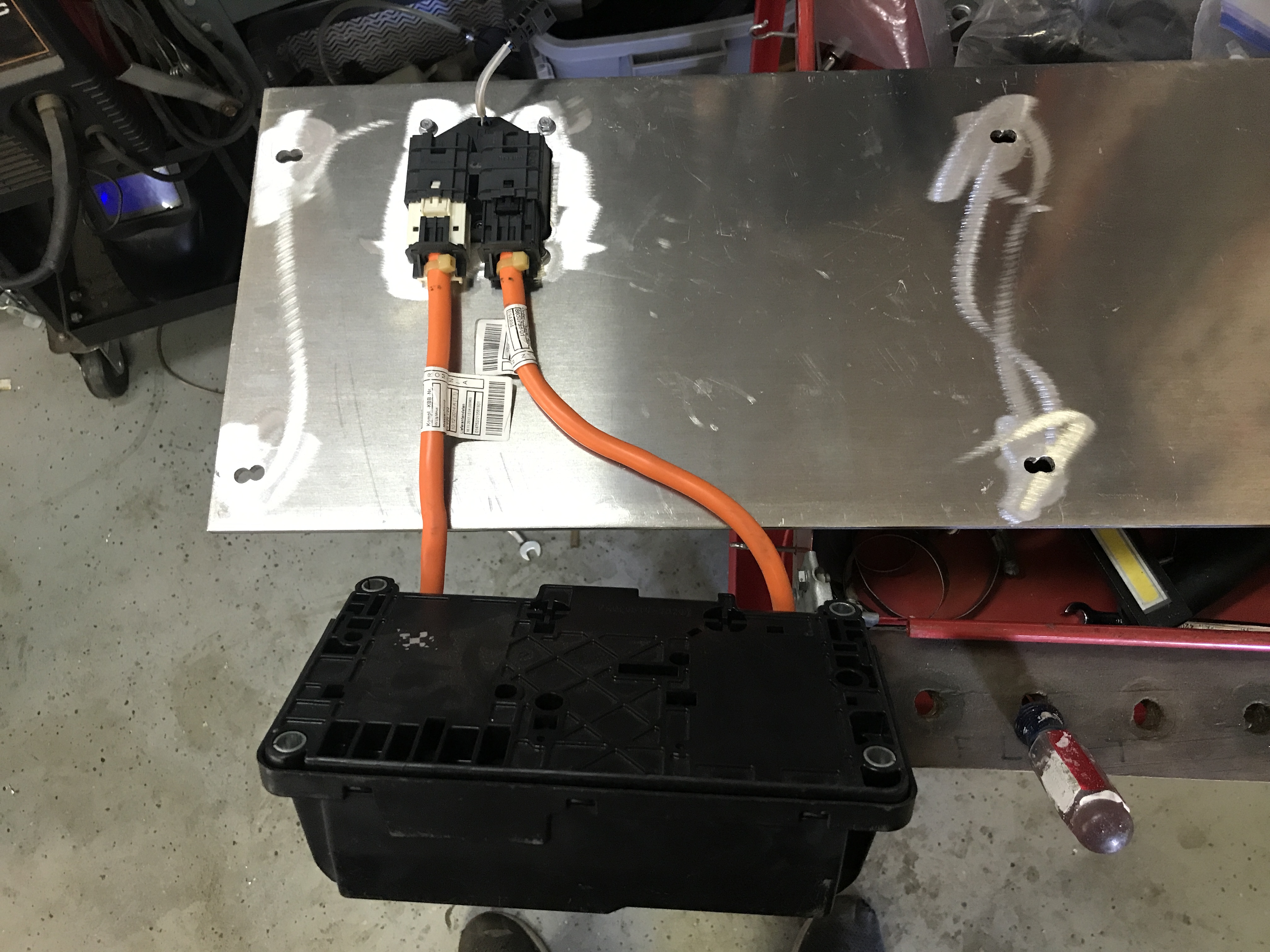

Post by Gregski »

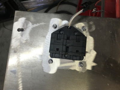

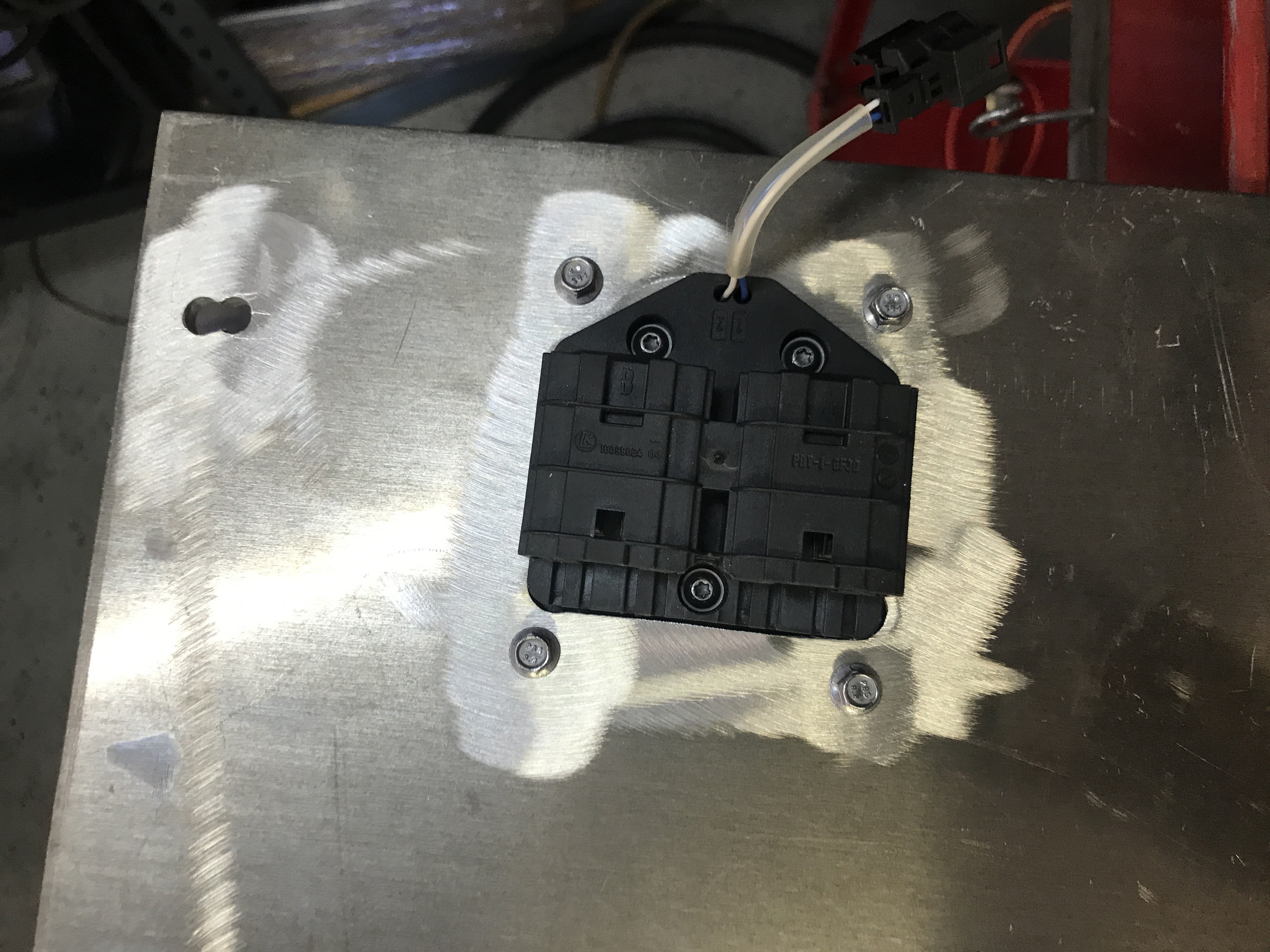

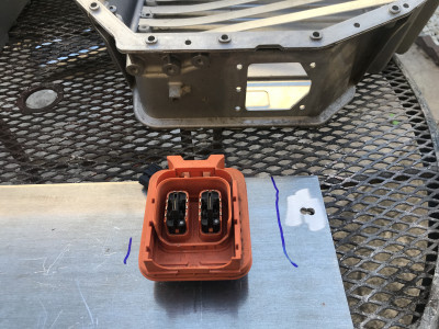

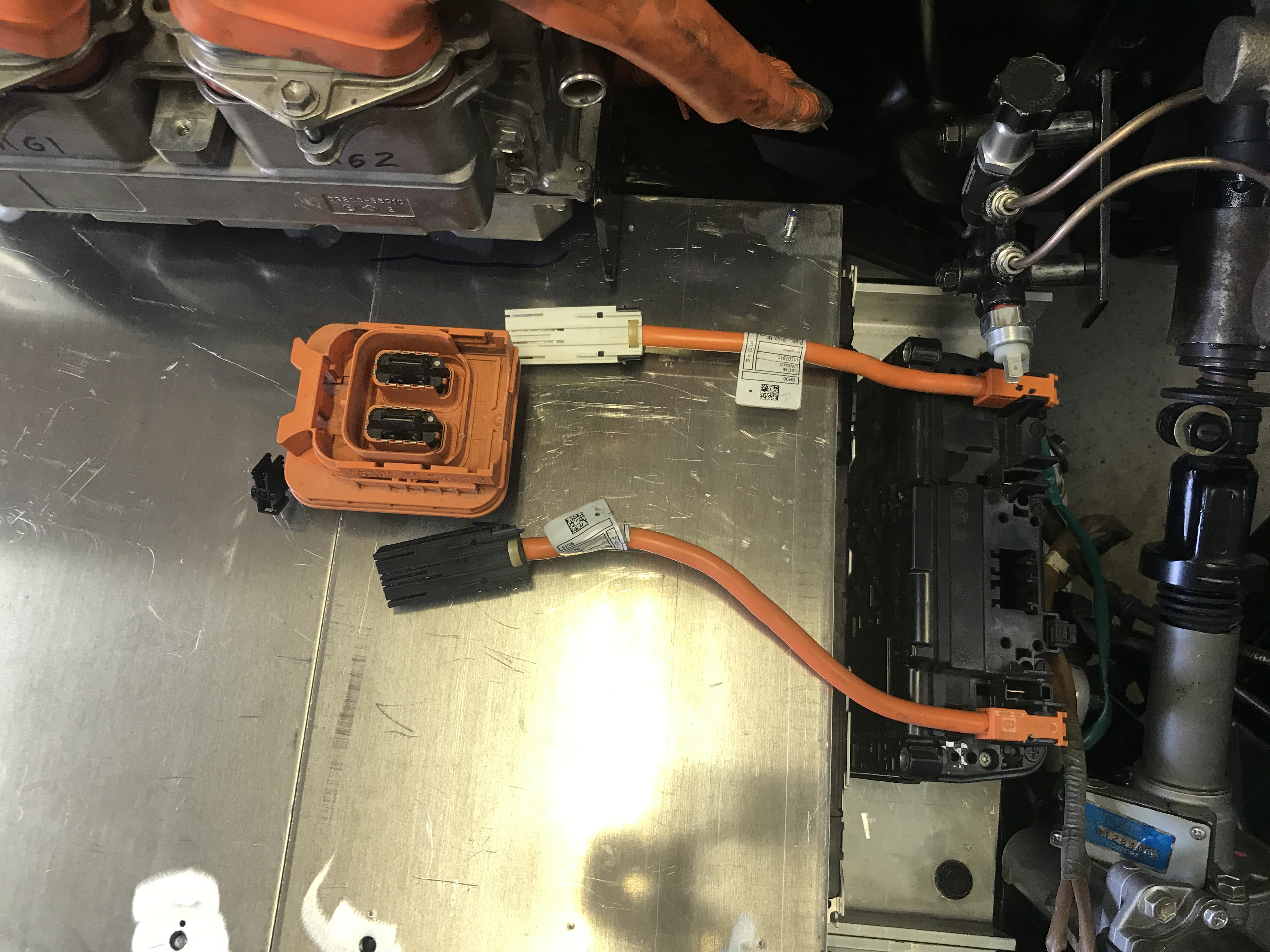

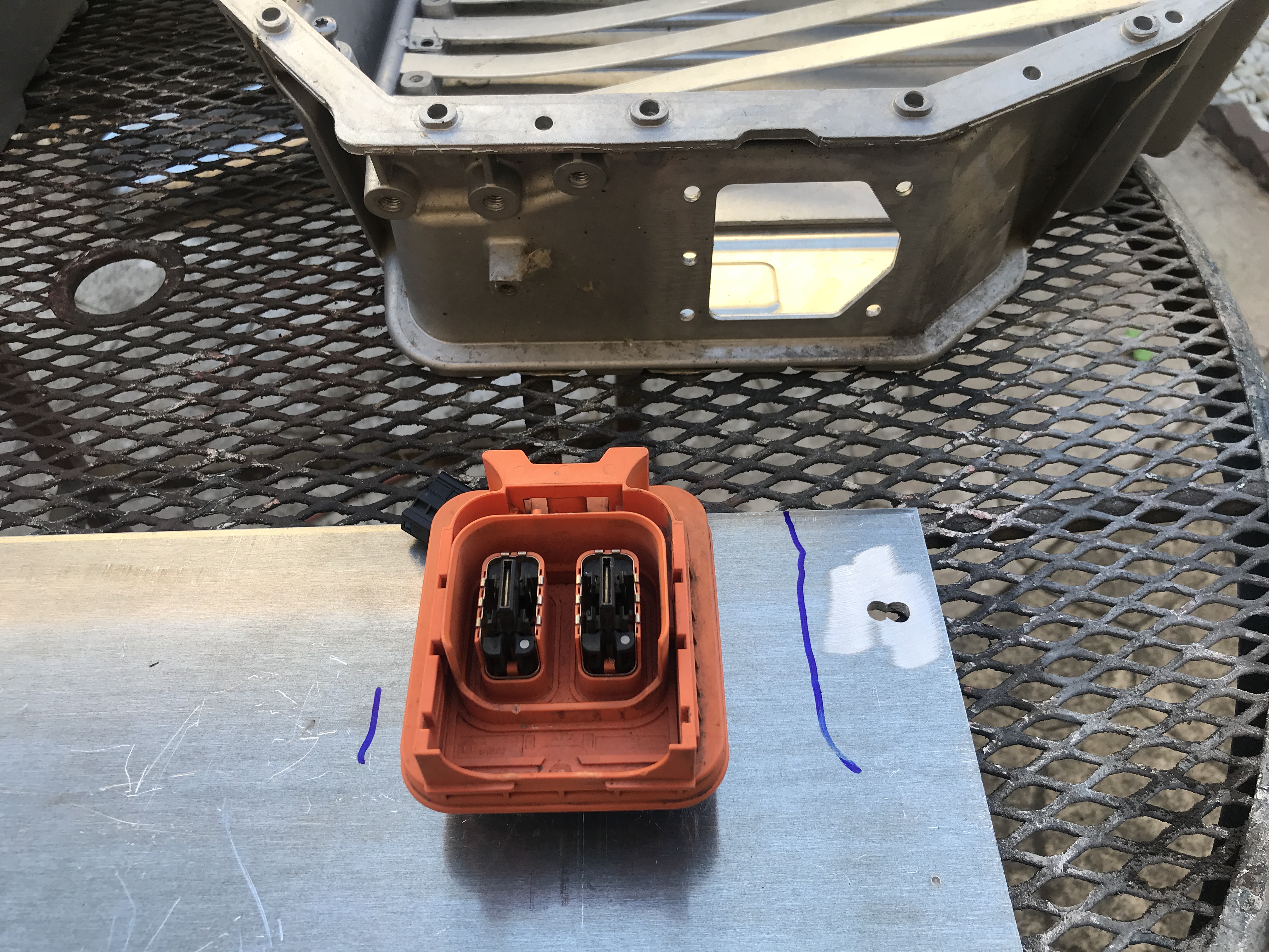

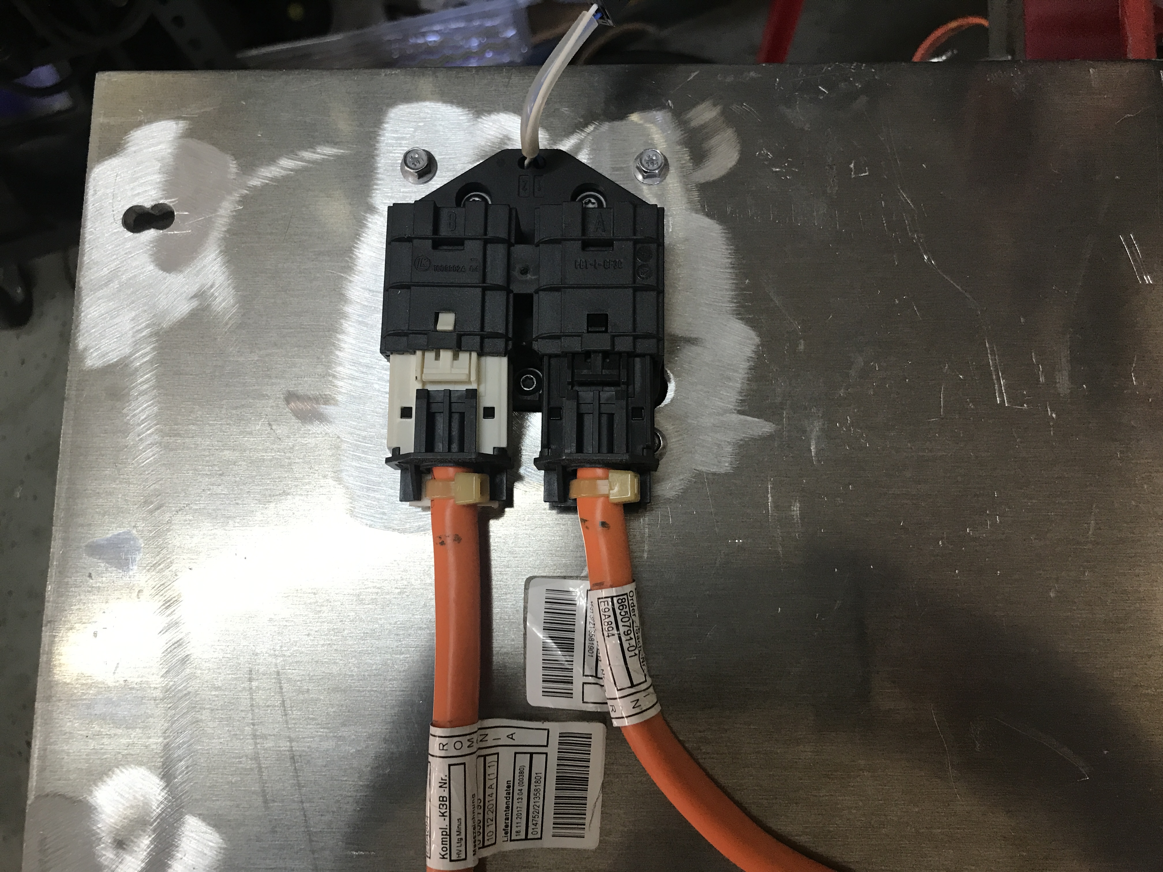

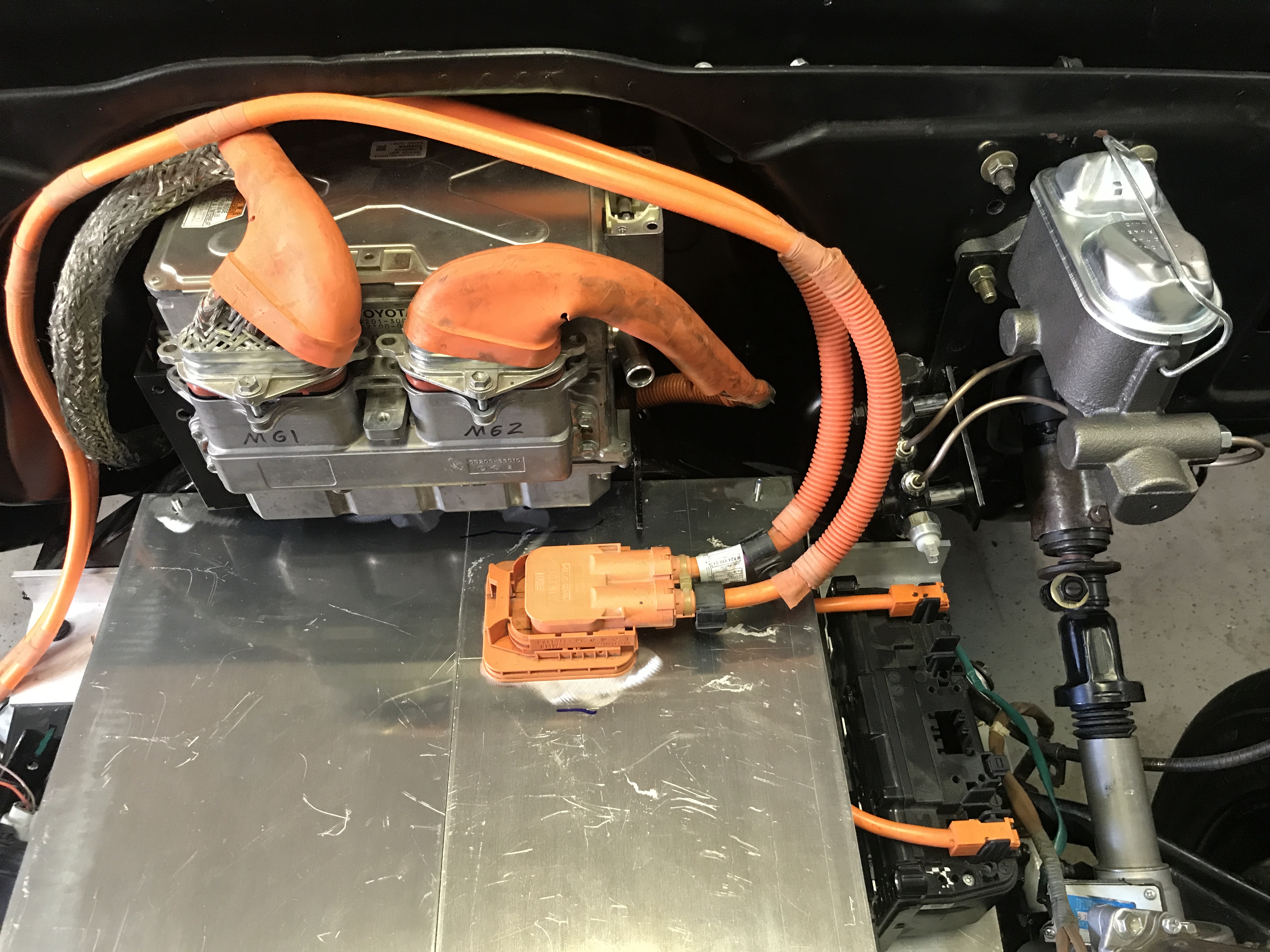

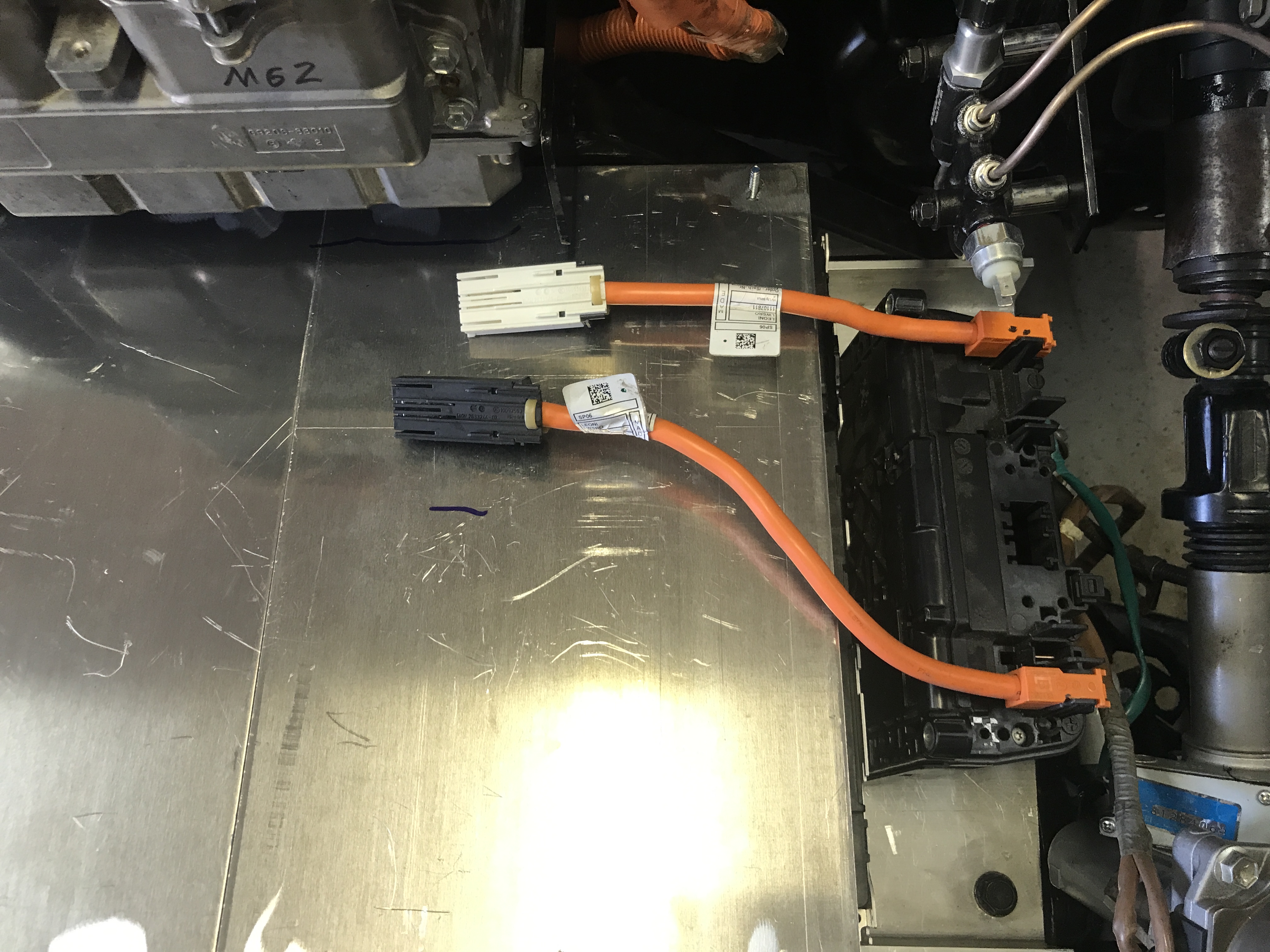

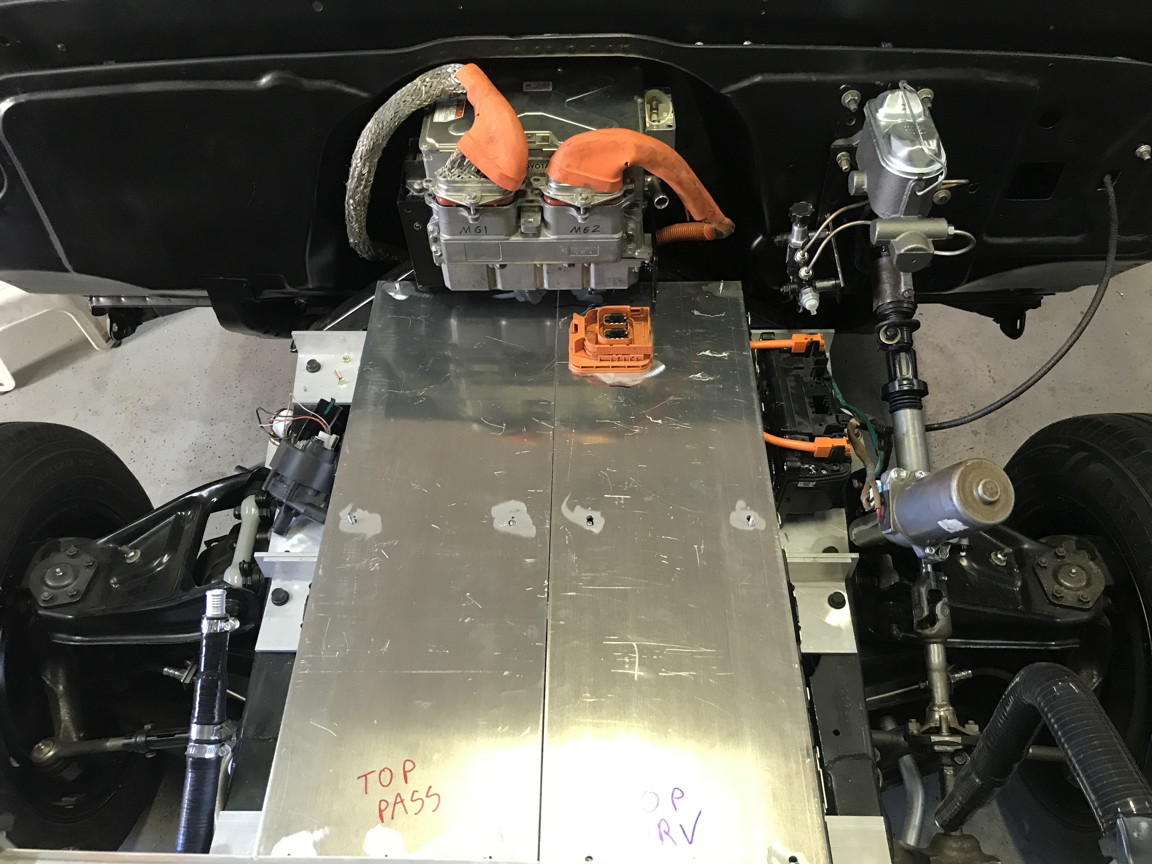

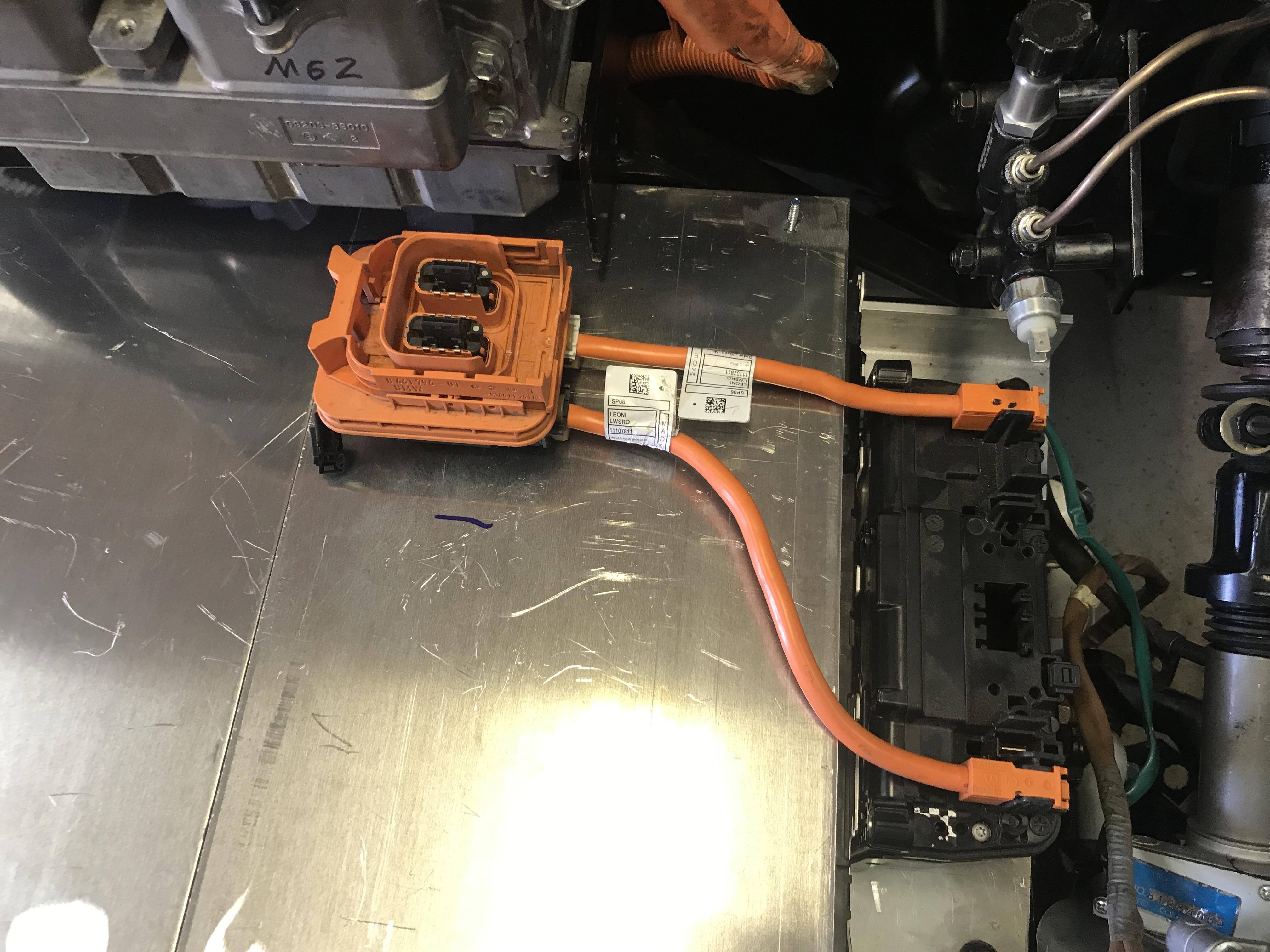

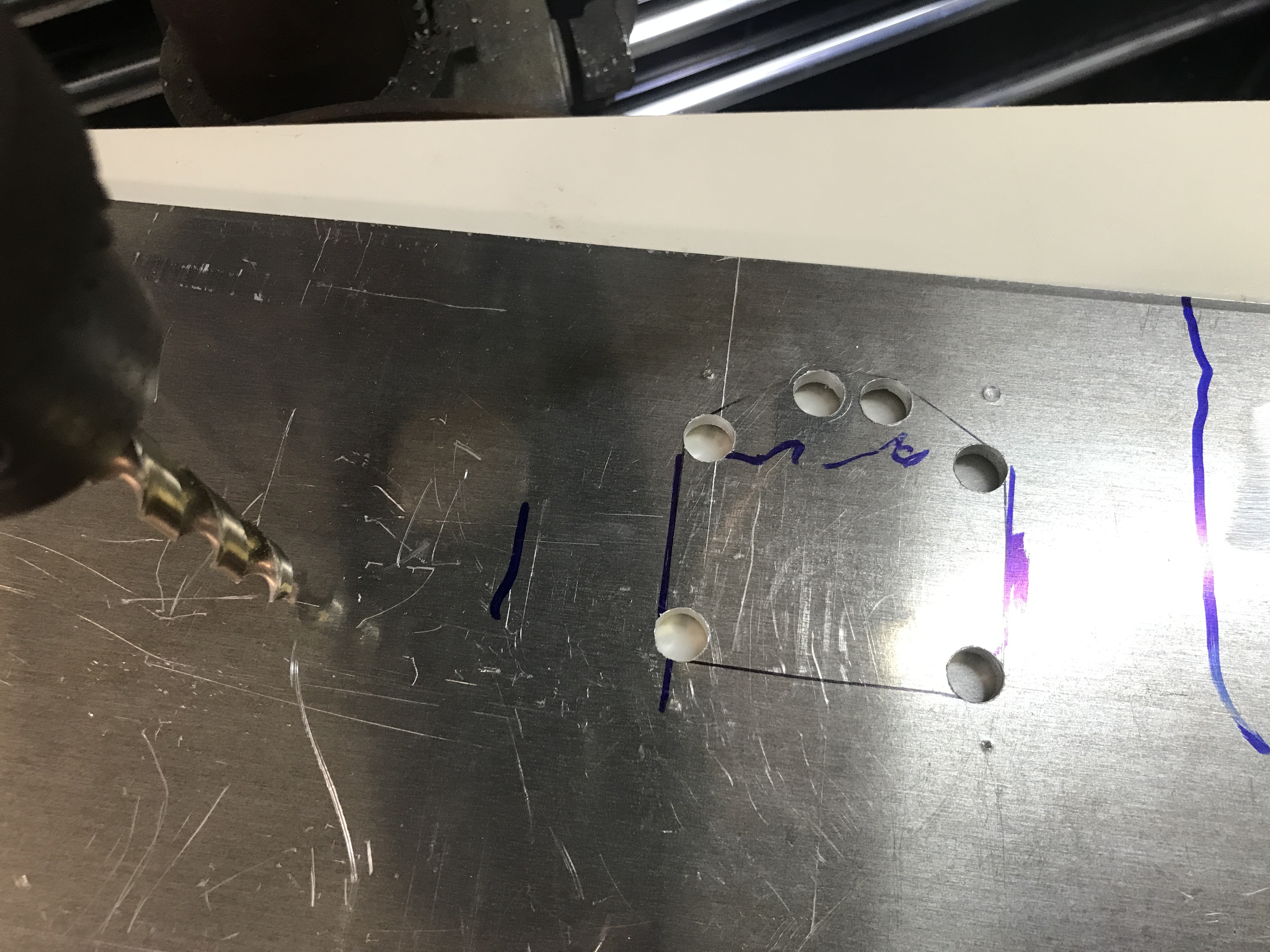

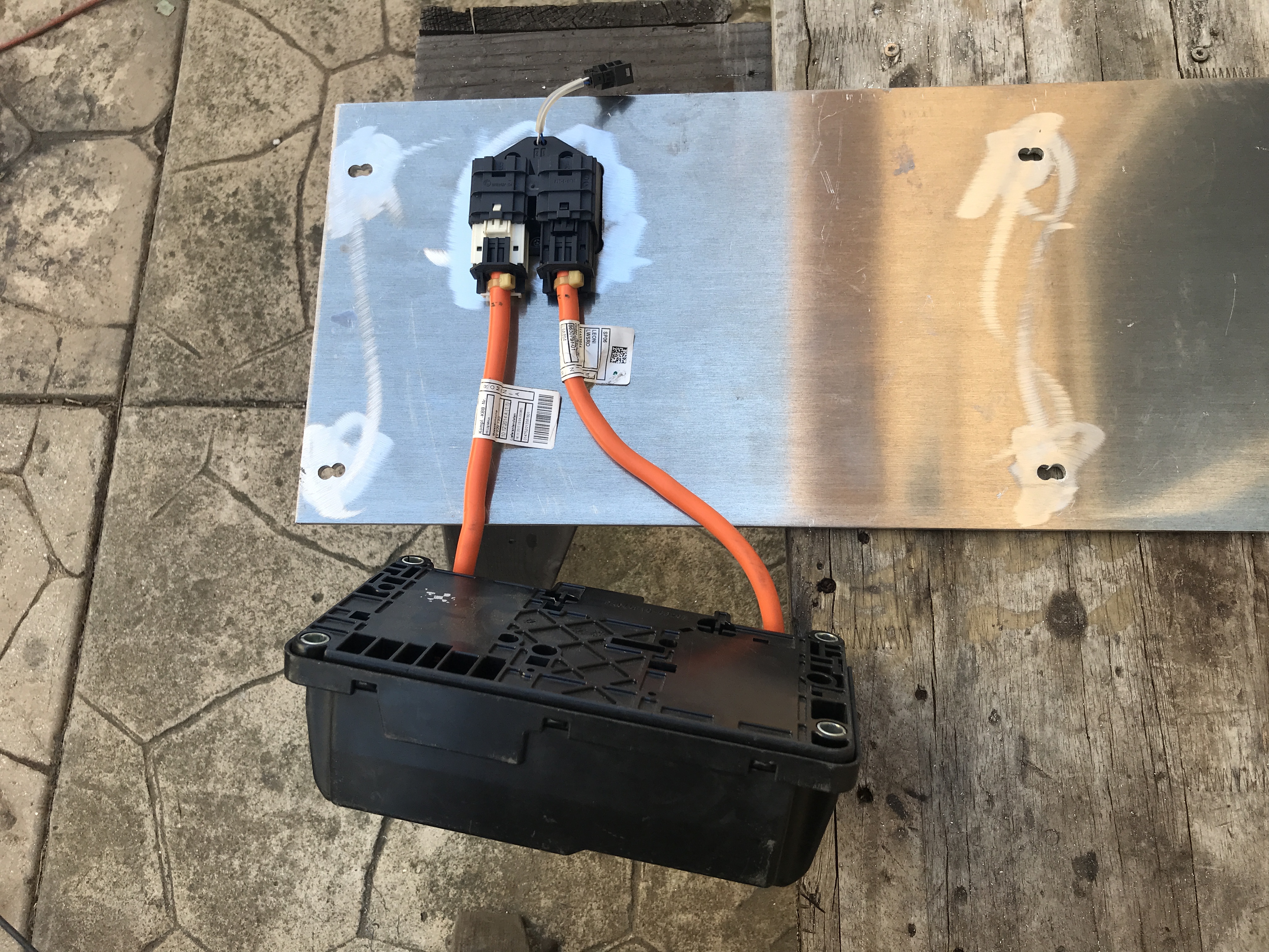

Our Mission: Connect the black BMW "Safety Box" to the Lexus Inverter
... using the stock OEM connectors as much as possible
turns out the BMW connection from it's Safety Box to the orange external plug on the OEM battery box is very modular and I luv that
Gregski
Posts: 3163

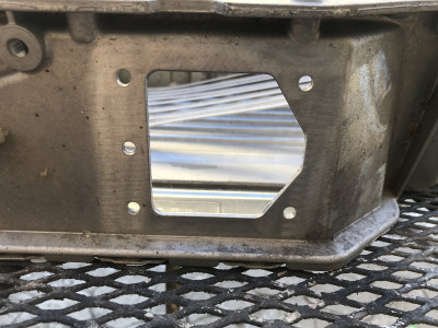

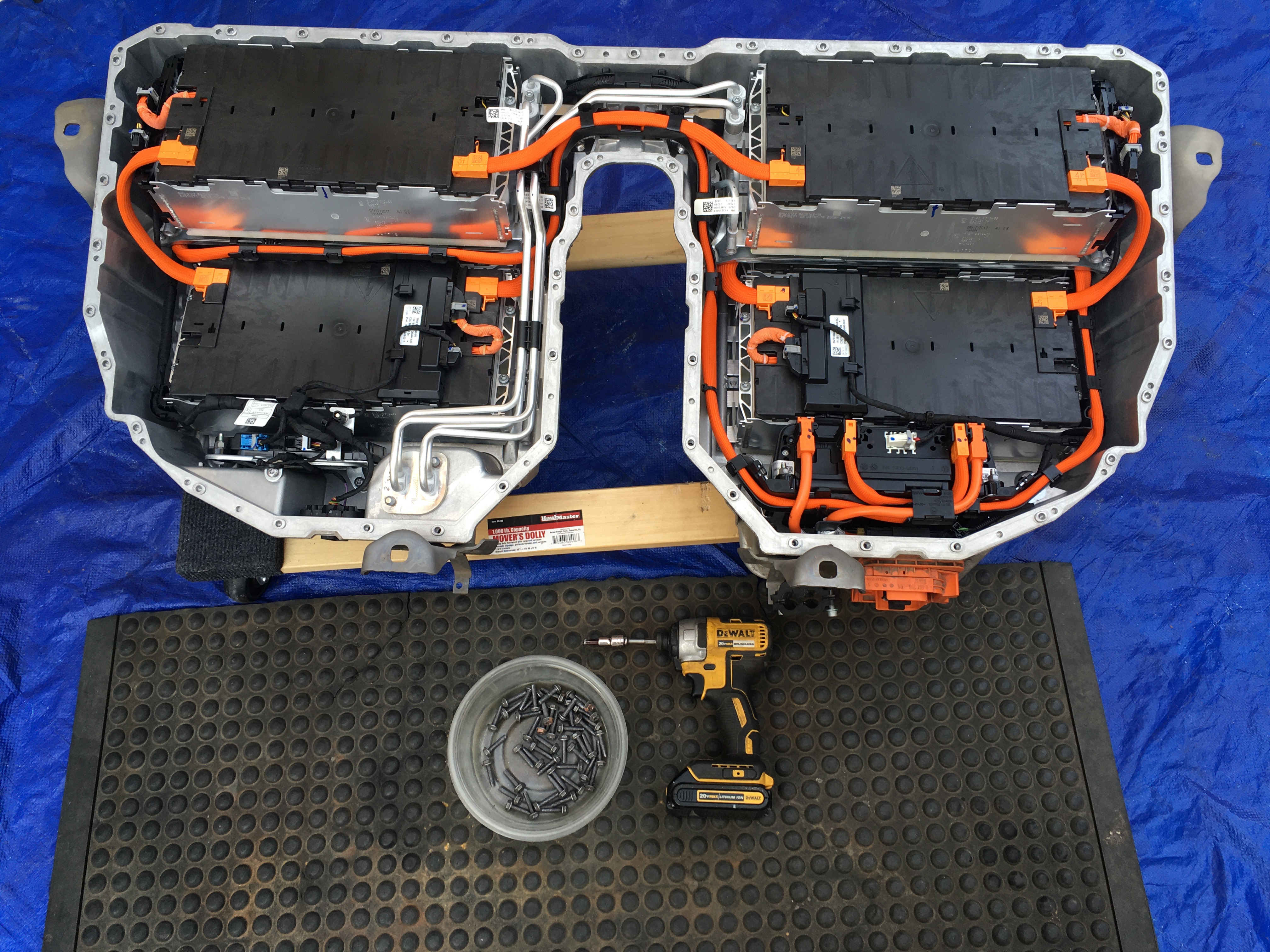

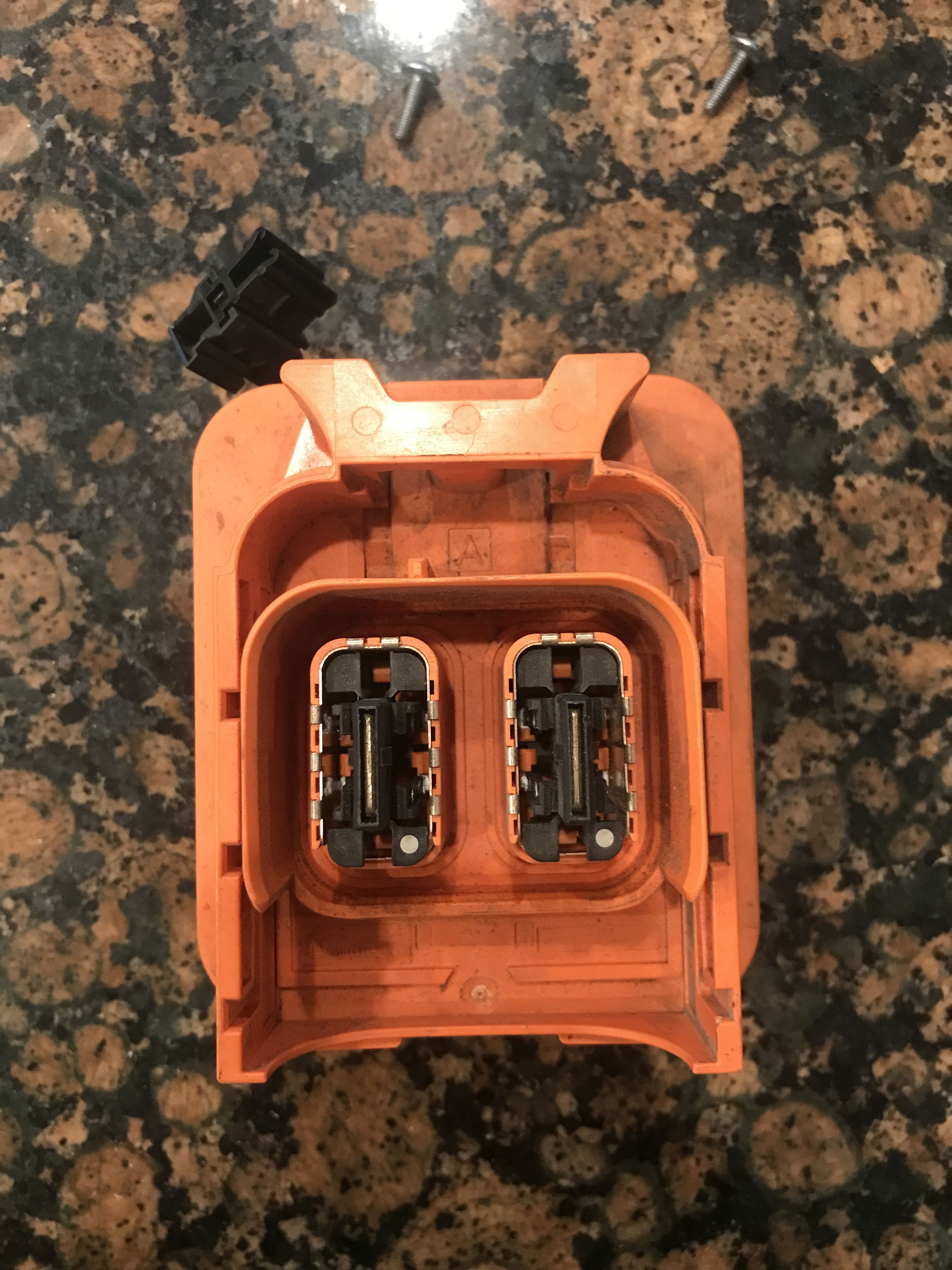

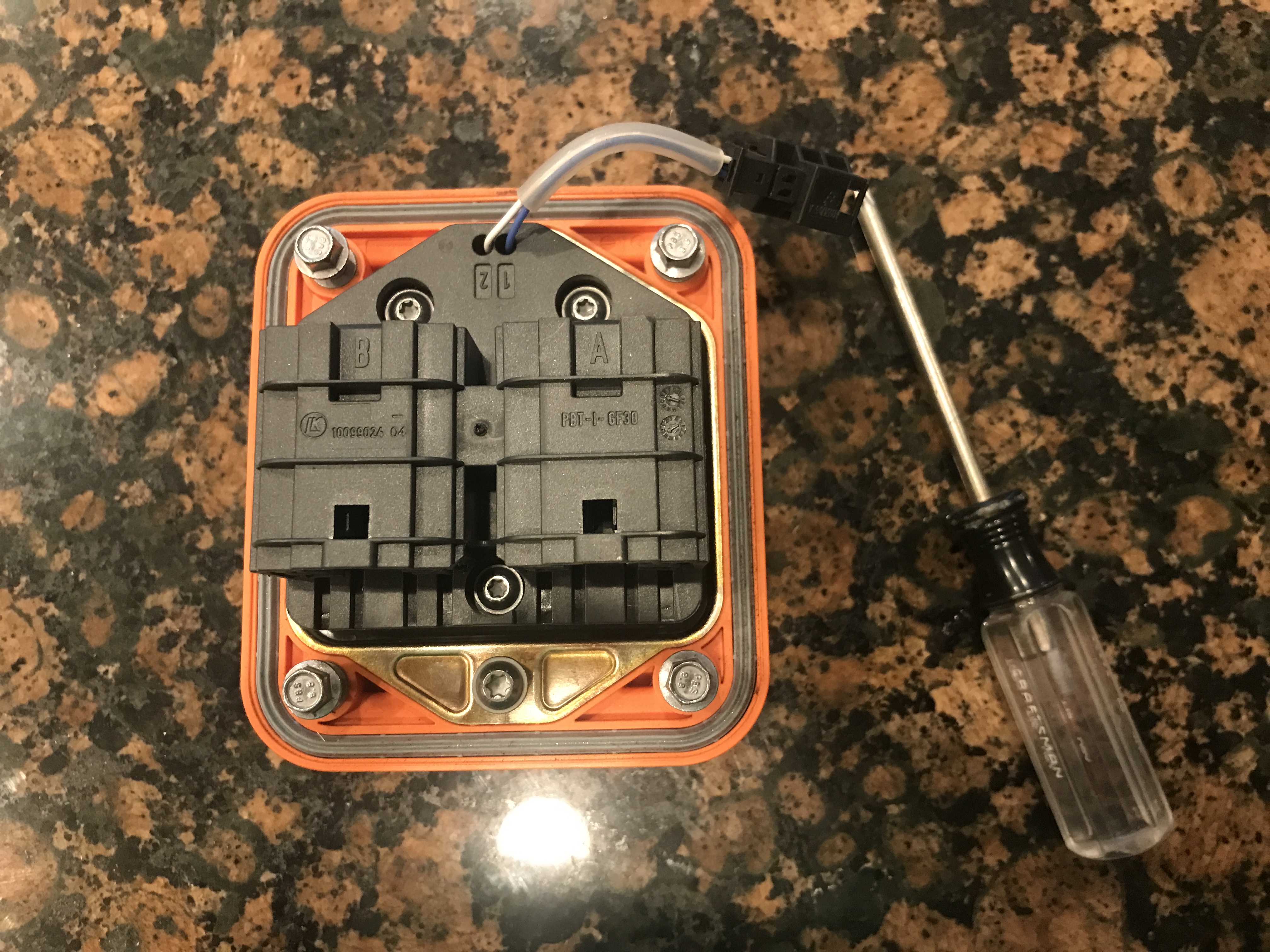

Post by Gregski »

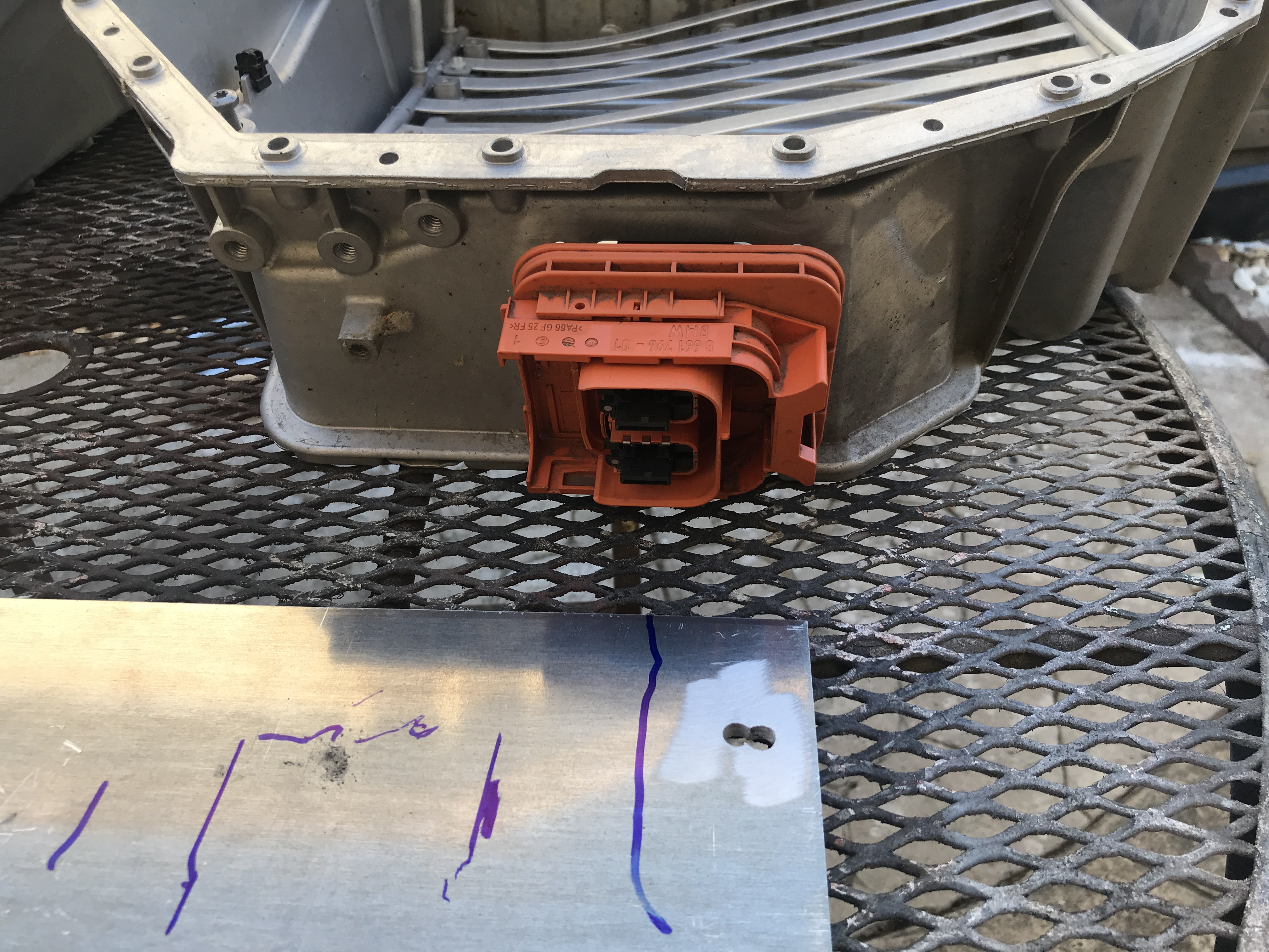

so this is the empty OEM BMW battery box that's what my batteries came out of, and that's where the orange connector is from
Gregski
Posts: 3163
Post by Gregski »
nothin' to it but to do it
Gregski
Posts: 3163
Post by Gregski »
let's see if she'll fit
Gregski
Posts: 3163

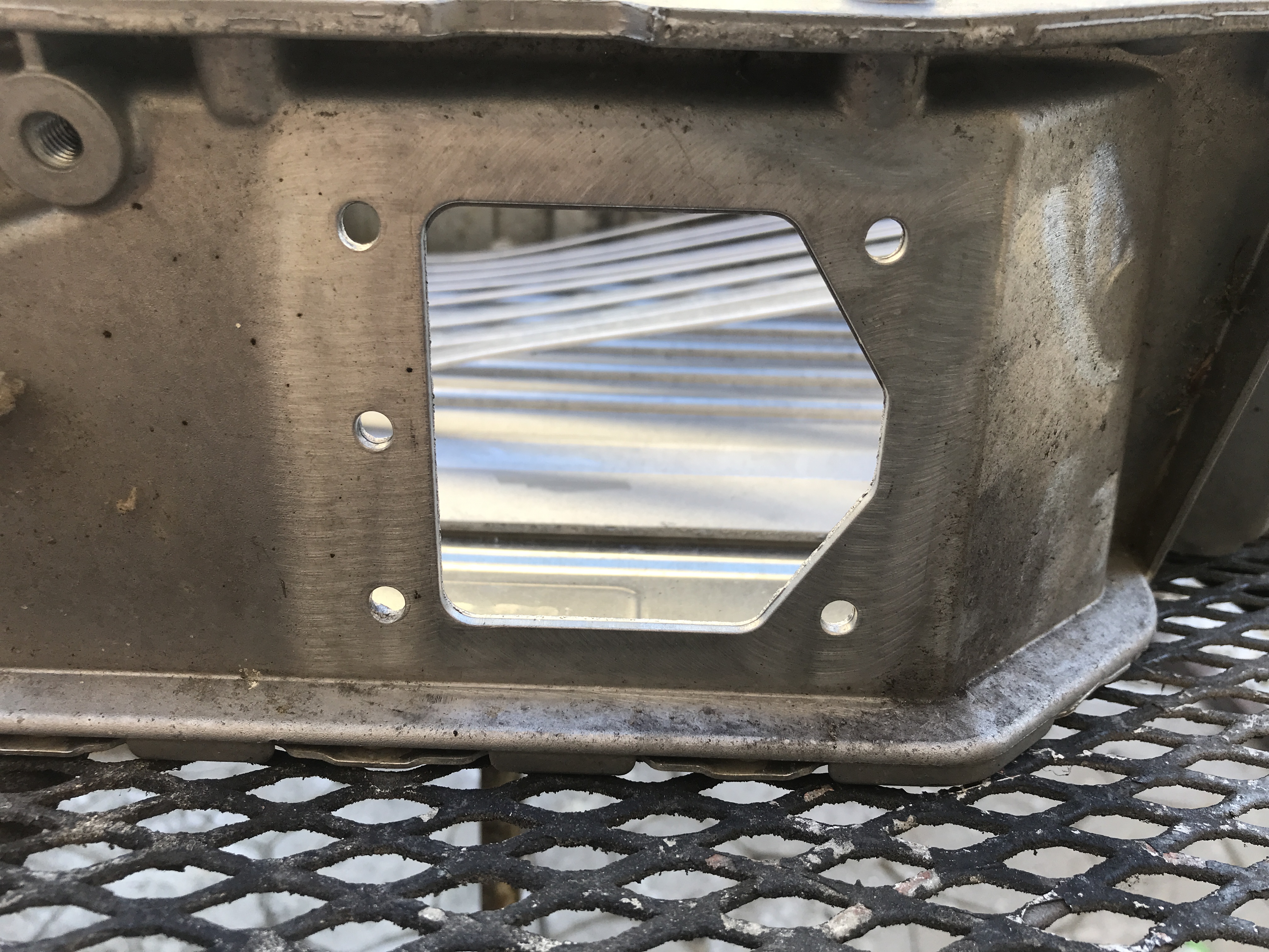

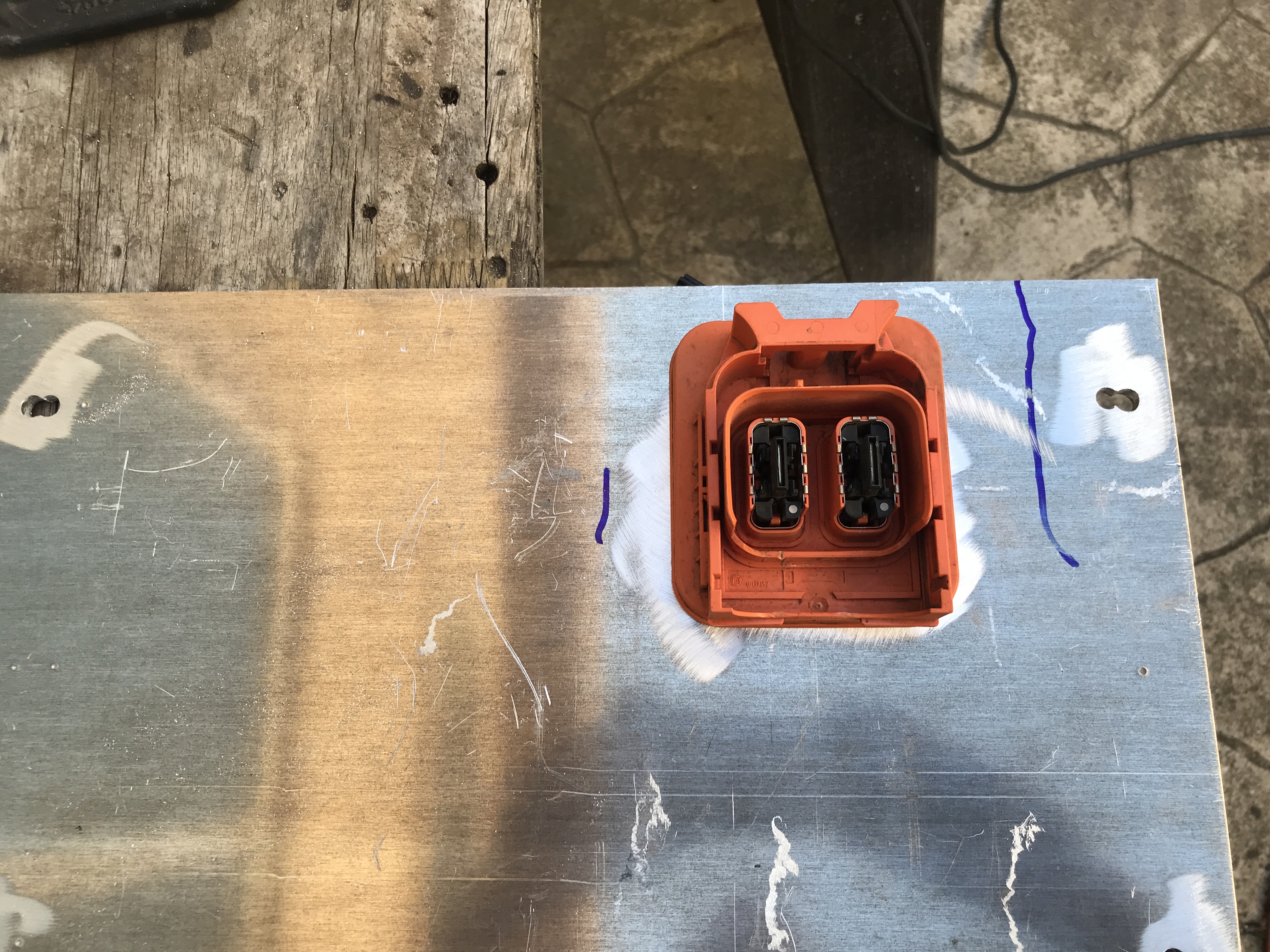

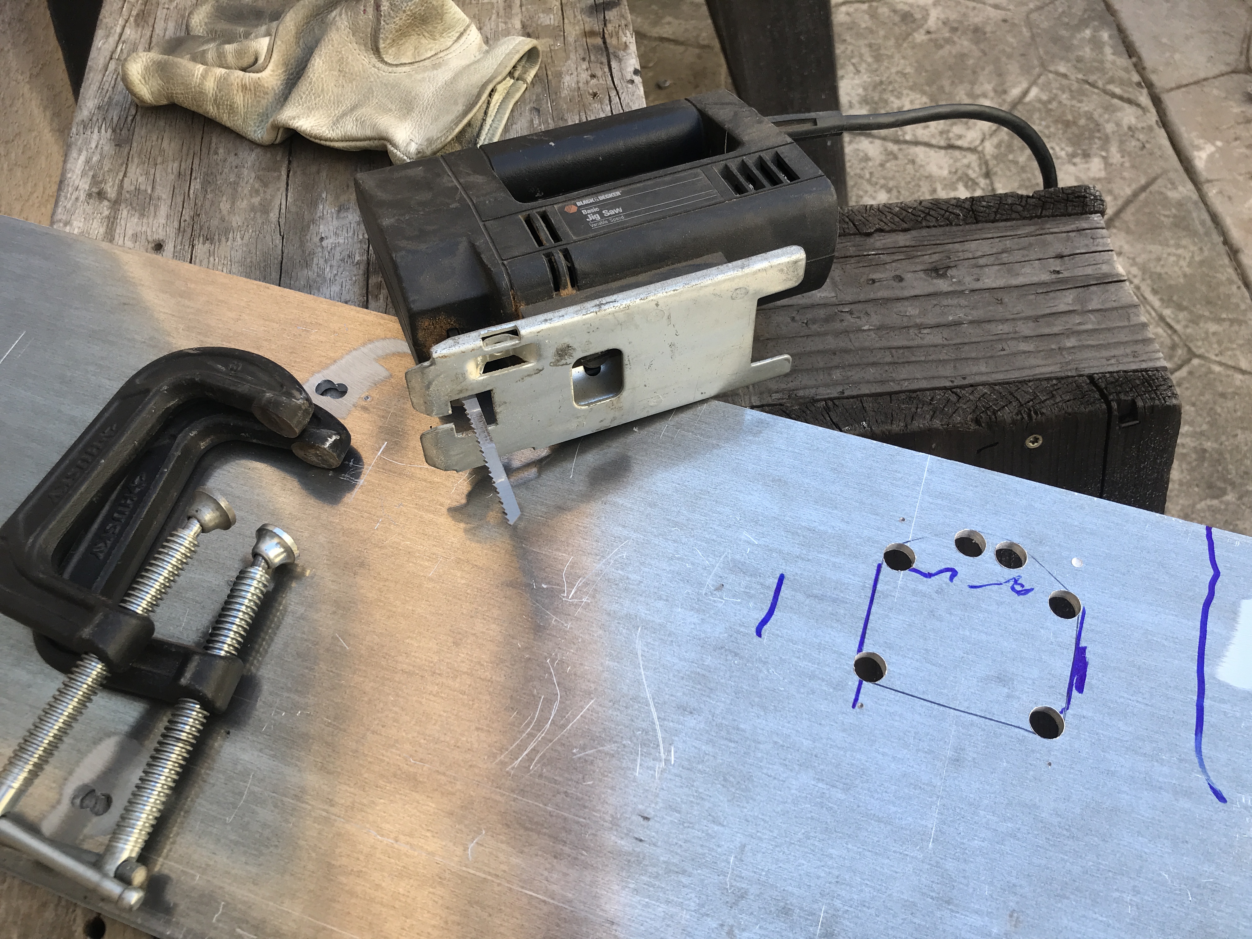

Post by Gregski »

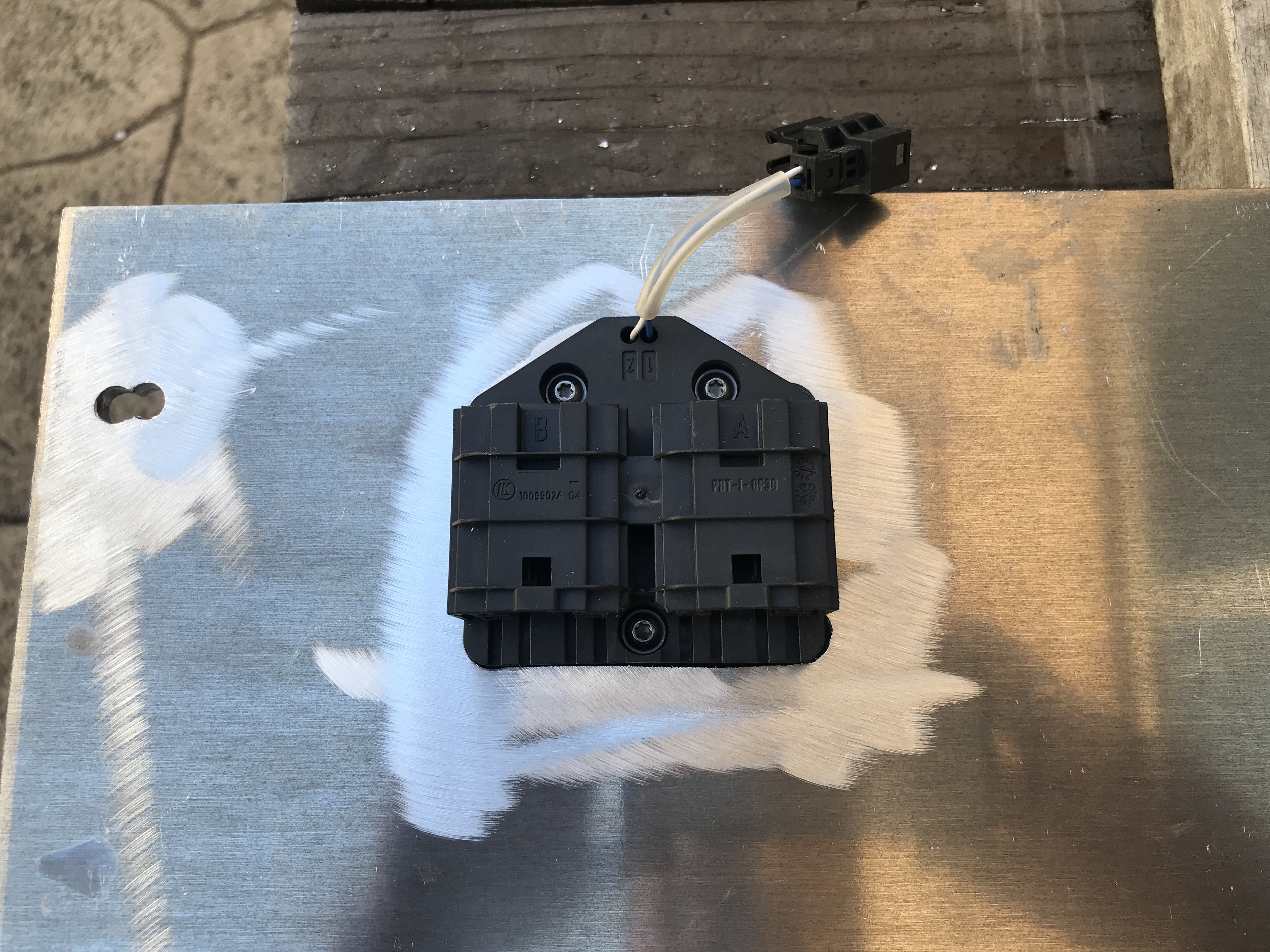

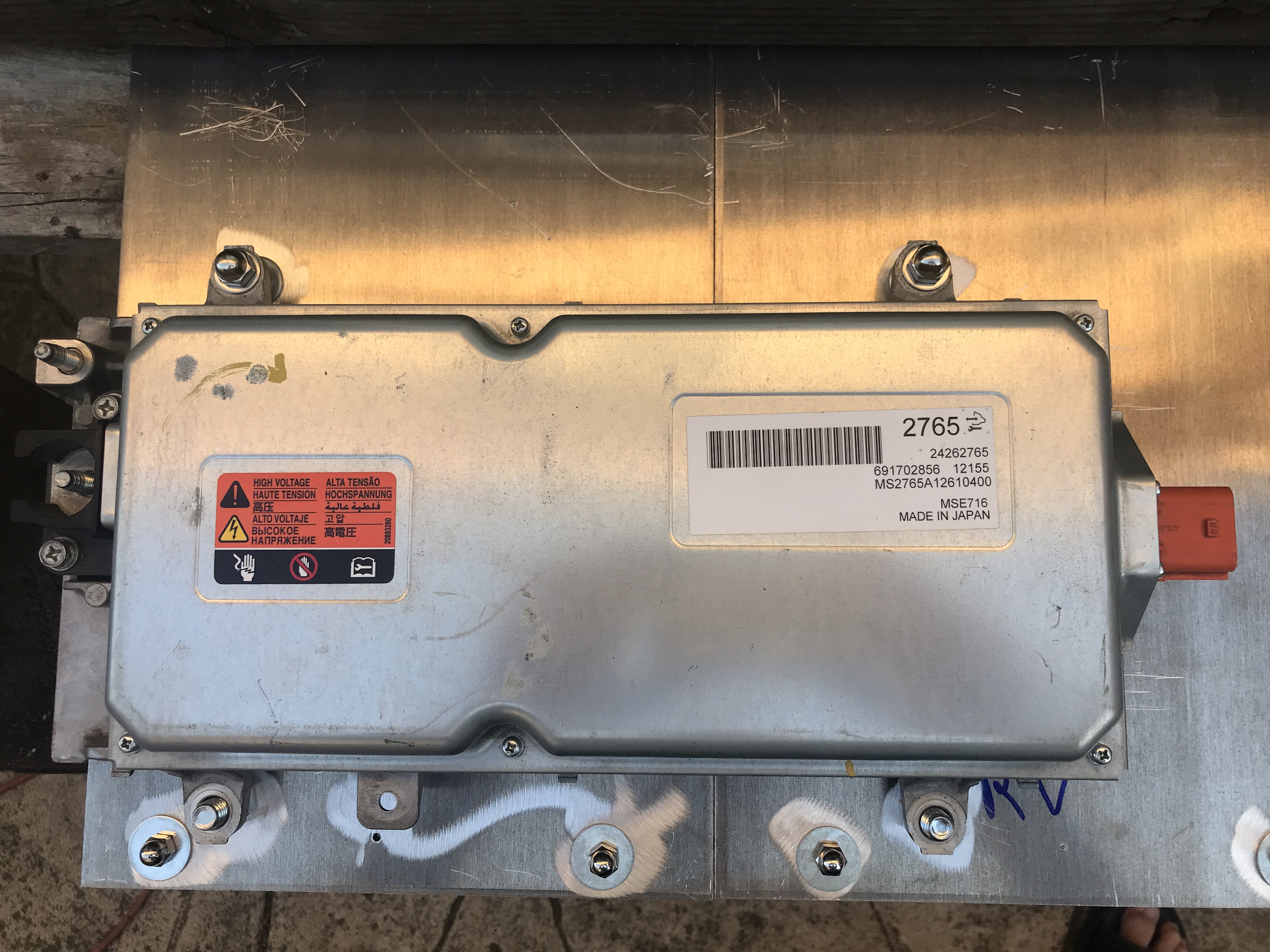

drilling these four blind holes to secure it with them OEM screws was a bit tricky
Gregski
Posts: 3163
Post by Gregski »

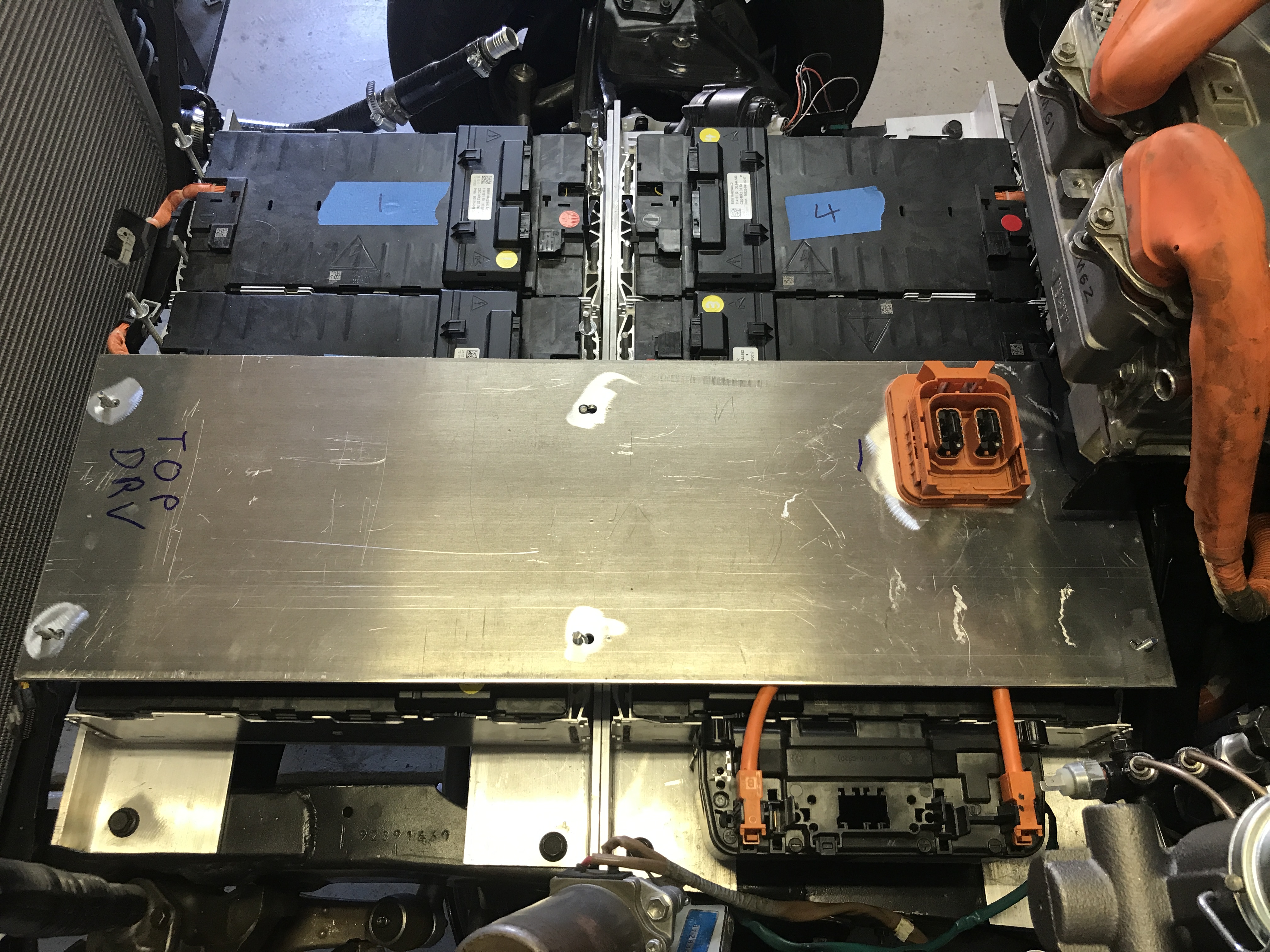

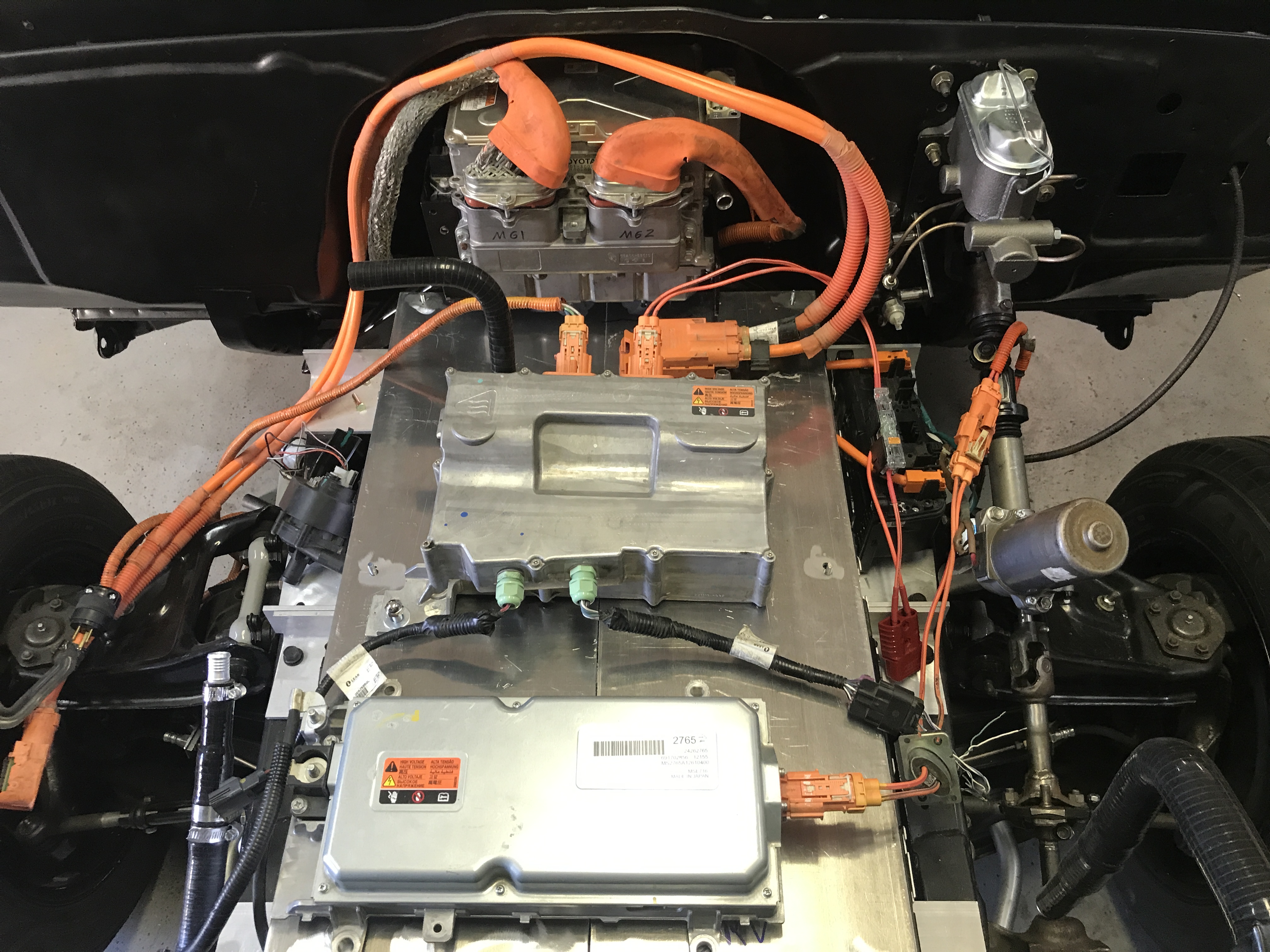

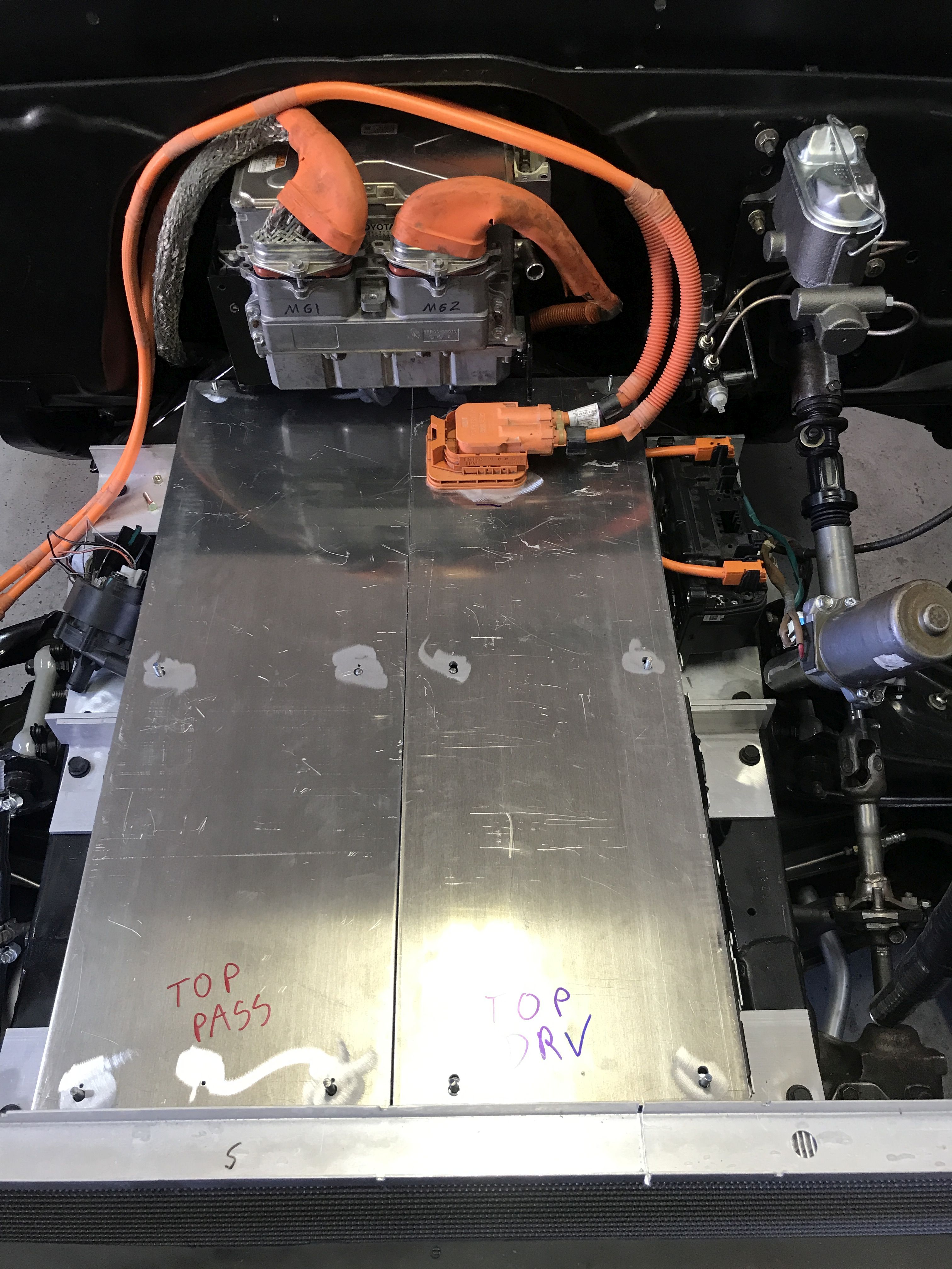

So everything below this plate is always live and lethal, 351 volts just waiting to make it a bad hair day, anything above this plate is only live and lethal when we turn on the truck to drive it or are charging the battery
Gregski

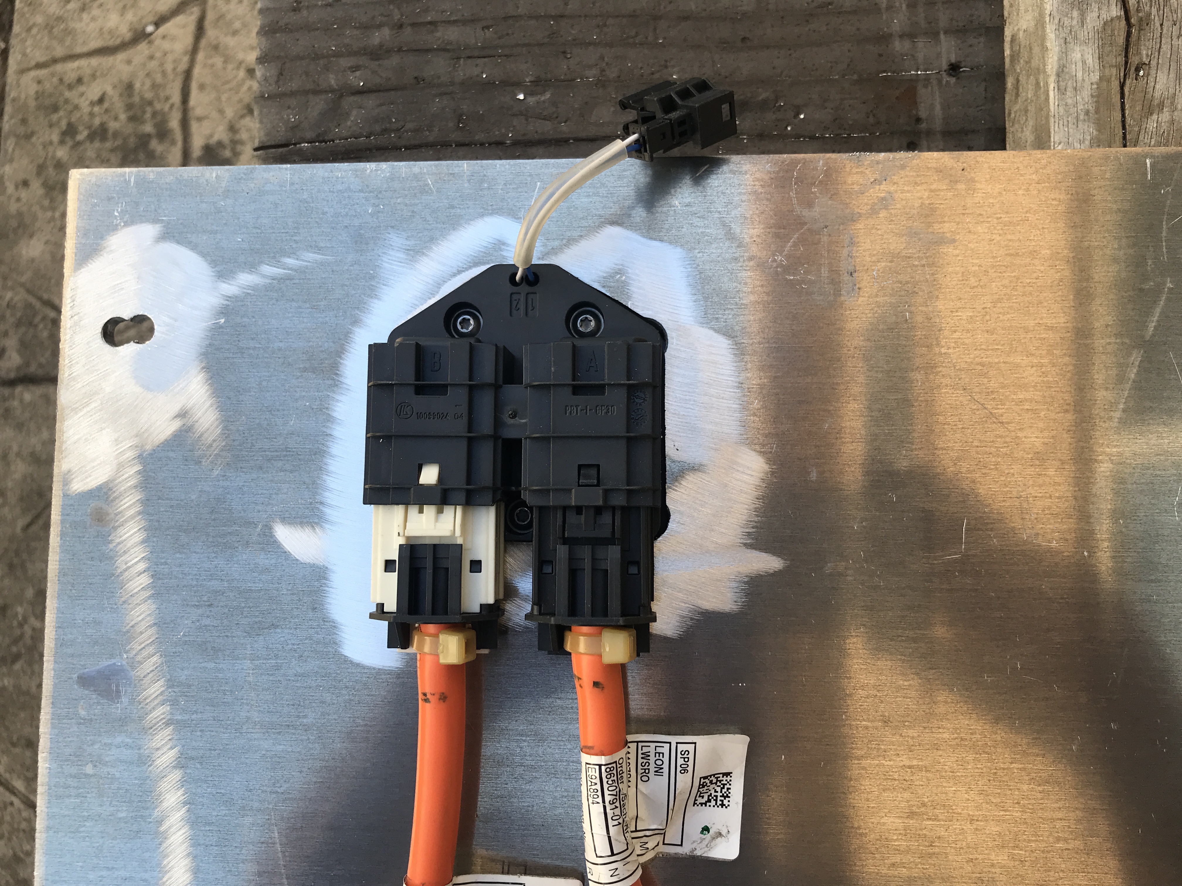

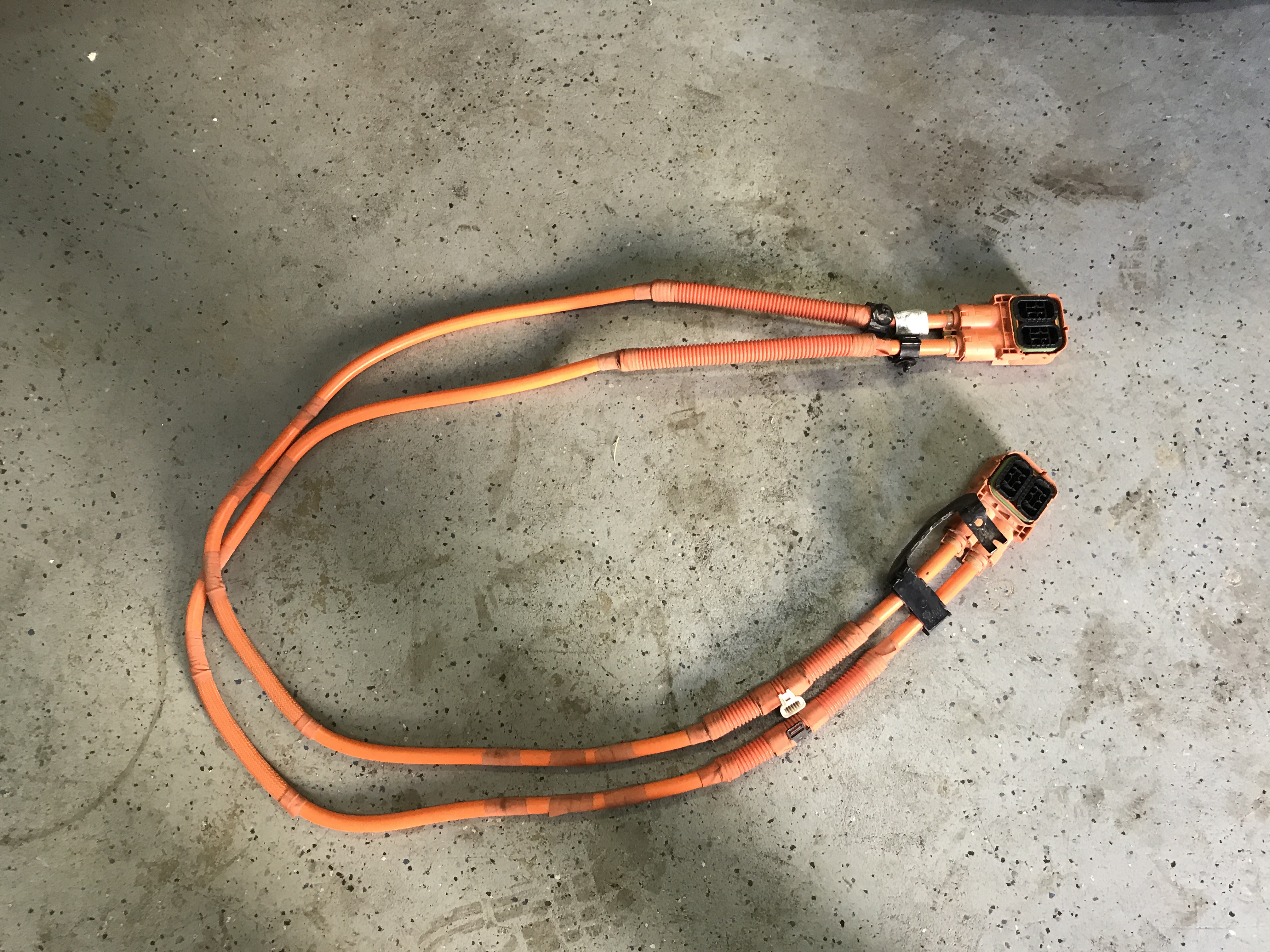

Post by Gregski »
Top Tip: always try and buy as much OEM stuff as you can, ask for pig tails, ask for cables, as you wheel and deal, and the seller is firm on the price, say something like: "that sounds good, but will you throw in the cables?" and 86.54% of the time they might
wheeler dealer.jpg (11 KiB) Viewed 4531 times
these fat long orange cables will get cut to size, we may just need like 18"

Not bad for government work !
Gregski
Posts: 3163
Post by Gregski »

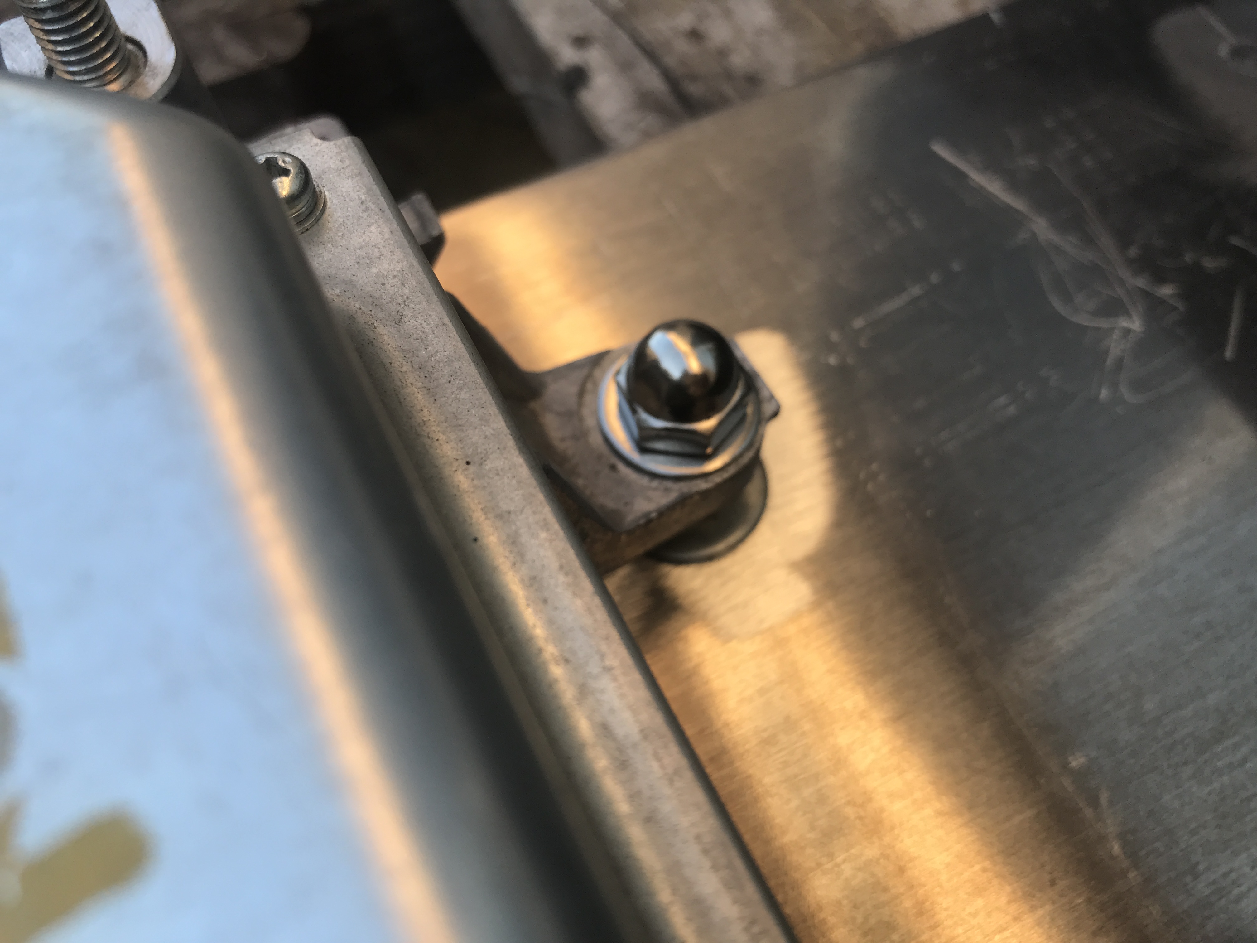

so got the Battery Tray Lid DC-DC Converter Holder (or BTLDCDCCH for short) in the good ol' organic free range BTLDCDCCH vice and decided to make things a bit sexy
Gregski
Posts: 3163
Post by Gregski »
to quote our astute colleague Mr. Damien Maguire "those eagle eyed amongst you may notice" the front two 7/16" studs are missing their acorn nuts, well, the struggle is real, take a look below at what my local ACE Hardware store carries (or should I say does NOT carry), they seriously jump from 3/8" to 1/2" you can't make this stuff up folks:
