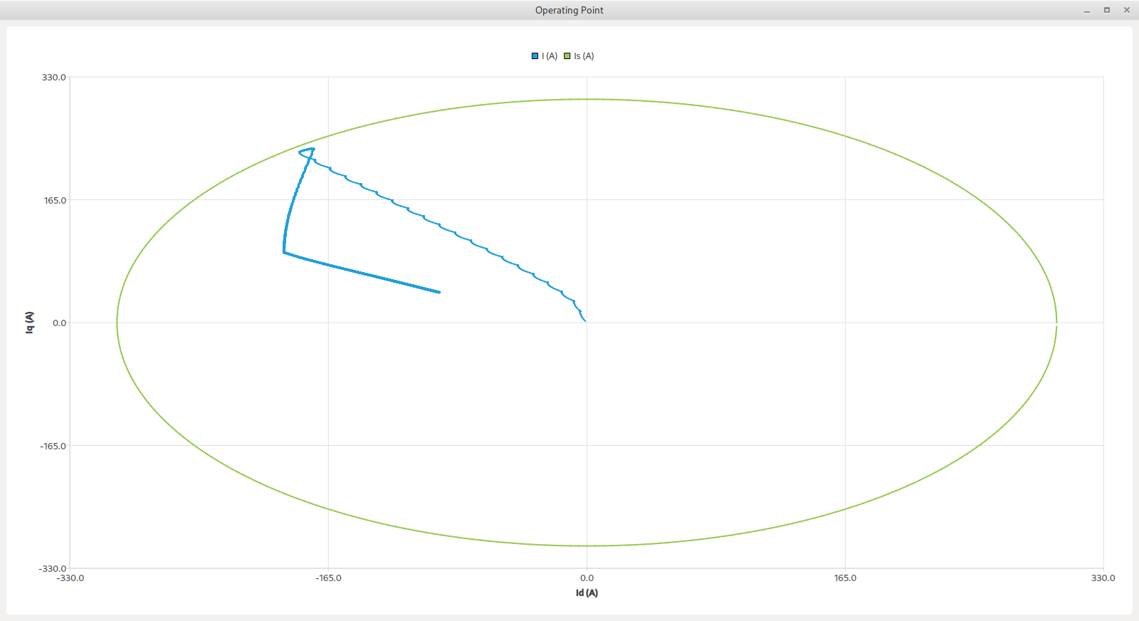

More combined simulator and car tuning today (Prius that is). Today it seems simulator and car match up quite well.
I struggle to get more than 20kW constant power both in the car and the simulator:
Controllers are very smooth now. The code is based on the recent github master commit, slightly modified for the simulator (e.g. export vlim). fwkp means filter constant!
The car starts out very powerful but quickly looses grunt above 40 kph. I saw 120A@360V which is a nice 43 kW. But then when at "speed", say 60 kph, I only see about 70A or 25 kW. So more than in the simulator but similar drop off. Any ideas how to obtain more constant power?

johu wrote: Sun Nov 06, 2022 3:20 pm Any ideas how to obtain more constant power?
Its all down to what the operating point is doing when it limits, could you post the operating point plot for that run?

Yes:

by Pete9008
Couple of assumptions, the vertical bit on the plot is the initial limiting at very low speed and the bit that then goes towards the origin is the limiting as speed increases.
The initial near vertical bit is actually increasing -Id slightly which is going in the wrong direction. The ideal would be to pull some -Id out to move closer to icrit while also allowing Iq to remain higher (this does depend on what ud is doing though) which should help keep torque up.
Posted: Sun Nov 06, 2022 5:06 pm
by Pete9008
Take that back. Just tried it both with the operating point moving to the right initially and then down towards icrit and also with it just moving directly towards icrit and neither is significantly better.
It may be that that is as good as it is going to be without running at a higher voltage?

by johu
Yeah, might well be. At 550V I'm getting 48 kW peak and about 35 kW constant power

by Pete9008
The problem is the wLqIq term in the Ud voltage equation. Essentially the torque producing Iq is generating a large Ud voltage, this isn't affected by field weakening at all and so whatever we do with Id has no effect on it. Without the higher voltage all we can do is reduce Iq as speed increases to keep it in check which reduces torque and power.

by Pete9008
Could do with a better handle on the flux linkage value. Setting it to 200mWeber with my controller gives the same results as in your plot, increasing it to 300 gives this:
which seems closer to the numbers you are getting in the car?
