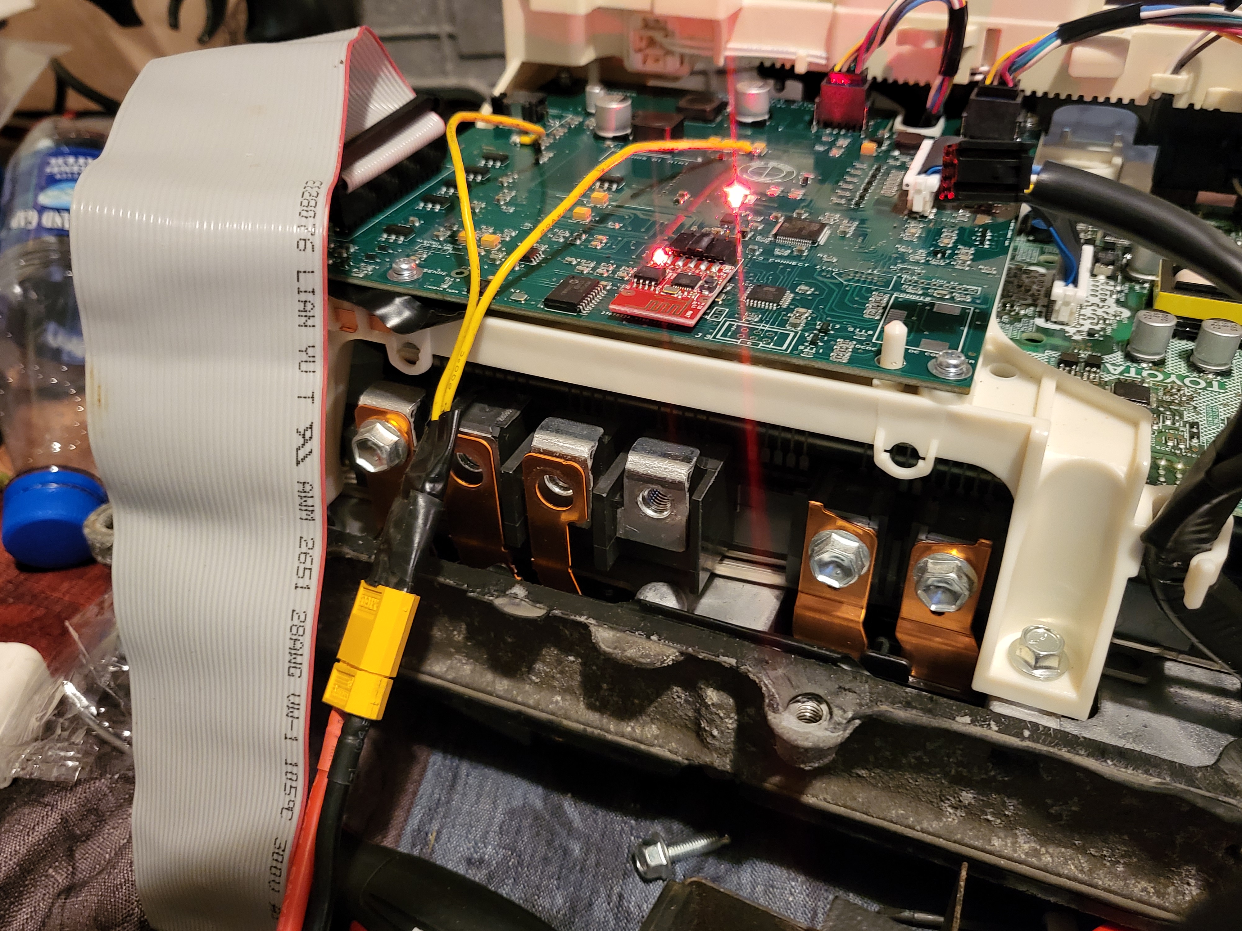

OK - just making a start on this. Got the V1c board from damien, soldered up the connectors and powered it up, got flashing led and web interface is up - all good so far. So i installed the board in my gen 3 inverter as per damiens 3 part video complete with gorilla glue option :-)
I ran a few tests (connecting mg2 fwd and start to 12v) and was getting two errors, the tmpsmax one (maybe temp sensor type not set correctly) and the precharge fail. not surprising as there was no HV connected. So not wanting to dive into connecting the HV just yet, i got to watching a latuta on you tube, i liked his small steps approach, so watched him load stm32_sin to test the pwm with no HV etc. When i loaded this firmware, the blinking led no longer blinks. I tried reverting to foc (I guess this is what damien loaded before he sent it to me), but still no led blink.
I note that I appear to have no parameter list, and when i download the json file it is empty.
Question, does the firmware upload wipe the parameters and if so where do i find the relevant parameters to start with. I found the 'database' of lists but could work out which was a good match. Tried to load the set i thought was closest, but whilst it appears to load, when i then request download from the board, the json file is empty, so i guess it's not loading correctly.
any help much appreciated - my wife will murder me if that 3 series touring we bought for the project doesn't find a use some time !

If you have no LED blink and no params, then there's something wrong with the firmware. If you can't get it to reprogram through the web interface, then you can try reprogramming through and stlink.

thanks Christian - after some forum digging it seems i'm not alone and sometime the OTA load doesn't work as intended.
So i spent an hour or so getting stlink to work on the PC (mfc140.dll issues) and this morning have reprogrammed the stm32 with the bootloader and the foc firmware and all that seemd to work ok.
However, still no flashing led, though it was working before i starting any firmware loads so unlikely to be a hardware issue i hope.
What can i try next ?

Sounds like the programming is not working to me. AFAIK if you don't have a flashing LED the programming didn't work. Are you following the steps on the wiki? https://openinverter.org/wiki/Toyota_Prius_Gen3_Board

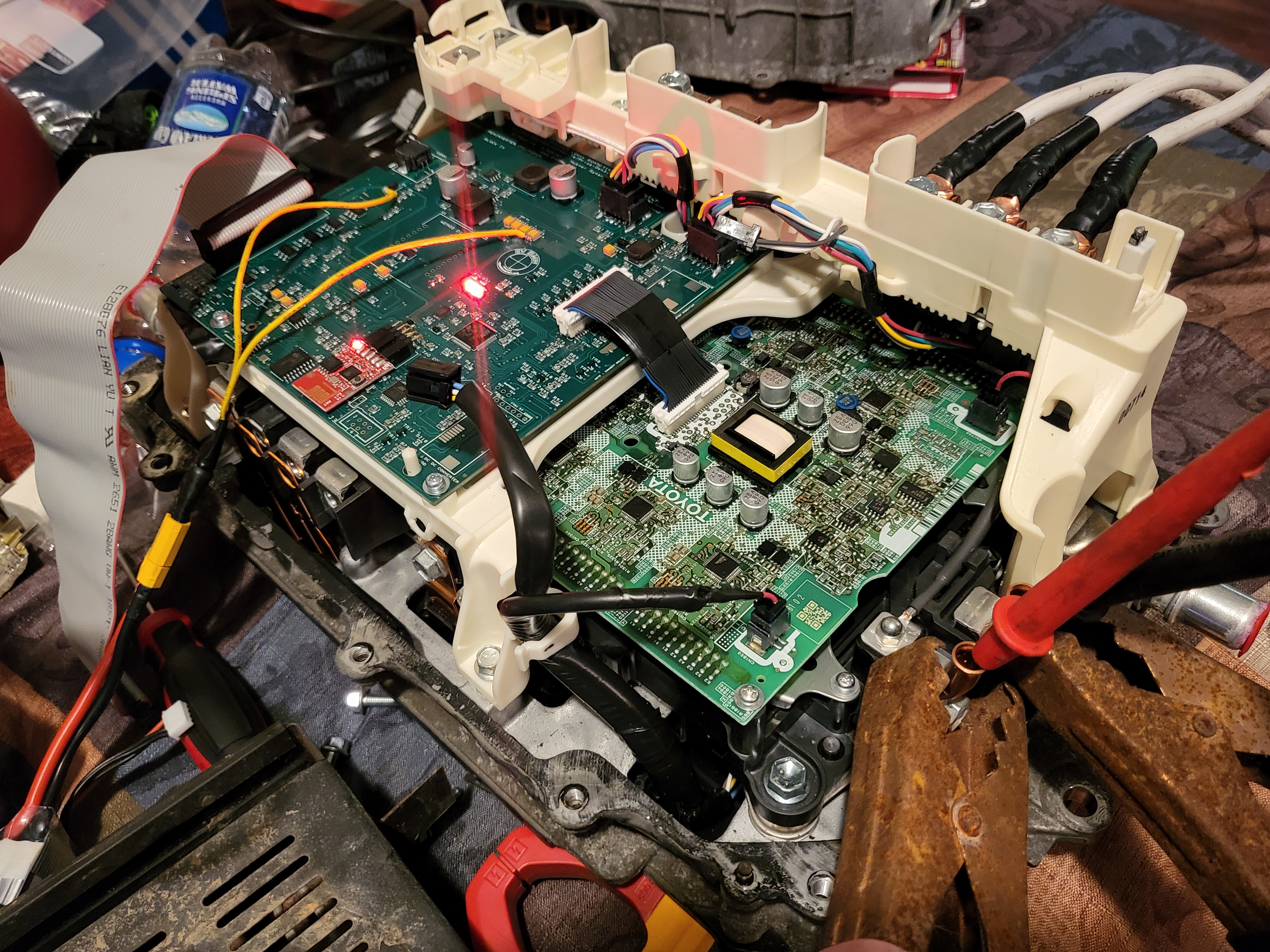

I'm not quite sure where to go with this now, i have a board which was functioning at first, but when i attempted to update the fireware has since refused to do anything useful although it appears to accept the firmware load.
Is there anyone willing to take on some paid support,or is it somehow bricked and i either need to purchase a replacement or accept defeat. If i'd done something silly to damage the board, i'd shrug and purchase another, but without clear indication as to what has happened i'm a little less bullish about this approach though still quite invested in building my open EV.
is it possible/likely the stm32 is damaged or locked somehow, and would replacing that IC (assuming i can get one) worth a try, or does the fact that it accepts a download not indicate this ?

I’m pretty sure your STM32 is ok. When you reprogrammed it with stlink, are you using .bin or .hex files? .hex is fairly straightforward but with .bin you have to use the correct start address.

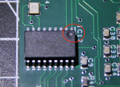

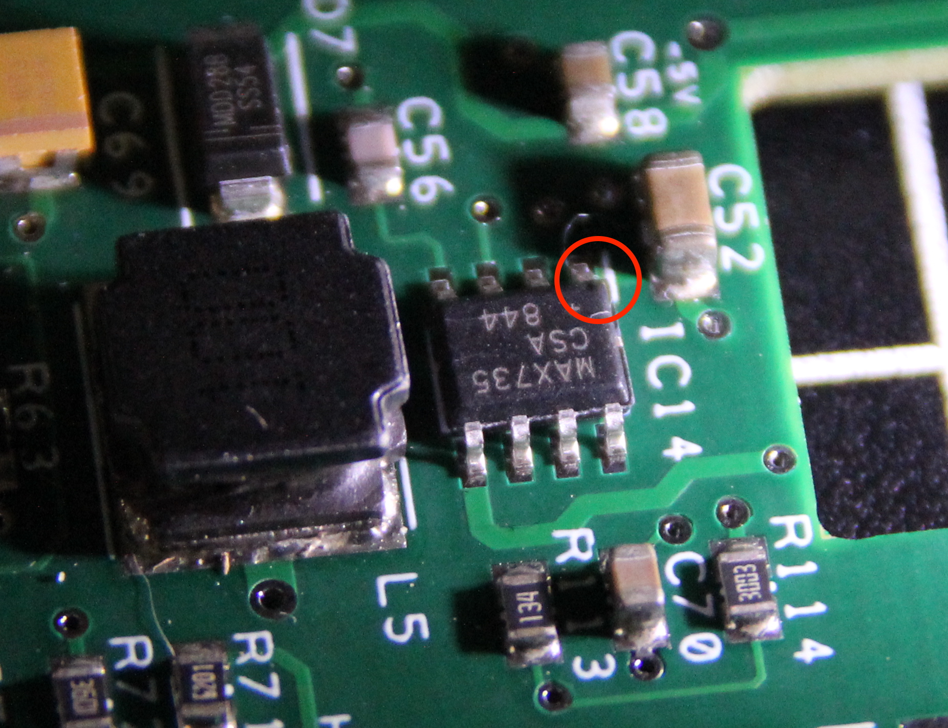

Just double checking before I start soldering the tricky little chips that came with the kit.
IC14 being the hardest to see, but there appears to be a notches to how I've orientated and placed it?
IC12 looks more straightforward and was confirmed earlier, but just wanted to double check.

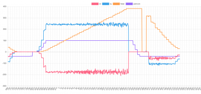

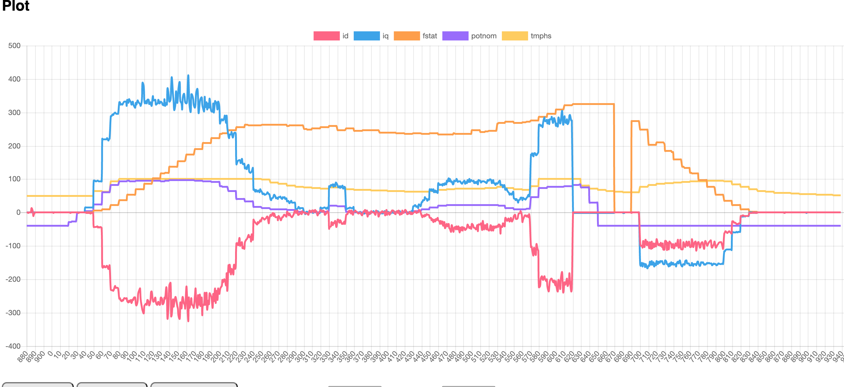

Anyone know about the temphs? Chasing my cutouts I noticed the temperature feedback seems to have a ceiling of 100 degrees
Graph shows where inverter shutdown current and fstat tanks as auto resume
Posts: 4000
Been thanked: 1116 times
The inverter will not cutout on overtemp but it will limit. The only source for a cutout is the IGBT desat detector outputs.
Posts: 1884
Has thanked: 91 times
Been thanked: 517 times
It looks to have cutout at lower currents on the graph, unless something spiked and Mr Toyota said now before Johannes gets the info.
2.5 Throtcur, if I'm reading this right, it's happy at about 250 amps then at 380Hz ish Mr Toyota sits down.
4.5 Throtcur, current 100 amps higher, but again at 380Hz ish Mr Toyota sits down.

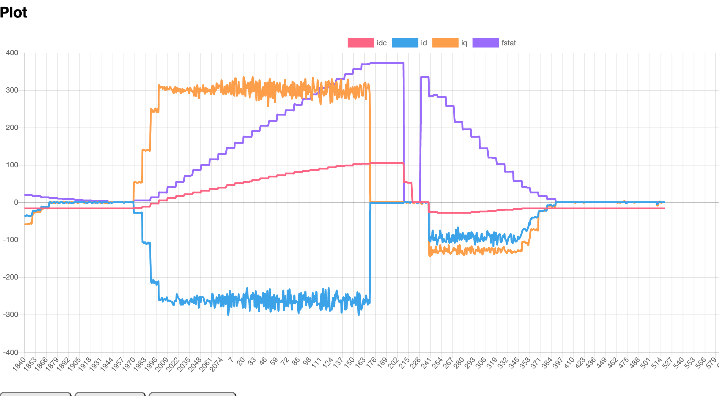

So wondering if it's DC max current? Anyone able to post some graphs of idc, iq, id and stats? Are you able to get over 100 amps DC?

I don't think the inverter even knows the DC current. Rather looks like some event that happens at full throttle and 380Hz. Could be the point where the amplitude is so high that the IGBTs can stop switching for parts of the period. Actually that's a good thing because it reduces switching losses. But perhaps Mr. Toyota don't like it?
You could plot "amp" to see that
Posts: 1884
I shall plot that next time.
Setting to derate at 100 amps has stopped cut outs for the most part. Stamping on it from 0 mph will still do so, but I can now floor it after rolling a little. Removed fmax and can now get the rpm back up high again. It's even allowed me to bump the throtcur further. Pretty pleased.
