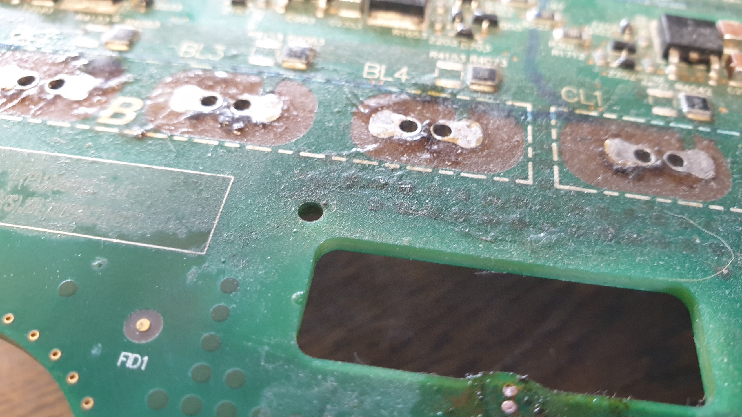

I want to preface by saying this is an outstanding post and I will do my best to add to it based on my abilities. to prevent damage, it is best to use a stripping agent to remove the conformal coating on the affected areas. I suspected the conformal coating (referred to in your post as "solder mask") might be polyurethane based, and so found a stripping agent capable of softening said coating for mechanical removal. I did a small experiment on the main TI chip surface to verify function and will post an updated later during the week with detailed images and timings to help anyone using the chemical method in the future.Davidk wrote: ↑Sat Apr 19, 2025 4:54 pm Now you can continue with 30 pin connector in purple colour, this is bit painful part:

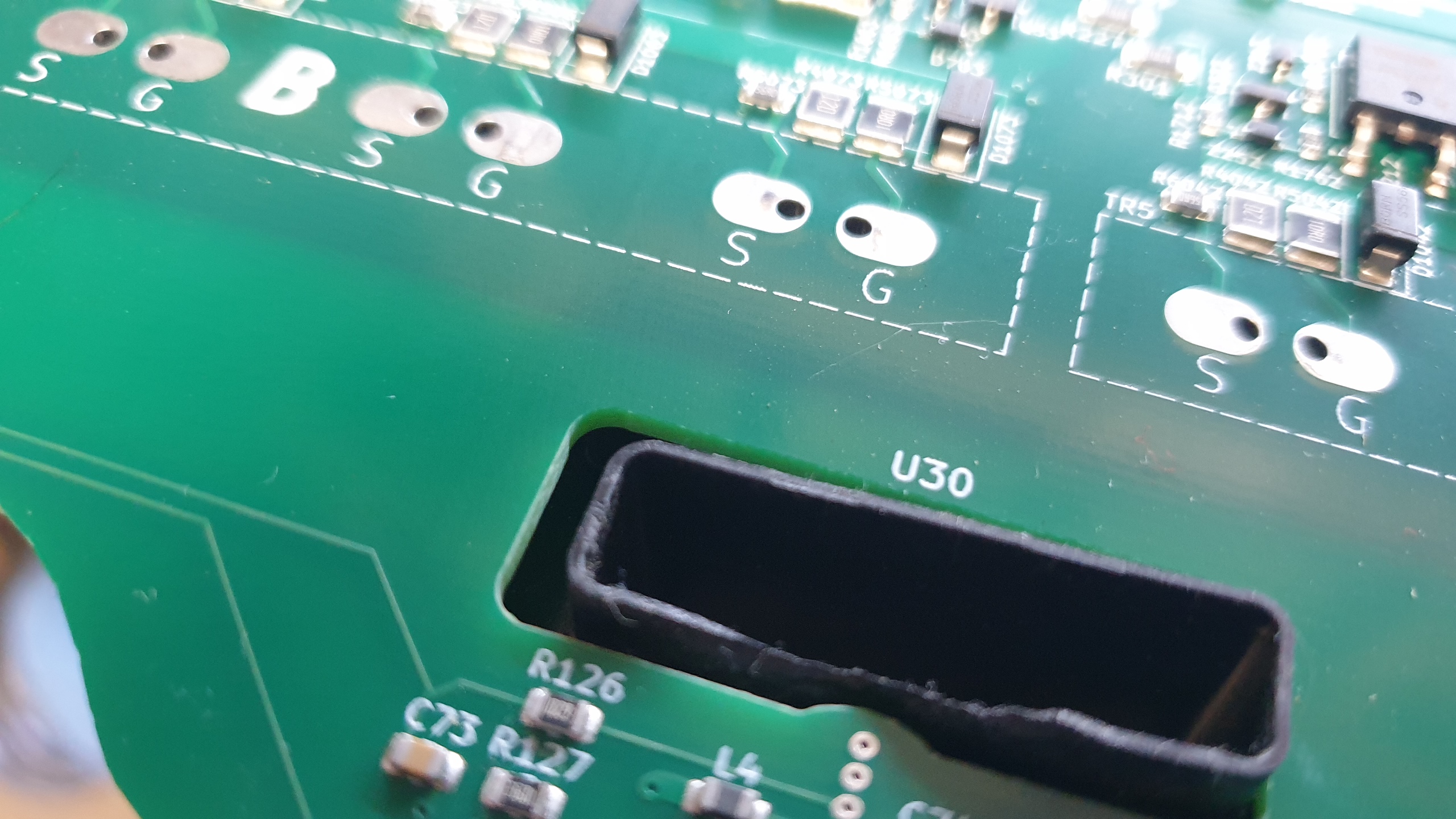

1. leads and whole surrounding area is covered by solder mask, i used Dremel with small tip to clean as much as i could.
2. Even when i tried a lot i was not able to wick solder from joins and free connector.
3. I ended with propane torch and connector just slid our, by this i obviously damaged board beyond repair/reuse.
4. To do this without damage to board you will need to use hot air soldering station.
Current sensor. Area around is again covered by solder mask a lot, i used Dremel again to clean area around. Housing is hold by 3 T10 bolts, coloured with blue dots. When trying to desolder sensors they slid out from black plastic housing, not sure if this is suppose to happen or not. I definitely used force to press housing away from board. Now i have plastic housing and two sensors which i desoldered later.

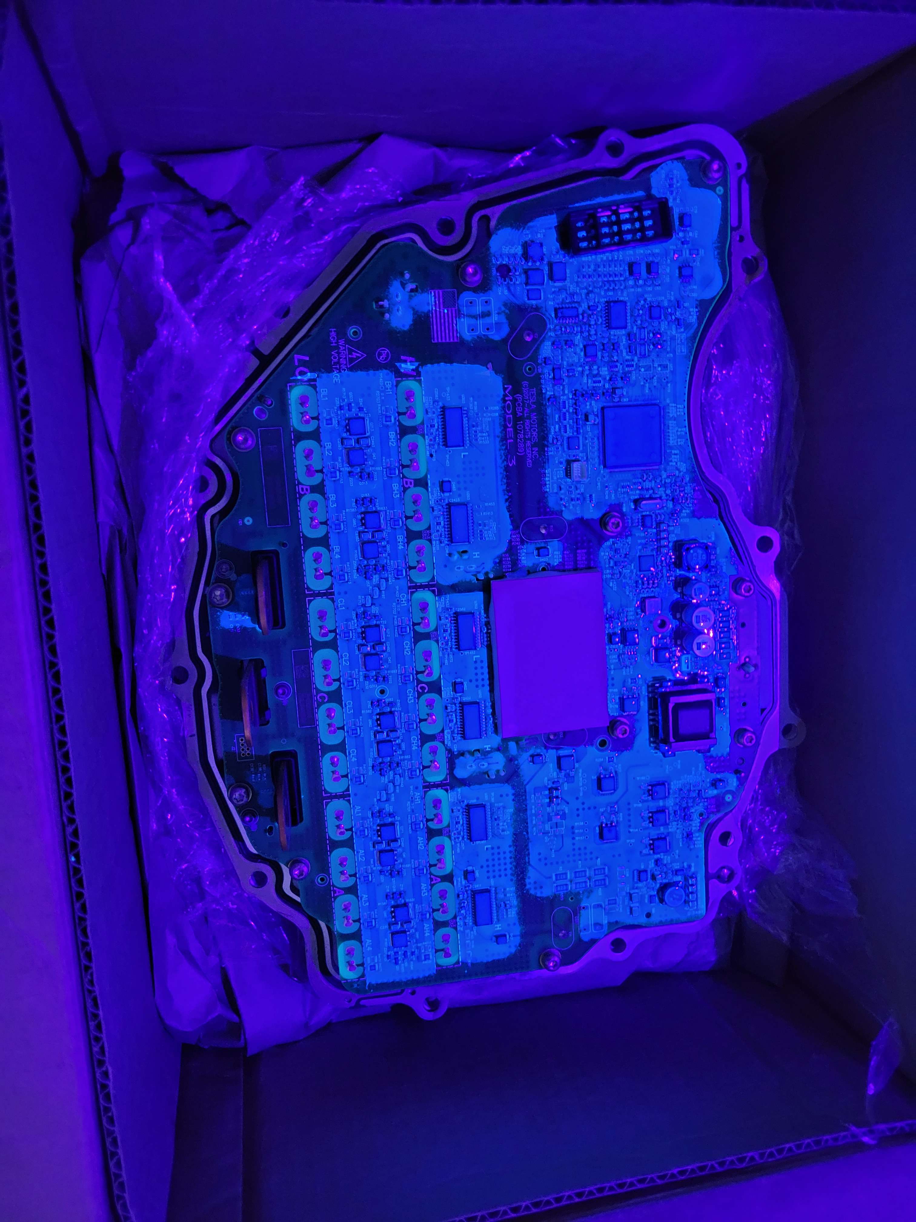

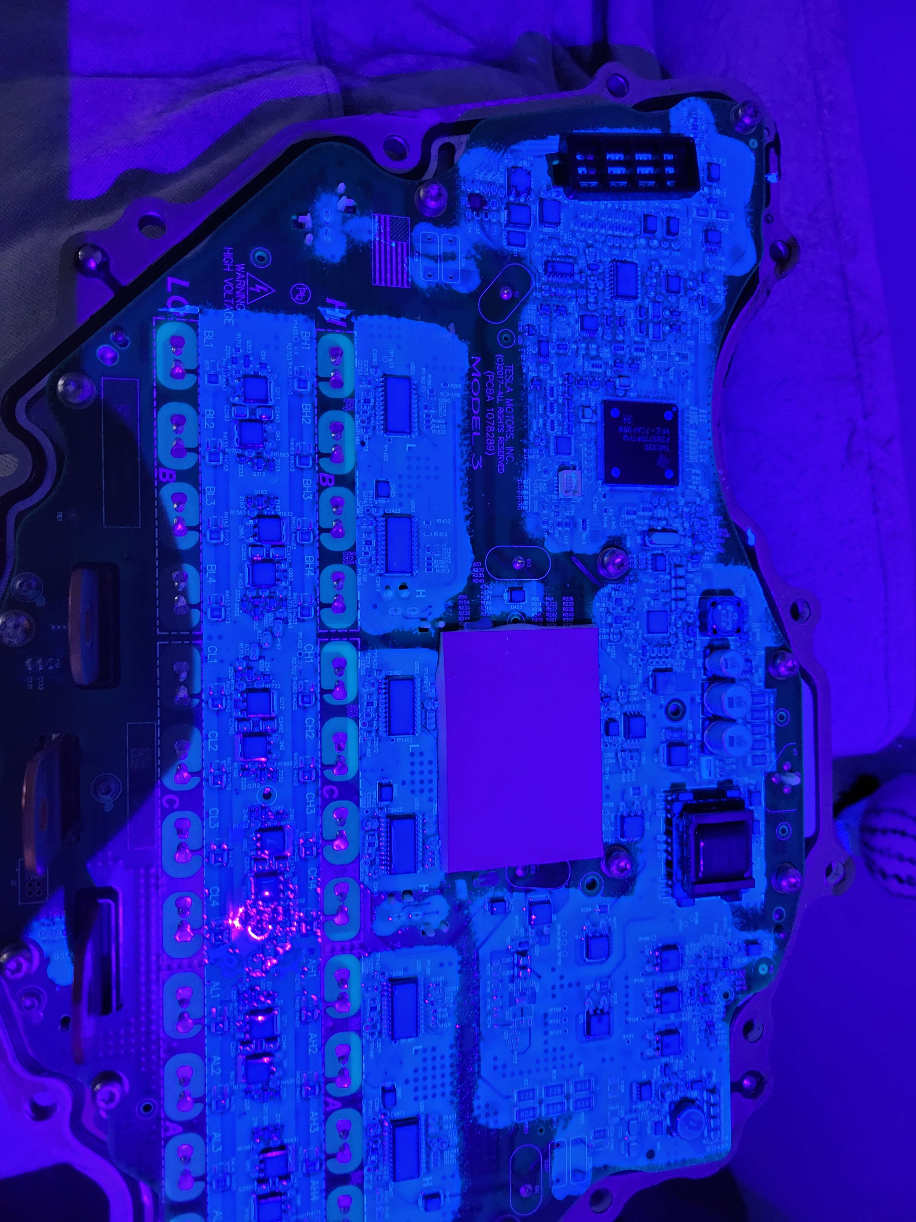

additional tools needed aside from those listed in this post:
Mg chemicals 8310/8310A as available in your locality or equivalent mg chemicals 8310A
UV/blacklight (I have party store blacklights at home and they work as shown) as conformal coating is uv reactive
Various stiffness brushes
Nitrile gloves, eyepro and respirator with volatile chemical filtering or some kind of active ventilation (or both for maximum safety)
Xacto blade or sharp flat screwdriver (again, peel not scrape, don't want to damage things)
Fine picks and tweezers to aid in coating removal of challenging areas and around leads. I have attached photos from my experiment
before after
I will copy it to Wiki once commented by others, I will also add notes around whole motor, how i disassembled it.Jack Bauer wrote: ↑Sun Apr 20, 2025 8:29 am Thats great info thanks:) Can someone please add this to the wiki.

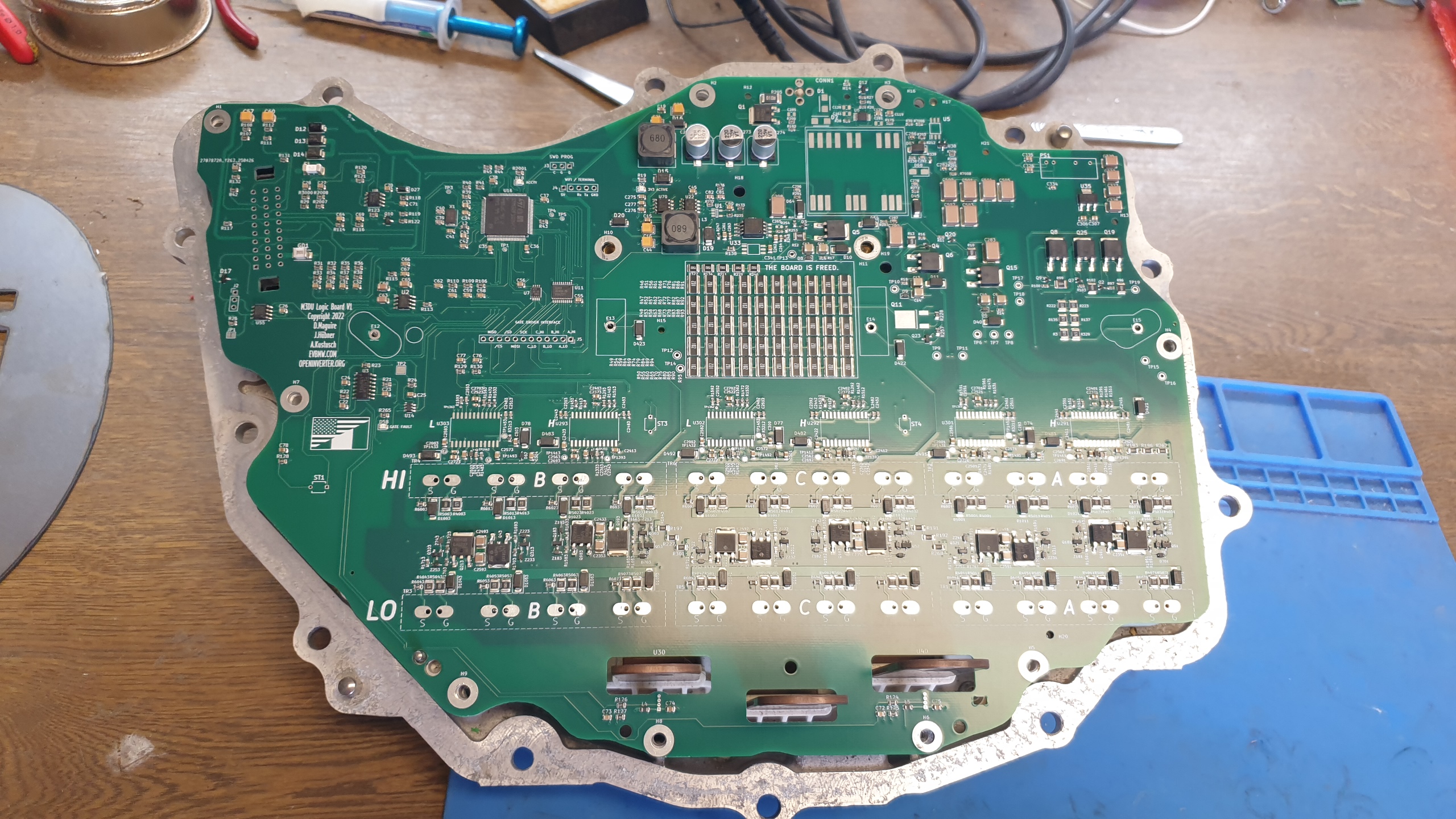

I ordered the 8310A from RS today. Also spent a few hours cleaning up the JLC bom and cpl so they dont generate weird errors. Good thing I did as JLC now have the STM32F103VCT6 as preorder only so I "reserved" 10. In any event, am ready to push the button finally to order 2 real prototypes as soon as confirm the fit of the 3d printed version.
- Posts: 3666
- Has thanked: 12 times
- Been thanked: 350 times

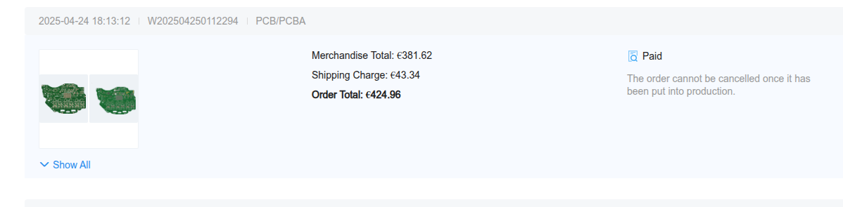

Real prototypes ordered. Wish me luck:)
- Posts: 3666

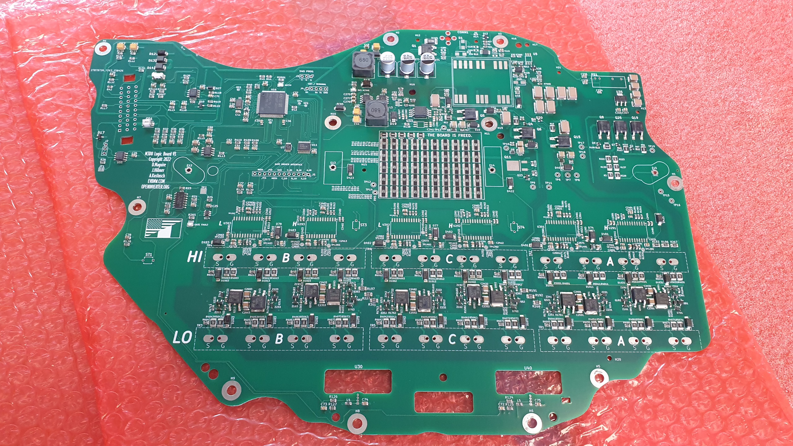

In production at JLC. BOM and footprints all match.

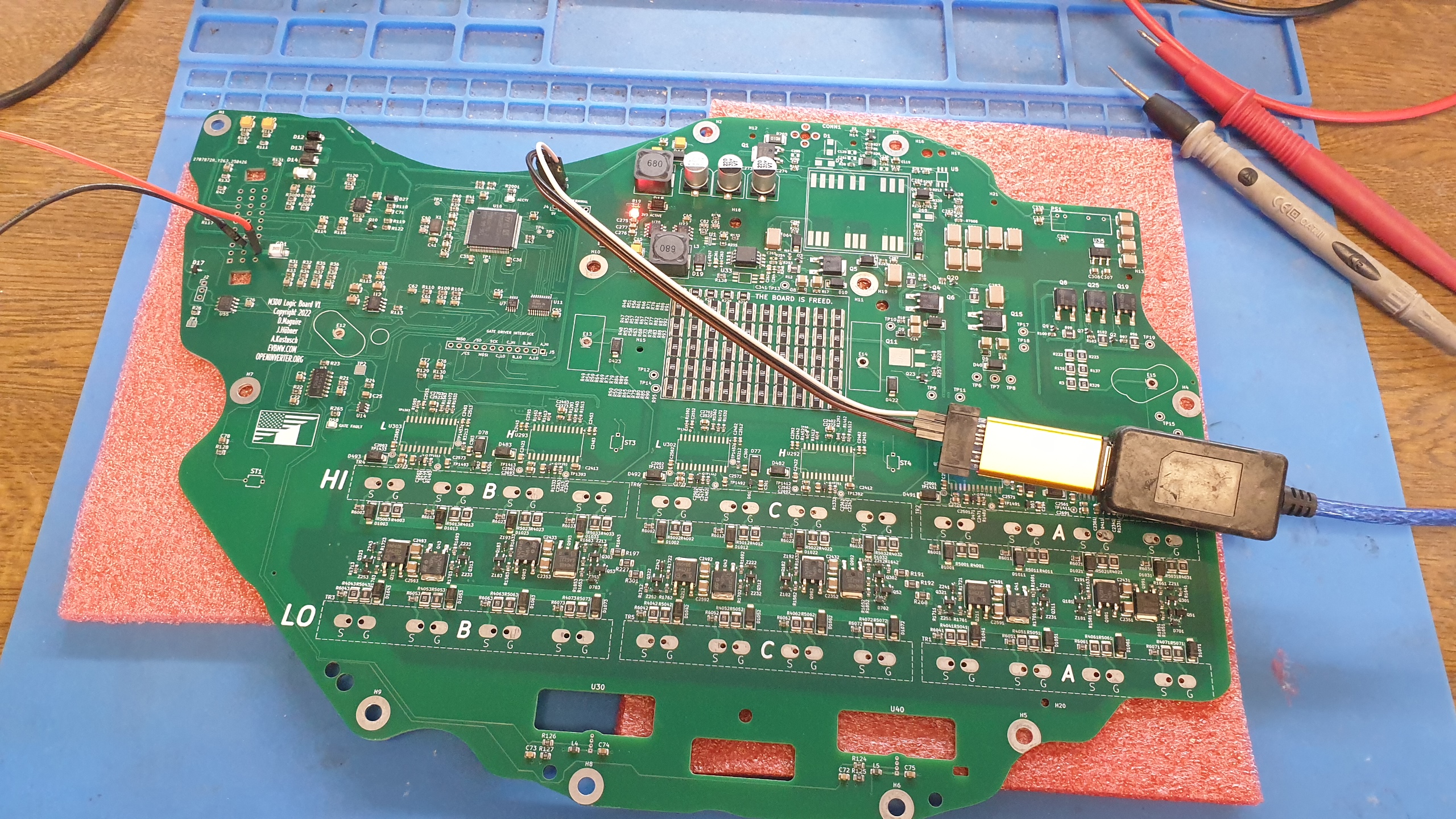

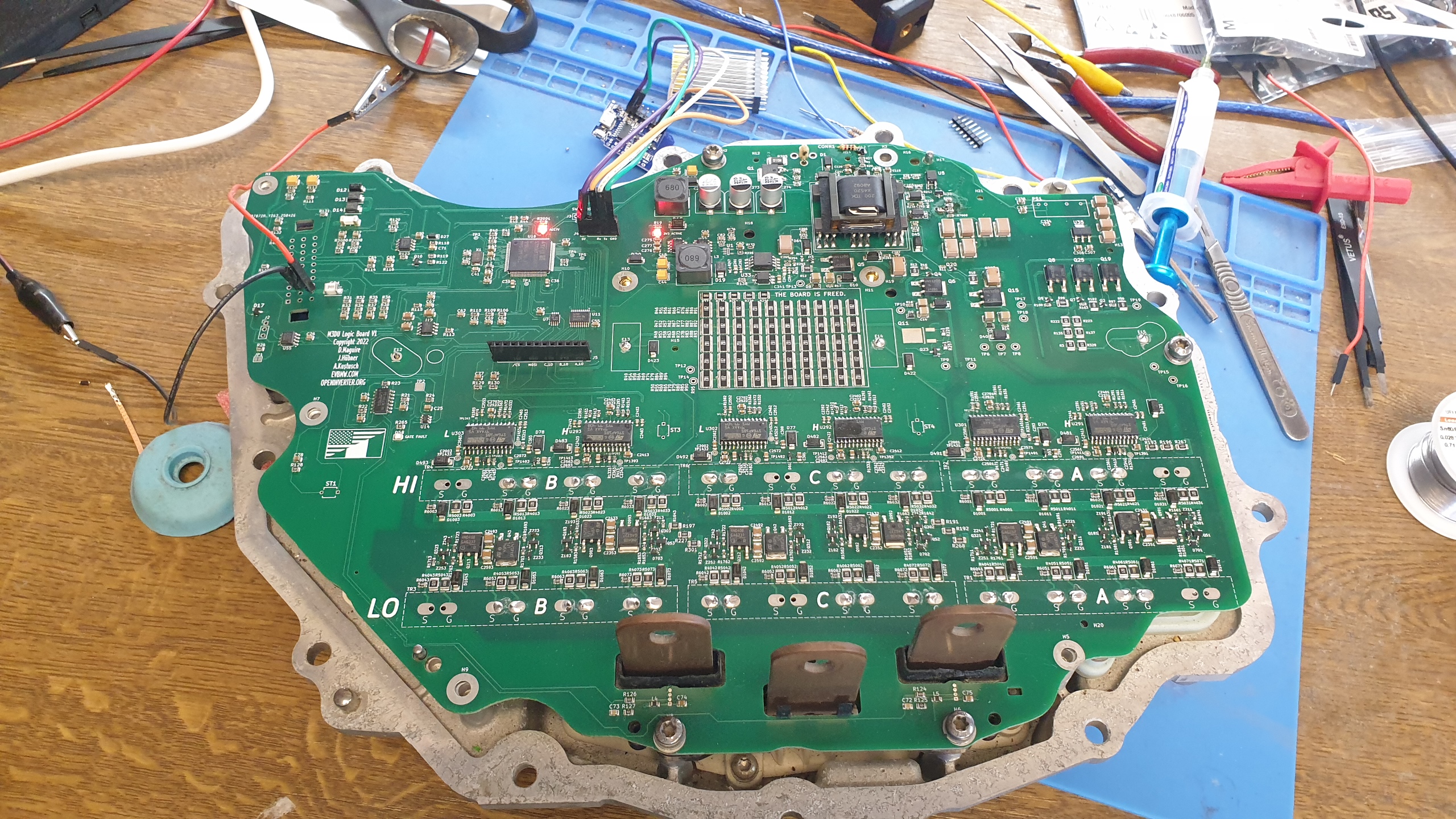

So far so good. Boards power up , 5v and 3v3 work and I can talk to the STM32.
Getting interesting:)
- Posts: 3666
Sadly missed one locating peg for the current sensor block. No big deal. I can just snip it on this one.

All gate drivers powered up, reset and waiting for spi configuration to be loaded.
- Posts: 294
- Has thanked: 78 times
- Been thanked: 96 times
Um. I dont think you need to be worrying about the spi configuration. That's looks to be all in place and working. Those chips are generally very unhappy until properly initialised with a working isolated gate supply. In my experience if the fault light is out the gate driver chips are happy or the power is off.Jack Bauer wrote: ↑Thu May 15, 2025 12:54 pm All gate drivers powered up, reset and waiting for spi configuration to be loaded.
If you're running the MG_DU branch code there's no reason it couldn't have just started working... I didn't check your schematic for any differences compared to the MG board. You might have just got lucky.
Can you check your error log for any GATEDRIVEFAULT or GATEDRIVEINITFAIL messages. Is it reporting 11 for the "hwrev" param? If so it's correctly identifying the TeslaM3 variant (HWREVS in param_prj.h needs updating to have the correct strings for the MG and TeslaM3).
