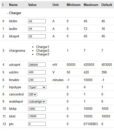

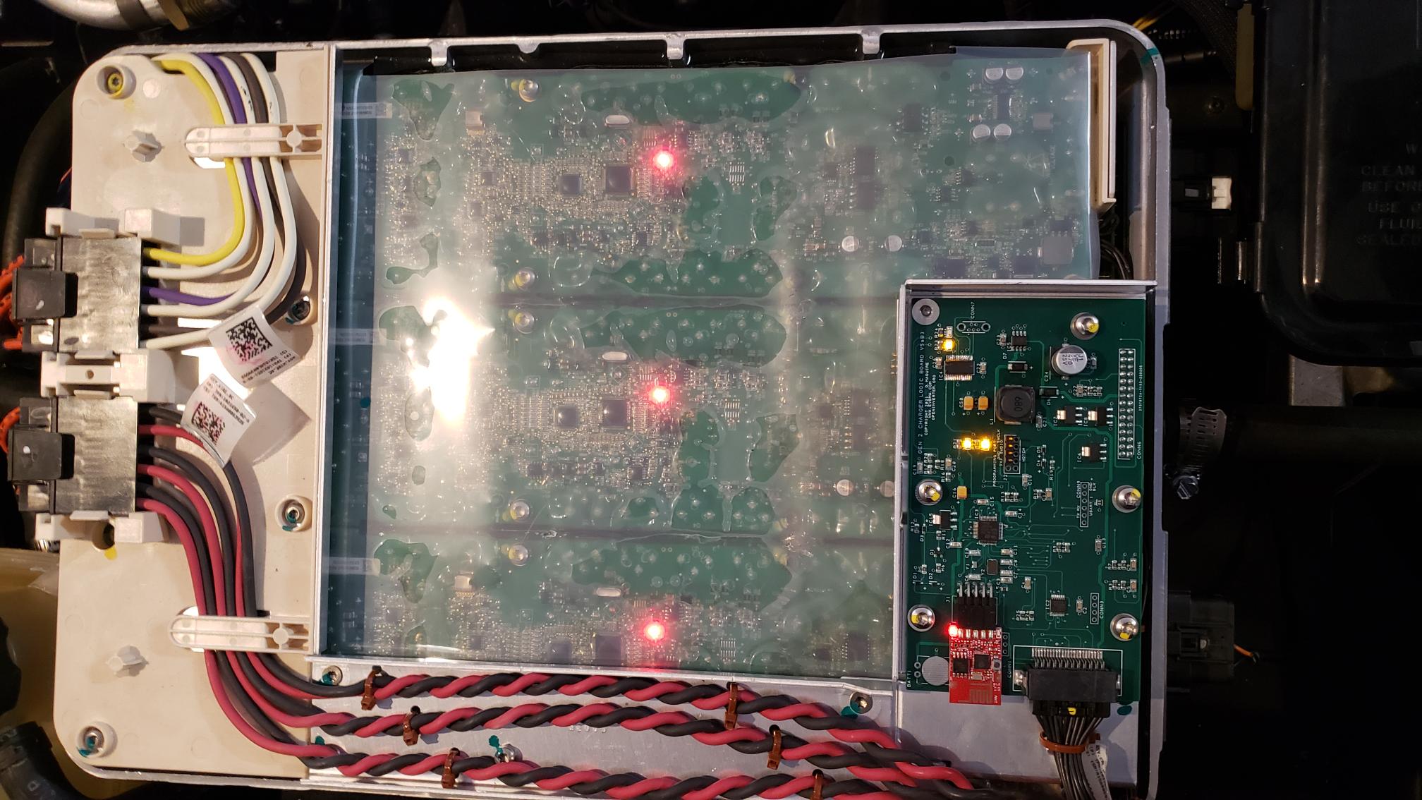

Have my new board installed and communicating through WiFi. Settings attached and photo of LEDs attached.
All modules are powering up, based on LEDs on each module.
Board LEDs are as shown, with upper LED (of two stacked amber LEDs) flashing (might appear solid in photo - it's not).
I can read battery voltage at DC connections on charger, but it is not outputting DC voltage (in other words, contactors are open but battery is not being charged).
Any suggestions?
Any suggestions?

Please post the output of http://192.168.4.1/cmd?cmd=json
Very likely the CAN termination solder jumper below the wifi module isn't closed

"idclim": {"unit":"A","value":45.00,"isparam":true,"minimum":0.00,"maximum":45.00,"default":45.00,"category":"Charger","i":0},
"iaclim": {"unit":"A","value":45.00,"isparam":true,"minimum":0.00,"maximum":72.00,"default":16.00,"category":"Charger","i":1},
"idcspnt": {"unit":"A","value":30.00,"isparam":true,"minimum":0.00,"maximum":45.00,"default":45.00,"category":"Charger","i":2},
"chargerena": {"unit":"1=Charger1, 2=Charger2, 4=Charger3","value":7.00,"isparam":true,"minimum":1.00,"maximum":7.00,"default":7.00,"category":"Charger","i":3},
"udcspnt": {"unit":"mV","value":398000.00,"isparam":true,"minimum":50000.00,"maximum":420000.00,"default":403000.00,"category":"Charger","i":4},
"udclim": {"unit":"V","value":400.00,"isparam":true,"minimum":50.00,"maximum":420.00,"default":398.00,"category":"Charger","i":5},
"timelim": {"unit":"minutes","value":240.00,"isparam":true,"minimum":-1.00,"maximum":10000.00,"default":-1.00,"category":"Charger","i":6},
"inputype": {"unit":"0=Type2, 1=Type2-3P, 2=Type1, 3=Manual, 4=Manual-3P","value":2.00,"isparam":true,"minimum":0.00,"maximum":4.00,"default":1.00,"category":"Charger","i":7},
"cancontrol": {"unit":"0=Off, 1=On","value":0.00,"isparam":true,"minimum":0.00,"maximum":1.00,"default":0.00,"category":"Charger","i":8},
"enablepol": {"unit":"0=ActiveHigh, 1=ActiveLow","value":0.00,"isparam":true,"minimum":0.00,"maximum":1.00,"default":0.00,"category":"Charger","i":9},
"idckp": {"unit":"","value":1000.00,"isparam":true,"minimum":0.00,"maximum":10000.00,"default":1000.00,"category":"Charger","i":10},
"idcki": {"unit":"","value":10000.00,"isparam":true,"minimum":0.00,"maximum":10000.00,"default":10000.00,"category":"Charger","i":11},
"pin": {"unit":"","value":0.00,"isparam":true,"minimum":0.00,"maximum":67108863.00,"default":0.00,"category":"Charger","i":12},
"opmode": {"unit":"0=Off, 1=Run","value":1.00,"isparam":false},
"state": {"unit":"0=Off, 1=Enable, 2=Activate, 3=EVSEActivate, 4=Stop","value":3.00,"isparam":false},
"uptime": {"unit":"s","value":770.00,"isparam":false},
"version": {"unit":"4=1.07.R","value":4.00,"isparam":false},
"lasterr": {"unit":"0=NONE, 1=CHARGERCAN, 2=CHARGERFAULT, 3=EXTCAN,","value":0.00,"isparam":false},
"uaux": {"unit":"V","value":13.18,"isparam":false},
"aclim": {"unit":"A","value":0.00,"isparam":false},
"hwaclim": {"unit":"A","value":0.00,"isparam":false},
"modaclim": {"unit":"dig","value":0.00,"isparam":false},
"modcmd": {"unit":"dig","value":254.00,"isparam":false},
"cablelim": {"unit":"A","value":40.00,"isparam":false},
"evselim": {"unit":"A","value":15.53,"isparam":false},
"idc": {"unit":"A","value":0.00,"isparam":false},
"udc": {"unit":"V","value":0.00,"isparam":false},
"soc": {"unit":"%","value":0.00,"isparam":false},
"proximity": {"unit":"0=Off, 1=On","value":1.00,"isparam":false},
"enable": {"unit":"0=Off, 1=On","value":1.00,"isparam":false},
"canenable": {"unit":"0=Off, 1=On","value":0.00,"isparam":false},
"cpuload": {"unit":"%","value":0.00,"isparam":false},
"c1stt": {"unit":"","value":0.00,"isparam":false},
"c1flag": {"unit":"0=None, 1=Enabled, 2=Fault, 4=CheckAlive","value":4.00,"isparam":false},
"c1tmp1": {"unit":"°C","value":0.00,"isparam":false},
"c1tmp2": {"unit":"°C","value":0.00,"isparam":false},
"c1tmpin": {"unit":"°C","value":0.00,"isparam":false},
"c1uac": {"unit":"V","value":0.00,"isparam":false},
"c1iac": {"unit":"A","value":0.00,"isparam":false},
"c1udc": {"unit":"V","value":0.00,"isparam":false},
"c1idc": {"unit":"A","value":0.00,"isparam":false},
"c2stt": {"unit":"","value":0.00,"isparam":false},
"c2flag": {"unit":"0=None, 1=Enabled, 2=Fault, 4=CheckAlive","value":4.00,"isparam":false},
"c2tmp1": {"unit":"°C","value":0.00,"isparam":false},
"c2tmp2": {"unit":"°C","value":0.00,"isparam":false},
"c2tmpin": {"unit":"°C","value":0.00,"isparam":false},
"c2uac": {"unit":"V","value":0.00,"isparam":false},
"c2iac": {"unit":"A","value":0.00,"isparam":false},
"c2udc": {"unit":"V","value":0.00,"isparam":false},
"c2idc": {"unit":"A","value":0.00,"isparam":false},
"c3stt": {"unit":"","value":0.00,"isparam":false},
"c3flag": {"unit":"0=None, 1=Enabled, 2=Fault, 4=CheckAlive","value":4.00,"isparam":false},
"c3tmp1": {"unit":"°C","value":0.00,"isparam":false},
"c3tmp2": {"unit":"°C","value":0.00,"isparam":false},
"c3tmpin": {"unit":"°C","value":0.00,"isparam":false},
"c3uac": {"unit":"V","value":0.00,"isparam":false},
"c3iac": {"unit":"A","value":0.00,"isparam":false},
"c3udc": {"unit":"V","value":0.00,"isparam":false},
"c3idc": {"unit":"A","value":0.00,"isparam":false},
"serial": {"unit":"","value":"87184258:49548566:670FF54","isparam":false}

Solder looks good. I heated it up and added solder to both sides again, just in case.
Thanks for your help here!

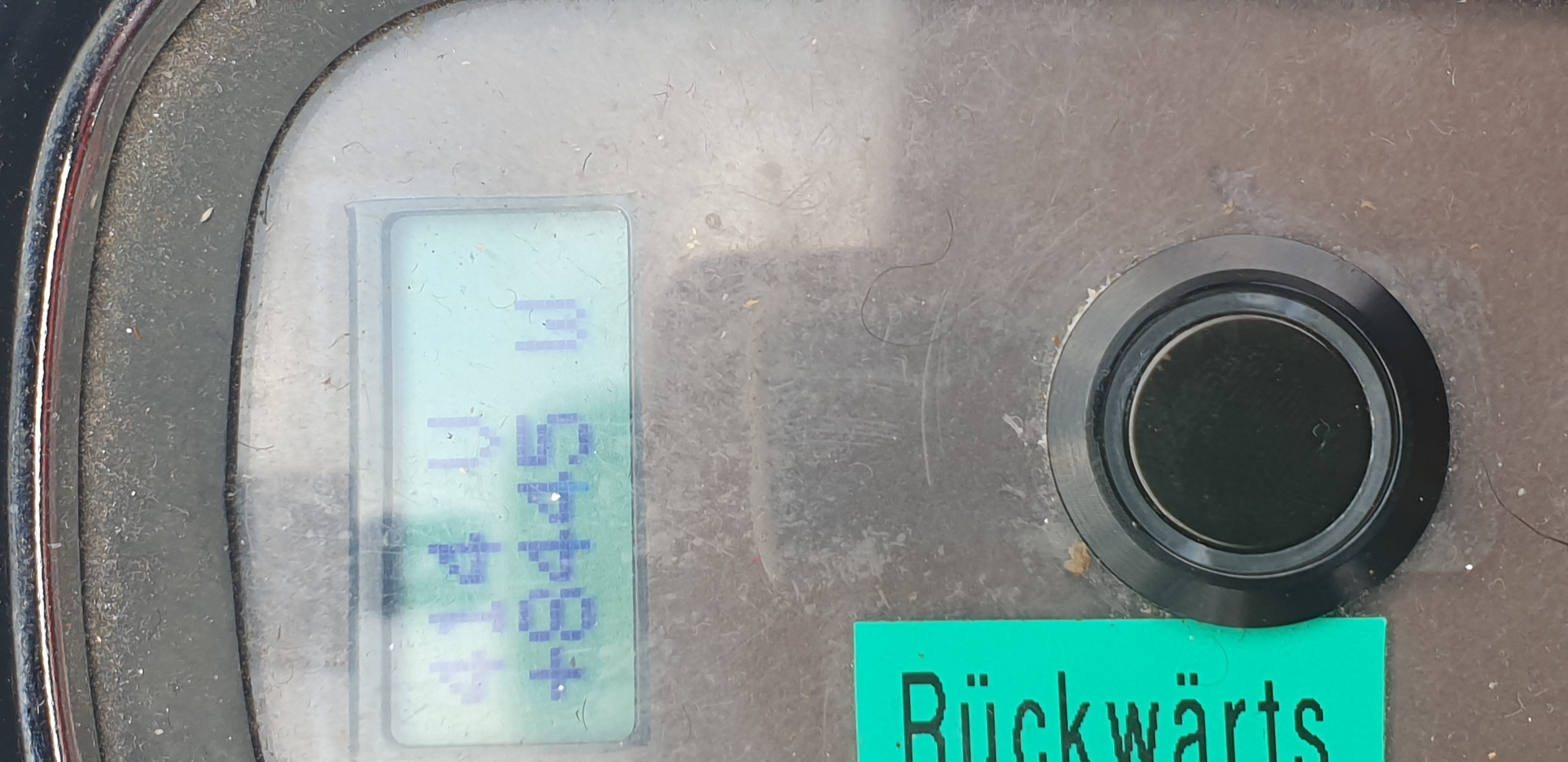

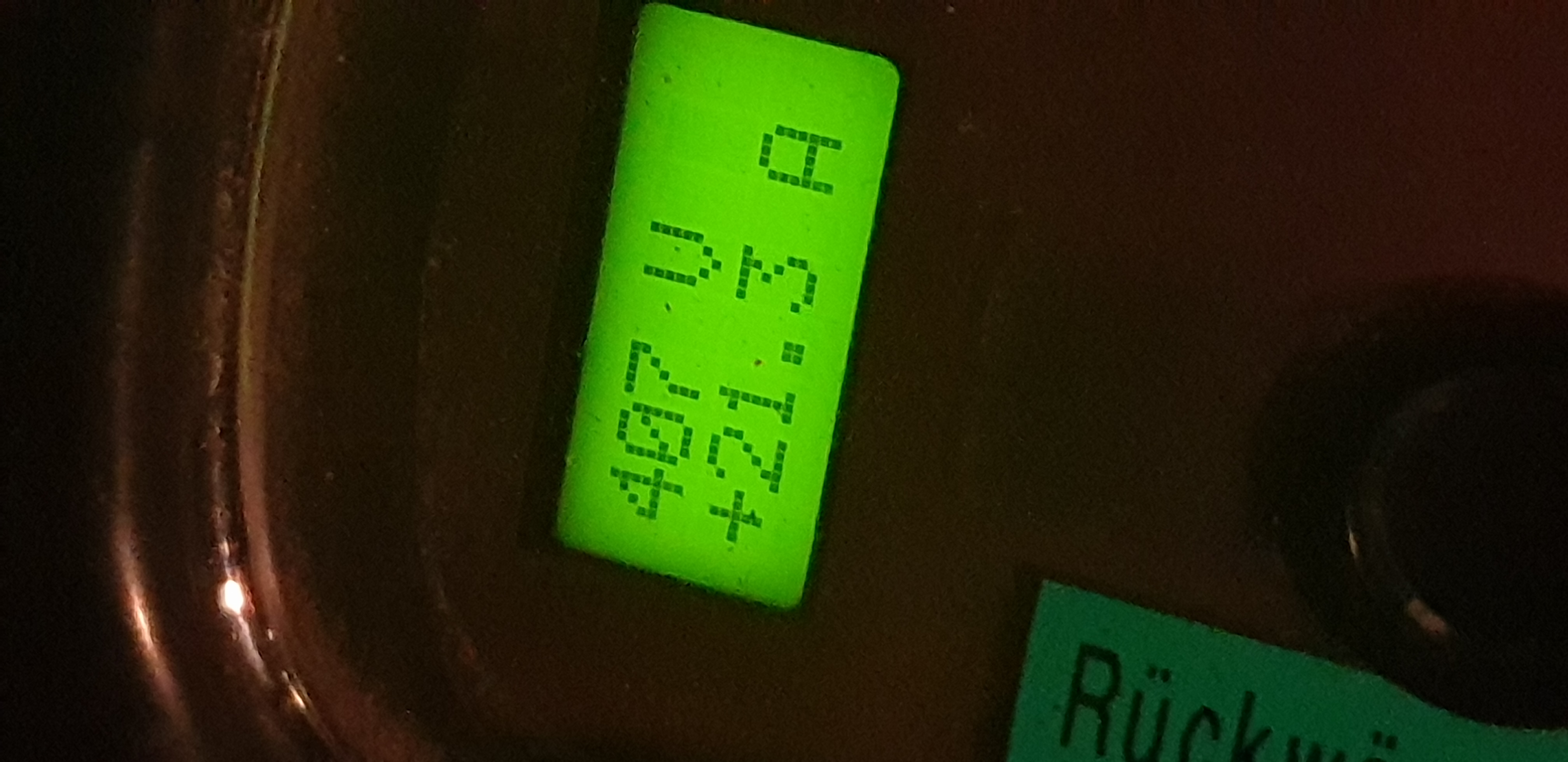

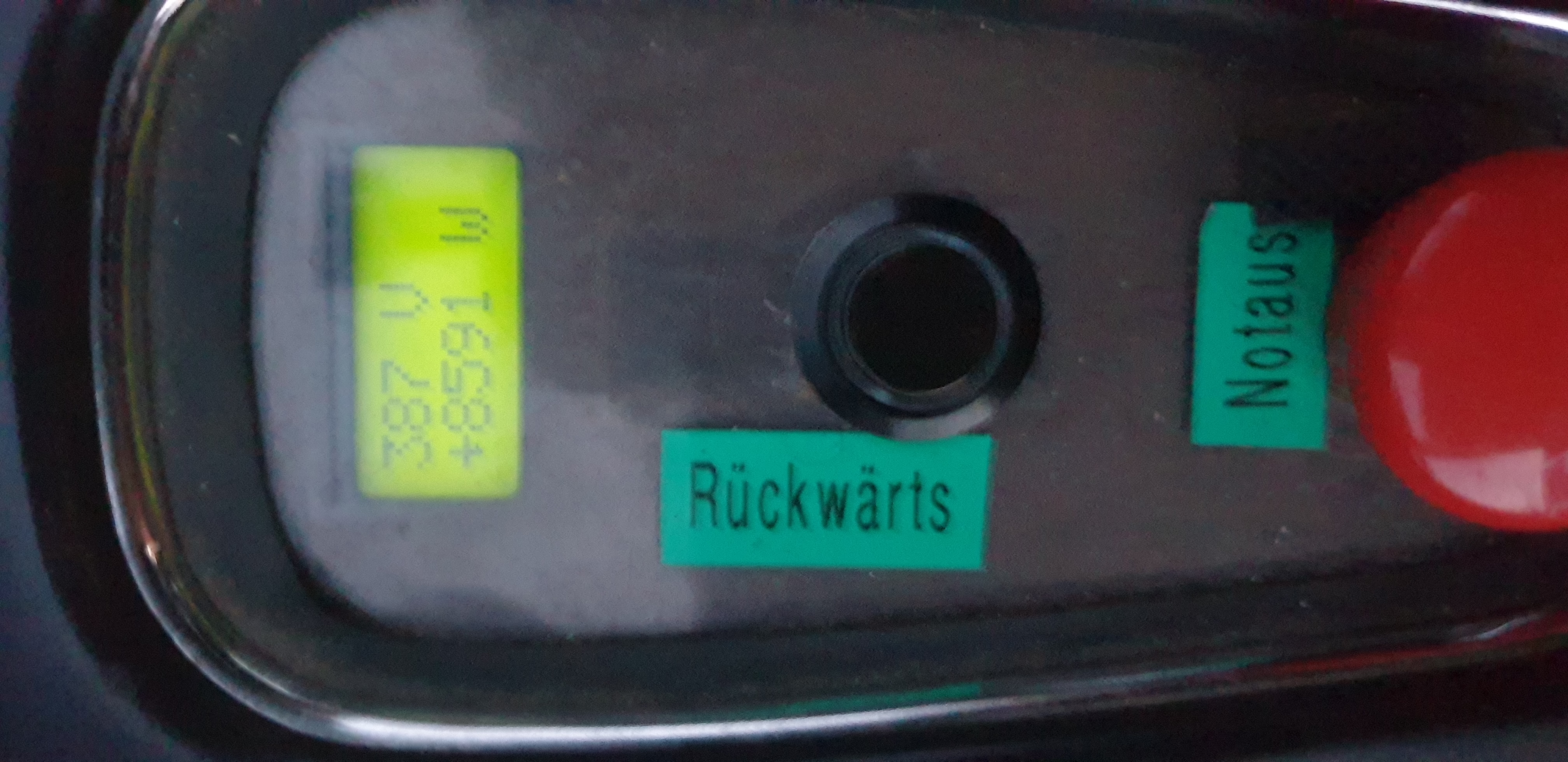

Ok i have an issue.
Not with the charger... it runs just fine.
Not with the board... it also does its job.
Maybe the formware? Or my settings?
I replaced 3x of my 3kW eltek chargers which were charging ar 9kW but would not abide by EVSE Cp signal.
I put in Tesla gen2 charger and used open source firmware with serial setup.
I did setup in evse mode with 20A phase limit.
Charger only goes up to 8.5kW! Why would that be? And i tested at various voltages as to eliminate constant power tapering. Also i tested on various L2 EVSE in Slovenia. See the photos.
Did anyone come across similar behaviour?

That is exactly what i am seeing. Goes up to 8.5kW and dances about 500W. Could that mean each of the modules sees something faulty in its CAN command and starts to reduce but is then overcome by correct telegram? Or is it that Cp sensing is not very precise. I count some 2m of unshielded wire from socket to charger.
Yeah... about debug... the way i installed the charger i have to gat it down and take the lid off. My plan is to put a small cable through the lid and use it to connect to FTDI to have serial connection. Then i will be able to see debug...any day now.
