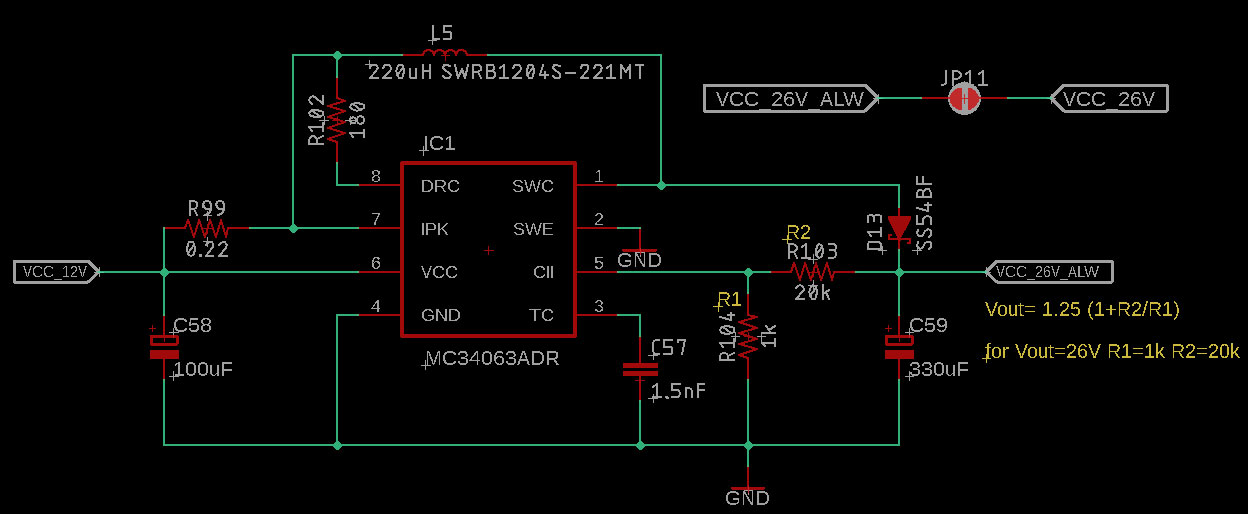

Alerted by your posts I started to check my power converters, because I didn't used them at my stage of development yet.
And I must say:
1. XL1509-5.0 is a complete piece of crap. Firstly it supposed to give 5V, but it gave 9V. After adding external resistor to its internal voltage divider it gave 5V, but under little current draw (30mA from 3x STM32 and linear regulator) it dropped under 3V.
There was earlier TPS54331. Why you switched to XL1509?
2. I had two days of nightmare with MC34063A. It simply won't switch in boost mode. It only puts thru voltage. I've changed few ICs, but from this same seller. Build another converter. Nothing! It just won't switch.
I've ordered from Ali some assembled converters to swap my ICs and see if they are faulty. Will see.
https://www.aliexpress.com/item/1005002494251409.html
3. I have no issue with -5V yet, but I didn't used it under load.

The XL1509 works perfectly. Added Block 4 PDFs to the repo :

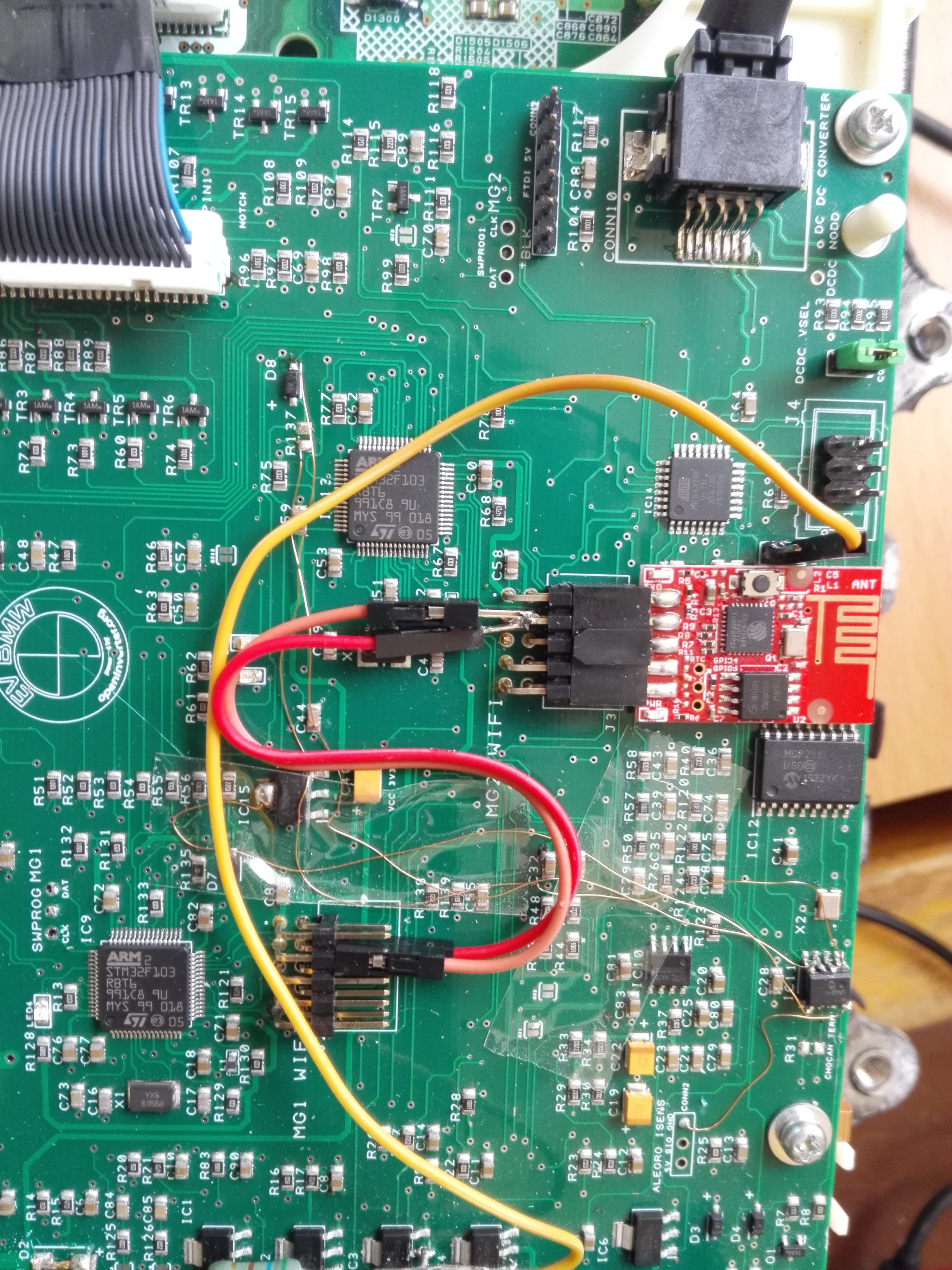

My inverter blowup meant I could take pictures of my board mods:
  1. Barely visible: 560R resistor to 12V pulling up IGBT. Also connected to precharge FET meaning IGCT is low at startup and thus DC-DC converter off
  2. Single wifi module mod
  3. CAN transceiver for MG2 CPU. Sits on top of the Atmel one. Not sure if this would work simultaneously with the onboard CAN to MG1. Have deleted that.
I never wired up PB9 to the DC-DC converter for setting voltage via user PWM.
Would these be mods for the next revision? Is this even the right place to discuss?

I have finally became my inductor and capacitor soldered, but the DC/DC converter for -5V (IC17) was still not working properly (1.5V at output instead of the -5V).
But I have eventually found out what was wrong:
THE DIODE D9 WAS SOLDERED IN THE WRONG DIRECTION!!! I have resoldered it and now it works perfectly fine!
The bar on the diode indicating the cathode should point right in the direction of the inductor, but it was soldered differently.
So guys, be carefull with Your boards, as this error may be potentially repeated in other boards as well.
