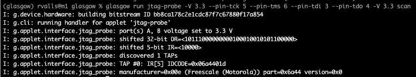

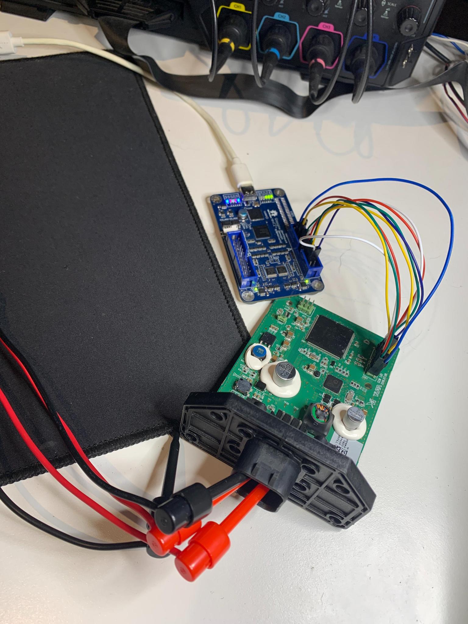

Hi uhi22, I'm projectgus' friend, helping him out with his FrakenKona
I also got a CCM to muck around a couple of days ago from another EV club friend and got to the point of having a Glasgow board talking with bitbang'd JTAG against OpenOCD. I've written up a few (not all) details from my setup here:
https://gist.github.com/brainstorm/ab2f ... d1a32a20ad
Unfortunately OpenOCD has some troubled and incomplete e200 support:
https://sourceforge.net/p/openocd/mailm ... nlr.menet/
May I ask how you managed to dump the contents of the main FreeScale SPC5606 IC? Like Mike Electric Stuff, I dumped the SPI flash 8 pin IC only to find the QCA drivers there, but not much application payload.
Cheers!

Luckily we used the same controller family 10 years ago in a professional project, and the "blue box" debugger from ISystems was still flying around. The connector matches directly, so it was just plug &play
Would be interesting to know whether there is a working open-source solution for at least flashing, in best case also for debugging ...

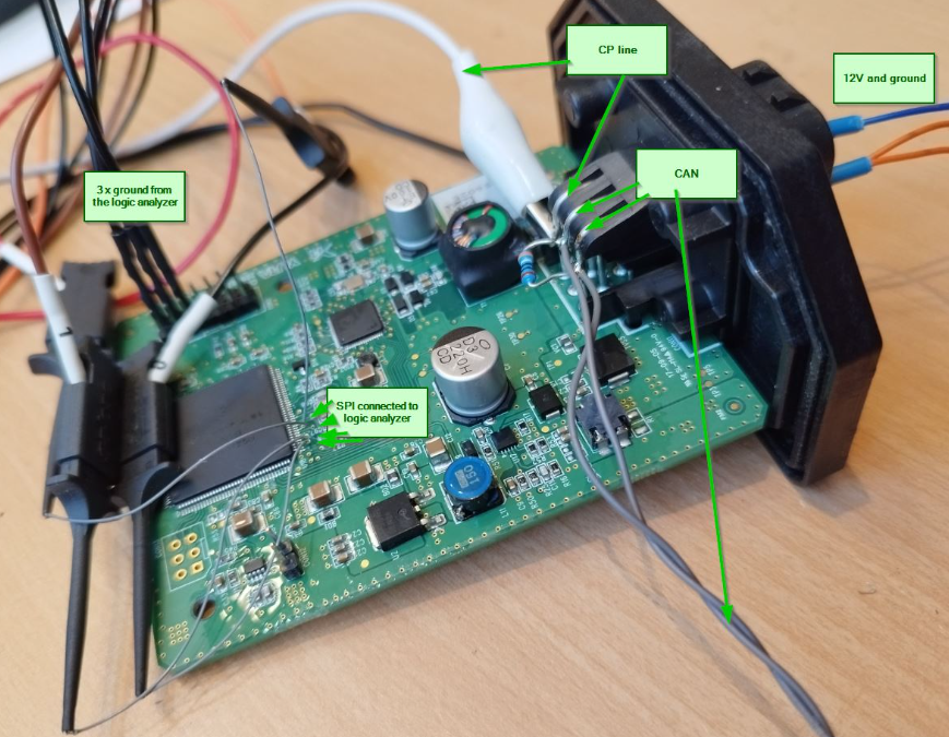

The toolchain for decoding the SPI traffic between the SPC5605 and the QCA7005 is working now.
- SPI is traced by Saleae logic analyzer, and exported as text file.
- The text file is converted to a pcap, using https://github.com/uhi22/Ioniq28Investi ... 1886e4a915
- The pcap can be converted to see the content of the V2G/EXI messages, using https://github.com/uhi22/pyPLC/blob/mas ... nverter.py
- Finally the result can be shown as osci plot, using https://github.com/uhi22/pyPLC/blob/master/scope.py

Installed the CCM from Lars in my Ioniq and drove to a public charger to see whether this works. Results:
- Charging works. (Ok, not a really surprise. Both CCMs have the same part number.)
- SPI trace of a complete charging session recorded and decoded, results here: https://github.com/uhi22/Ioniq28Investi ... i-analysis

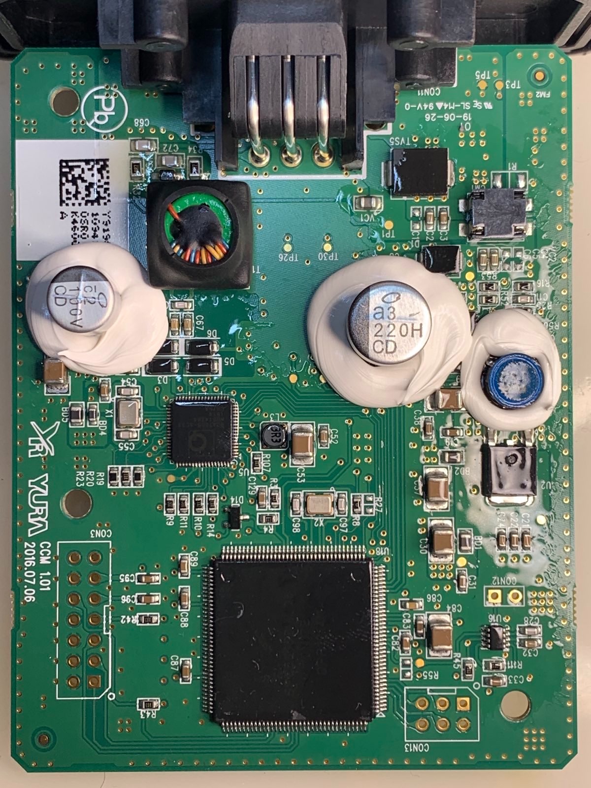

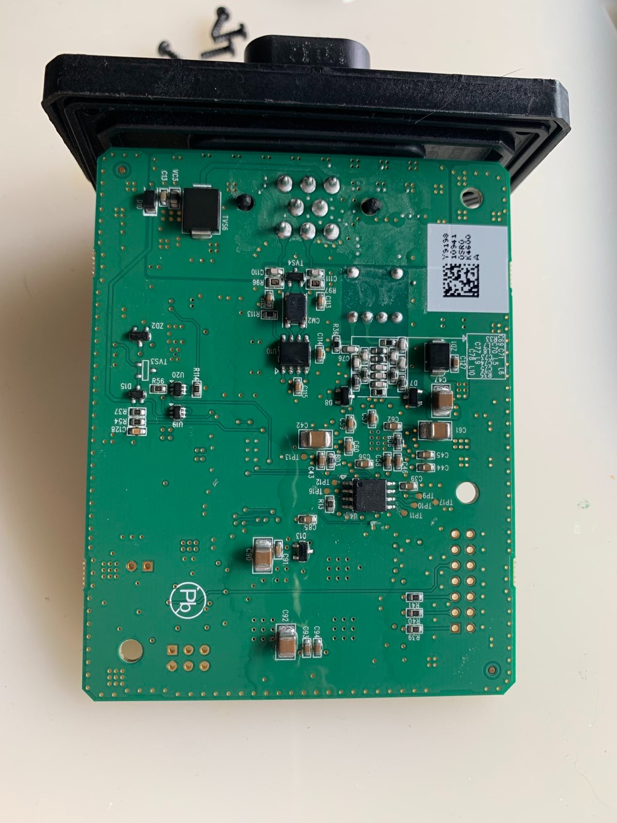

Managed to read out the SPI flash and made some quick analysis: https://github.com/uhi22/Ioniq28Investi ... i-flash-u4

To summarize the current status:
- From the CAN traces, created a (still weak) understanding how the CCM is talking with the rest of the car during a charging session. https://github.com/uhi22/Ioniq28Investi ... ng-session This needs to be refined to be useful. My conclusion for the moment is: The CCM is not really suited to play as a charge controller for not-Hyundai projects. Because it does no CP handling, no connector lock, no charge port temperature measurement. It is just a CAN to PLC bridge.
- The CCM helped a lot to understand the design of the QCA7005 together with its power supply, flash, microcontroller communication.
- Based on the gained knowledge, there is a way open to make an open-source implementation using ESP32 and QCA7005. The CCM works well for such a development (while it's original host controller is just hold in reset, so it does not disturb). https://github.com/uhi22/ccs32berta
