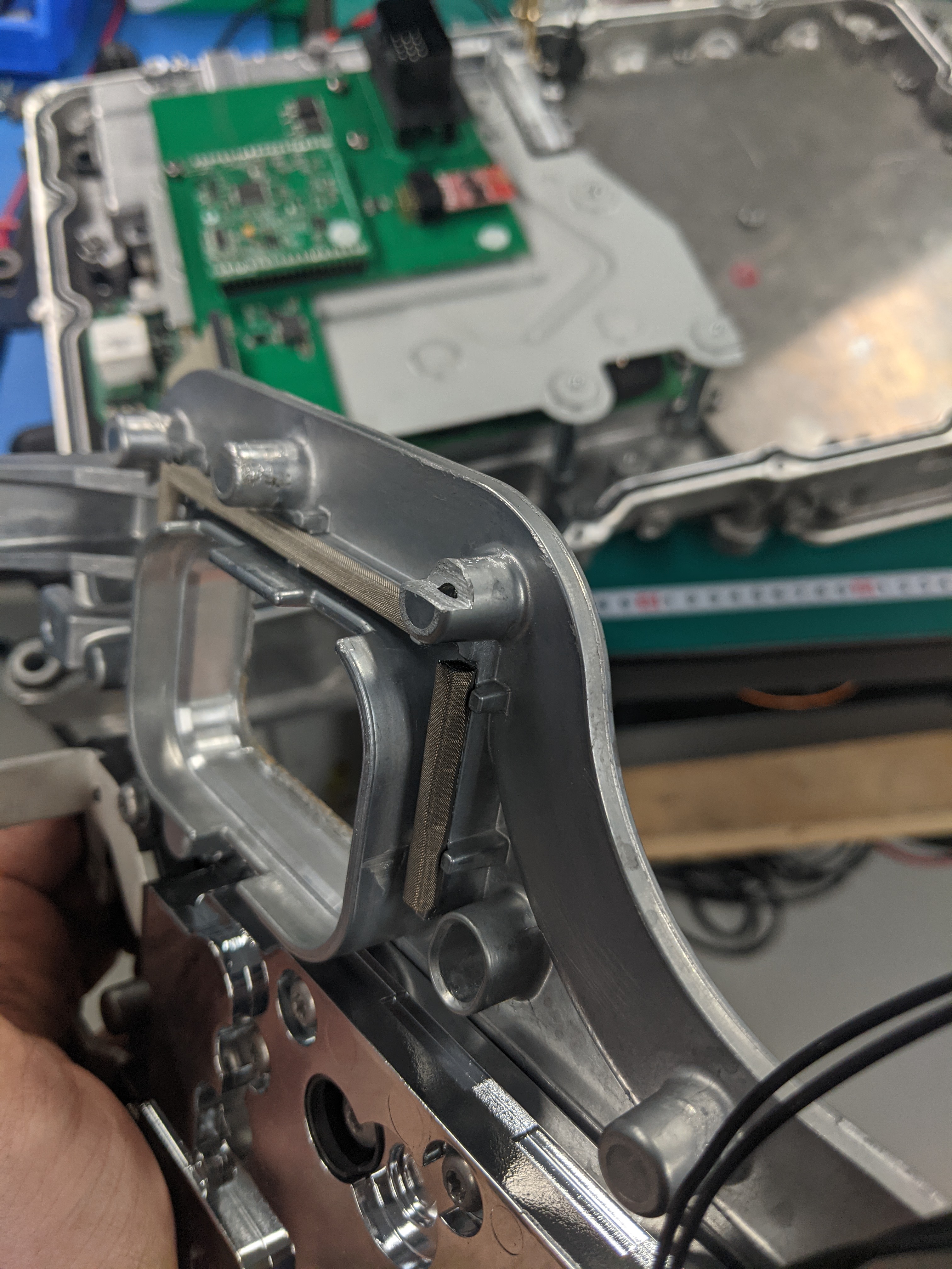

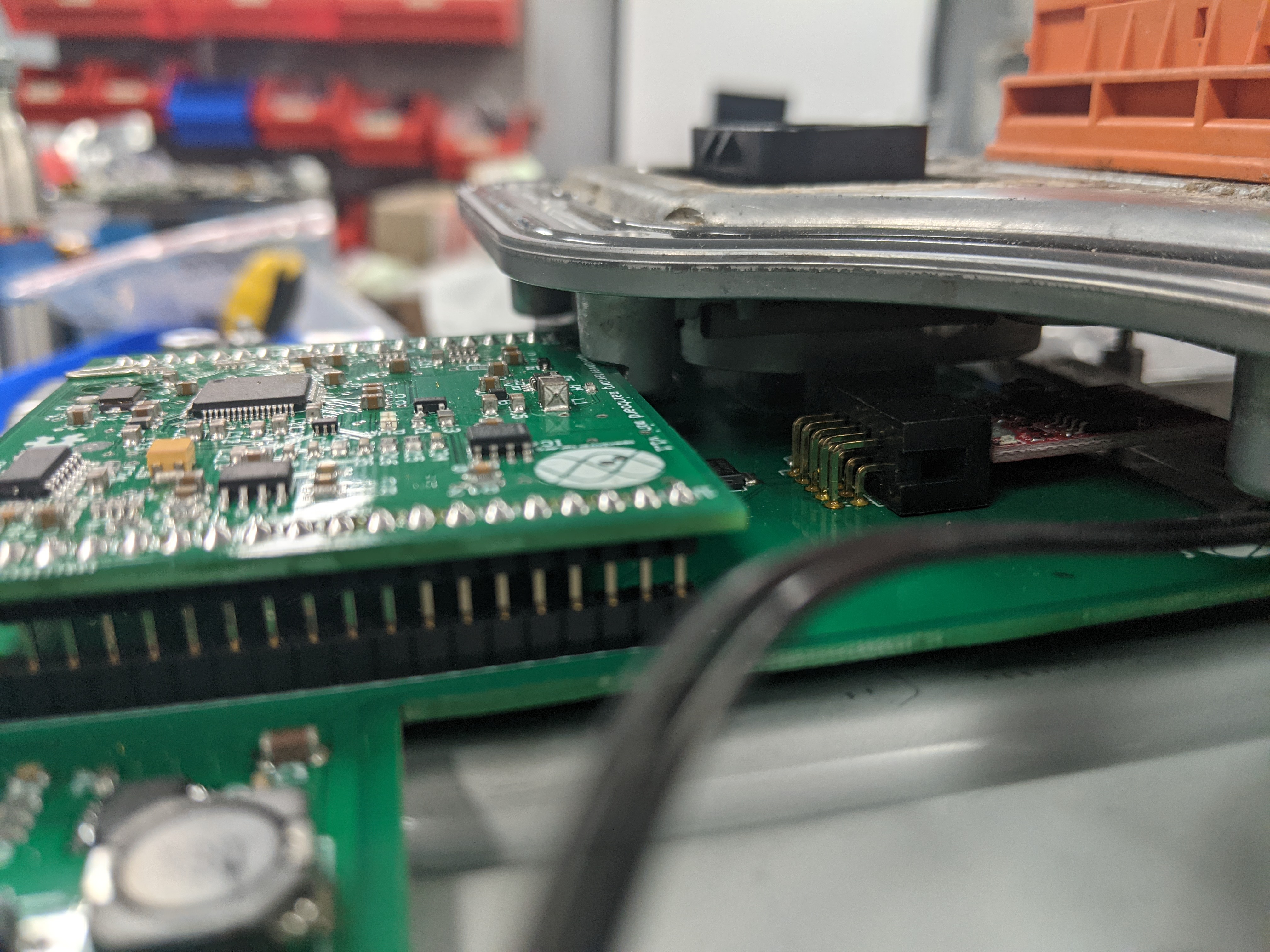

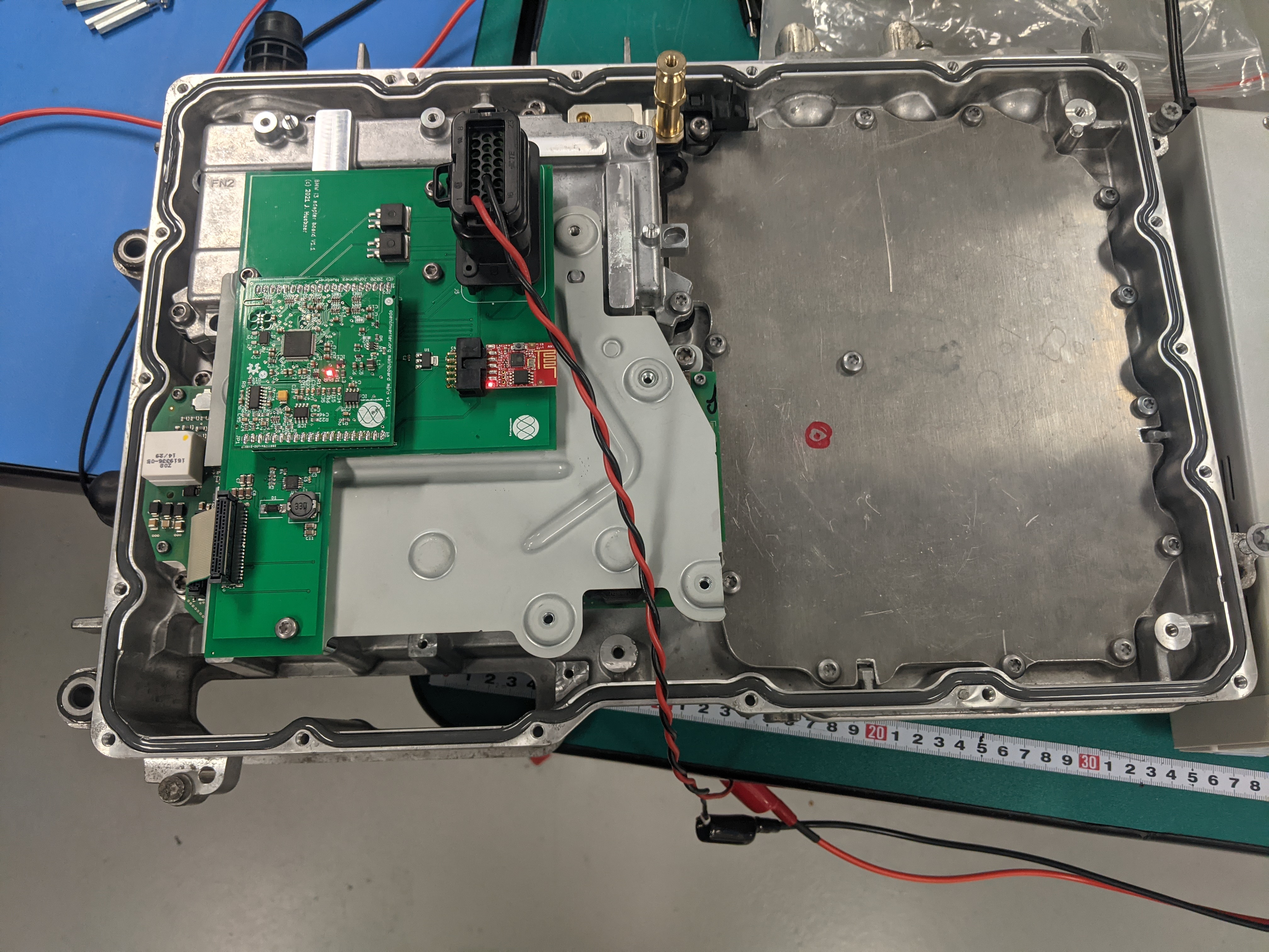

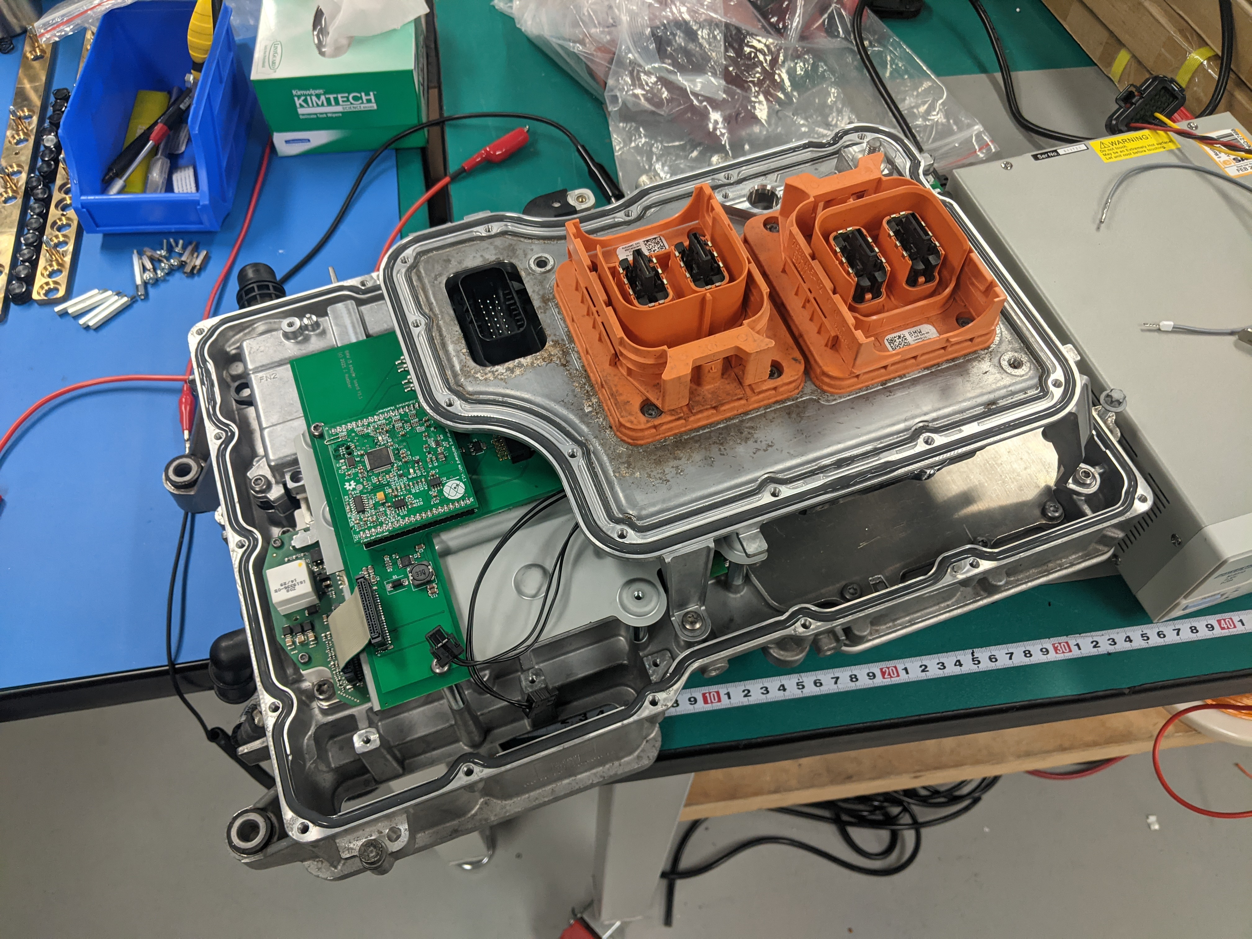

I've been working on some mechanical integration bits and pieces, hopefully some that will help other members.
1: If you are planning on using the shield mounted under the inverter, you will have to knock out the centre post as it sticks up into the pins on the adapter PCBA. I used a large step drill and slowly worked my way through it.
- adapter PCBA shield mod
2: One of the posts for the connector mount casting collides with the inverter, I just milled this down ~7mm and halfway across the post. The screw will need loctite to seal from the topside as you expose the threads in doing this.
- Post mod connector casting
- Post mod connector casting 2
3. Lastly, I've made some waterjet cut blanking plates to close off cooling for the charger and DCDC inside the housing. This is just to remove them whilst they aren't doing anything useful and remove some weight from the assembly. Unfortunately it's not straightforward to do this, as some posts have to be machined down for these flat plates to fit, and this exposes one of the threads from the liquid side. I've hydraulically sealed this one, so it shouldn't be a problem (fingers crossed). If people want DXF files for these I can definitely send some links. They are definitely
not perfect, and will need some modification to fit well. I did as best I could for hole placement for a first-pass. Fine for now though!
