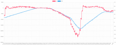

Reposting:
I did some more testing. Something still isn't right. It seems the car accelerates less above 4000rpm at full throttle than at, say, half throttle.
Also at high revs the transition to regen can become so brutal that the inverter desats.
I got it a lot tamer by dialing down curki and therefor raising curkd. It never reaches the id set point though, so it lacks the liveliness of that reluctance torque.
So with curkp=96 and curki=64 at least it stops doing "cruise control" at higher rpm and also regen transition is not overshooting so much.
I'm not sure if this is just a matter of tuning the controllers or if something else is wrong also.
I'm playing with the thought of getting rid of fweak and idweak and instead cascade another controller on top of the d-controller that makes sure the q-current doesn't become too large due to lack of field weakening.

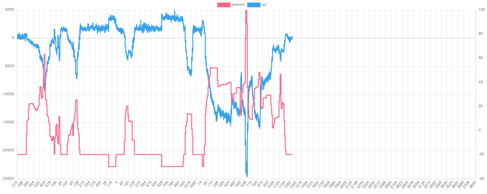

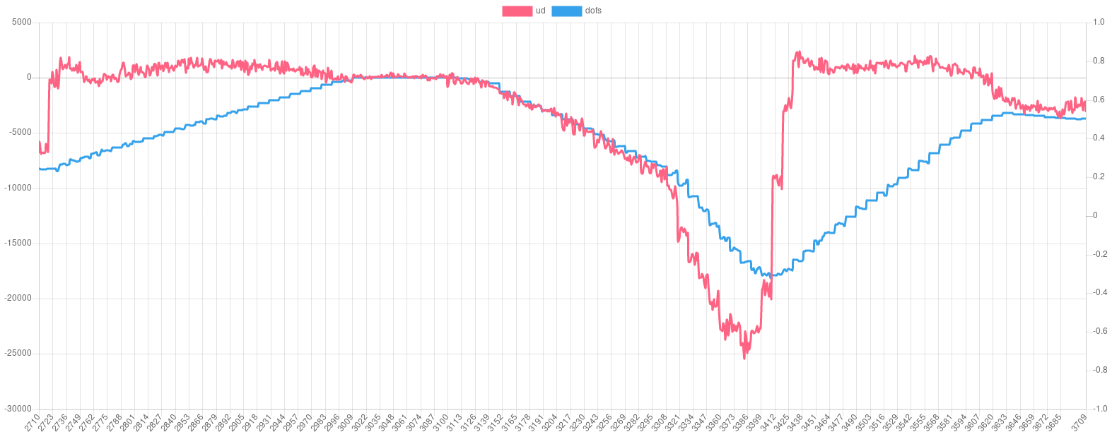

So did some testing.
So while q-current/voltage is well suited to be supported by a V/Hz profile, d current is a bit more complex. Not sure what the physical connections are.
- ud is negative when accelerating and sortof linearly increases with frequency
- ud becomes positive when regenning and seems to not vary much with frequency
- uq is positive in both regen and acceleration and also linearly increases with frequency
- both quantities vary a fair bit depending on throttle input, thats the part that the PI controller must handle

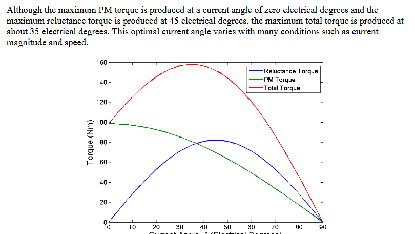

At first I was excited about some rotor time constant array in the beginning but then it turns out they are only used for induction motors. Not much magic going on in case of Leaf motor (starting line 936). It's basically just "get angle", "Clarke/Park", "Clamp", "Park⁻¹" and SVPWM. No rotor time constant is used. The code is a bit convoluted because he had to play a lot of tricks to keep the runtime in check. Thank god we have more horse power on the stm32.
I guess I'll do some more research on MTPA (most torque per amp) to find out how to vary iq/id over the speed range.

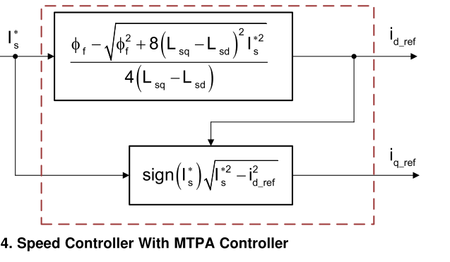

Re: Testing FOC for synchronous motor

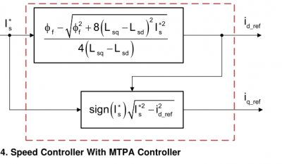

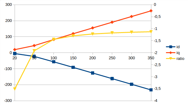

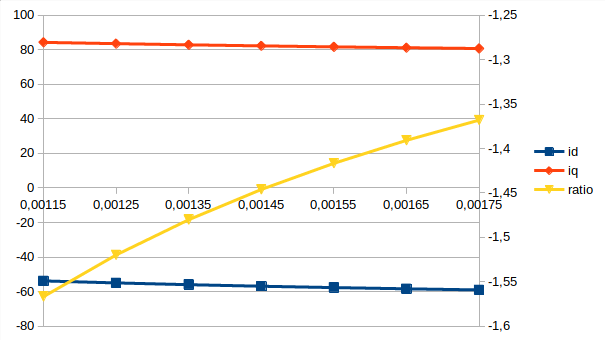

So I found this in a TI paper (www.ti.com/lit/pdf/spracf3)
It does not take speed into account, only the differences in the inductance and the flux linkage. I found another paper that has some actual data on these: https://www.mdpi.com/1996-1073/11/6/1385/pdf
Typical values at medium currents and 90° phase angle are Lq=2.5mH, Ld=1.2mH, Flux linkage=0.09 Wb.
These values plugged into MTPA at 100A total current would result in Id=-57A and Iq=82A. The ratio varies quite a lot with current set points.
So a first approach would be using constant values.
The TI paper also has something on field weakening, just have to find out when to deploy it.

Yes that could actually work. I'll keep exploring the "mathy" solutions. For example I could try if a PID in place of PI controller cures some problems.arber333 wrote: ↑Thu Nov 07, 2019 4:56 pm Is it possible to make a "frewheel" function in code?
You can use it at least thrice.
1. When at such a low speed regen is not desired you can switch to "freewheel" to stop at trafic light.
2. If you dont desire regen say in winter time you switch on BMS pin and motor frewheels untill you apply brakes.
3. You can cheat the code and command freewheel for 1/10th second everytime throttle would pass 0 position. From there you apply regen torque in %.
Do you think that would cure the spike?
It seems in many papers they throw in PI controllers while hardly ever talking about the drawbacks.
- Posts: 3660
- Has thanked: 145 times
- Been thanked: 368 times
Well i dont think PID will cure the regen surge just by itself. Remember, it is still "proportional" first, If you dampen the initial surge you may have a lame response from regen regulator.
Maybe you could retain PI response but you could just cut or blank out torque of initial regen surge and turn torque back "on" when it is on downslope. This should only effect one time after throttle passes through 0%. For example if i would pump throttle back and forth this would cut in every time throttle goes down.
What happens when throttle is going from 0% to positive? Is there also a positive throttle surge? I can tell you with ACIM there is. I have succesfuly dampened it by streaching FW point further on slip graph. However this turned Mazda into an average car.
