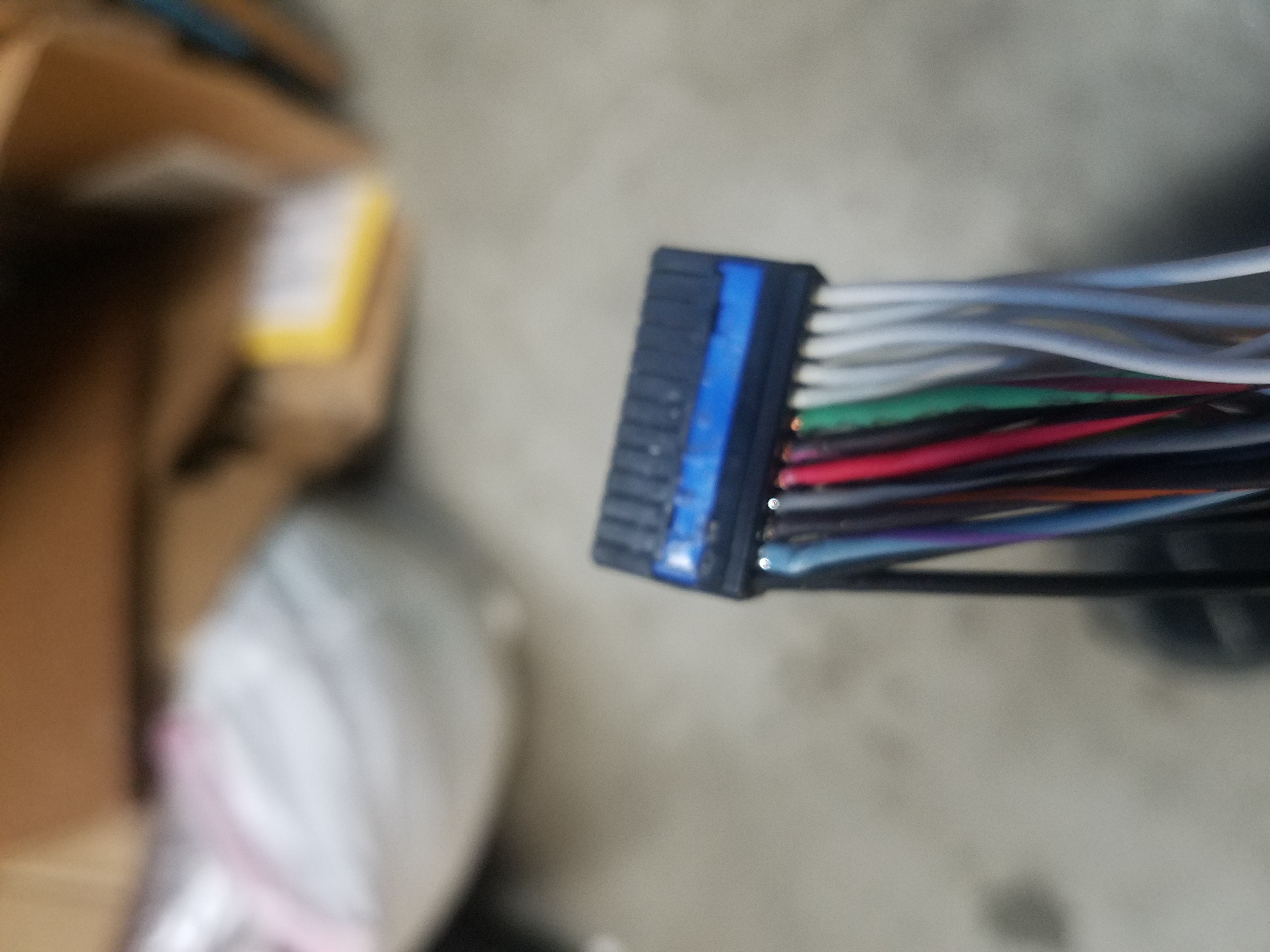

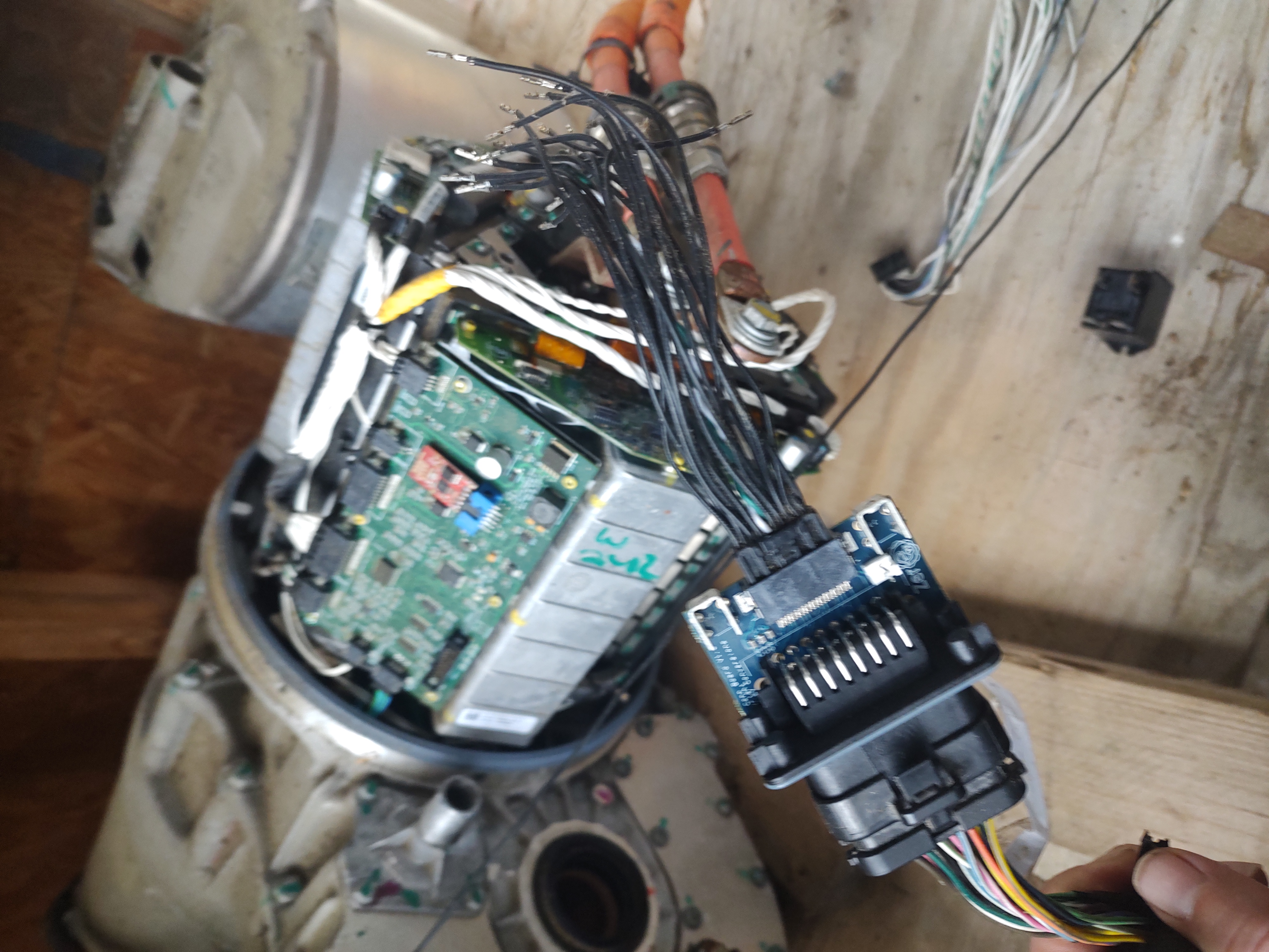

Turns out I ordered the wrong JST connector and posted the wrong link earlier in the thread. Ended up just pulling the JST connector off the Zero Ev loom I purchased to build my harness. The one I listed only excepts 20 wires and the tesla JST connecotor to 23 pin ampseal connector takes 24 wires.

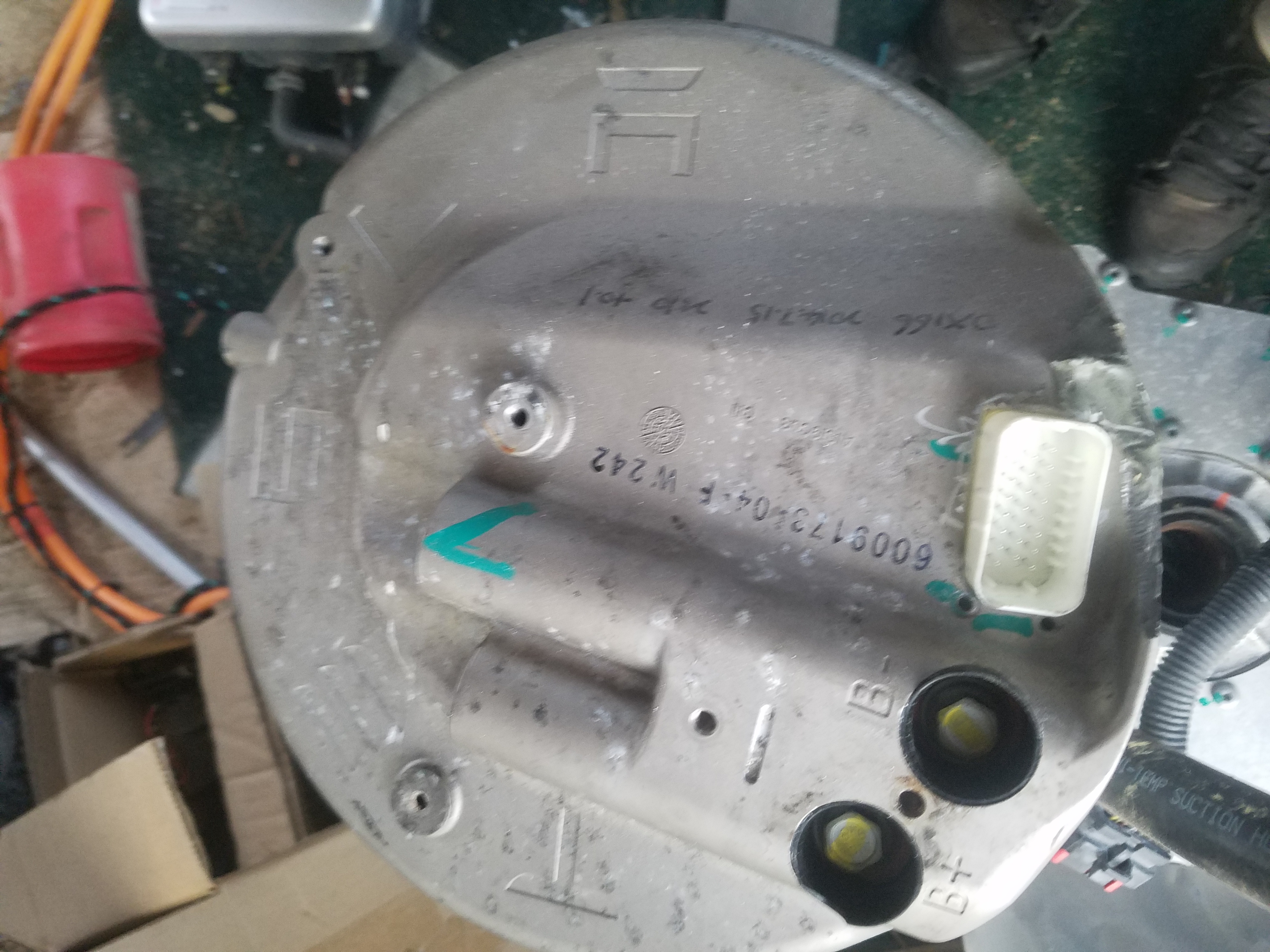

I built the harness using wires from the 23 pin ampseal ms3 pro 8 foot harness wires. Not sure its going to work. I know John Volk has had good luck with the cables. Just terrible at ordering 22 awg wires with 19 strands like the original mercedes wiring harness. The rubber housing does not fit inside the JST connector which kind of scares me because of the almost imminent possibility of electrical shorts that could and probably will occur if I don't find another cable to use. Just cant sit around all day and do nothing. So I tried to guess my pinouts based on the pinout charts provided and solder all the wires to the 90 degree 23 pin ampseal connector using my weller soldering iron.
Got it all built, cut the ampseal connector hole a lil wider to accommodate the 23 pin ampseal connector and installed it.

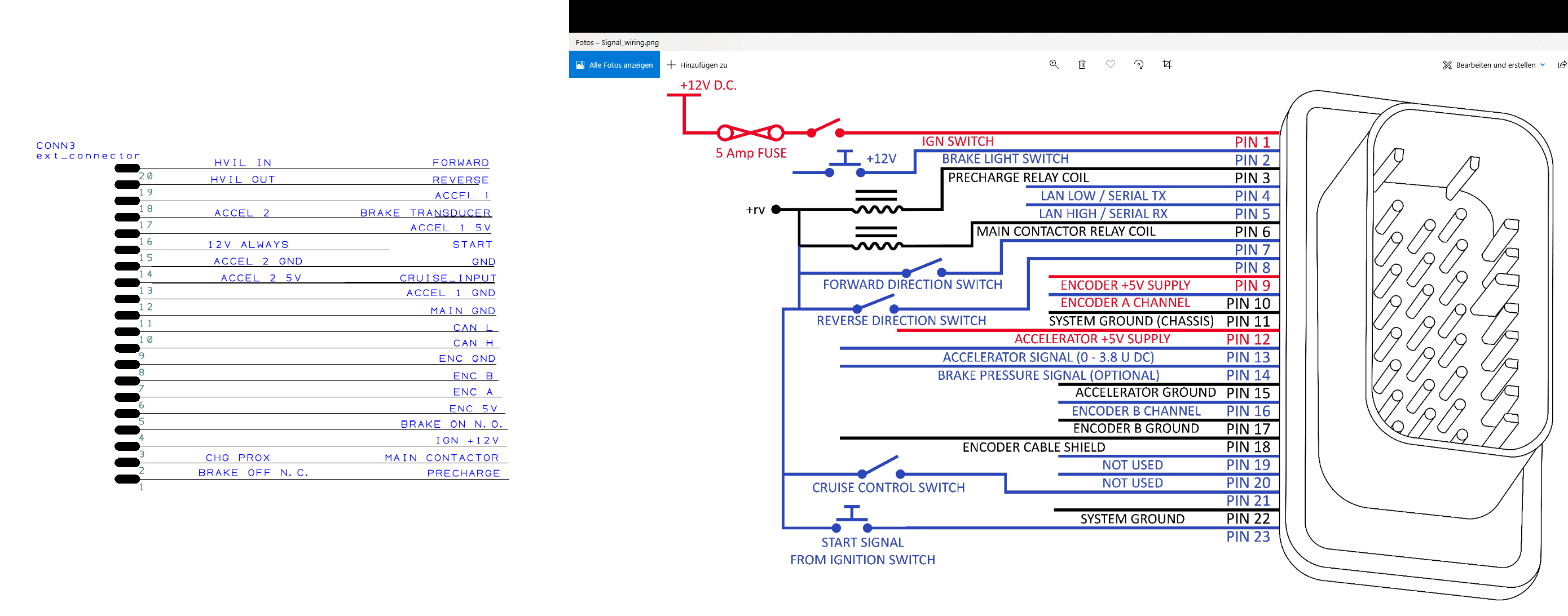

So I fished up the wiring harness and hooked it all up to a 12 volt battery. I got something wrong because the board will not light up.
I can not figure out what +rv stands for on the diagram. Anyone got any ideas where I should hook up all these wires when it says +rv
- Posts: 4006
- Been thanked: 1134 times
Re: Mercedes-Benz B Electric - motor support
Its a missprint. It should be simply +12v.

Otherwise I fear I may have the wiring on my custom harness hooked up wrong.
Also Not quite sure where the can lines are supposed to go? If I where to guess I would say the DC to DC or the Charger? Still got to begin work on all the wiring on these componants.
Isaac96
- Posts: 656
CAN lines go wherever you need them -- if you don't plan to use CAN with the inverter you can skip them for now.

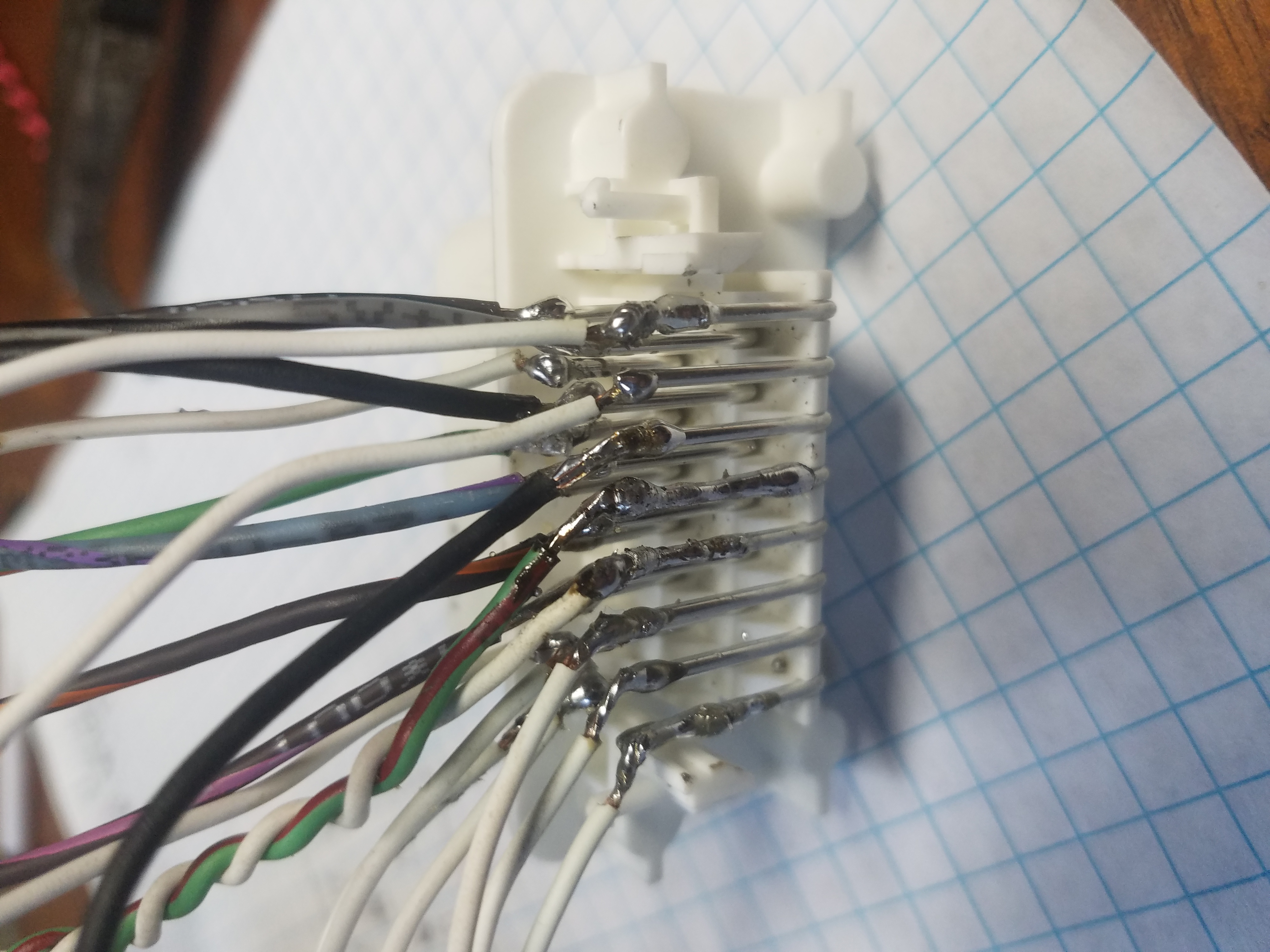

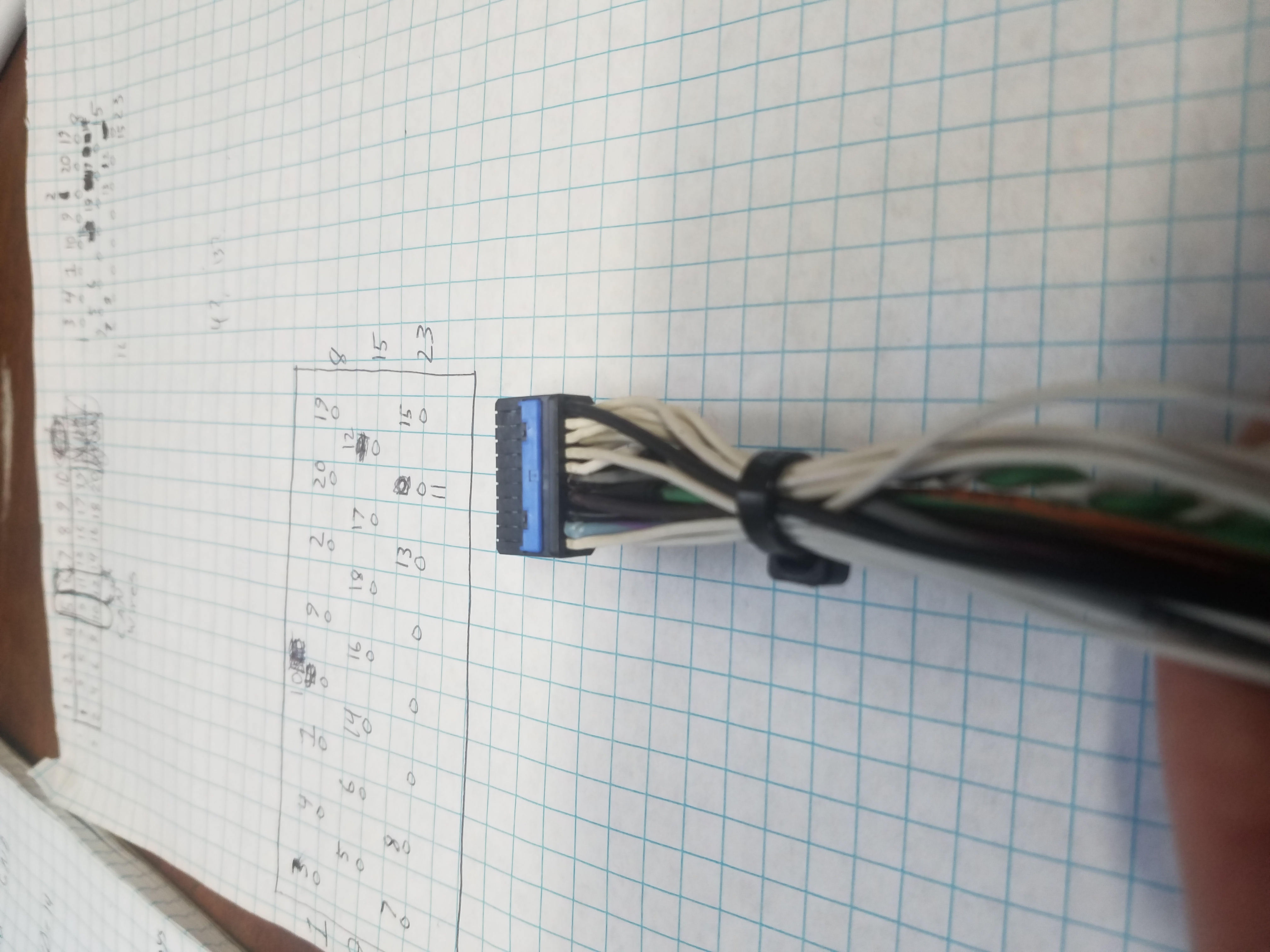

Such a painful thread to read. Two (OK, three) things I can address:
Mating Connectors: one non-obvious thing about the way that connectors parts are named is that the plastic housing bits have nothing to do with the gender. The gender of the terminals (the metal bits) are what determine whether a connector (housing [shell] + terminals) is called male or female. Again, ignore the connector's plastic housing: you'll usually find that the terminal gender is the opposite of the housing gender, but there are exceptions so never guess, always check. This will have you ordering the wrong parts over and over until the lesson is learned.
Connector pinout numbering: when dealing with electronics, get comfortable using the manufacturers' datasheets, you'll need them over and over. Pinouts are always specified in the connector's housing datasheet. There is not "one way" that connectors are numbered, although if you work with enough of them you can sometimes make an educated guess -- which is a Bad Idea.
When things have been connected improperly, always assume that damage has been done, and don't assume that correcting the connections or wiring will fix the situation. You are not connecting things together at the consumer level here, where often designers assume that consumers WILL connect things together wrong, so the components have some rudimentary protection -- either physical, electrical, or both -- built-in by design. At the level you are working with components, there is often no circuit protection from making a misteak, so if it's connected wrong once, assume it's broken until proven otherwise.
so the female end is on the left.
the male end would be on the right.
I was looking at the plastic housings not the actual metal connectors. this changes everything.

I hope you’re not actually running this connector in the drive unit. This is a big no no. the chance of this failing is very high. driving a 400hp motor, very dangerous.
leman2112
- Posts: 173
- Joined: Sat Dec 21, 2019 10:30 am
- Location: United States
- Has thanked: 29 times
good point. Any suggestions on how I could make it safe? Maybe I could just do a gland nut like jrod talked about earlier in thread?

Here’s an off the shelf solution https://zero-ev.co.uk/shop/ldu23db-ldu- ... oard-12873
at least spend some time soldering each connection, have the striped wire strands fully parallel to the connector pins. Then heat shrink each connection to shield and take the stress off the wire. The solder makes the wires brittle and susceptible to cracking.

yeah that was the first time I soldered anything. your method is a way better idea.
I am going to buy that part from zero ev. then I don't have to guess the coding of the connector pinouts. such an awesome plug and play solution. thanks so much!
