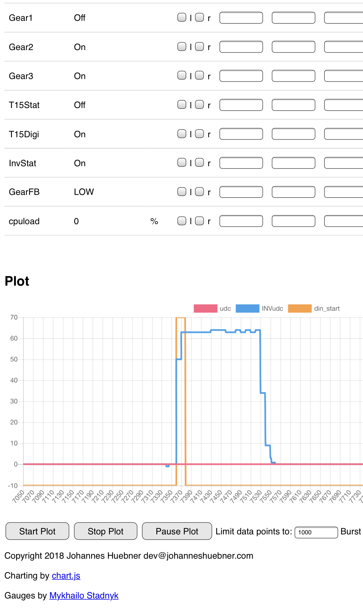

OK, some progress but stuck again - appreciate any suggestions.
Shunt is connected up to CAN EXT.
“Start inverter in manual mode” produces a message “unknown command sequence”. What should it do?
Pulsing the start signal operates the precharge relay, which stays on for about 5 seconds. However the main relay doesn’t close and there is a message “STOP-PRECHARGE”
Supply voltage is 65, all minimums are set to 45.
Here’s the plot of that happening. INVudc shows up (that’s read from the inverter?) but not udc.
And the parameters I have set:
params.json
(637 Bytes) Downloaded 415 times
What should I be looking at to debug this, is there still a serial output?

et0 wrote: Wed Oct 13, 2021 11:56 am
Looking at the code, seems a reasonable guess that it's not communicating with the shunt, as that's where udc comes from. So maybe the shunt is not initialized. I can see code for that in the project but it's commented out. Should I go down the rabbit hole and try to build the source and call that initialize function or is there an easier way?
I see parts of a serial interface in there but it doesn't look complete? How are people typically working with this HW? It would be great to have some basic live info like whether comms with the various modules is established, view of the states and variables etc.
Lots of questions into the void...

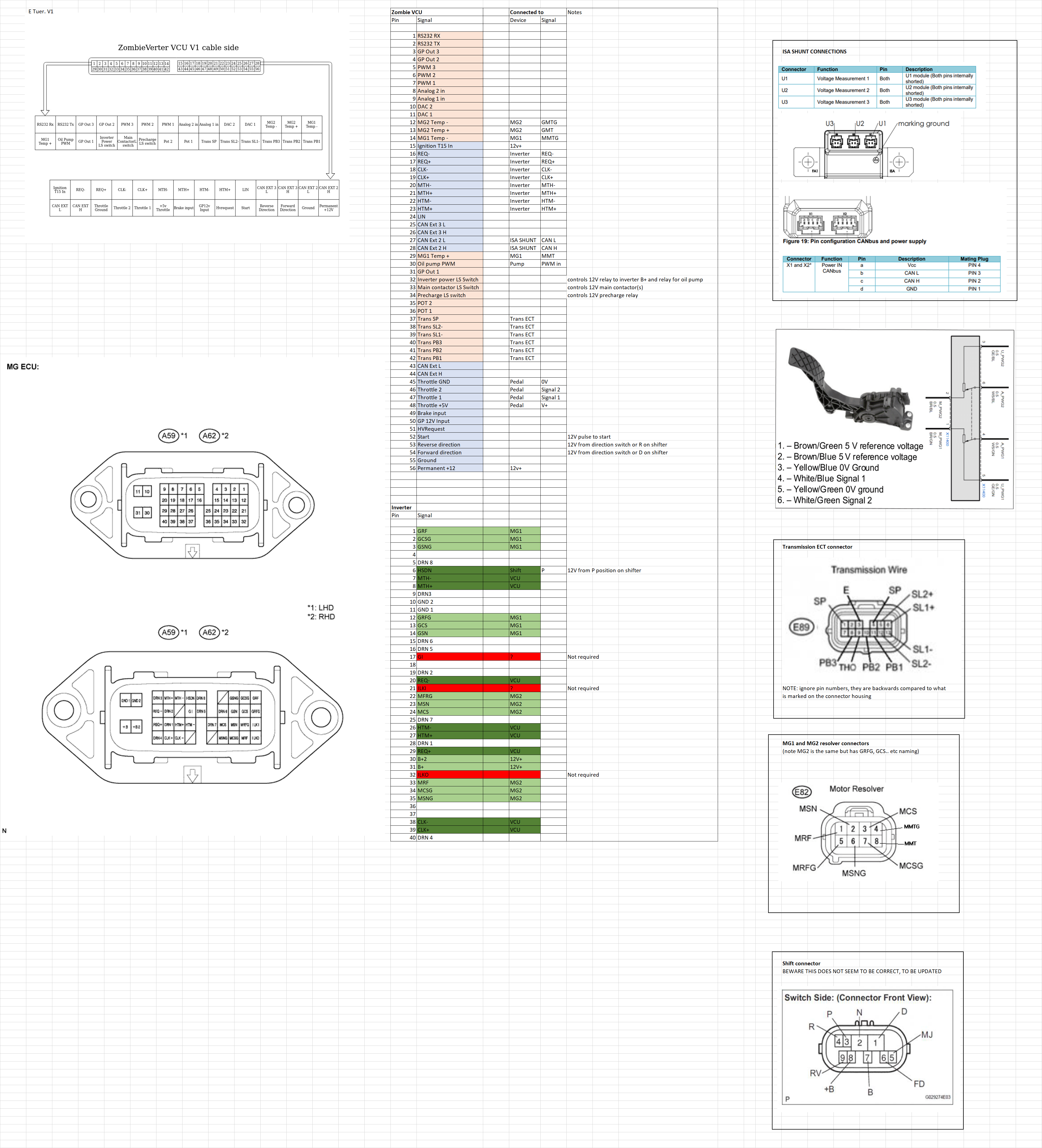

Here's a list of connections and where they go to, or at least my best guesses. I've added it to the wiki since it's better than nothing, but will update as I learn of further errors.

et0 wrote: Thu Oct 14, 2021 4:23 pm Here's a list of connections and where they go to, or at least my best guesses. I've added it to the wiki since it's better than nothing, but will update as I learn of further errors.
This is great! Hope that the other connections can be filled in soon, along with maybe some definitions of the abbreviations, and for what purpose the others may be used.

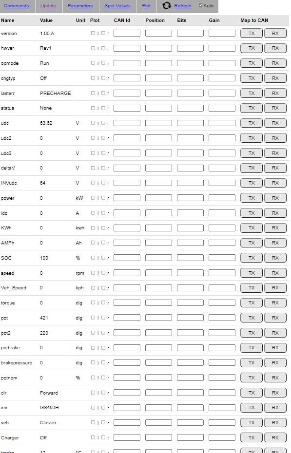

OK, the tweezer trick worked. Assuming that's the reset line for the STM, I might solder a button on there.
And the shunt appears to be programmed (it's reporting udc at least), and the VCU seems to be back to life.
Problems I'm having:
1) InverterPowerLSSW does not pull in the relay to turn on the inverter, so I bypassed it for now. Can hear the relay buzzing slightly.
2) tmpm was 6400, which produced an error. I zeroed it out in the code, and the error has gone, but that seems like an issue.
3) Now I have "run" and no error, forward selected etc, pot signal is good, 0.6A pulled from the HV supply but no sign of the motor turning.
4) no terminal still
What should I look at next to get the motor spinning please?
params.json
(976 Bytes) Downloaded 372 times

Lexus GS450h as far as I know.
Inverter number G9200-30030 A06K06Y023
Can't see a number on the transmission.
Yes, UDC is showing 65V after starting, so is INVudc. udcsw is set to 45 as is udcmin.
Yes I have calibrated the throttle (set min just below the lowest value and max just above the highest value) and can see the pot input moving correctly.
As I said, Forward is selected (and showing on the GUI) and T15 is on. Start has been triggered and pre-charge happened OK.
All this can be seen on the screenshot I think?
